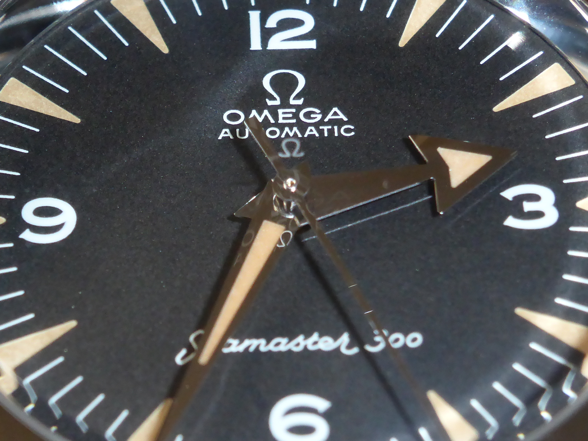

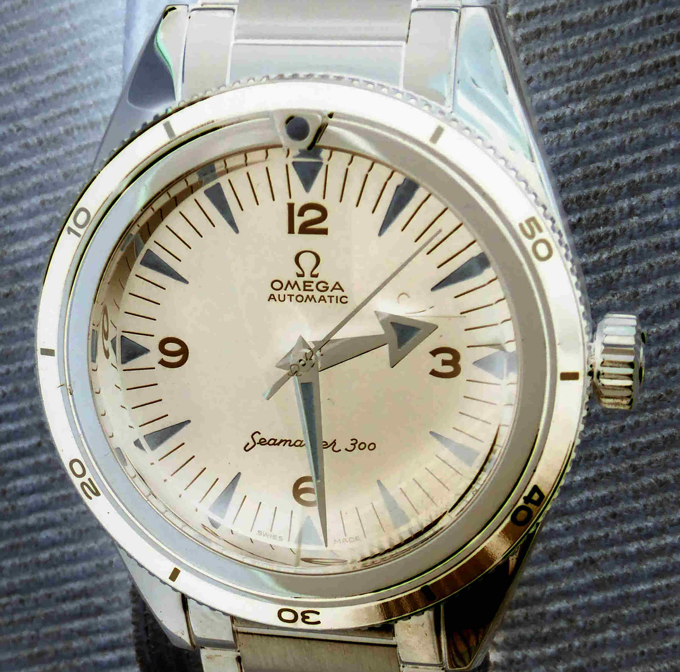

I love my modern movement 57 trinity Seamaster,(pictured) but I have been giving the Railmaster more attention following some of the threads here (example thread link below). It is a fine looking watch IMHO

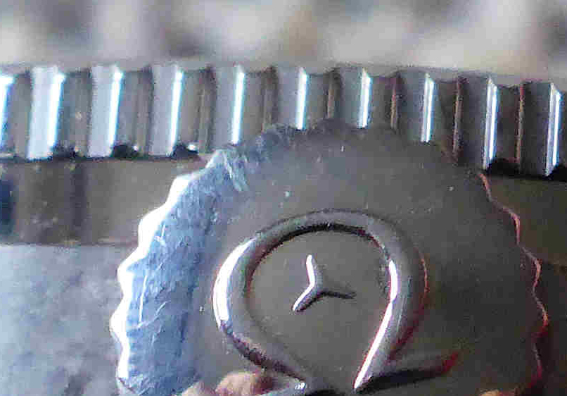

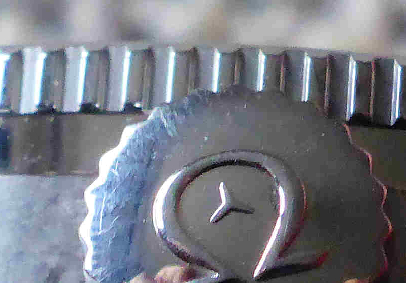

From a recent review I read, it looks like the vintage Railmaster was also fitted with the obsolete Naiad crown water sealing system. The 57 re-issue Railmaster still has the 'Mercedes' symbol on the scanned modern homage (not to be confused with the new Naiad case back system now fitted on some Omega watches).

The caseback/crystal are also major factors and IMO other than marketing are the main reason why the Trilogy SM is rated deeper than the SM. The back on the RM seems thinner with a different profile. Crystals and casebacks crush under extreme water pressure if not sufficiently strong. The sapphire crystal is also a different possibly weaker curved profile on the RM. The crown screw down factor really only prevents the pulling out the crown under water on clothes etc, it doesn’t add water resistance in its own right. They are different crowns though so there may be other sealing differences. Both watches maintain (some, all?) water resistance if the crown is pulled out under water.

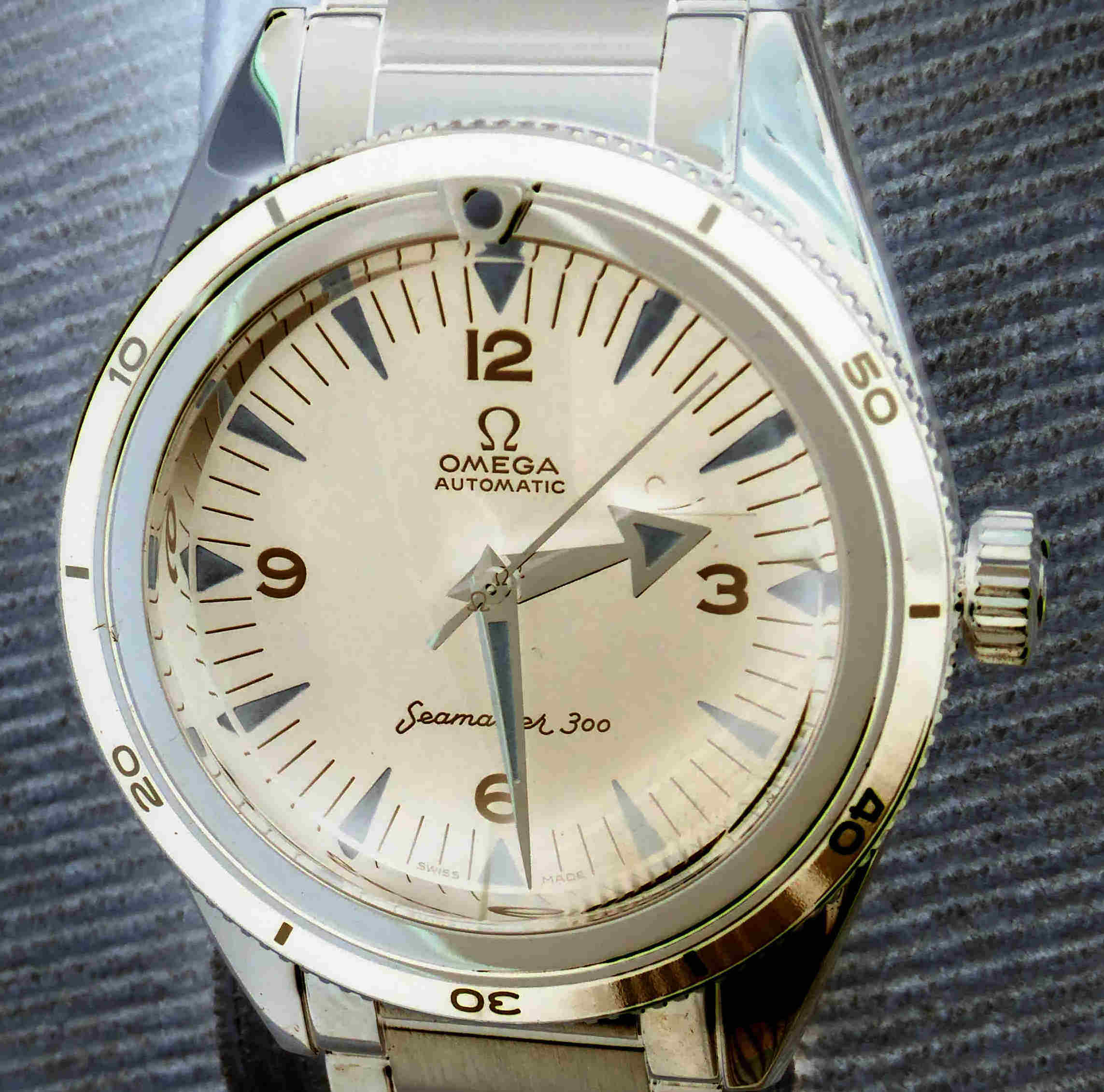

A white SM300? I've never seen that before.
Its a negative filter. I had to look twice.
4,719
17,868
Ref the negative filter on polished watches I sometimes use it to remove any distraction and show the dial / bezel details up in a different light (so to speak).

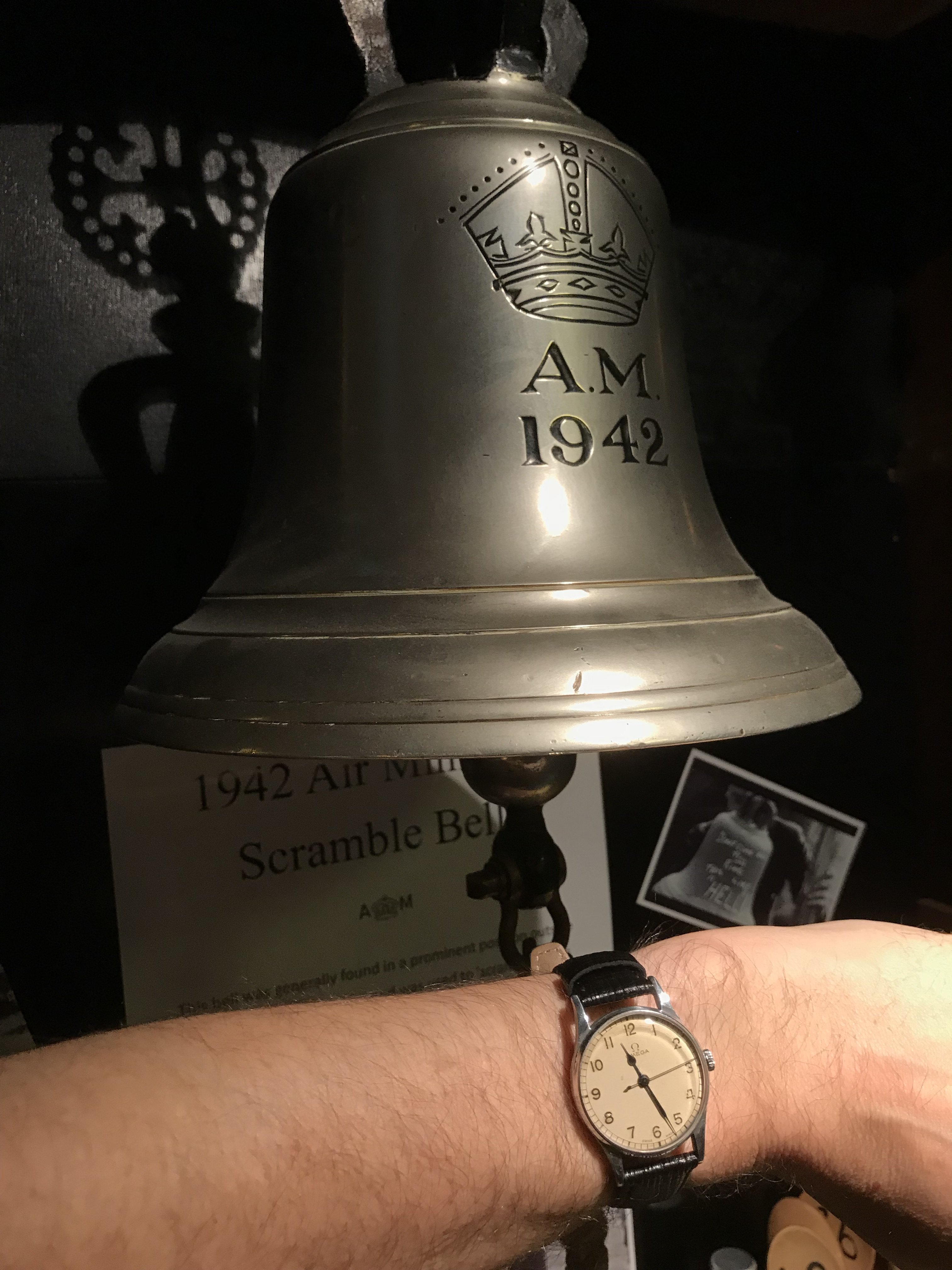

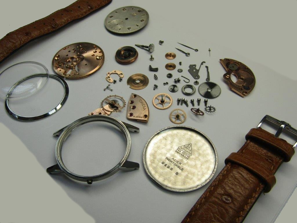

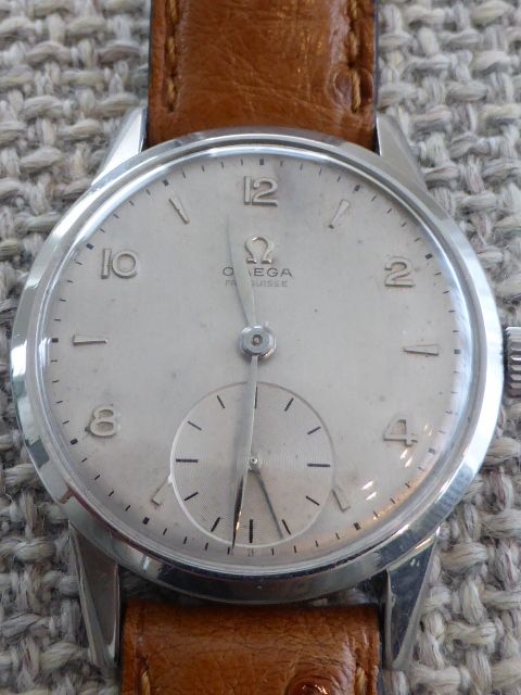

Thanks again for the replies and the links. I have had time to read the articles now and found them very informative. Showing my ignorance of the Railmaster I had not realised it was based on the 30T2 manual movement or that ‘versions’ had also been used by different Air forces. I am still very pleased with my Seamaster choice from the modern trinity but in some respects the Railmaster would have been a nice fit to my current collection and flows well from the 6B/159 - 30T2 and CK2495 / 265. The re-issue RM is a lovely watch in its own right but part of me now wishes it was also a manual wind. Knowing how important the 30mm movement was in the evolution on the brand reading this information has left me seeing the original Trinity in a new light and feeling even more love and respect (if a bit belatedly) for the Railmaster.
