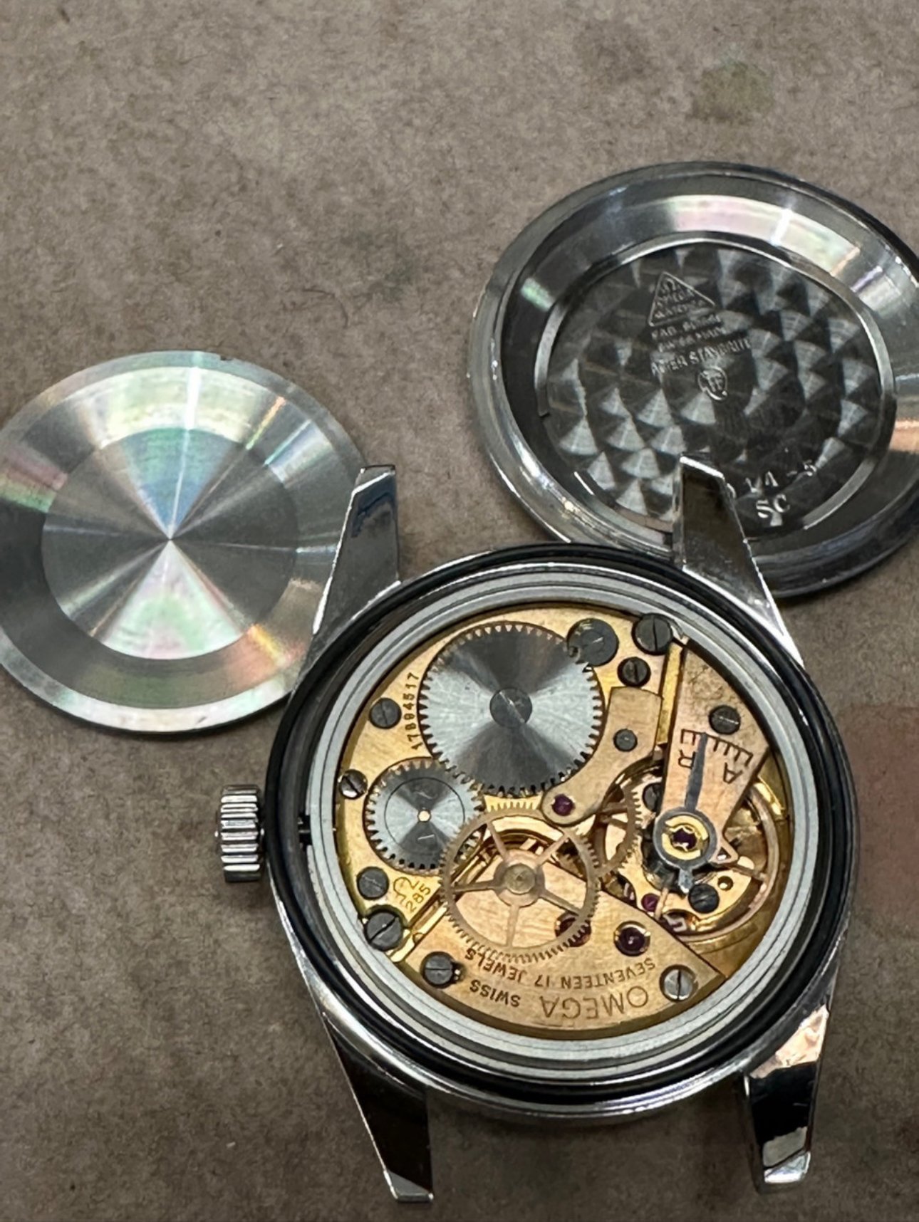

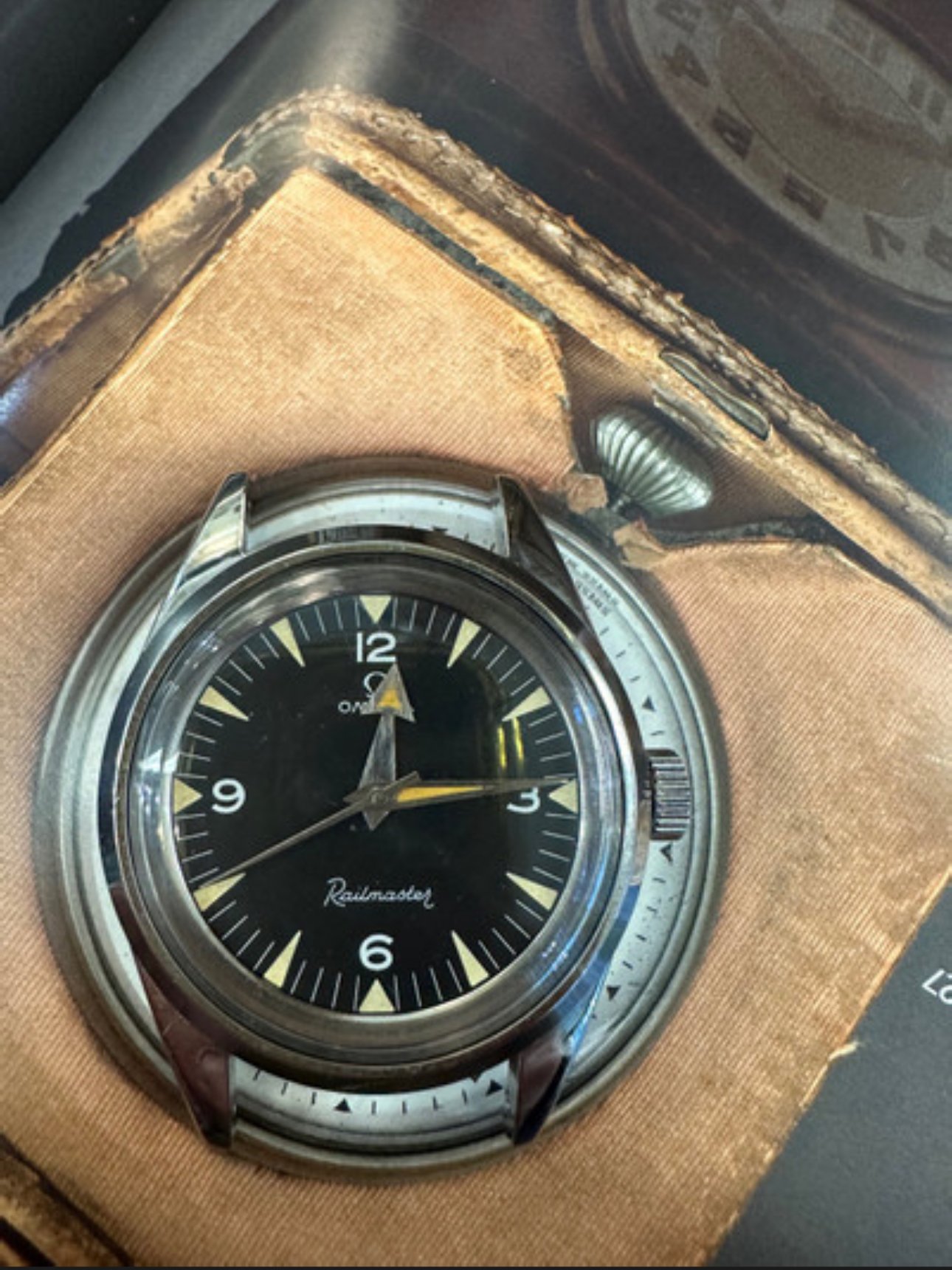

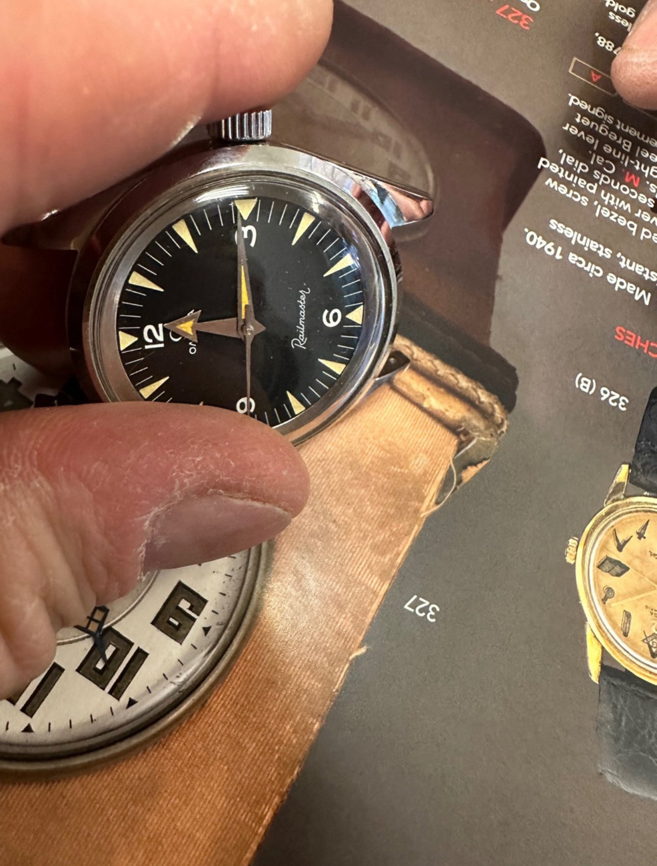

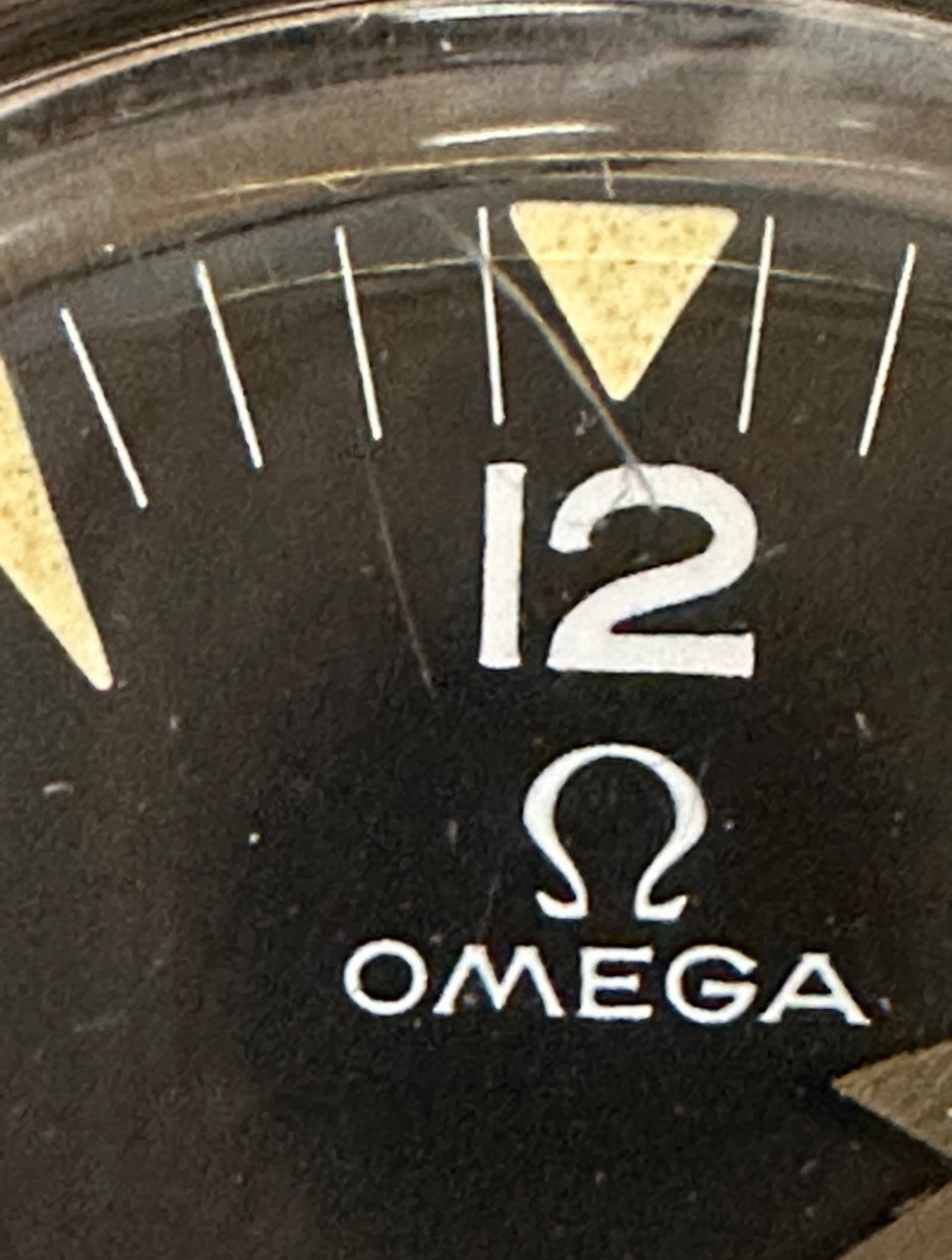

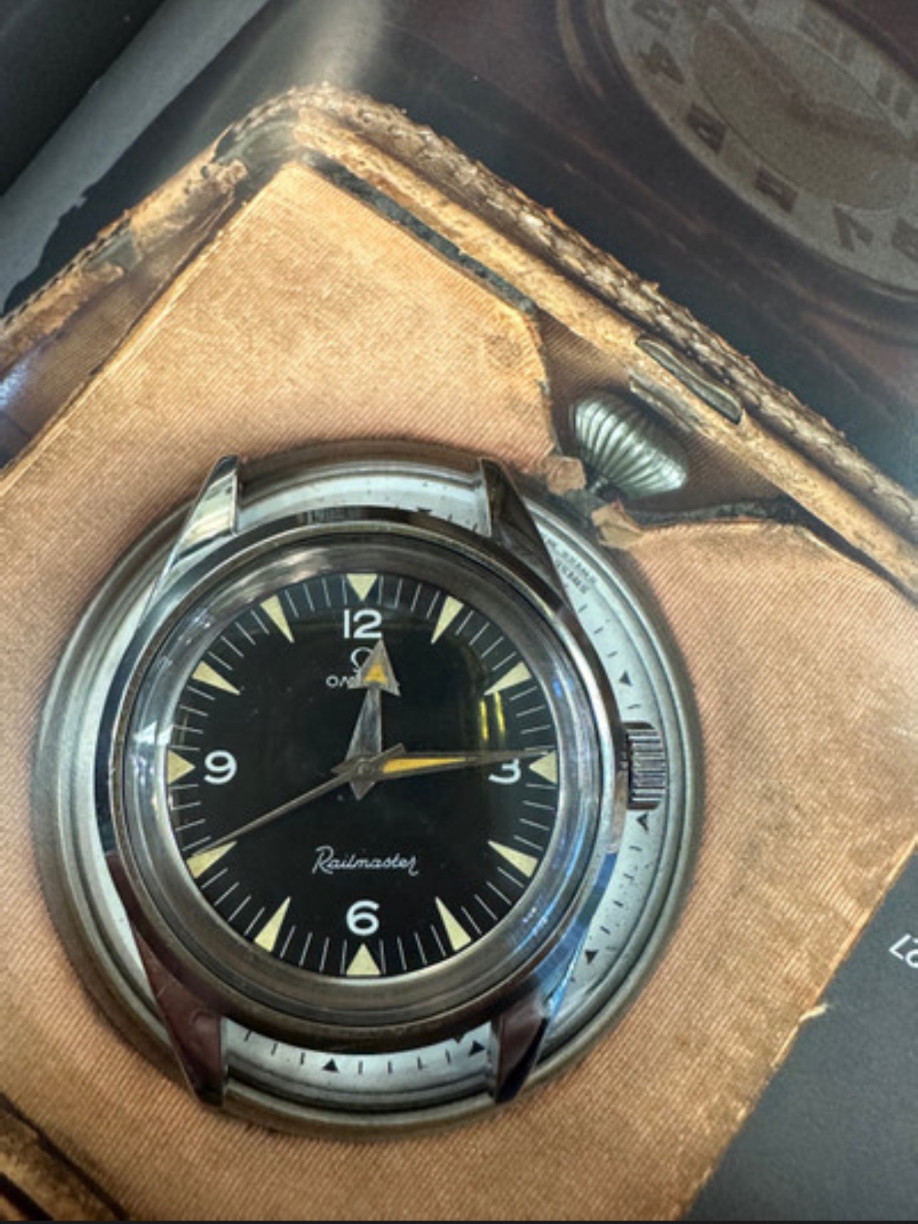

Hi everyone. Below are photos send from the seller of a vintage Railmaster. I have no idea what to look for unfortunately. I’ve always admired this reference from afar. Any feedback is highly appreciated.

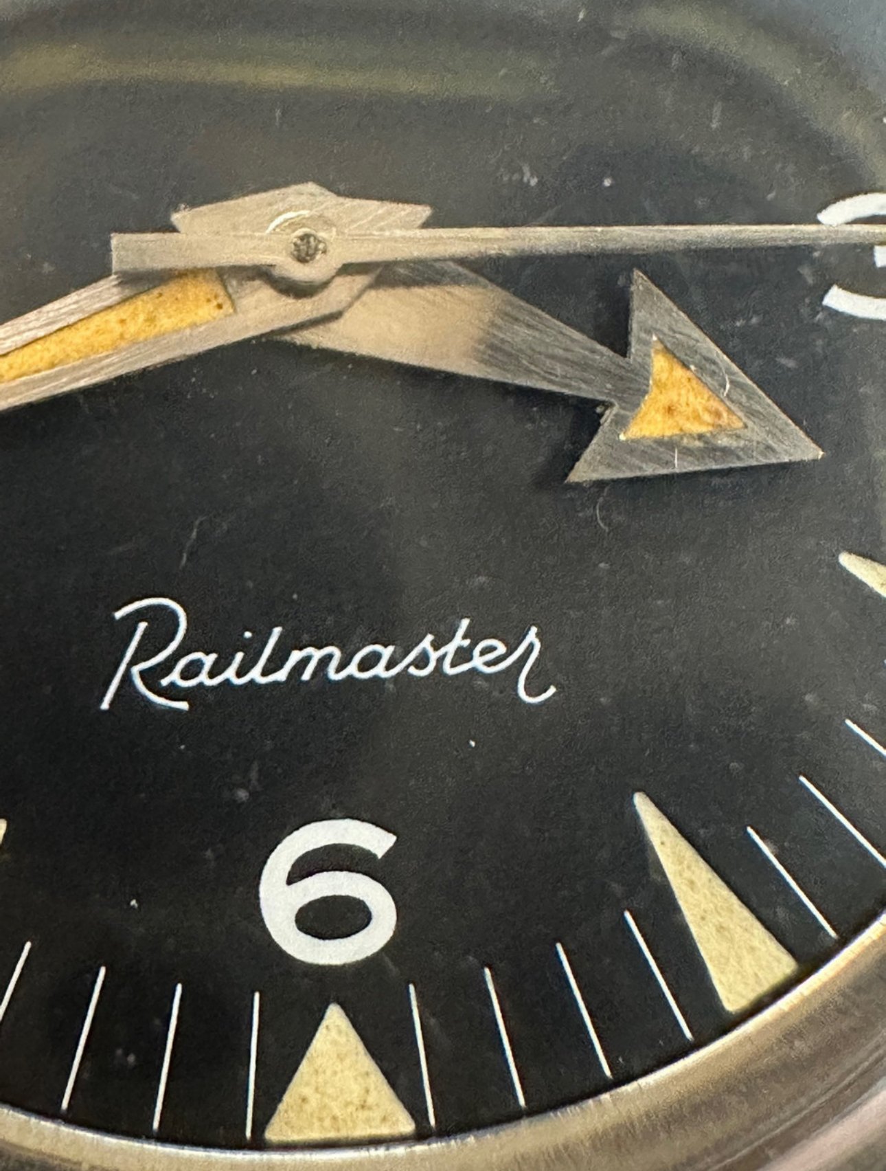

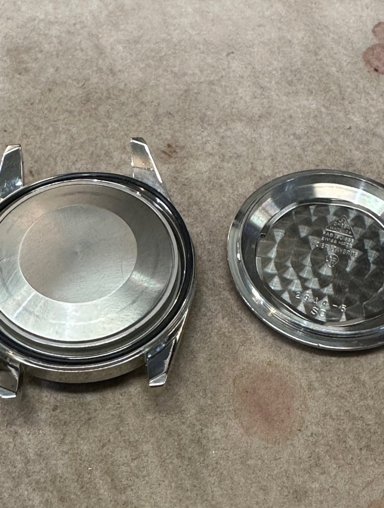

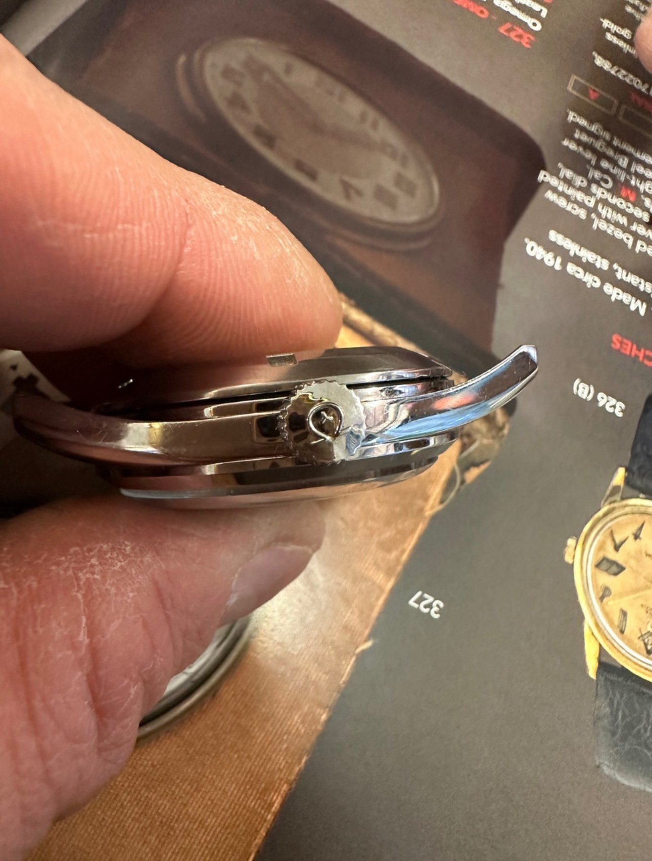

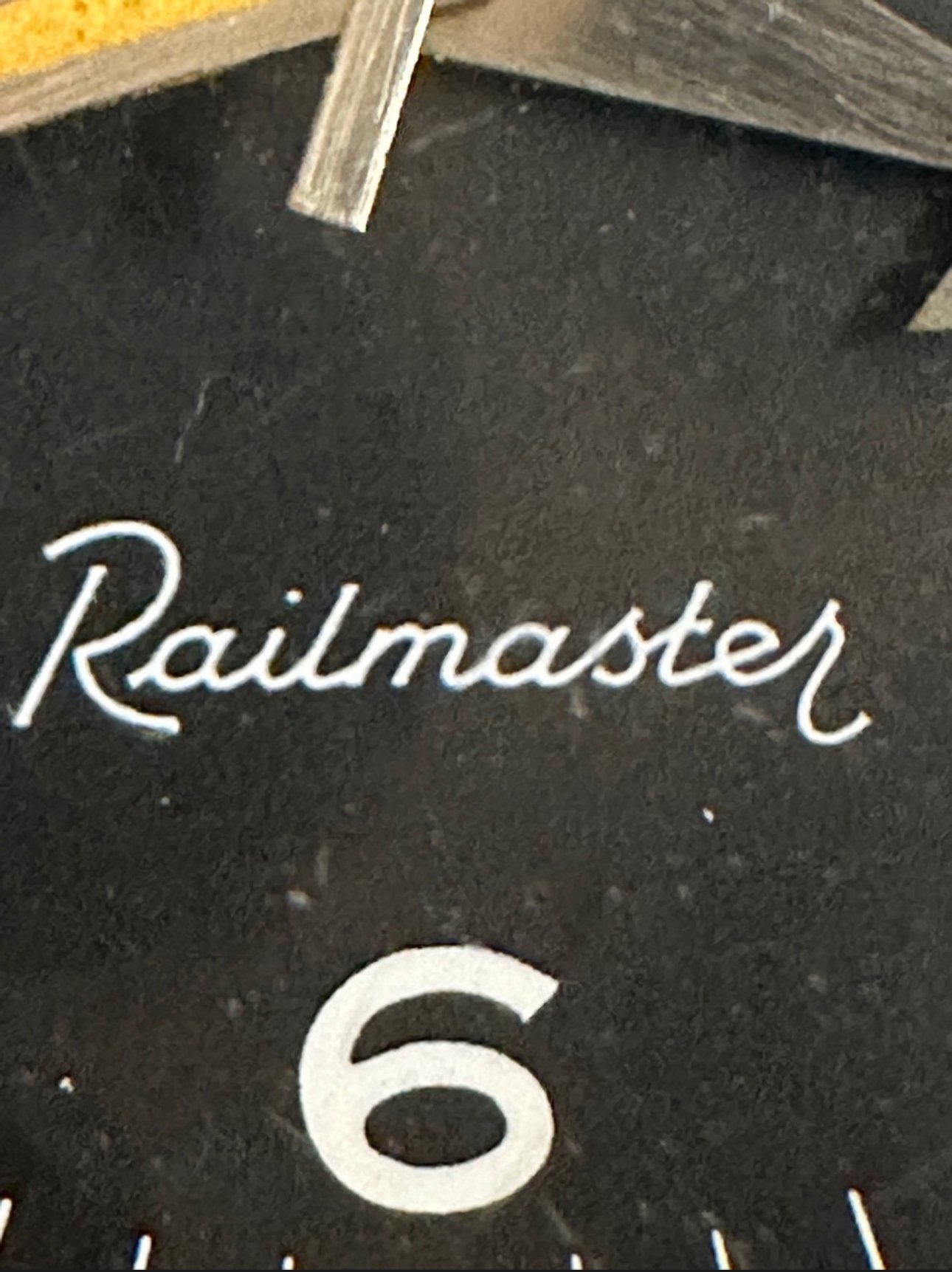

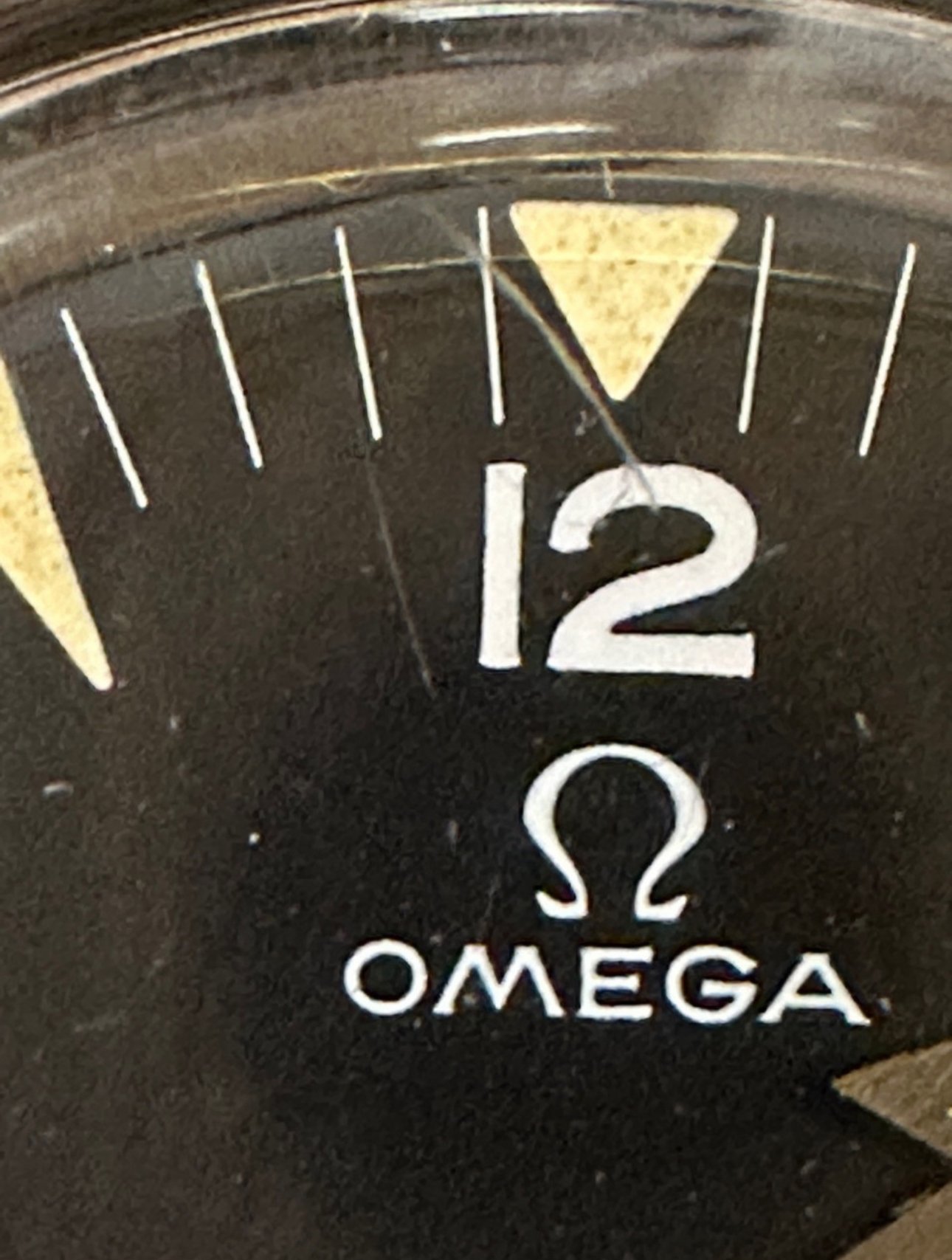

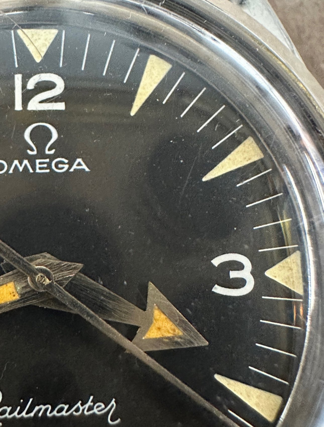

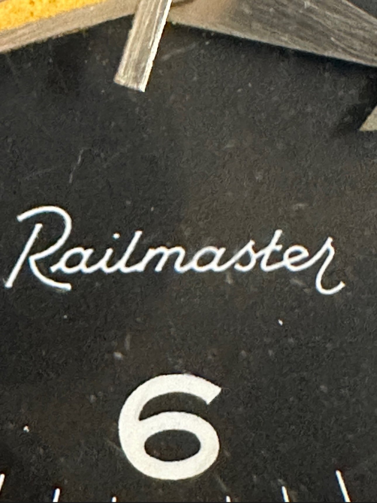

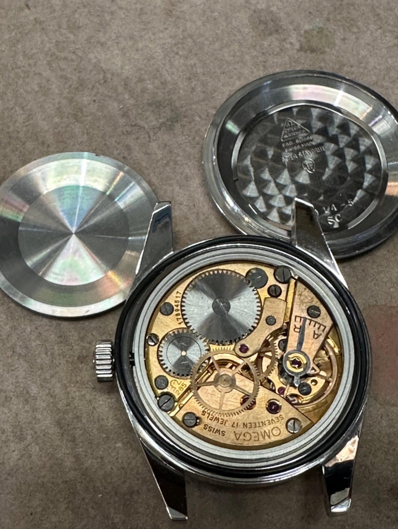

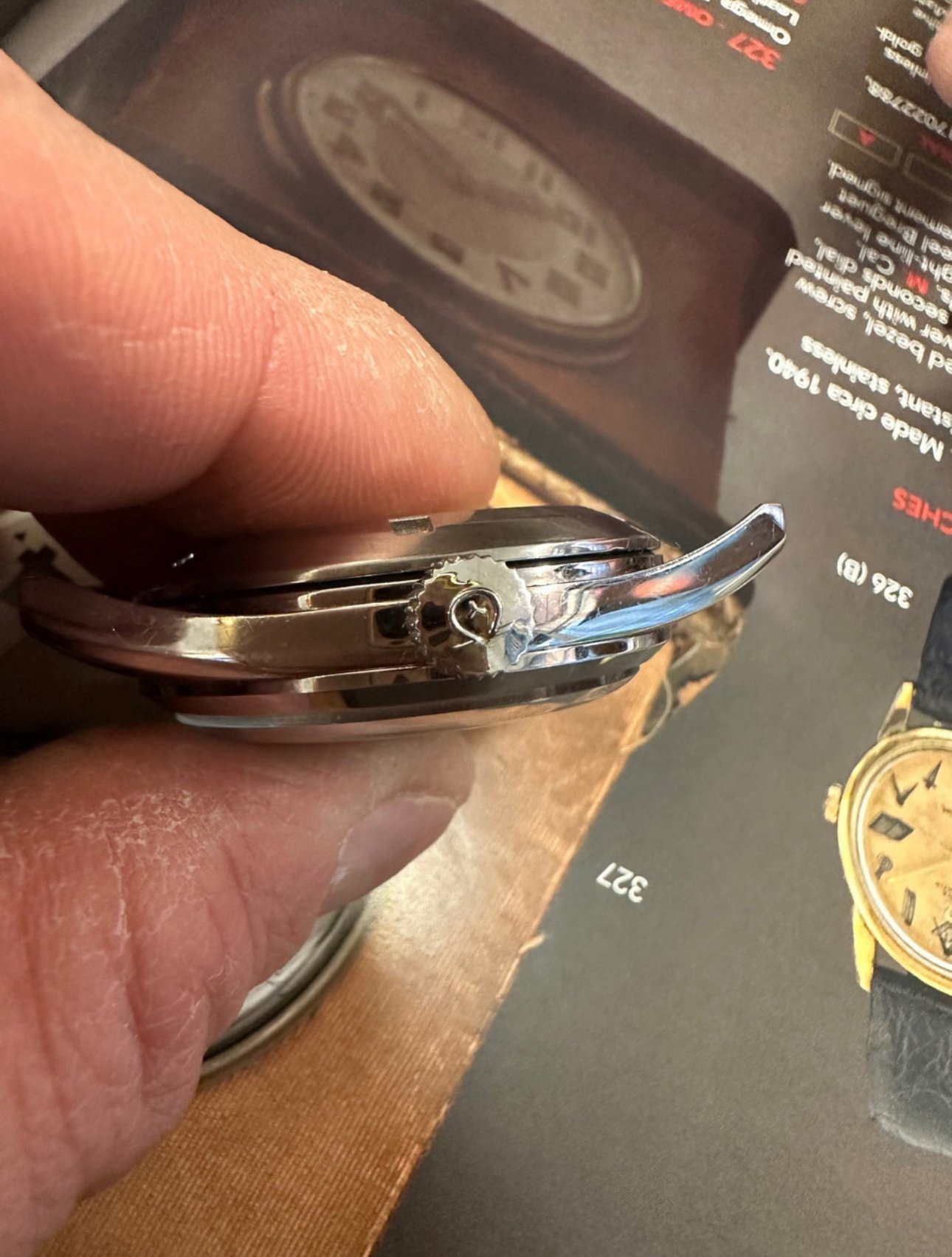

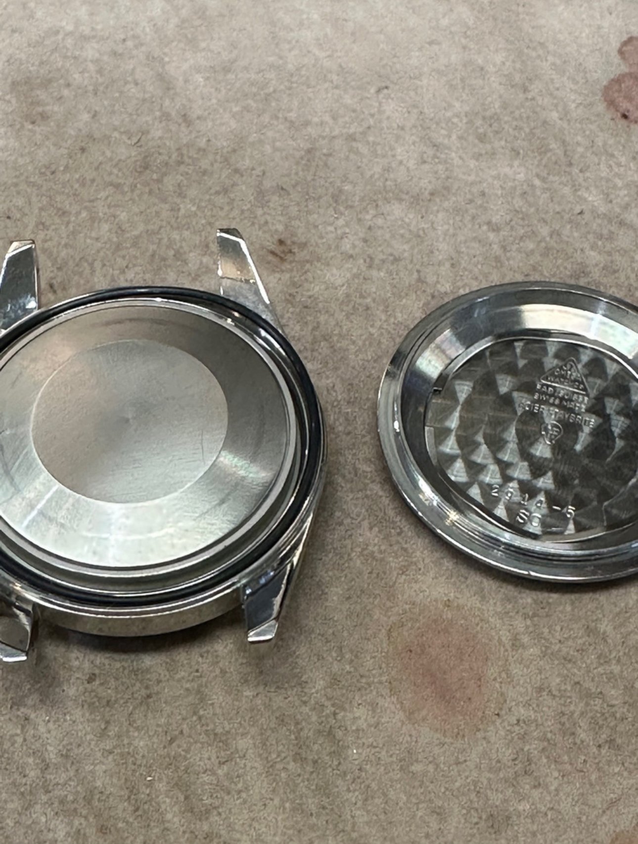

Case looks very new. Need more close up's and outside case back close up as well. Pics. straight from above and move the hands to 2.40 for the pictures. Make sure, the lume is filled into lume wells cutouts on the thick soft iron dial. And is not just printed on. All lume on this dial has rounded corners ; should be sharp and not rounded. Lume too uniform on dial versus hands. The movement sits in a newly manufactured non amag mvmt. Ring and inner non amag back. The inner spring loaded original " press down the inner back " ring is missing as well. The hands have been coarsely brushed ... Rust ? Different, wrong coating ? Exact diameter without crown needed.

Thank you for taking the time to write this up. The seller confirmed the dial was refinished while in his possession. He’s asking $2800…🍿
