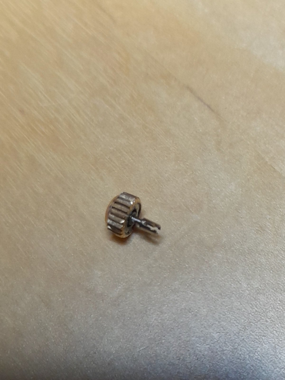

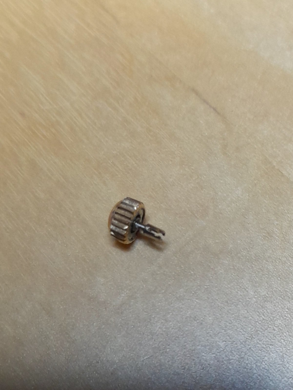

If the stem issue you described is with the cosmic, that one should have a split stem. It's hard to tell without seeing (and I'm not an expert either), but the issue you described does not necessarily mean that you need a new crown and a stem. It could be the connection point of the two parts of the stem, but I'm just speculating here. You could reuse your current crown with a new stem, if that's where the issue is.

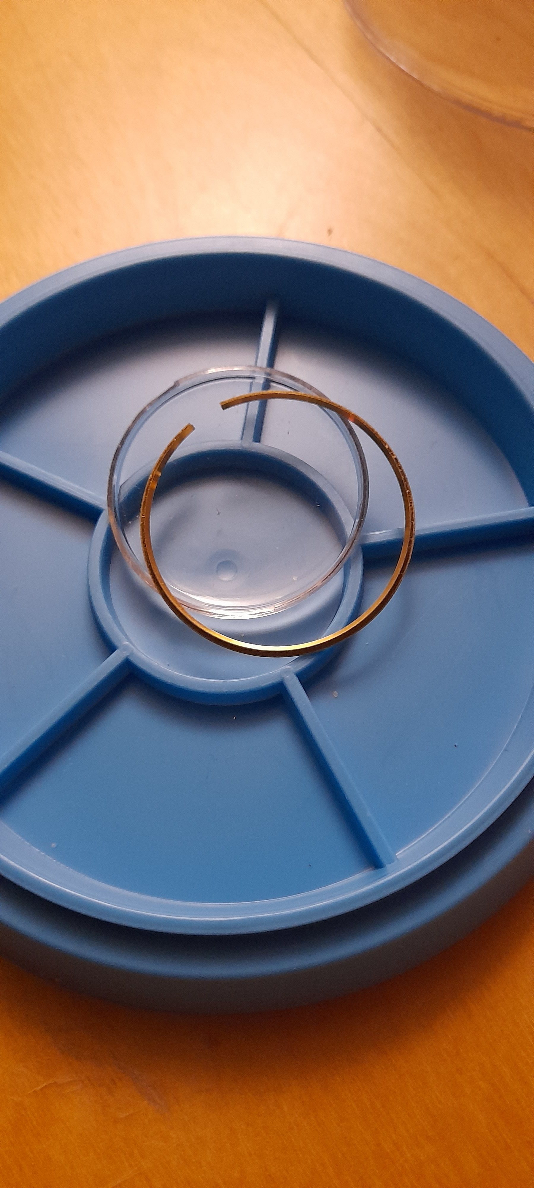

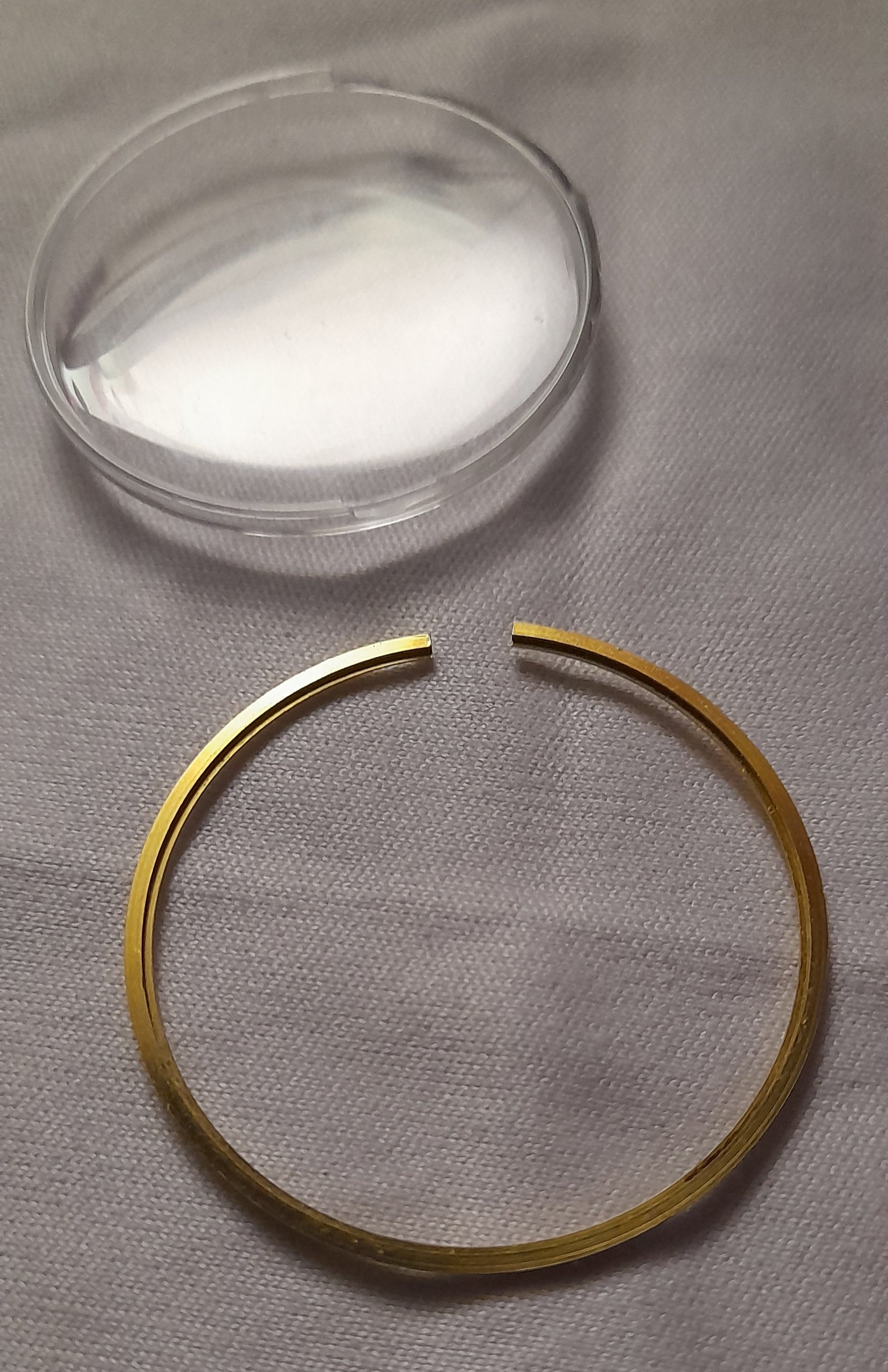

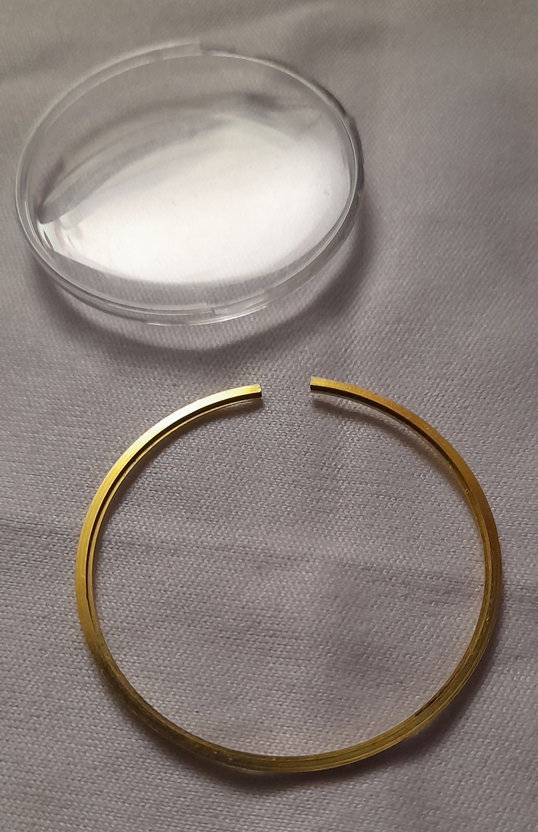

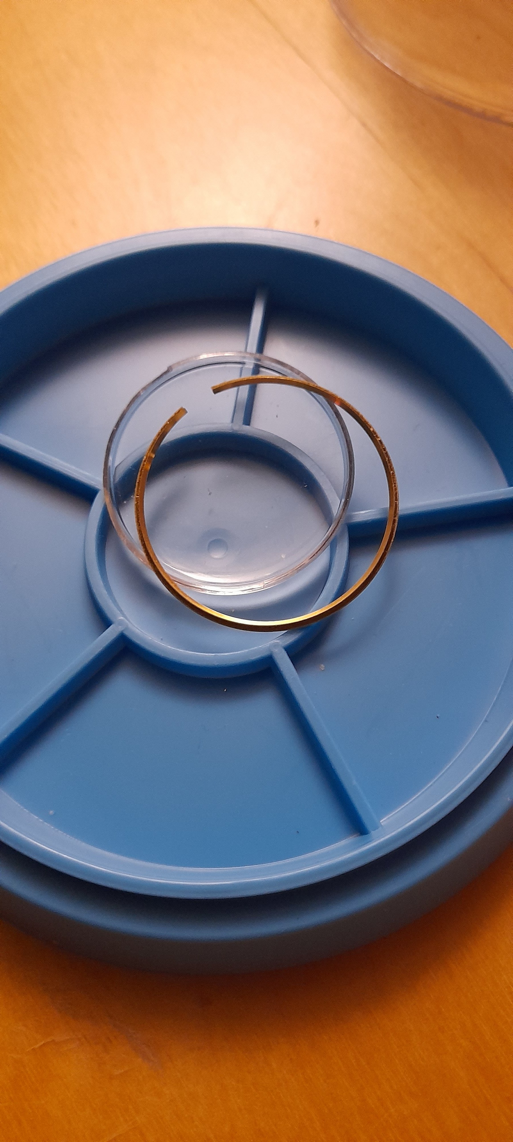

I know £142 is a crazy price, l can get a genuine cheaper the confusing bit is its the same parts number for the crystal omega 5123, but for a 166.032, mine is a 166.0260 same measurements 32.95mm. I took the old cracked crystal out with a crystal press and saw that however installed the crystal either broke the ring or they put it in with the broken ring
As for the crown and stem, l'll wait and fit the new generic crystal and see if l can engage the crown as the crystal and tension ring acts as the movement holder in the cosmic, it would just be handy to know the stem part number, the crown looks okay

When l removed the crystal this was the ring looked like
That is how they are supposed to be.
That’s not broken, they have a split in them.

I can’t comment on this specific reference as I can’t recall owning one, but for some references, particularly the front loaders like 166.020, generic crystals often do not work well at all.
In these refs the crystal has a tension ring similar to the one you’ve shown, which also acts to secure the dial. Generic crystals often put too much or too little pressure on the dial and also can be a poor fit with the bezel, being too tight to properly apply or too loose to be properly secured.
