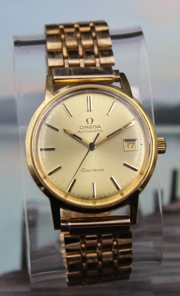

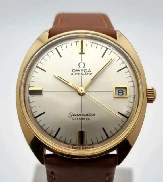

These are my 2 vintage omegas, as my first Omegas, l don't think l've done too bad with the look and movements
