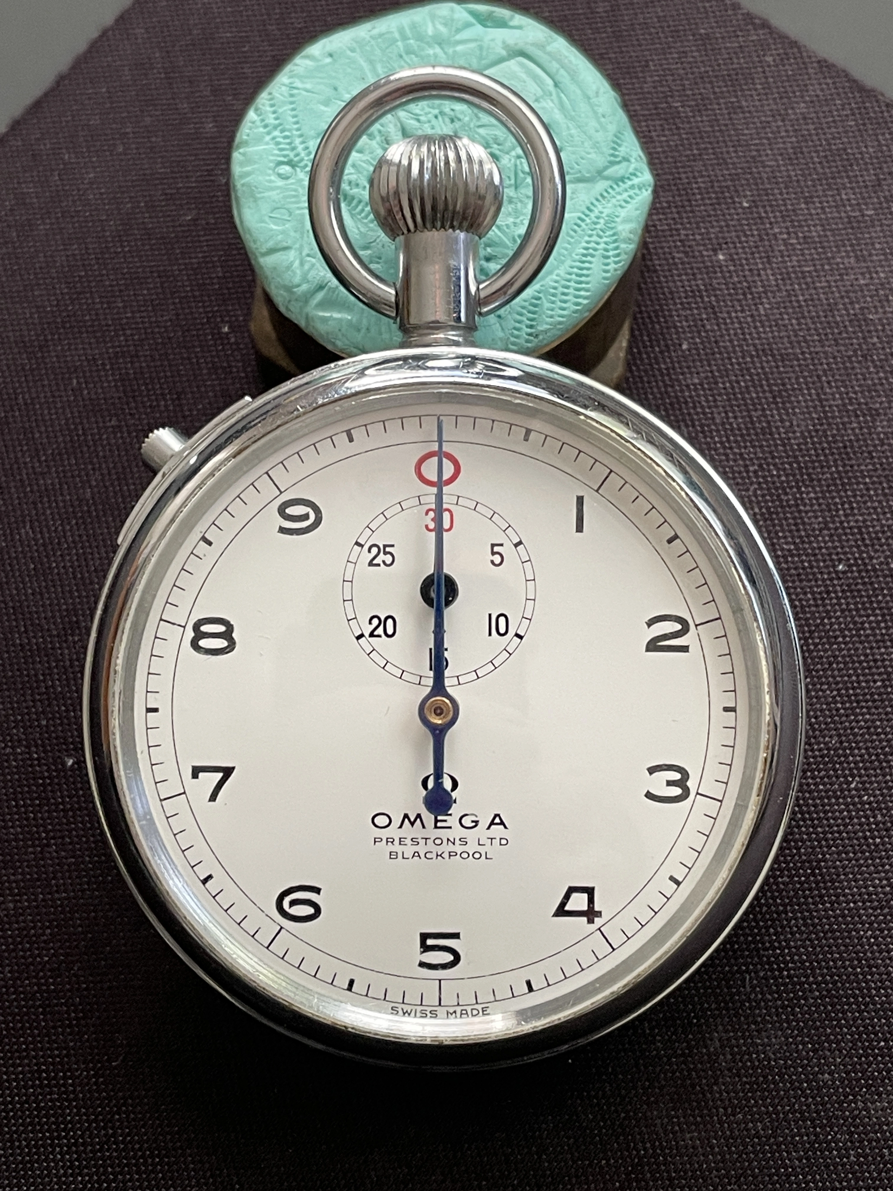

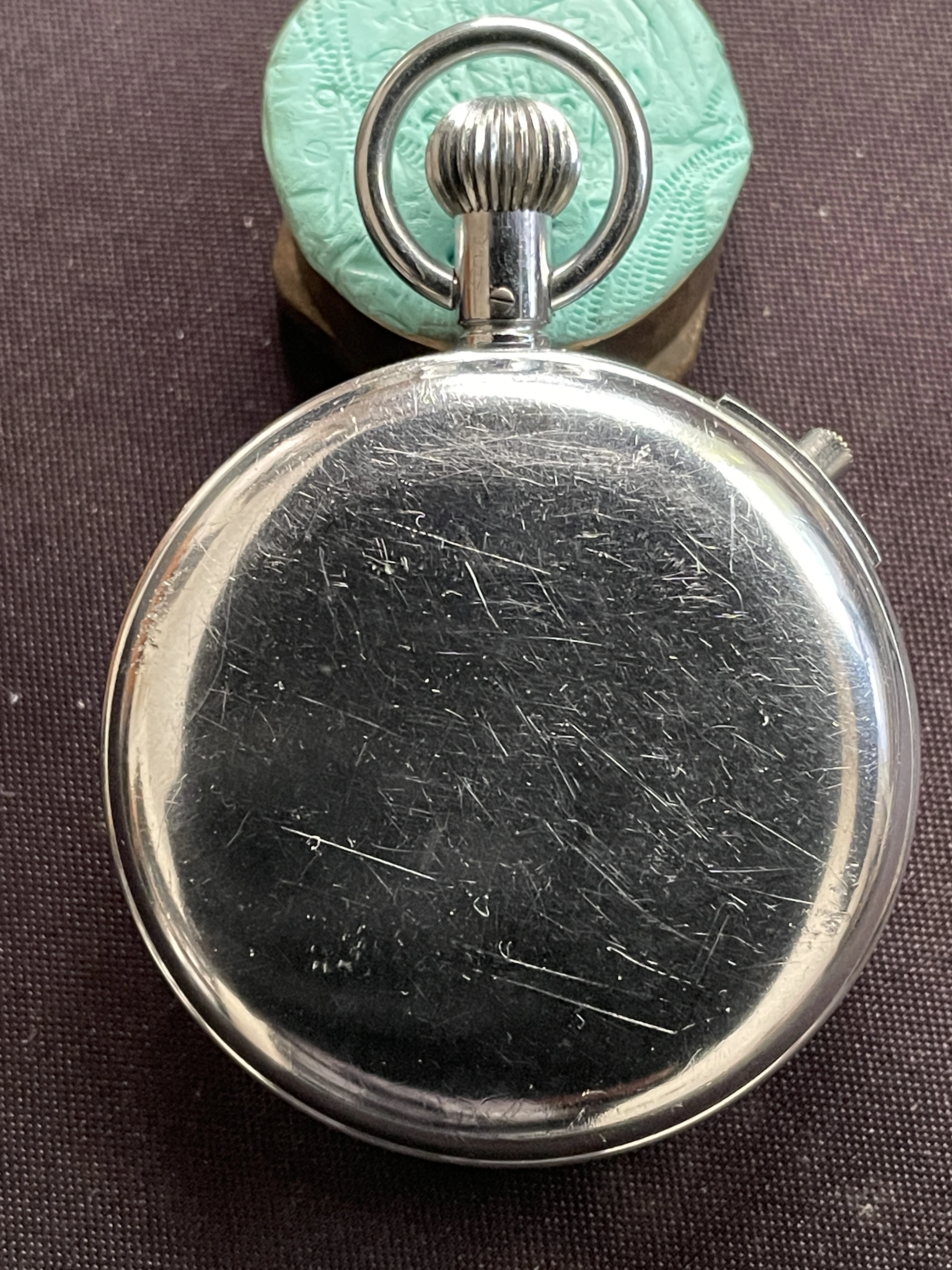

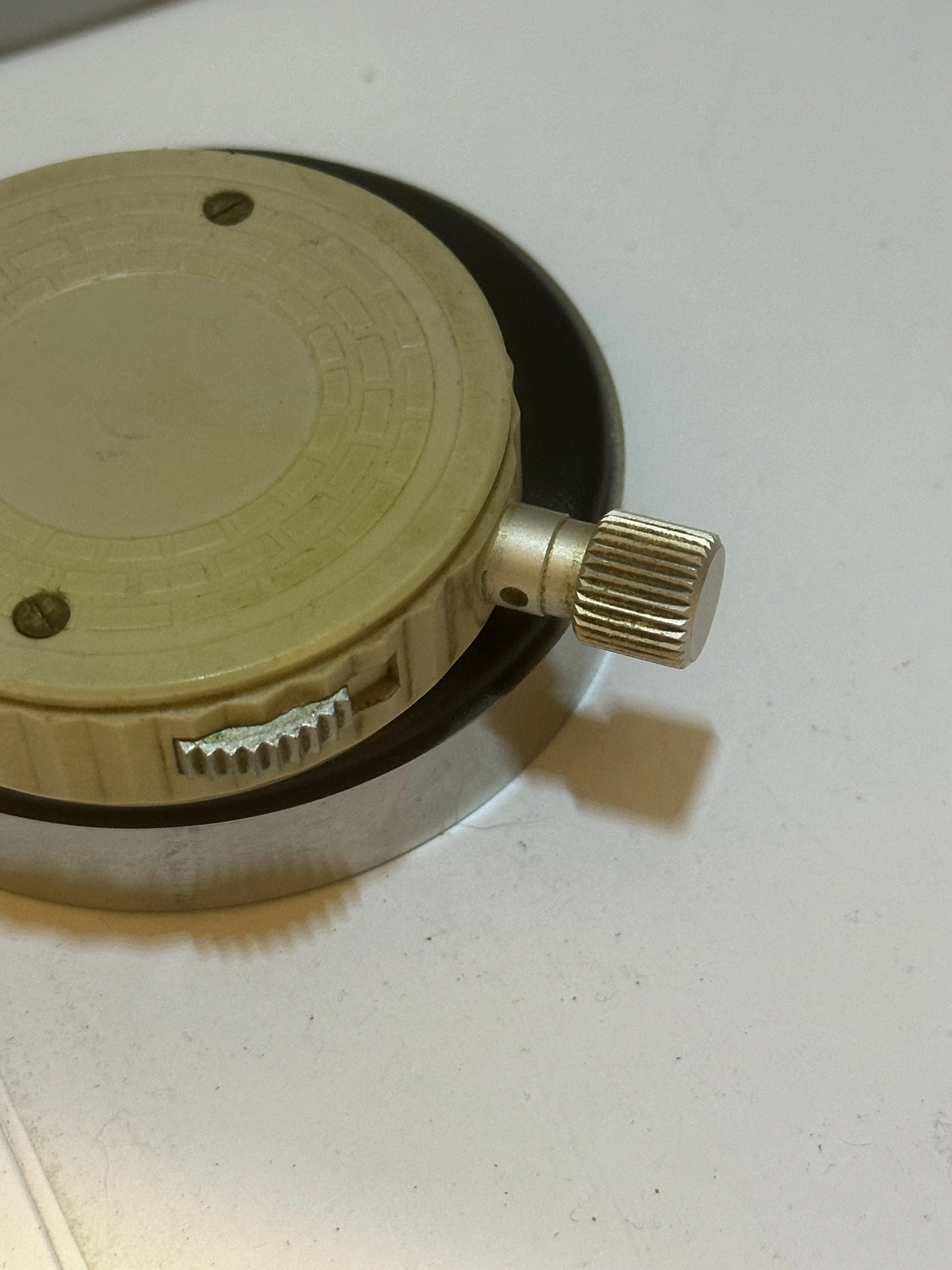

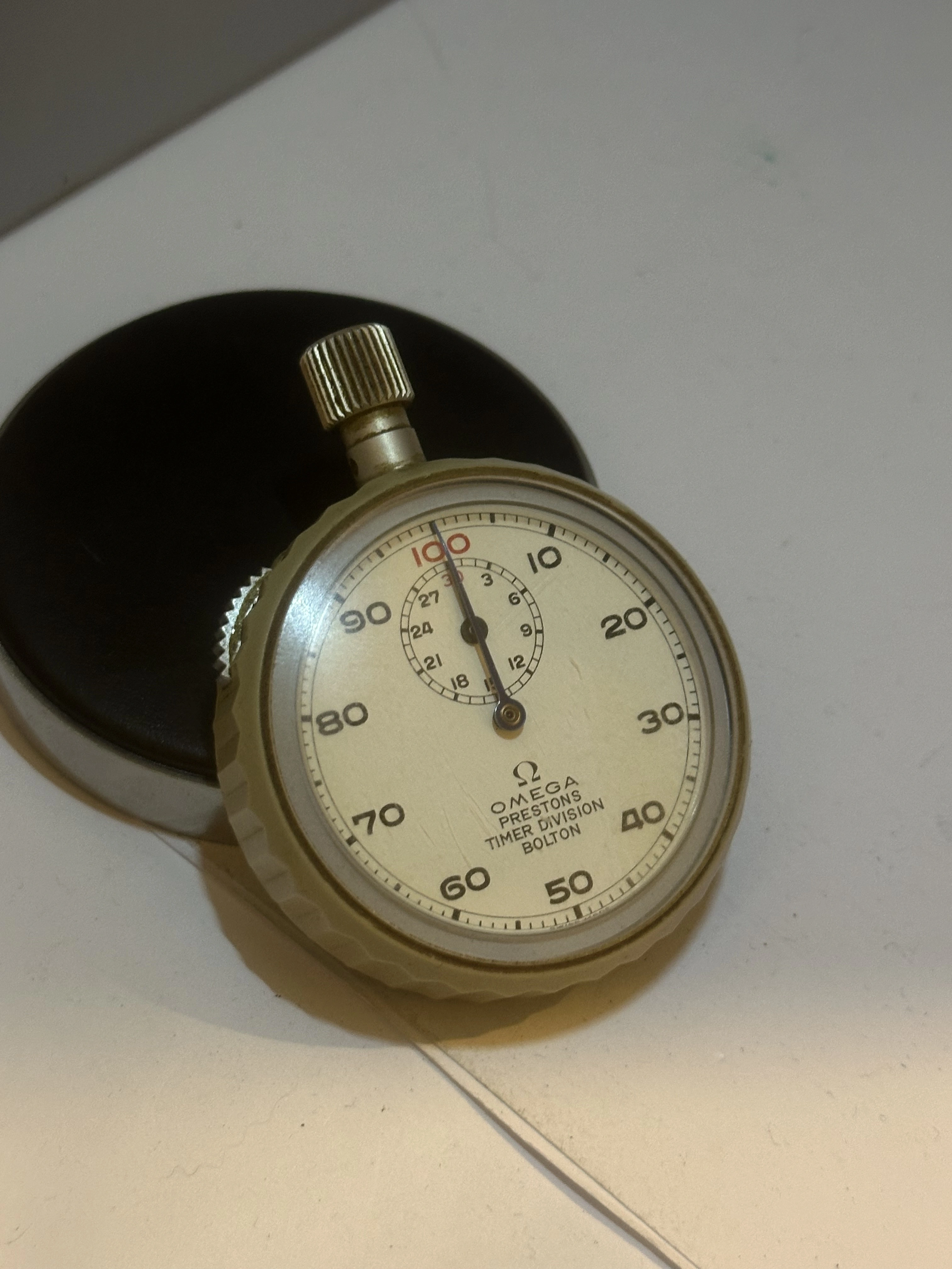

Hi, I’ve bought this older omega stopwatch however I cannot find anything similar through searching which is making me question what model it is and further its legitimacy. On top of this how can I access the moment to get a movement id. Thank you

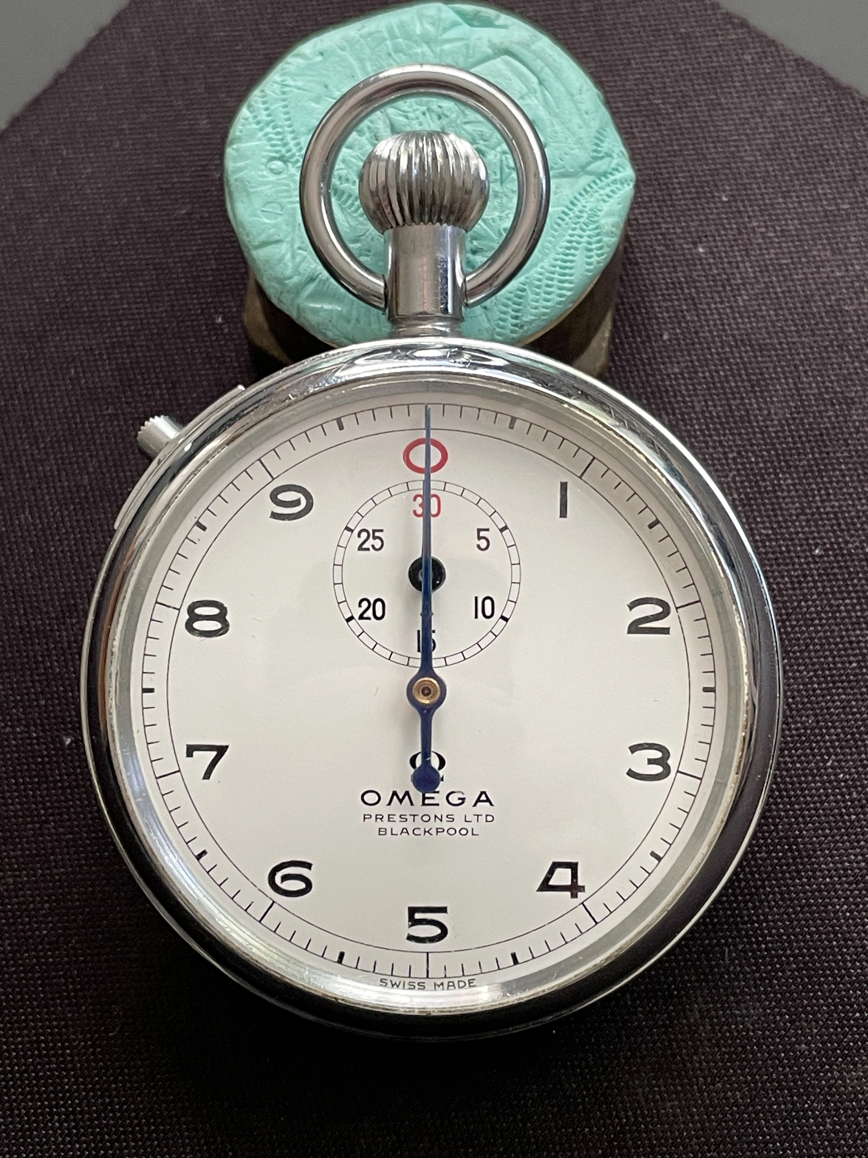

I’ve seen one of these before on eBay and in a collection, they’re not overly valuable a couple hundred bucks or so, but they are a real stop-watch used in the 1970’s for timing of competitive sports. Quite a cool collectible to have for an Omega fan but there are more of them out there than there are interested buyers, hence the relatively low price.

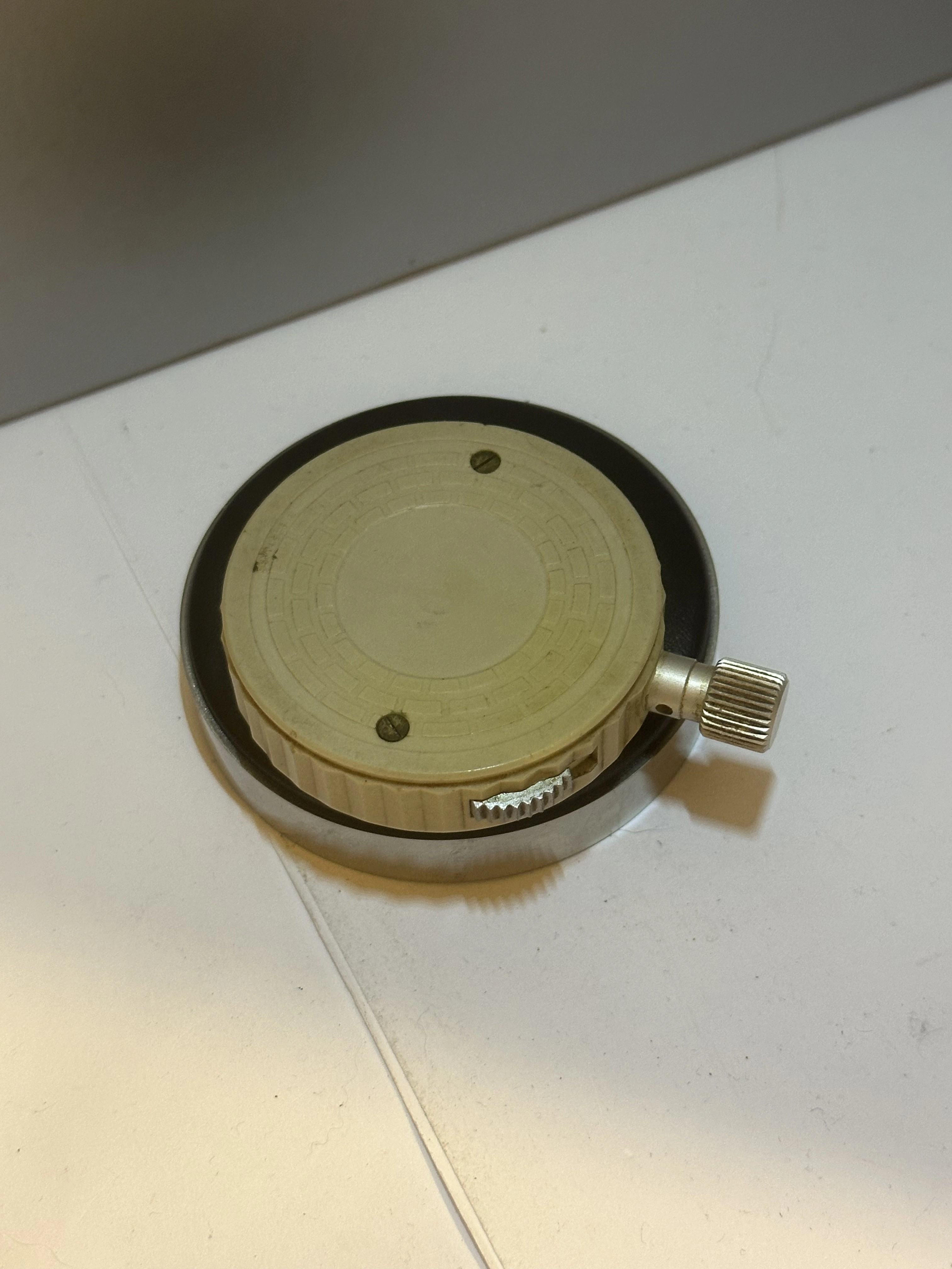

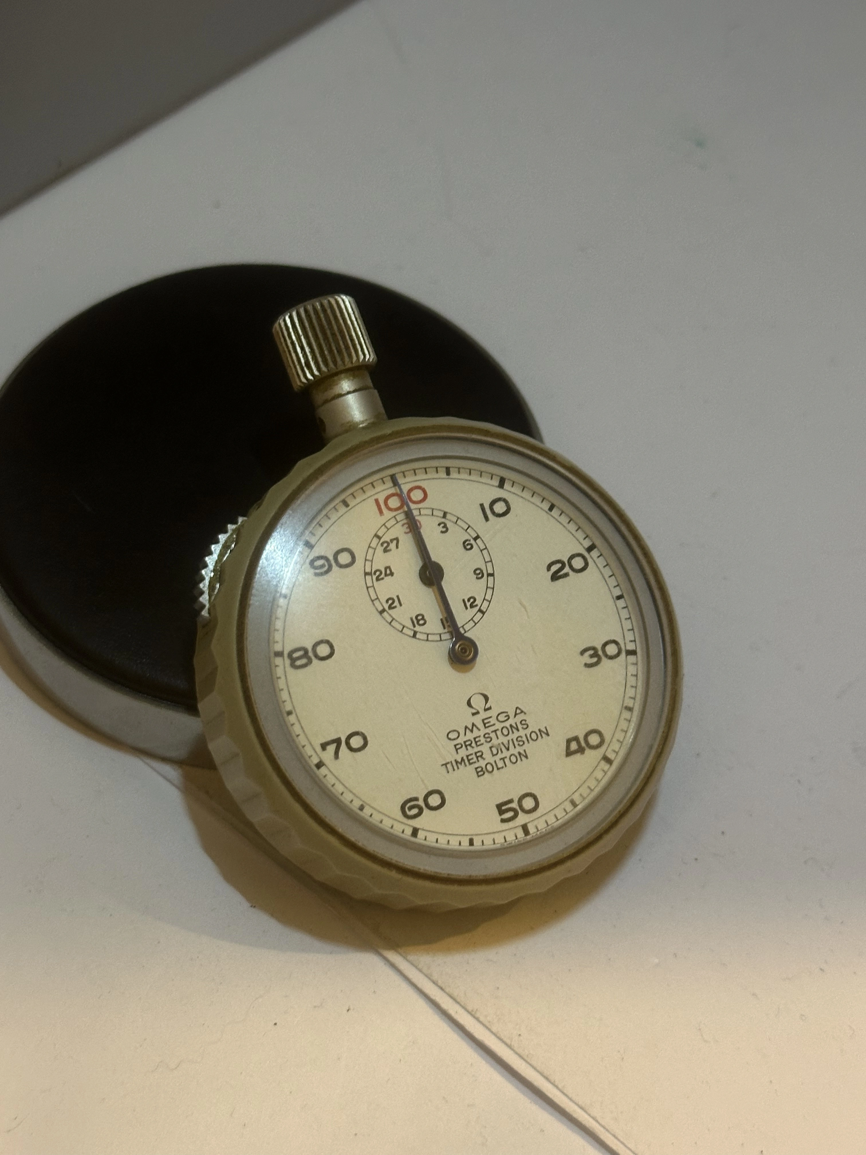

This one is actually a decimal timer.
The dial is divided into 100ths of a minute as opposed to a regular stopwatch which has the minute divided into 60 seconds.
They are used primarily in industry/production/manufacturing environments to determine performance and operational rate as it's much easier to compute and analyse the decimal times.
18,803
39,061

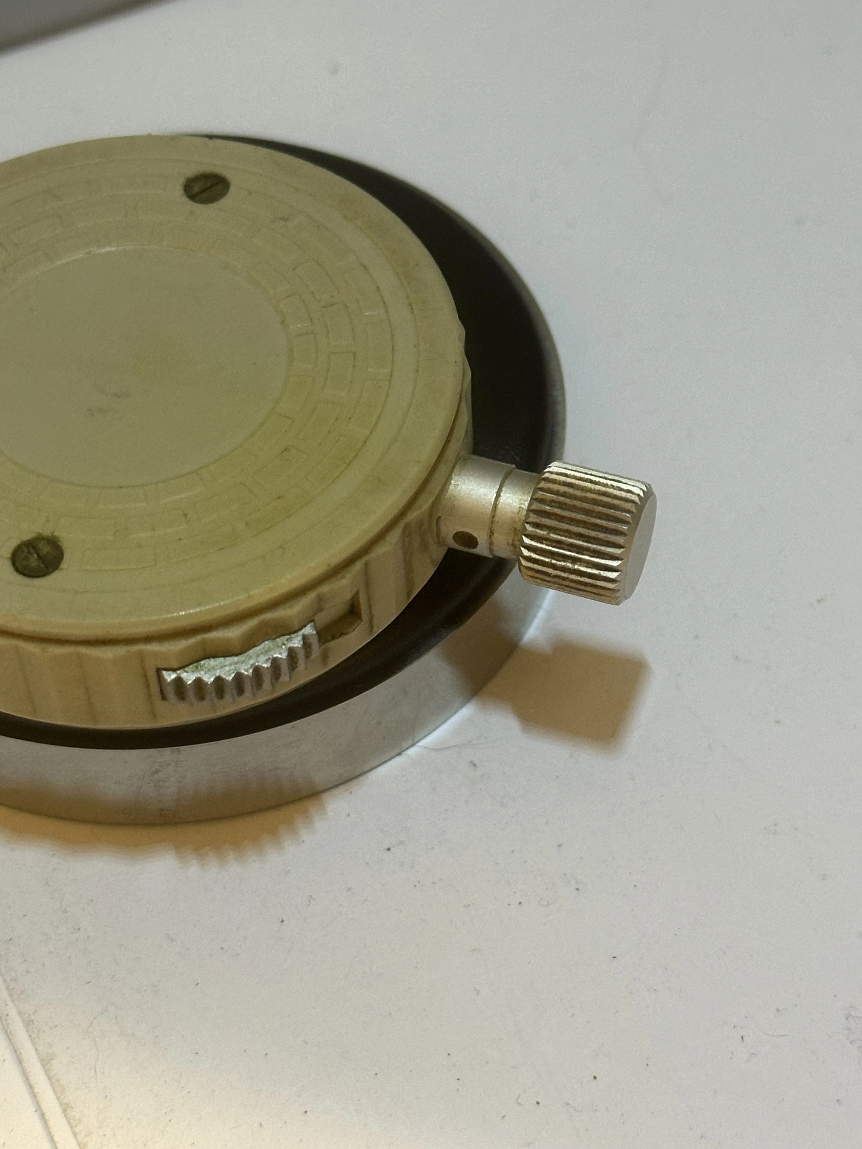

I thought I had one somewhere.
Very similar to yours although mine has slightly different decimal dial.
The "switch" at the side turns the movement on, press the crown and the count starts. When the observer has witnessed 10 or howeber many operations/sequences thet hit the crown again and the count re-starts for the next sequence.
When enough readings have been taken, the switch is set to off and the sweep hand is retuened to zero.
Readings that were noted allow quick calculations to be made based on decimal numbers rather than the complication of calculating X operations in 32.5 seconds to arrive at a rate of effort (for example).
