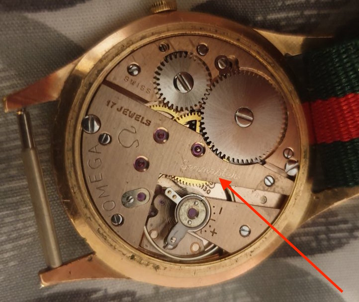

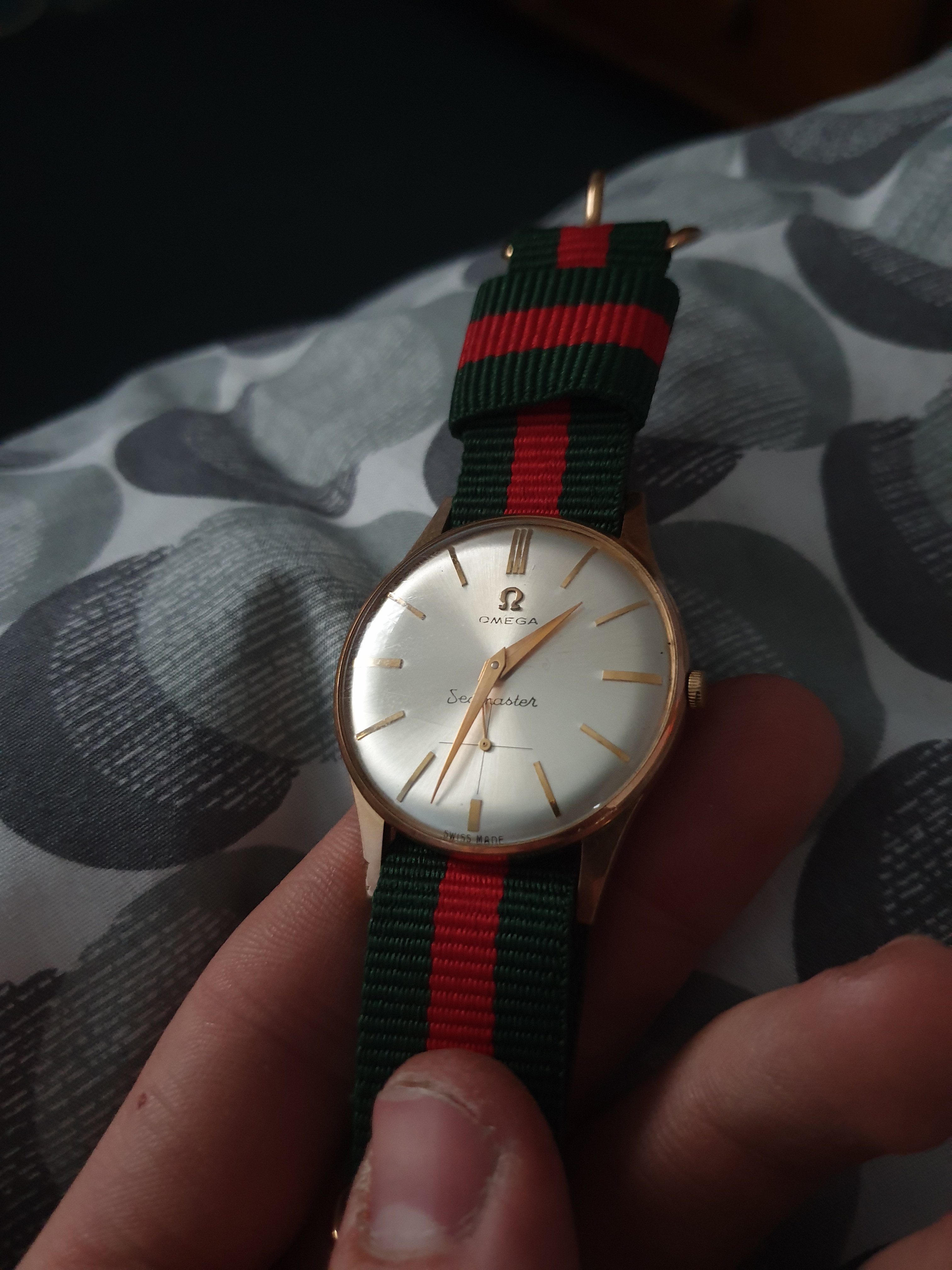

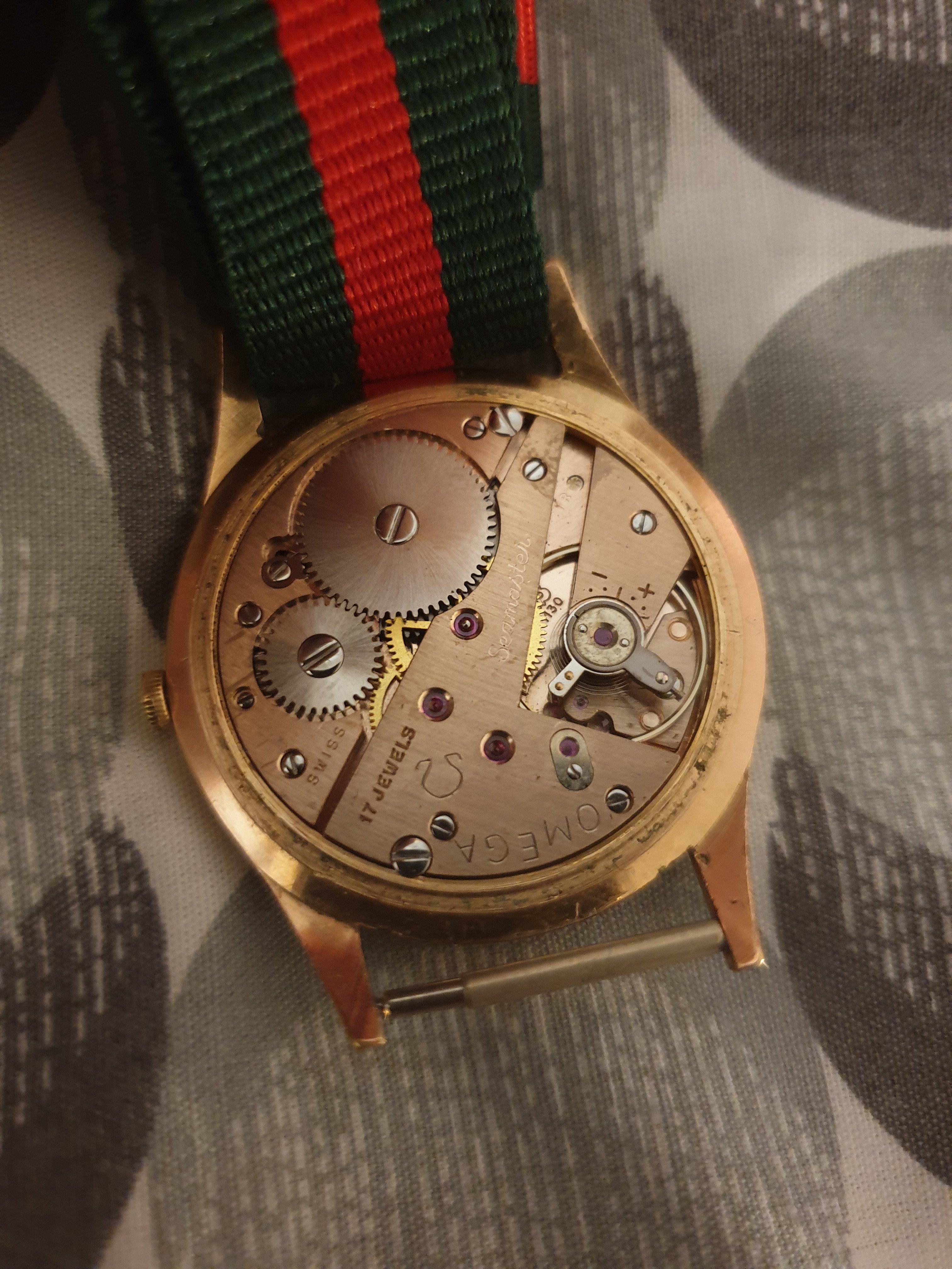

Hi everyone,
I bought this Omega Seamaster at a fair recently, and I'm wondering if it's a fake or not. I know the crown and case back are both not original, but I was hoping the rest was. I'd appreciate if anyone could lend me some knowledge as I haven't got a clue.

It doesn't look like an Omega movement. I think the actual manufacturer's stamp is under the balance wheel

It's a counterfeit watch. Commonly called a fake.
A trashy case and dial with a reasonably good Adolph Schild AS 1130 movement.

First time I've ever seen a movement engraved "Seamaster".
I imagine that text says "AS 1130" as you can just see the 130. Shame! Good to know though.

Yeah, that dial should have screamed "Run Away!!!!" Good learning experience, and hopefully you did not pay more than a few dollars.

Well suspending my suspicions for a moment, if you were sold this as an Omega of any kind, you were the victim of a fraud, though perhaps a minor one, and should feel aggrieved. What is a shame is that if it wasn't covered in fake markings it would make for a nice cheap beater using a robust everyday AS Schild movement. As it is, it is fit for nothing more than the bin sadly. There is a fake thread on here which is worth a look, there are several on there very similar to yours, it was commonly seen back in the 60s.
