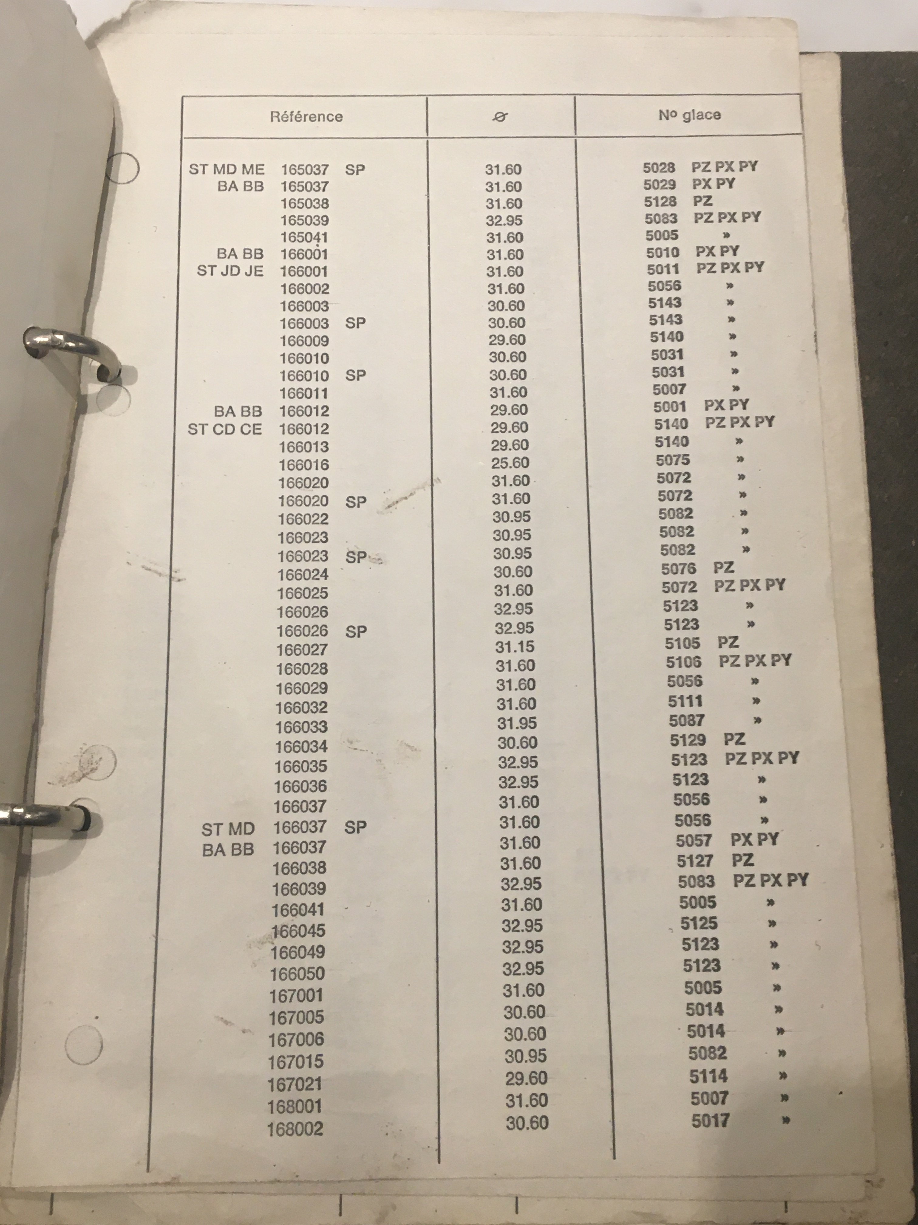

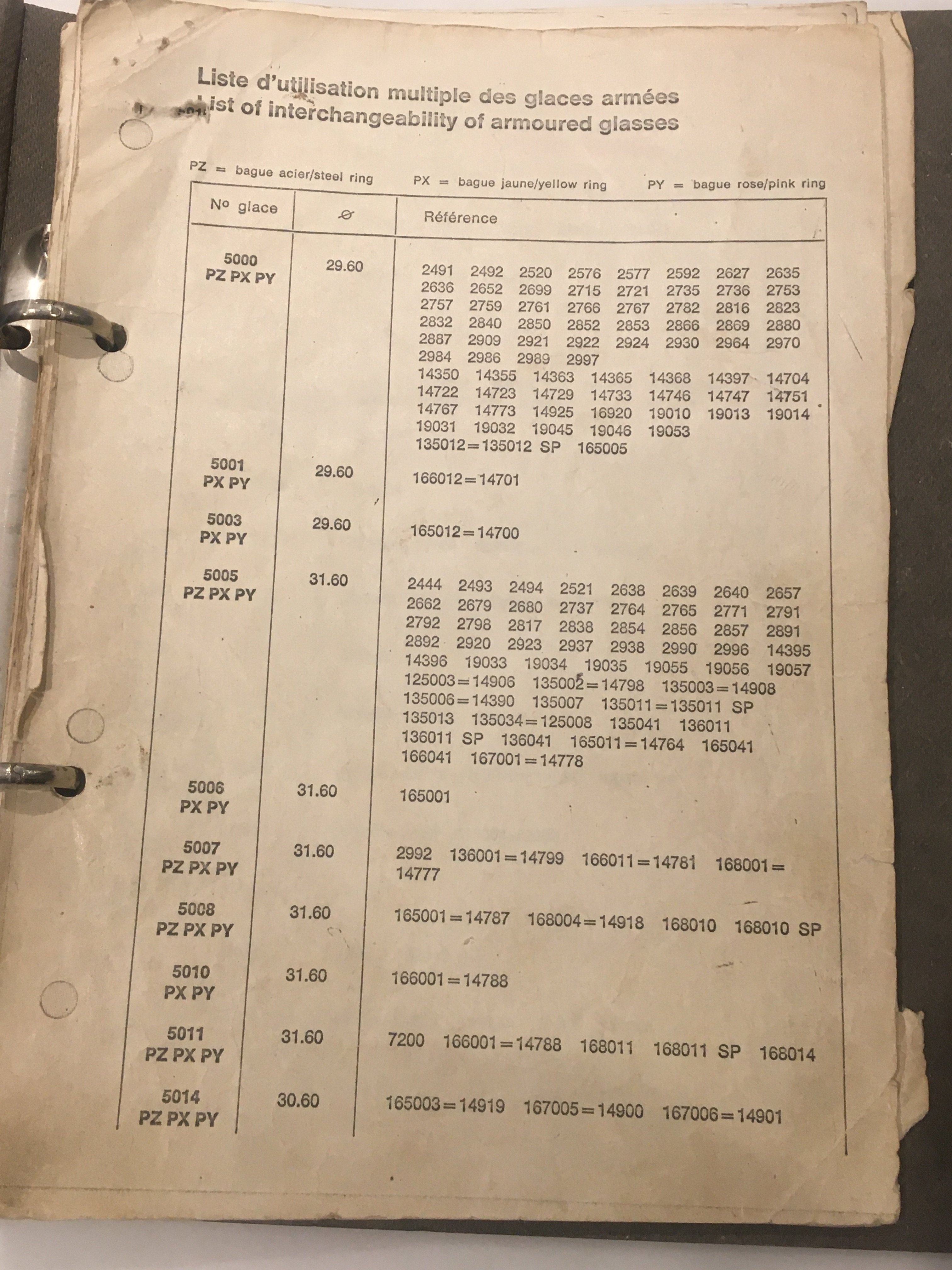

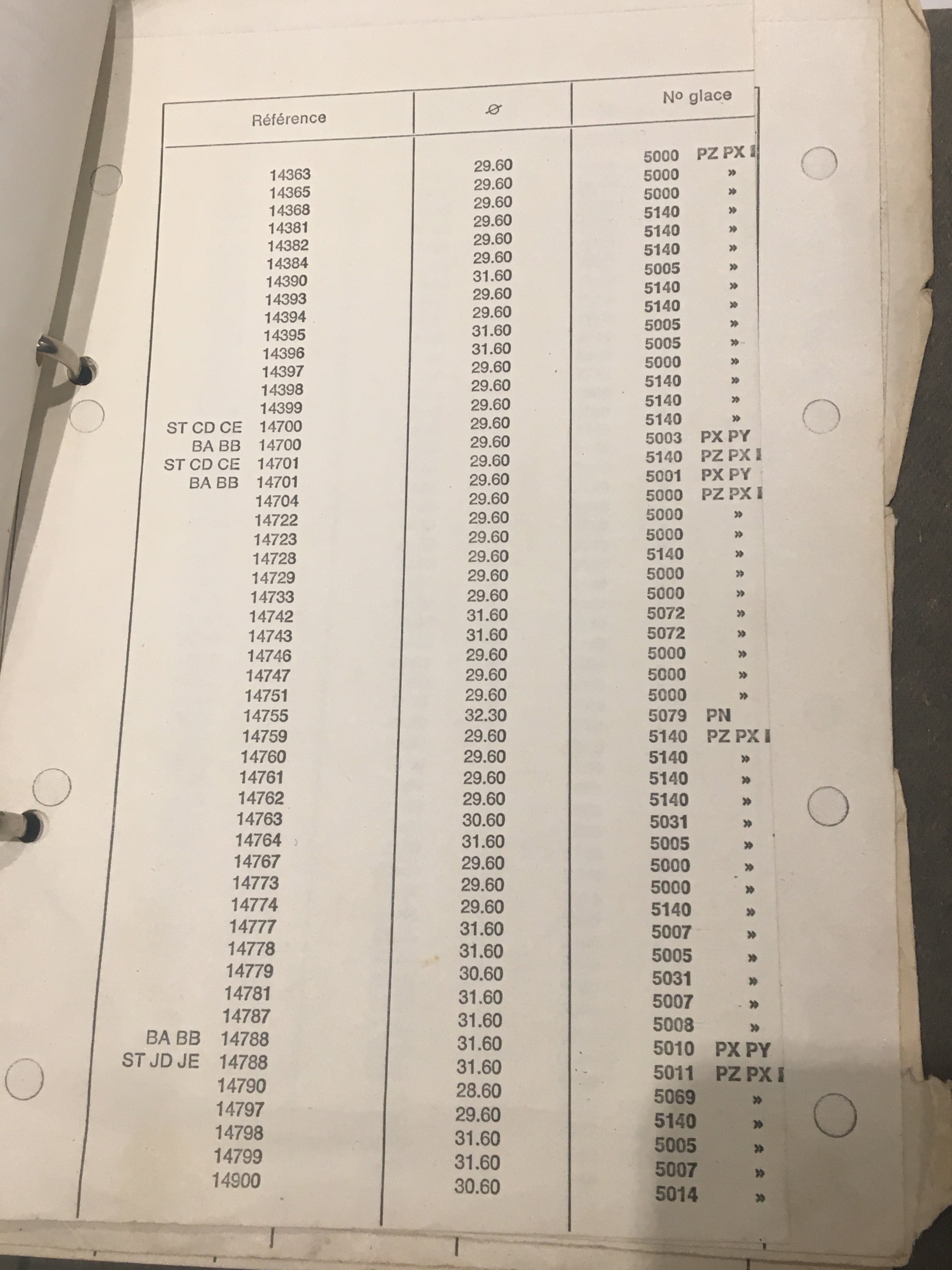

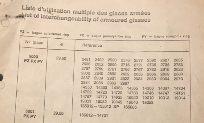

Vintage Omega plexi interchangeability and case reference plexi-case list.

Michael thats great - thanks a lot! This is very useful indeed.
4,453
11,355

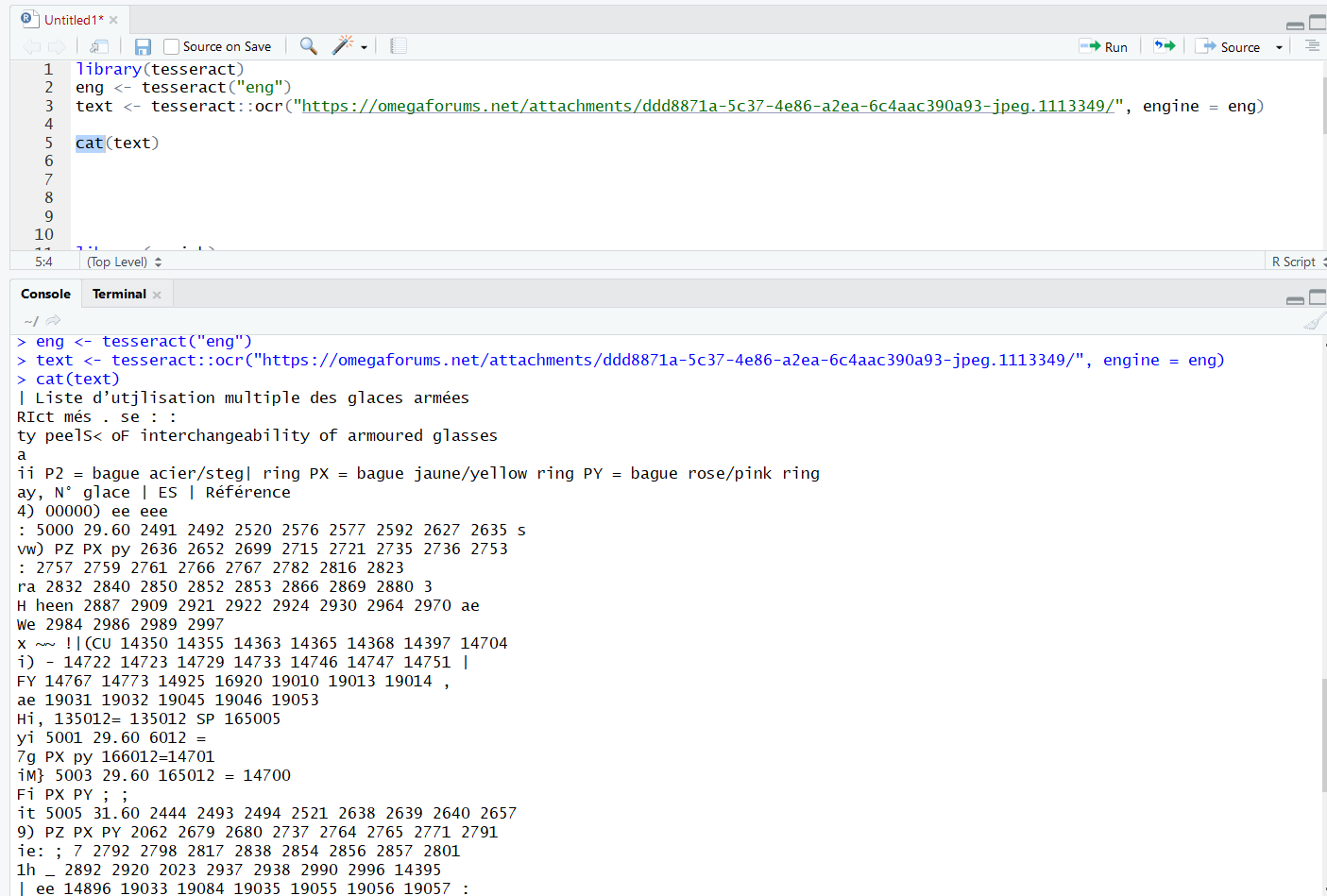

Great document! Maybe there is a way to convert an image to text accurately ...
1,678
5,309

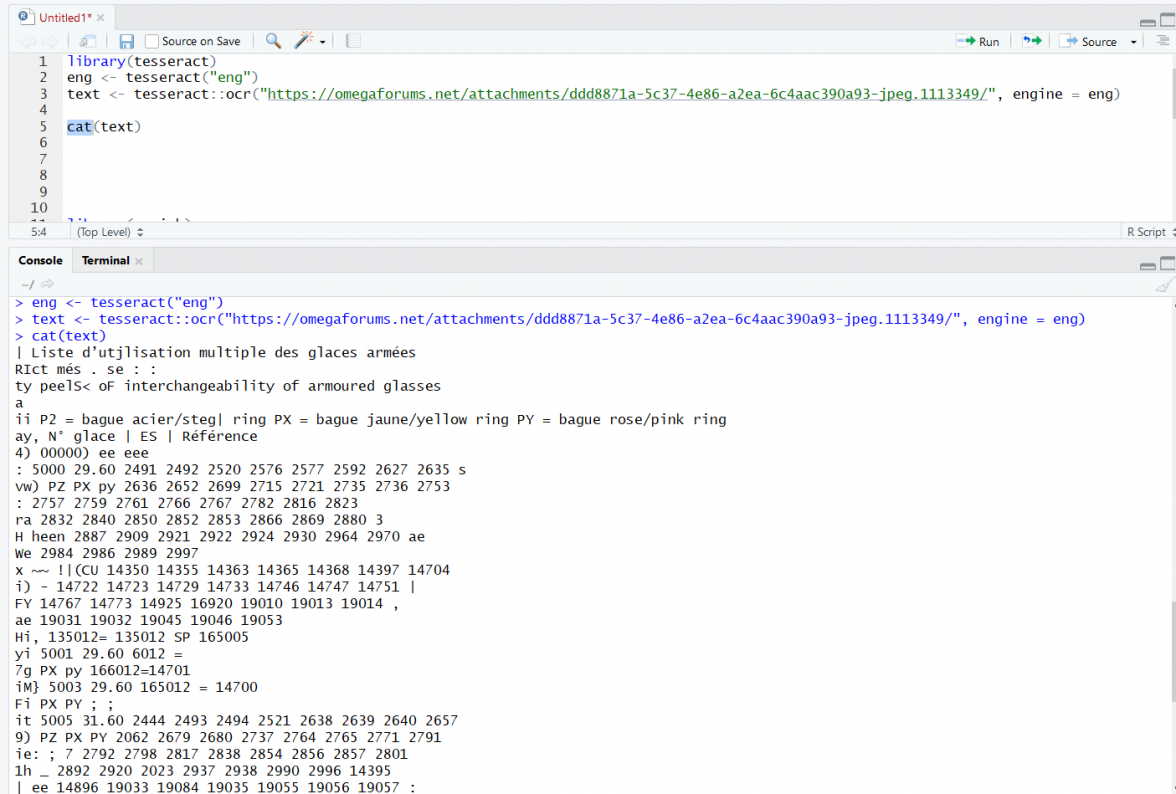

i just had a quick try with the first image using an R Package "tesseract".
One has to do some formating, which is probably a bit more time consuming, but it should be possible.
If you are fine with unformated Data, that should be fairly quick and easy. if you want i can provide it, but not today.
cheers

who did a great job here
Great reference, thanks for posting!
Unfortunately, I can't help right now because these tables are more extensive than the 'Case_Bracelet_End_Link_List', which already was quite a task.
It's good that the tables are arranged in both directions and so you can find the right crystal based on the watch reference as well as the right watch reference based on the crystal. Not too much searching 😉.

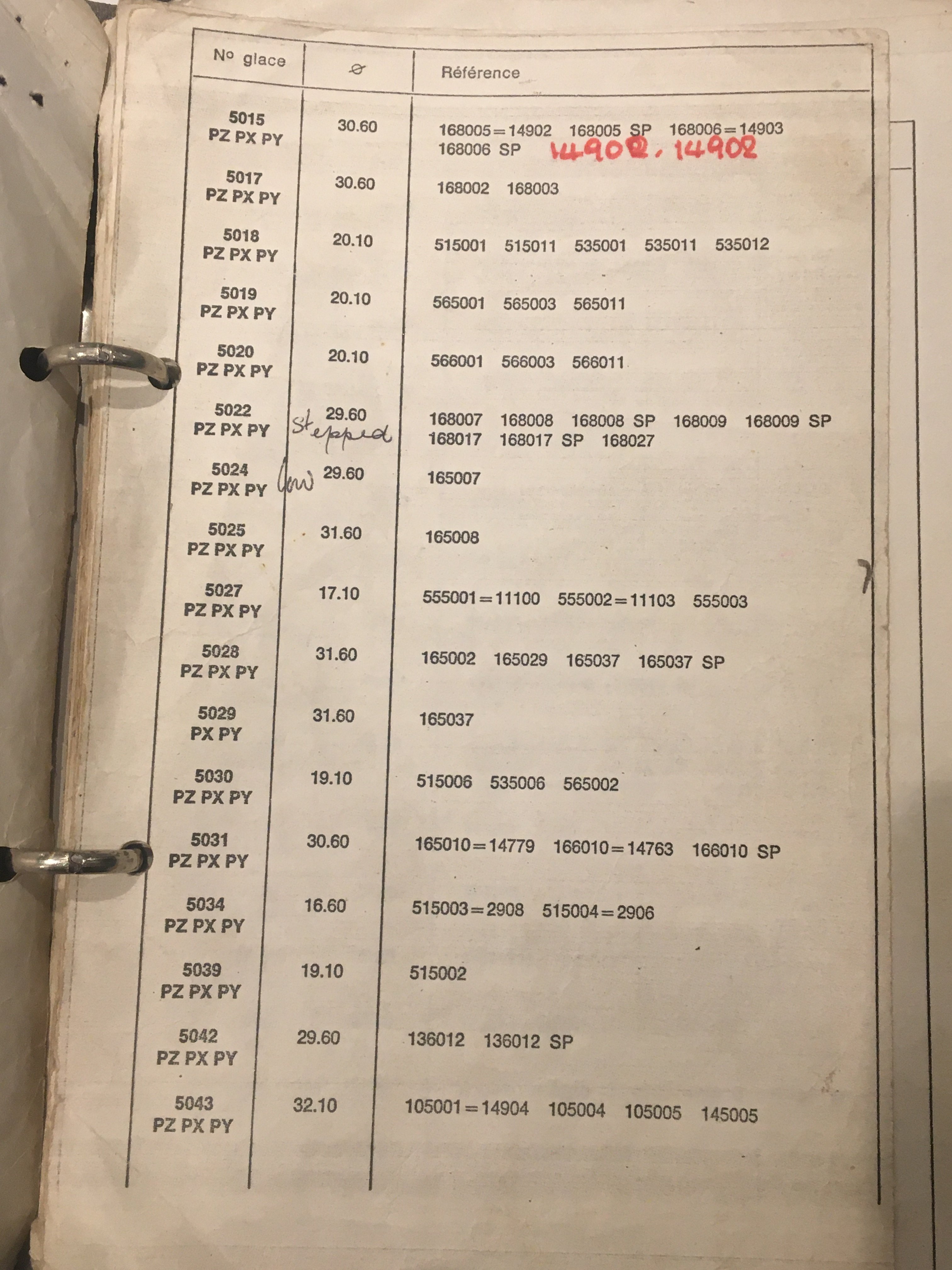

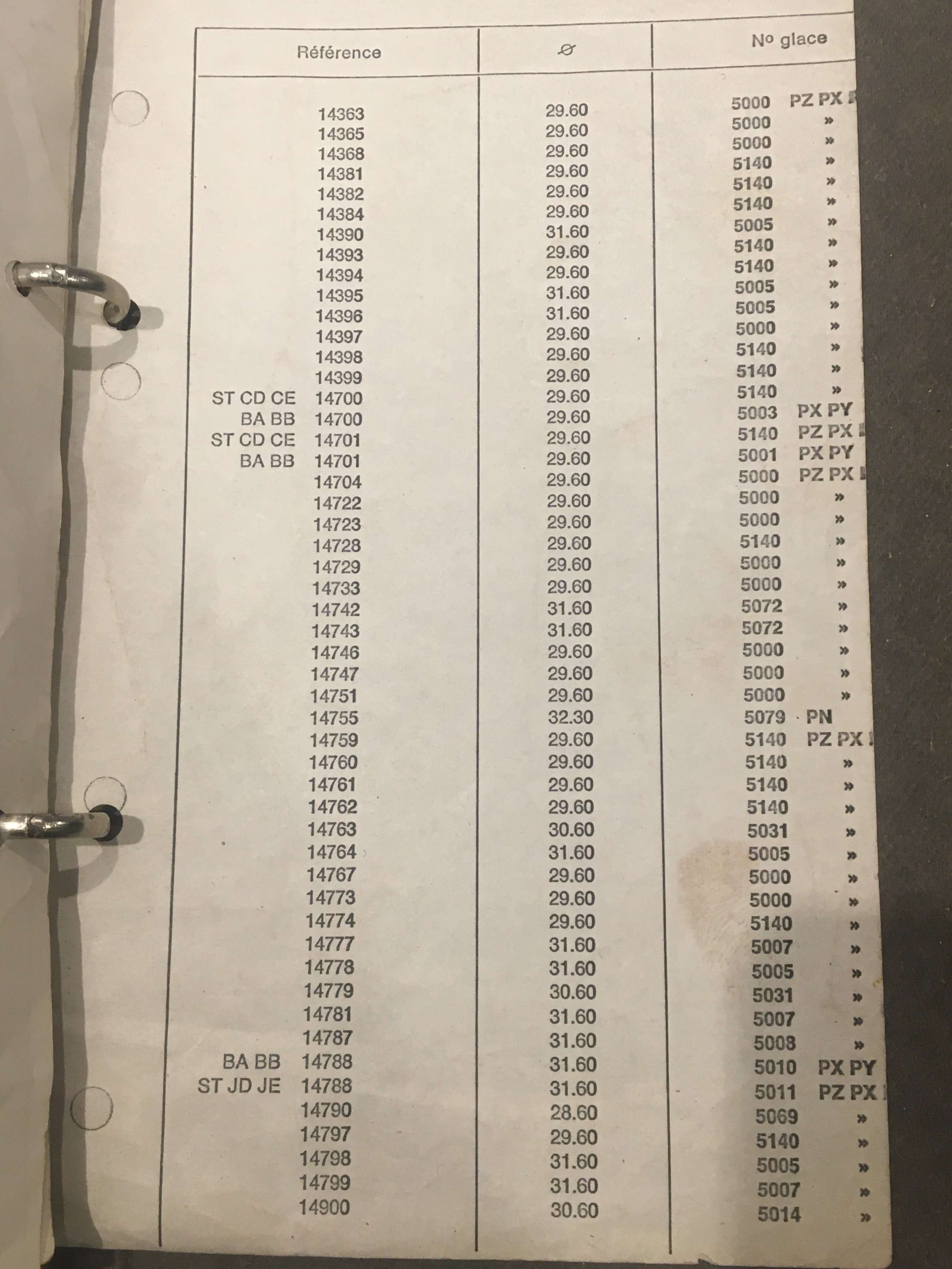

These threads seem to get buried and I never know how to find them-don’t we have a reference library and if not- can we sticky the endlink and this thread to make them easily searchable? Or has there been discussion of a tab or sub-thread for just reference info and not discussion?
I had the endlink pics saved on my phone but lost it in the last migration.
oh- and @michael e - if you still have access to this binder, would it be possible to do document scans to pdf? I think that would make it much more usable for most to save and print.
1,522
4,786
To be honest I do not have the time to scan everything but maybe I can start a thread with all of the useful threads linked within, so one thread with everything inside?
But what could I call it so it would come up easily on search?
Cheers, Michael
