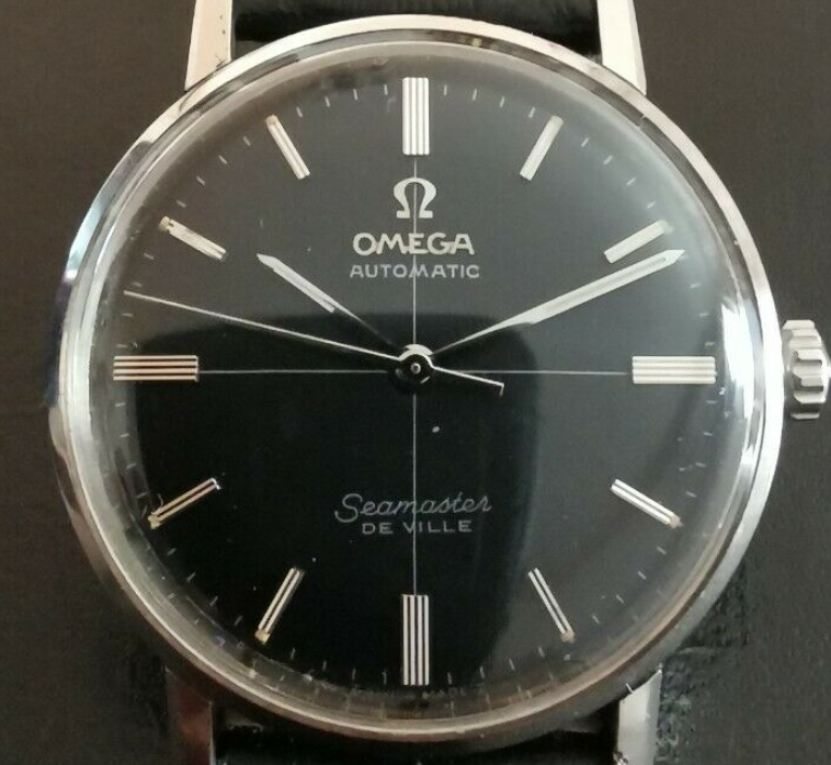

Its just a terrible, poor quality, miss-matched, fantasy mess.
No SM600 dial belongs in this case.
This style of dial is a commonly used template for redials.
The quality of the print is poor.
I saw that kind of dial in another case, I assume it's possible, just not in the case in the pic?
45
13
It’s more the reference/dial style. Ie yours looks like a 136.011? The ‘Technic’ version of this dial only appeared on the watch mid/late 60’s and the broken crosshair is correct.
An earlier Constellation on the other hand should have an unbroken crosshair.
Yes, mine is 136.011
So any Constellation with crosshair will be unbroken crosshair, but mid/late 60s SM600 will be broken?
It's so confusing... I looked at the database in OMEGA web, but it's not nearly complete
That’s a reasonable rule of thumb but there are lot is nuances and exceptions to most rules with Omega.
The SM600 never had this dial. It’s a fantasy redial based on a Ranchero that is frequently seen in various cases on eBay.

3,4, and 7 are the only ones I'd posit are legit dials.
No 3’s hard based on one photo but as:
- The black dial Deville with crosshair is commonly seen as a redial
- Some of the hour markers don’t appear to be well centred with the minute marks
- There doesn’t appear to be any lume in the recessed.
I’d sway towards redial. However, I agree, better pictures could show otherwise.
Wow... you have lots of knowledge thats for sure
amazing
If you saw Ranchero with those orange on the hours marking, will you consider it re dial?

I did 1, 2 and 3 when I bought mine but weirdly I only saw one variation of the one I got
Thank you for the warnings!
45
13
It says in the description, “dial is professionally redone”
Whew, I didn't even check the description haha

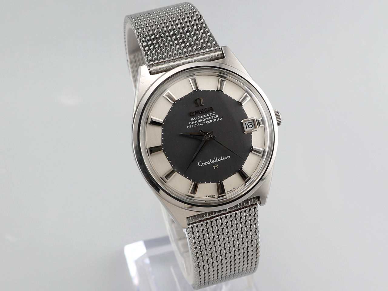

whats your opinions on this watch? will you consider a re dail like that?

What an unfortunate situation
I fell in love with a pie pan tuxedo

Not at the price he wants for it. Maybe $400 if I was *really* in love with that particular dial and saw no other way to get my hands on it.
I thought so, it looks pretty common within SM600 line, I saw couple of black dials with crosshair priced lower than this one

Absolutely not. The hunt is part of the fun and I know if I bought a redial like that it would niggle me, I’d never wear it and just end up selling it at a loss

If you saw Ranchero with those orange on the hours marking, will you consider it re dail?
No that dial looks original to me (although I’m no Ranchero expert).
Whether the lume has been redone is a different and sometimes much harder question to answer.

wow this thread is a mess and that tuxedo pan is a bombshell
I also want a tuxedo but a very impractical watch since the crystal seals it and there's no caseback
