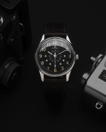

Hi Guys,
just wondering if someone could shed some light on this watch, believed to have redial and possibly not correct markings but I've had it for years as a non-runner and only recently decied to get it fixed up just becuase of the growing popularity of the watch
I have attached a photograph of said watch, with Six Stars around the face and a crows foot about the 6 o'clock marker, it has either an omega 601 or 600 movment cant remember off the top of my head
Any info much appreciated

Never seen that one.
If you could provide pics of the movement and inside the case back, it would help.

It's what is known in the game as a "fantasy" dial, i.e. no connection to a genuine vintage Omega dial.
2,346
1,475
On the inside of the back is the case reference number. Get that and do a Google search Omega ### etc.
That will bring up models of what your dial should look like
