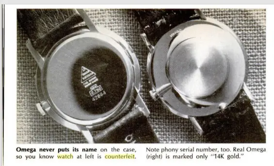

Just point him to the 1971 article on Counterfeit Watches:
https://books.google.com/books?id=fQEAAAAAMBAJ&pg=PA54&lpg=PA54&dq=popular+science+counterfeit+watch&source=bl&ots=JTPLWoAFSg&sig=cVul1eDwCSYxCgbohU4cBYKrd7U&hl=en#v=onepage&q=popular science counterfeit watch&f=false
There is a sidebar that discusses fake Omegas.

Omega did not stamp their external case backs with these markings, which are deliberately placed there to fool the unwitting. Fineness was not displayed externally at all on solid gold Omega watches.
Need to stay away from absolutes with Vintage Omega.
Many US National production cases have fineness hallmarks on the case back. Just not imitation Swiss hallmarks like OP’s
US hallmarks are simple “14K Gold” is typical.

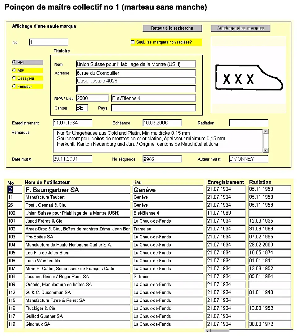

I am particularly interested in identifying the case maker (Poinçon de Maître hammer-head No. 12)
There is no registered maker with a No 12 mark.

As far as I know, this genuine 18k white-gold watch with diamond bezel is the first example I have seen with a 16203 mark (a red flag), while also carrying the correct Swiss Helvetia hallmark for 18k gold produced outside Geneva (right) and Poinçon de Maître collectif No. 1, hammerhead without handle No. 12 (left). This mark was registered in 1926 but does not appear in the centralized 1934 records.
