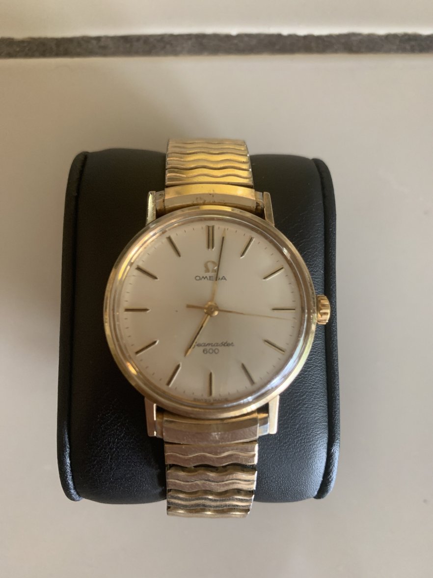

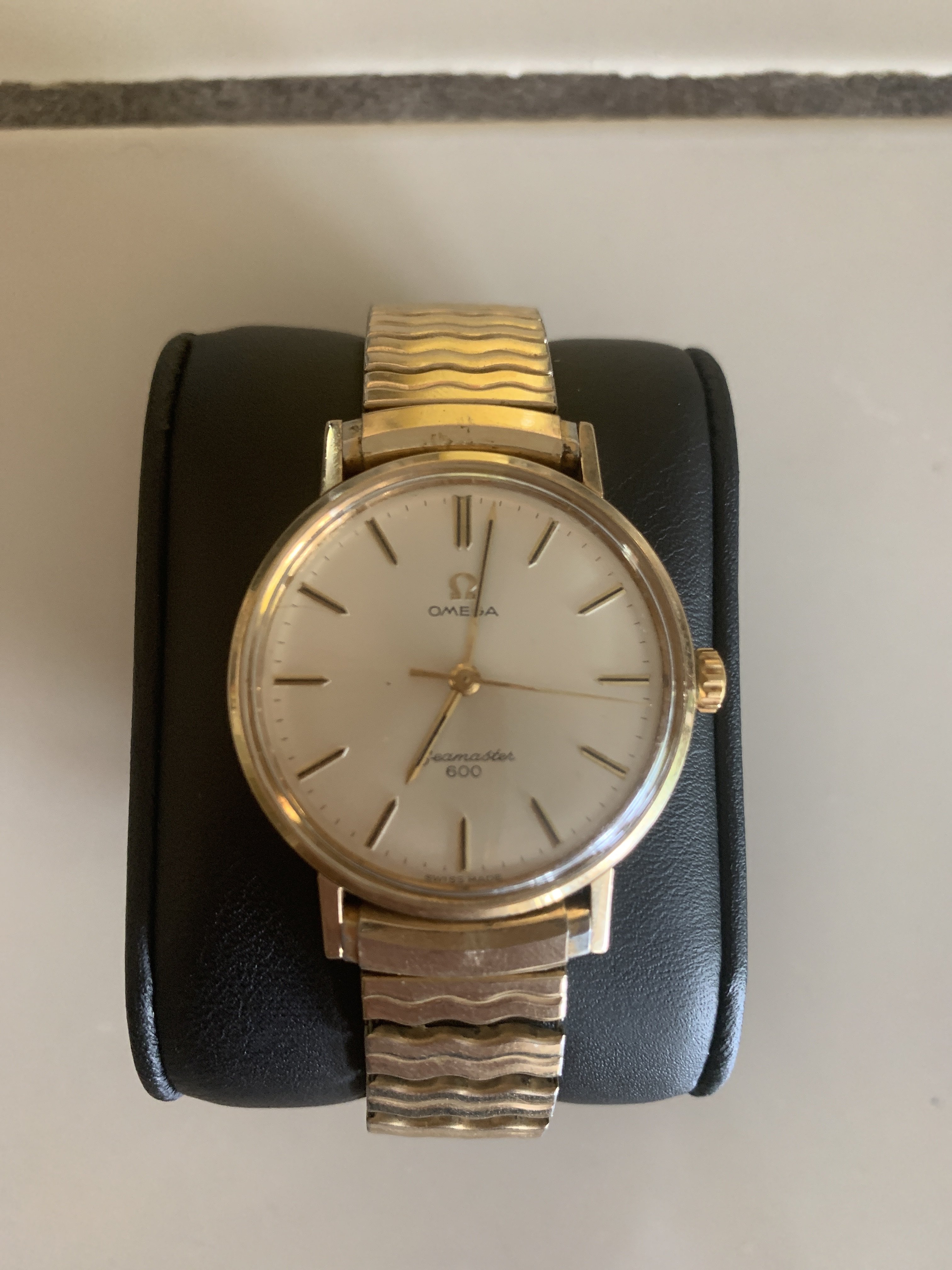

I recently acquired this Omega from my father, and this was his fathers watch so my grandfathers. I believe its from early to mid 1960’s but thats about the best guess i have on it. Other than that i’d love some help identifying the time period, current value, and such. I’m currently looking into getting it repaired and in working order but just need to know a little more about it! Thank you!

Could be a ref 135.011, fitted with a cal 601 movement. Have the movement serviced, but unless there are technical issues that only a watchmaker can assess, leave the dial, crystal, and crown alone as they're likely original. Also best not to have the case polished.
Update: it's not a ref 135.011. I've seen a 135.011 with a similar dial, but your case is different. Could be a 135.010.

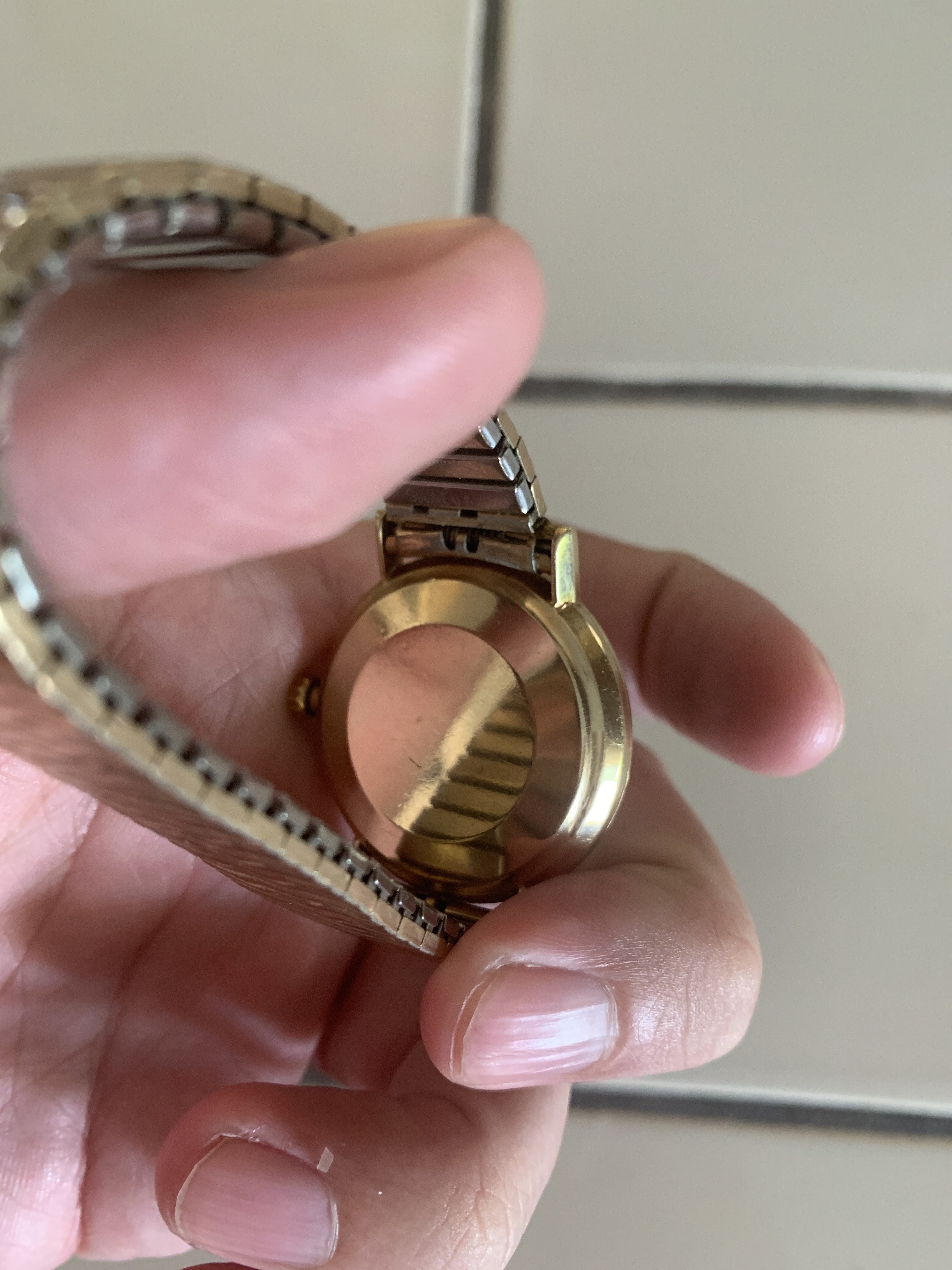

I see your update, and this is what I thought originally too that it was a 135.011 but they seem to all have screw down backs. This seems like a front loader. It also has the appearance of possibly being a solid gold case. Maybe recased?
@Adumb Does it have any gold purity marks visible?

I am unable to see any purity marks on the watch casing, there are no markings whatsoever on the back of the case

I believe all i need is the movement serviced, it still begins ticking when i shake it but stops after maybe 10 seconds
also, the crown does not function whatsoever. It is stuck in place and can not be pulled out or twisted

In that case I would not advice doing anything until it is serviced. Once it's in a watchmaker's hands he can get pics of the movement and inside caseback which will reveal much more information such as who made the case and the year the movement was produced.

Could this be a 135.010 with a 135.011 dial?

We certainly seem to be getting closer.

Looks like a reference LL6287 with an incorrect dial and possibly movement. This is absolutely not a Seamaster 600.
Gold content will be marked between the lower lugs.

Meaning its possibly fake? Or just that incorrect parts were put together?

Possibly just fitted with a replacement dial at some stage in its life
The original could have been damaged by water intrusion, or damaged by a watchmaker who didn't know how to extract the movement from this style of case in the correct manner.
Back in the day, watch owners weren't as pedantic about dials, fonts, the height of the "M" in Omega, the number of teeth on the crown etc.
They just wanted their watch to look nice.

Just mismatched parts.

OK, just to say it again your watch is NOT a Seamaster 600. The Seamaster 600 always has a screw back.

The reference number is on the inside back. Once you get it serviced. You can ask the watchmaker to write it down and then you can search Google or whichever browser you use to see what type of dial it should have.
I would just leave it as is. Dial looks fine and hands are a match
