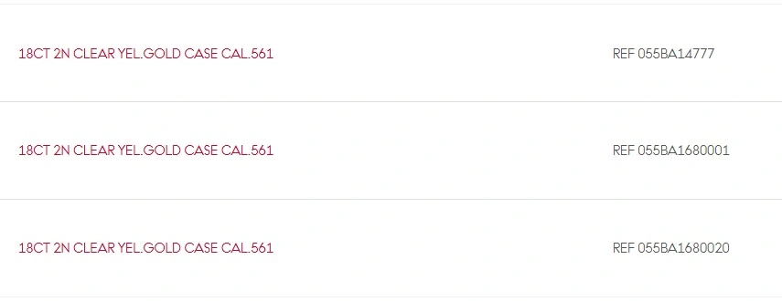

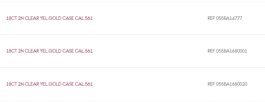

The dial indicated is "correct" for the following 3 case references per the Omega Extranet:
14777
1680001
1680020
If the 34-35mm is correct then the watch is almost certainly a 14393.

Not Archer, but I can tell you that the dials of jumbo Connies 168.001 and 14777 absolutely do not fit 14393s, 14381s etc. It’s not even close.
Which makes me wonder what’s going on there. I had no idea jumbo service dials are readily available from Omega ( @Archer would it be possible for you to share pics from the database?) and I do not understand what the shop is doing there, potentially ordering a dial for an incorrect reference. The case backs also aren’t interchangeable between the refs, so how they get the idea this might be a good fit is above me.

I think the 168.0020 on the Omega extranet must be a typo (or aberration ) as I can only see this reference matching a Deville.
And if they meant 168.0002, that would be a gold, standard sized dial in a grand luxe horned-lugged case.

I suspect what the watchmaker is doing, is actually looking at the case number inside the case back, and ordering according to that. That is after all, how you do it. Unless this watchmaker is completely out to lunch, he's not going to order a dial for that kind of money, have it be wrong, and then not be able to return it (you cannot return parts because you ordered the wrong thing, so he would have to eat the cost of that dial). I trust what this watchmaker is doing more then the measurement that's been given, but that's just me as I do this for a living and know the consequences of screwing up.
I'm baffled why the watch owner decided not to take a photo inside the case back, or even write that number down, because it would end all speculation.
