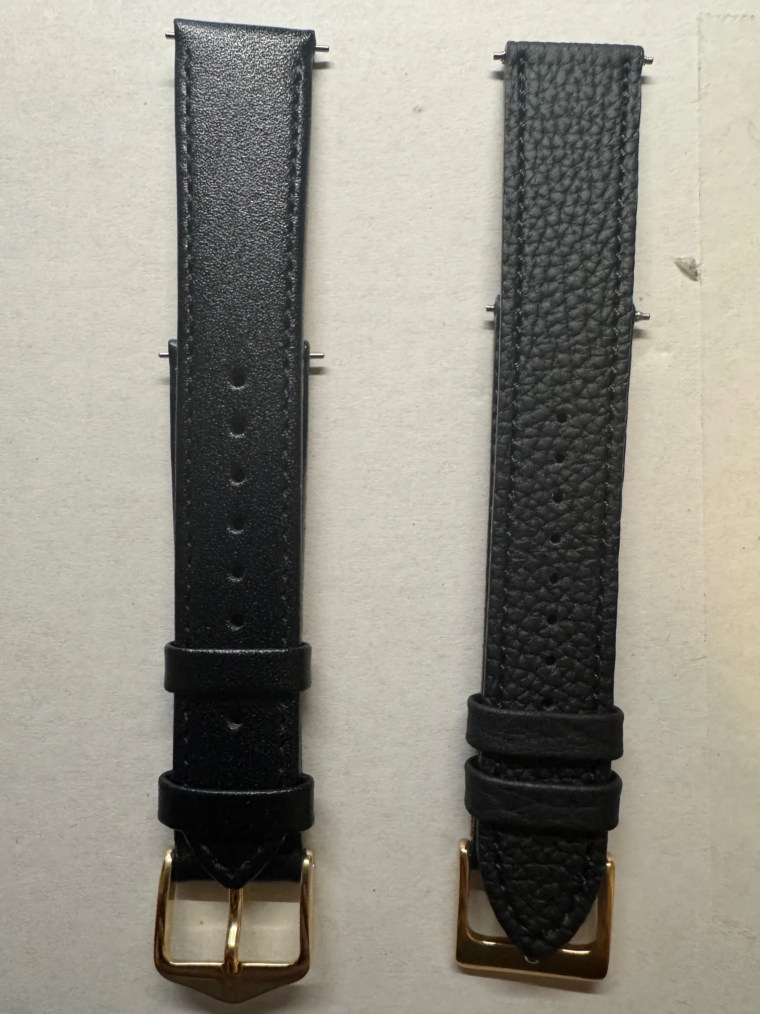

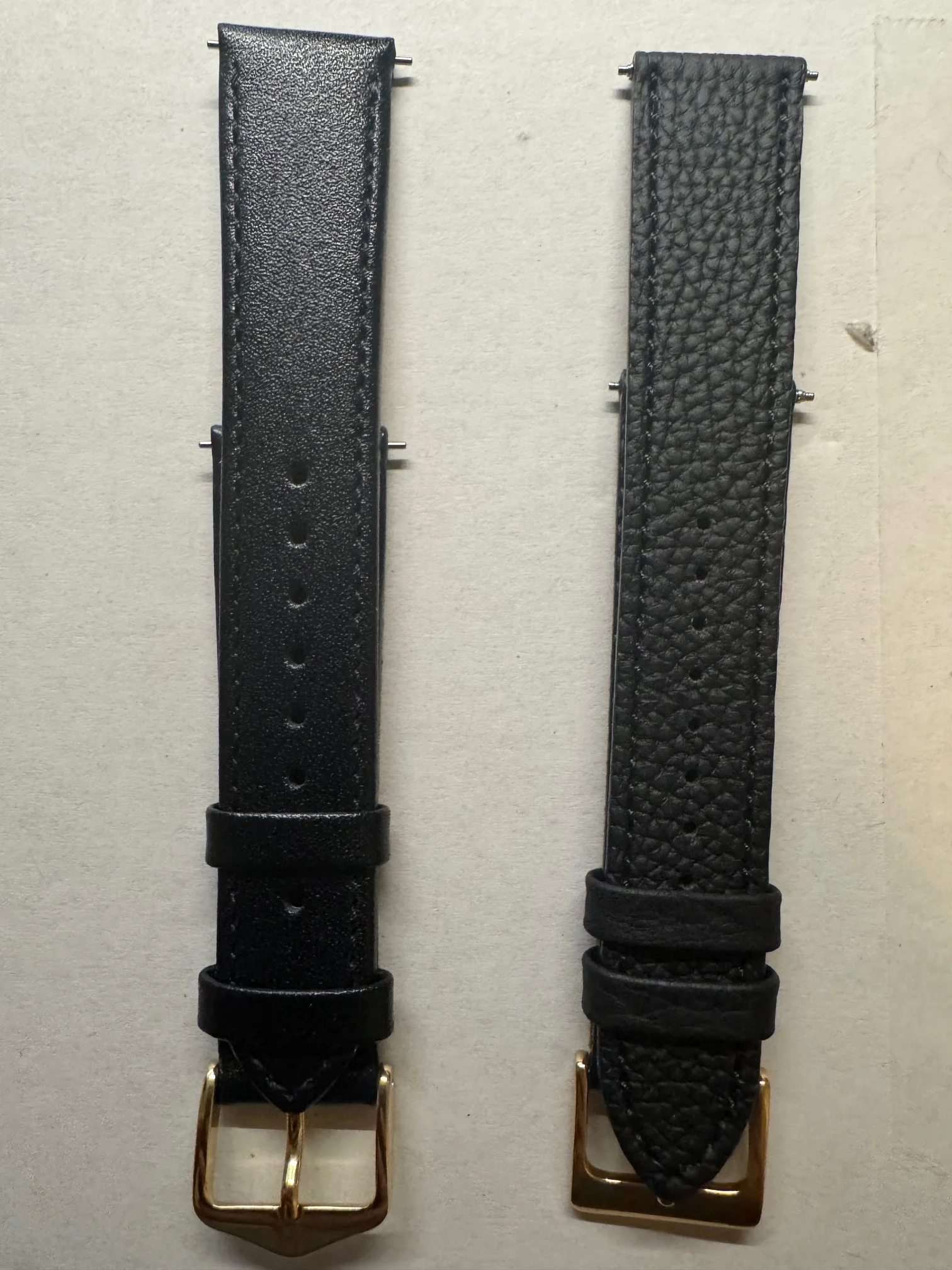

I just purchased some straps for my watch. Still in the process of being fixed. These are two I picked . I purchased from a company called Black. Bought from the UK. Which one do you think would look the best? I am leaning towards the left strap.
