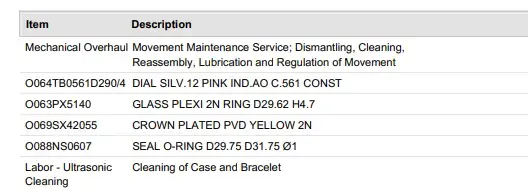

So I went to a watch store in SoCal. They quoted me 1500. They would fix everything. What do you guys think? Is it worth it? All the parts are from Omega.
6,306
9,744
The redial comment was indeed regarding the other watch not yours.
From the scope of work list, are we right in thinking that they intend to replace the dial as well as the other work?
I wasn't aware that replacement dials were available - but if they are, what does the 'pink' refer to? (your watch is yellow gold capped and the current indices are yellow gold.)
Who was it that you went to for the quote?
The dial has a part number - If I could politely page @Archer to see if he knows if dials are available for a 50/60s Constellation and what this dial code refers to.
Each to their own - but I would probably retain the original dial unless you have seen what you will be getting and are happy with it.
That's probably about 3x what a basic service should cost, but they are apparently including a dial, which would be nice to have because yours is in bad shape. Make sure that the markers match the case color, and you will also need hands.
Also, I don't know how important the watch is to you, but $1500 is probably more than the value of the watch after restoration.
If this includes the movement parts that are required, then the price is not out of line at all. The dial alone is a full 1/3 of that price, and I've had watches come close to this number without a new dial.
Do Omega do (correct) dials for this reference?
29,671
76,828
The dial listed is available, along with 3 others that have different colour combinations.
Whether these are "correct for this reference" would depend entirely on what the reference is. You have stated a reference, but we don't have confirmation that is what this watch actually is from what I can see.
The dial indicated is "correct" for the following 3 case references per the Omega Extranet:
14777
1680001
1680020
6,306
9,744
14777
1680001
1680020
You are absolutely correct.
There is a jumbo reference that has the ‘missing text’ dial (14777) so it could be that.
We should give the watchmaker credit that they have actually had the back off and looked at the reference.
Interesting that there are any Omega sourced service dials available at all.
Pink refers to the colour of the indices - so pink gold.
There are two dials available that have yellow gold indices:
064TB0561D290/2 - this has onyx looking inserts in the indices
064TB0561D290/3 - plain gold indices
The last one is:
064TB0561D290/1 - with "grey" indices, meaning silver.
None of these have lume of any sort.
That’s what I was afraid of - as the watch looks to be yellow gold.
