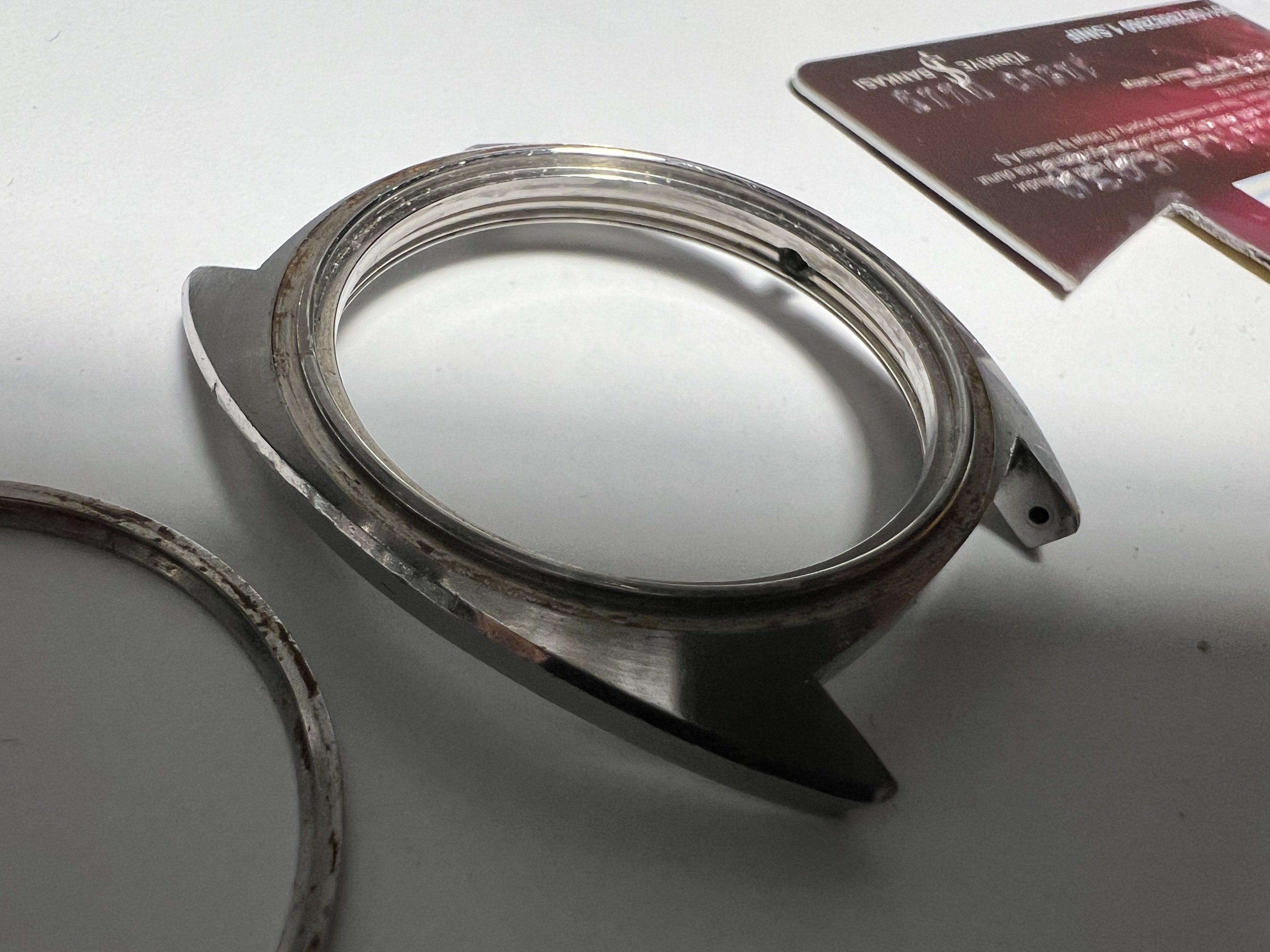

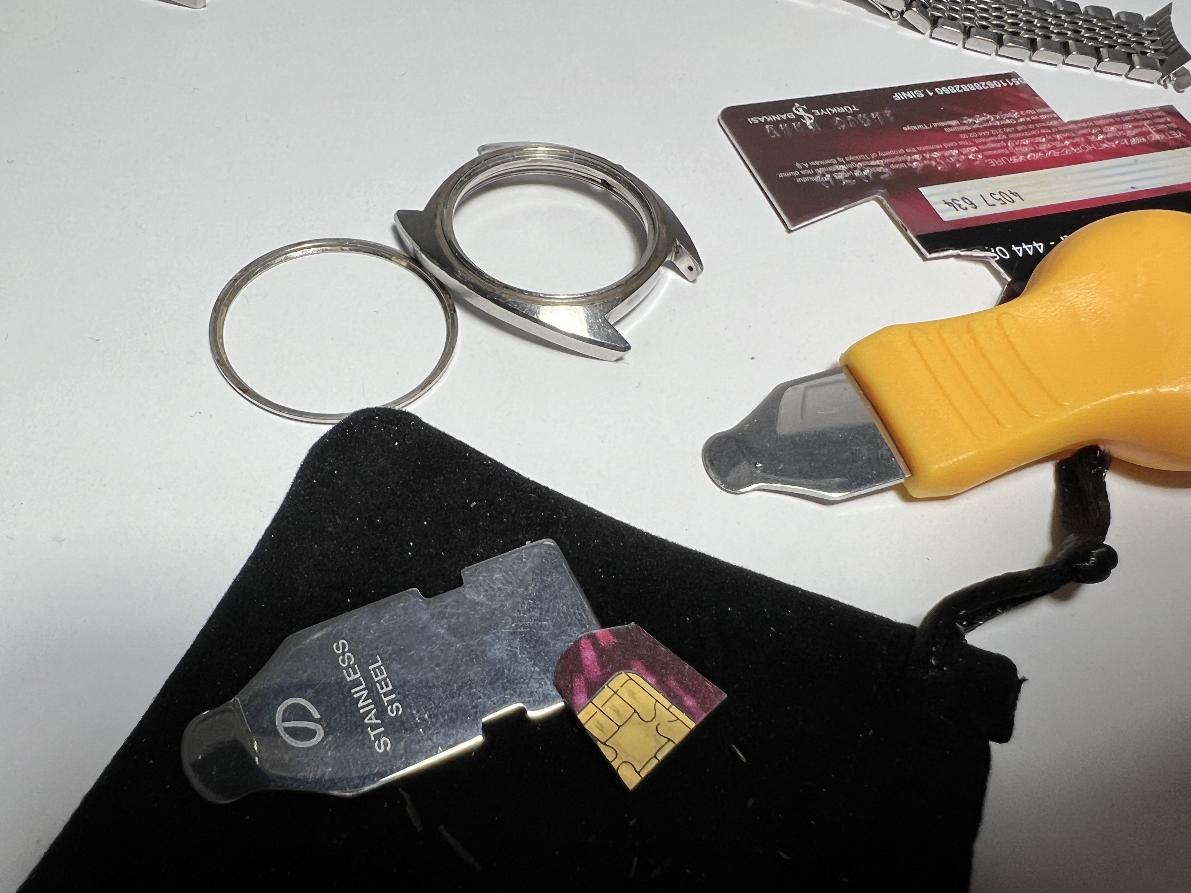

Hi everyone,
My old method was to prepare shivs from plastic materials like credit cards and use them to yank from inside under the bezel and remove the bezels (I say method but I only did it 2 times, lucked out maybe). This specific bezel was challenging and fused- I ended up removing it with 2 opposing caseback openers, one slimmed down to hopefully prevent inner damage and luckily it worked well
But I think using caseback openers is super risky, I want to be able to safely remove bezels
Is there a tool that will get inside the case and extend 4 yankers from inside? That could be a good way to approach this
With these cases the outer sides are flush, so approaching from the outer sides is I think a harder approach and will most likely scratch the case
Is there a correct way to do this?

Thanks for the suggestions, very curious about the Chinese version, if there was a tool that did this from inside it would be idea but I guess the use would be very limited
I've used opposing caseback openers on a couple of other discarded cases, didn't tarnish the cases or bezels, I'd suggest it as well - if the bezel is thin though, like on some GC cases, this Chinese tool could be better
