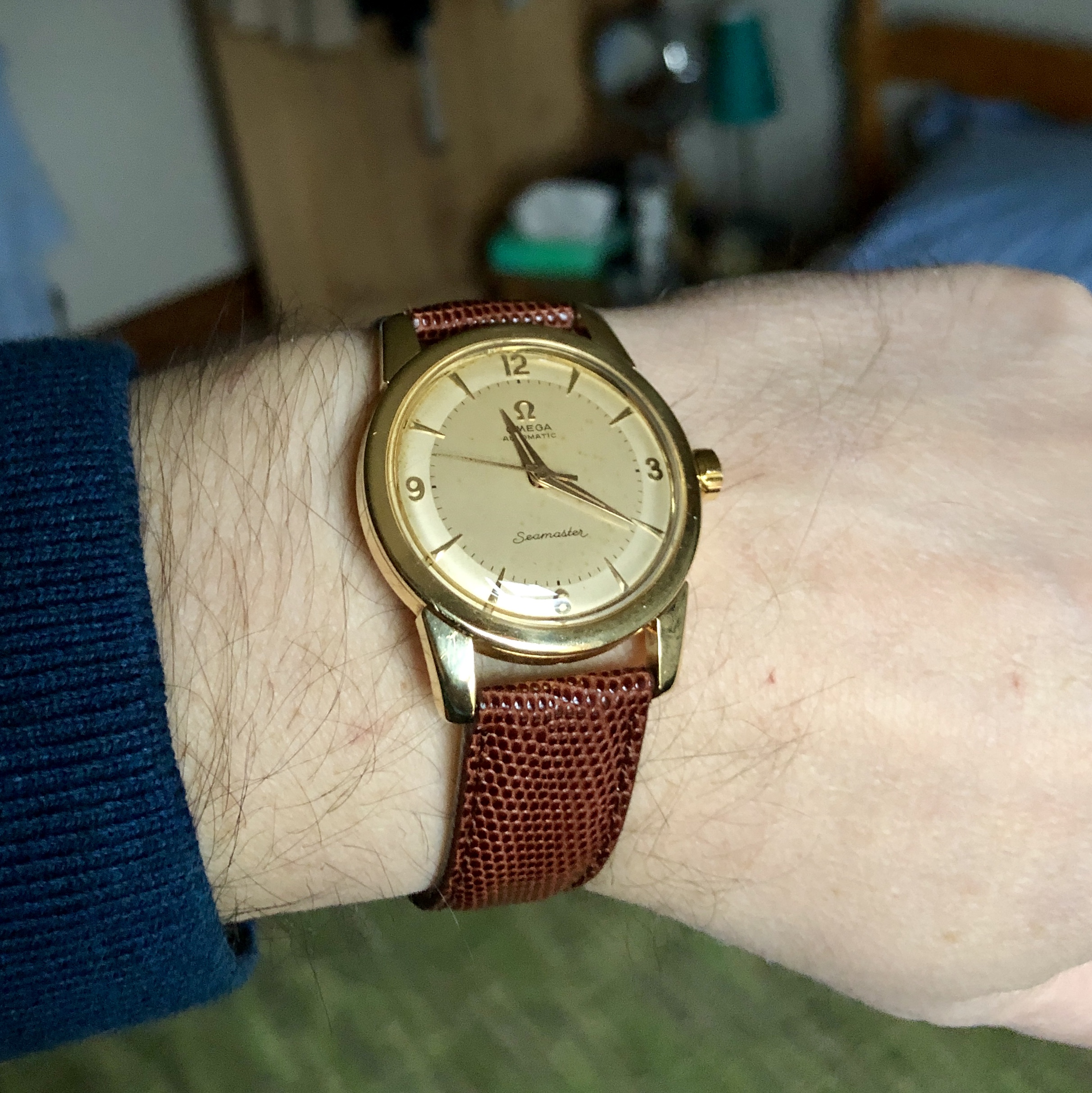

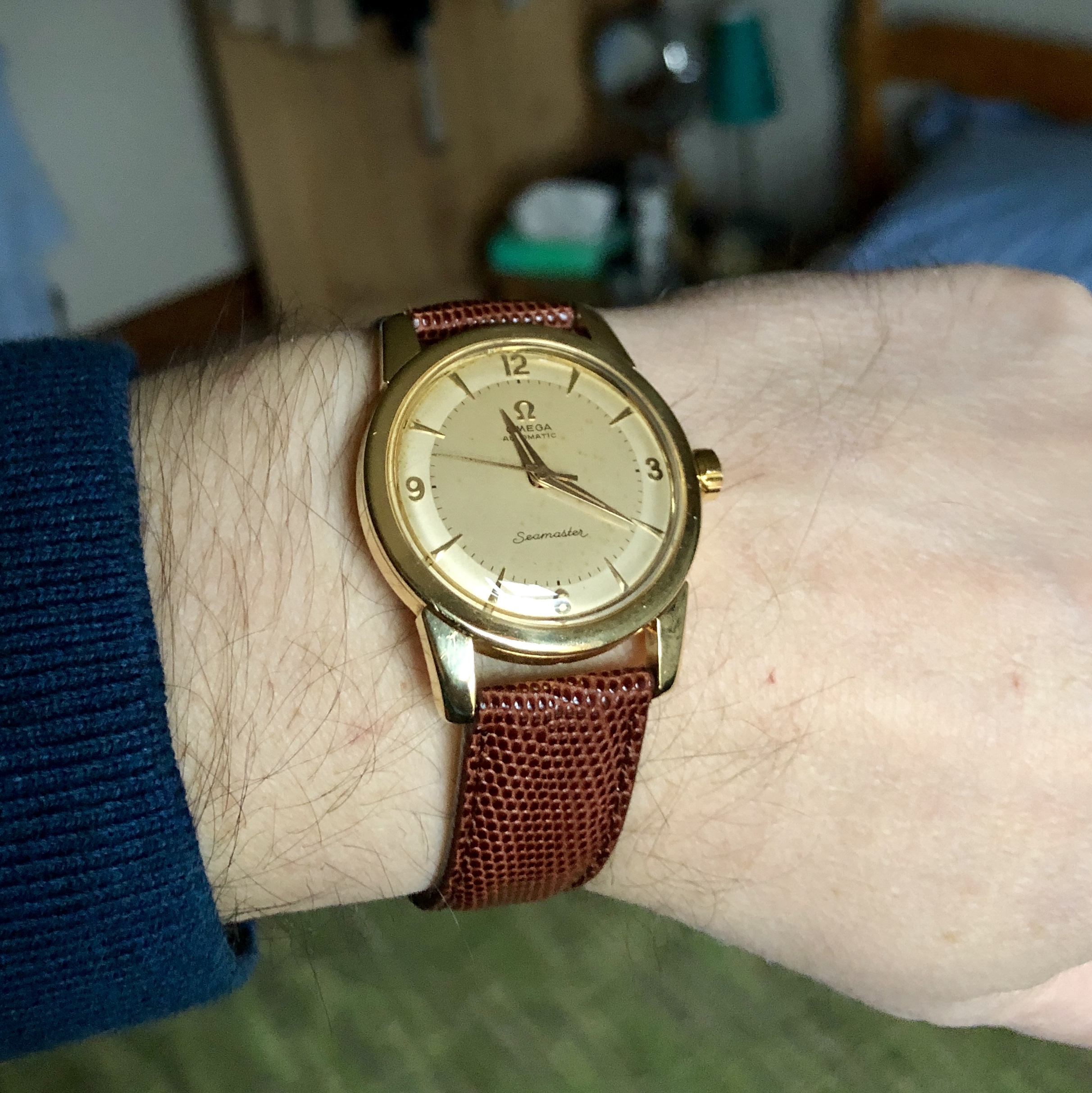

Here is my 2846 (centre second full rotor fat lug) in 18k gold:
22
14
Be aware that fat lugs like these are usually no bigger than 35mm. I think there was a jumbo 36mm model but you will struggle to find it even in steel, and really struggle in solid gold.
Beautiful watch! Yeah, I think there is a 36mm variation which is the one I tried on at the store.

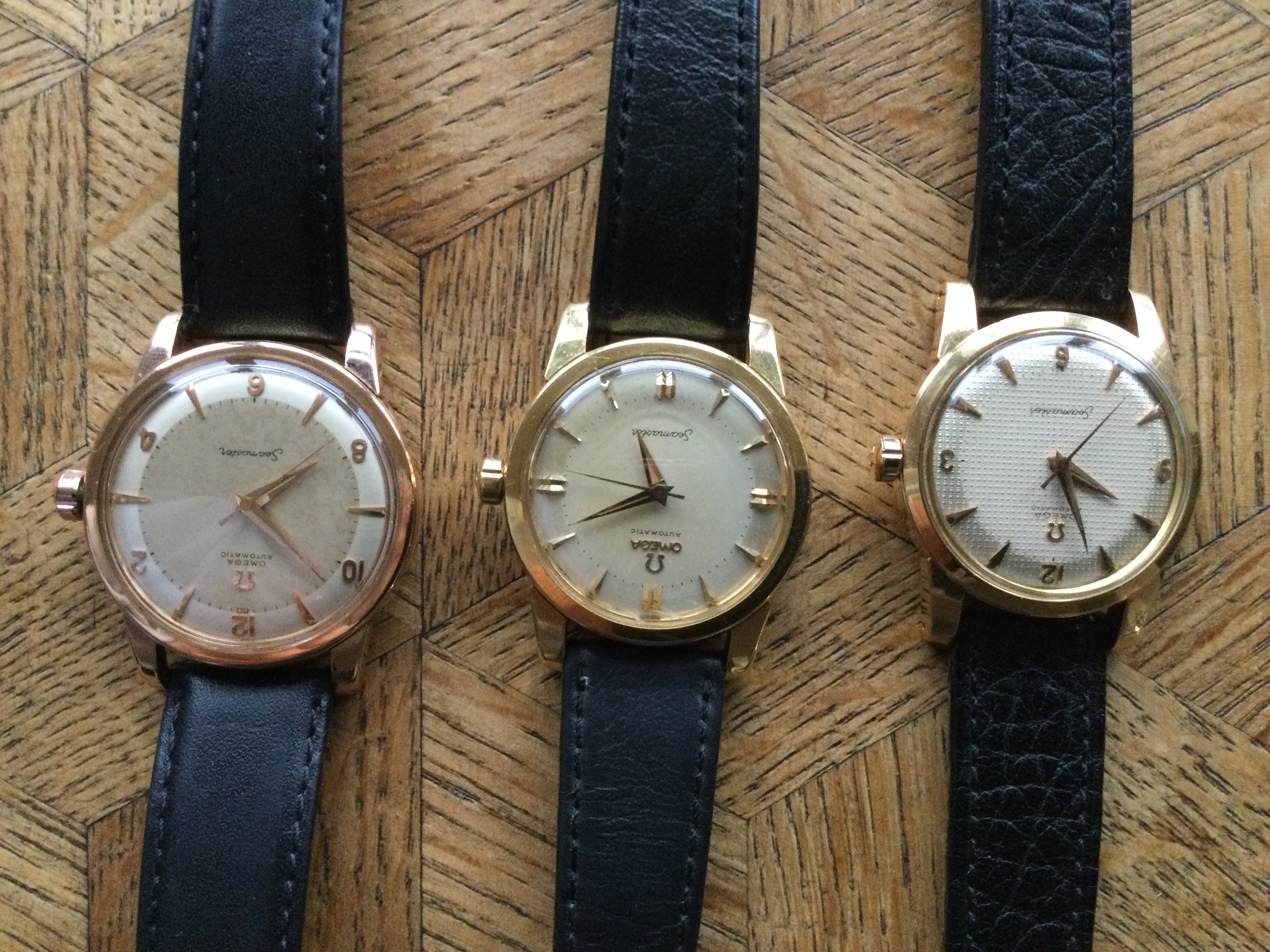

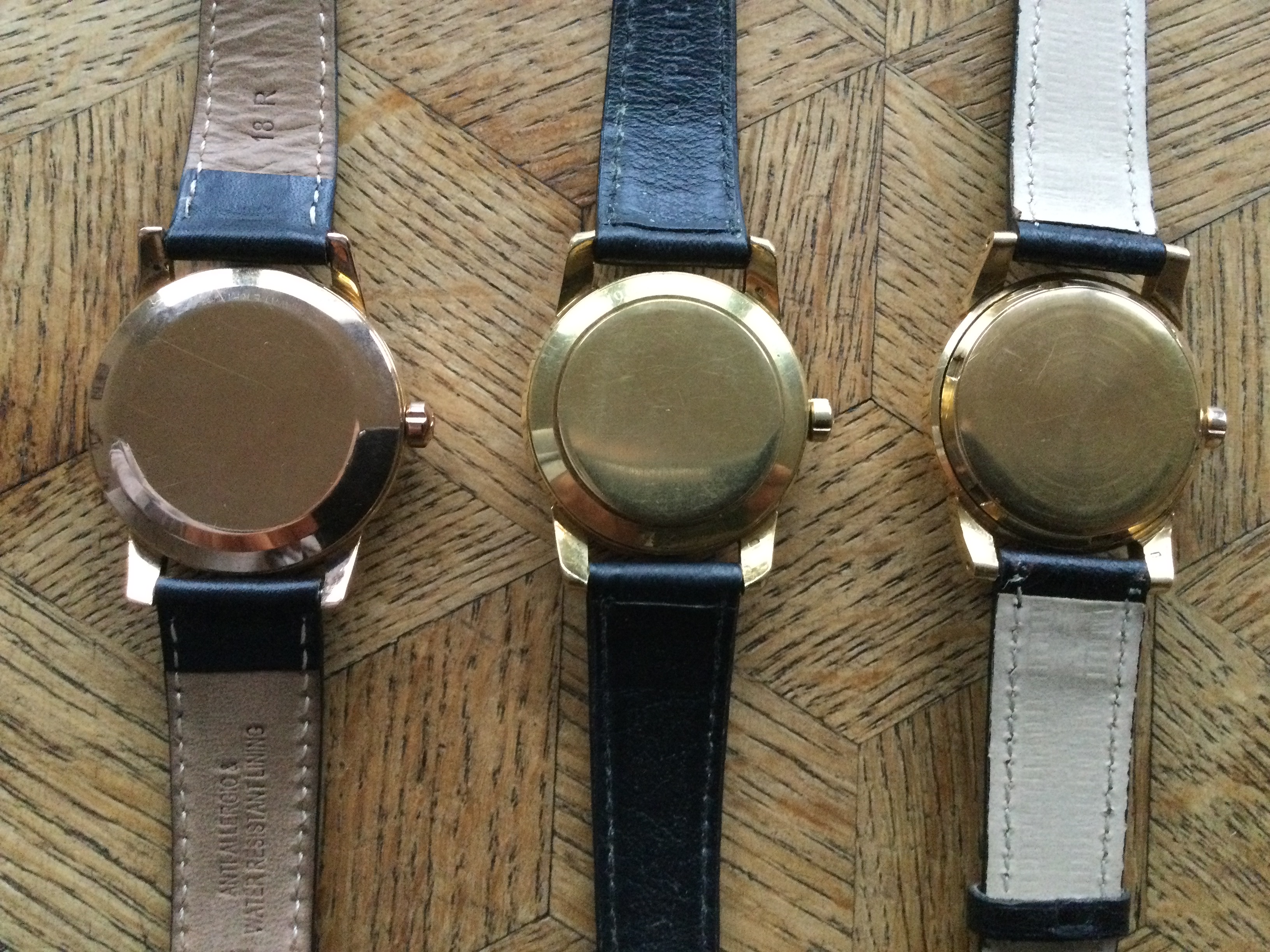

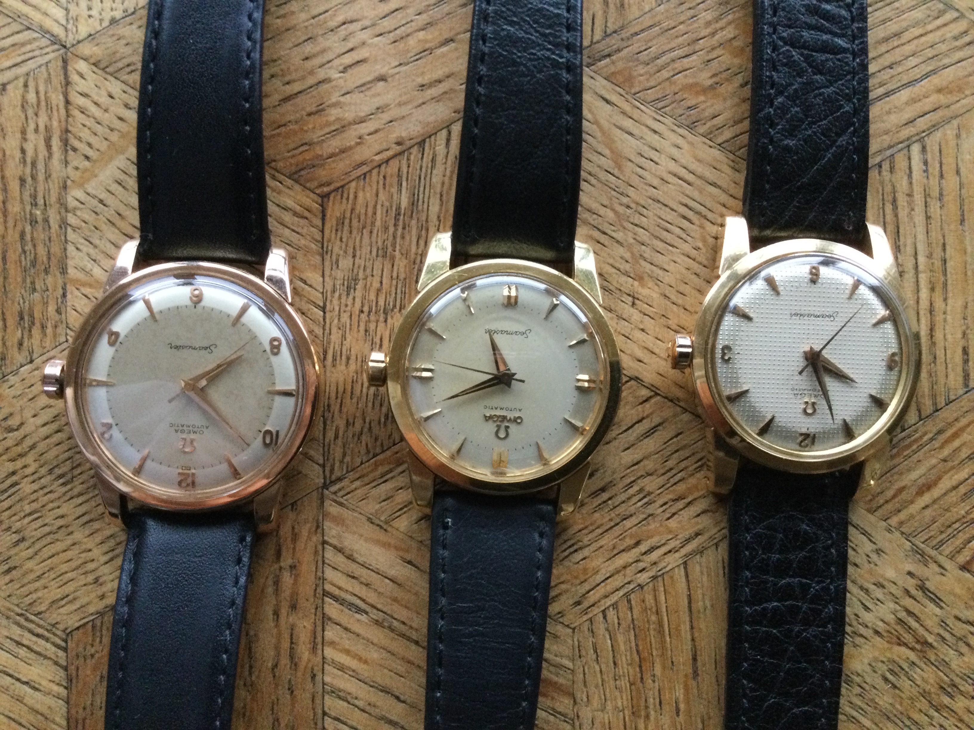

The « jumbo » is 35,6 mm. and the normal one are either 34 mm. for the bumper and 34,2 mm. for the rotor.
Here are center second ones, respectively bumper, rotor and jumbo rotor :
8,174
36,709
Clearly Australian editions 😁

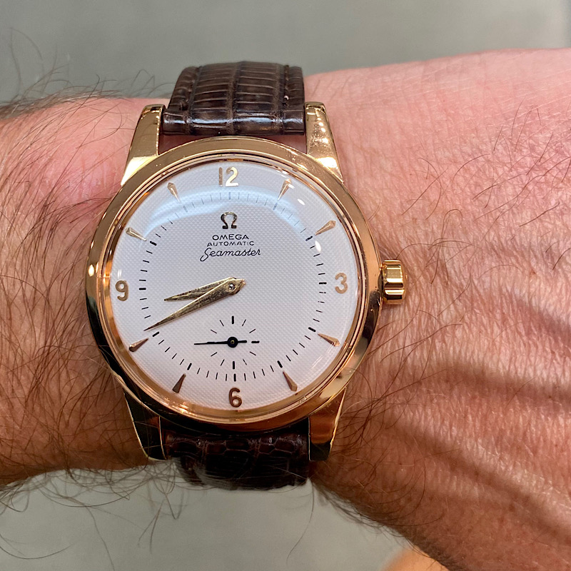

The watch in the original post is a jumbo bumper, so a ref. 2494 pr 2657 which is 36.5mm to be exact 😁
While some of the fat lug Seamasters have fairly skinny lugs and could be confused for a jumbo reference, only the jumbo versions have a full 6 o'clock marker and a sub-seconds dial. On regular versions the 6 o'clock marker with be missing or smaller due to the smaller dial. On versions with a central seconds hand, ID is more difficult.
