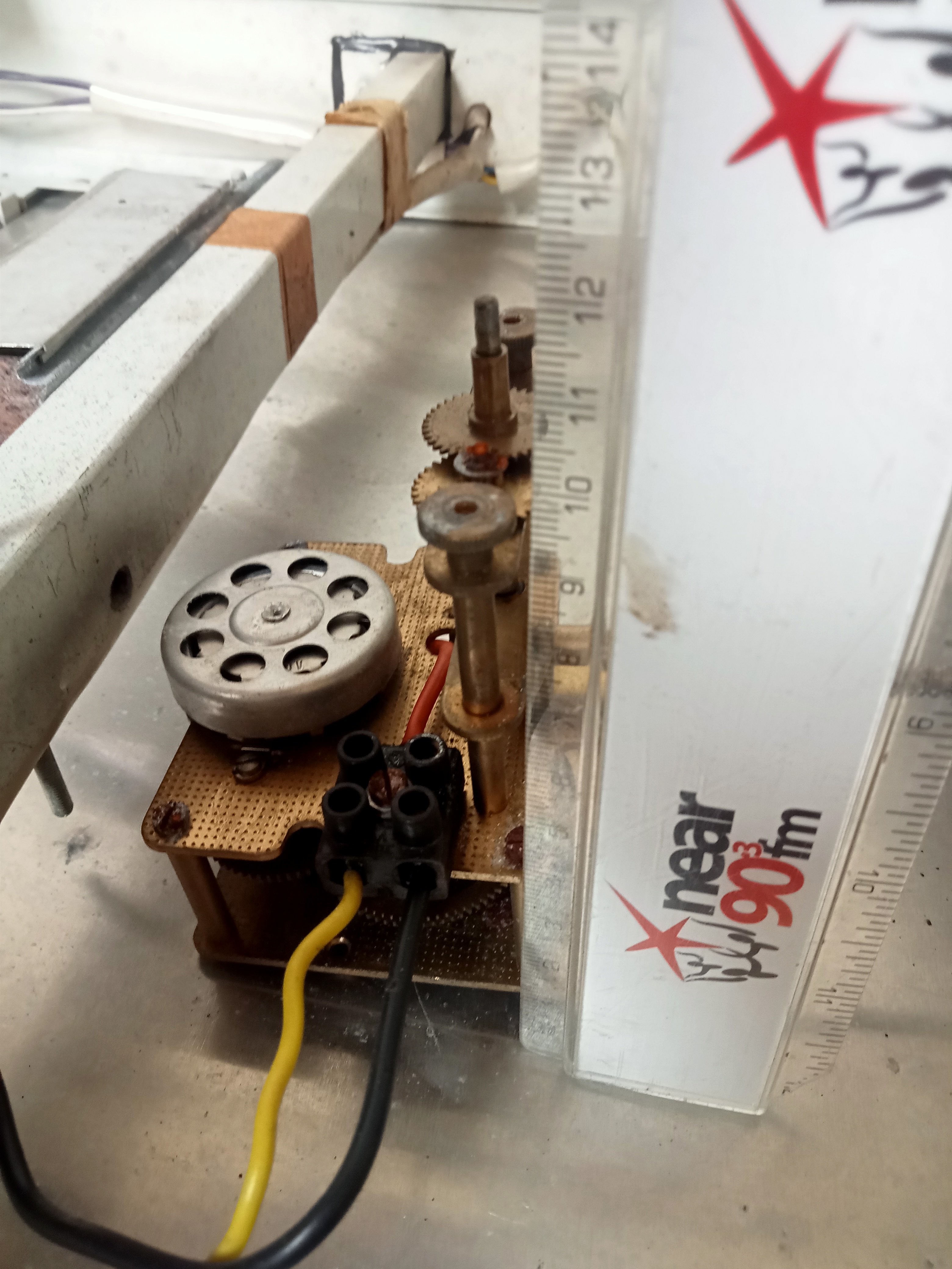

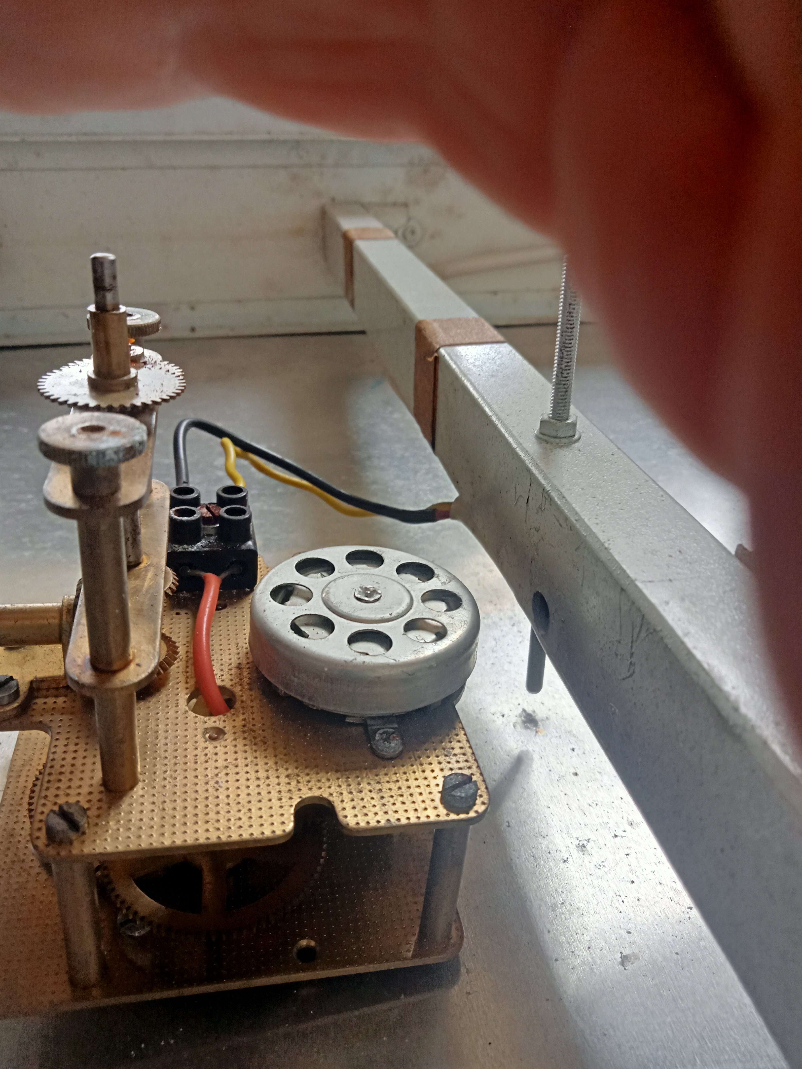

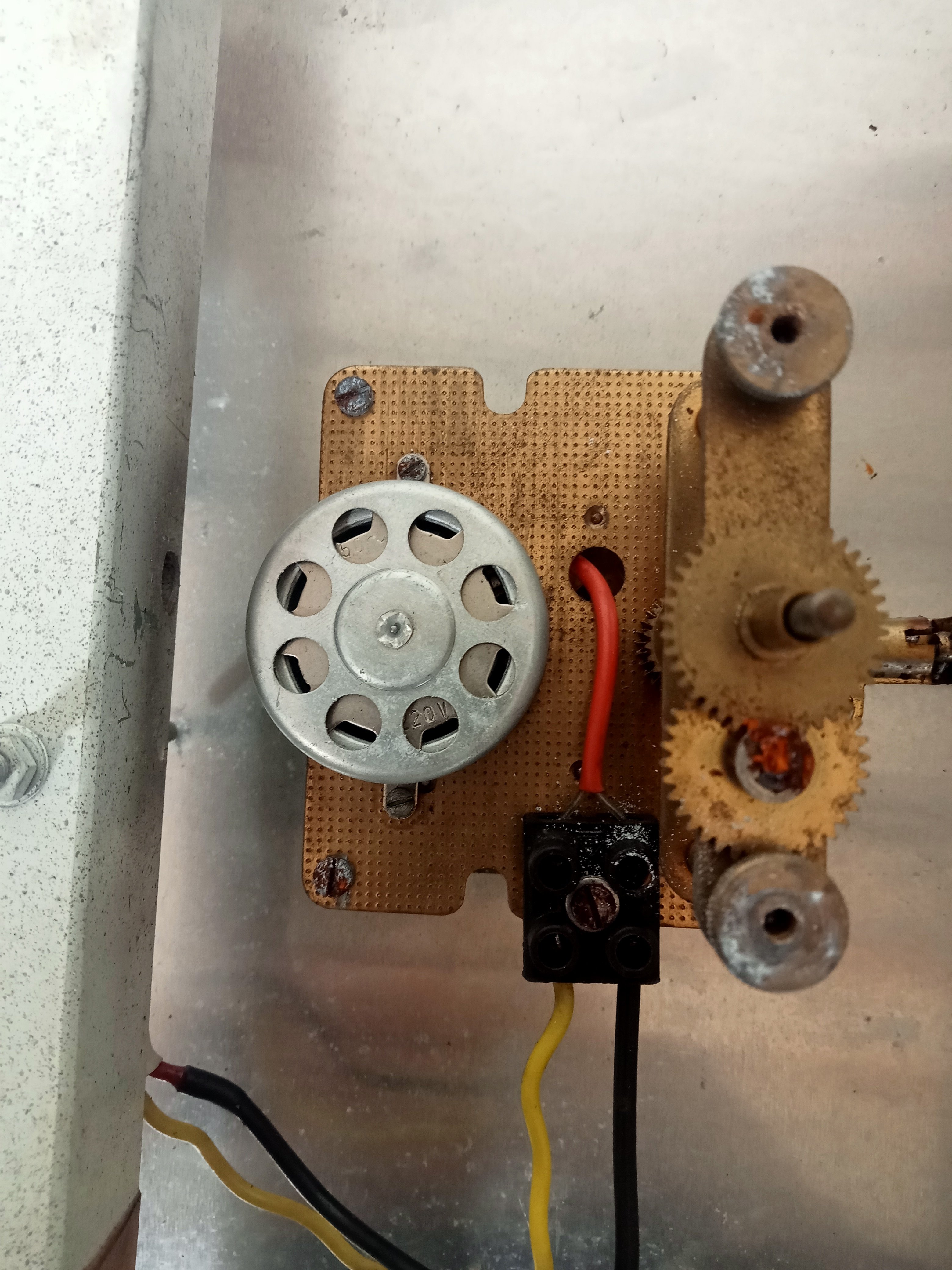

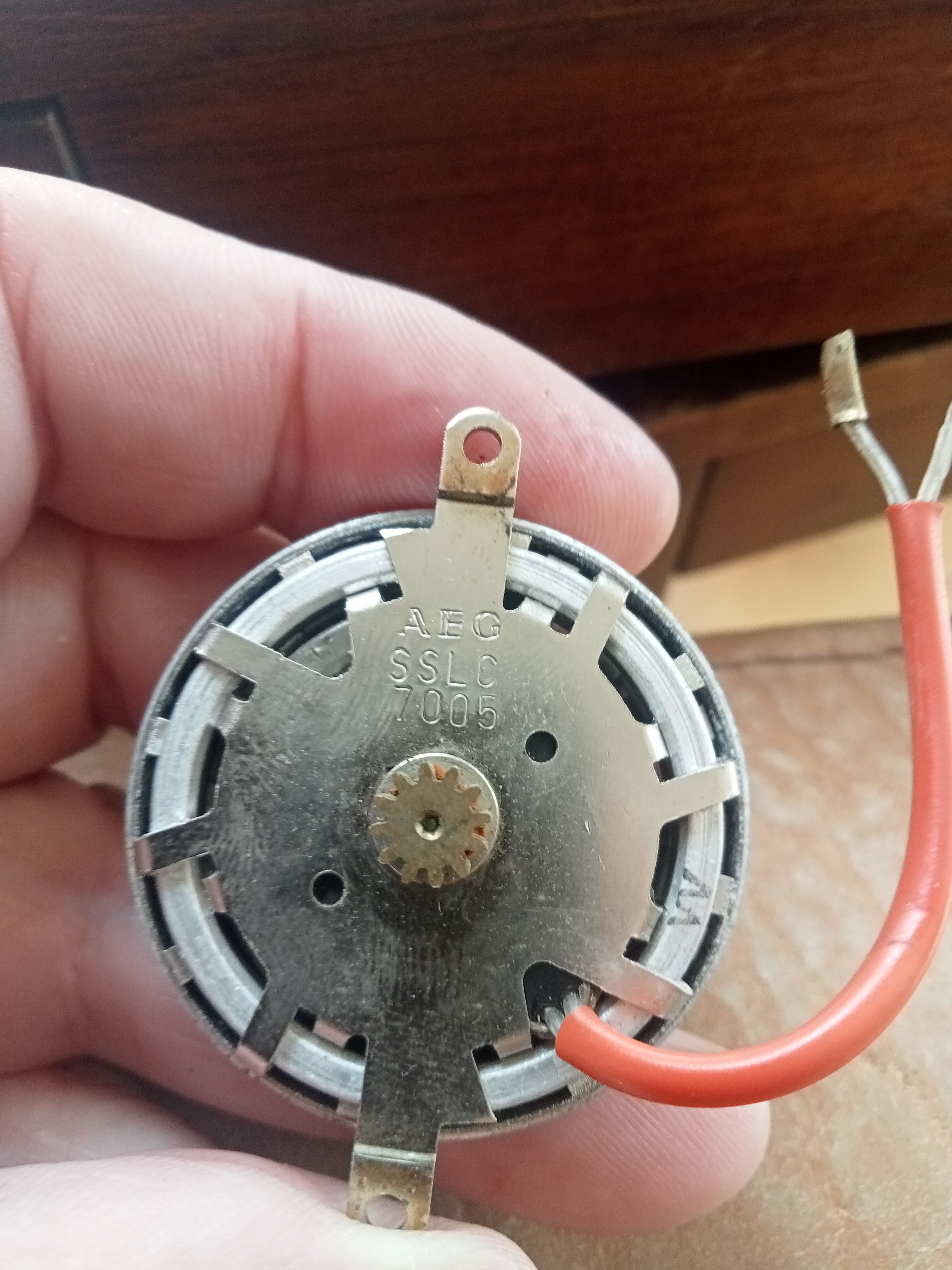

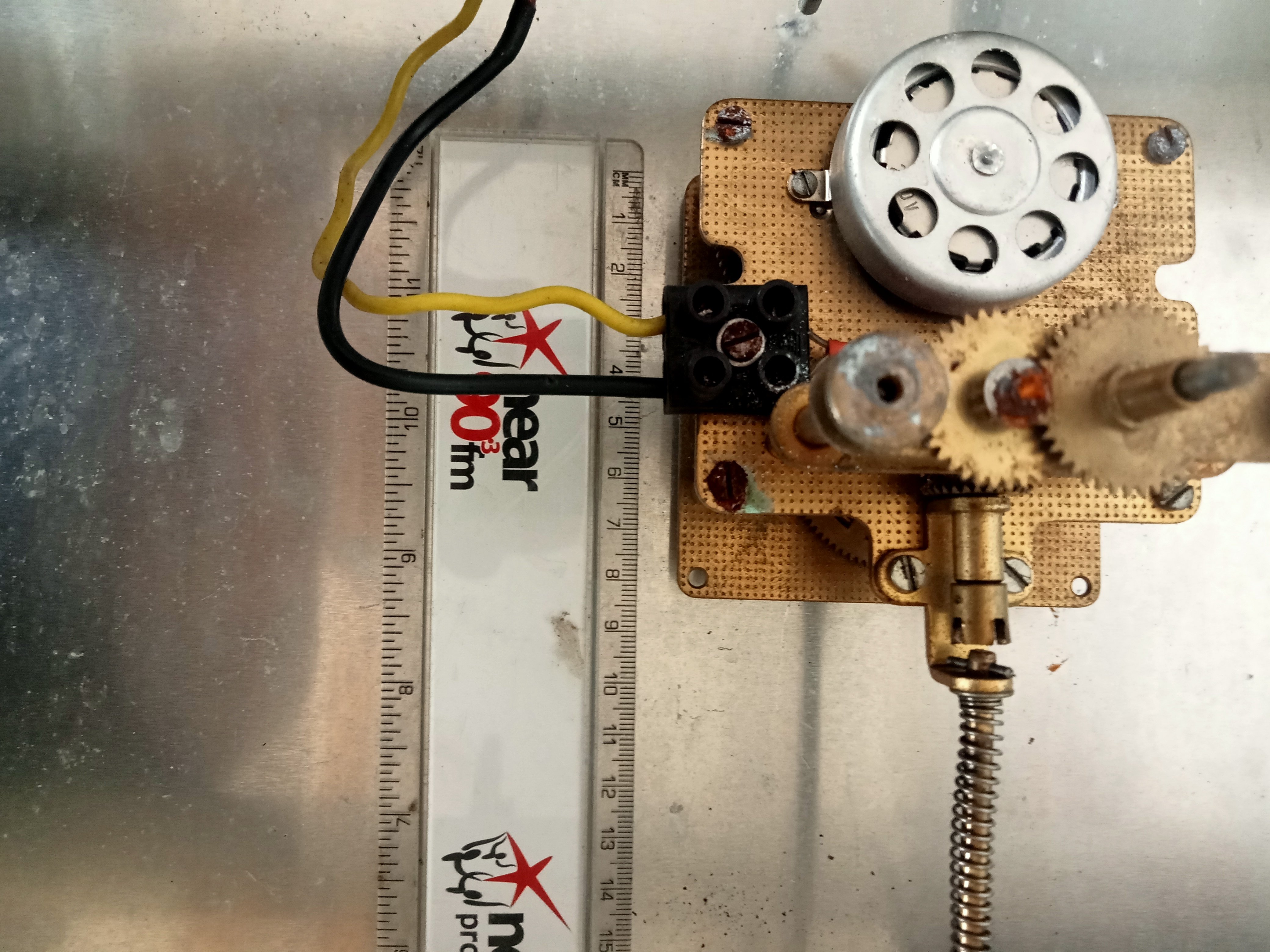

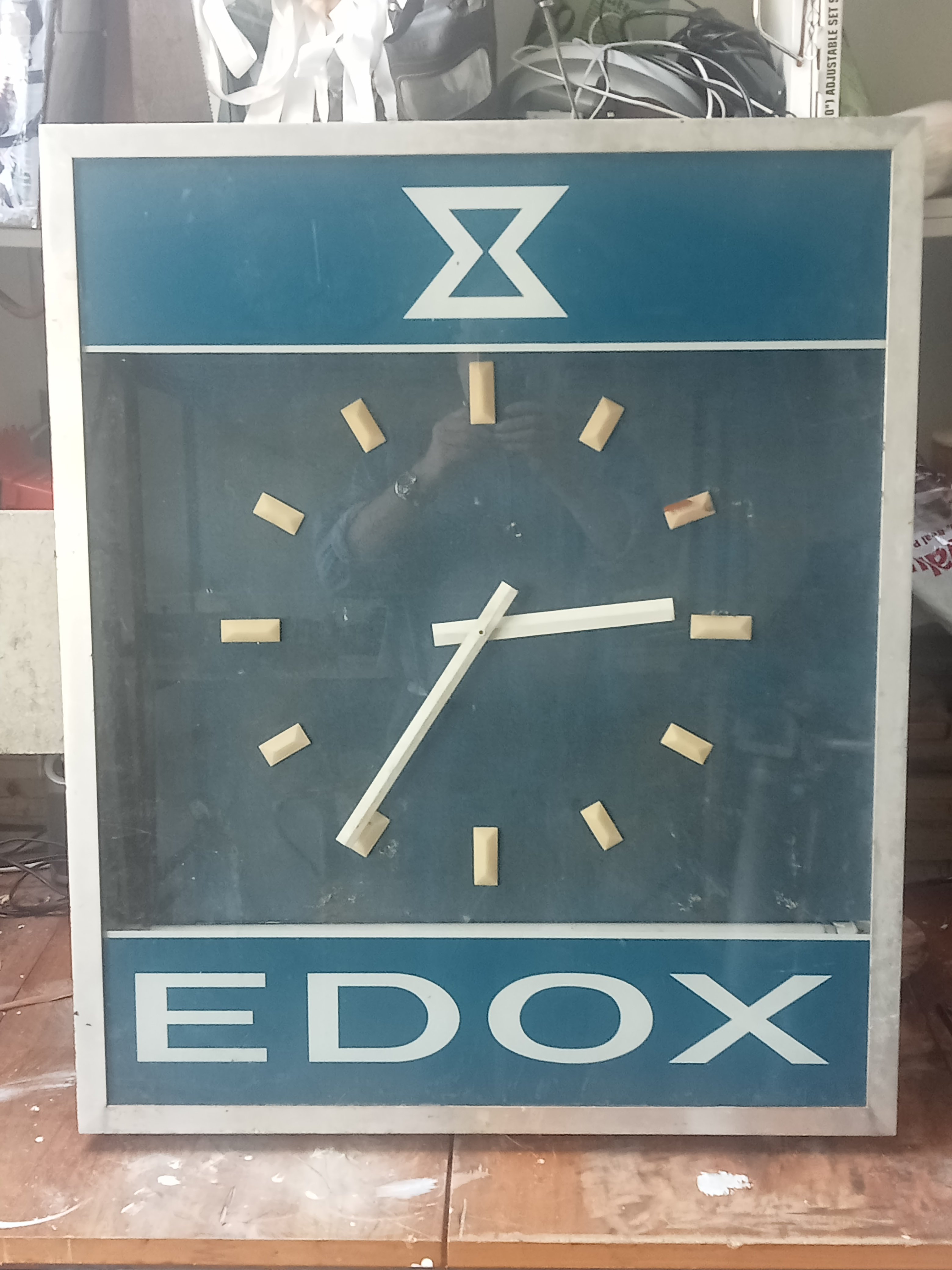

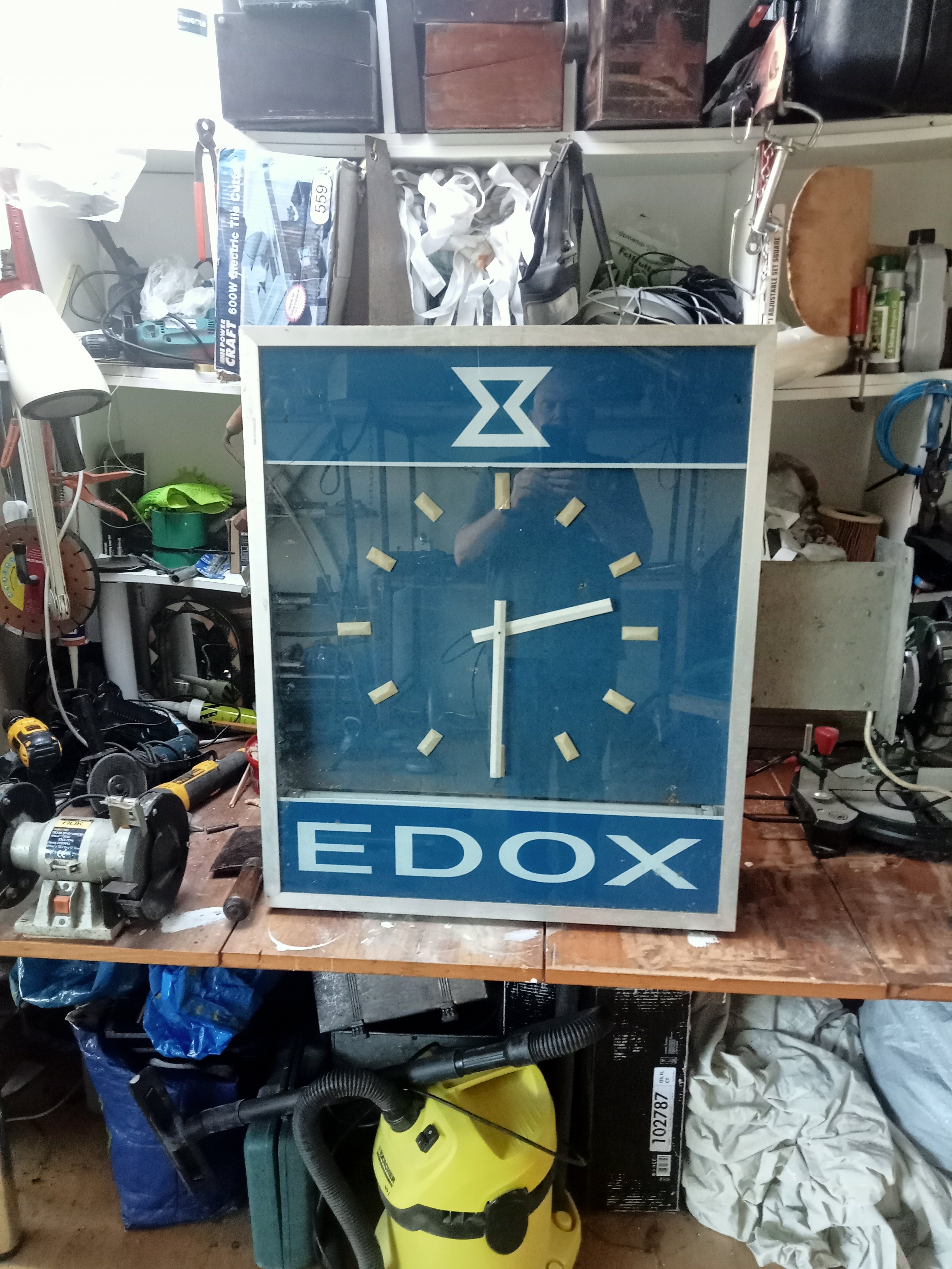

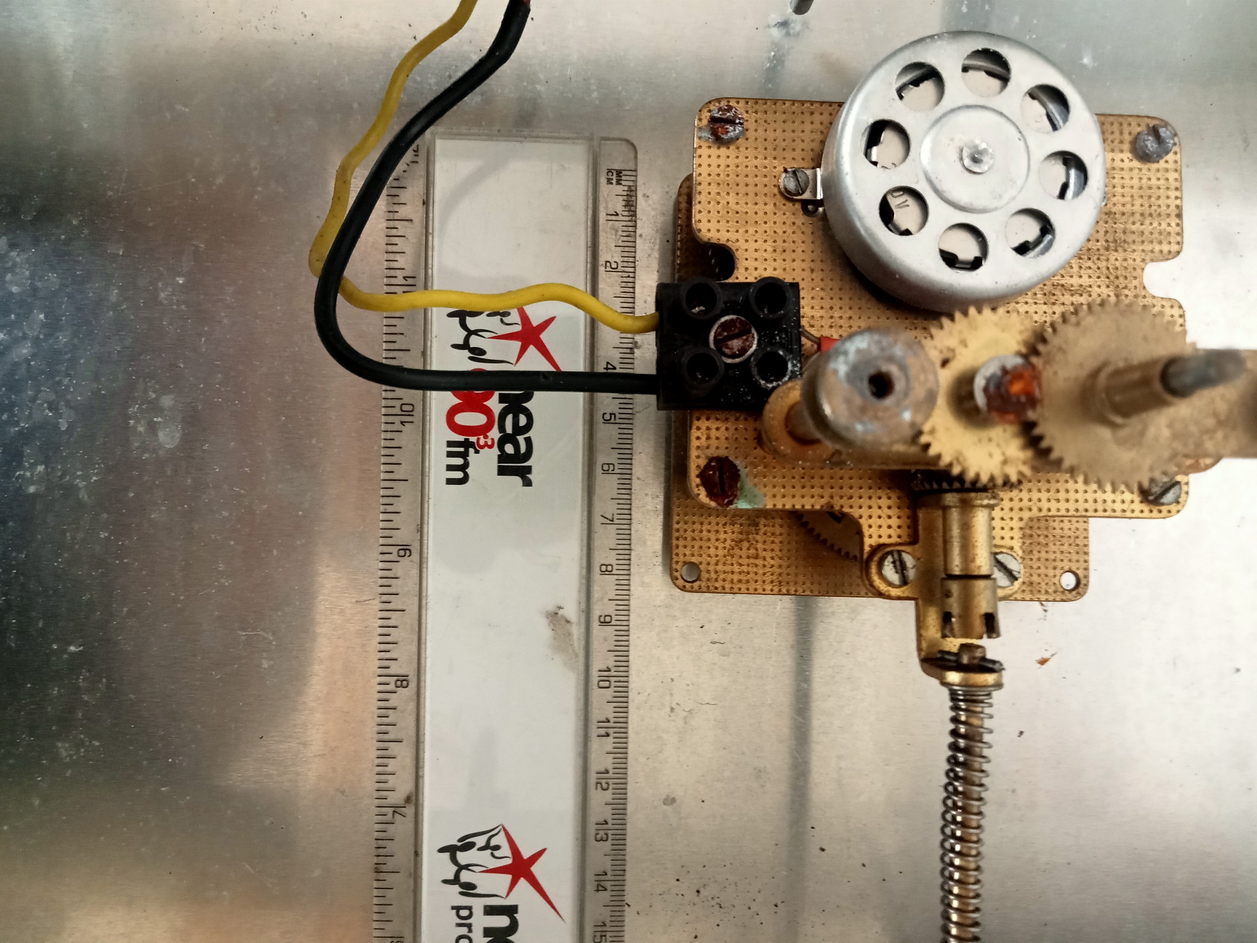

Not Omega related. Hi, I recently picked up a large Edox dealer outdoor clock. I am in the process of attempting to repair the ( very small ) clock mechanism. It seems very simple but just wanted some advice on replacing a synchronous motor. I enclose photos and know that I need a 220v , 50h motor but I am not sure about the speed of rotation. I assume it should be 1 rpm . If anyone has any knowledge could you please let me know. Many thanks.

perhaps you can calculate "backwards" : you count and calculate by the "number of teeth" of the transmission...if the motor drives the second-hand

Thanks for the reply. There is no second hand, only minutes and hour hand. It really is the most basic mechanism I have seen.

You need to know if it drives the minutes or hour hand directly , then you can " calculate" ..... if there is another transmission below/hidden
3,237
6,783
errata: I don t think, the motor has 1/rpm. So he will not supply the one minute hand directly - IMO not suitable for a watch.
Maybe you can find an un-original (quartz) movement from an (old) wall-clock and change just the hands

I really like the esthetic of the clock as is so hopefully I can find the correct synchronous motor to suit. Lots for sale on eBay, just hoping to pick the correct one.

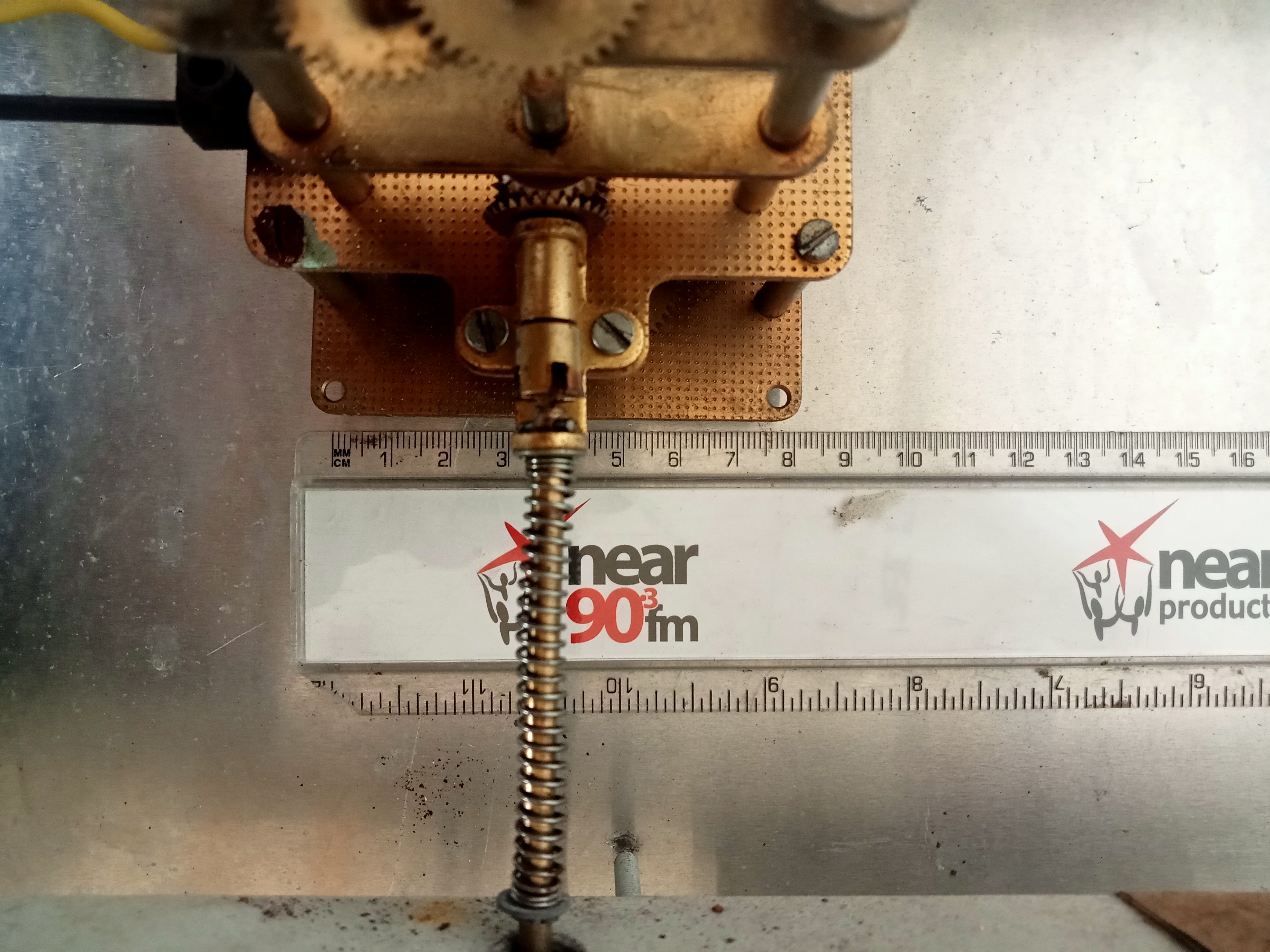

No, this one is just a plug in and go clock. Even the mechanism to change the time is on the base of the clock ( probably with a big ladder ) . Take a look at this photo. You push up a lever and it engages
