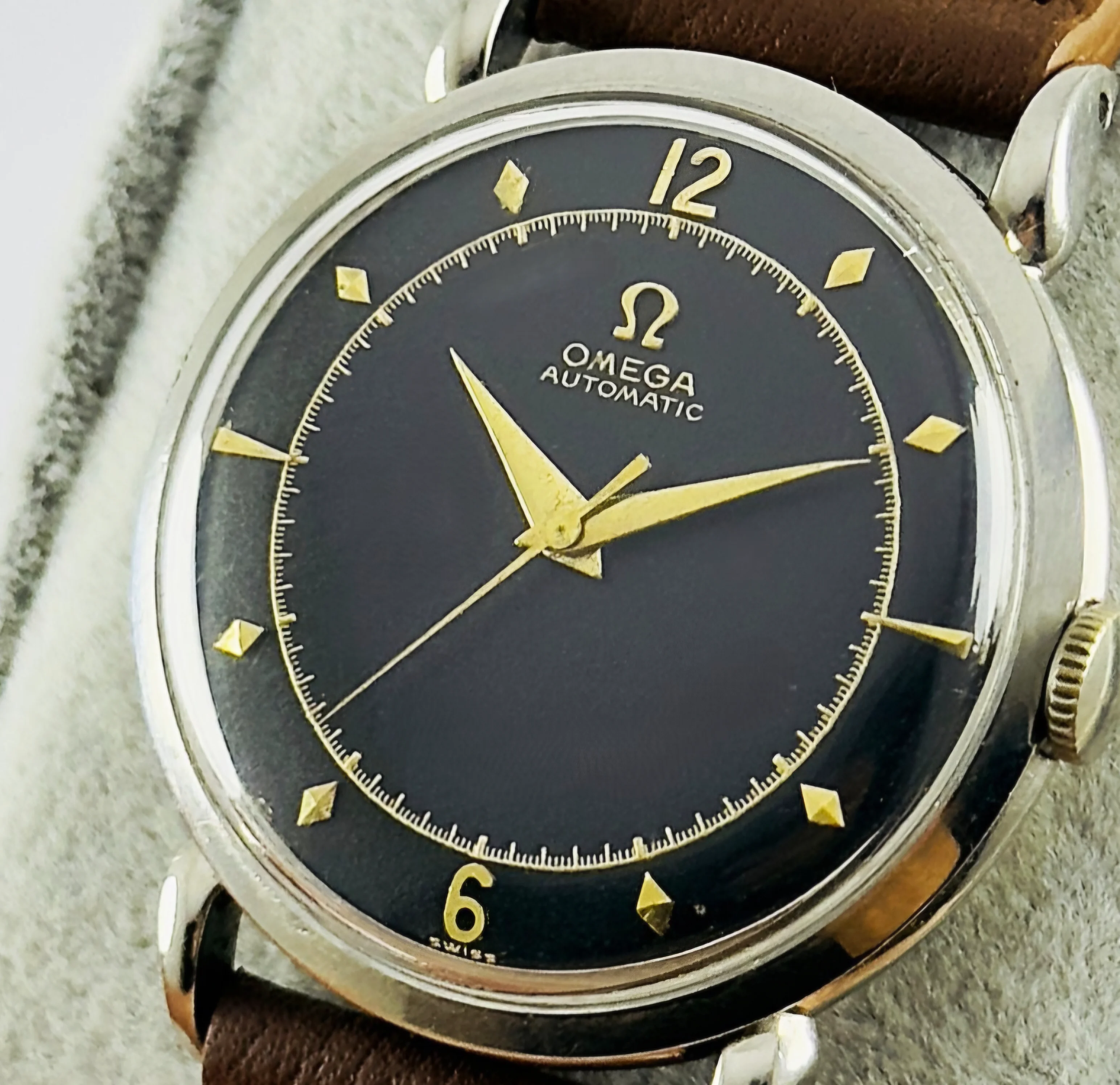

I got my hands on this Omega watch - I did not pay a lot and just fell in love with the look (each to there own) it also is the first Omega watch I got...
Nevertheless, now I am a bit curious about the exact model and have a few questions about it, I would like to ask you guys!

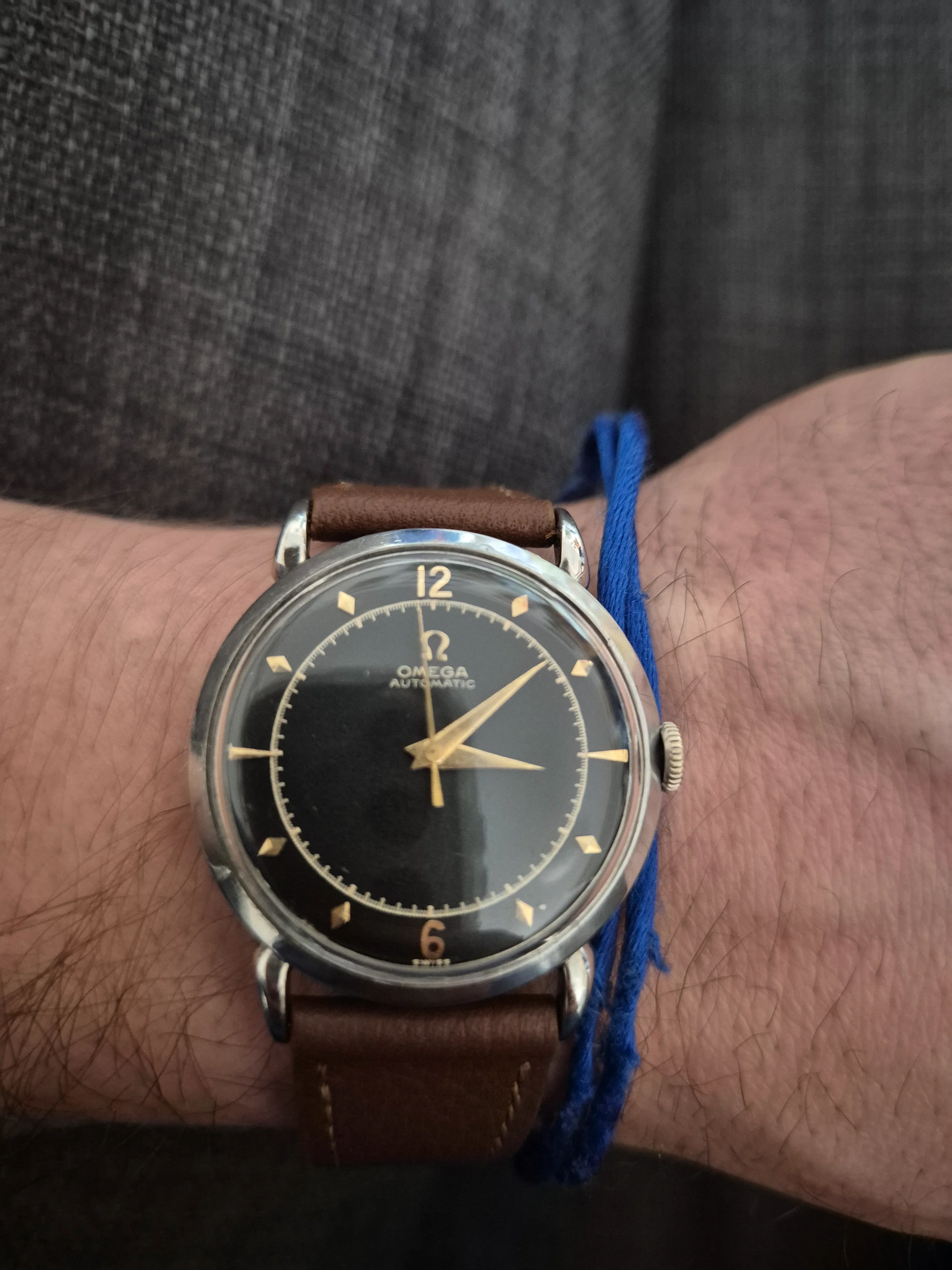

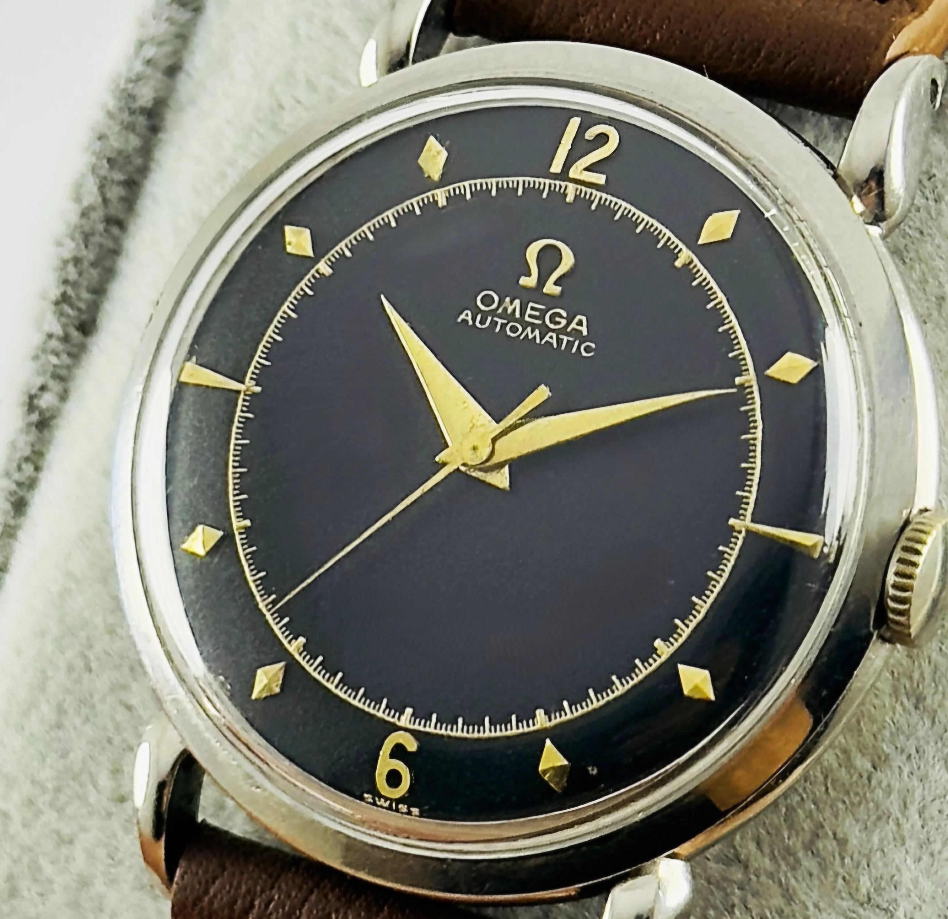

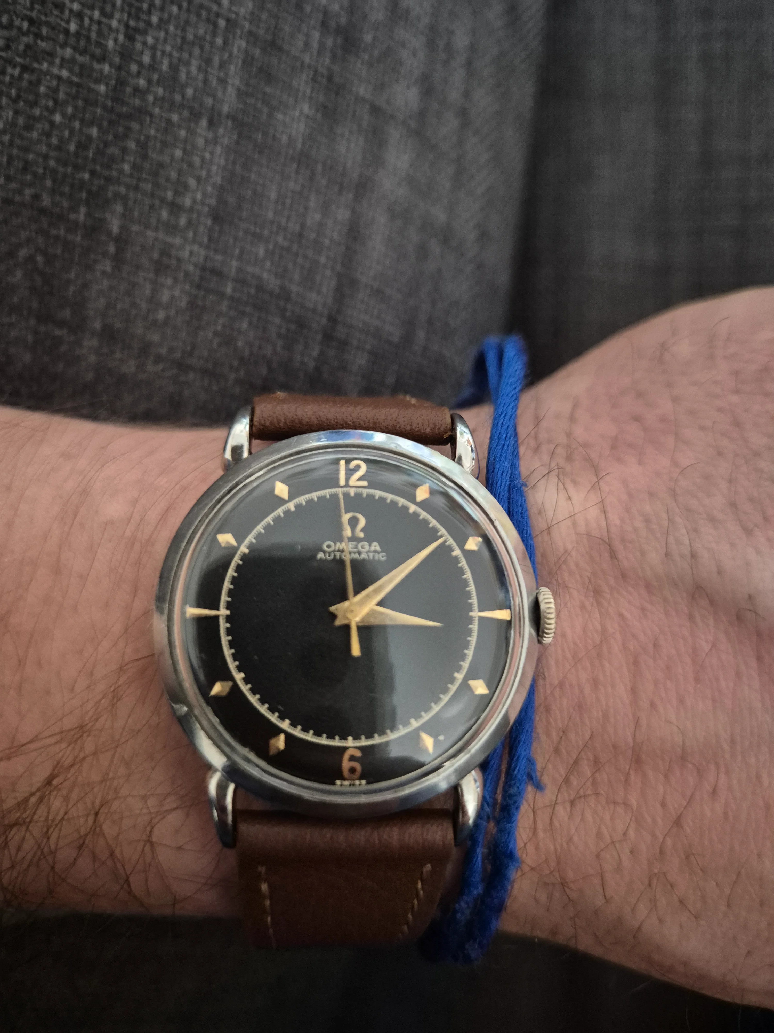

I guess the watch was badly restored and repainted, looking at the dail (the six is not in the middle... and so on)
Also, the crown is not Omega as the sign is missing, I guess.
And the bracelet is some cheap exchange.
Anyway, I am more curious about the inside and the crystal?
The crystal seems like plastic to me it is not glass anyway, very light, and it has this typical plexiglass feeling it i hit my teeth against it 😉
but the seller says something about mica... probably MICAVER®
Does this make sense? And was this used on these watches originally?
The inside of the watch might be original, but knowing that so much was done here, I just want you to have a look.

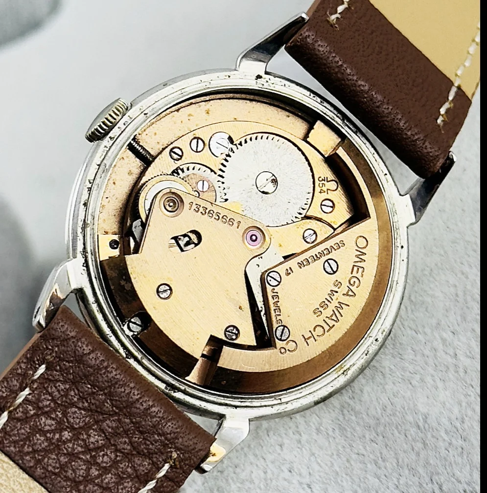

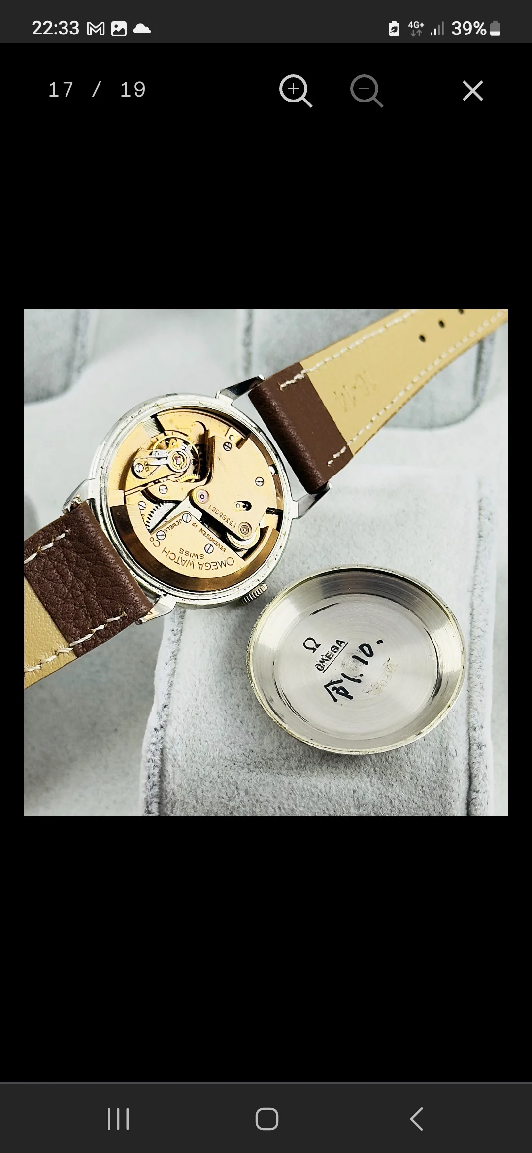

It does have that typical "bump" if I turn it and the watch keeps the time, but what year is it? 1952 or later?

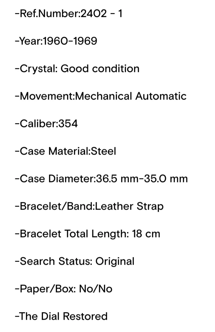

Do these ref nr. and othere nr. make sense ?

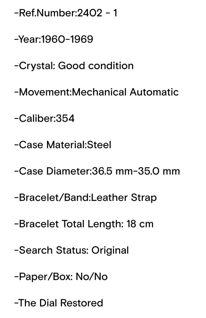

Here are a few pieces of Informationen I got from the seller and the pictures of the watch:

The word MICAVER likely refers to MICONCAVE! A type of plastic crystal. The movement S# would be required to get an idea of the age. But mid ‘50s sounds about right. As to the crown? It would appear that the case may have lost the case tube (pendant), and a regular non water resistant crown was used. The seller admitted that the dial had been re-painted.
18,837
39,175
In answer to some of your questions.
The crystal is an acrylic plastic, the same as the watch came with originally.
The dial has been re-painted, as indicated by the seller.
The serial number dates the movement to 1952 (+/- a year).
The crown is not original.
The 2402 should have a sub-second caliber, this movement is for a sweep second so it may not be original to the watch.

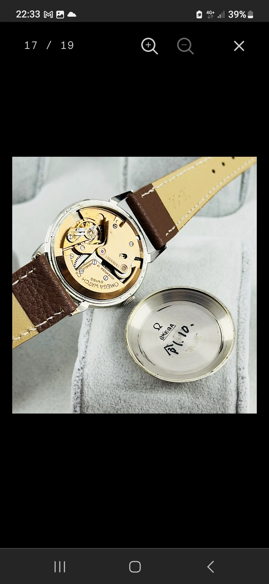

The caseback is probably not original and may be a replacement item for one that was lost.
Here is an example of an original 2402.
