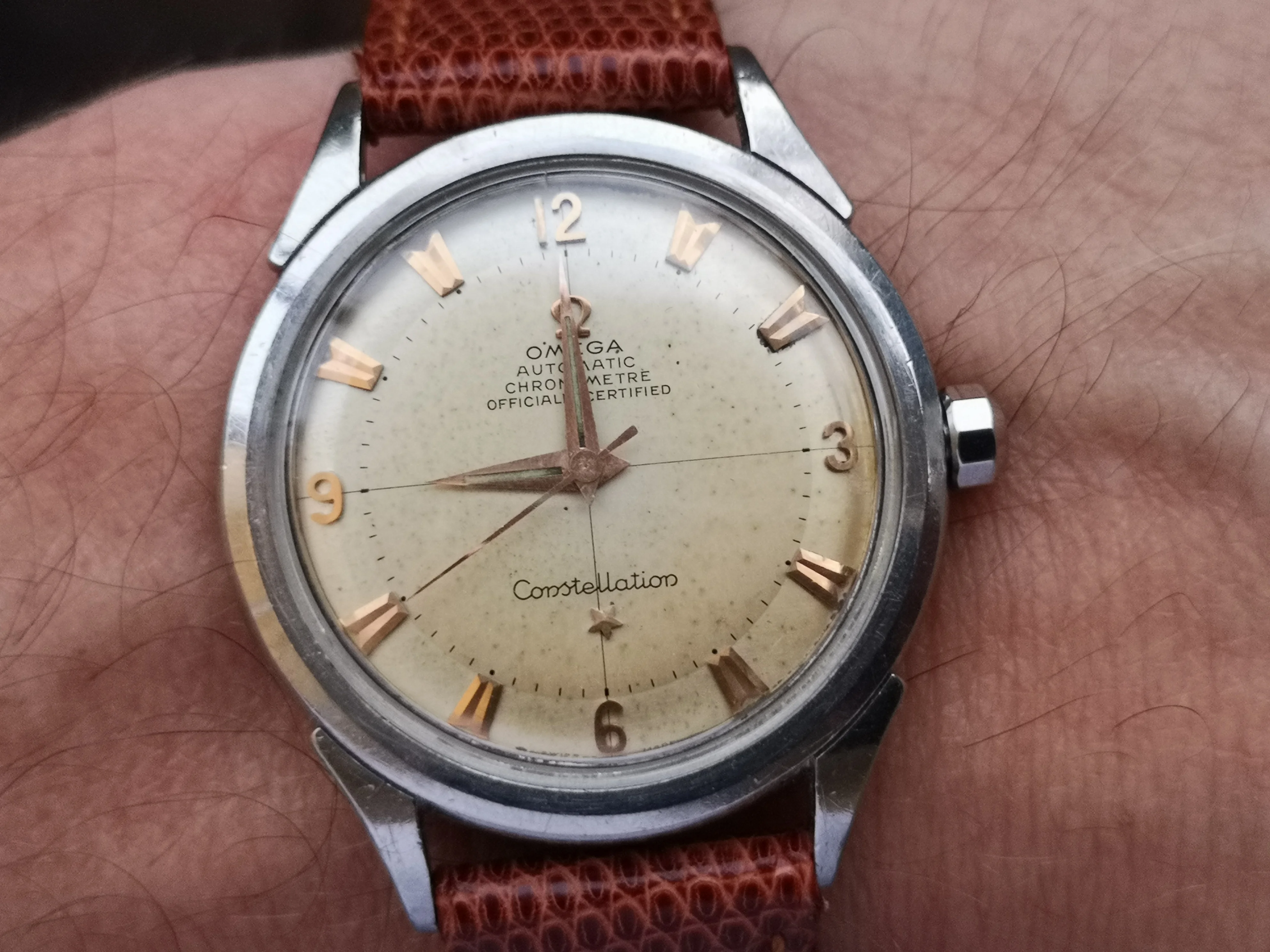

Incoming 2652 with this movement, would like to hear some thoughts from OF...
Some rust pitting (on the mainspring barrel), rusty screw head, regulator fully engaged, did I miss something?
Thank you!

Some wear on back edge of rotor. If you turn watch face up. Does the rotor drop?
Ratchet wheel and rotor screw can be replaced if you want

Hi DON, thank you so much!
Watch came in today, rotor doesn't drop as far as I can hear/feel
I mistook the barrel with the ratchet wheel, thanks for clarifiying that.
Movement is running good and the watch looks beautiful 🥰
