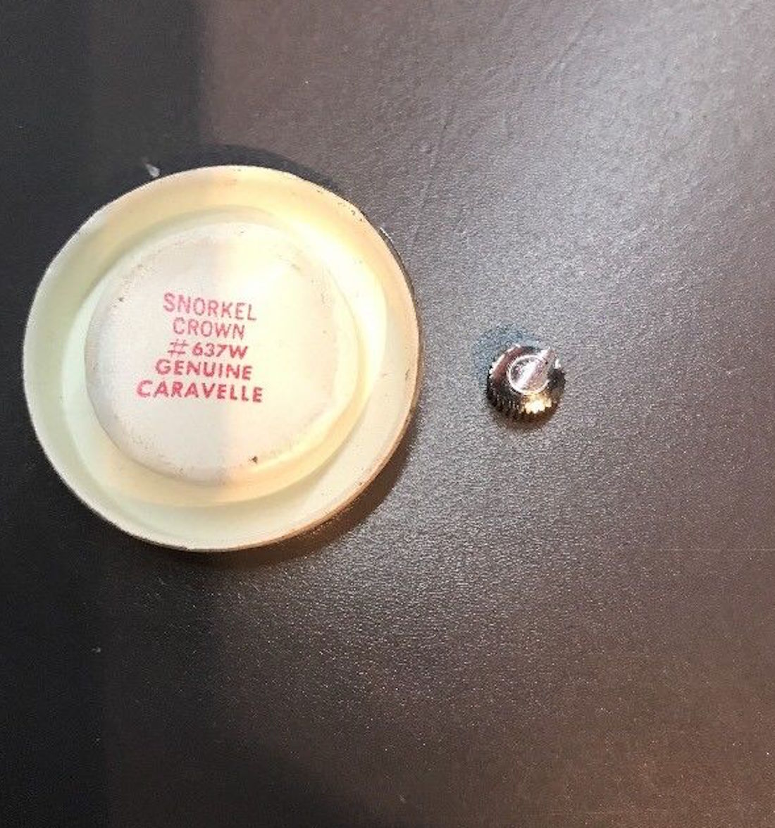

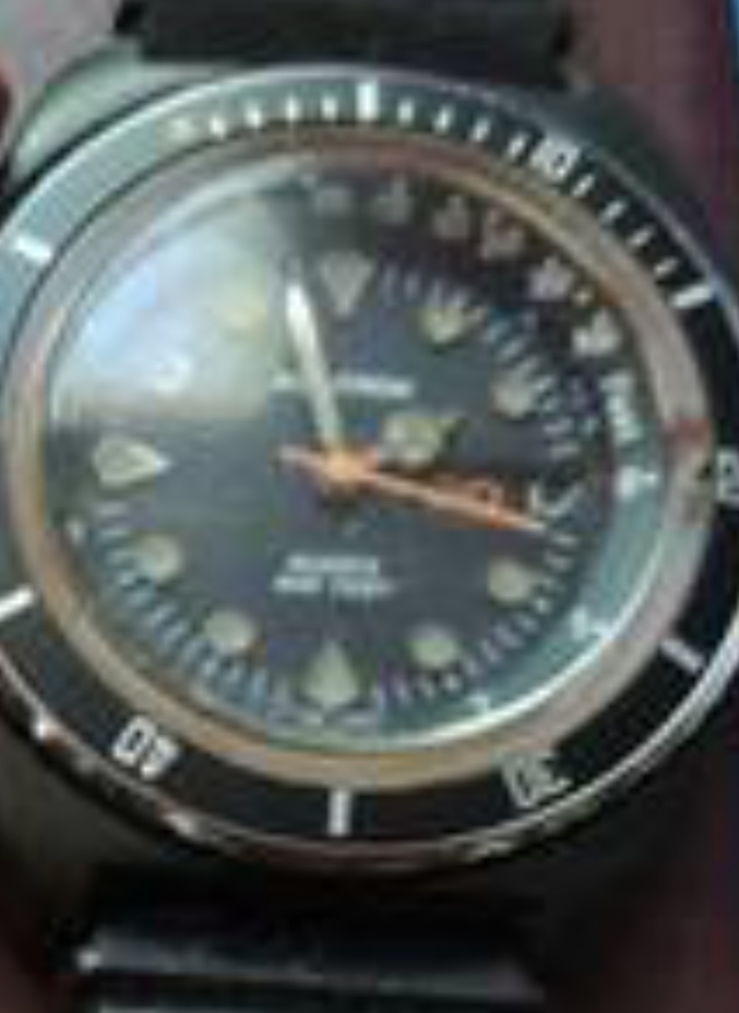

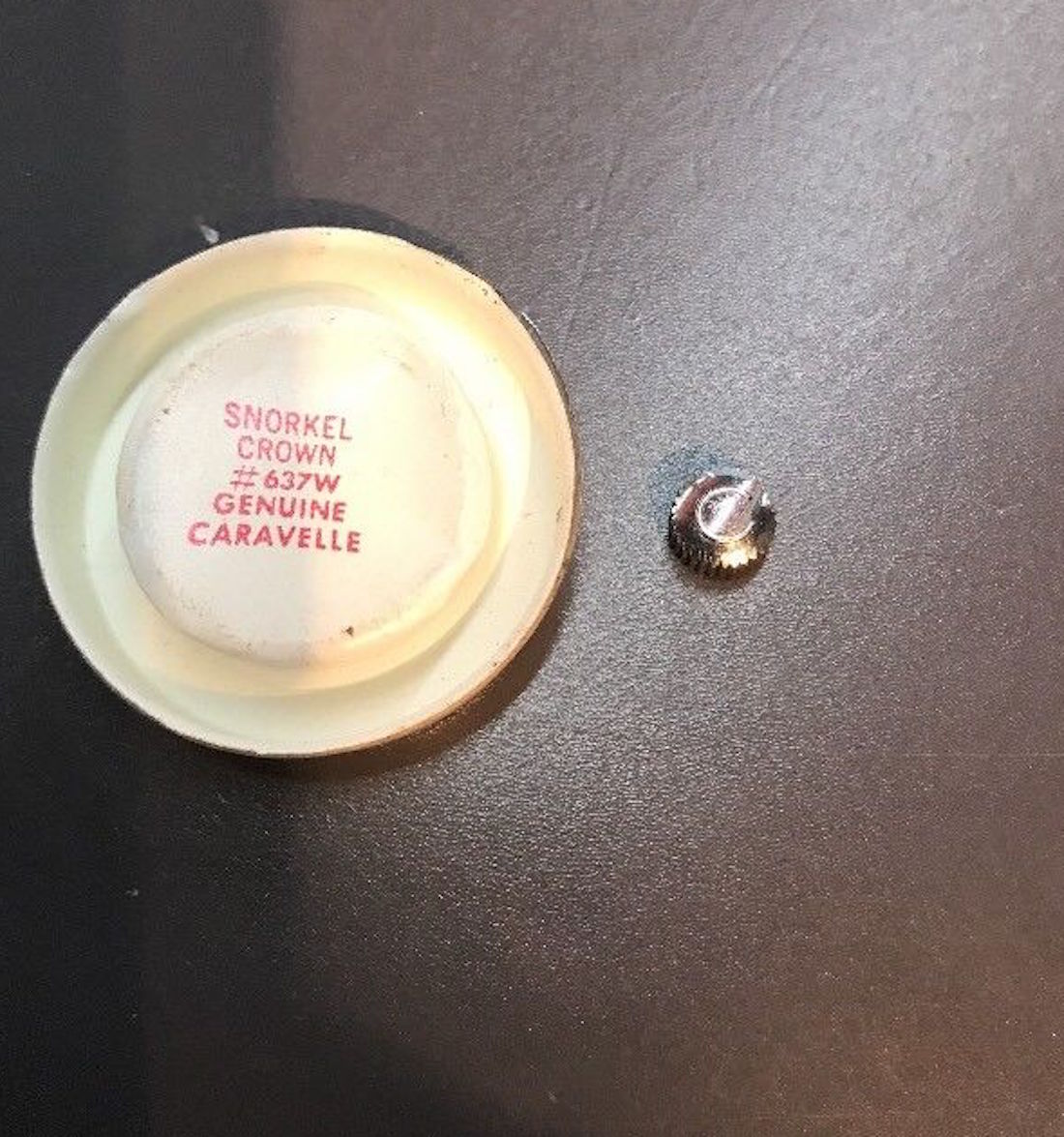

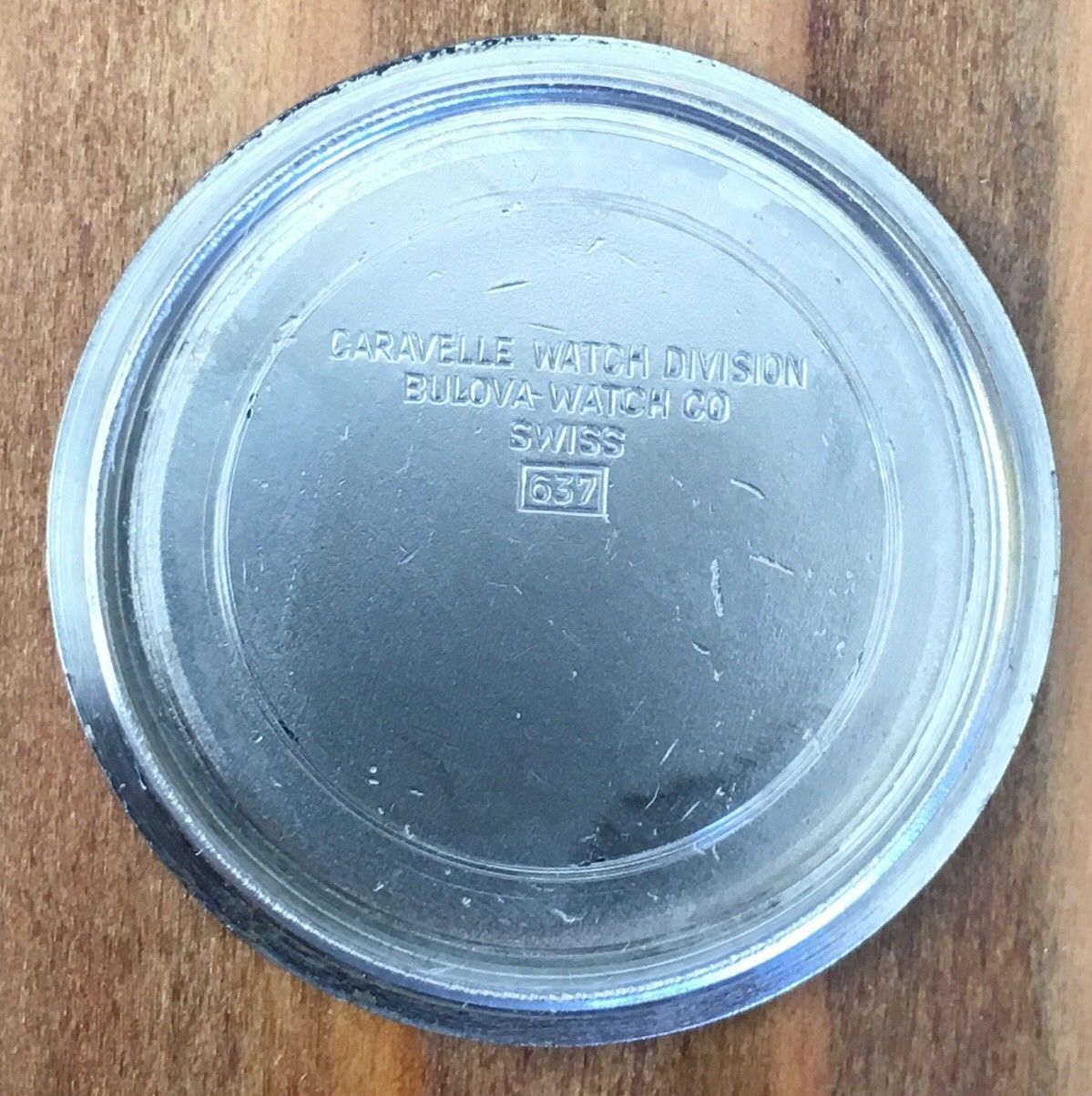

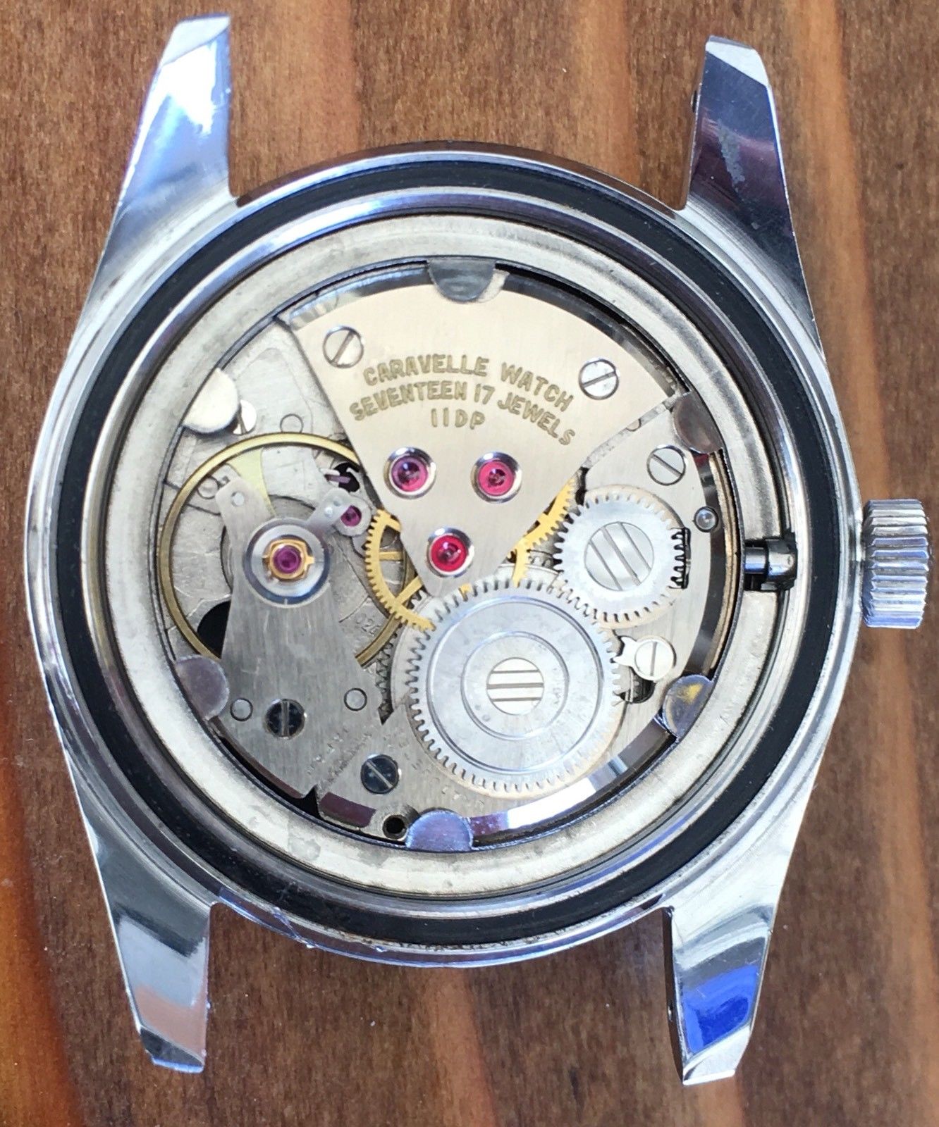

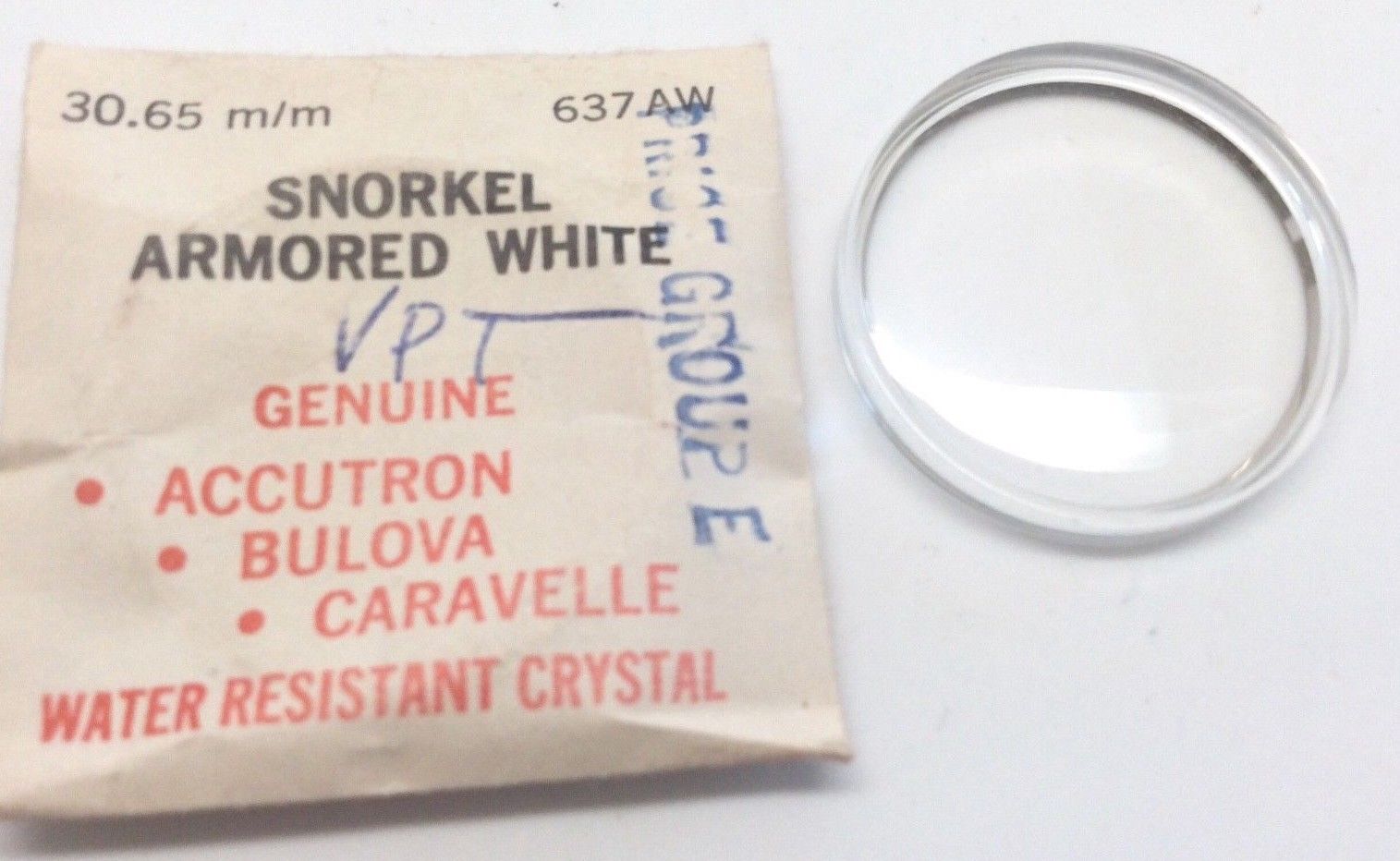

getting sick of how this damaged crown is scratching me. does any one know the proper replacement crown? thanks!
2,327
2,542
Odd but my 80's Bulova crown also has an invisible ding of some sort that I occasionally feel catching almost scratching my thumb print ridges when setting or winding.
It must be a manufacturing error of some sort. I think any blow hard enough to upset the metal would have left a visible mark.
3,570
17,834

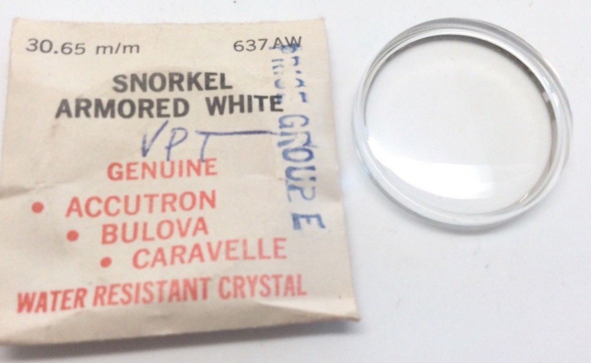

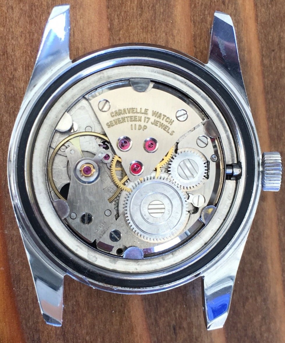

DOUBLE CHECK THE REF# inside ur case back .... if it is marked ..... " 637 " ..... here are the parts and ref# u are looking for .... i attached photos of ....... CROWN and CRYSTAL ....
Movement: - Bulova 11DP (Citizen 0241)
case: - ref# 637
crown: - ref# 637W
crystal: - ref# 637AW
(images borrowed from cyber space)
https://www.facebook.com/photo.php?fbid=10155789515094537&set=pcb.387609121769350&type=3&ifg=1
https://www.facebook.com/groups/208317149698549/
2,597
5,665

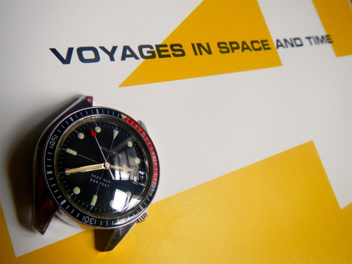

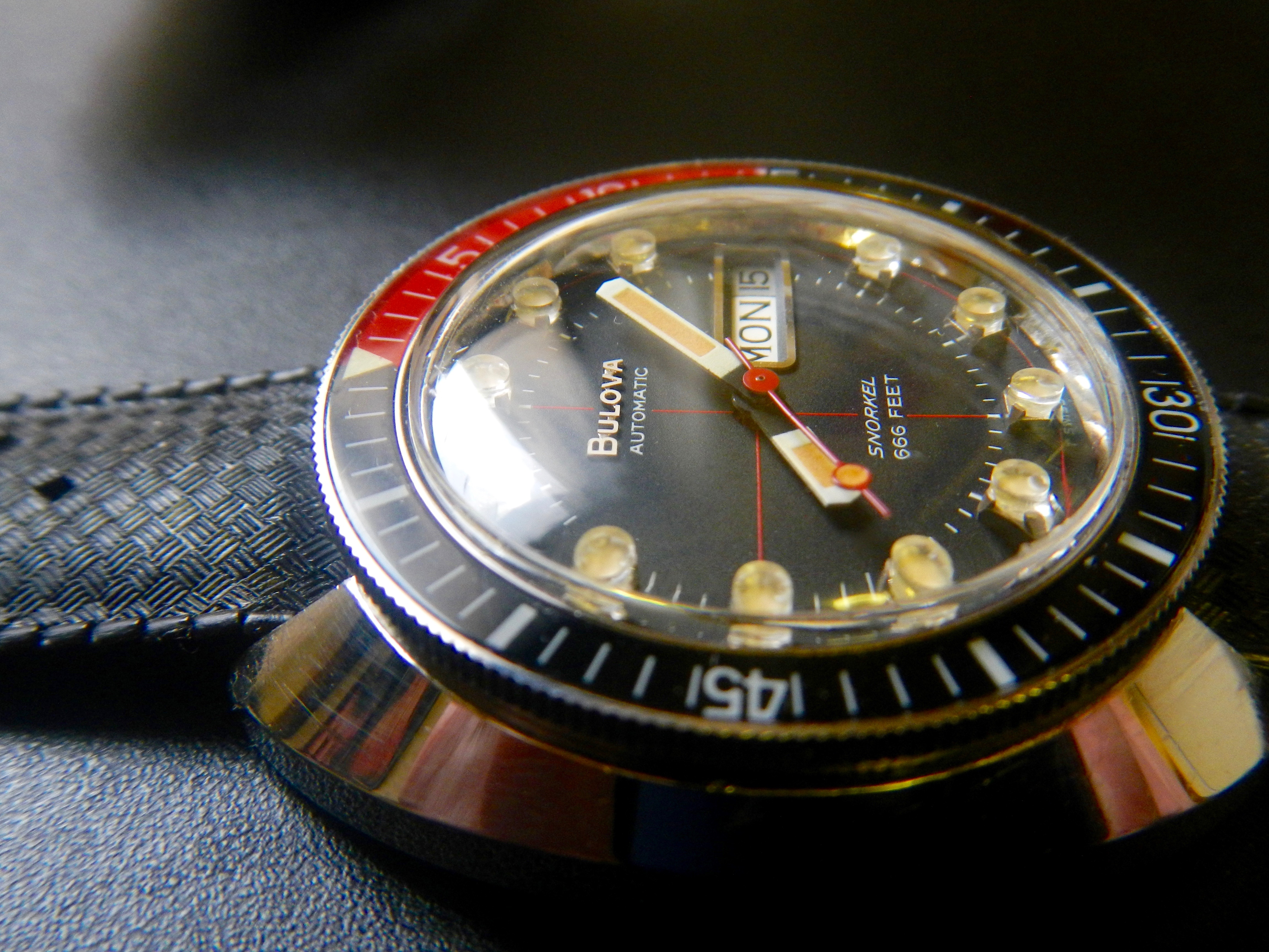

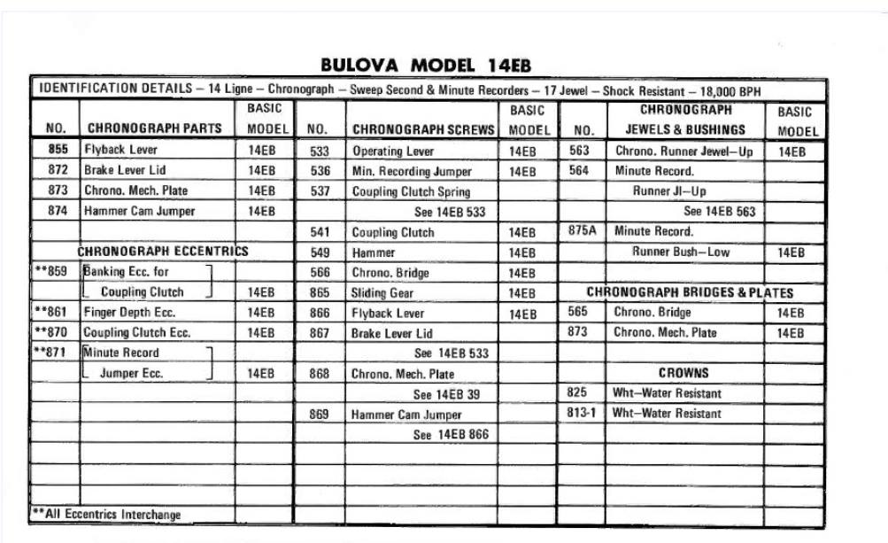

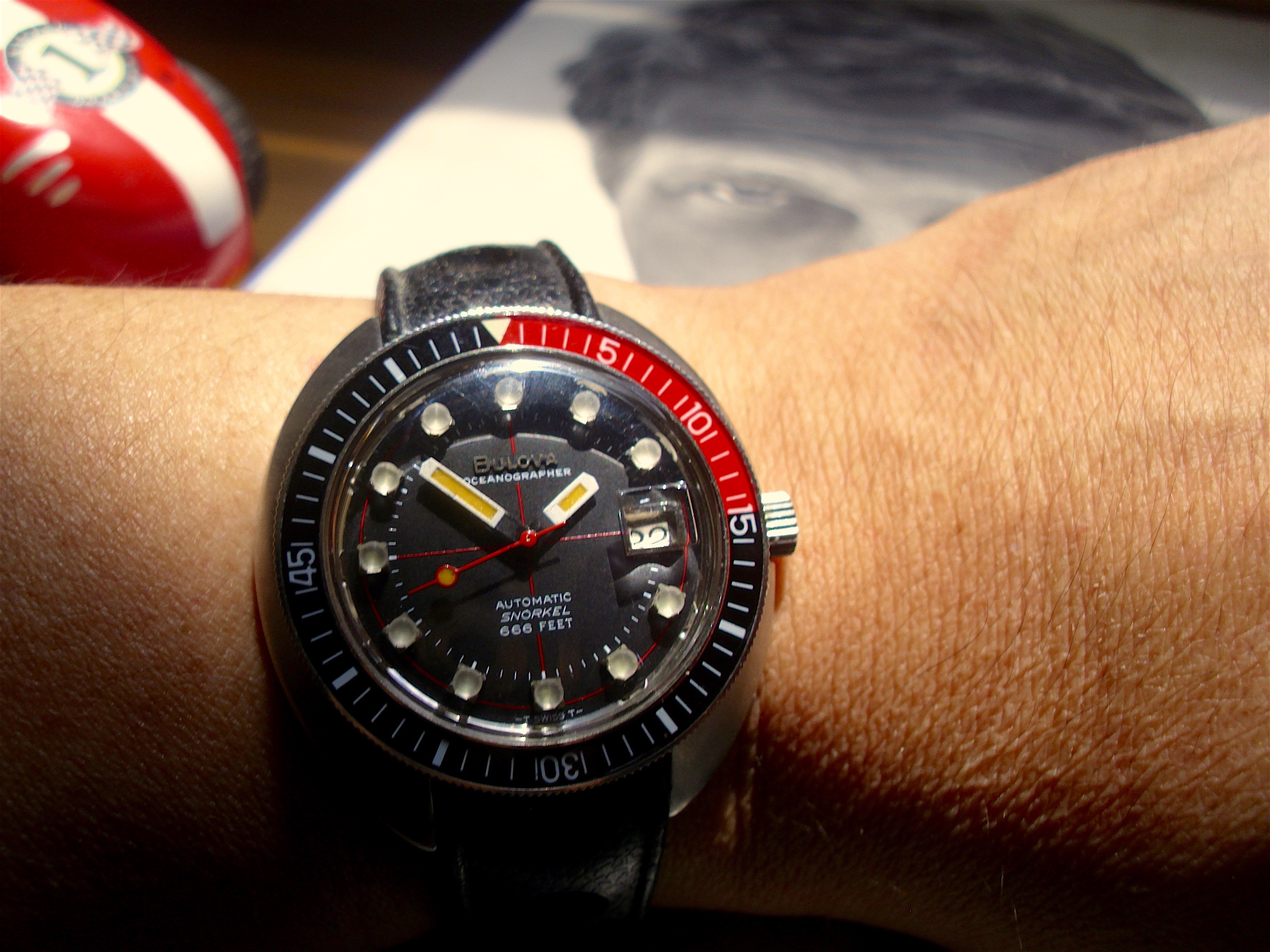

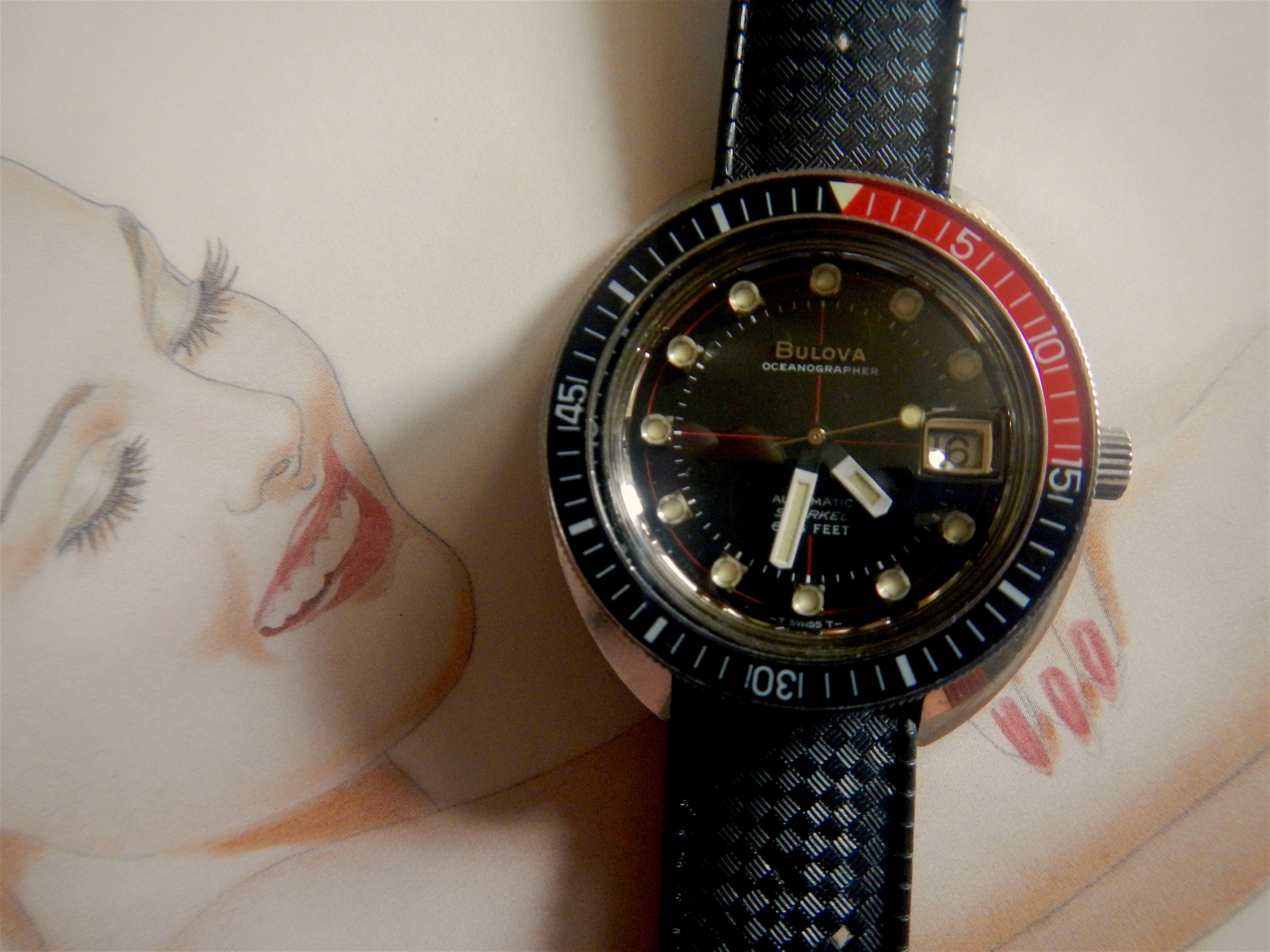

Bulova Deep Sea Chronograph 666 " B "
Reference Guide / Parts ...
Note: ..... Crystal, Bezel, and Bezel Spring ....
this watch ... MUST ... use Bulova crystal REF# 825AW or correct substitute
for the bezel to be mounted and secured to the watch case a generic diver crystal will not do
The crystal is an armée type and requires the right press and die. Also, the bezel can be damaged if you remove it the wrong way. These have thin wires that either create tension to prevent free-turning, or hold the bezel in place. The wire is easily distorted and not easily fixed.

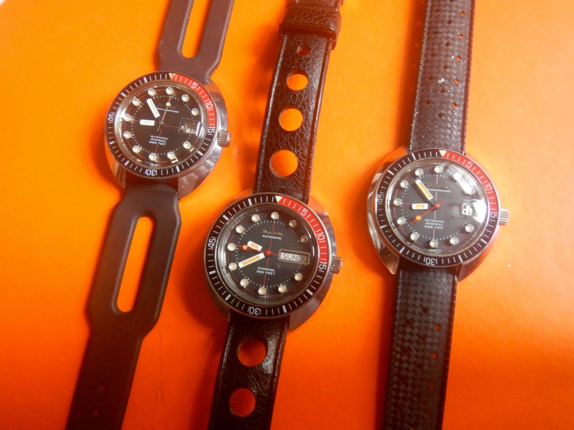

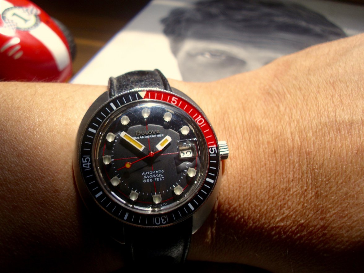

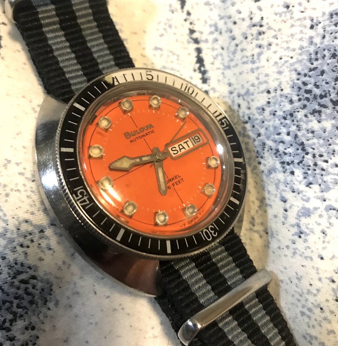

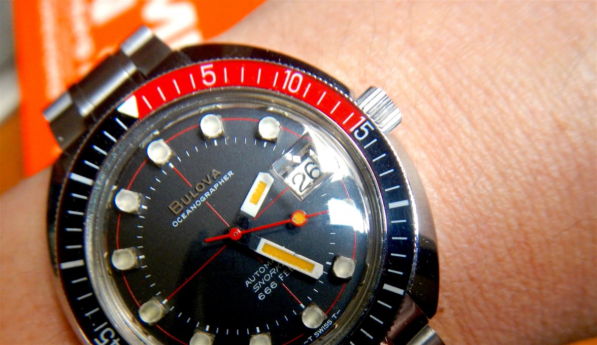

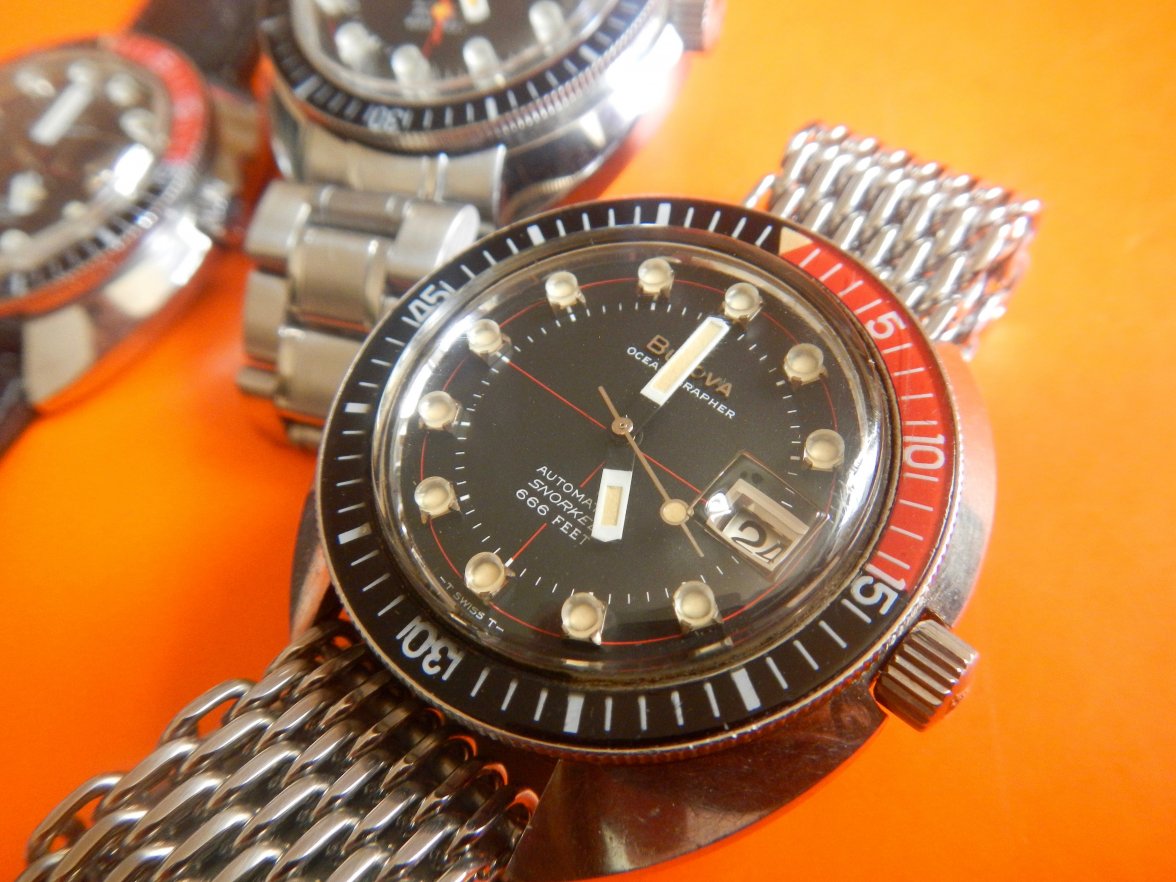

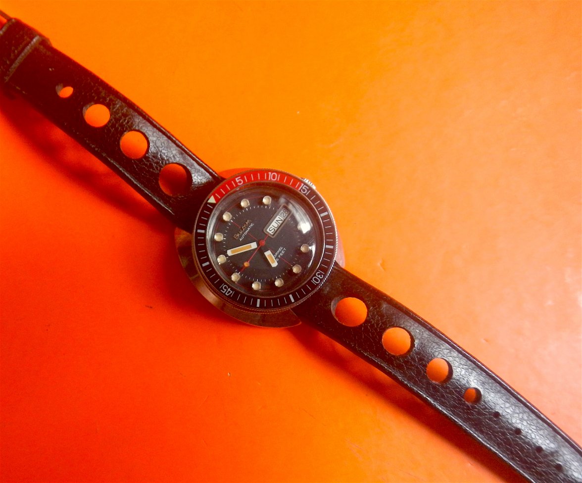

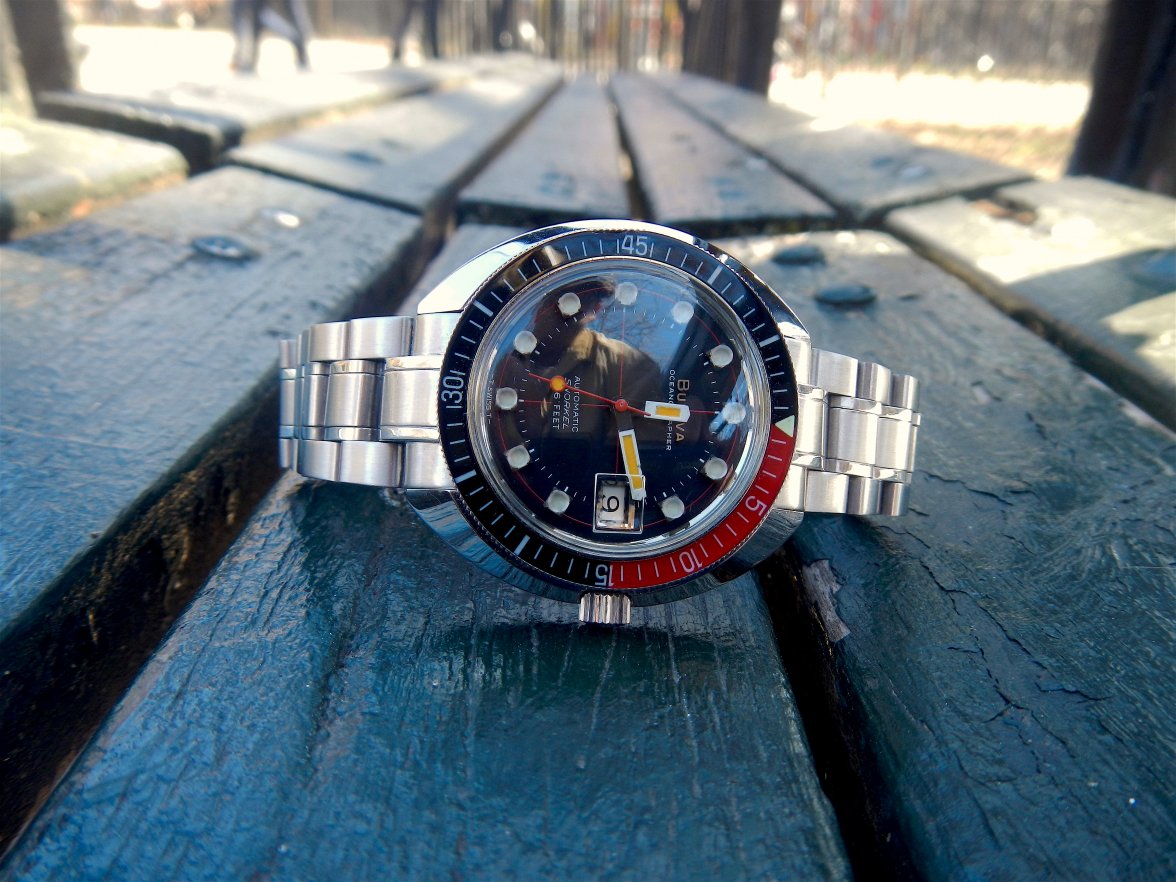

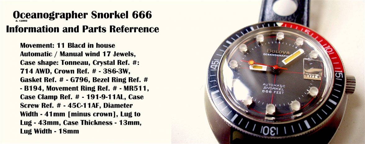

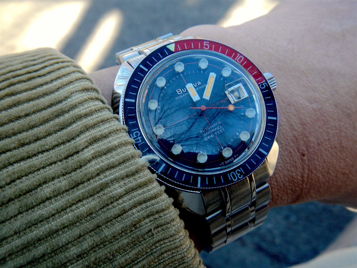

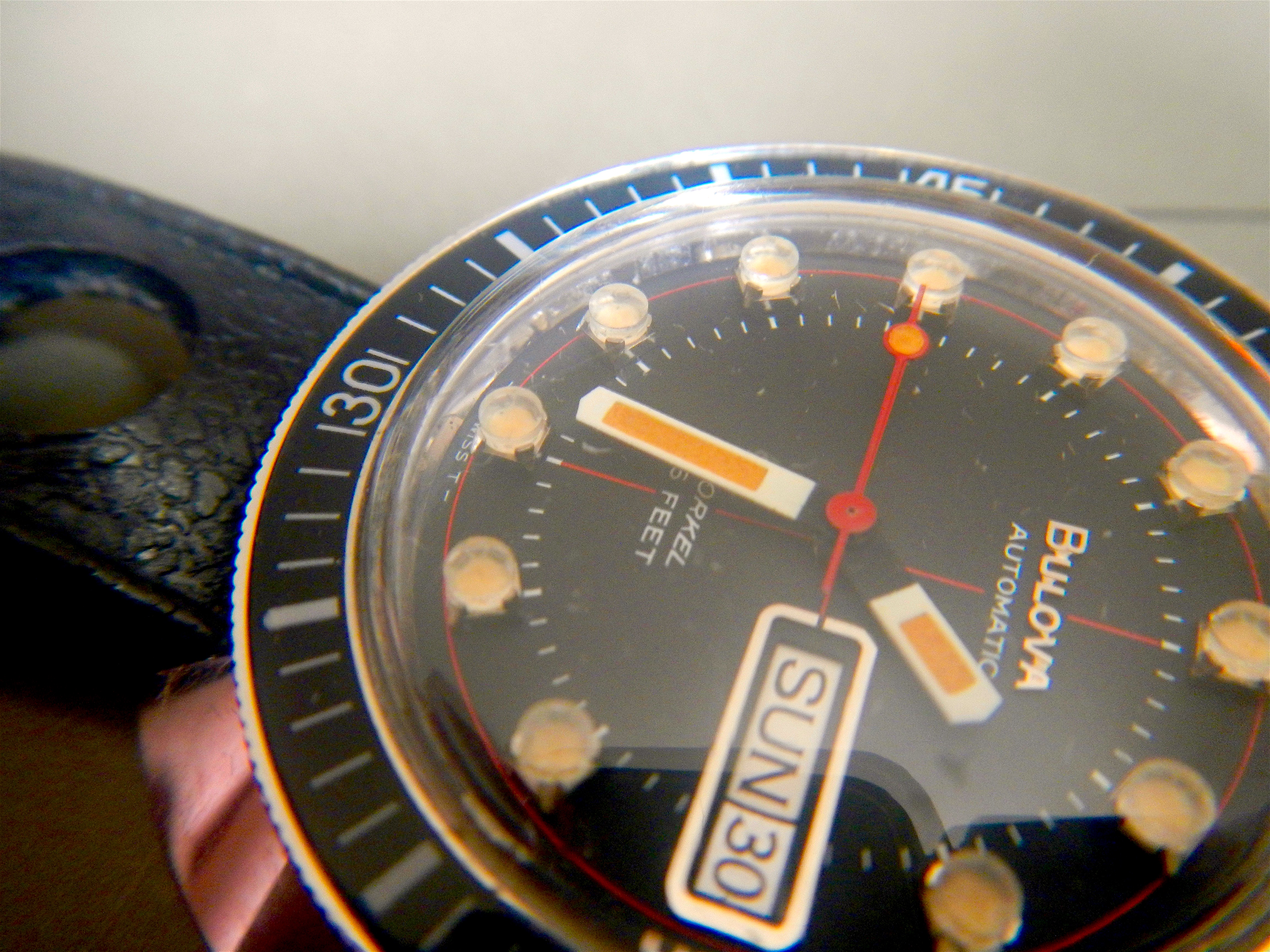

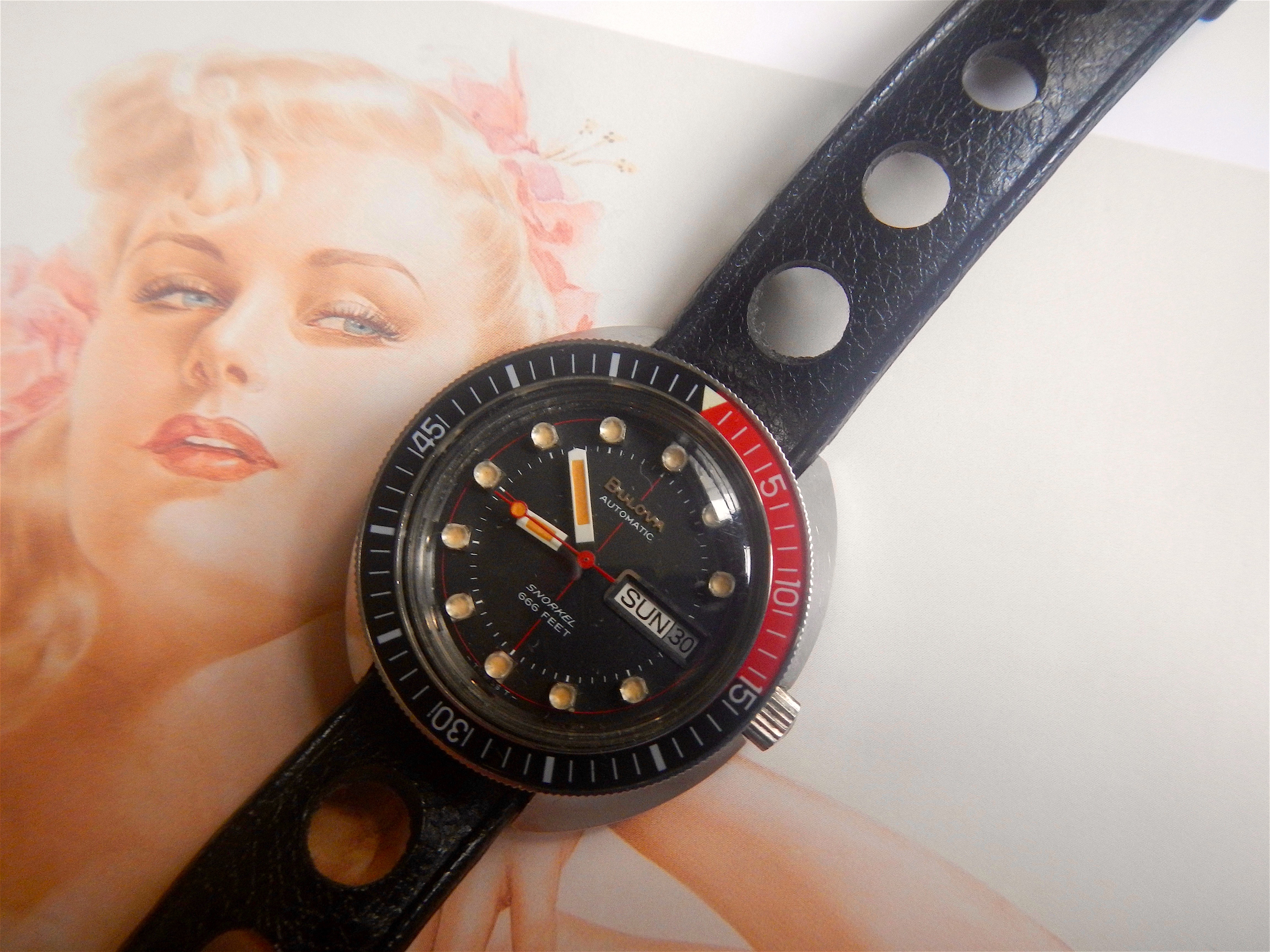

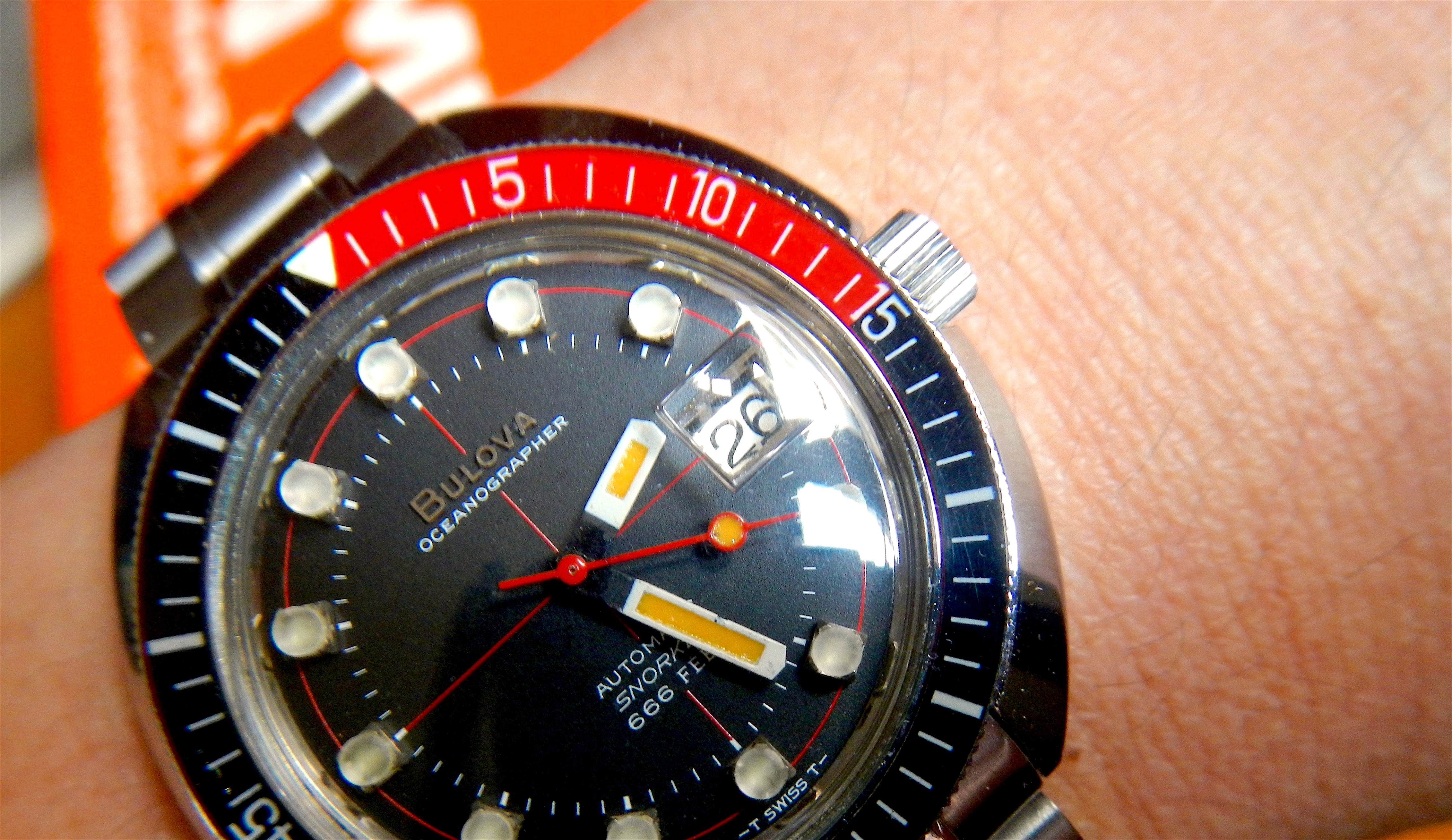

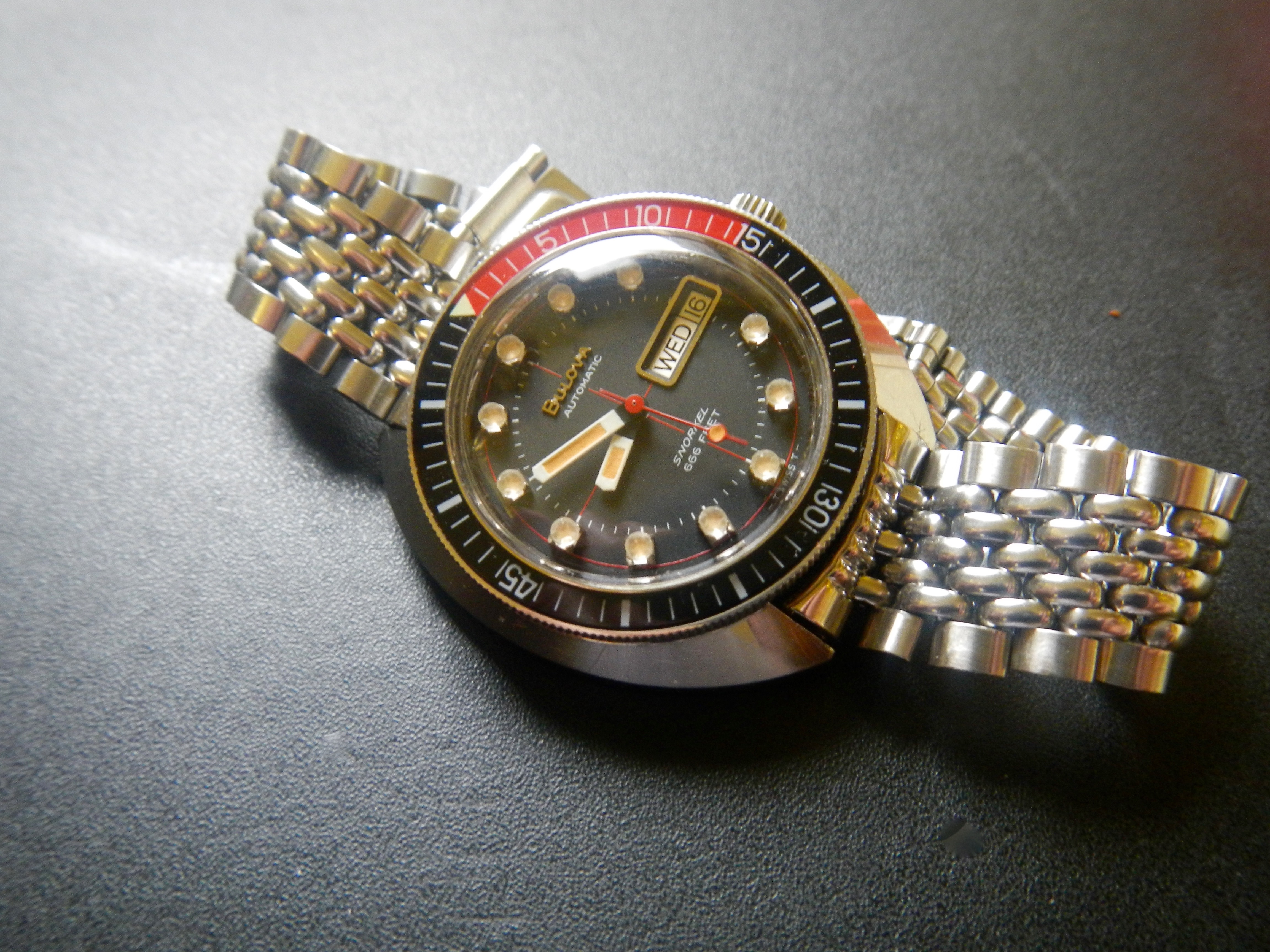

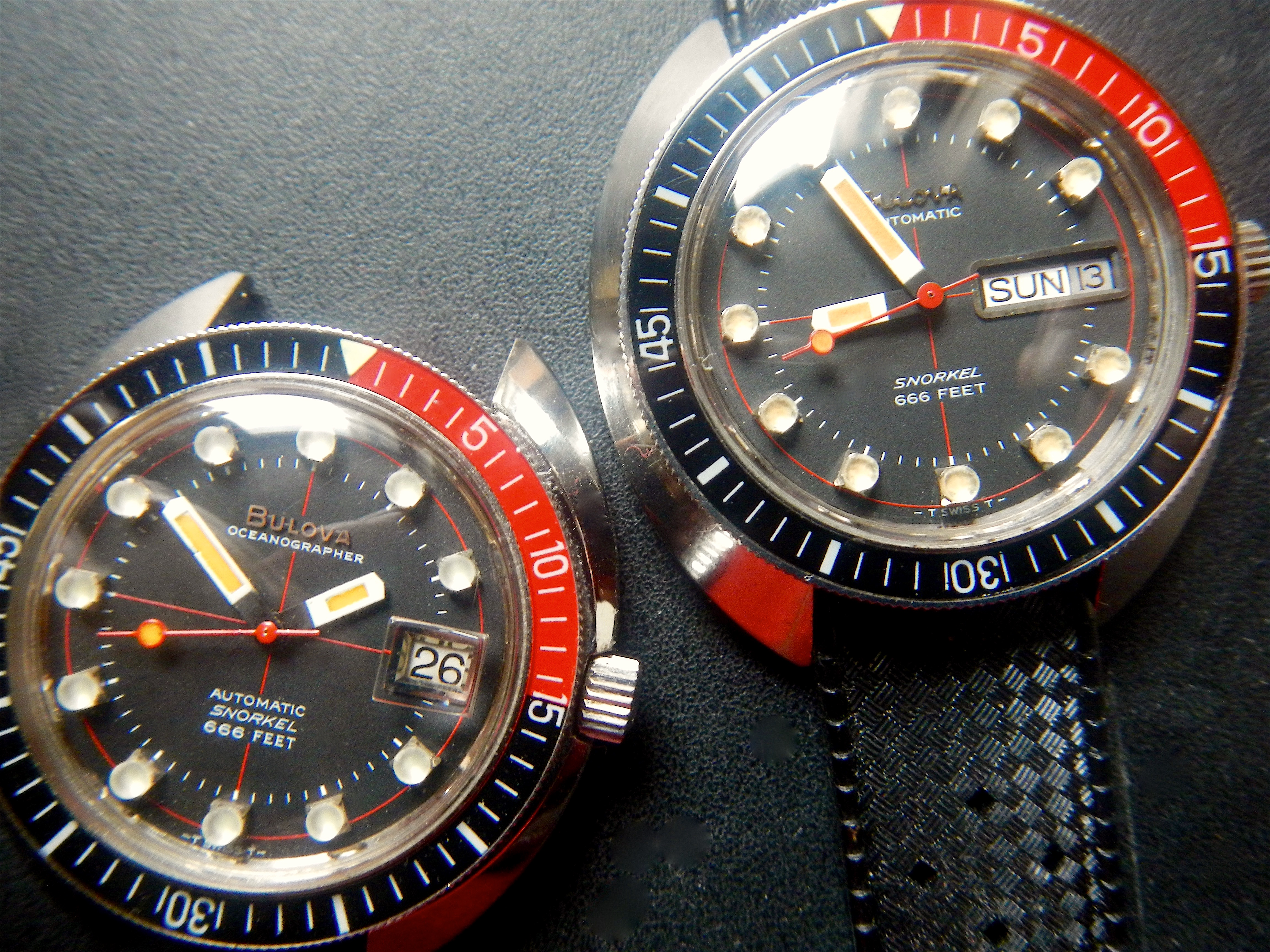

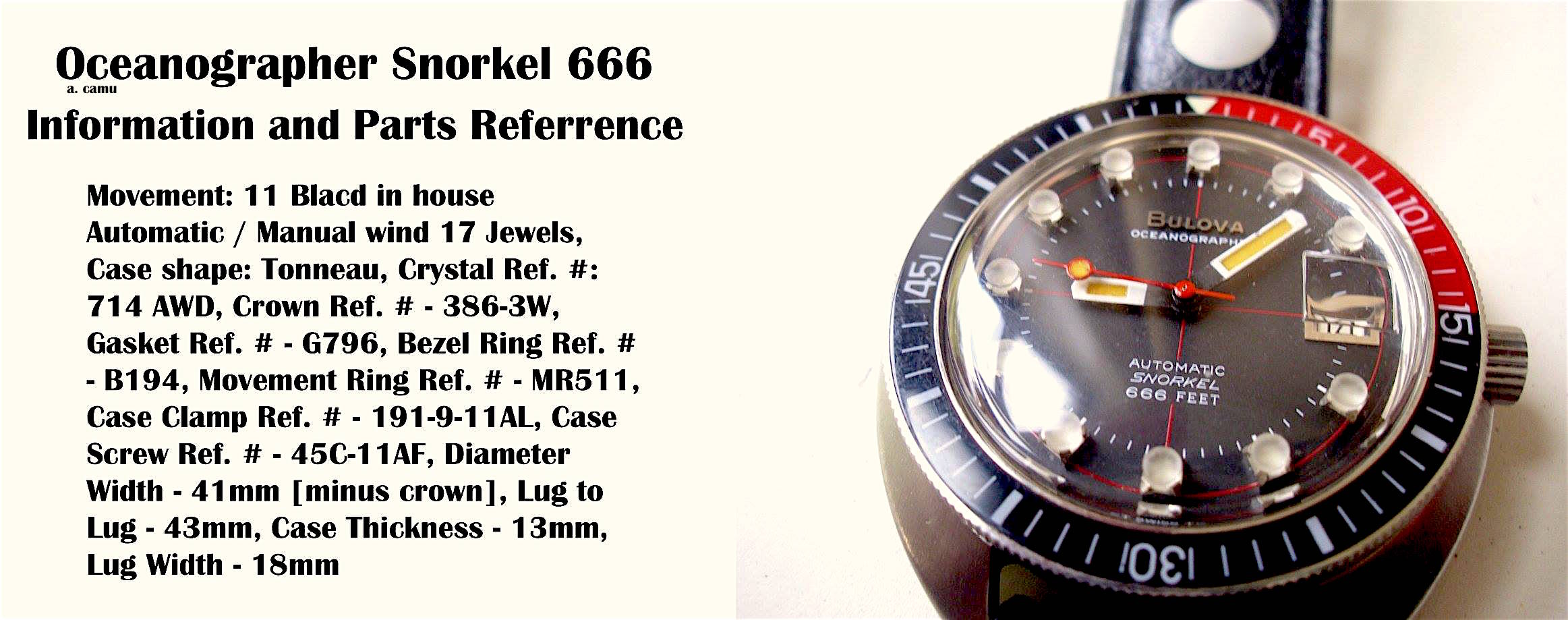

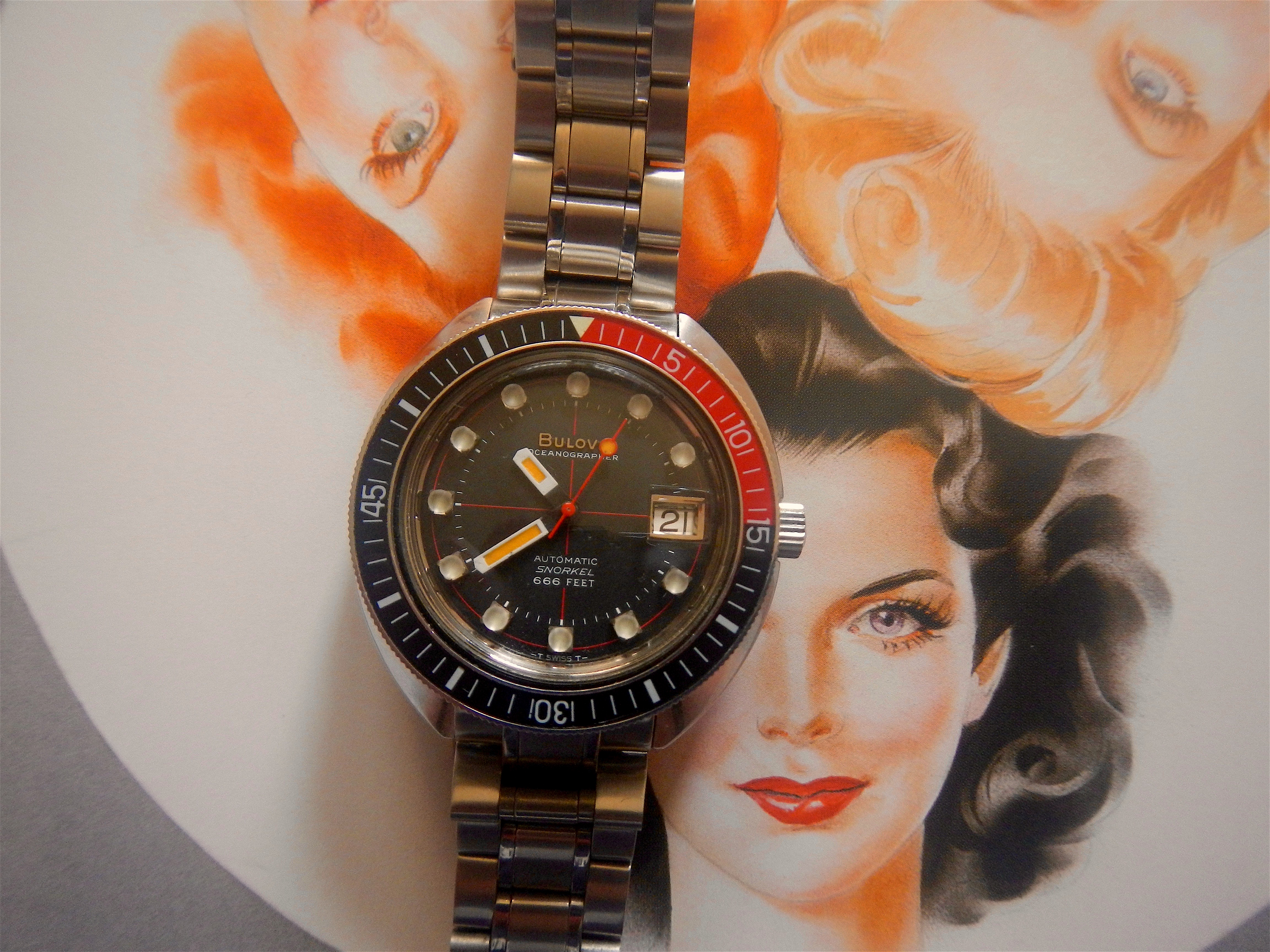

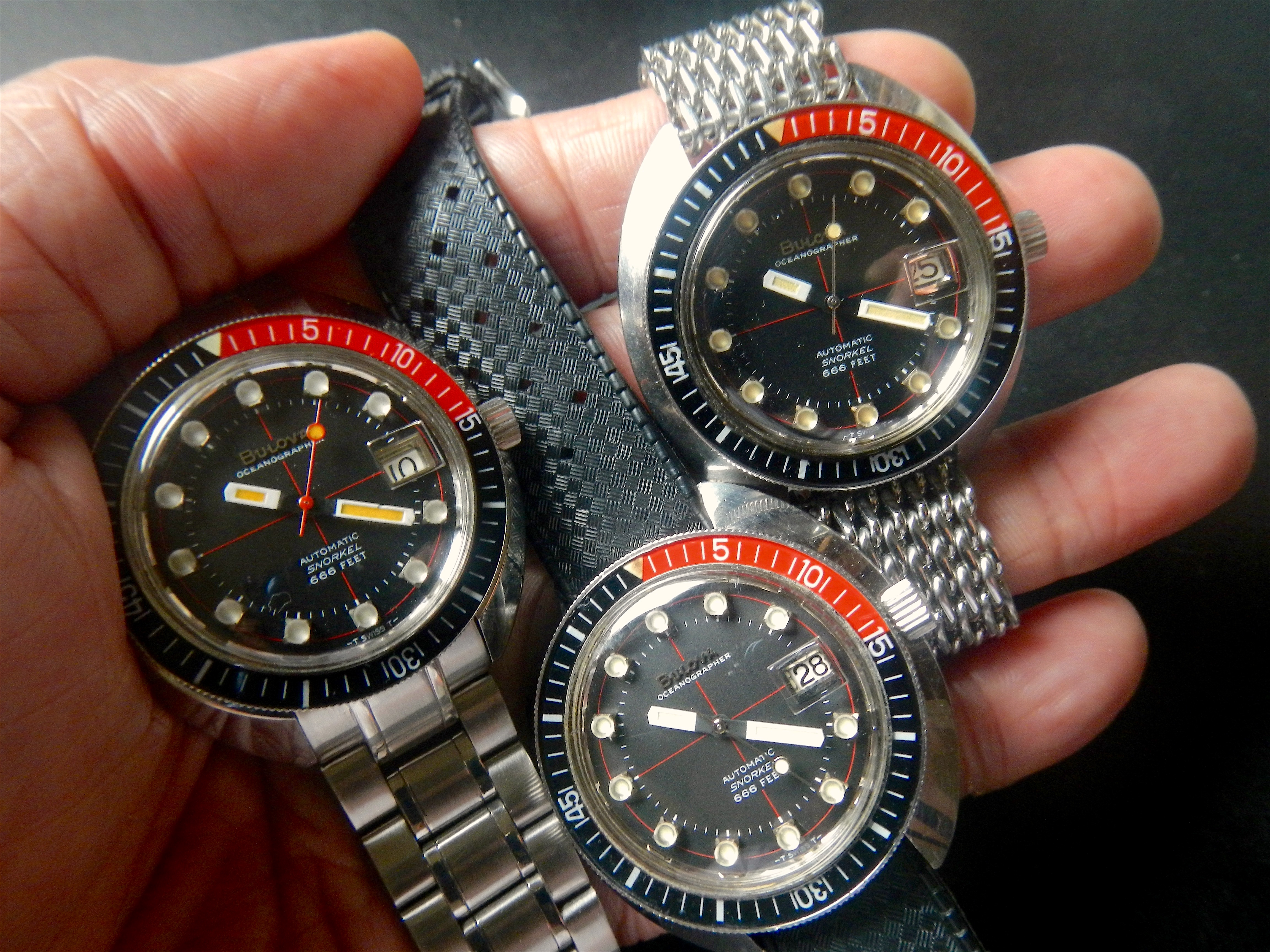

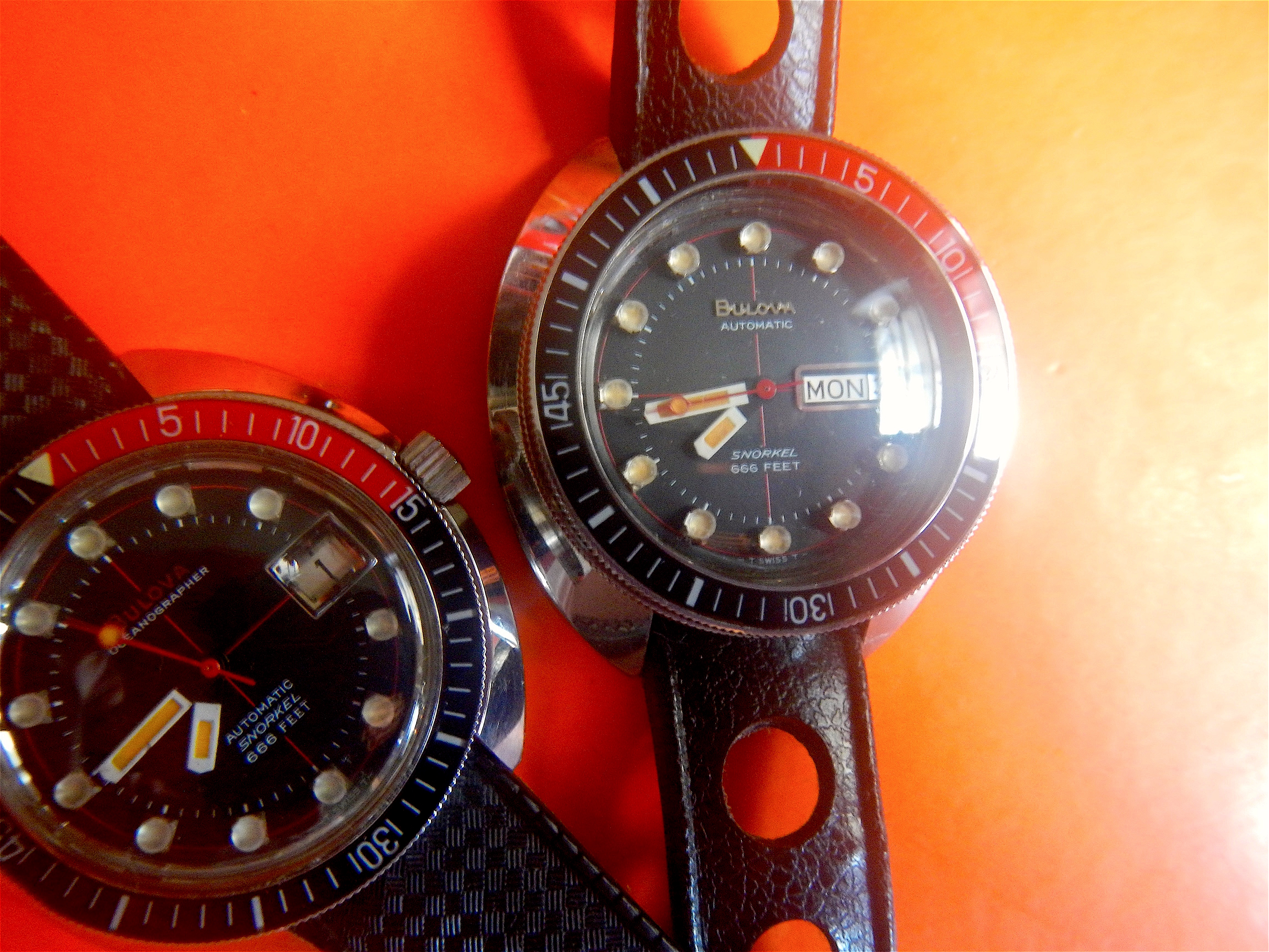

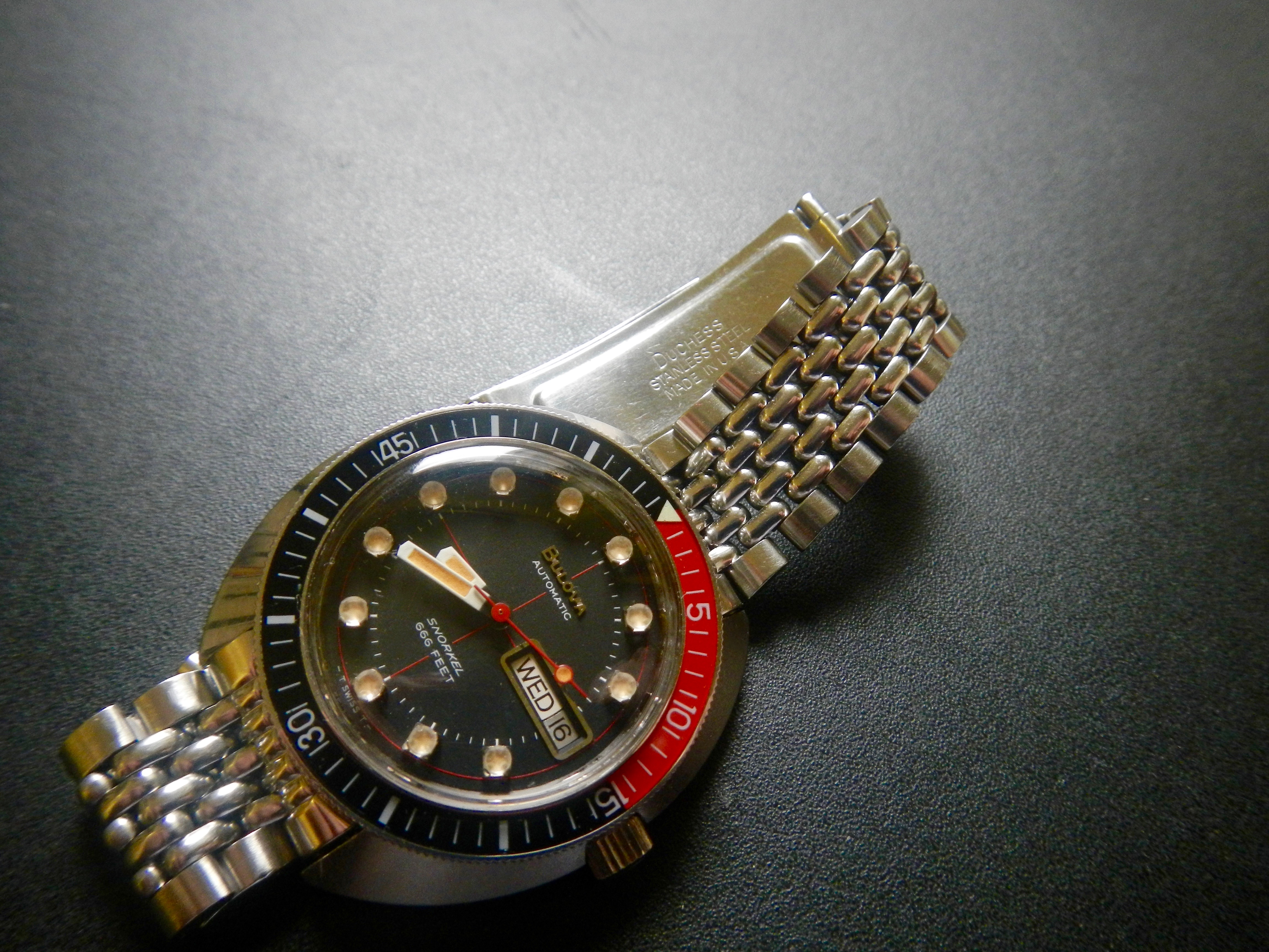

1973
Bulova Oceanographer Snorkel 666
Movement: 11AOACB Day and Date AUTOMATIC
Case Ref# - 7095-1
friction [no click] mounted, Bi-directional " Coke " Bezel
note:
Case Ref# 7095-1 looks similar to case ref# 714 [date only model with 60 click uni-directional coke bezel] but is ... NOT ... the same, and will not house properly 11BLACD movement
