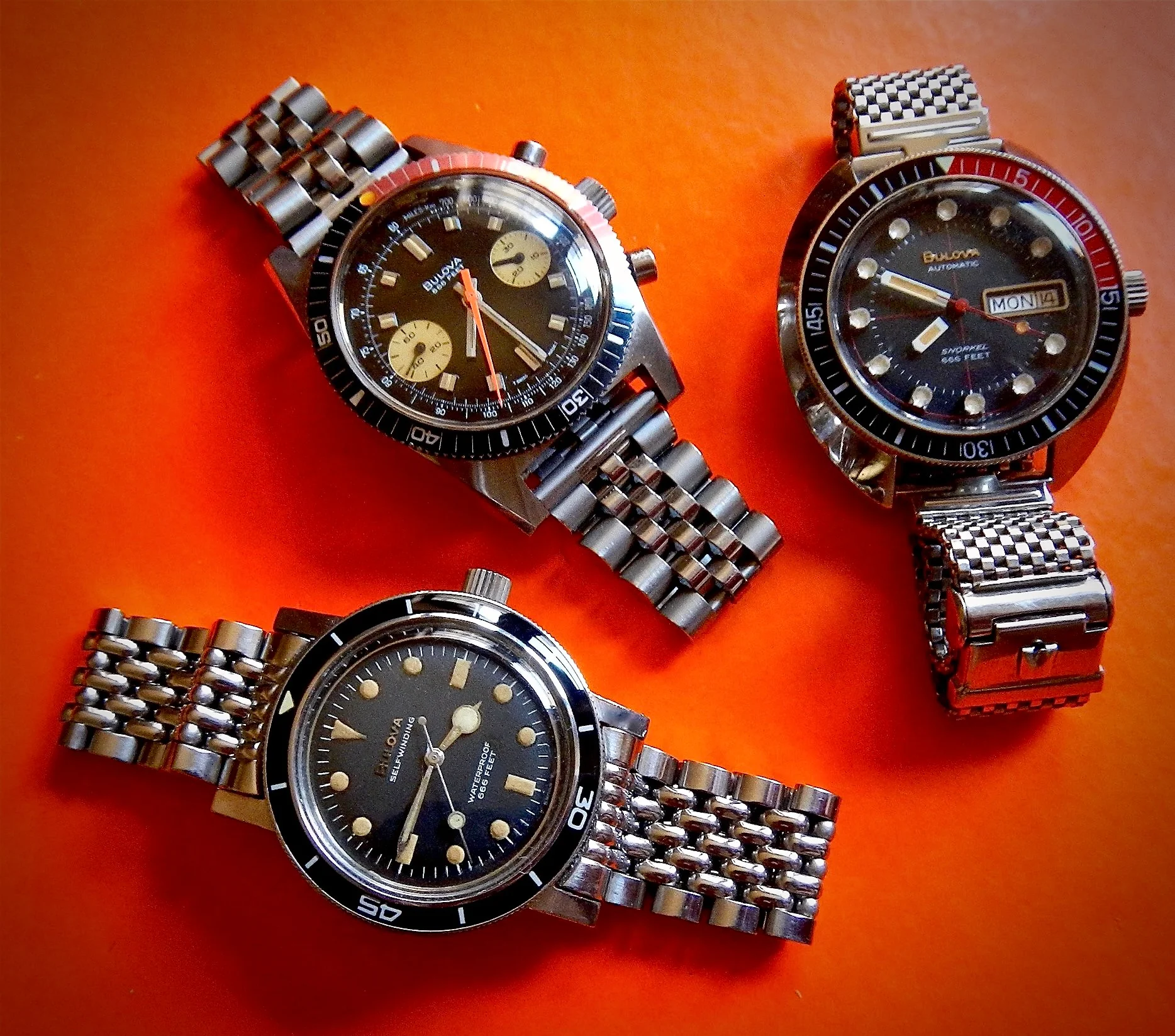

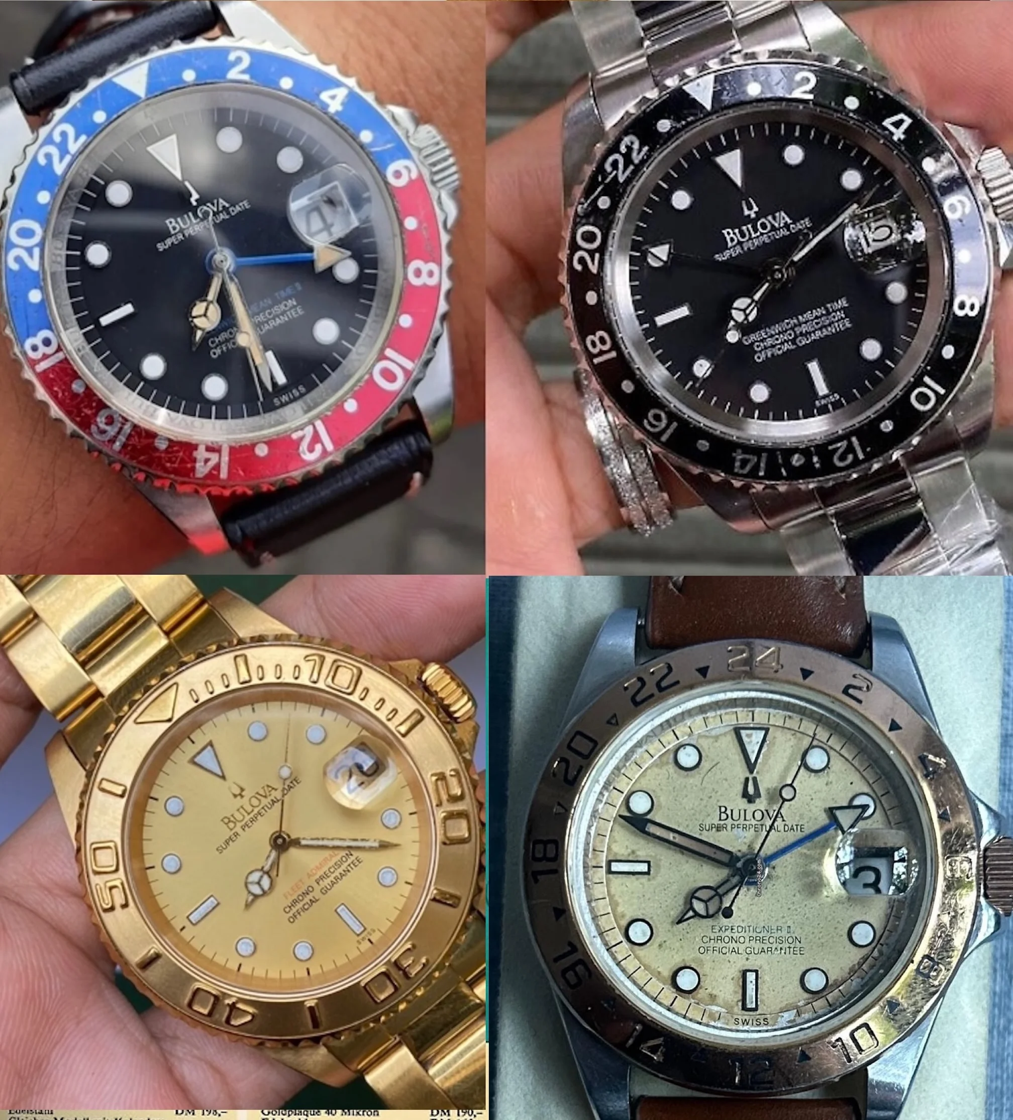

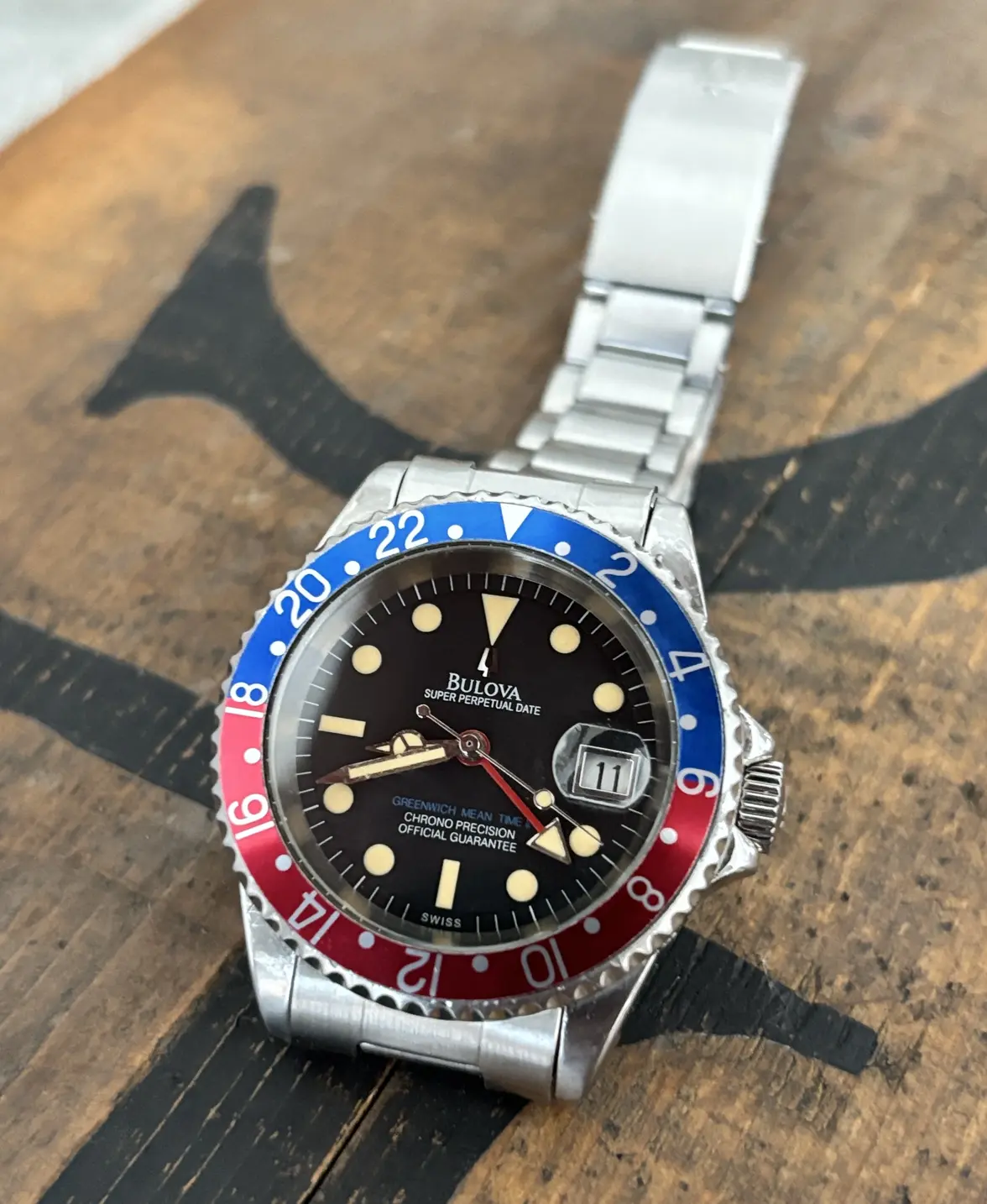

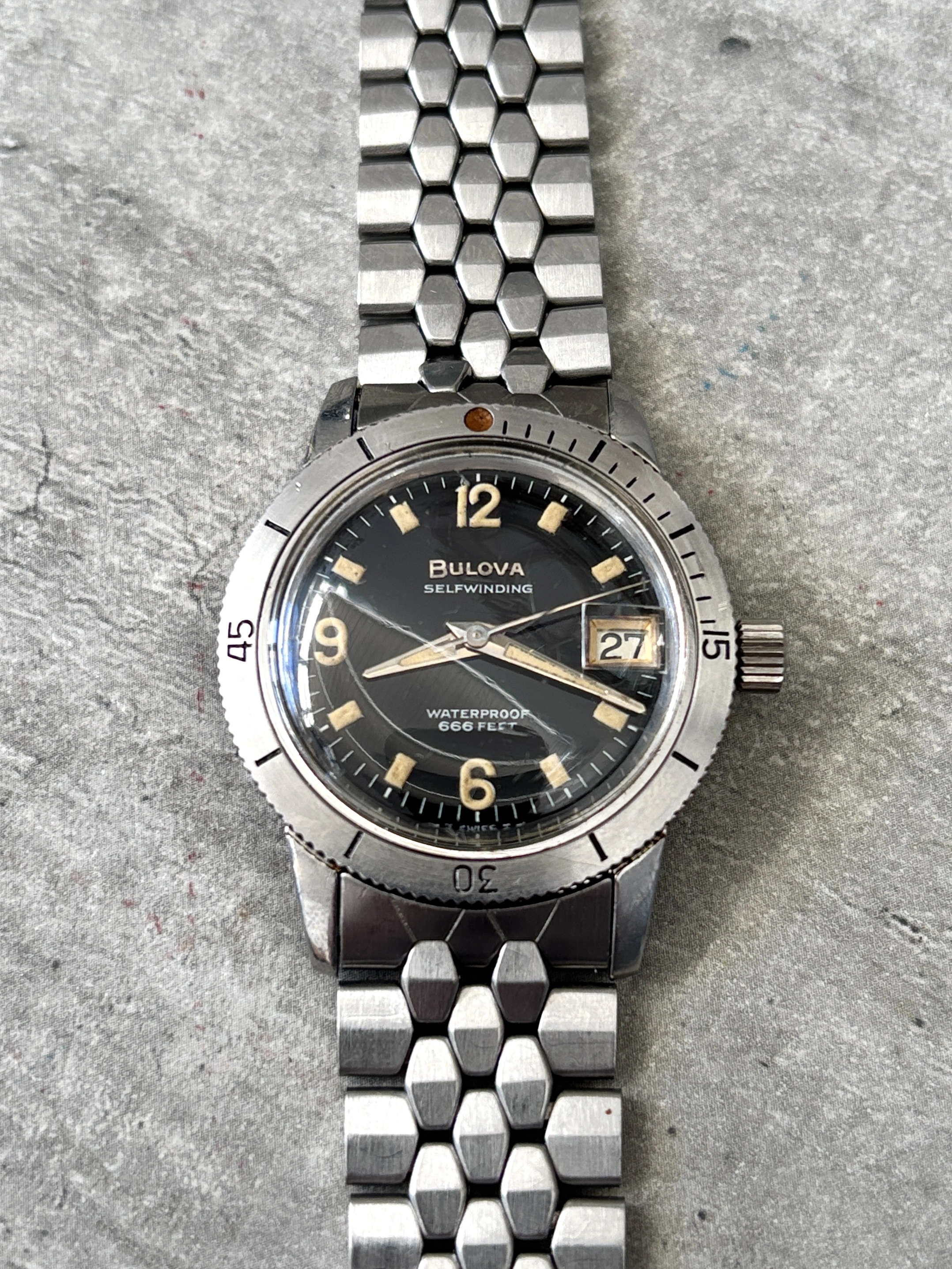

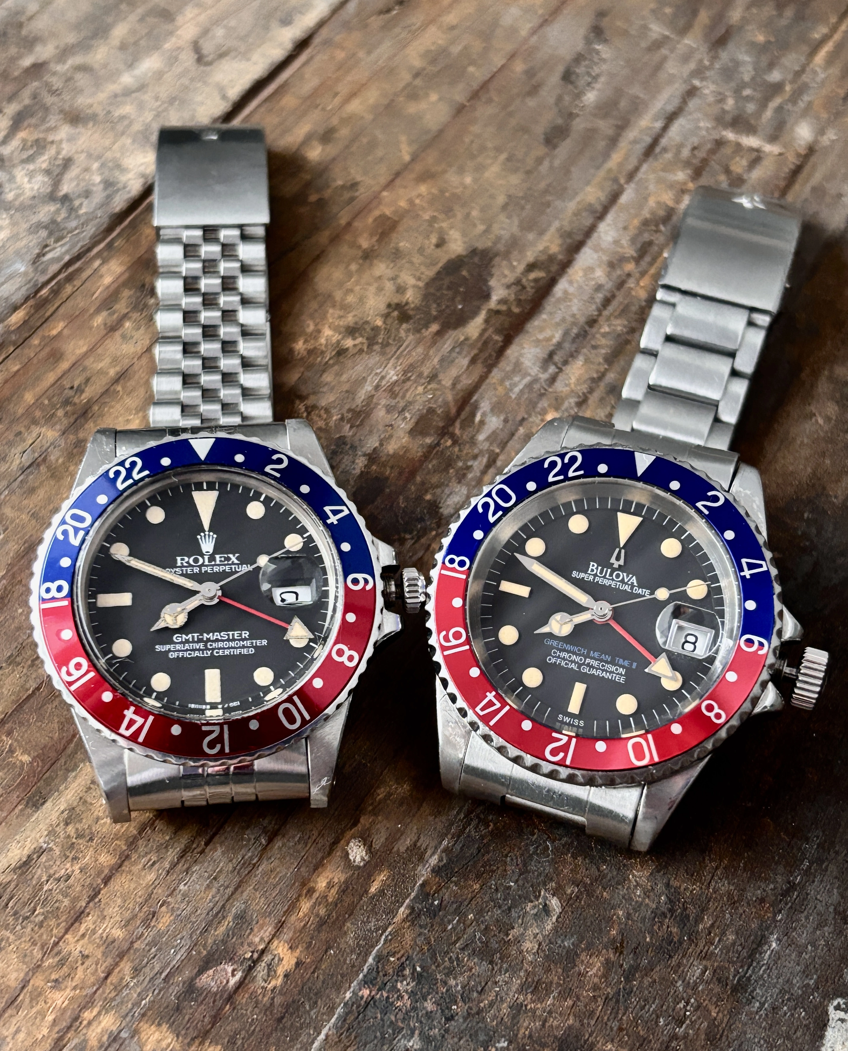

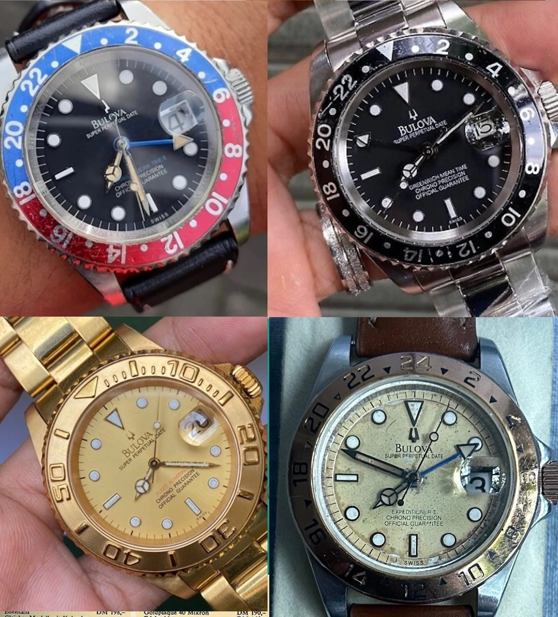

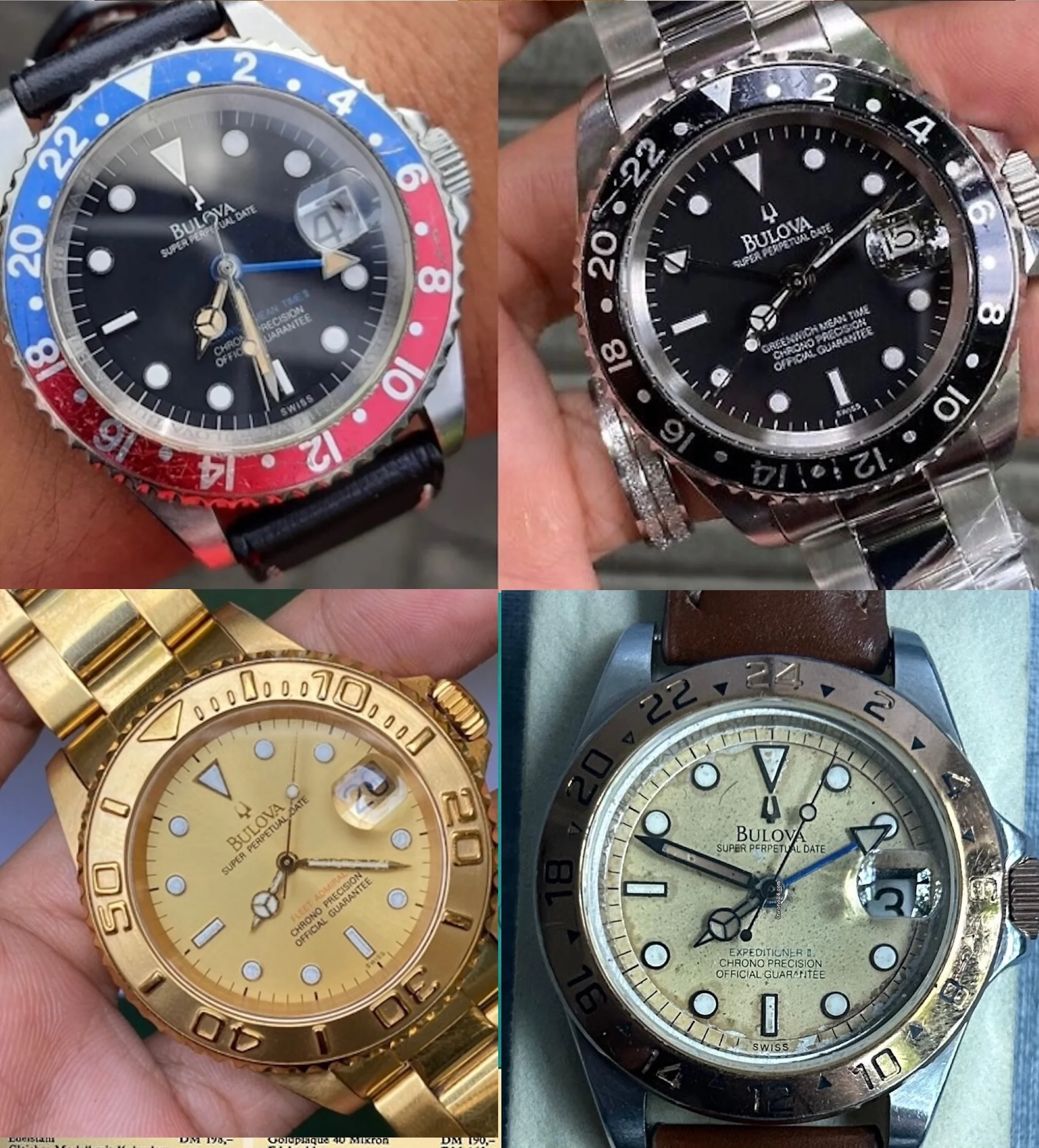

VINTAGE BULOVA SUPER PERPETUAL DATE GMT models ...
Overseas model commonly found and sold by sellers in Vietnam, Malaysia, Thailand, Indonesia, there are several versions that mimic the ROLEX GMT models. Some examples ...
6,368
21,725
vintage
This convinces me that I am missing out on a great collection. Way more than I expected. Beautiful designs and condition.

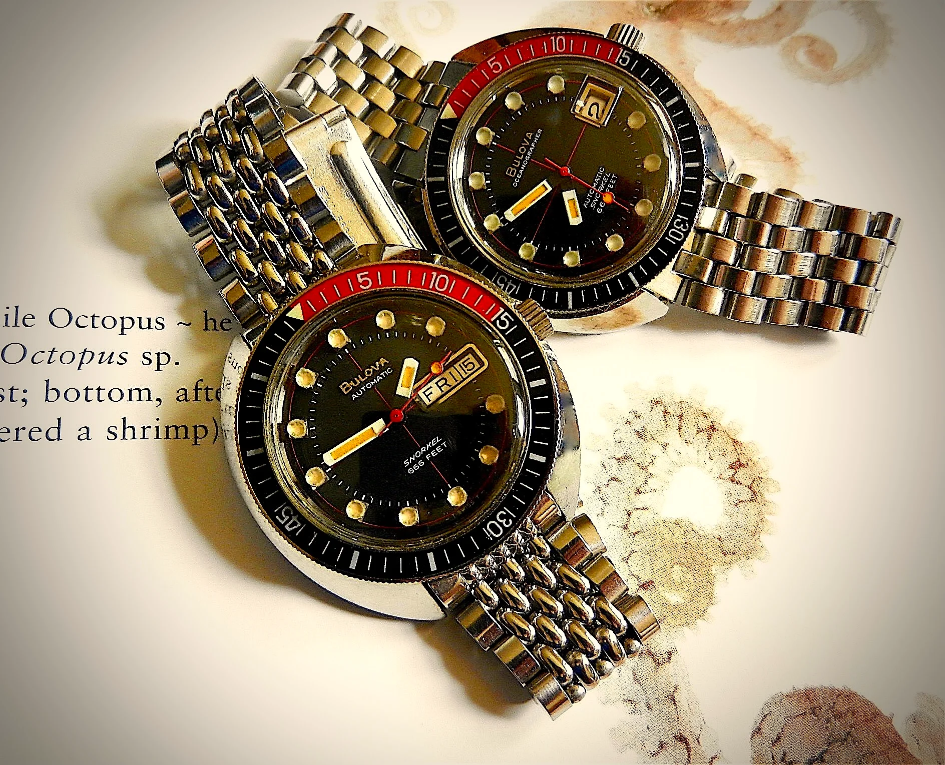

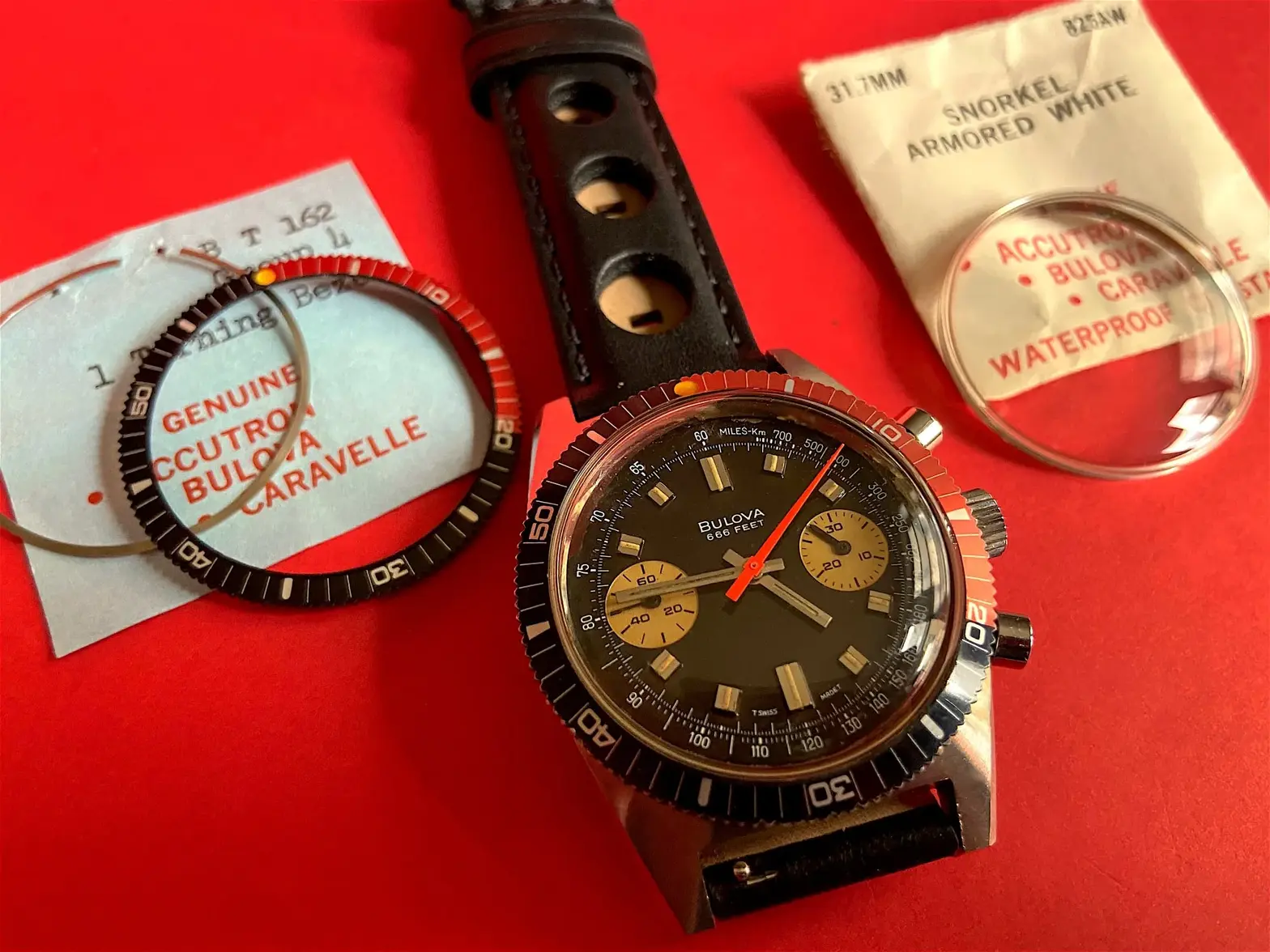

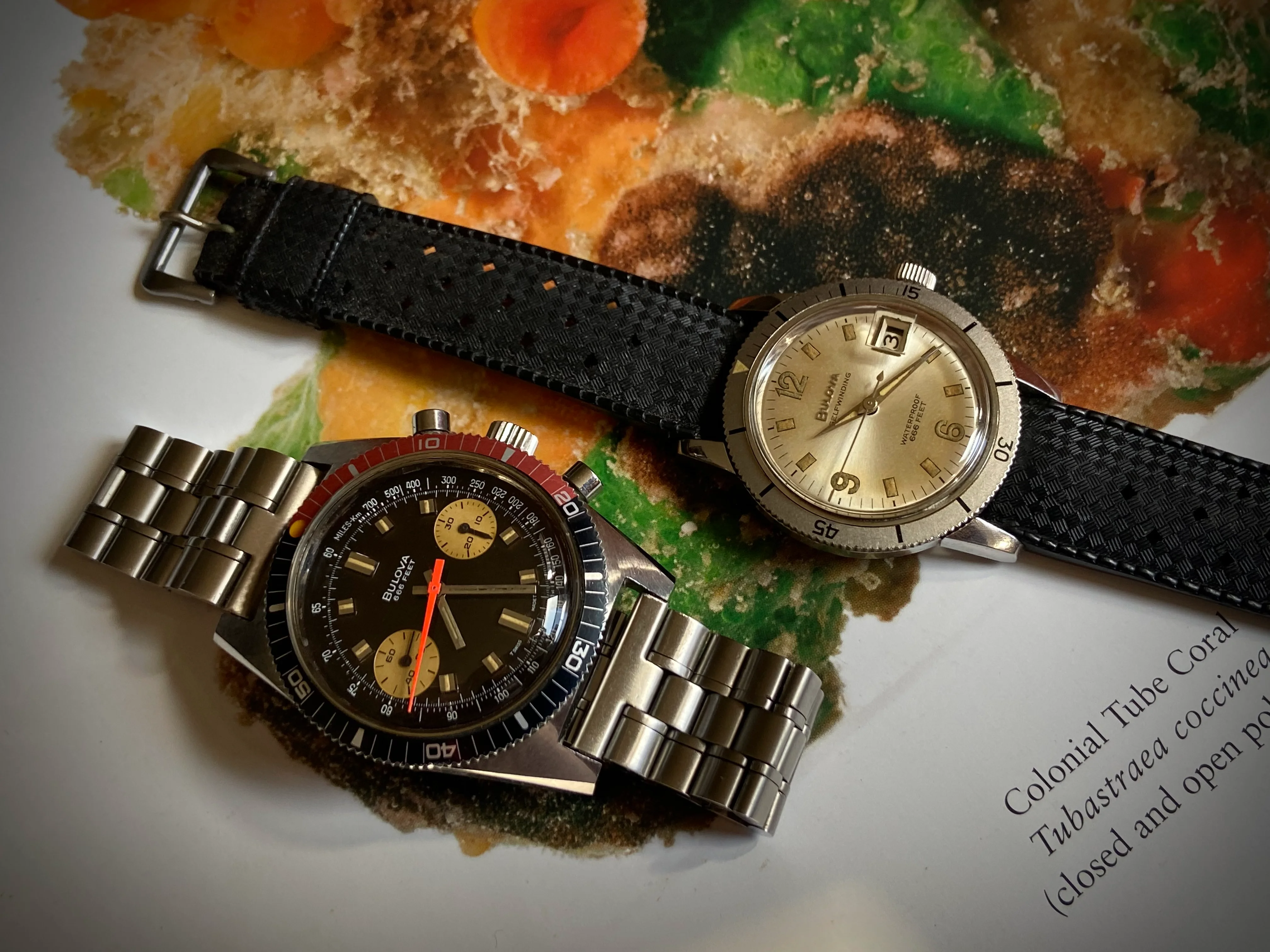

1973

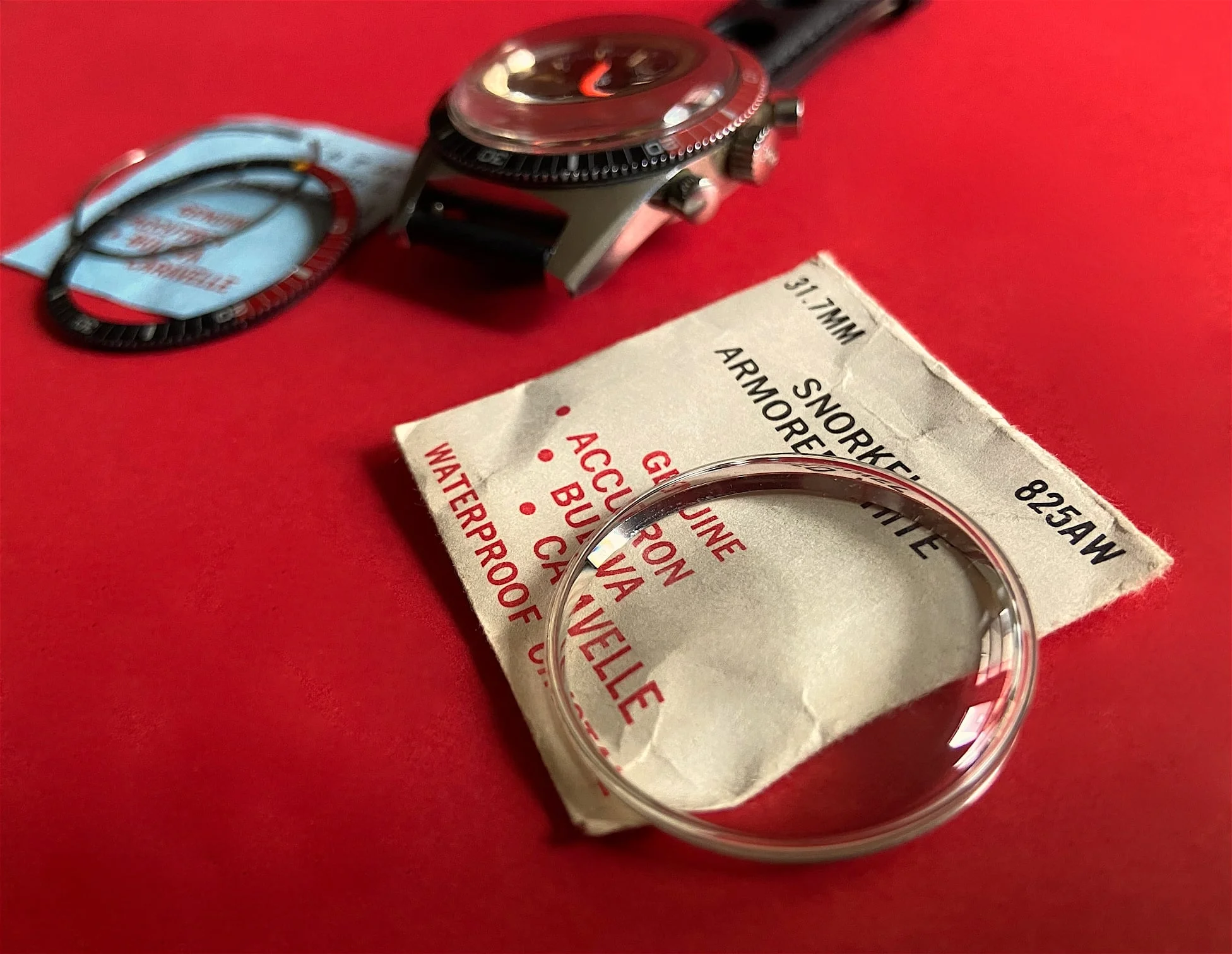

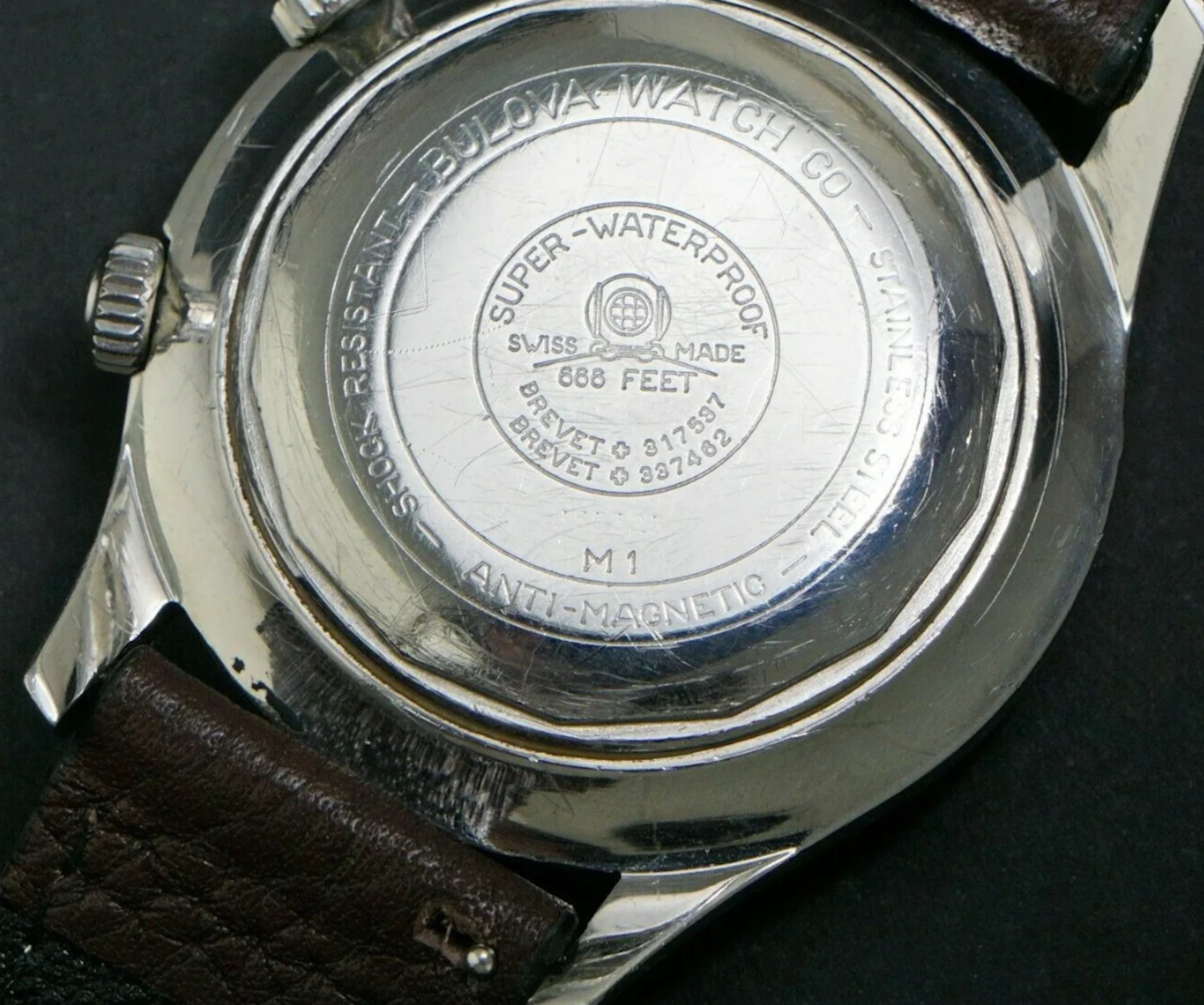

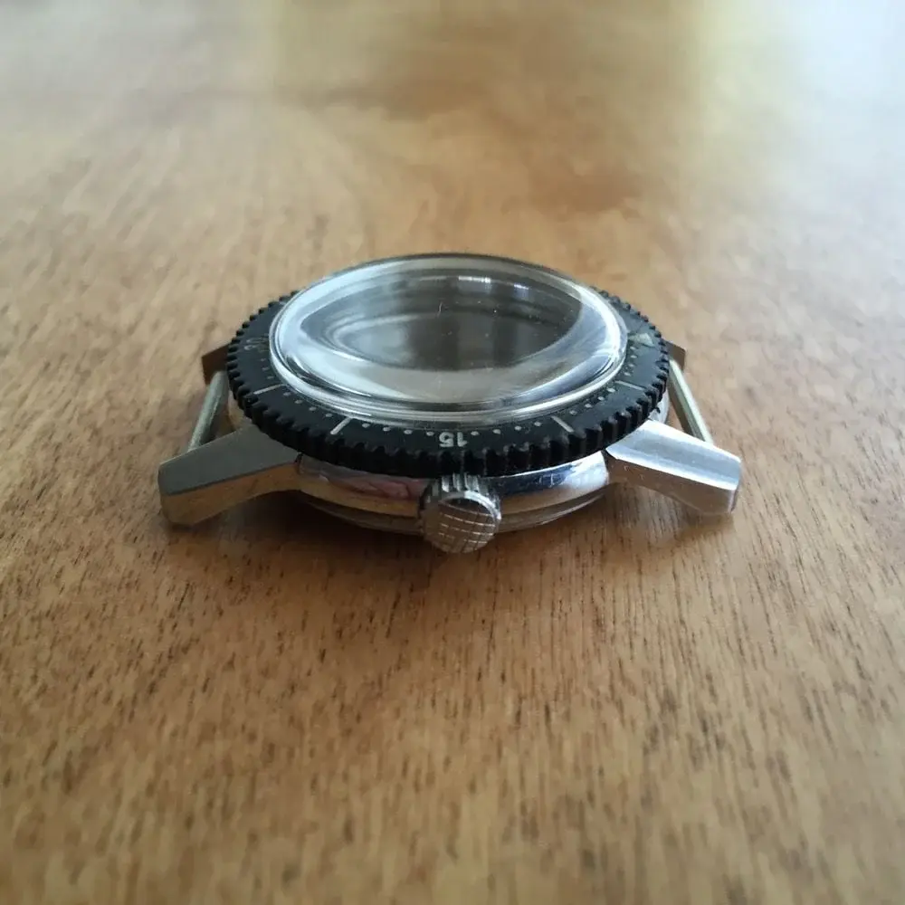

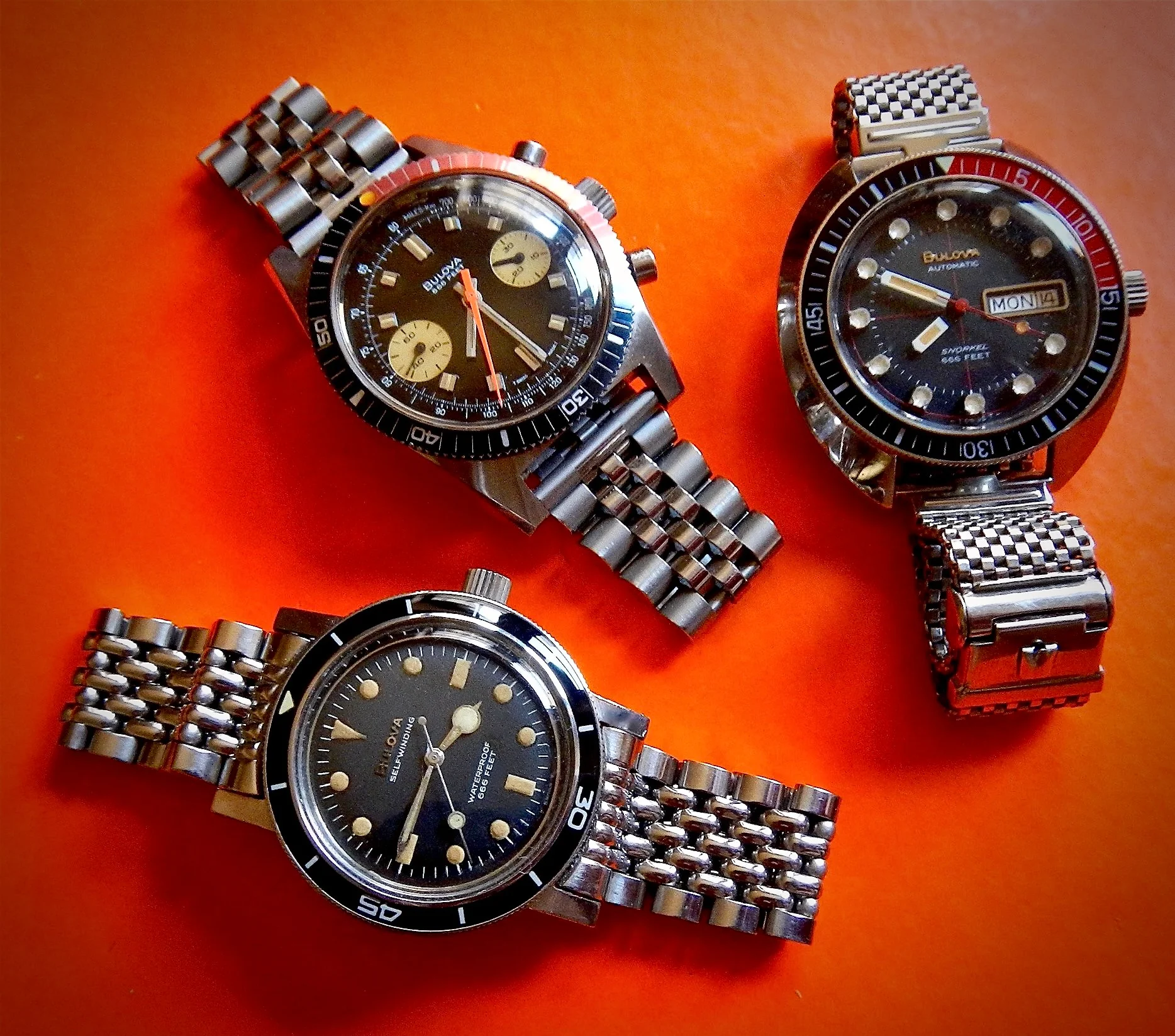

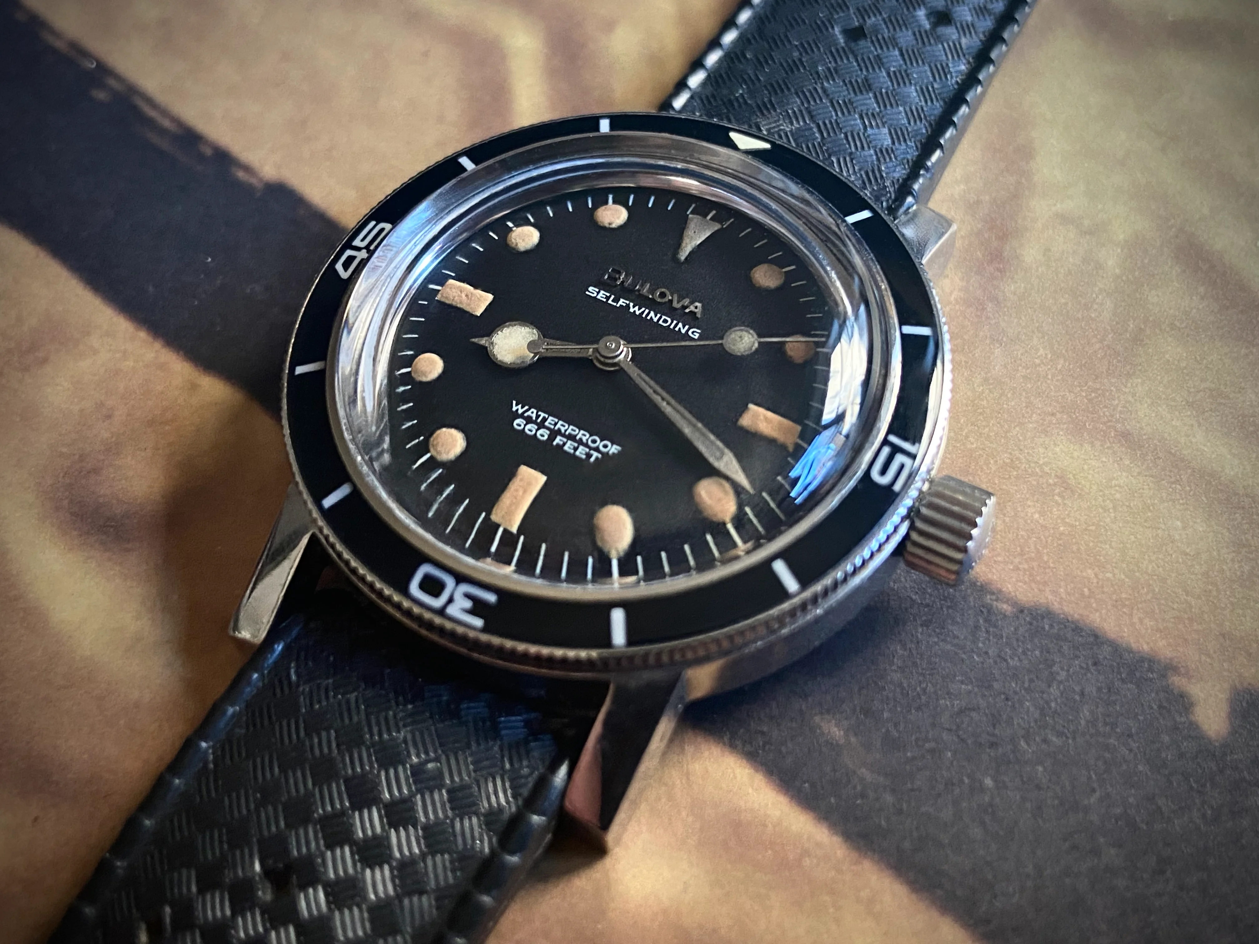

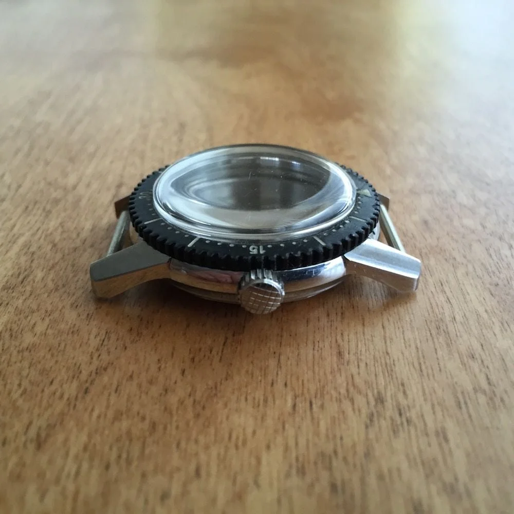

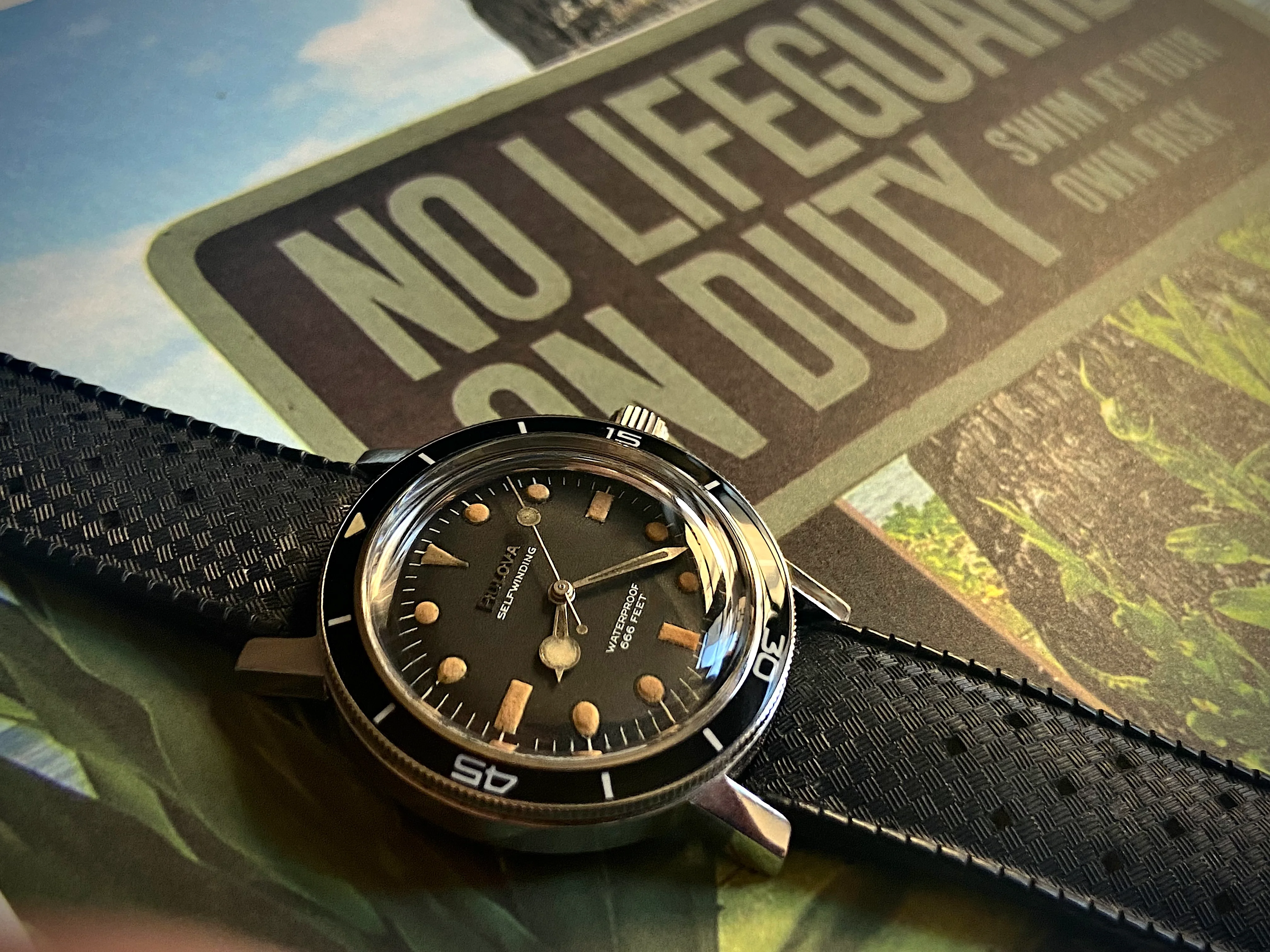

BULOVA DEEP SEA 666 feet DIVER CHRONOGRAPHE variant B
it's original Bulova divers crystal is a HIGH DOME heavy duty double plexi crystal.
3,570
17,833

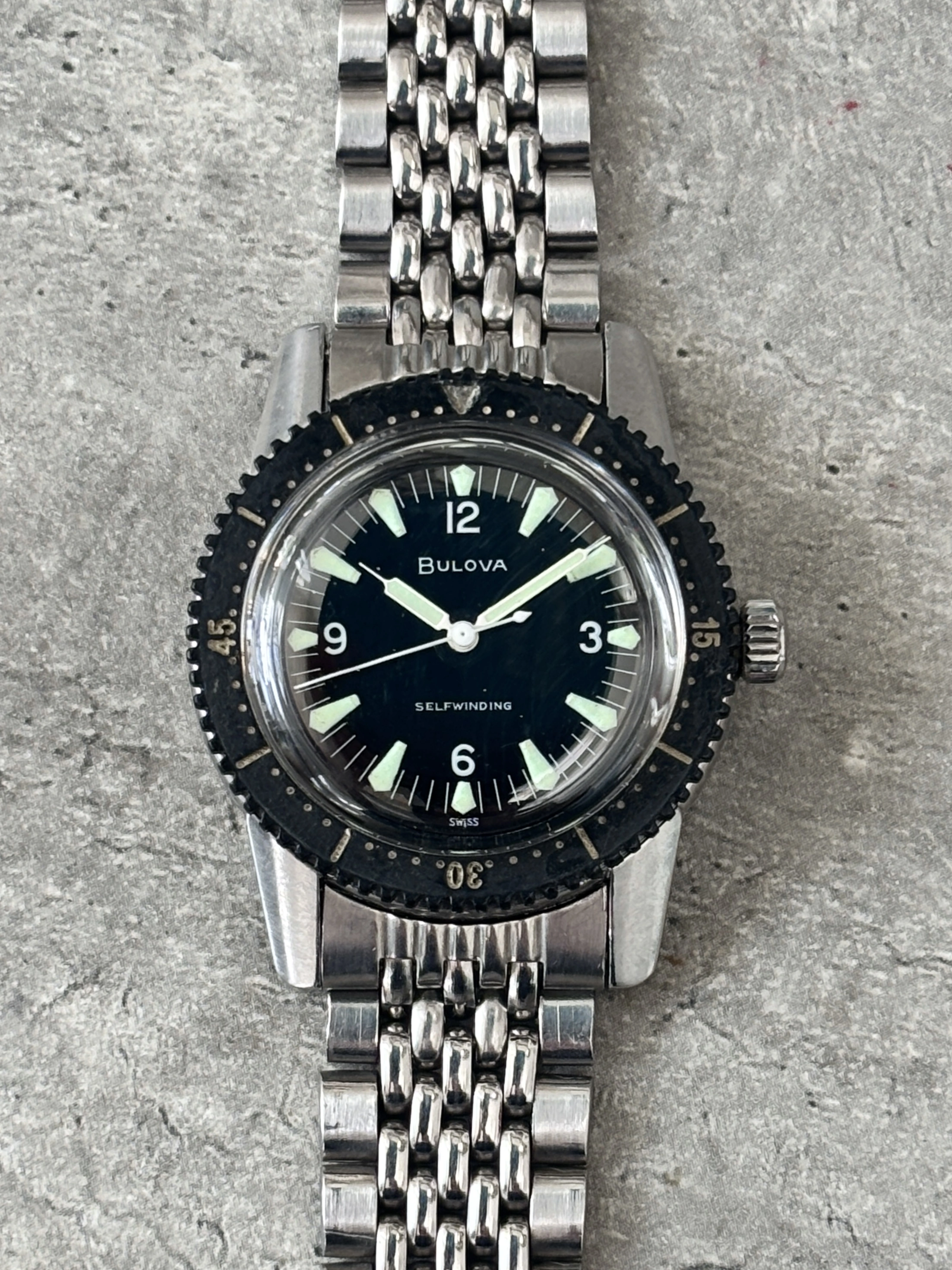

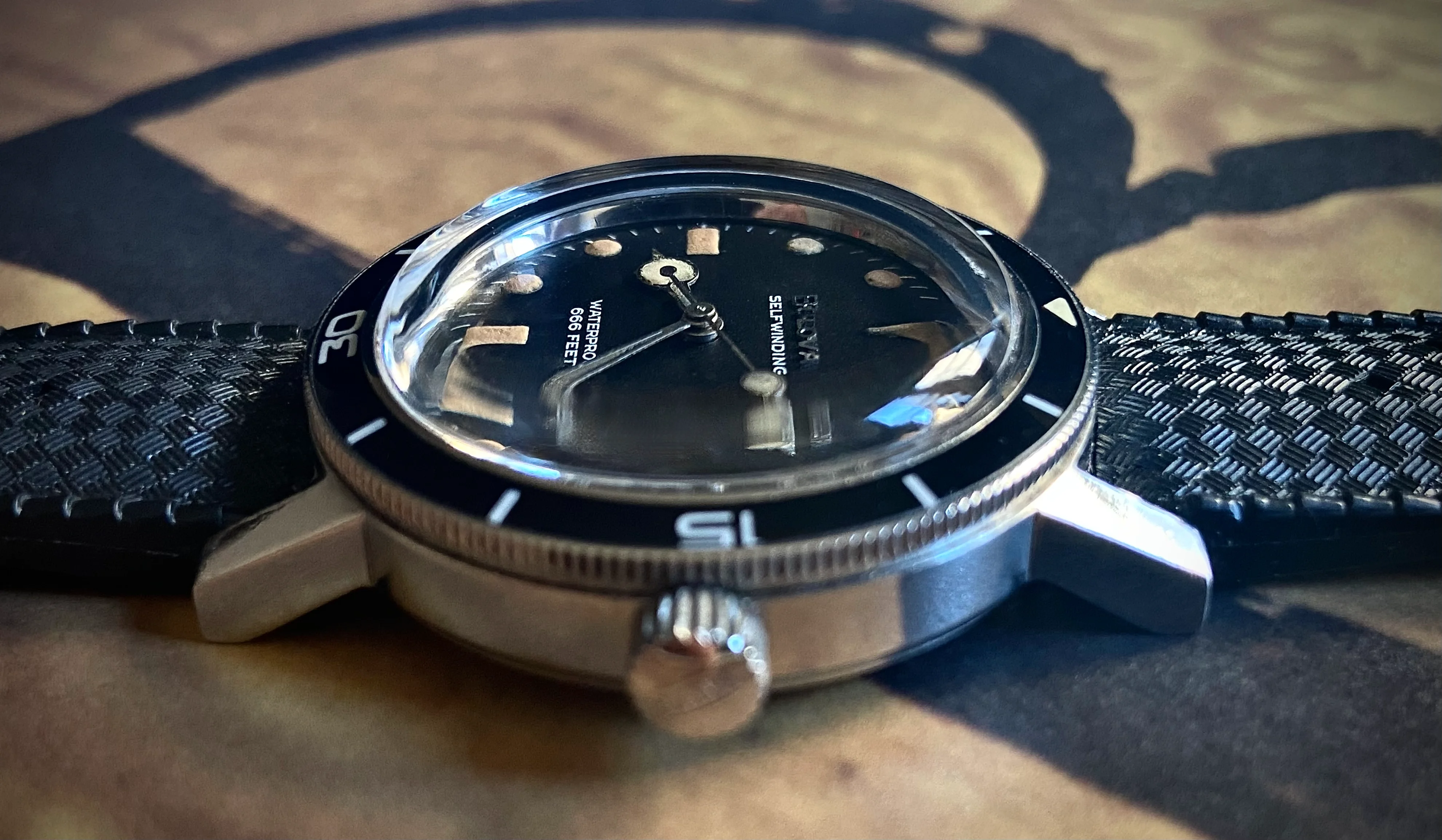

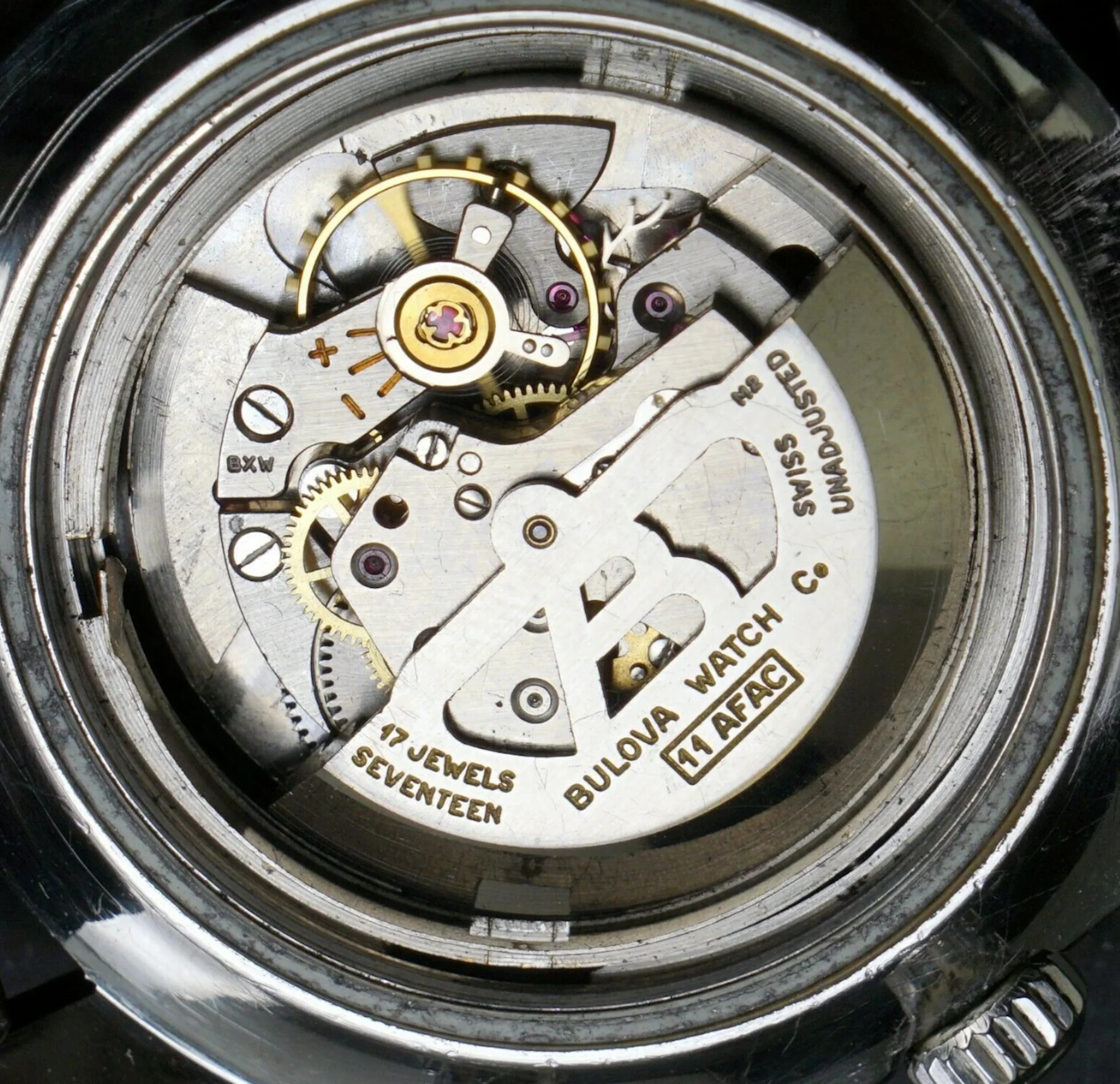

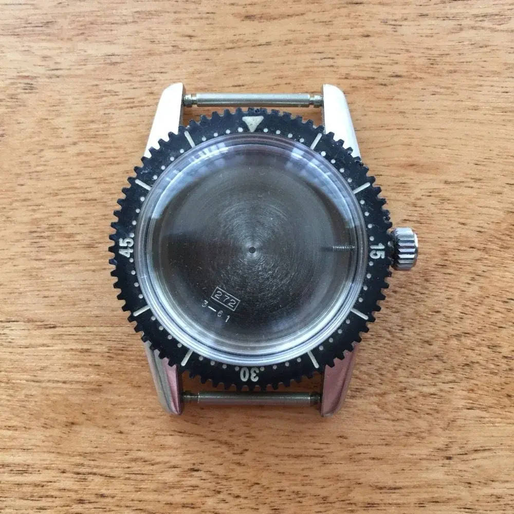

THE MORE YOU KNOW

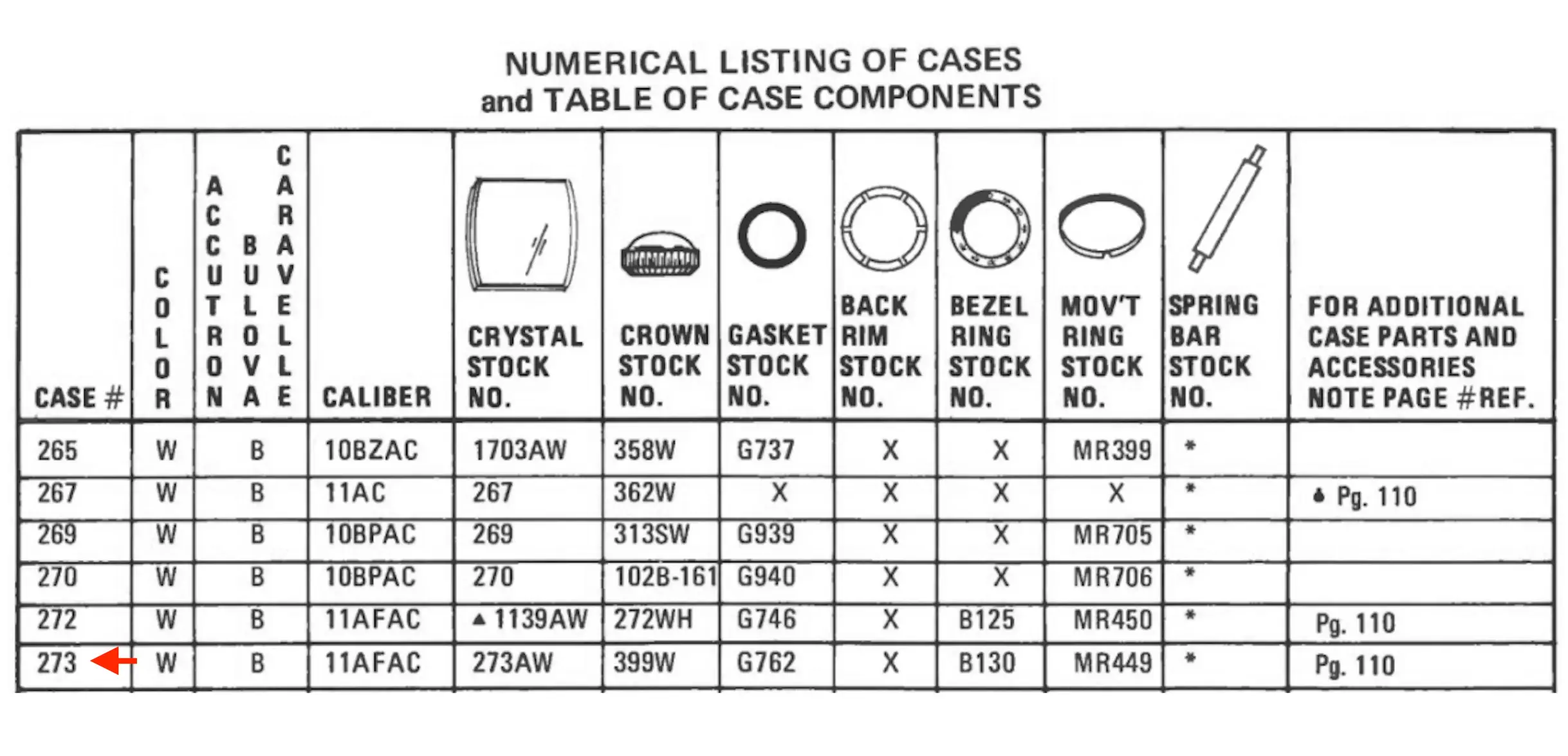

if u need research information on ...

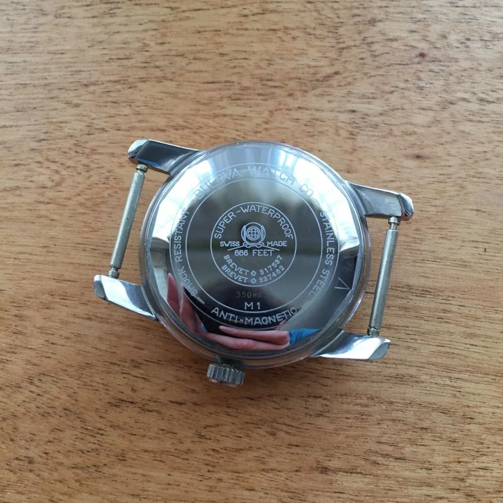

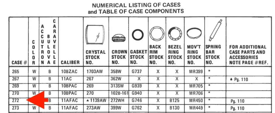

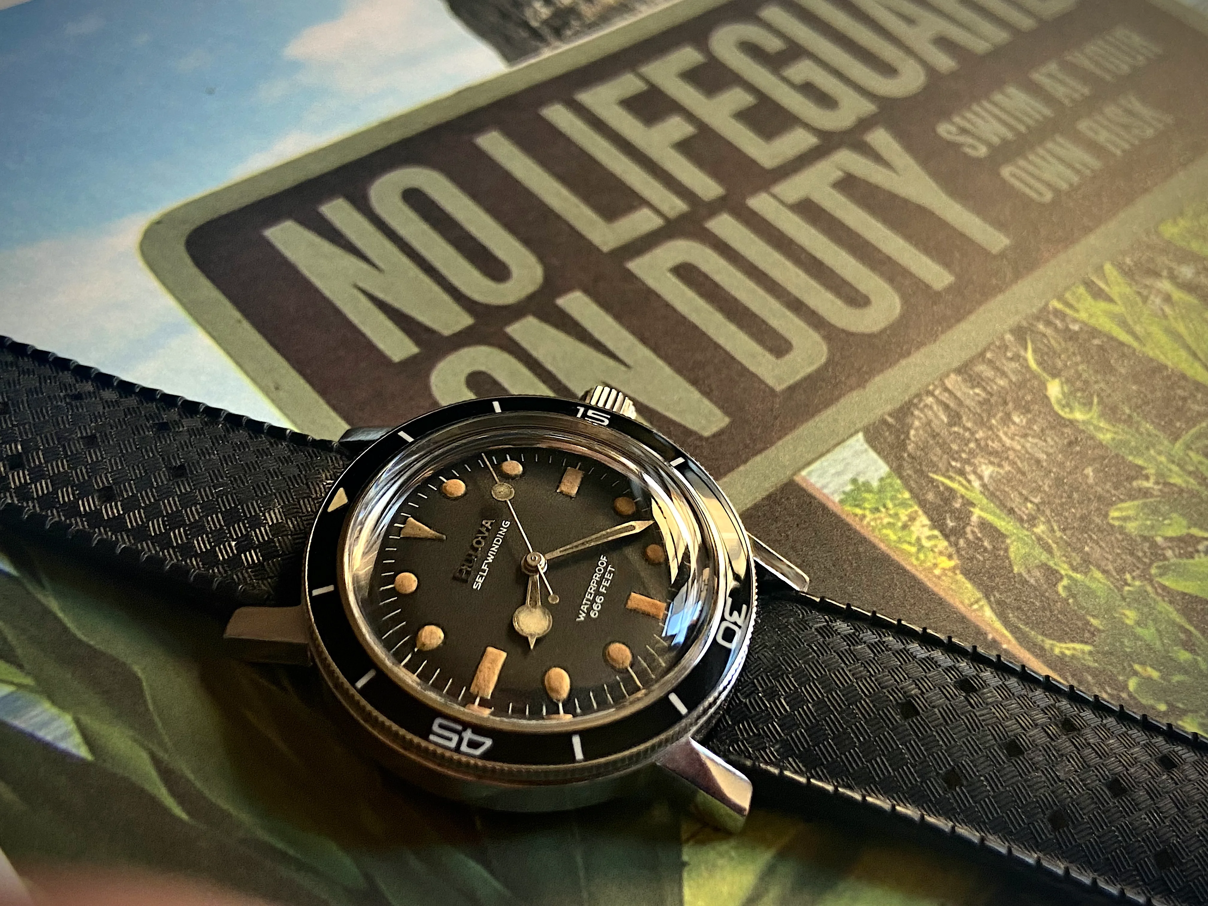

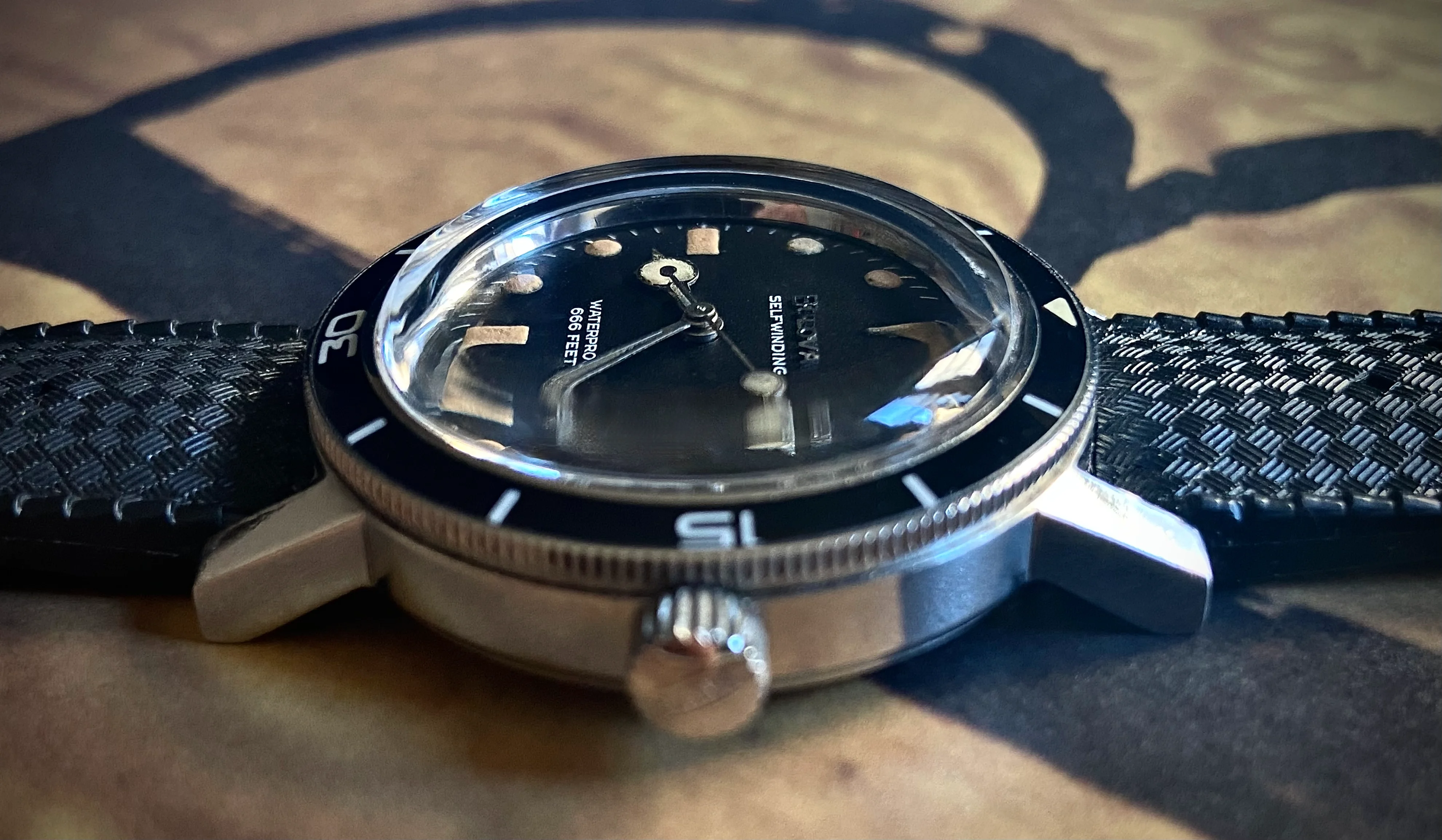

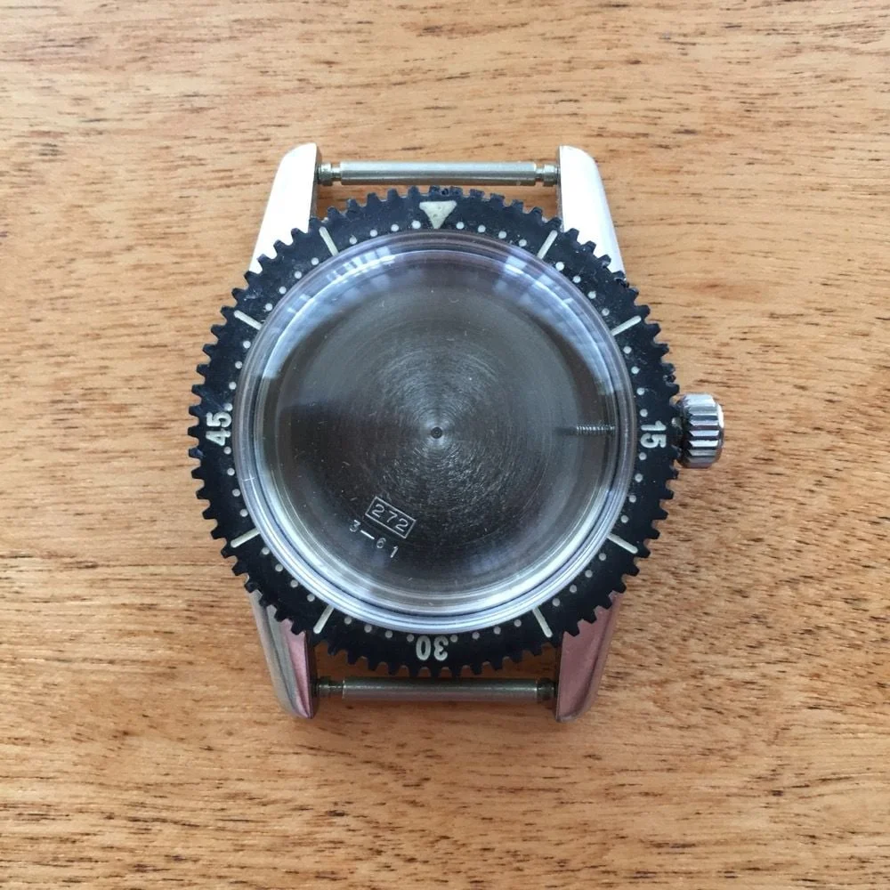

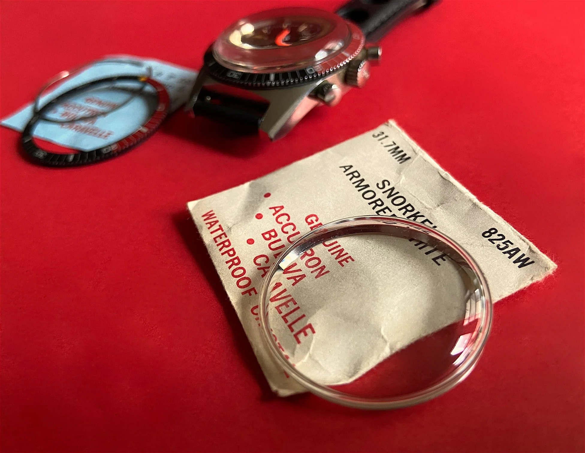

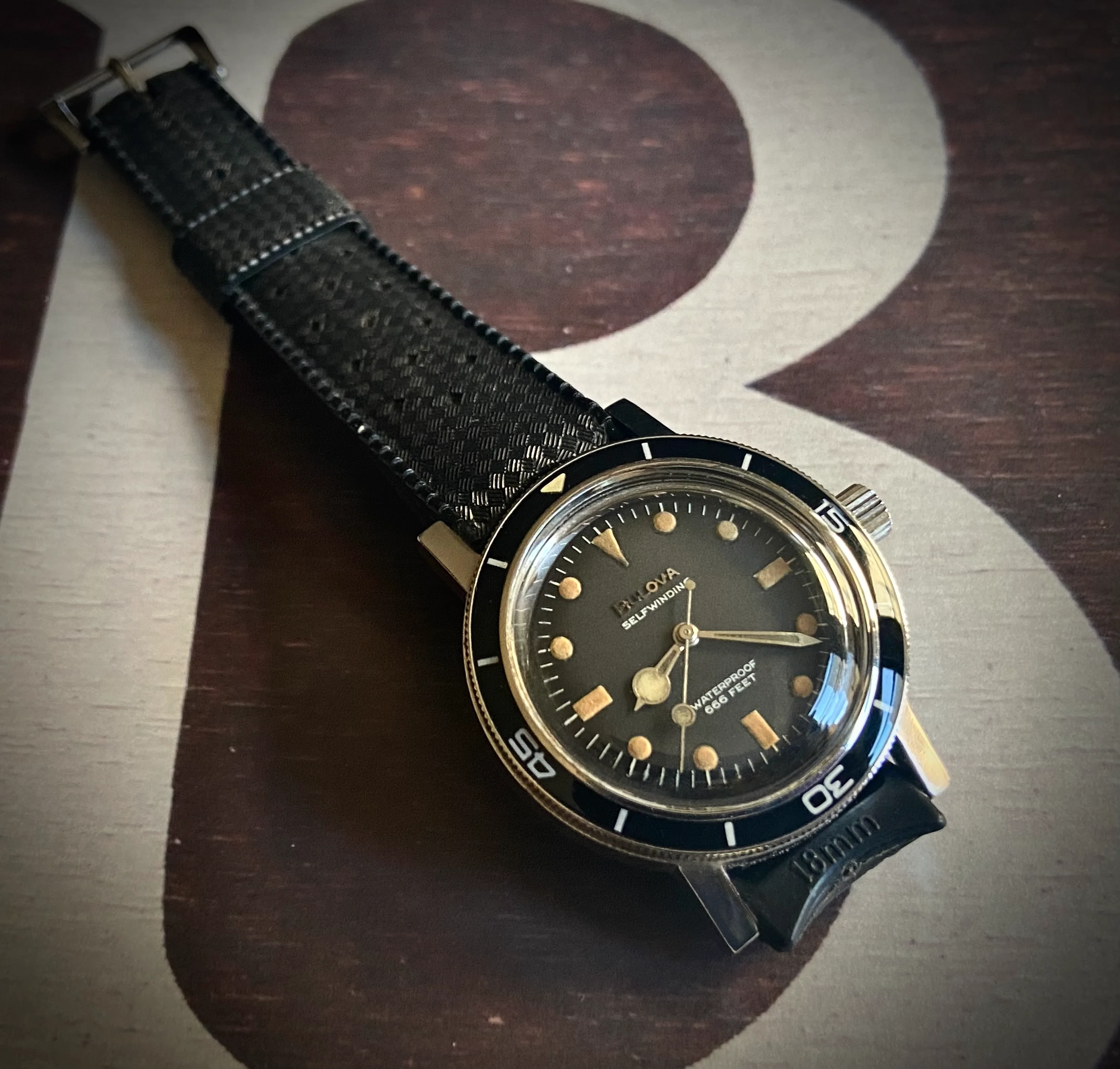

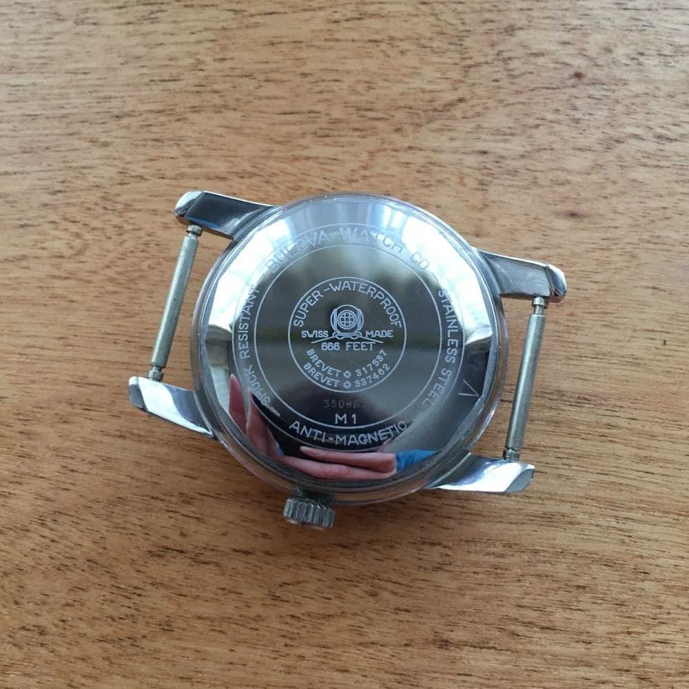

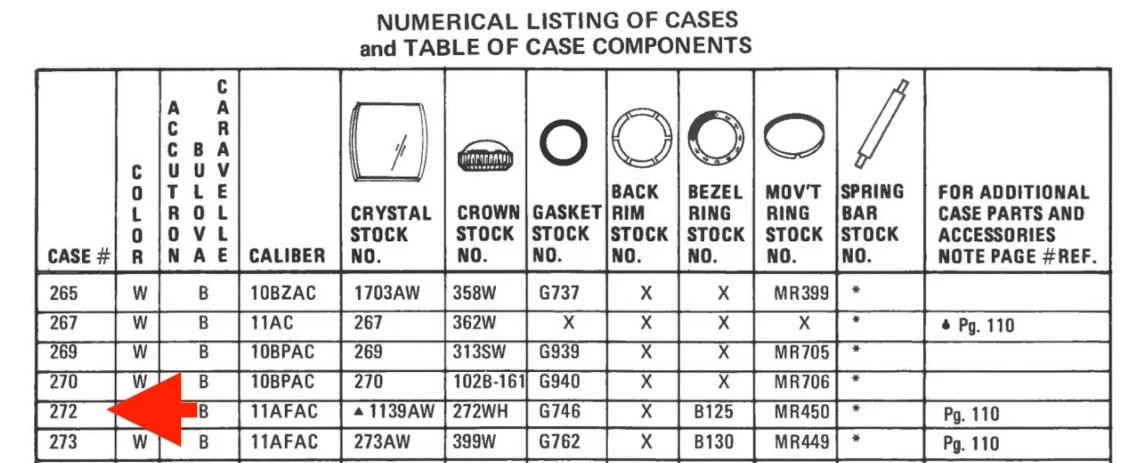

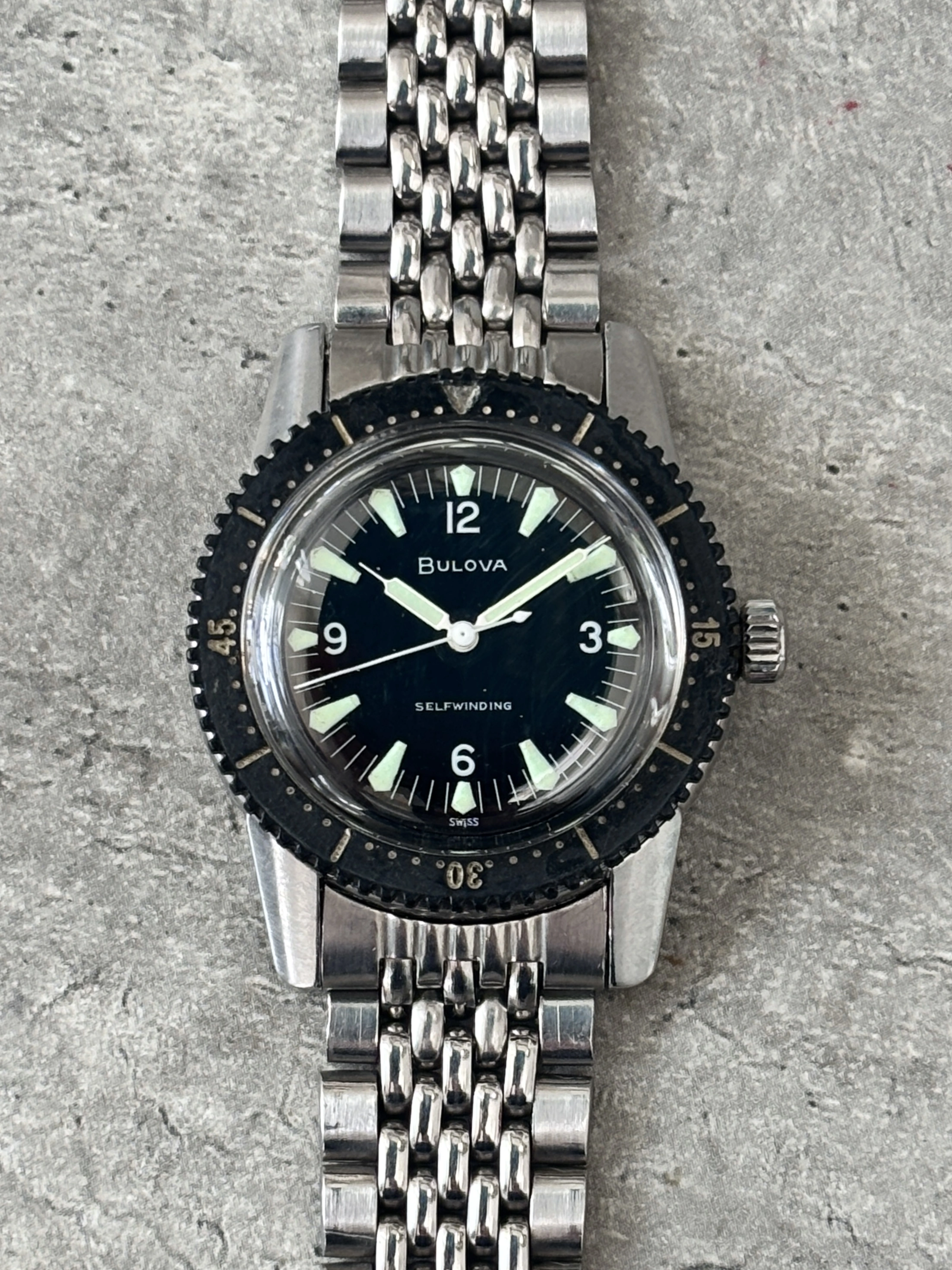

36MM BULOVA SUPERWATERPROOF
Single Crown Compressor SELFWINDING
EPSA CASE REF.#
272 [ BREVET ] as per Bulova specs rated at 666 feet static
with solid plastic resin bezel
Bulova mvmnt. ref.# 11AFAC [17 jewel]
LUG WIDTH: 18MM
Bulova OEM crystal / plexi ref.# 1139AW

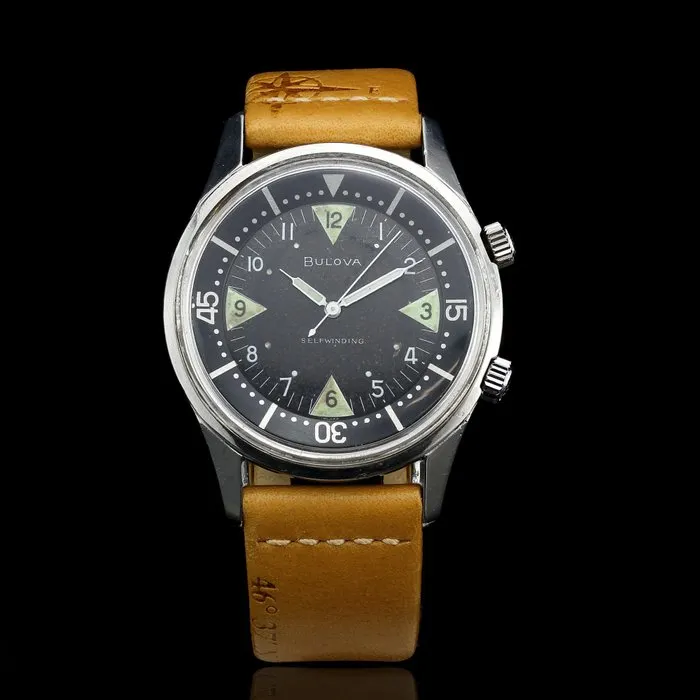

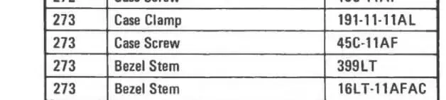

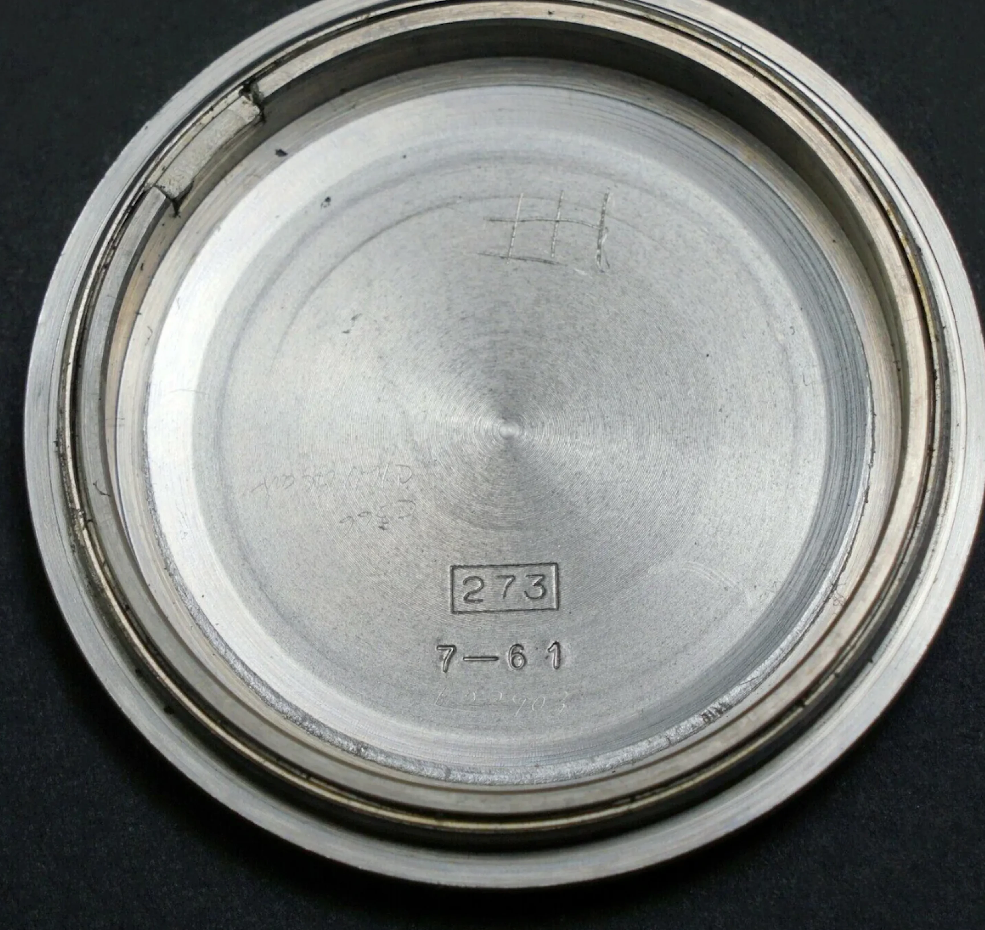

THE MORE YOU KNOW

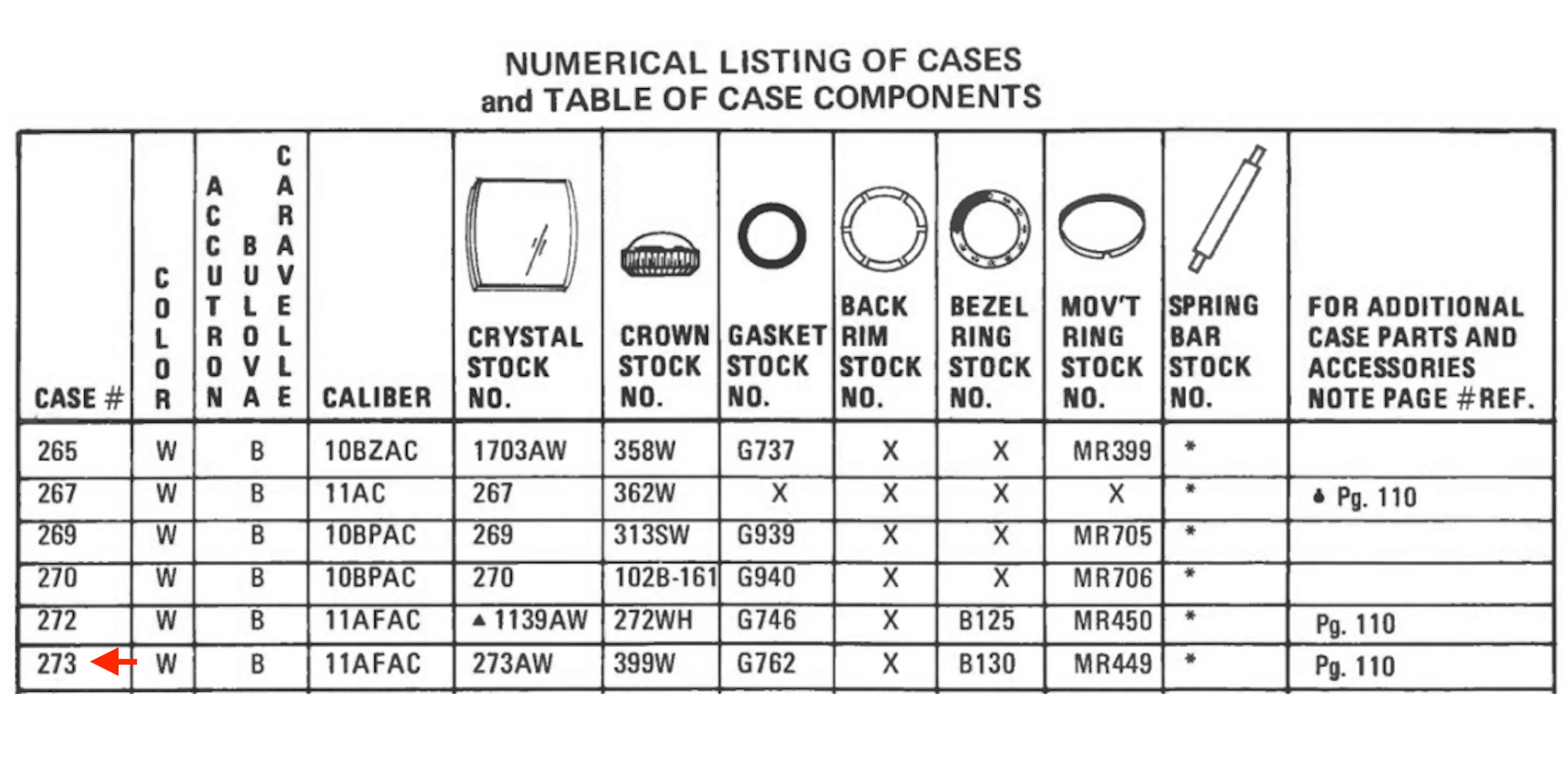

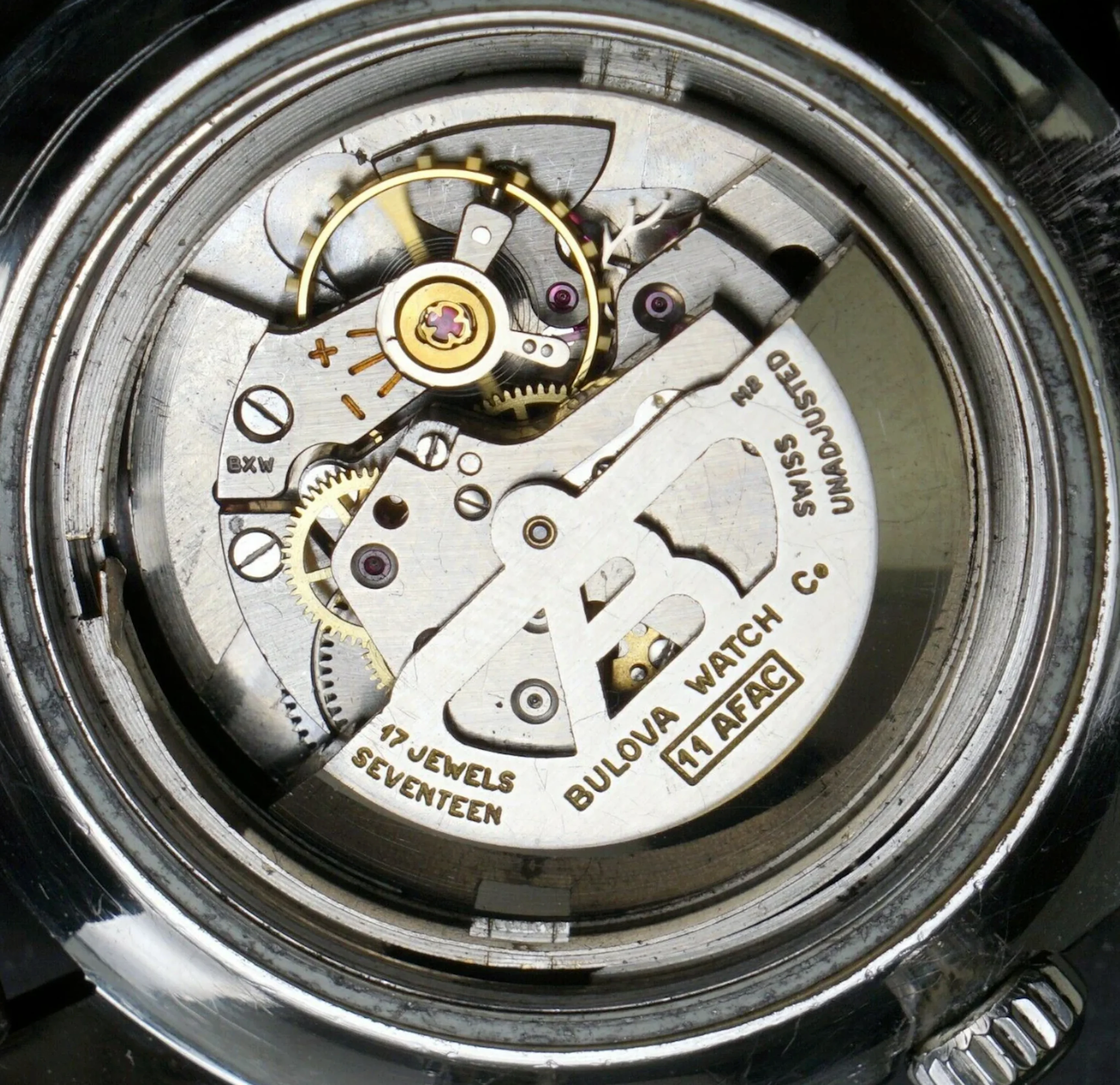

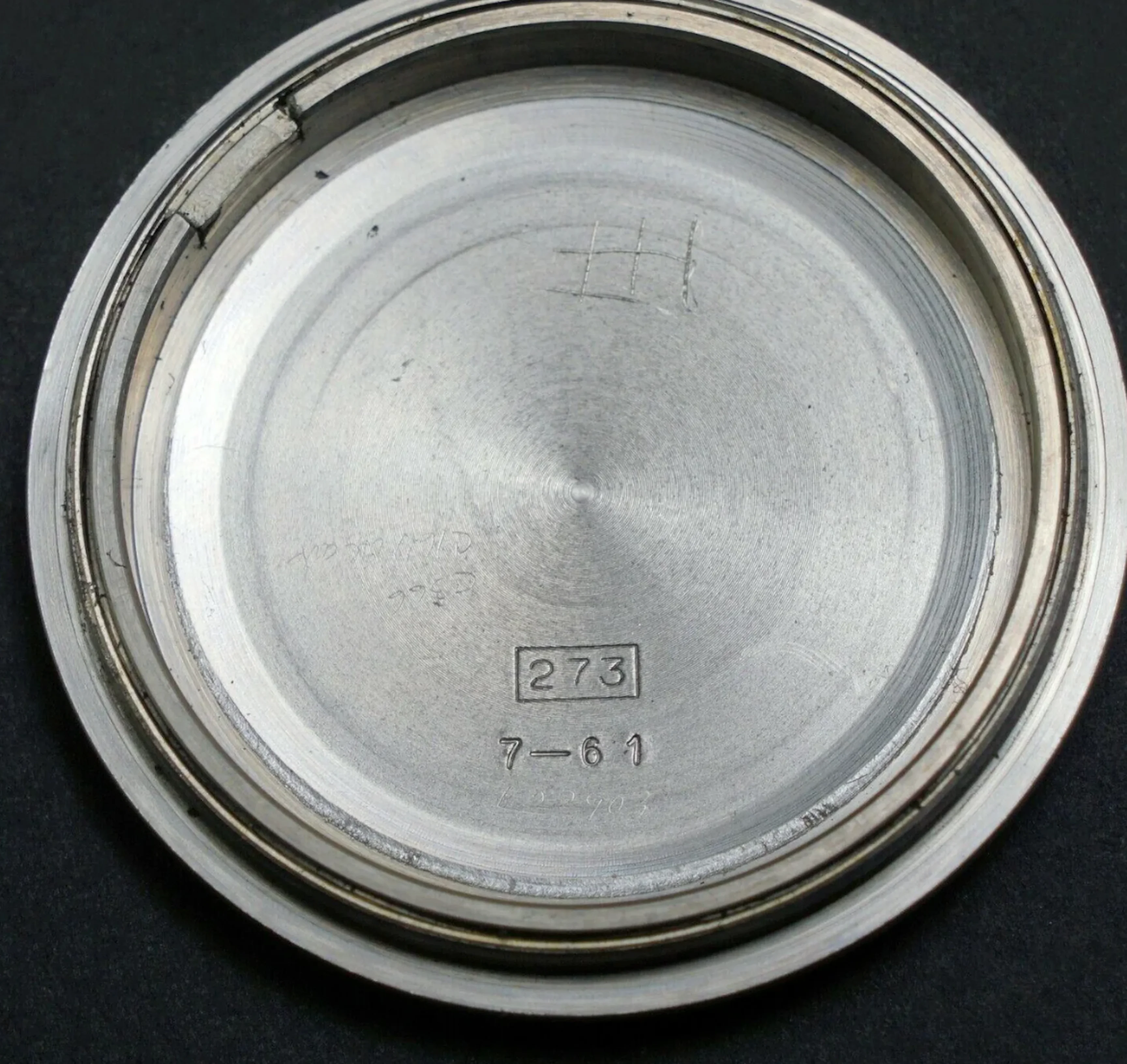

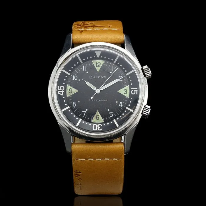

42MM BULOVA (Oversized) DUAL CROWN Supercompressor ....​
EPSA case ref.# 273 [BREVET] as per Bulova specs rated at 666 feet static
Bulova OEM crystal / plexi ref.# 273AW
IMAGES BORROWED FROM CYBERSPACE

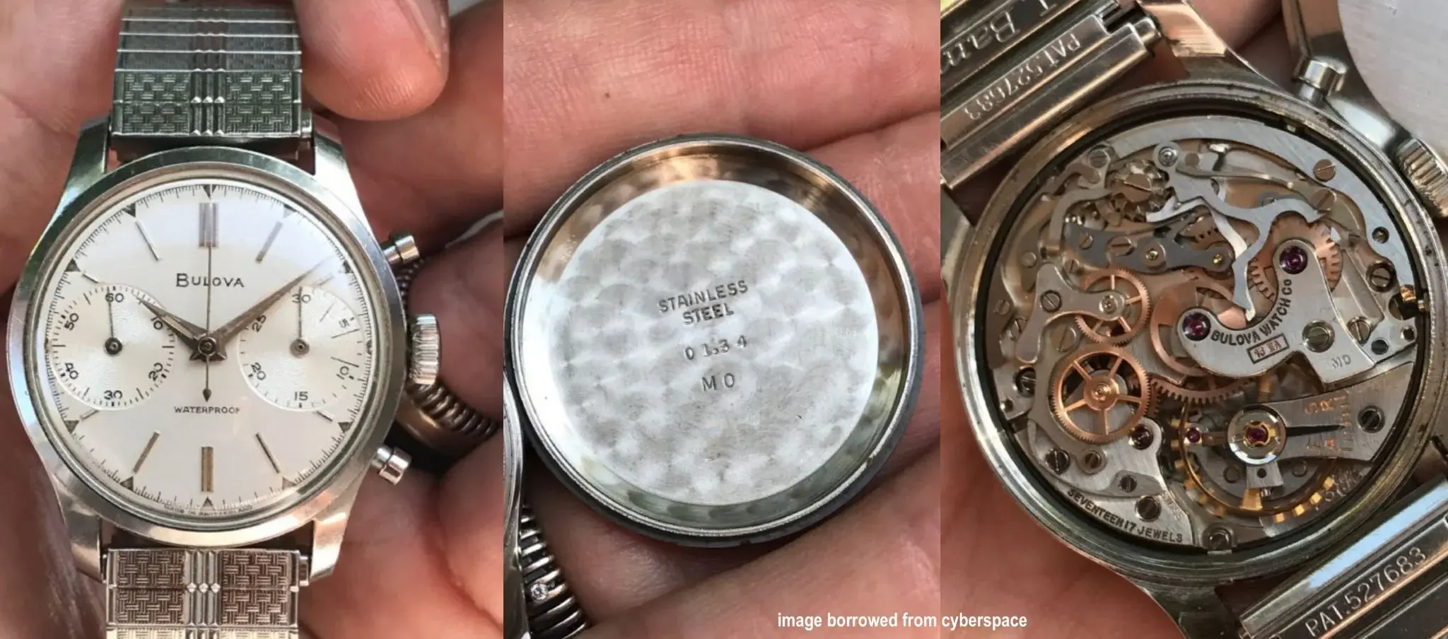

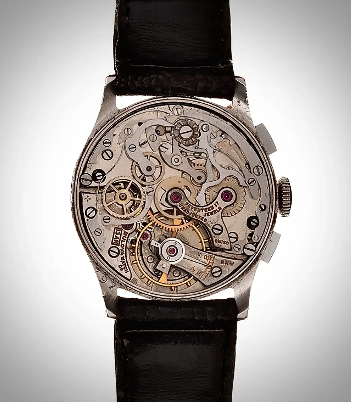

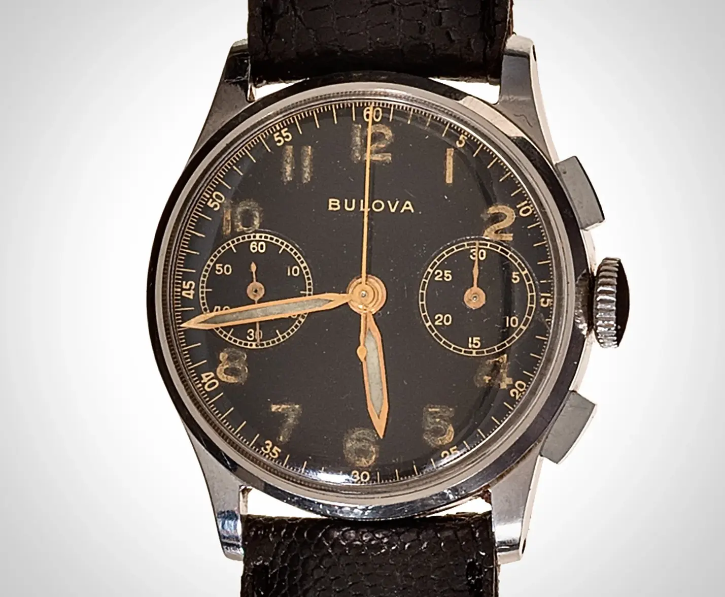

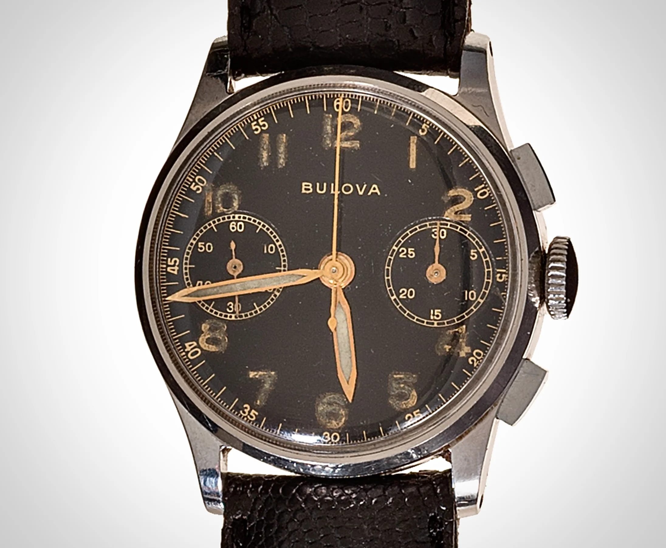

EYE CANDY

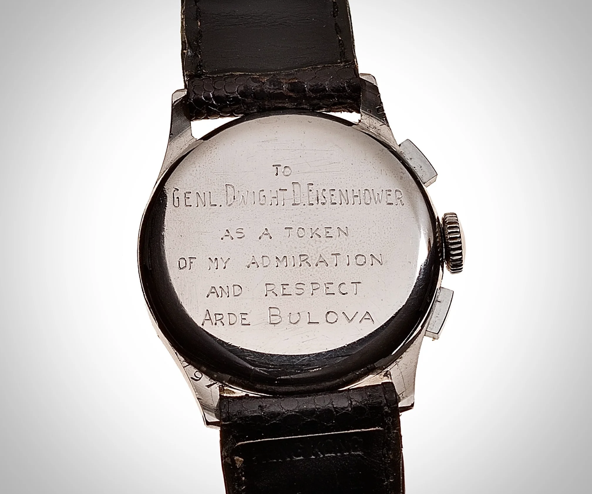

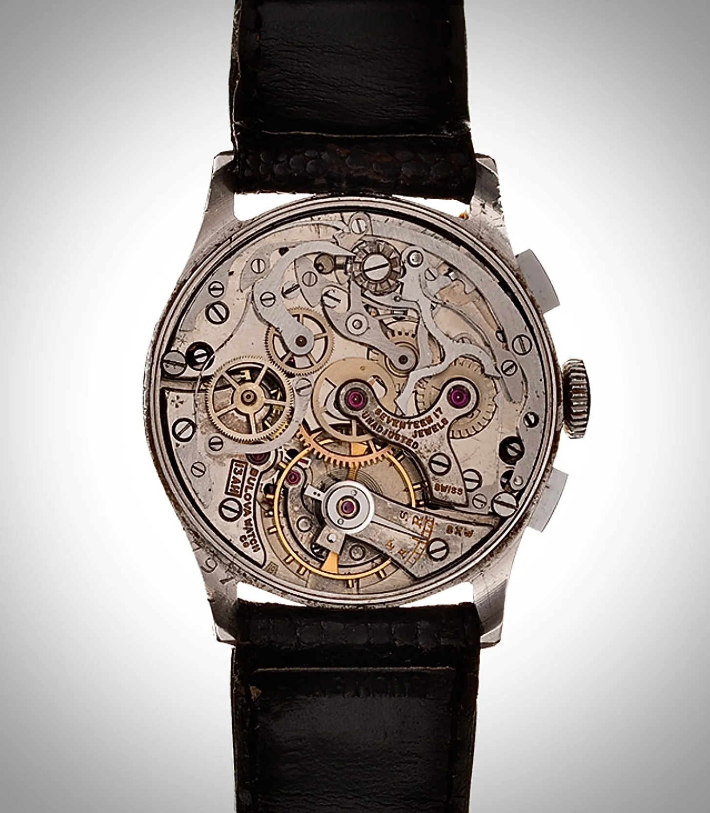

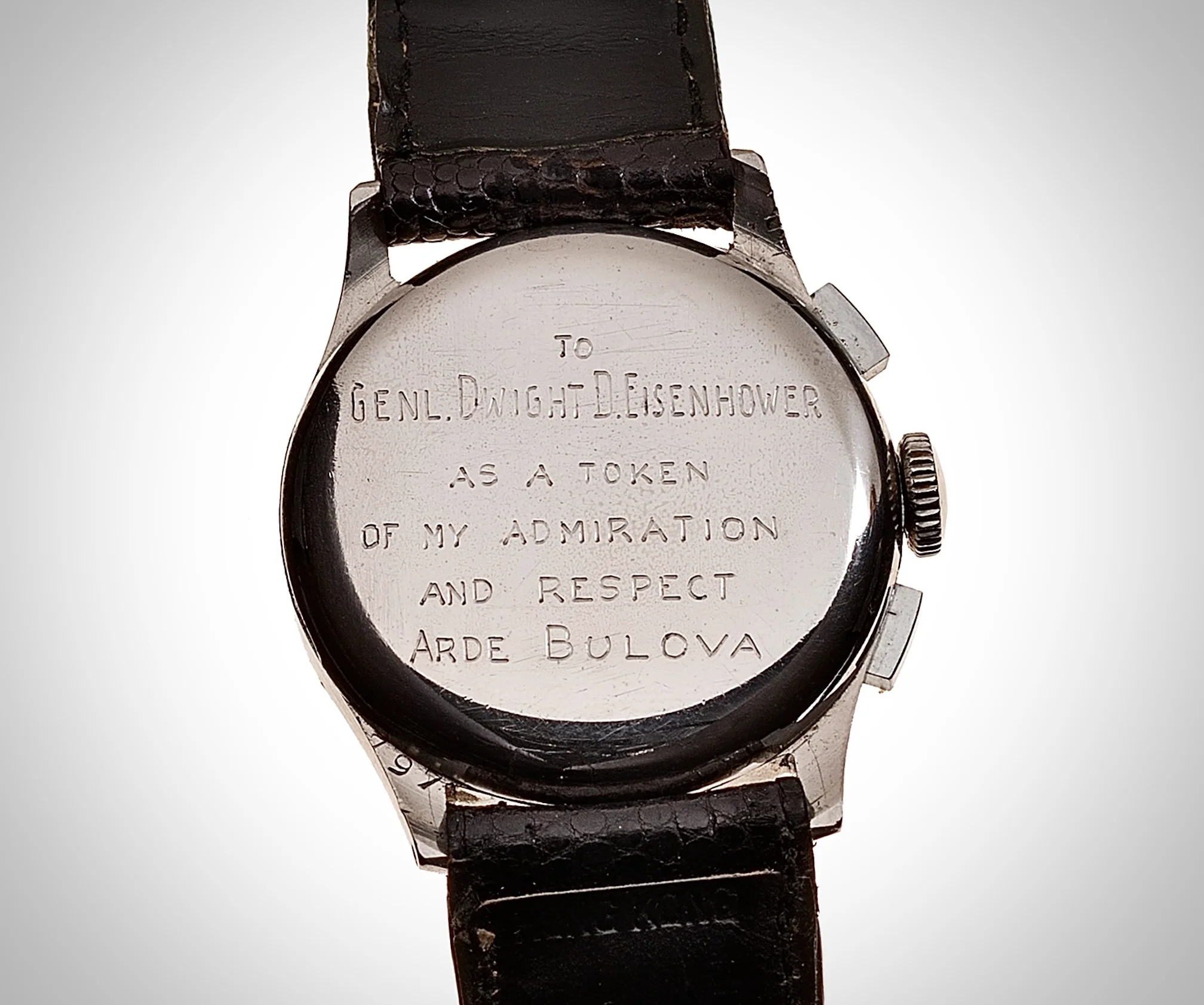

Bulova Chronograph​

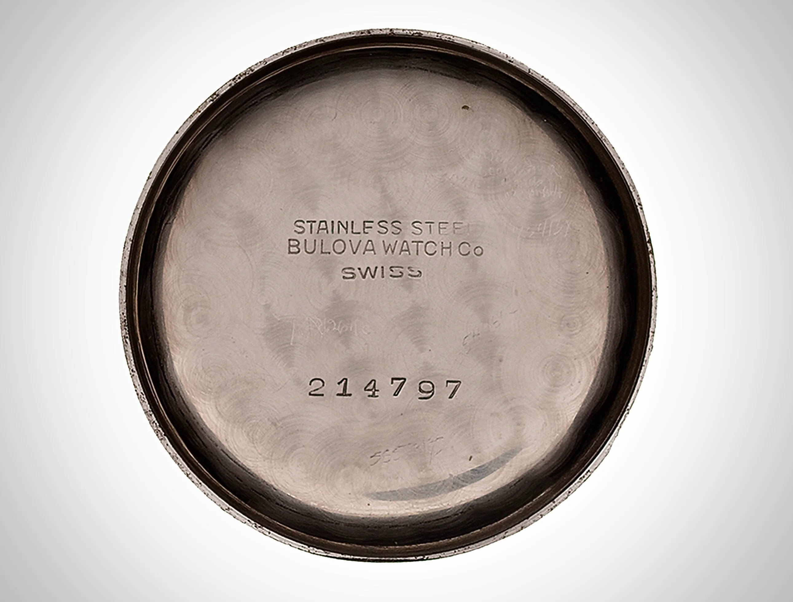

Presented to Dwight D. Eisenhower​
A historically significant stainless steel Bulova chronograph was presented to General (later President) Dwight D. Eisenhower by Arde Bulova, Chairman of the Bulova Watch Company.
The watch, dated to 1941 by a movement stamp ("BXW" with an asterisk), features a 32mm case, black glossy dial with gilt printing, and a manual Caliber 13 AH movement with 17 jewels.
It was accompanied by a Gay Frères beads-of-rice bracelet.
The caseback is engraved with the inscription:
"To Genl. Dwight D. Eisenhower, as a token of my admiration and respect, Arde Bulova."
Though the exact date of presentation is unknown, ties between Bulova and Eisenhower were strengthened through shared connections, including General Omar Bradley, a West Point classmate of Eisenhower and later Bulova’s chairman.
The watch left Eisenhower’s possession when he gifted it to his wife Mamie’s uncle, Joel Carlson, during a visit to Boone, Iowa. It was later traded to jeweler Walter Donald Eckstein for repair, remaining in the Eckstein family until its auction. It sold for $25,000 at Phillips in 2018, far exceeding its $10,000–$15,000 estimate.

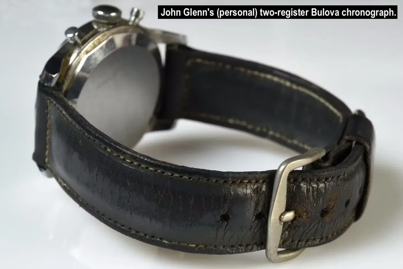

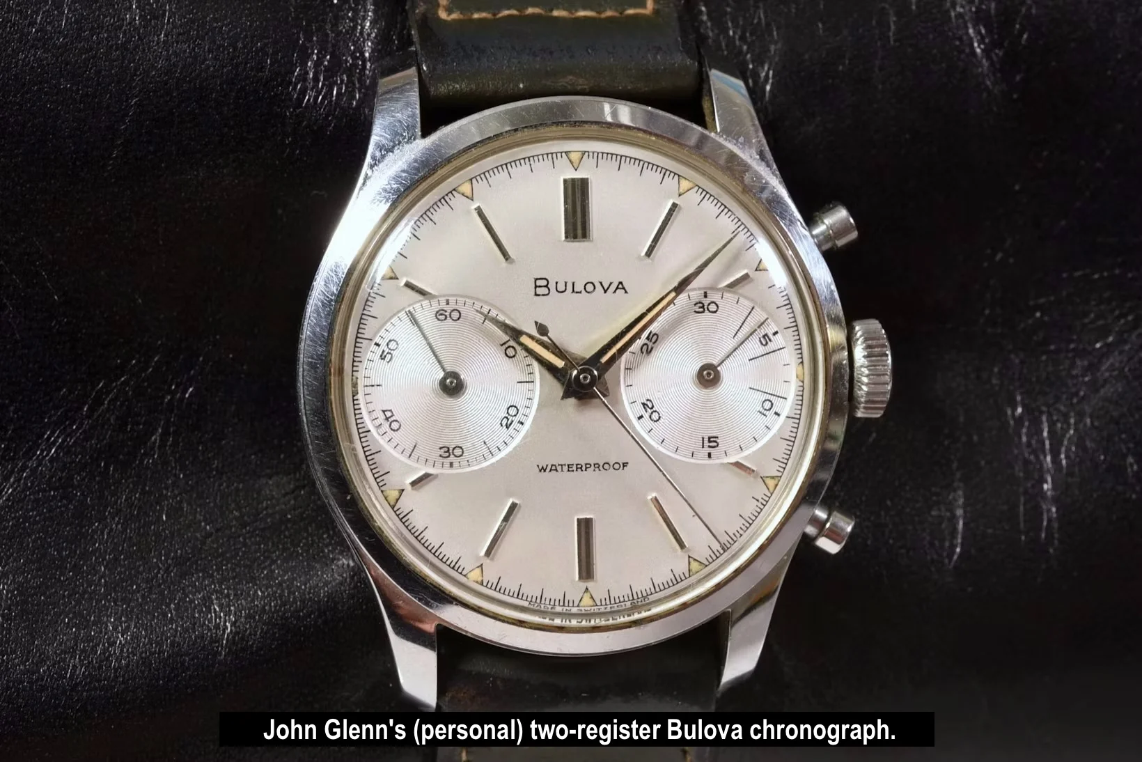

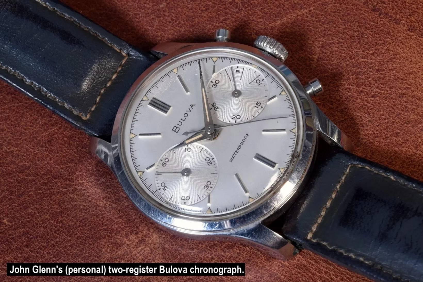

EYE CANDY

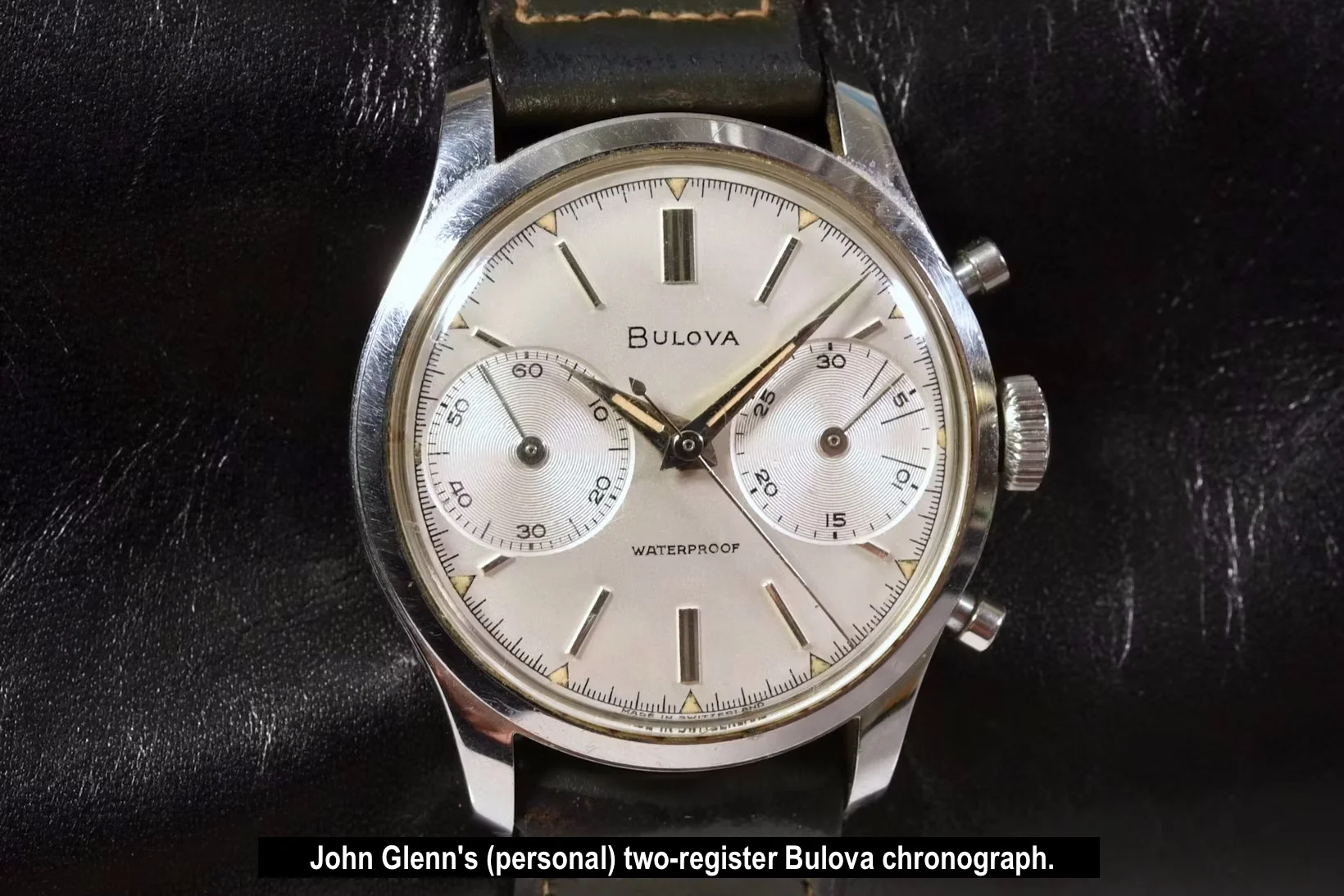

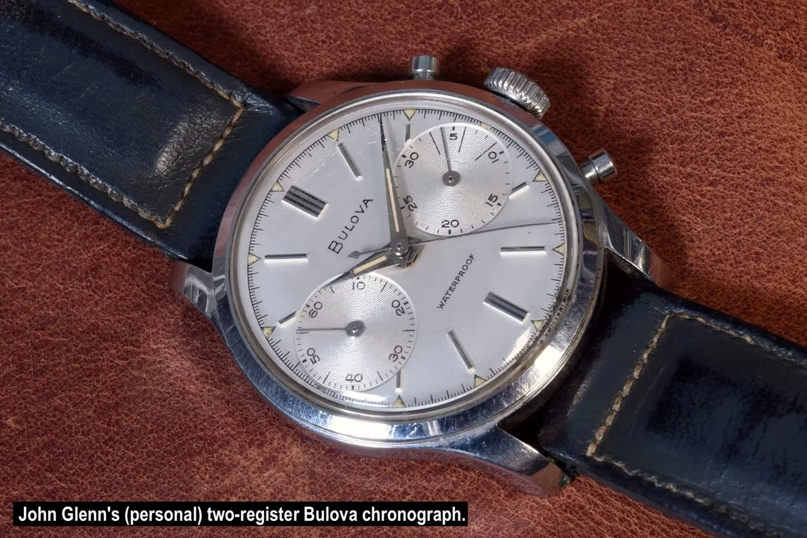

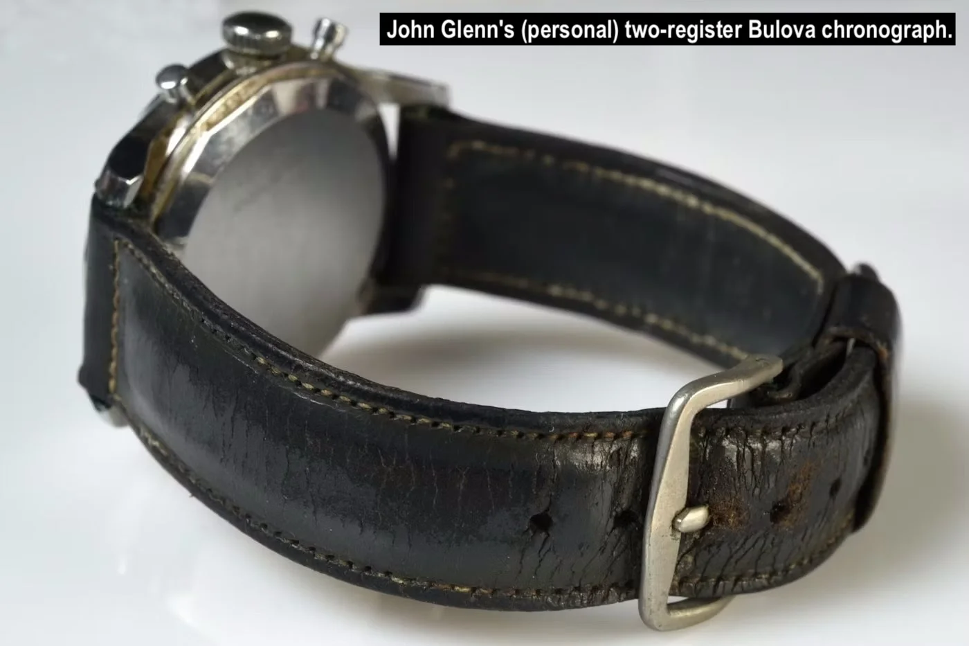

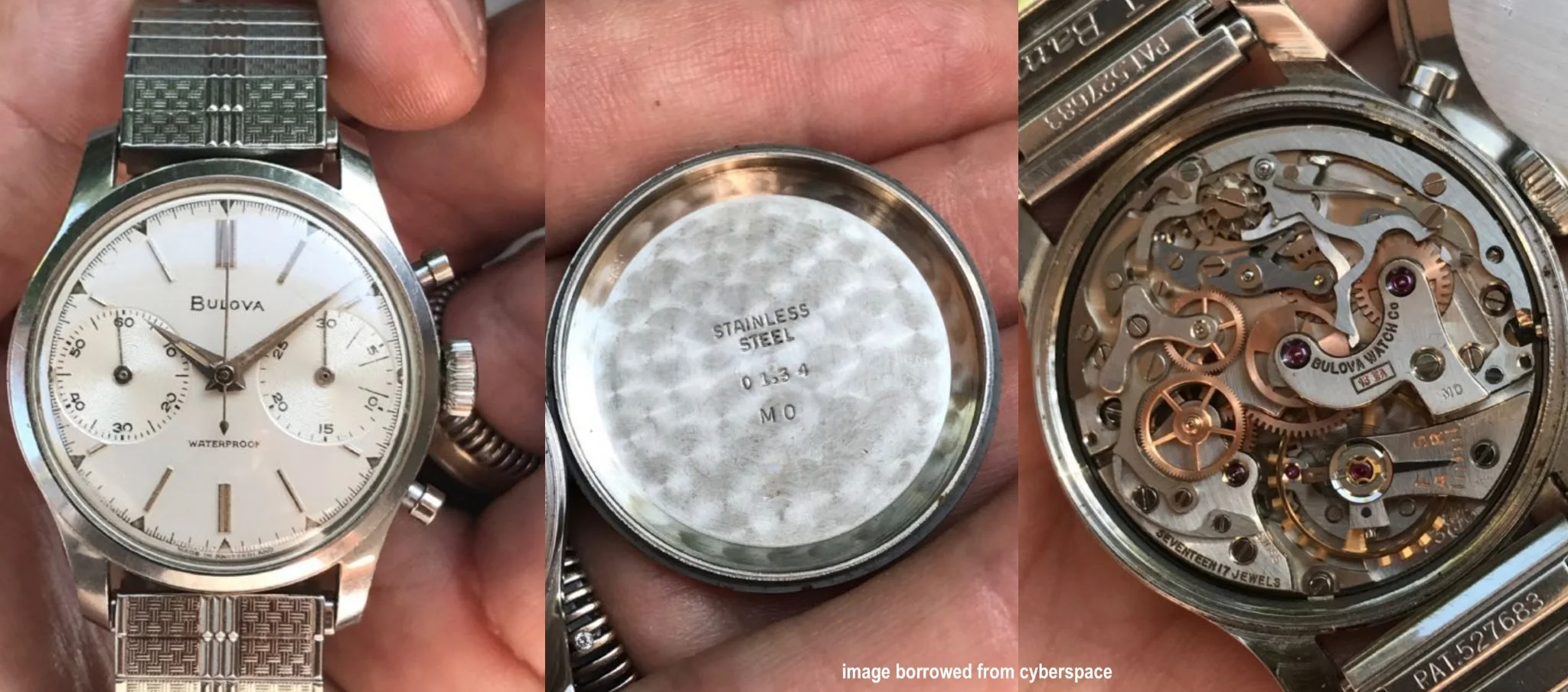

BULOVA "Big Eye" CHRONOGRAPHE
from: Heuer (not TAG)
Powered by - Vajoux caliber 23
owned by: John Glenn
Heuer had made some chronographs for Bulova, The dial and case appear to be identical to the Heuer Reference 404.​

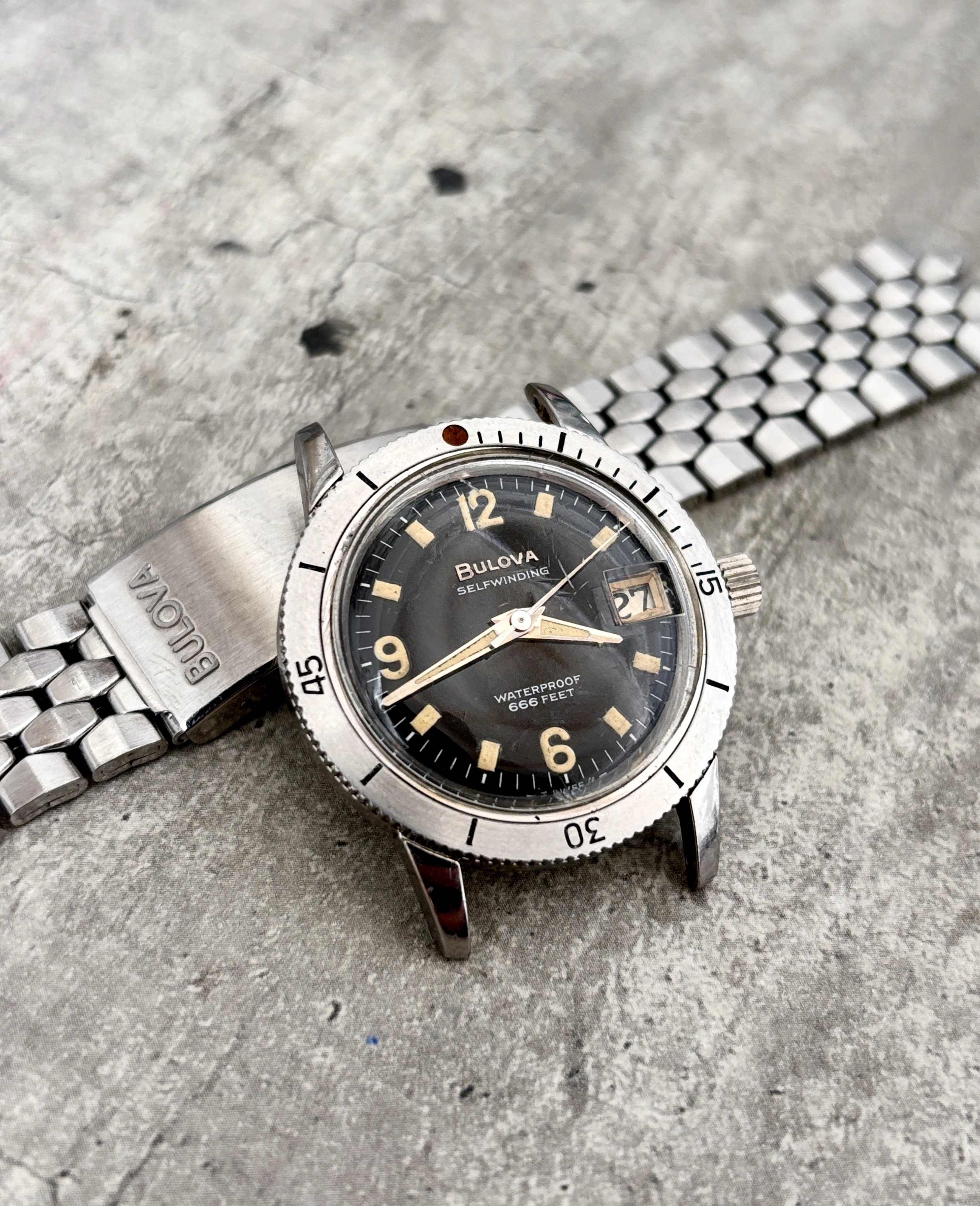

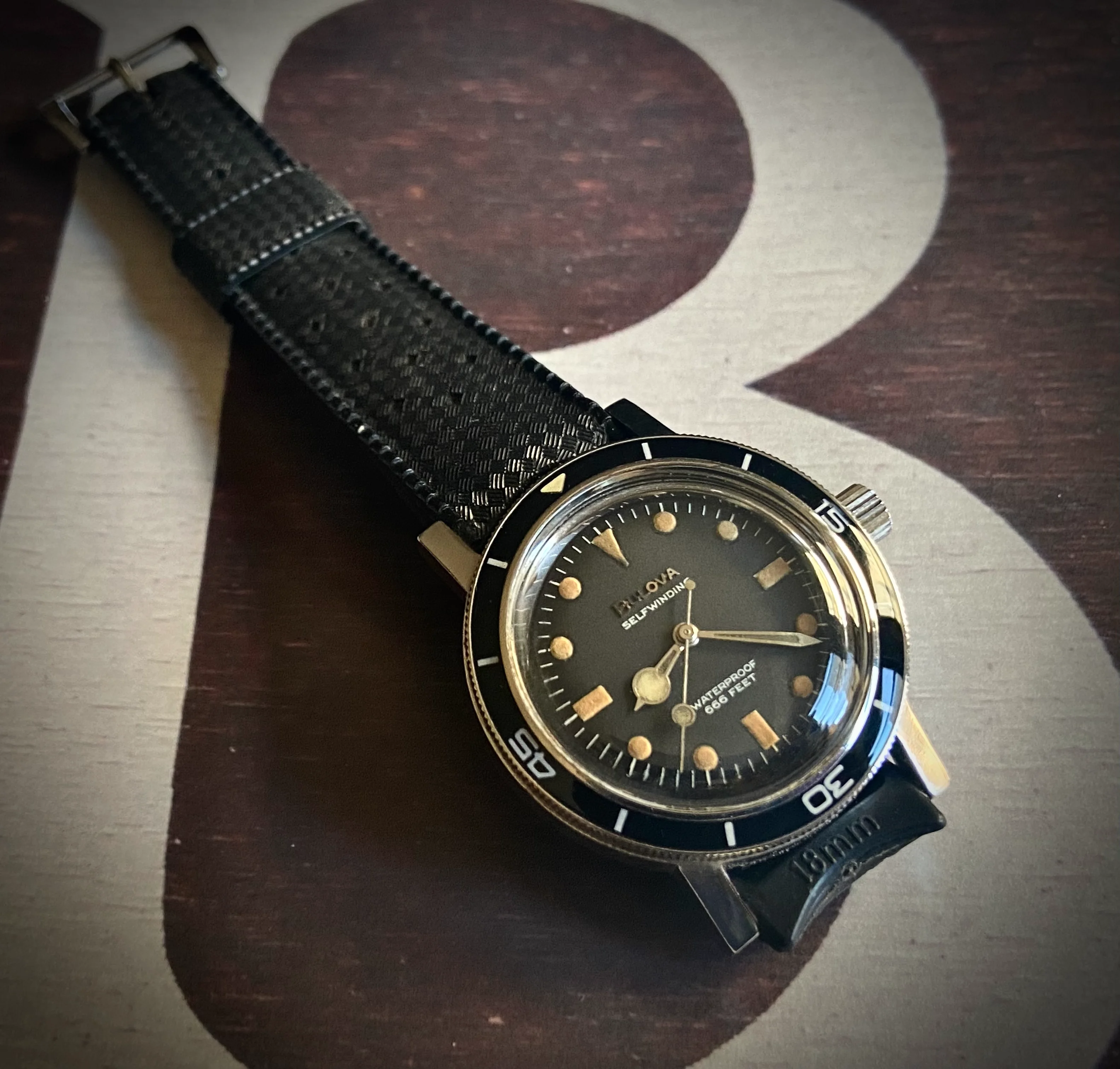

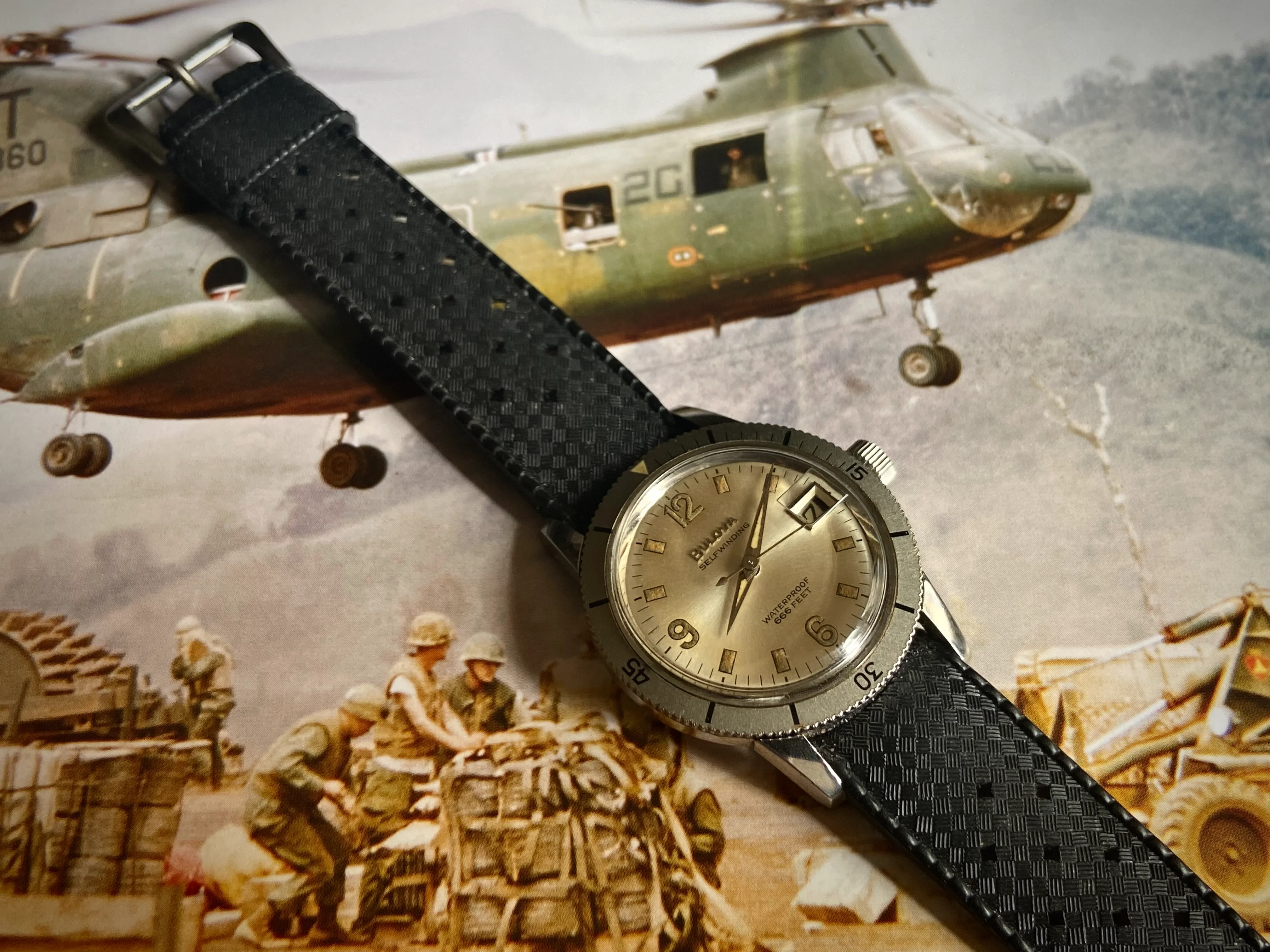

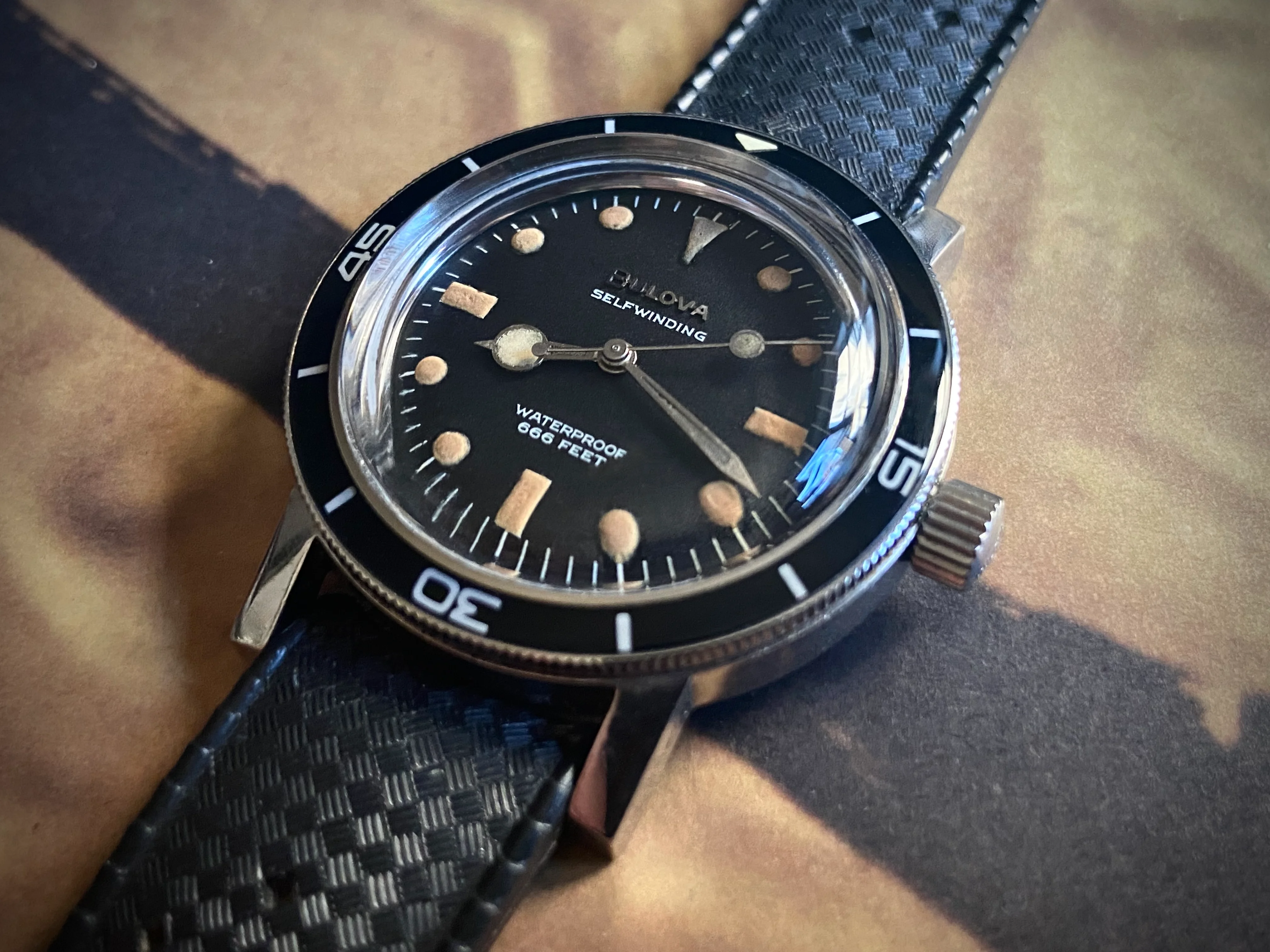

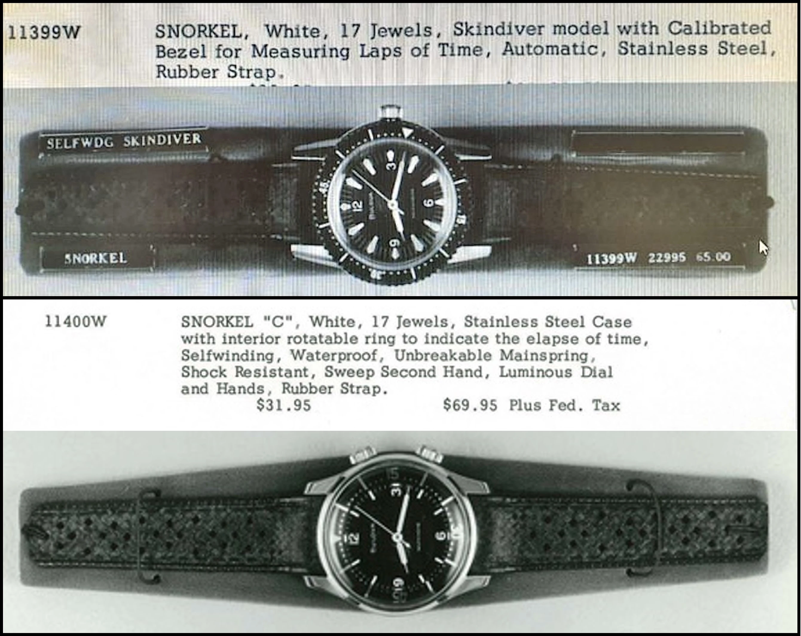

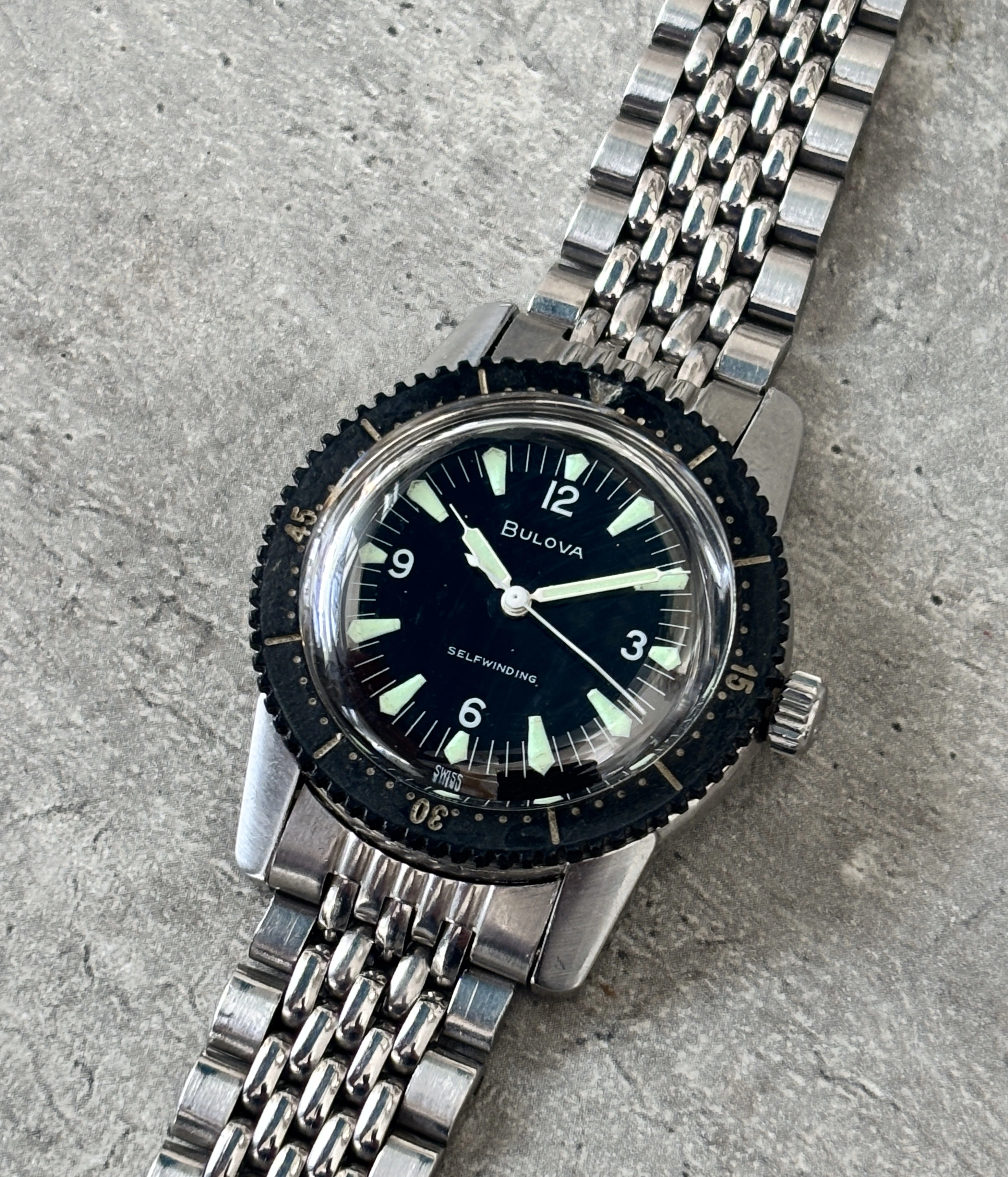

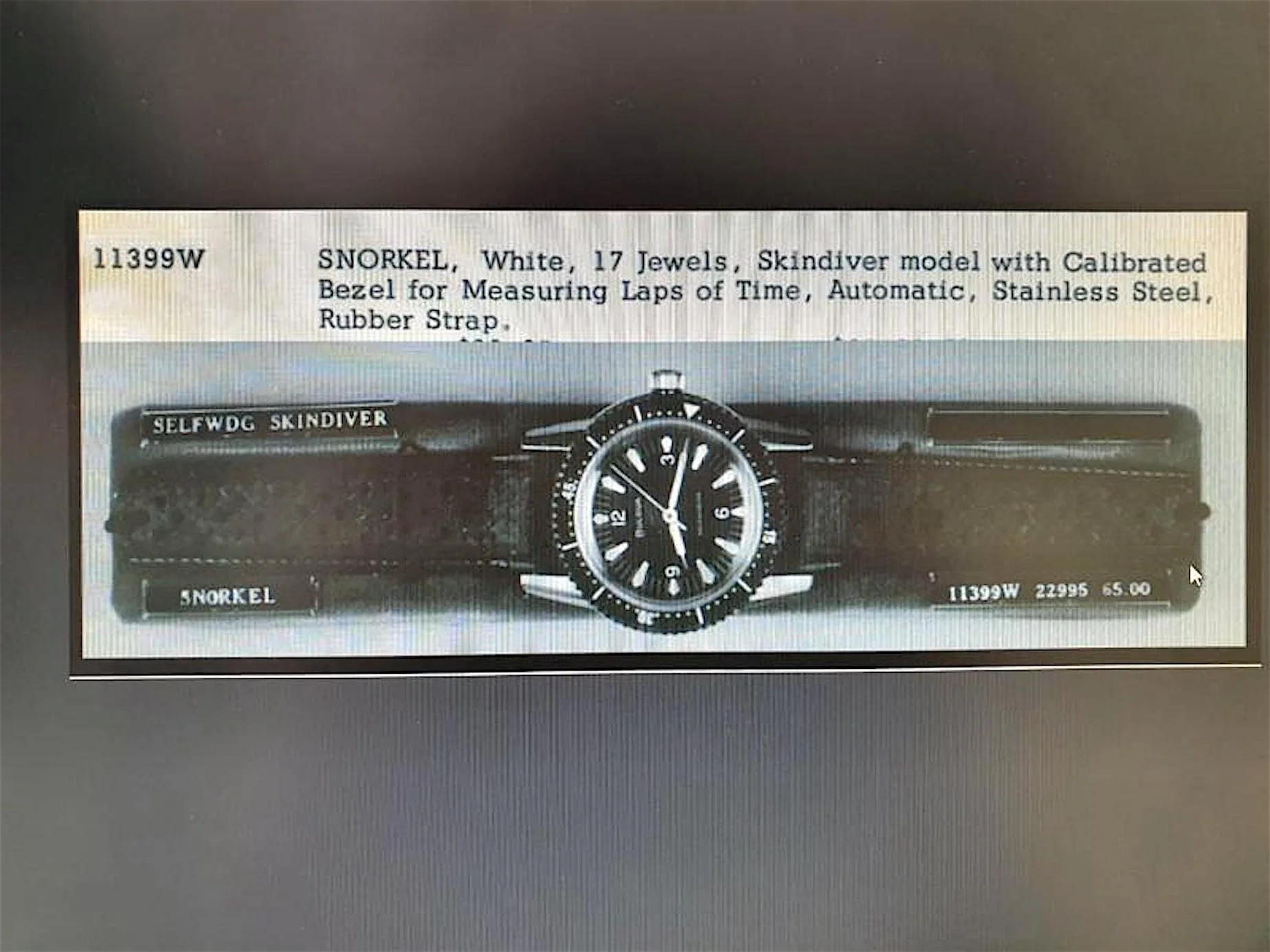

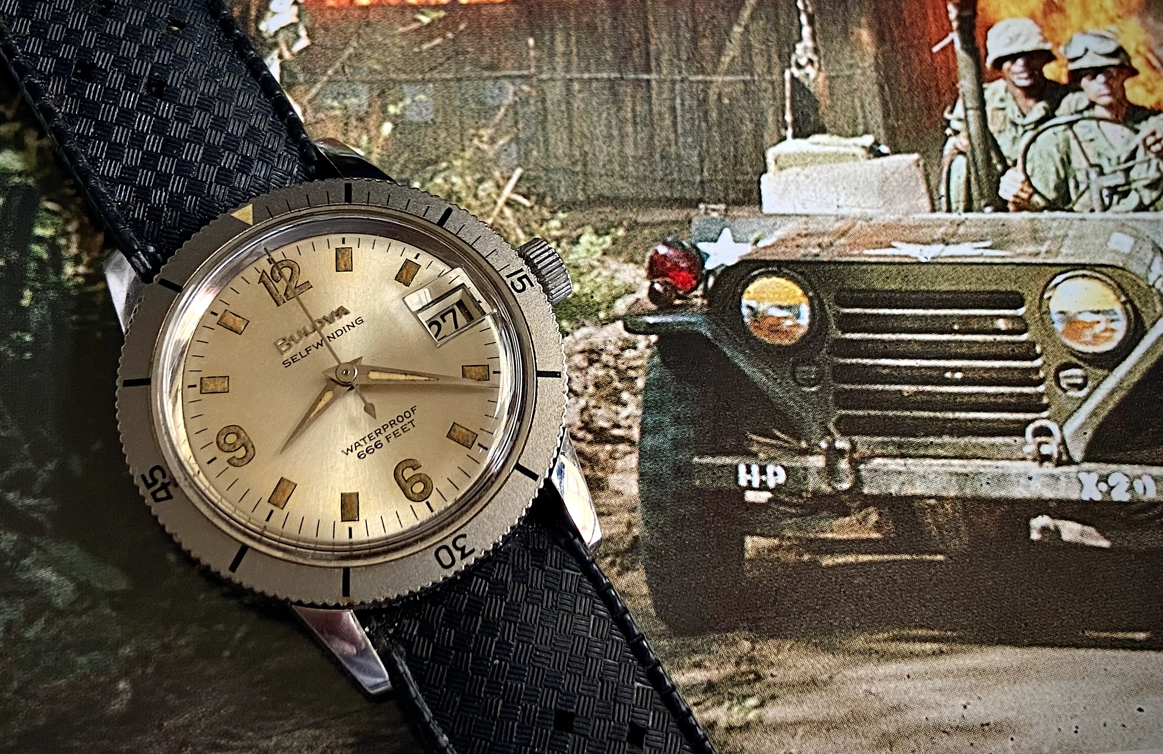

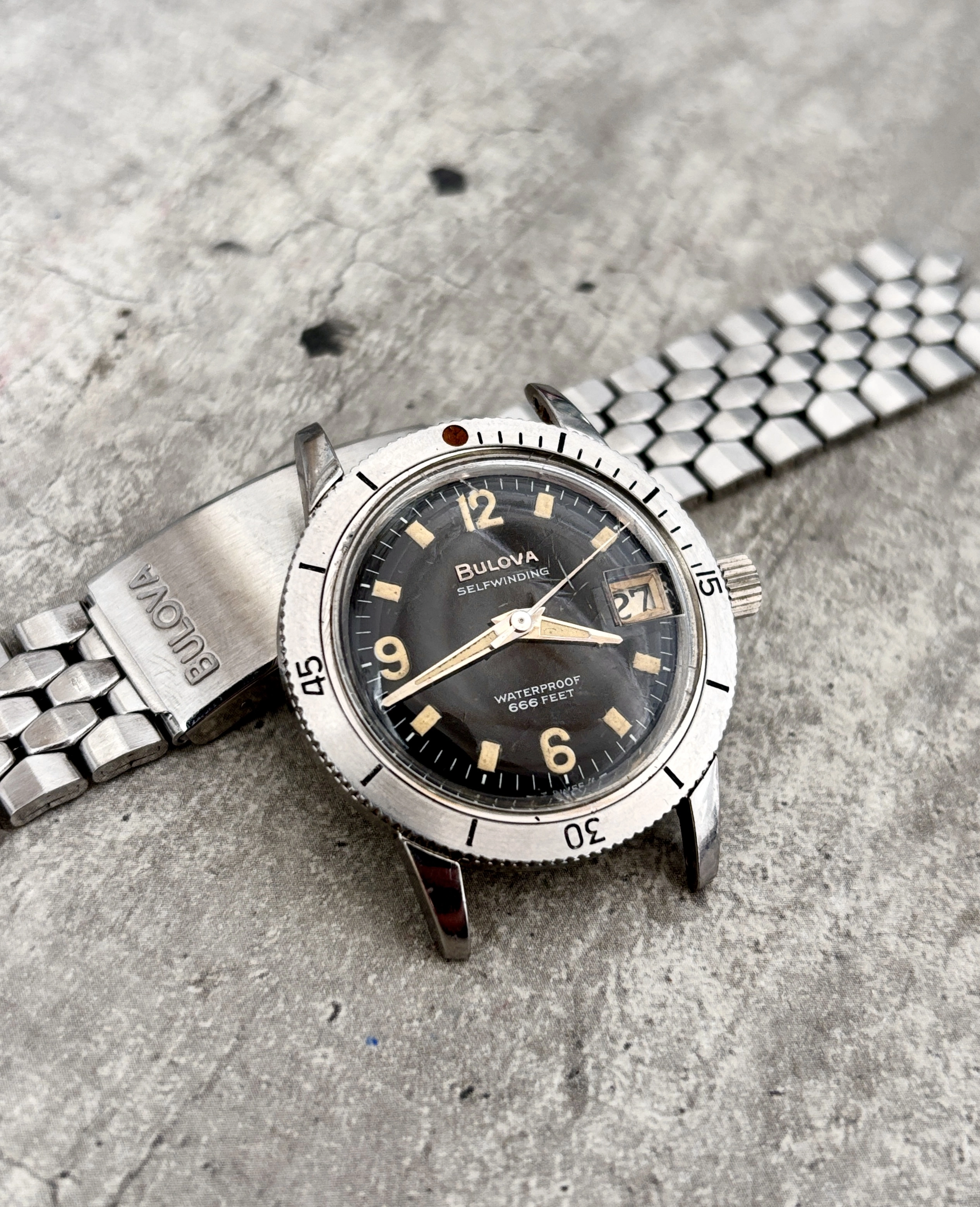

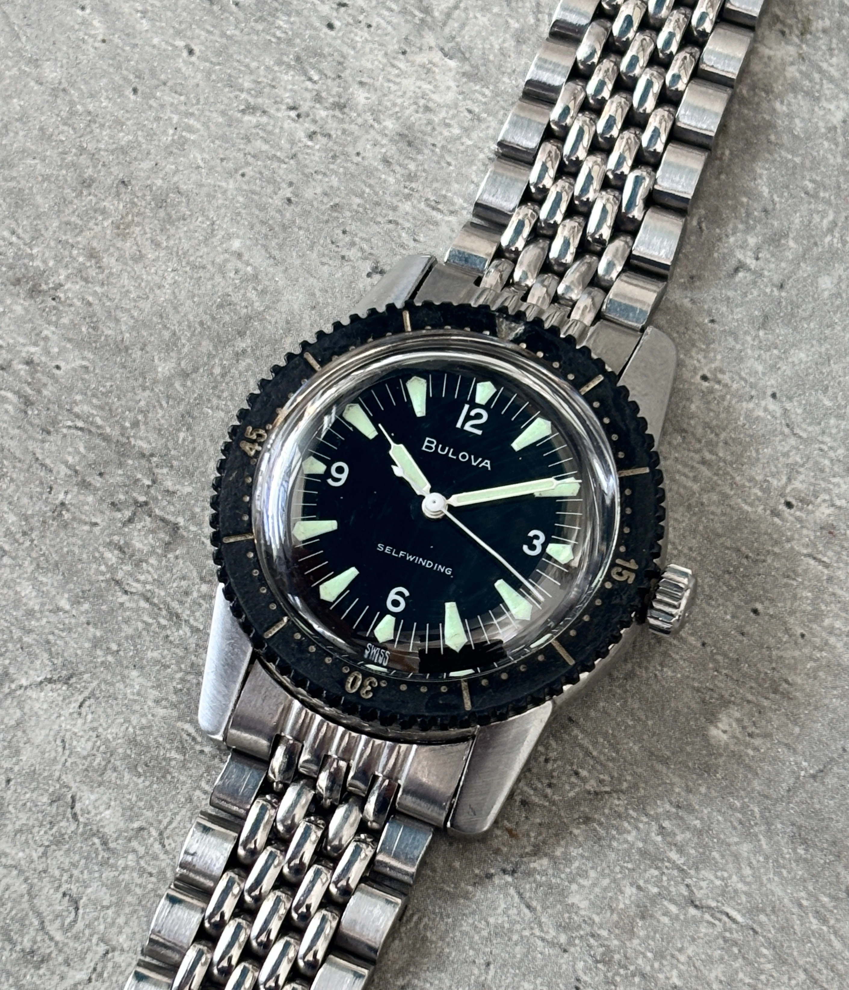

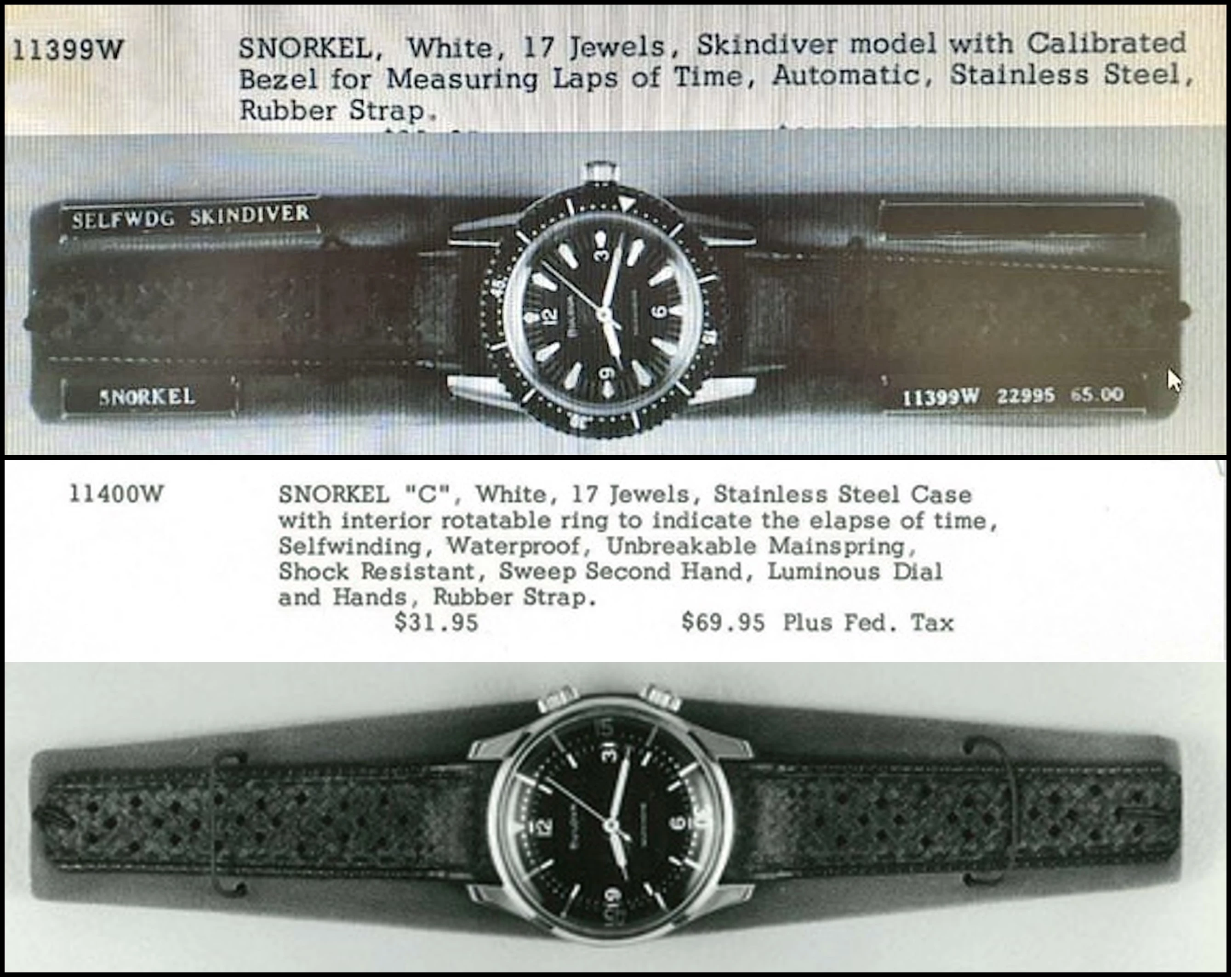

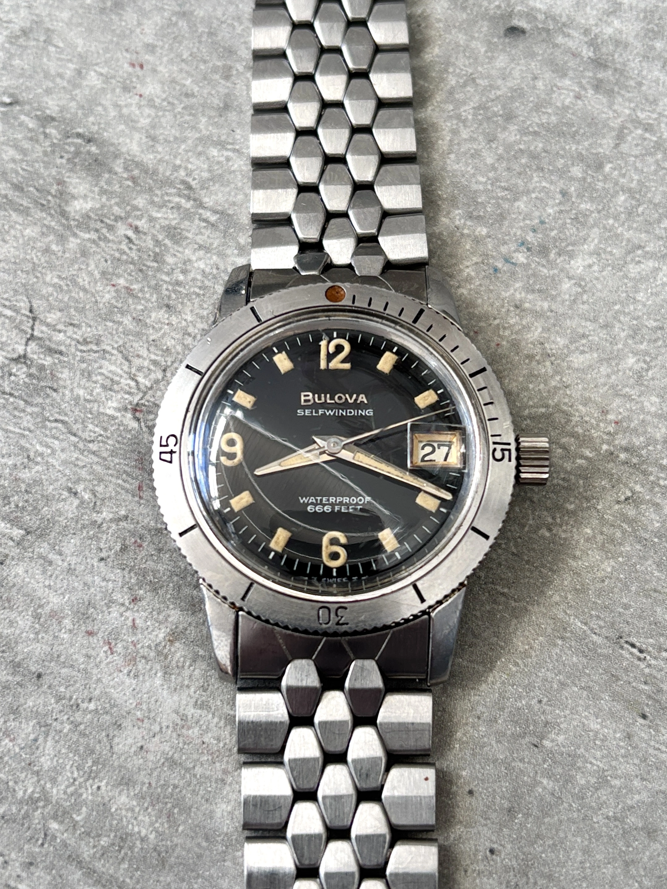

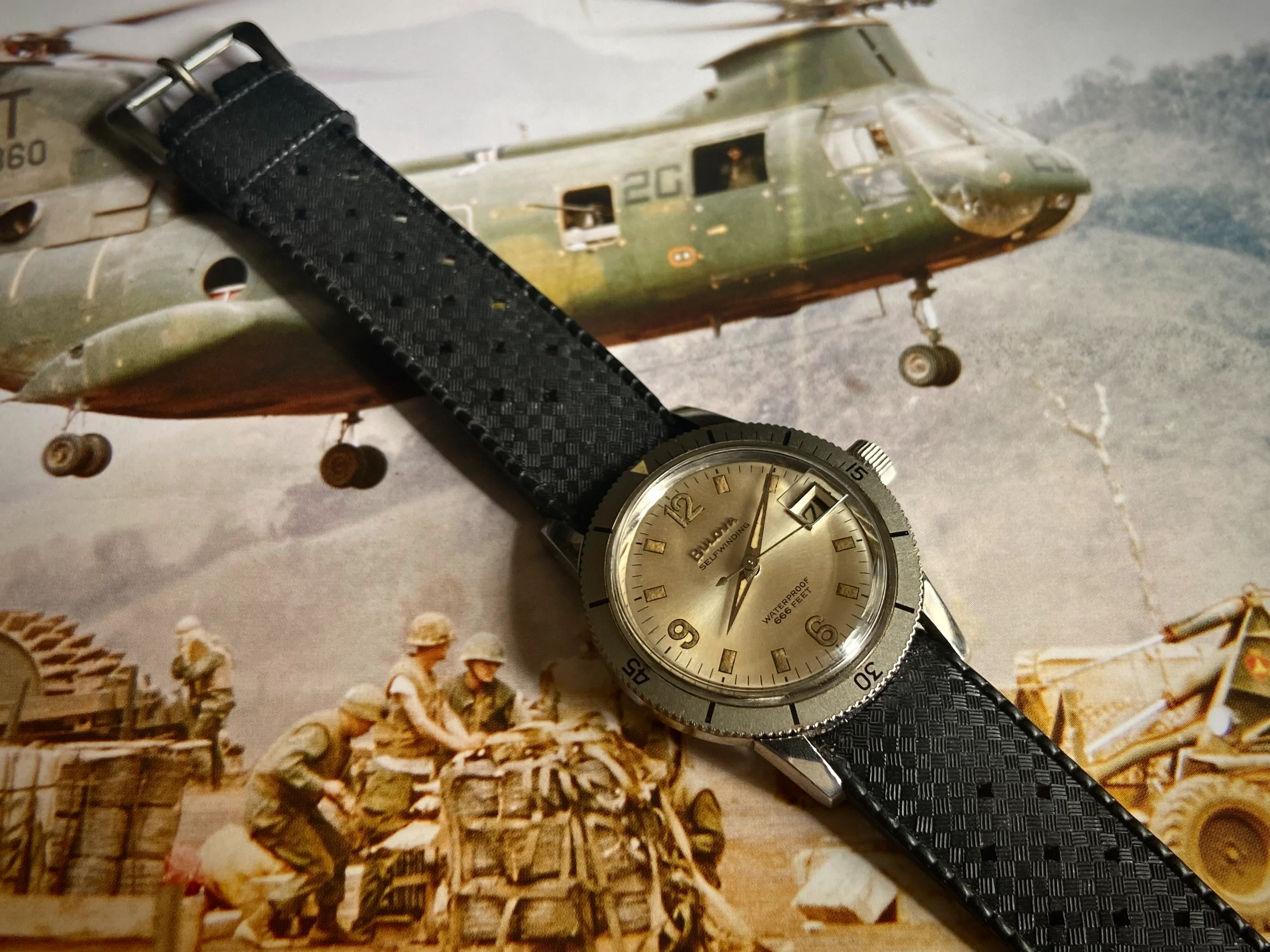

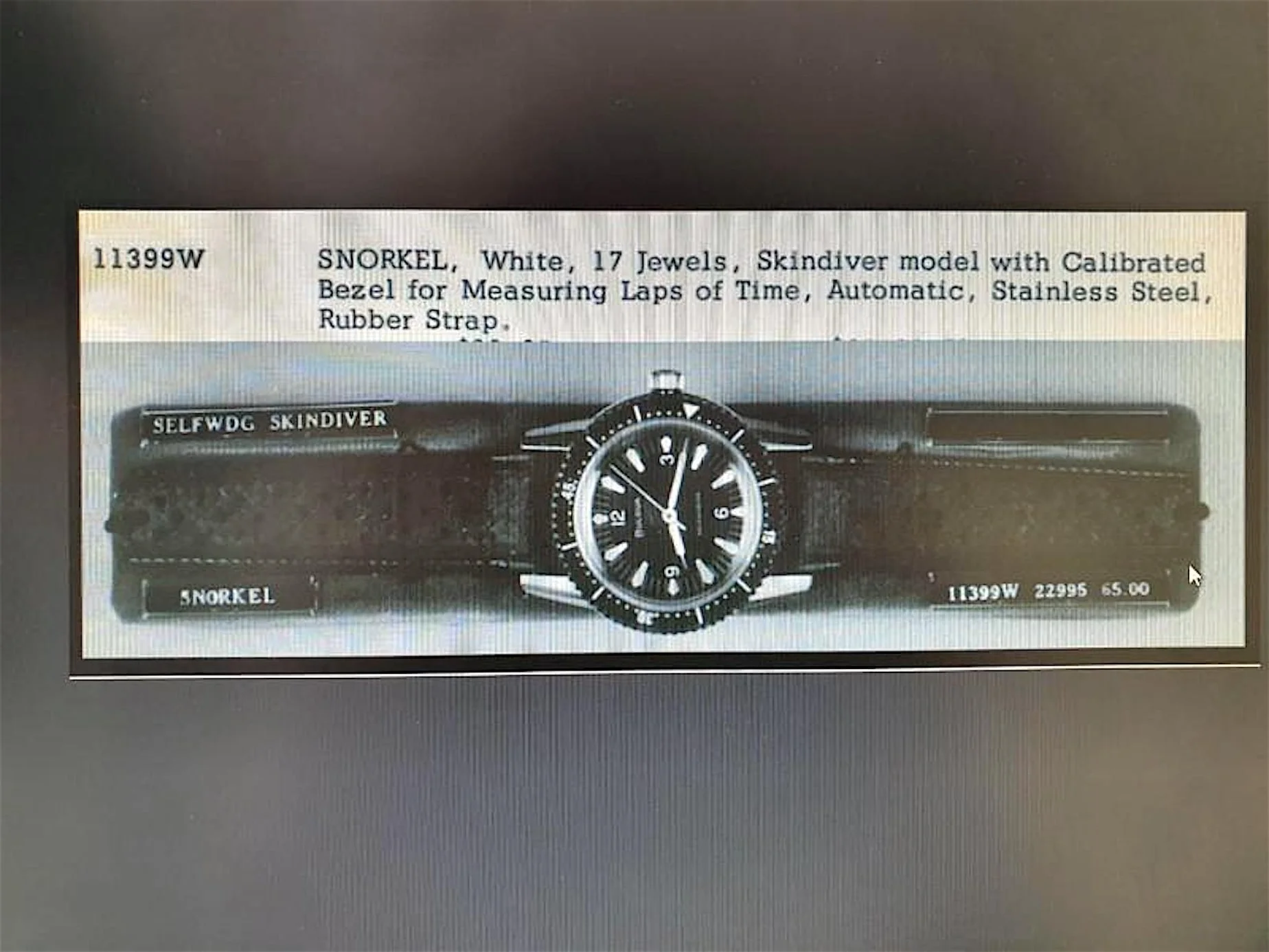

1961 Bulova Snorkel Skin Diver - Single Crown Compressor - Ref. 11399W - Cal. 11AFAC automatic movement - This model is often referred to as the "Bulova Nautilus" due to its resin bezel being almost identical to the Longines Nautilus Ref. 6921 from the same era. These are quite, only produced in 1961 & 62, and especially hard to find with delicate bezel intact.
In 1961 Bulova entered into the recreational diver's watch market offering two unique models: the "Snorkel" (Ref. 11399W) - a 36mm Single Crown Compressor Skin Diver & the “Snorkel C” (Ref. 11400W) - a 42mm Dual Crown Super Compressor. Both models utilized the cal 11 AFAC movement and were housed in EPSA cases by Ervin Piquerez SA, which is easily recognized by the trademark Bell Dive helmet on the case back. These cases were designed with a spring-loaded case back that compressed under water pressure, sealing the watch more tightly as the depth increased.
The EPSA case was rated to 600 feet, however Bulova pushed the limit to 666 feet. By exceeding the 600-foot standard, Bulova set itself apart from its competitors and emphasized the ruggedness and reliability of its watches. From a marketing perspective, the "666 ft" number stood out, making the watch instantly recognizable and ultimately becoming what we refer to today as a "Devil Diver".
While the one year 1967 Bulova Snorkel Model J grabs attention for its Bathyscaphe styled case, the 11399W Snorkel Single Crown Compressor stands out with its Nautilus style resin bezel, coffin indices, syringe hands, and EPSA case. Truly an "OG" in the Bulova “Devil Diver” world.

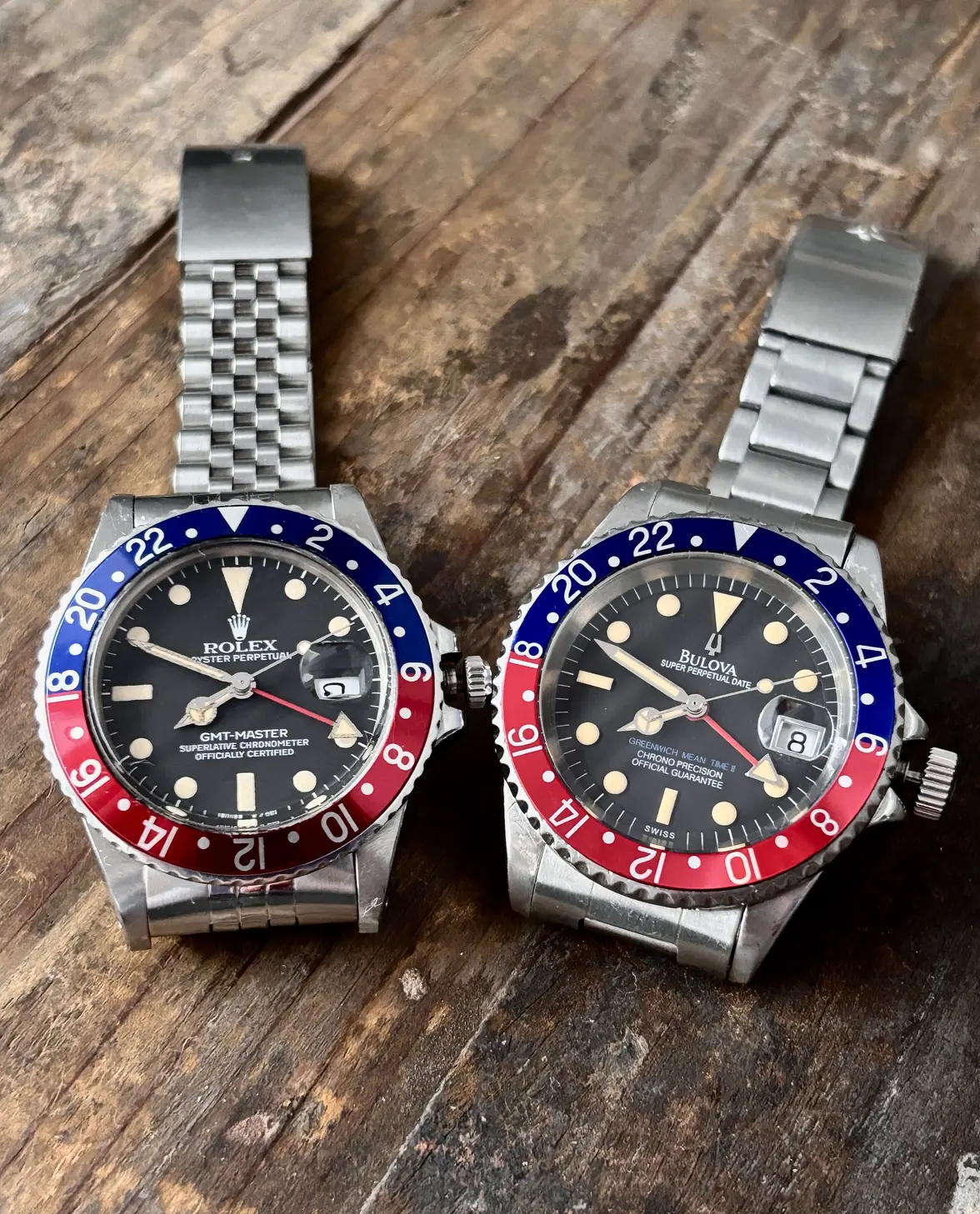

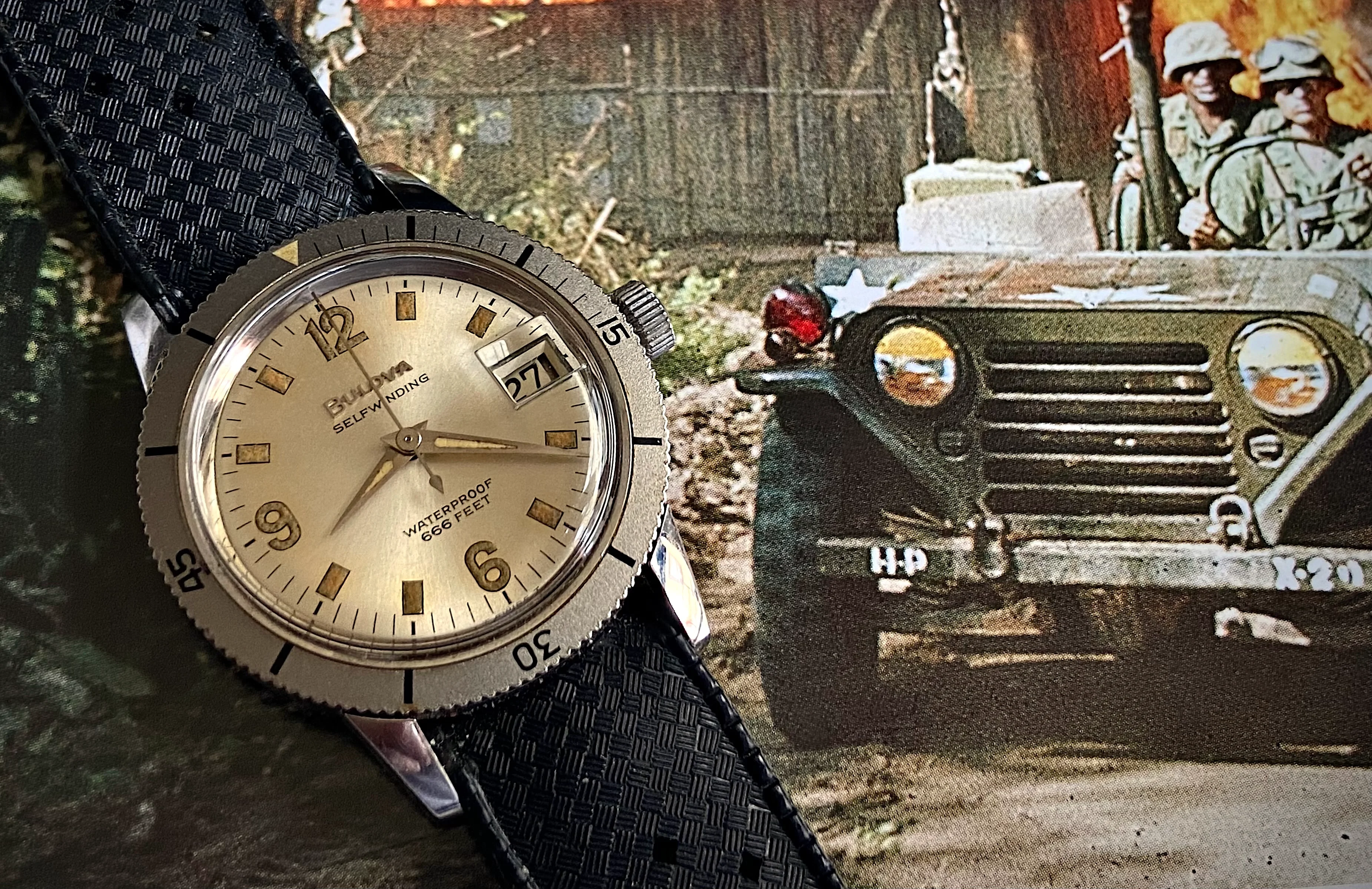

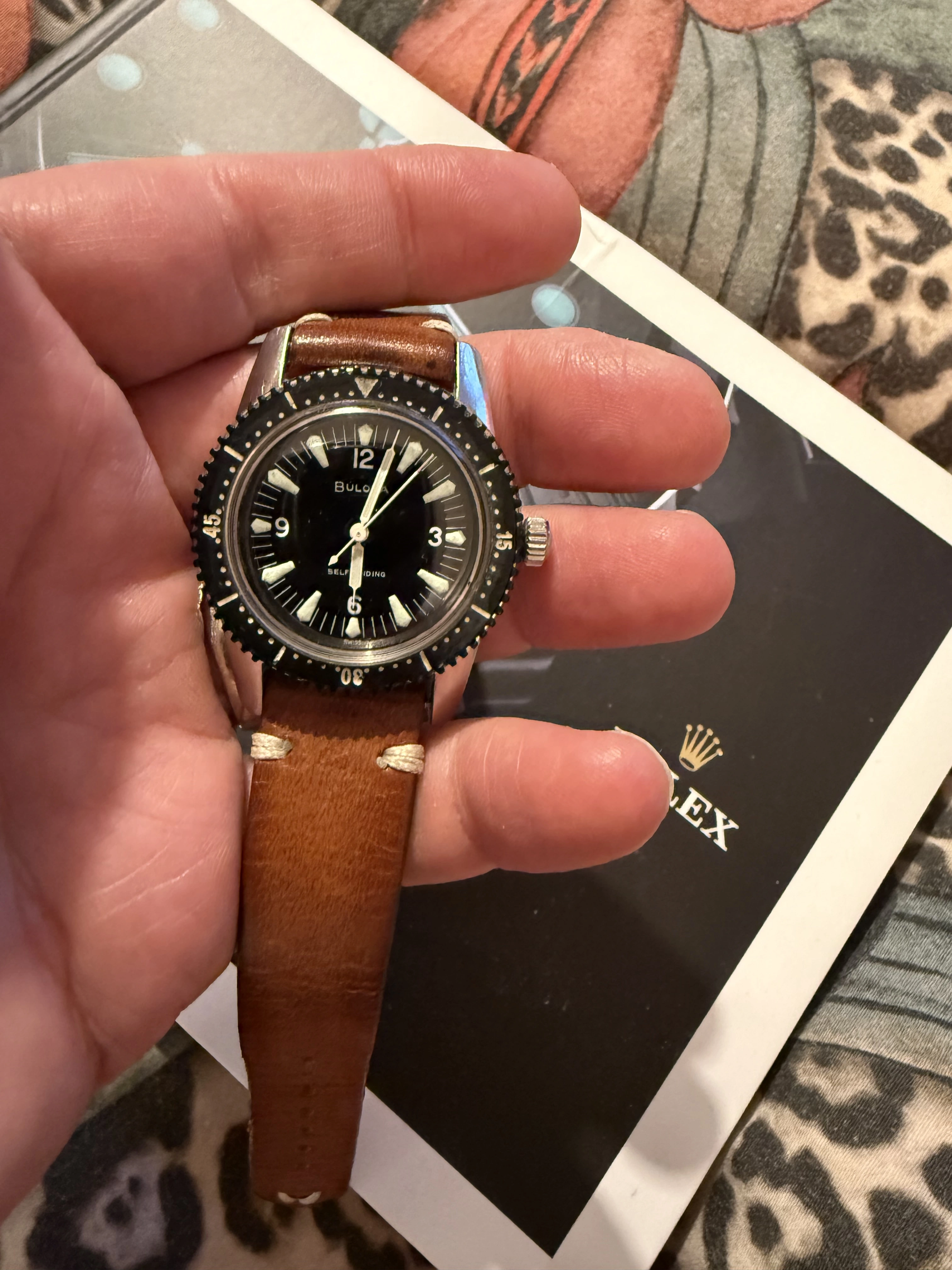

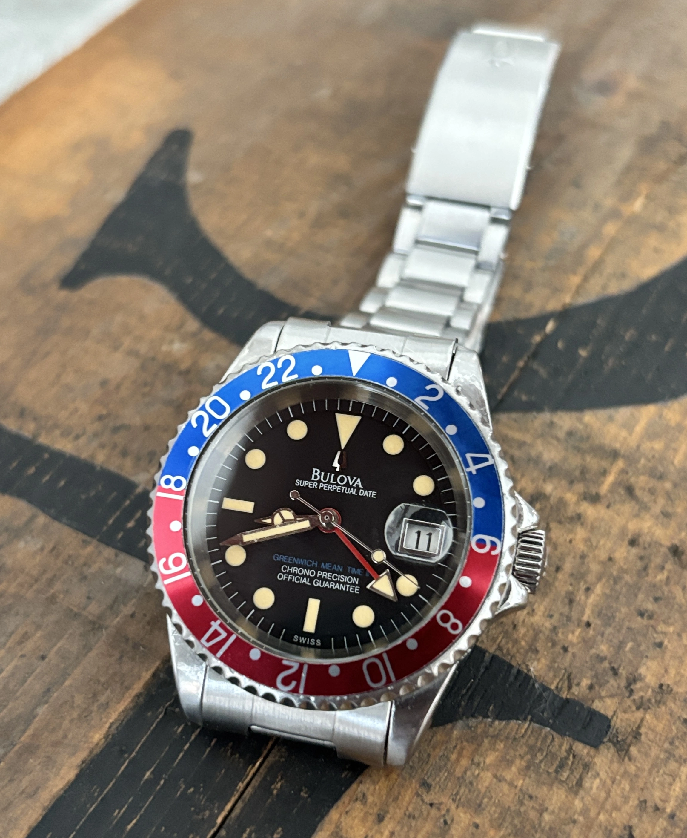

Neo-Vintage Bulova Super Perpetual Date GMT II - Ref. 91692 - Powered by a Bulova signed ETA 2836A movement.
There’s a long-circulating rumor surrounding these watches involving a dispute between Bulova and Rolex over design similarities—possibly related to trademark or trade dress issues (I’m not a lawyer, so take the terminology loosely). According to the story, Bulova allegedly moved remaining stock to Indonesia and other Far East markets, where trademark enforcement was minimal at the time, in order to sell them off. I haven’t been able to verify this, and it remains anecdotal, but it’s a story that continues to follow these models.
From what I’ve been able to determine, there were at least two references produced: 91692 and 93381. Multiple dial and bezel configurations exist, including Pepsi, Root Beer, all-black 24-hour, and others.
The movements are modified ETA 2836A calibers converted from a day-date configuration to a GMT layout, an approach that was used in several GMT models of the era and is still seen in some GMT watches today. These examples are Bulova-signed. Interestingly, it appears that the conversion was orignally a aftermarket modification which was later adopted by ETA for the same purpose.

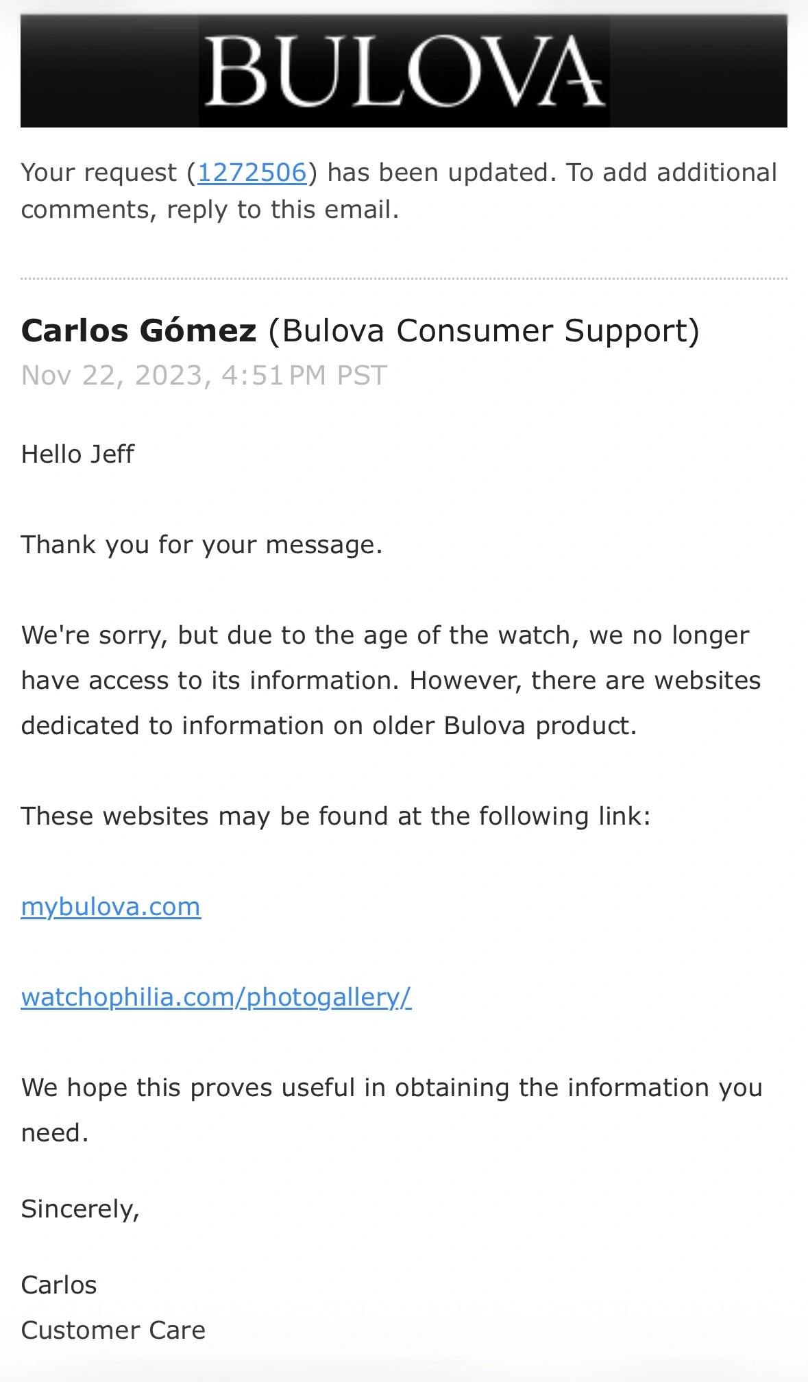

A few years ago, I contacted Bulova’s historical department seeking more information. I was told that after Citizen’s acquisition of Bulova, access to detailed records for many vintage and neo-vintage models was lost or no longer available, leaving much of this period undocumented by the brand itself.
If anyone has verified information, production details, period advertisements, or firsthand knowledge to add, please reply below.

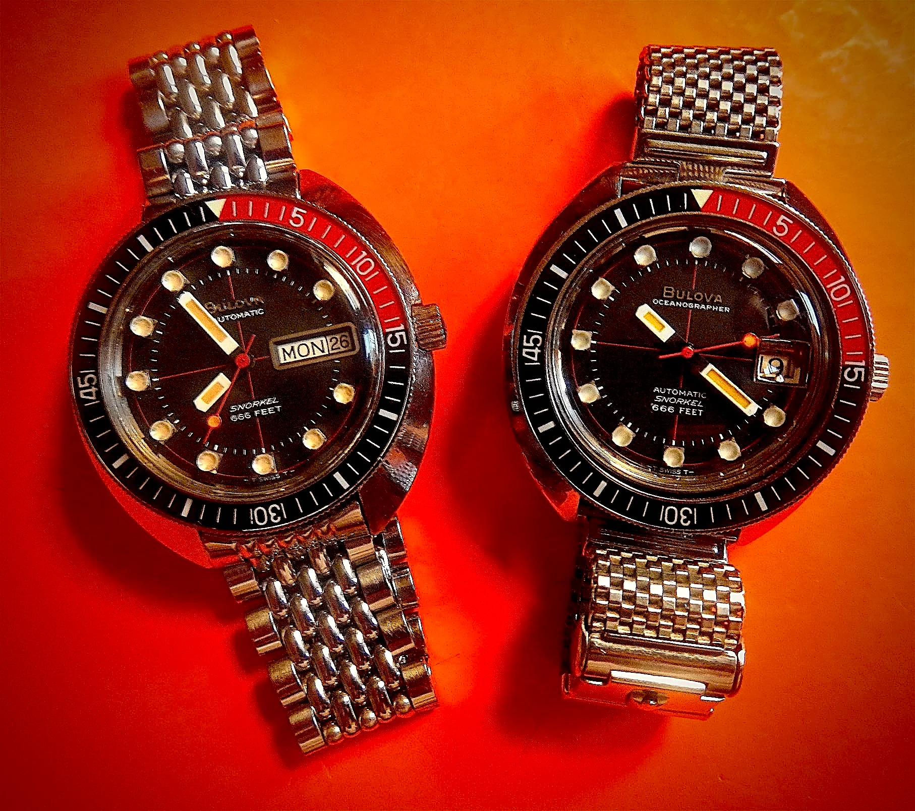

THE MORE YOU KNOW

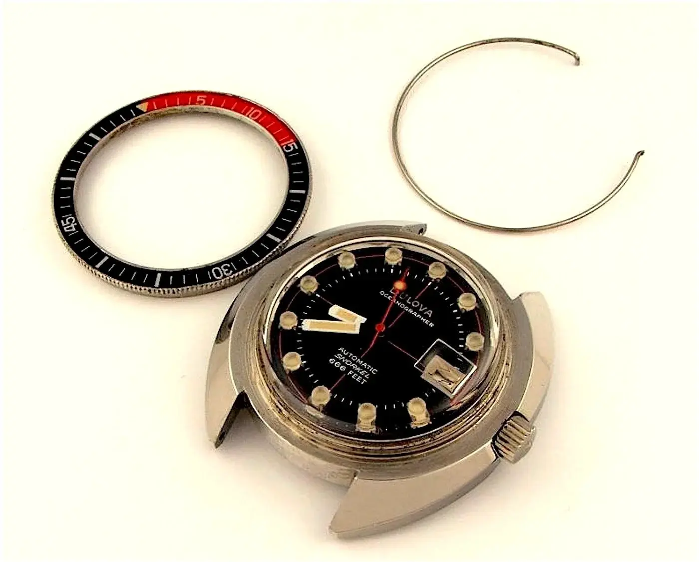

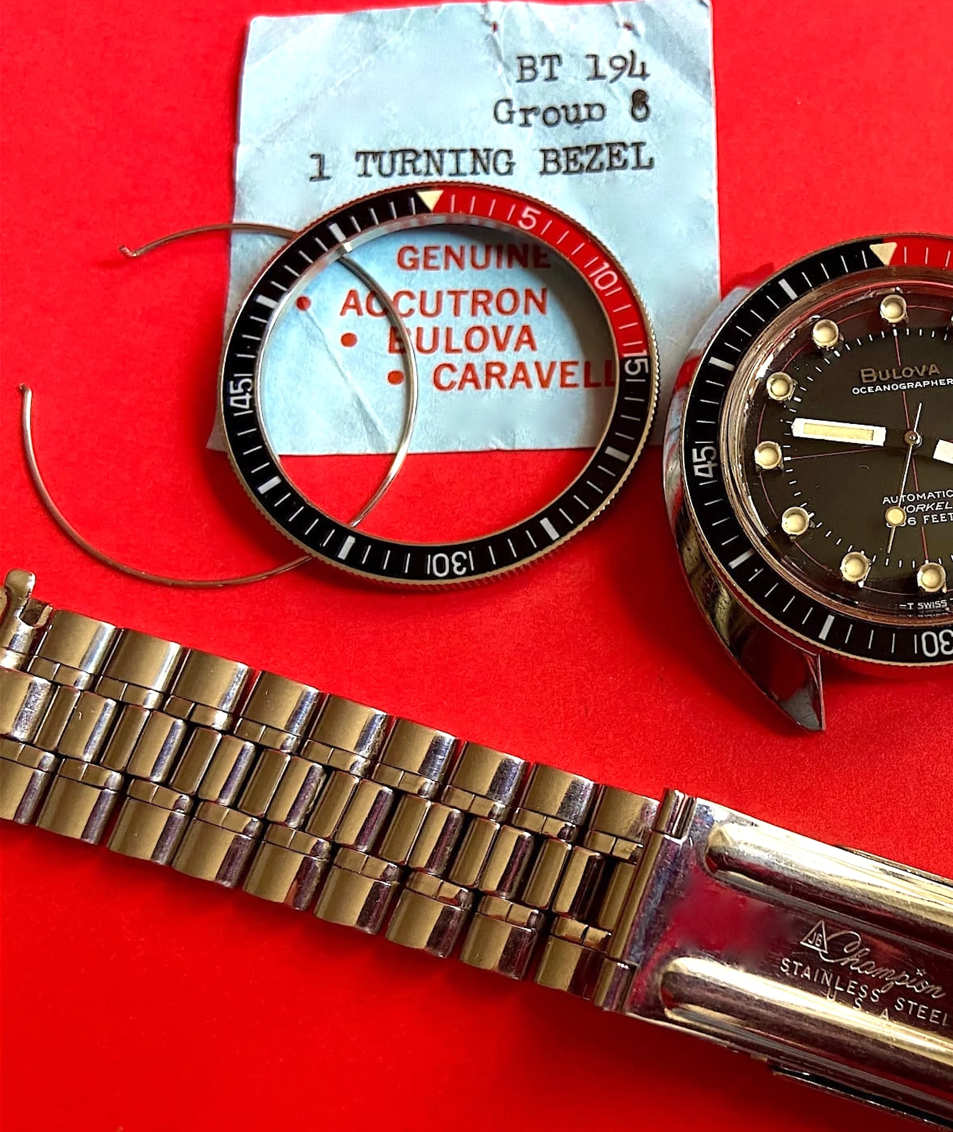

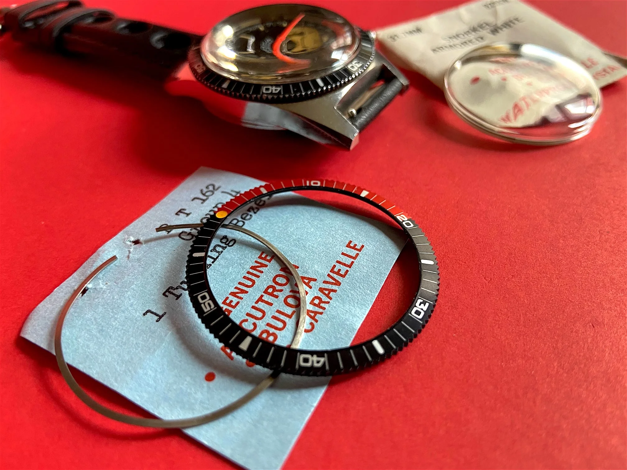

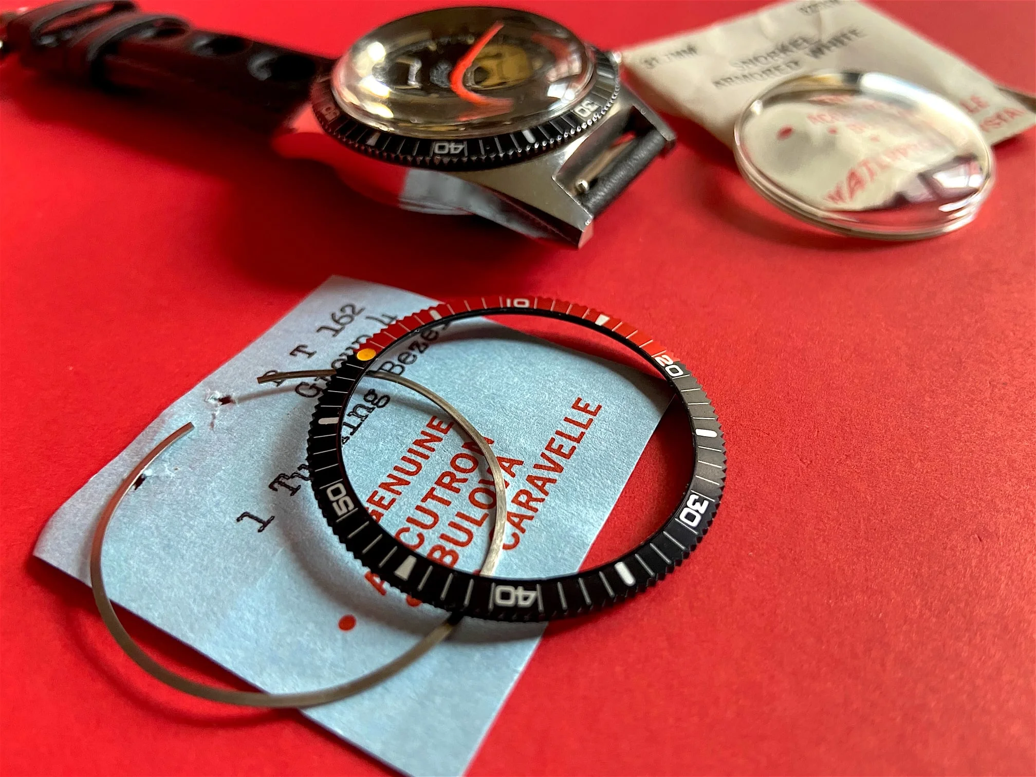

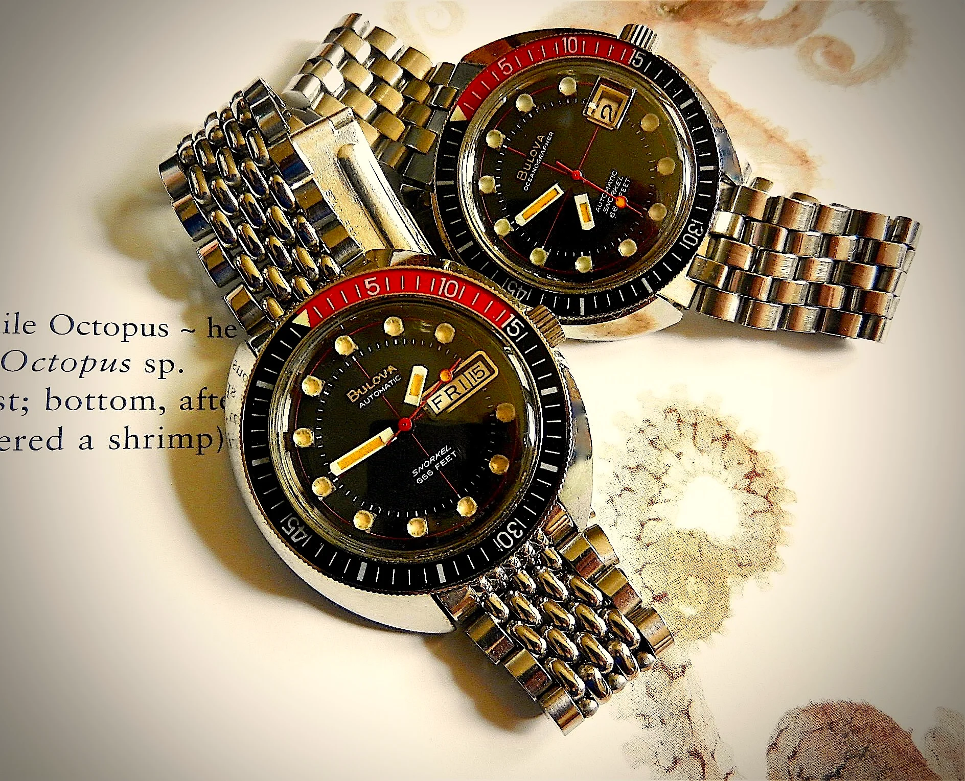

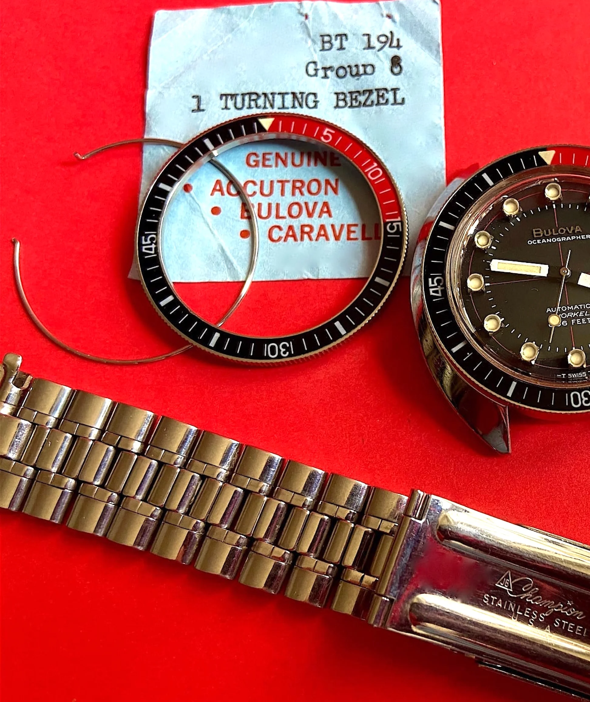

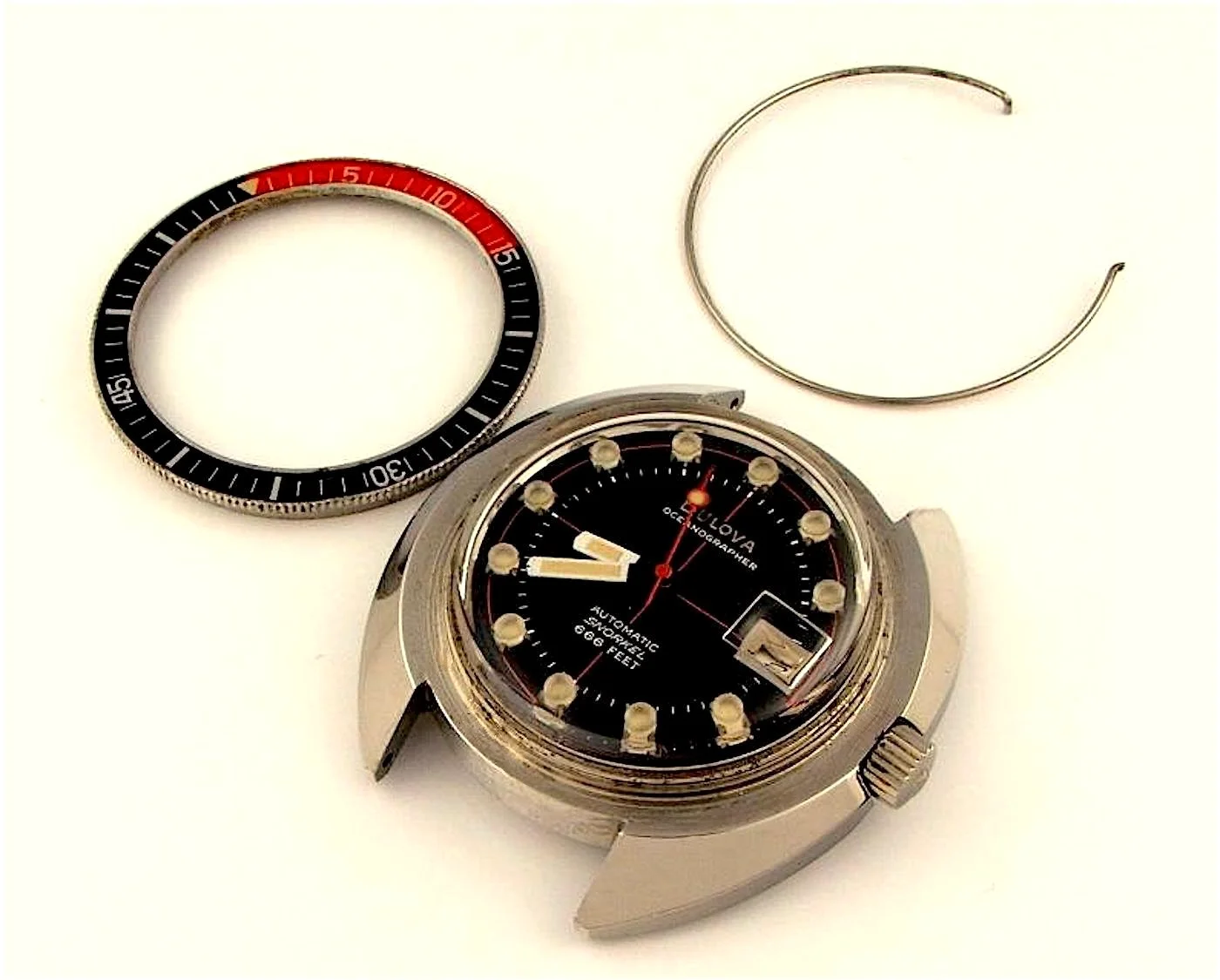

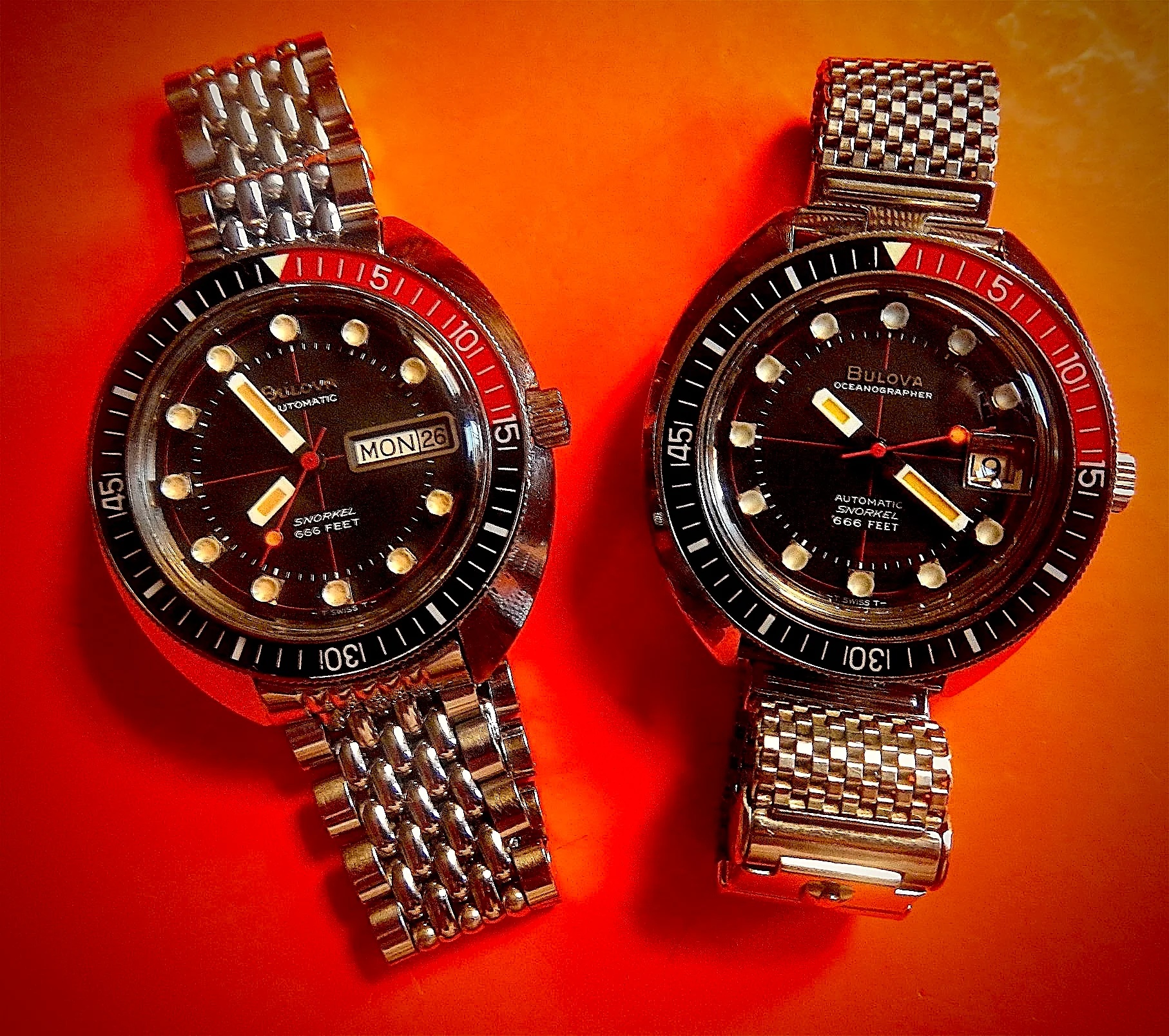

COKE BAKELITE BEZEL ref.# BT-194 with DETENT SPRING
for BULOVA SNORKEL 666FEET OCEANOGRAPHER series case ref.# 714
Case reference # 714 that housed the date-only cal.# 11BLACD mvmnt. is equipped with a unidirectional 60-click rotating Bakelite (coke) with a grooved interior bezel. The bezel rotation is controlled by a detent or tension spring mechanism (aka: click spring).
NOTE THAT ...
The friction-mounted (no-click) bezel was used on case ref.# 7095-1, which housed the day-date movement cal. 11AOACB.

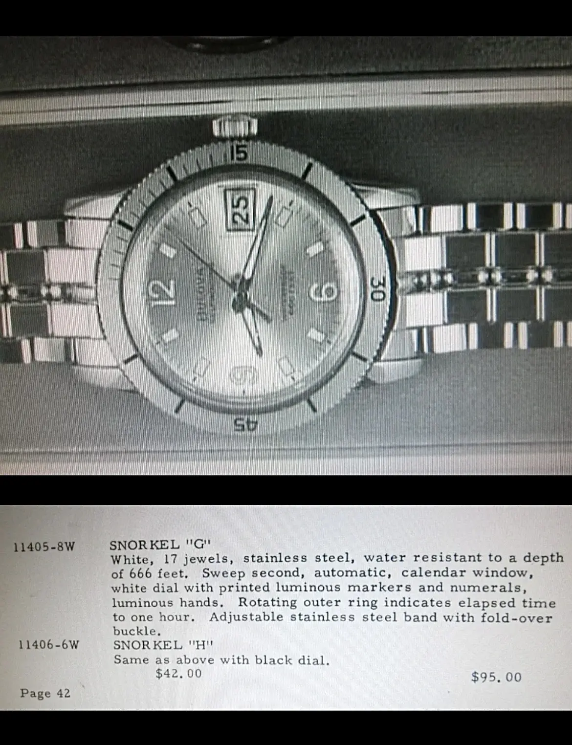

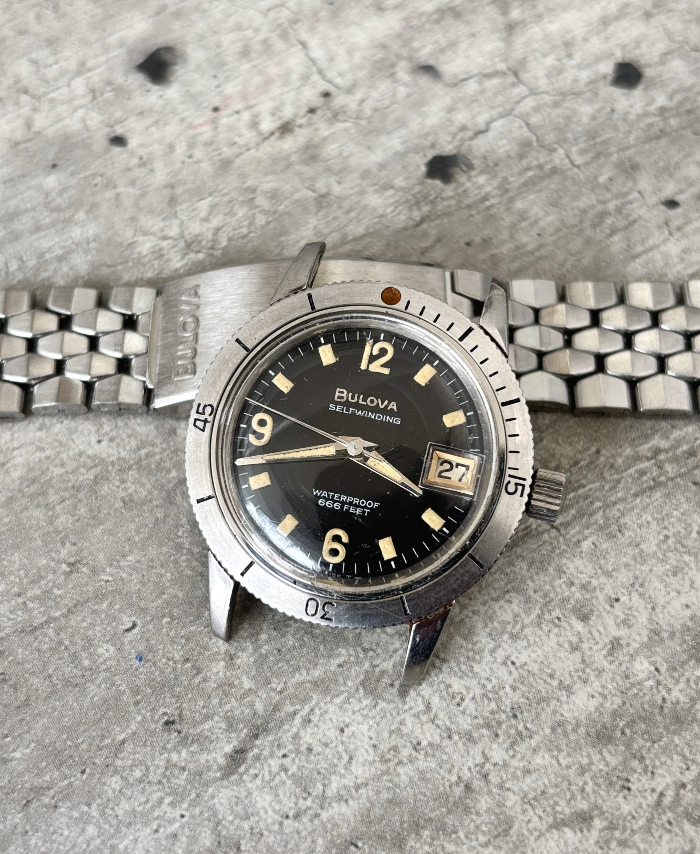

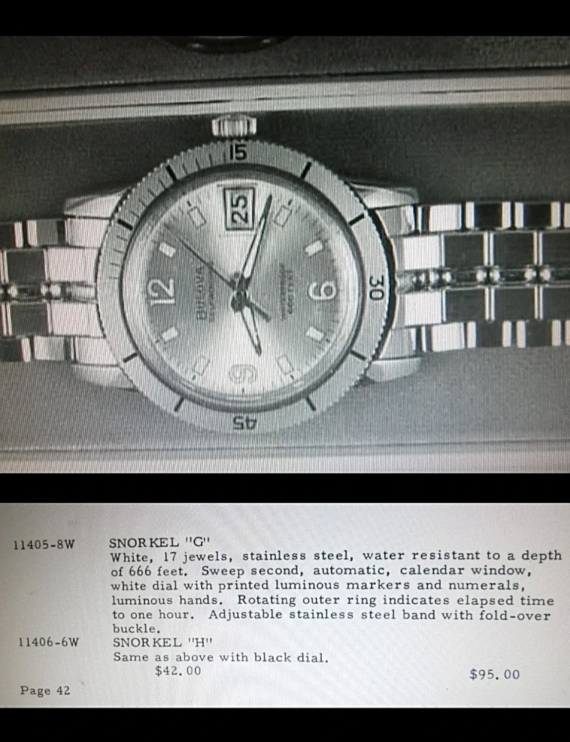

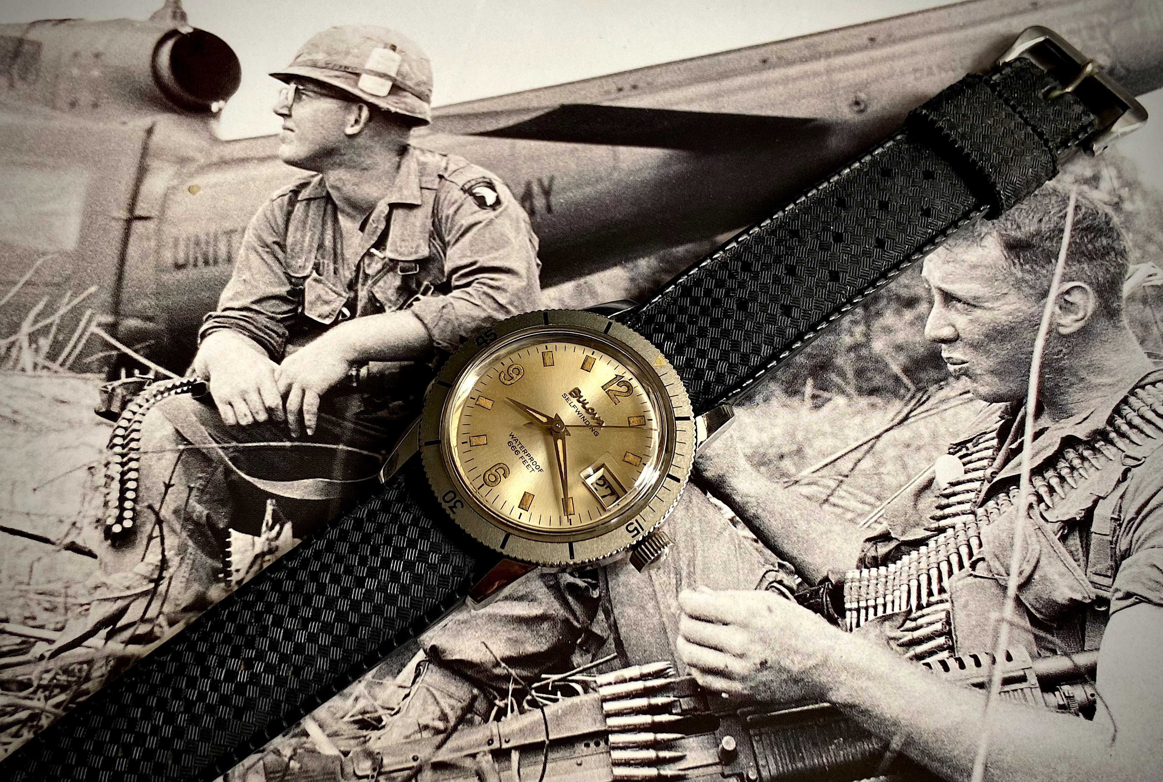

1st execution 1967 Bulova Snorkel “Devil Diver” - Ref. 11406-6W - early “Pre-Snorkel” dialed version - 35mm with date, powered by a Bulova 11ALACD automatic 17J movement.
This is paired with the “HOLY GRAIL” of Bulova and Caravelle bracelets, the Snake Scales / Coffin-Link, an exceptionally rare period bracelet. These would have originally had 20mm ends and been primarily fitted on the Caravelle Sea Hunter - Ref 49482 (the 35mm, Full Swiss Automatic version) from 1967-1969.
This example (found loose in the wild without its ends) has been fitted with vintage 18mm end links, pairing beautifully with this Snorkel, maintaining strong period and brand correctness. Of note, traditionally the 11406-6W is seen on a JB Champion “Bambi” bracelet.
The 11406-6W was introduced via advertisements in late 1966 and appears to have been launched into production in 1967. The “Pre-Snorkel” appears to have been produced for approximately 2 years in 1967 & 1968 and was also available in a white dialed version Ref. 11405-8W
This model is often incorrectly called Ref. 386 due to the case etch, however that is the case model number stamping. There is also a 2nd generation (1969 and later) version where the “Snorkel” name now appears on the dial, and case etch 386-1 is present.
Both generations have the 666FT depth rating on the dial that Bulova boldly began marketing in 1961 to differentiate their diver introduction from the competition. Bulova and Caravelle divers carrying this designation aptly became known as “Devil Divers” to collectors and enthusiasts.

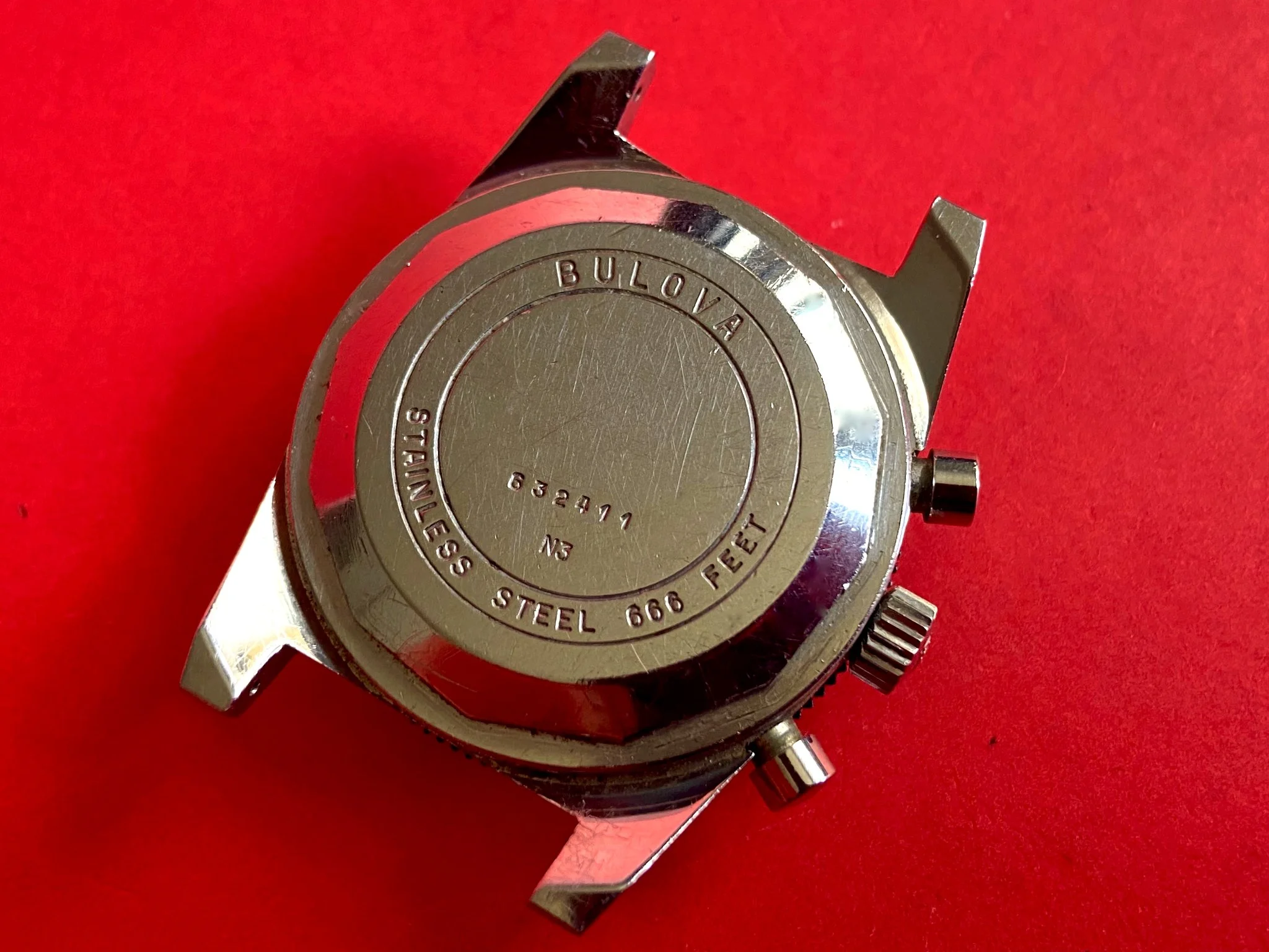

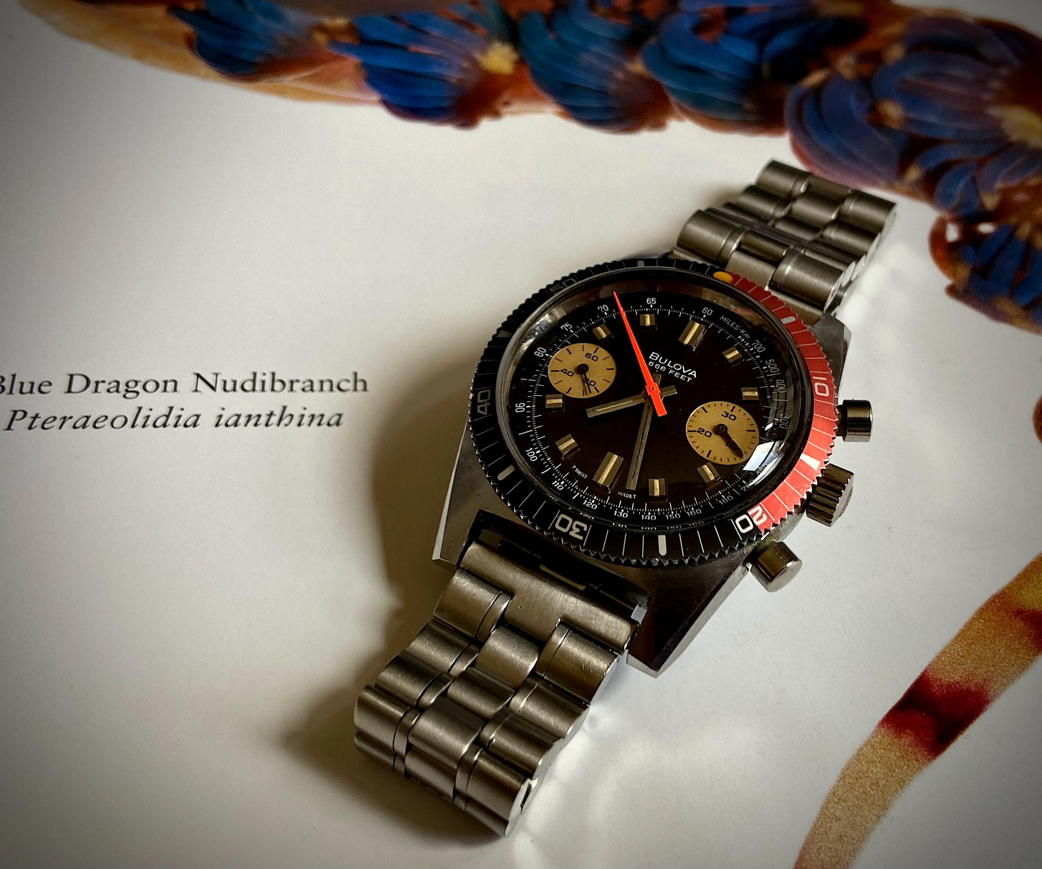

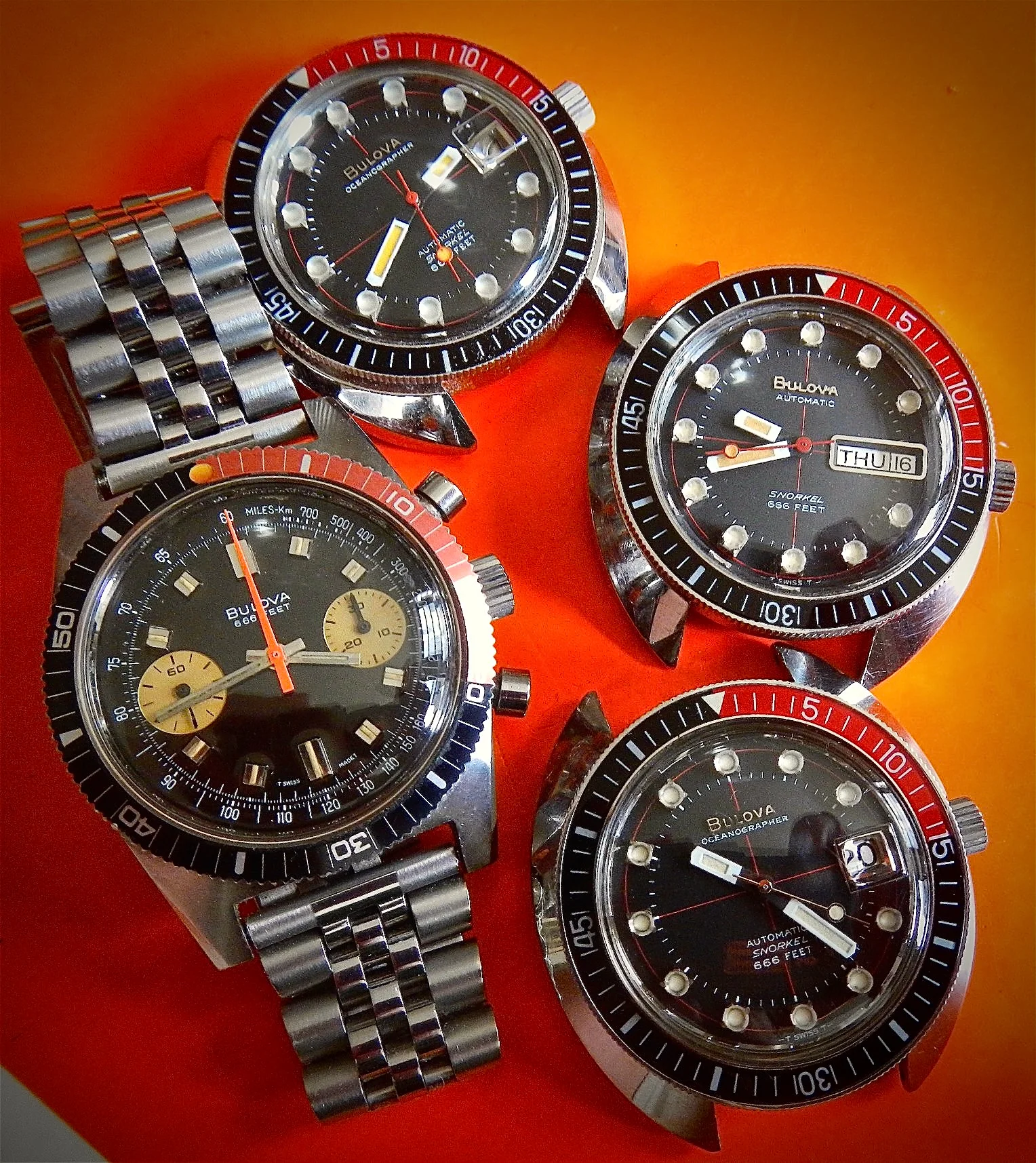

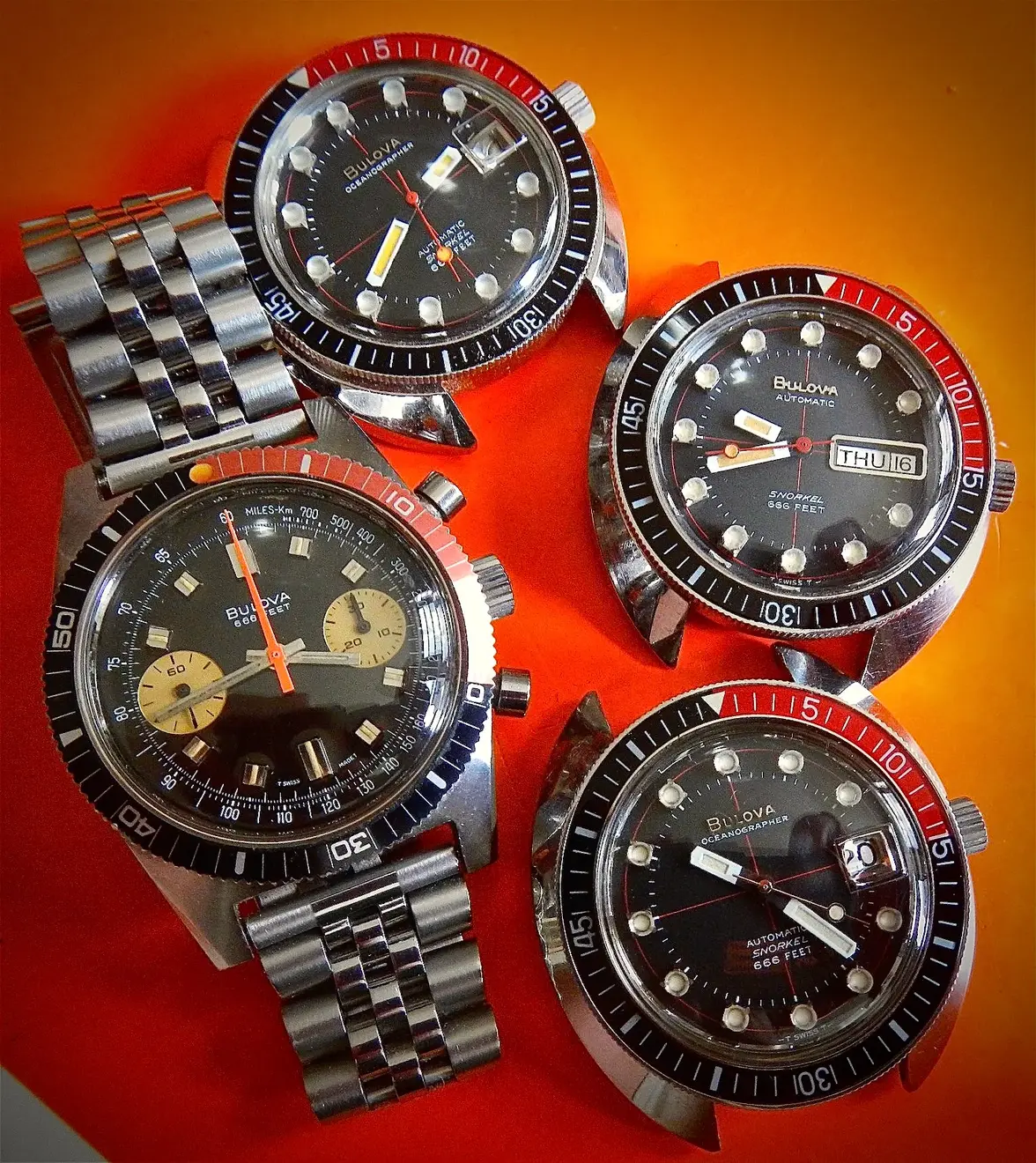

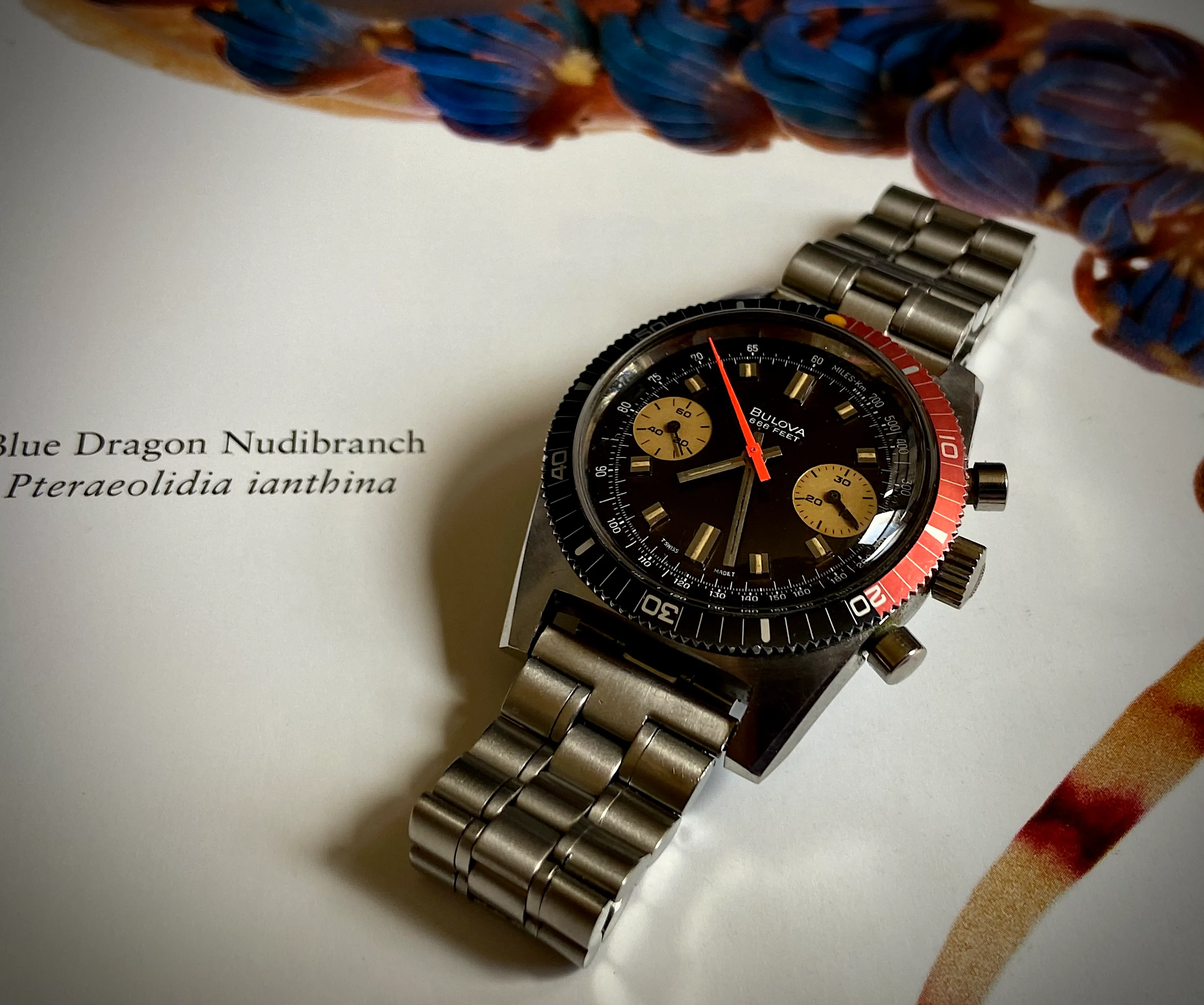

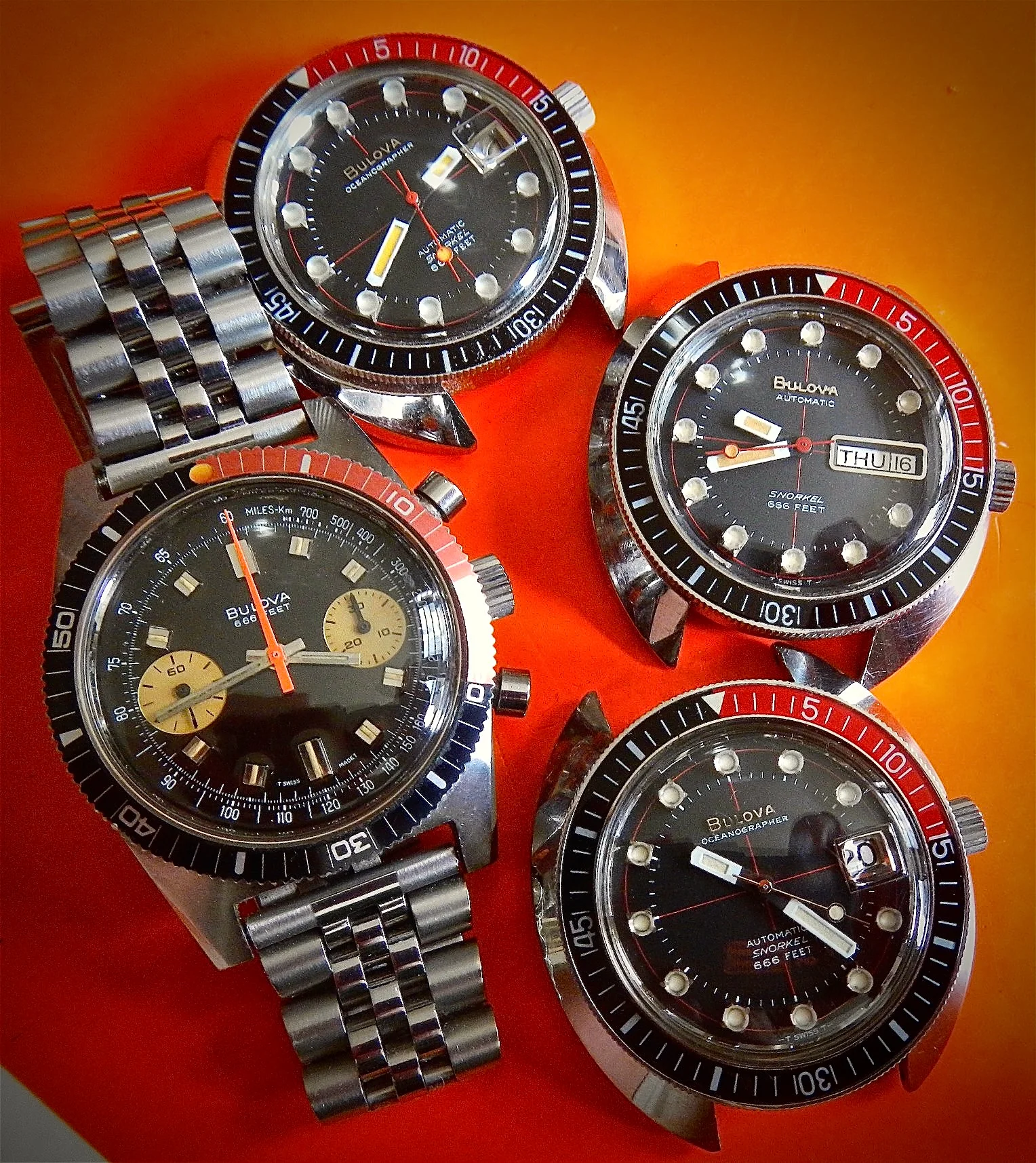

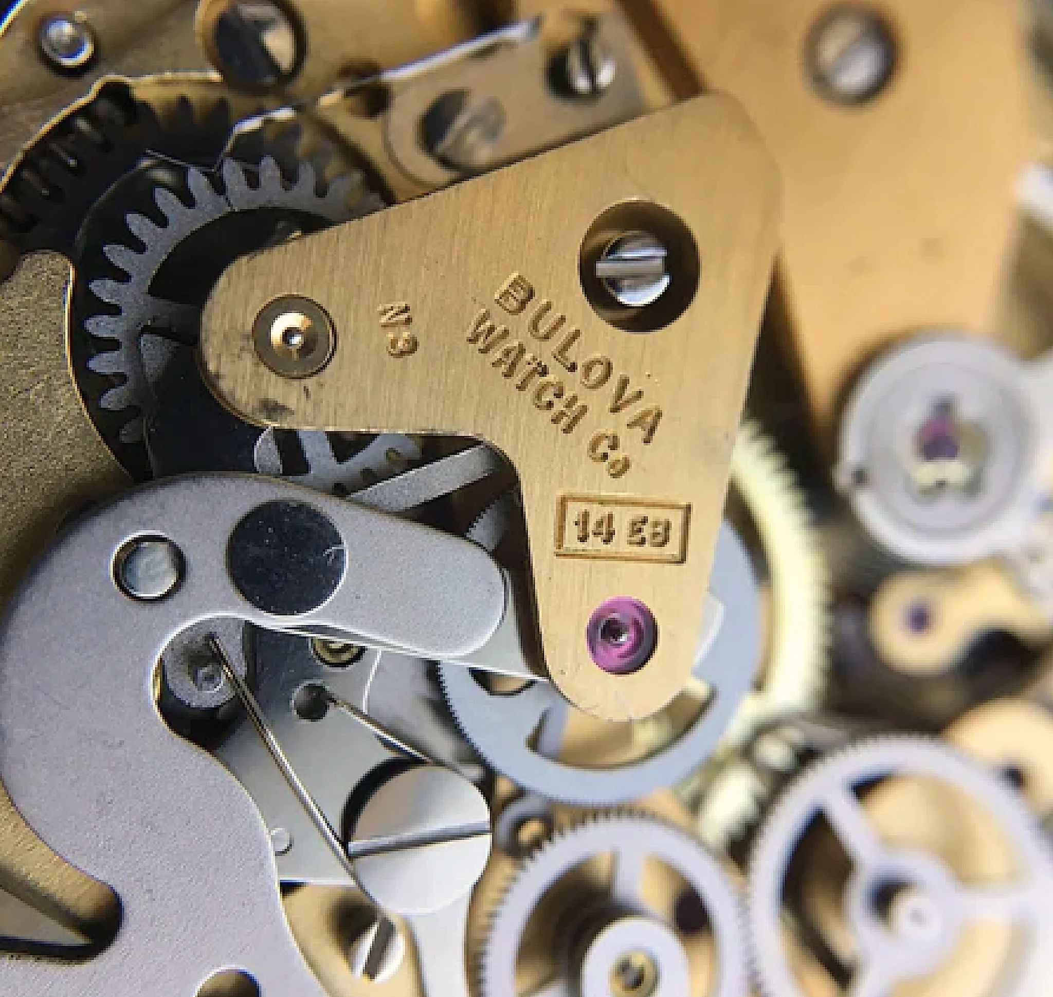

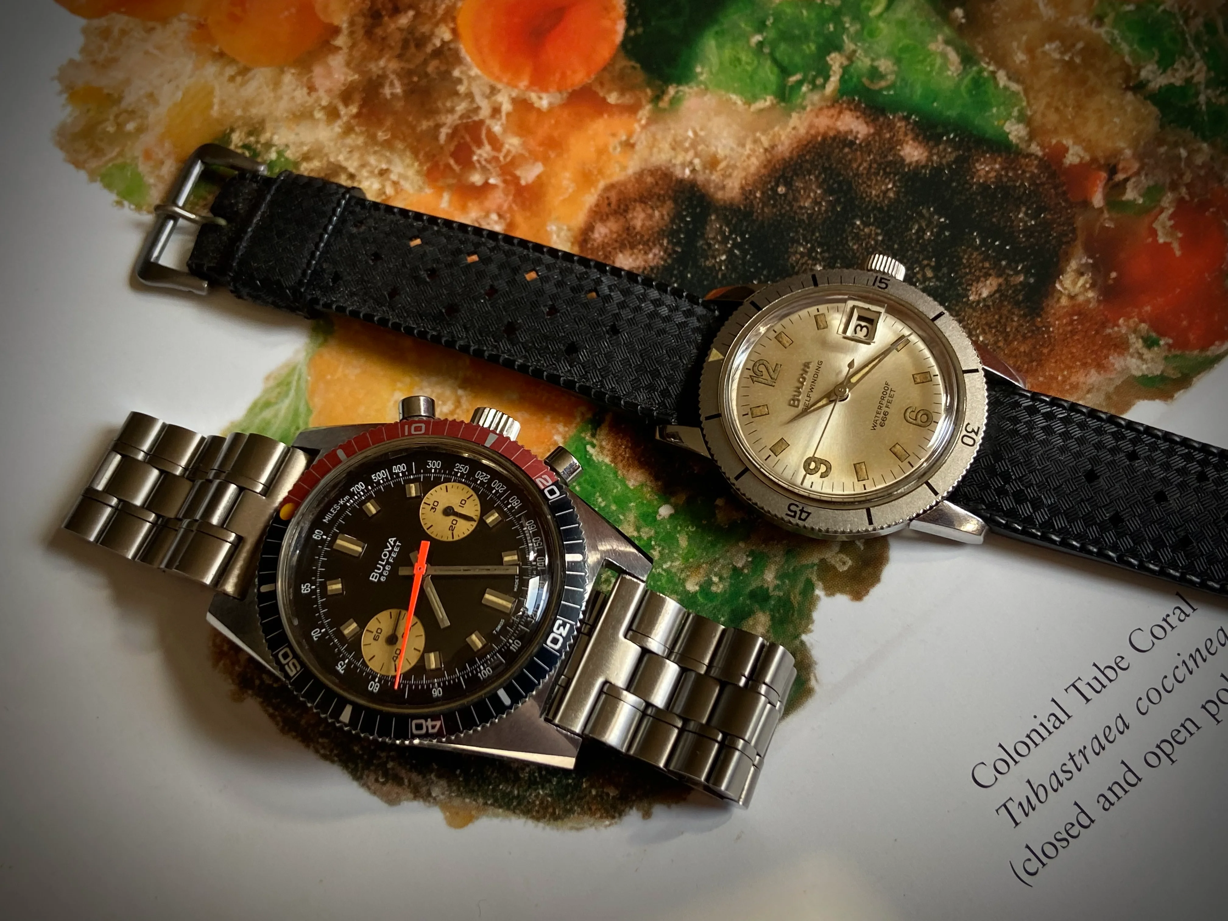

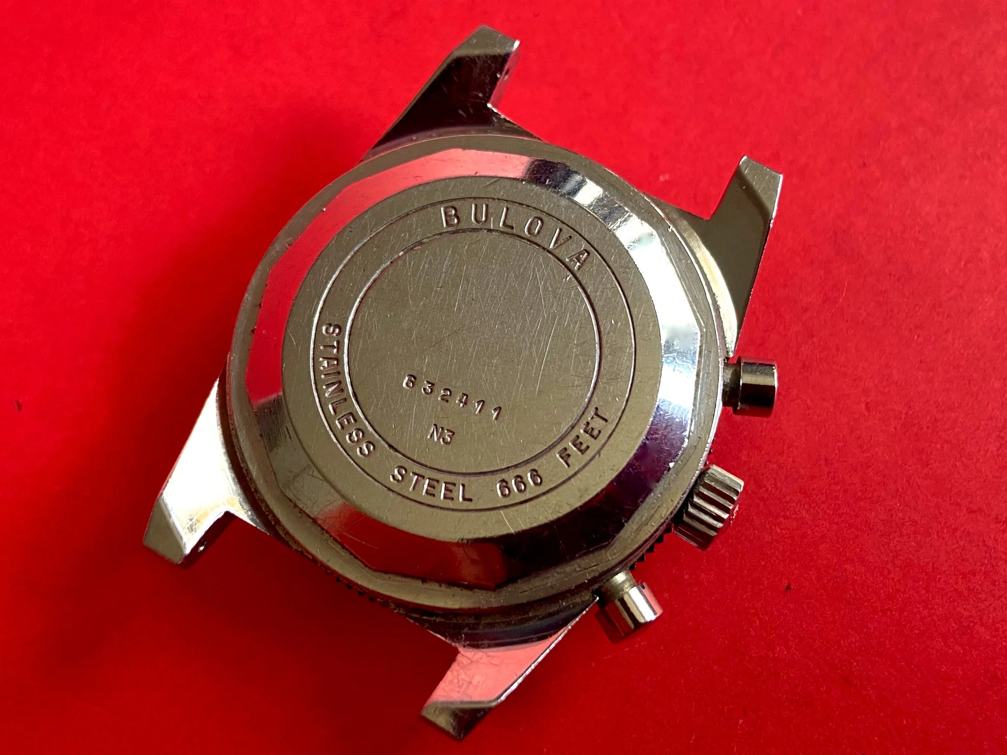

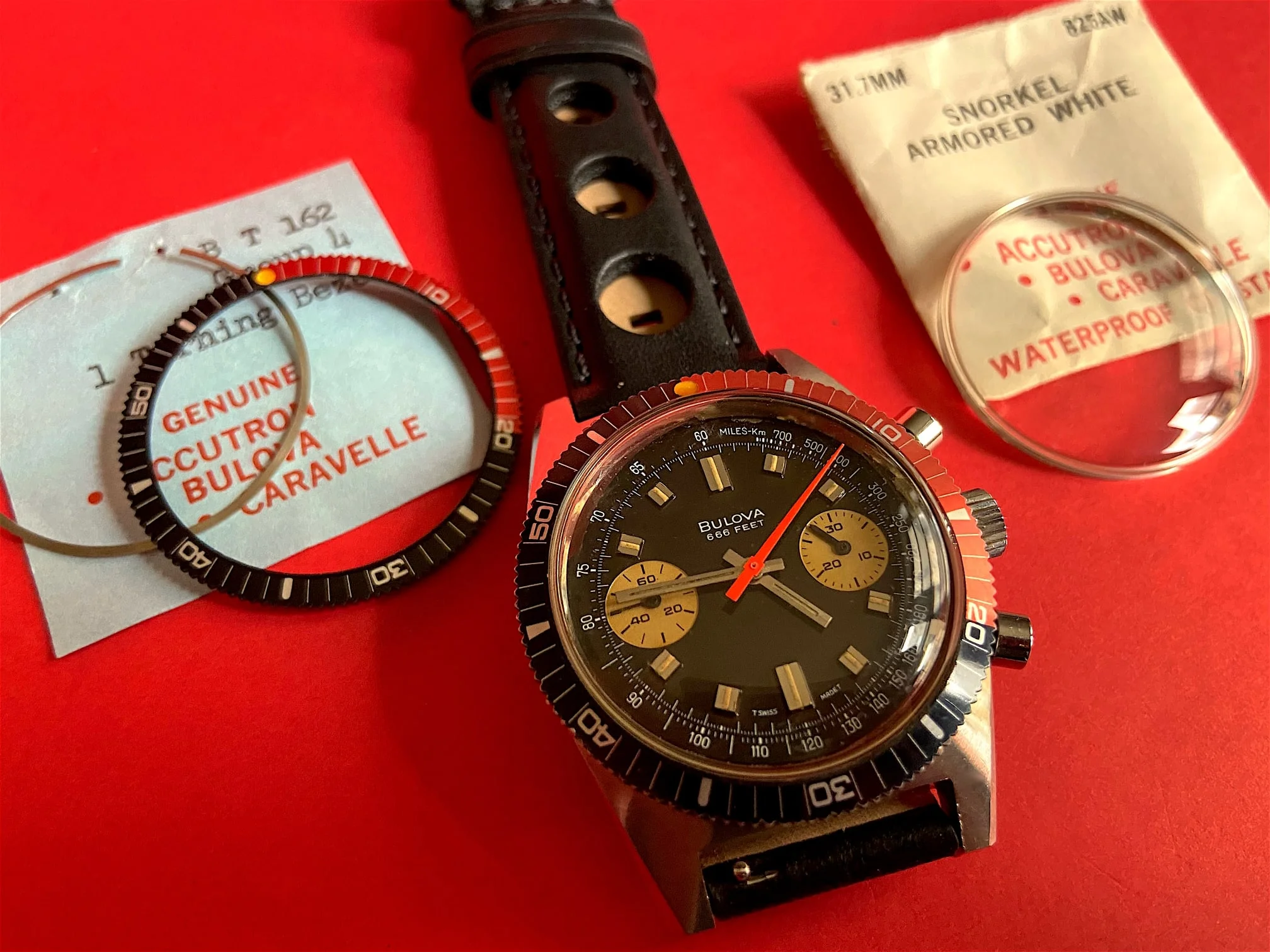

BULOVA CHRONOGRAPH 666 FEET.
Series: DEEP SEA
Case ref.# 895
Variant B
circa: 1973

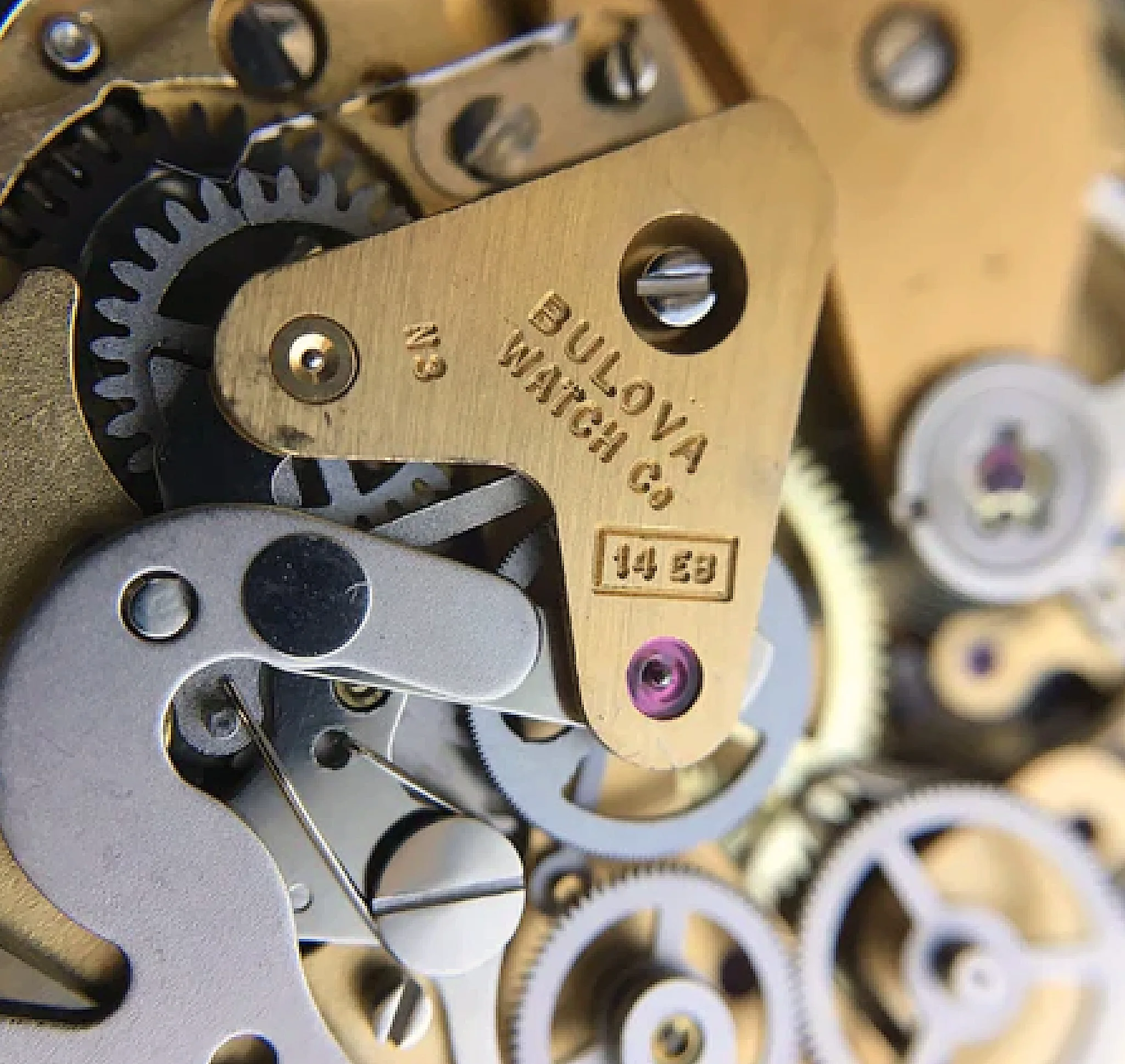

Despite its auto racing-inspired tachymeter scale, the watch was engineered as a true diver, the tachymeter scale and prominent SAFETY RED (with age fades into a lite orange) chronograph seconds pylon made applicable for use as an auto racing chronograph as well.
Case diameter is 37mm minus crown, Lug width @ 19MM, Case thickness 15MM with a double high dome acrylic divers crystal, reverse (two sub dials) panda dial, tritium lume, tritium batons (hands), applied hour indices, pump pushers, 30-minute counting chronograph, friction mounted bidirectional rotating black and red (Coke) bezel with 20-minute red zone and a luminous tritium dot at 60 to assess decompression time with a safety red seconds pylon, with tachymeter function.
Bulova movement caliber # 14EB (modified Valjoux 7733) electroplated with copper beryllium to minimize galling of the moving parts, this also reduces oxidation / discolouration / rust / and also has anti magnetic properties.
Design and Variants
The 1970s Bulova Deep Sea Chronograph "666 Feet" was produced in distinct series, each with unique design cues:
VARIANT A "Surfboard"
Dial: Cream-colored with a blue oval "surfboard" around the sub-dials.
Hands: "Cigarette" style—white with orange tips.
Bezel: Blue and red "Coke" bezel.
Case: 38mm cushion case, 15.5mm thick, 20mm lug width.
Movement: Manual-wind Bulova Cal. 14 EB, 17 jewels stamped with production year code.
Lume: Tritium on markers and hands.
VARIANT B "Reverse Panda"
Dial: Glossy black with white sub-dials (reverse-panda).
Hands: Baton-style, tritium-filled.
Bezel: Bidirectional black and red "Coke" bezel.
Case: 37–37.5mm, slightly thinner at 15mm.
Chronograph Seconds Pylon: Safety Red
Caseback: Stamped with production year code.

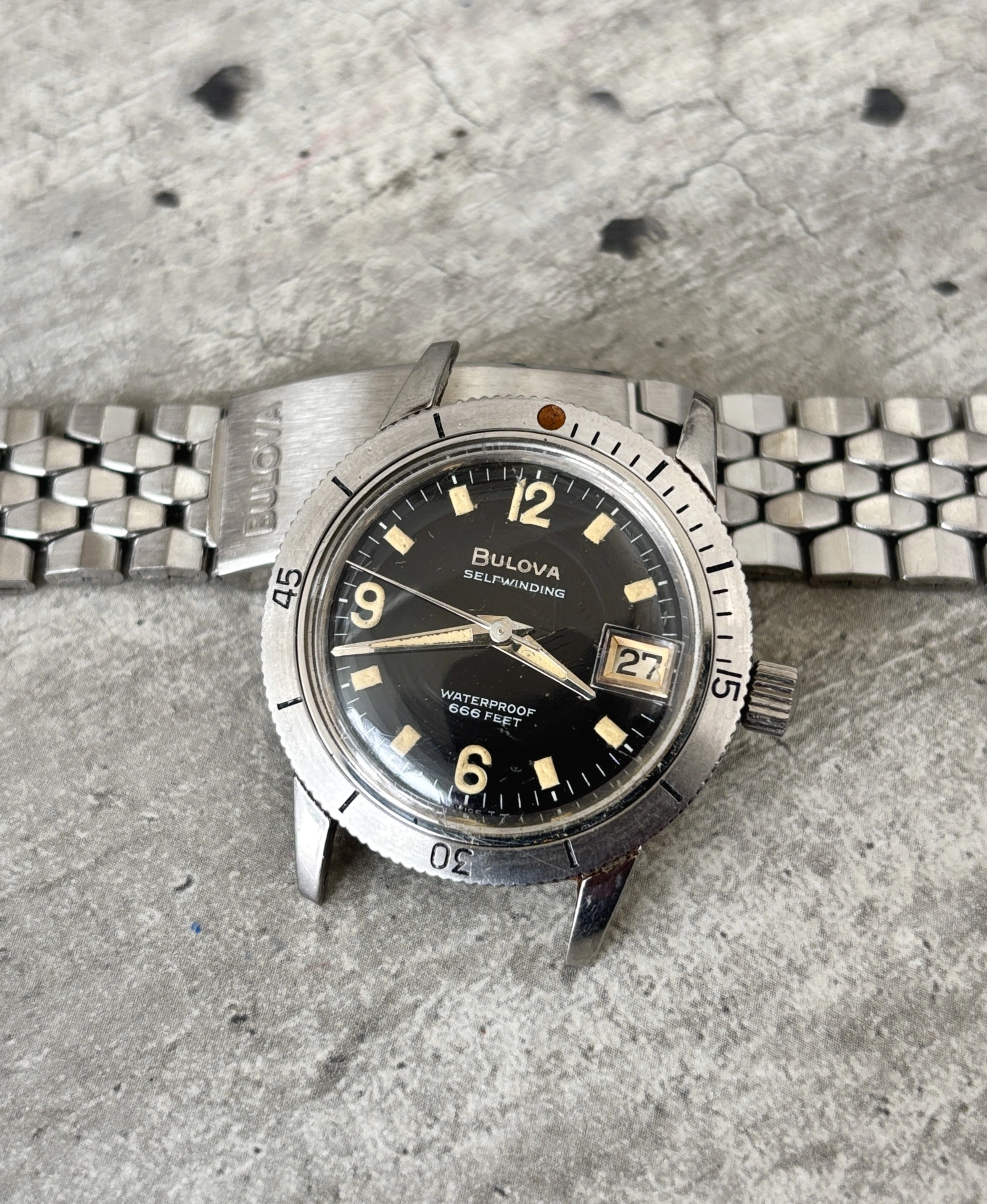

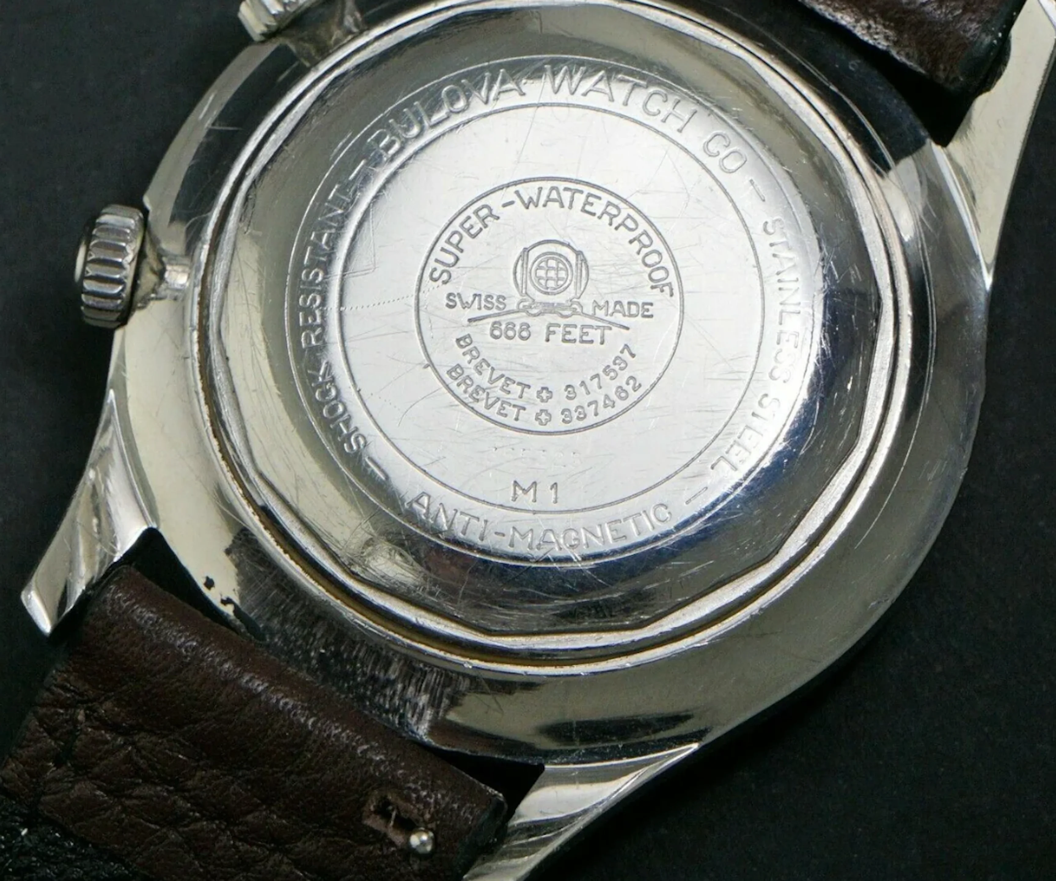

BULOVA Watch Co. SUPER-WATERPROOF 666FEET (202.99M static) M7 SNORKEL J Ref.# 11403W case ref.# 608
PARTS INFORMATION:
Case ref# 608 with 18MM lugs single crown compress design with screwdown case back
Case Maker: Centrale Boites S.A. [hallmarked CB]
Mvmnt. Bulova SWISS cal.11ALAC with 17 jewels no date complication automatic.
Crown ref.# 342W (elongated variant for ease of grip)
Bezel ref.# B152 (bakelite) ref.# BS152 (bezel spring)
Gasket ref.# G801 (caseback)
Dial ref.# 11403W (black) with Tritium makers
Crystal ref.# 608AW
circa: 1967 (M7)
ADDITIONAL MODEL - Snorkel 'K' white (ref# 11404W) dial variant
