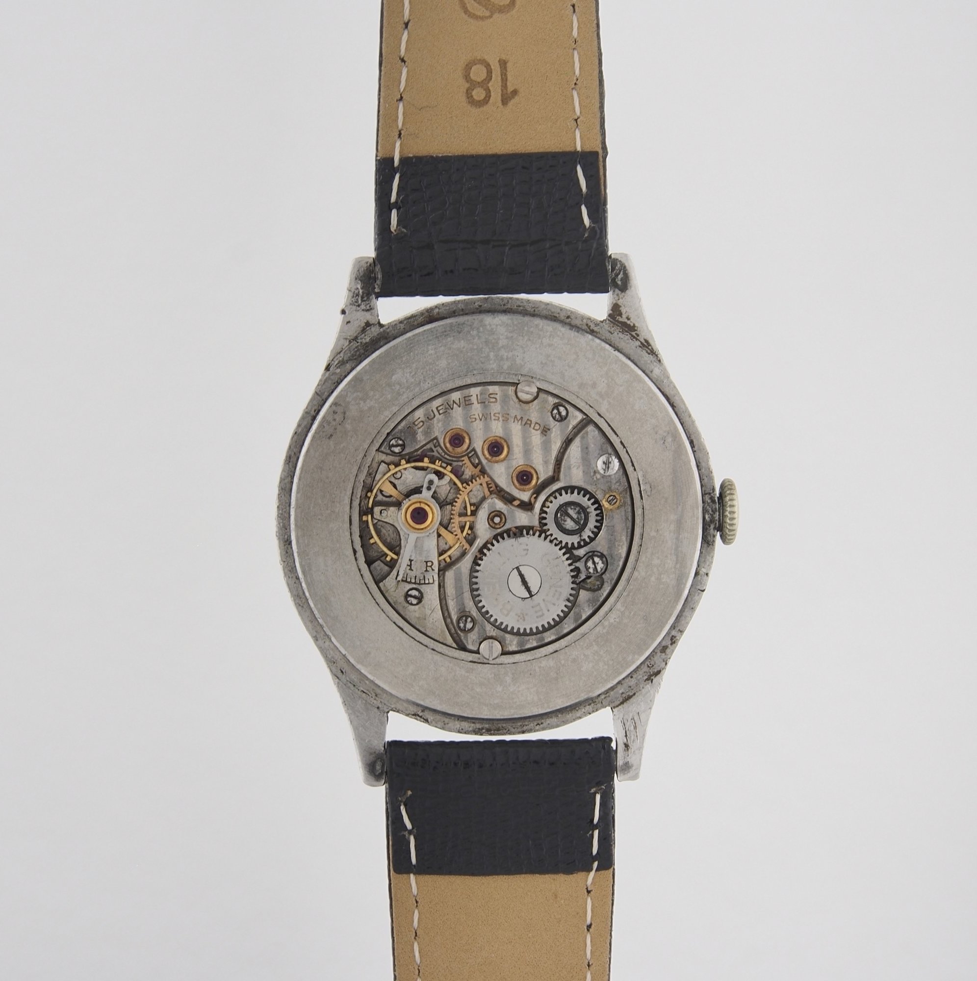

If you really wanted to dig deep I'd ask for a photo of the movement of yours and hit up this seller for a photo of their movement also:
https://www.chrono24.com/breitling/...-original-dial-1940s-servised--id26277104.htm
I can't imagine breitling had many different calibres in the 40s for a time only small seconds movement, so if they're the same movement that's probably a good sign also.

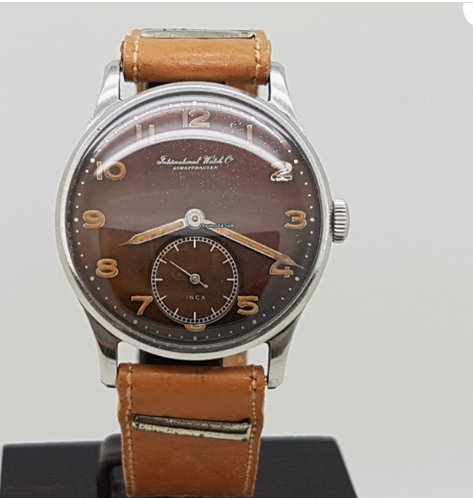

The overall layout reminds me a bit of these vintage IWCs from the same era:
https://www.chrono24.com/iwc/iwc-ve...l-dial-cal-88-mini-portuguese--id27381875.htm
So if it is legit I wonder if there was some military order or spec around the time;

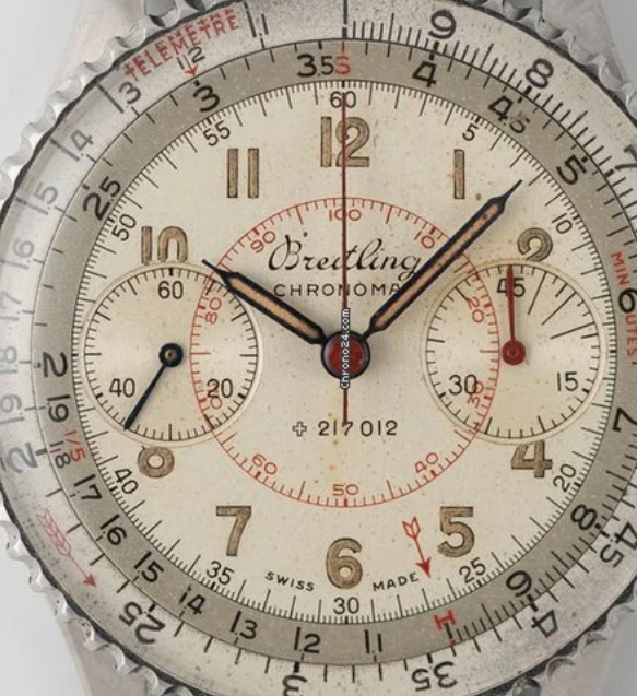

Thanks! In particular, I was worried about the dial signature. It seems like it matches another Chronomat's:

Here are additional pictures! Does this look like a proper Breitling movement & caseback?
4,495
10,986
Red flag on the script on the inside of the case. I haven't seen much documentation on the dress watches. Have you already purchased it? If you are looking for an authentic Breitling, tap the brakes on this one. Refinished dial and the script on the inside case = danger.
217
173
I don’t think it’s right. Dial looks like a reprint, and Breitling watches post ww2 always (99.99% of the time) have a reference number and serial number on the caseback. The script engraving in your caseback is an obvious forgery IMO.

There are ugly ducklings that are correct, and that note im not saying OPs is correct.
Breitling made simple ones aswell apart from their 'lines', one example is the ref 124 with fhf207 mvmt
