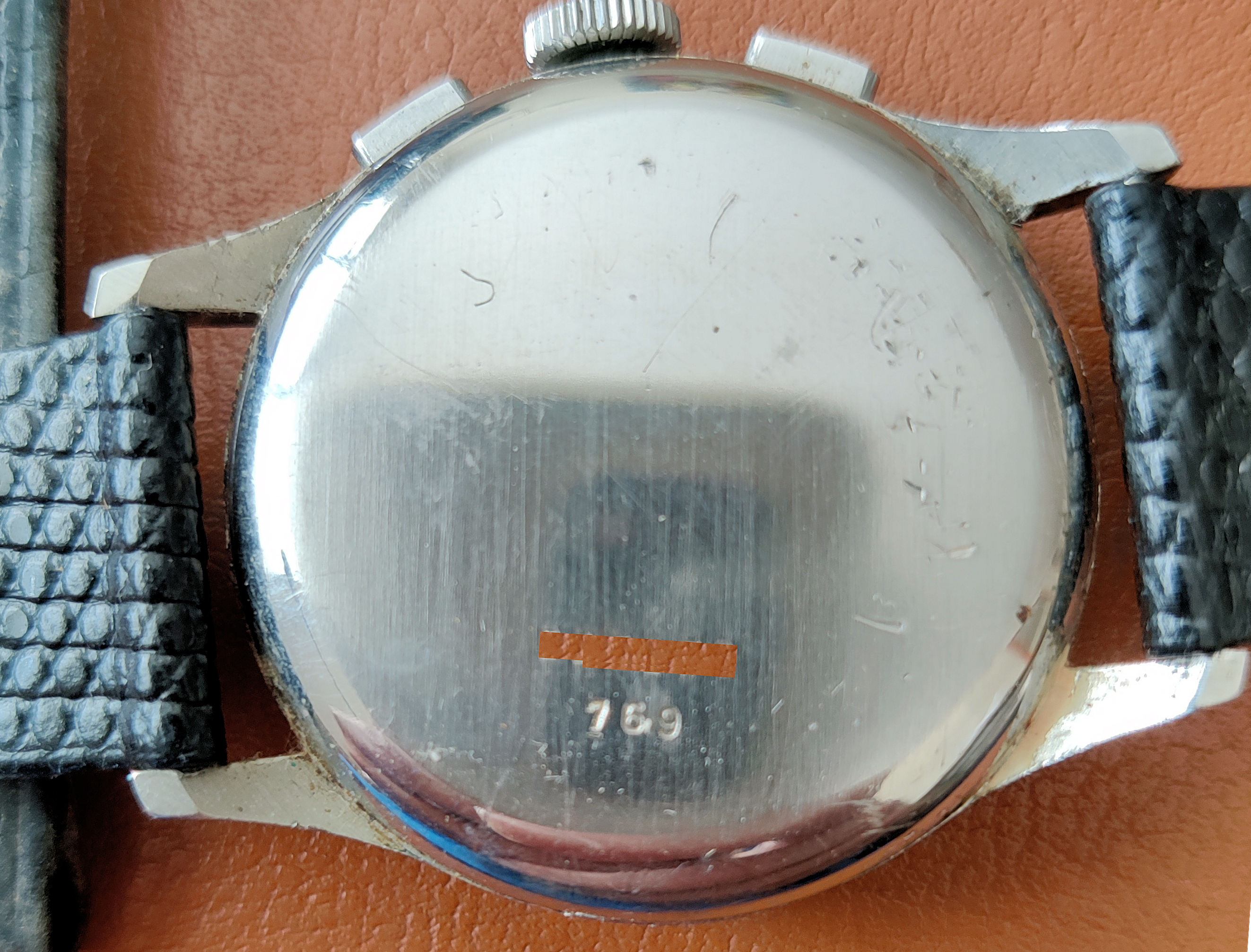

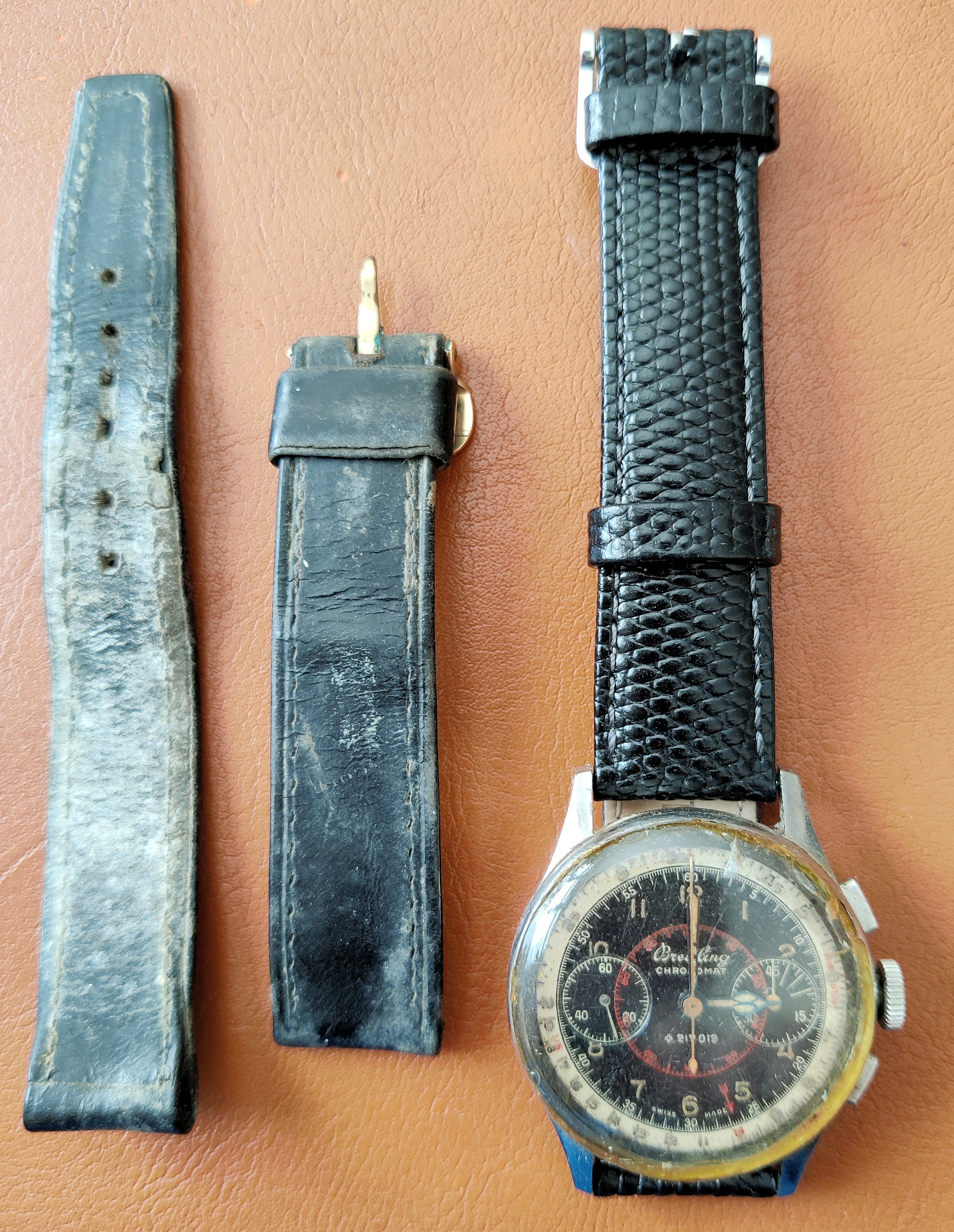

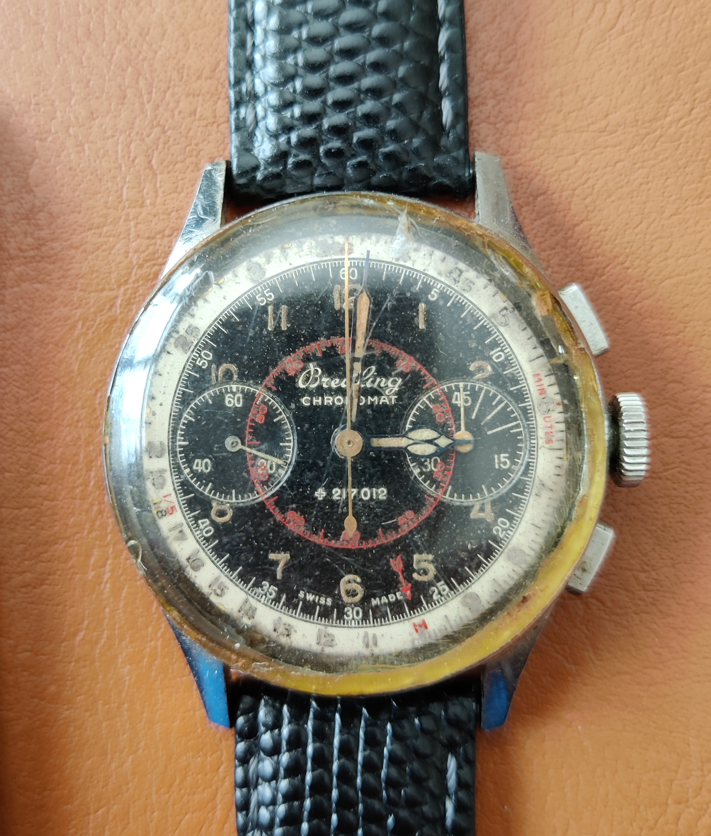

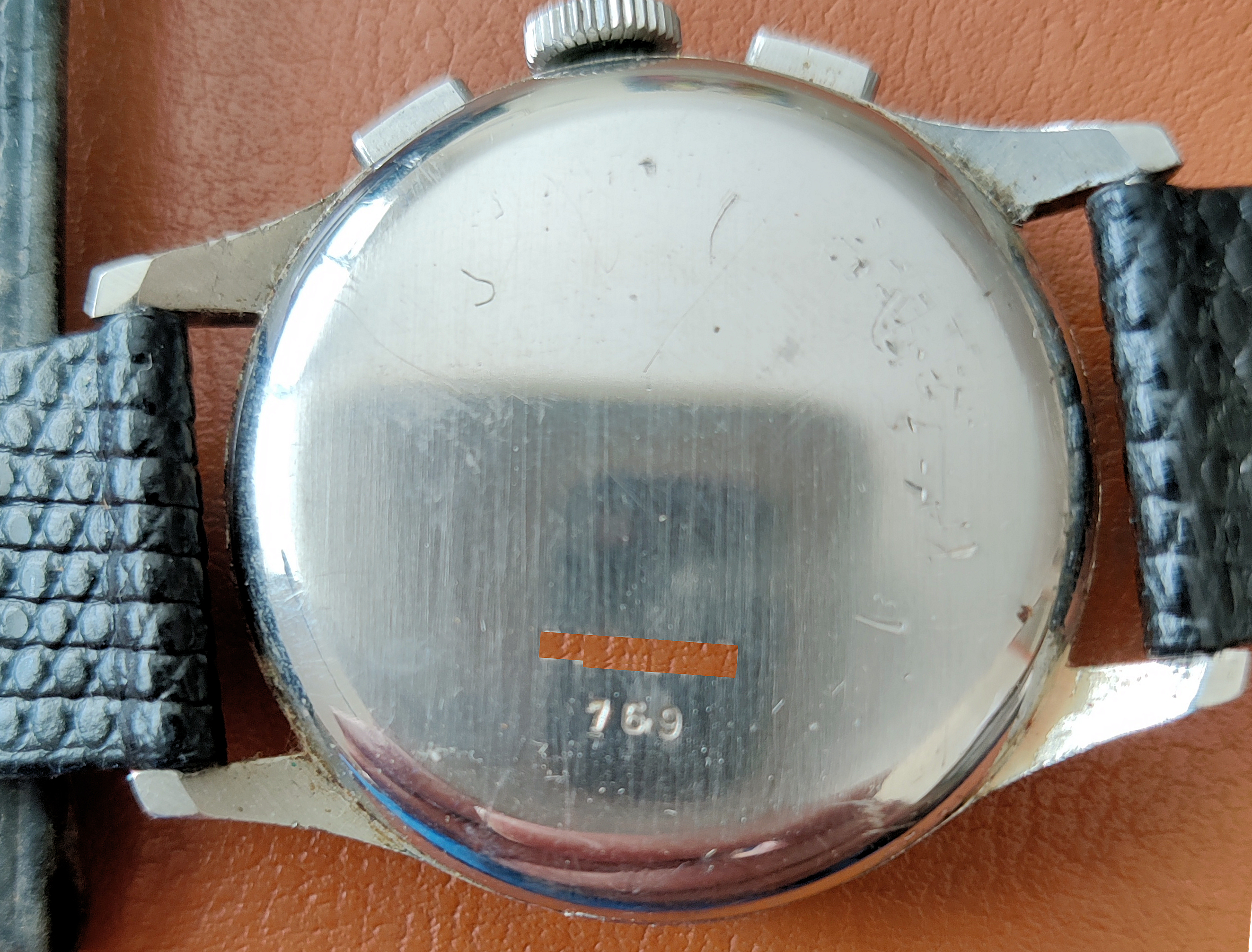

Ok so I now have some pictures of the actual watch (which still had its original strap). The serial number was pretty obvious and I thinks puts this at 1945 - maybe it was purchased to celibrate the end of the war or to match his commencment as a test pilot? I am not sure if these were ever RAF issued?
Anyway very interested to hear the forums thoughts on the watches condition and what cosmetic / cleaning work the family should consider if any (not my area of expertise).

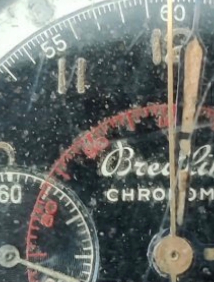

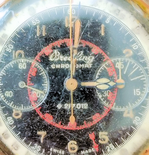

Given the damage to the dial, case, crystal, and bezel, I can't imagine the movement is working. It may not even be salvageable - we'll need to see inside. Wrong hands. I'm not an RAF expert (or a Chronomat expert, for that matter) but I think it would have been marked if they issued it, thus it would have been a personal purchase/gift.

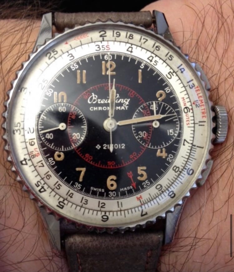

Thanks for the replies so far. I have borrowed the image below from the @LouS post linked by @DirtyDozen12 above.
@jsducote - I am told the watch still runs but I have advised them not to try that again.
In terms of the hands, bezel and condition:-
I don’t believe the watch has been touched for 40 years after the death of the owner aside from the new strap but I will check that. It would have had a few decades hard use in an test pilot / engineering environment prior to that. The hands are interesting / maybe a late service swap out - a bit of a mystery and I wonder what they are from?
The watch has strong provenance with photos and family history. The owner is a renowned test Pilot and was a senior RAF fighter pilot and test pilot in WW2 (I will share more when I can). He was a test pilot for a private company after the war but retained service privileges as the aircraft were top secret and of strong national importance.
I would like to give the family some advice. Looking at the condition now is it best left as an air loom / museum display item or would it benefit from any work / could one of his sons or grandsons wear it?
I think the dial needs more than just a clean - there is some degradation and damage?
It is way off a pristine model - but has a strong history and was probably worn during a famous flight which the family want to keep in peoples memories.
Thanks again for help so far and any help furthers help and thoughts on this.

What happened to the bezel? 😲

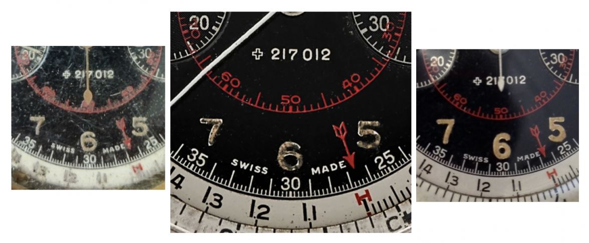

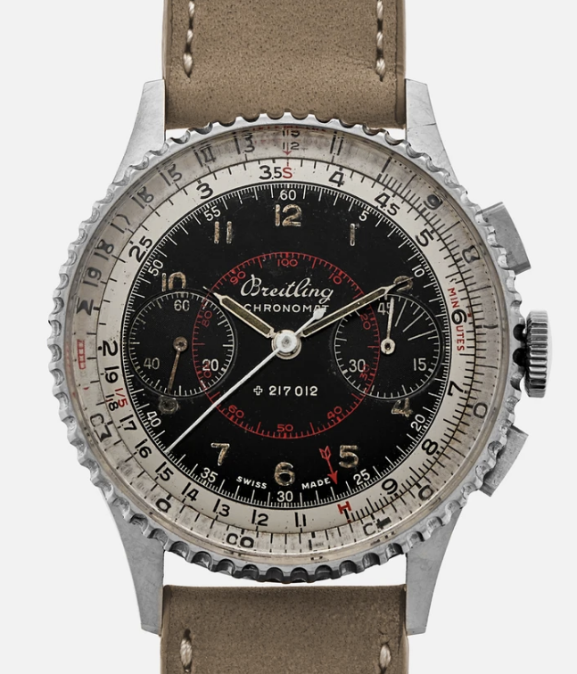

I just noticed that the dial on @LouS' example (right) is not the same as the one in question (left). Anyway, below is another example (center) that looks similar to the dial in question.
https://shop.hodinkee.com/products/chronomat-ref-769case-595766?variant=33073648795723
Many thanks for this. I plan to send them some feedback before the weekend and cross check a few questions. I guess the biggie for me remains what is best for the watch? I guess leave it as is and find a place to display it with some notes on the pilots achievements (there might be a museum option for that). I cant see that it would be possible or economic to improve the watch to a wearable condition / it looks too far gone + to what degree should it be refurbished if at all - I remain a bit confused what to advise them?

I'd say display piece.
I haven't looked for a while, but the dials (in poor condition, but at least better than what they have) come up from time to time. However, the outer bezel was near impossible to source. It really depends whether the family wants to restore this to original condition or just get it going to wear/run again. The former may never happen, or it'll be a loooonnnggg and expensive endeavour.

I wouldn't be surprised if service bezels and dials are available and could be provided by horologicalservices.com. However, they might insist on replacing a lot of parts to make the watch look like new. It's an option.

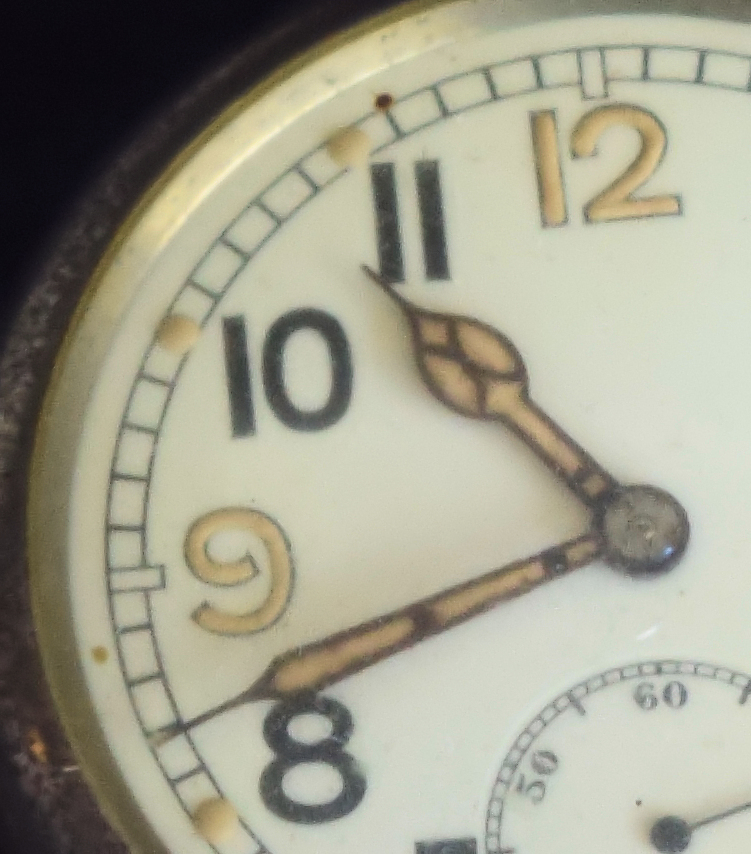

I wonder where the donor hands came from - I have seen some MOD pocket watches with that style?

I just wondered if anyone had thoughts on the style / source of the replacement hands fitted at some point for this watch. I was comparing them to this MOD pocket watch for example. I wonder where the new watch hands came from and what period they were fitted?
24,838
55,263
The hands could well be older than the watch. Perhaps a watchmaker went through a bin of hands just looking for something that would fit.
782
1,387
I'd agree that's the most likely scenario.
1,079
2,243
Only thing I'd feel confident replacing at this point is the crystal. It'd be a different story if I were preparing it to sell. The wrong (albeit old) hands have been on it so long, they're part of the personal history of the watch at this point. And I agree that they likely came out of a bin 50 years ago, so finding the exact donor is going to be impossible. The damage to the crystal is part of the personal story too, but I think it'll look nicer in the display case being able to see the dial better. A watchmaker who specializes in vintage restorations may have some advice on stabilizing the dial & movement so that it at least doesn't degrade any further should you decide to fully bring it back to life at a later date.
