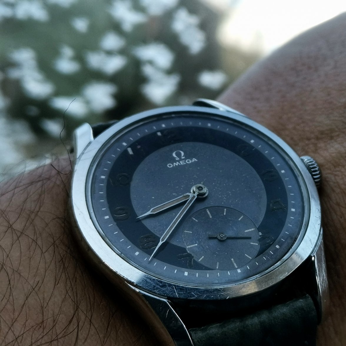

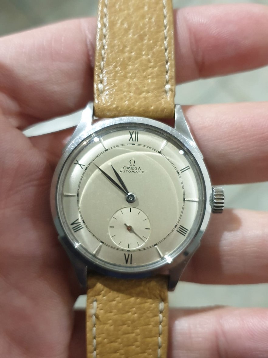

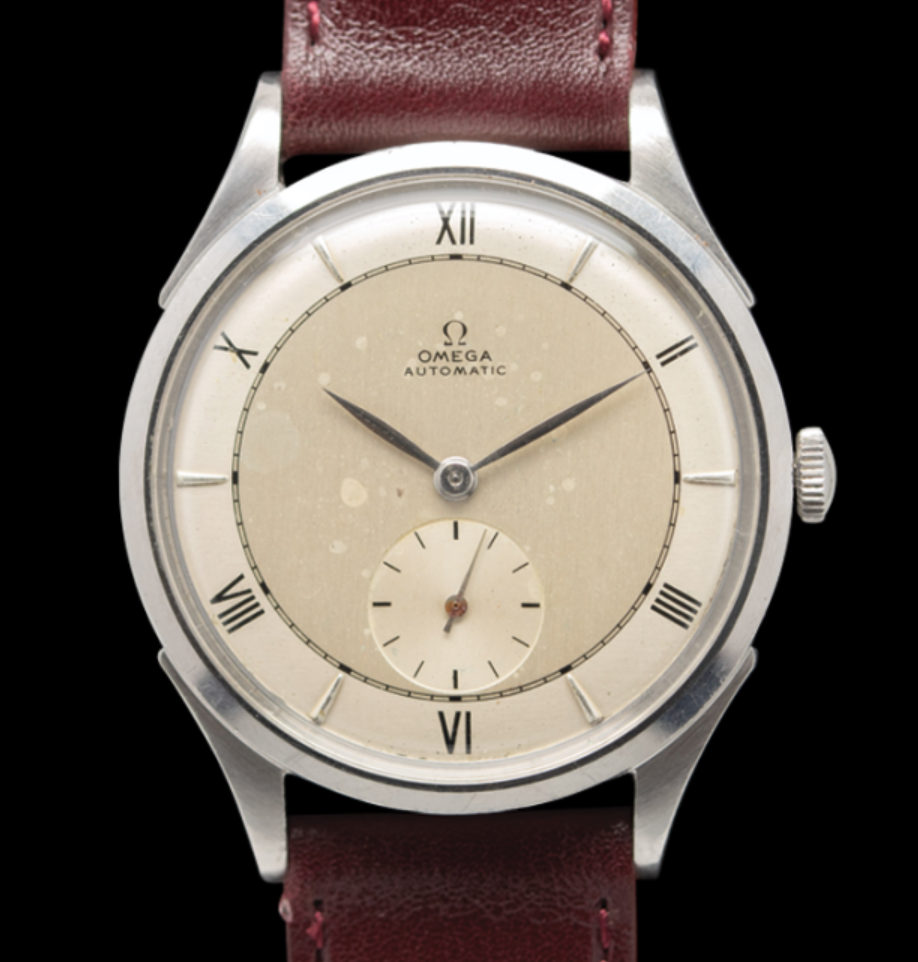

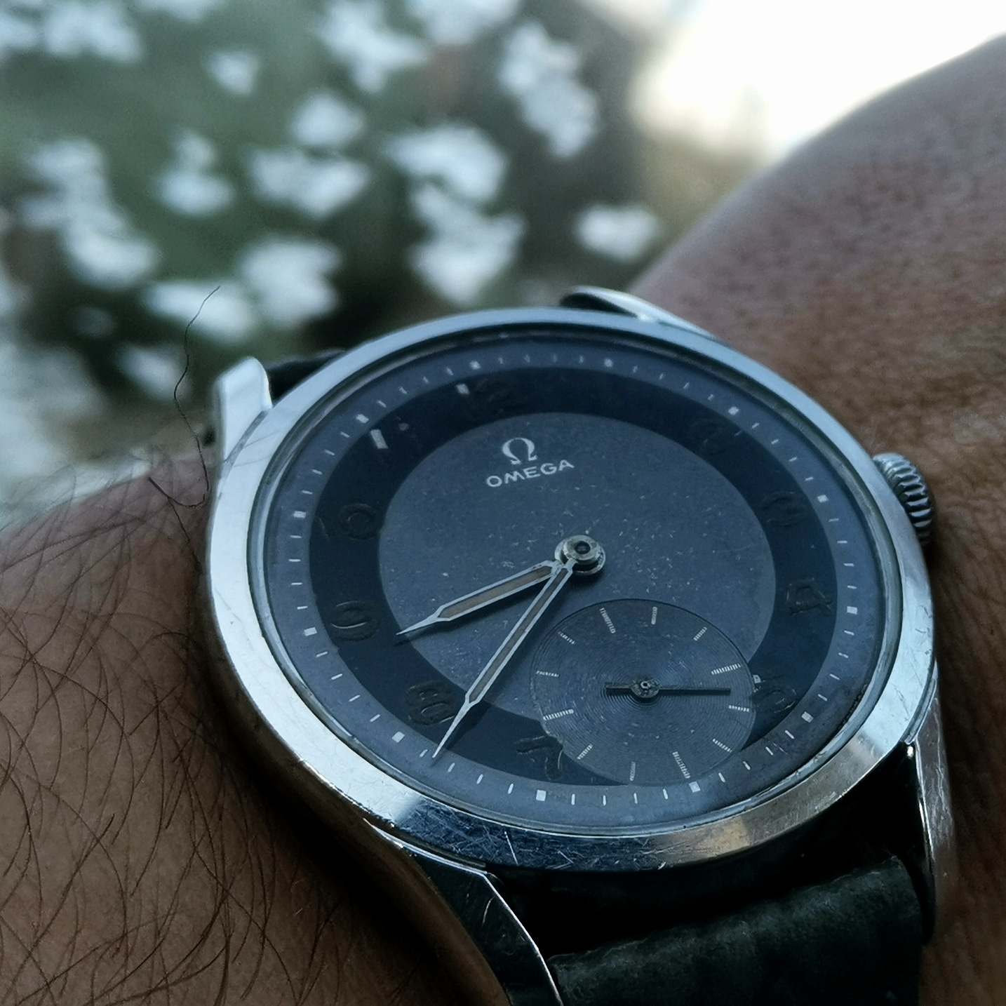

I've recently bought 2 nice vintage omegas from a watch dealer.
Are the dials (without SWISS MADE inscription) legit in your opinion?
thank you all!

From my point of view, both are redials. The first one looks very strange to me..

Second one is redial, I would need straight pictures on the first one to be sure.

I guess I'm going to go against the grain here. I feel like someone has been trying to clean these dials, and perhaps touching up a few flaws. But I'm not really seeing obvious signs of complete repainting.
I do think the sub-seconds hand is wrong on the first one, but the radium certainly looks original. The entire outer edge looks cleaned.

Need a better Pic of first one. I think second one with Roman numerals is all original with replaced crown.
More pics of both please.
