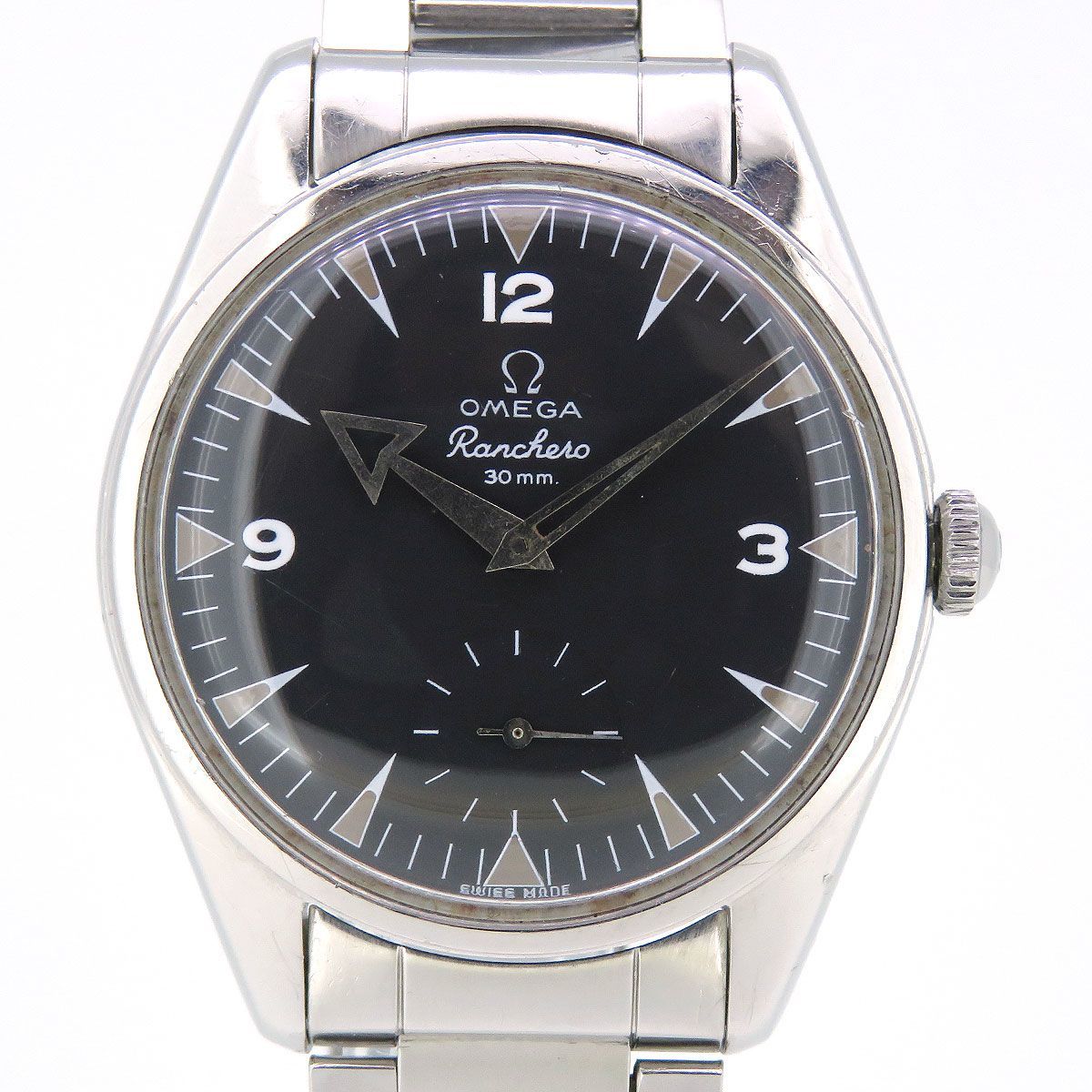

Serial number is 17,500,686. Is this genuine? It appears to be mostly original but I'm skeptical that the lume in indices are not full coverage like the dial on hodinkee's, here: https://shop.hodinkee.com/products/1958-omega-ranchero-reference-2990-1?variant=243815383055. Looking for open discussion 😀

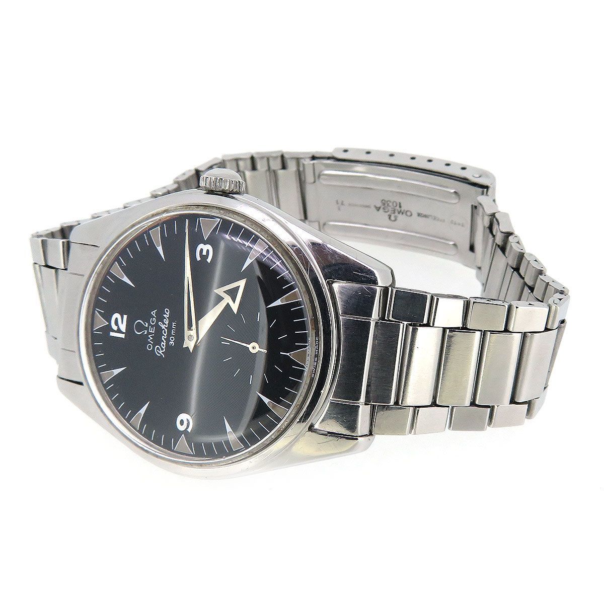

Definitely a redial. Seconds markers should be longer.
If you are wanting a nice original Ranchero, just stop here and move on. ☕

Thanks everyone! I have decided to not purchase this after further consideration.

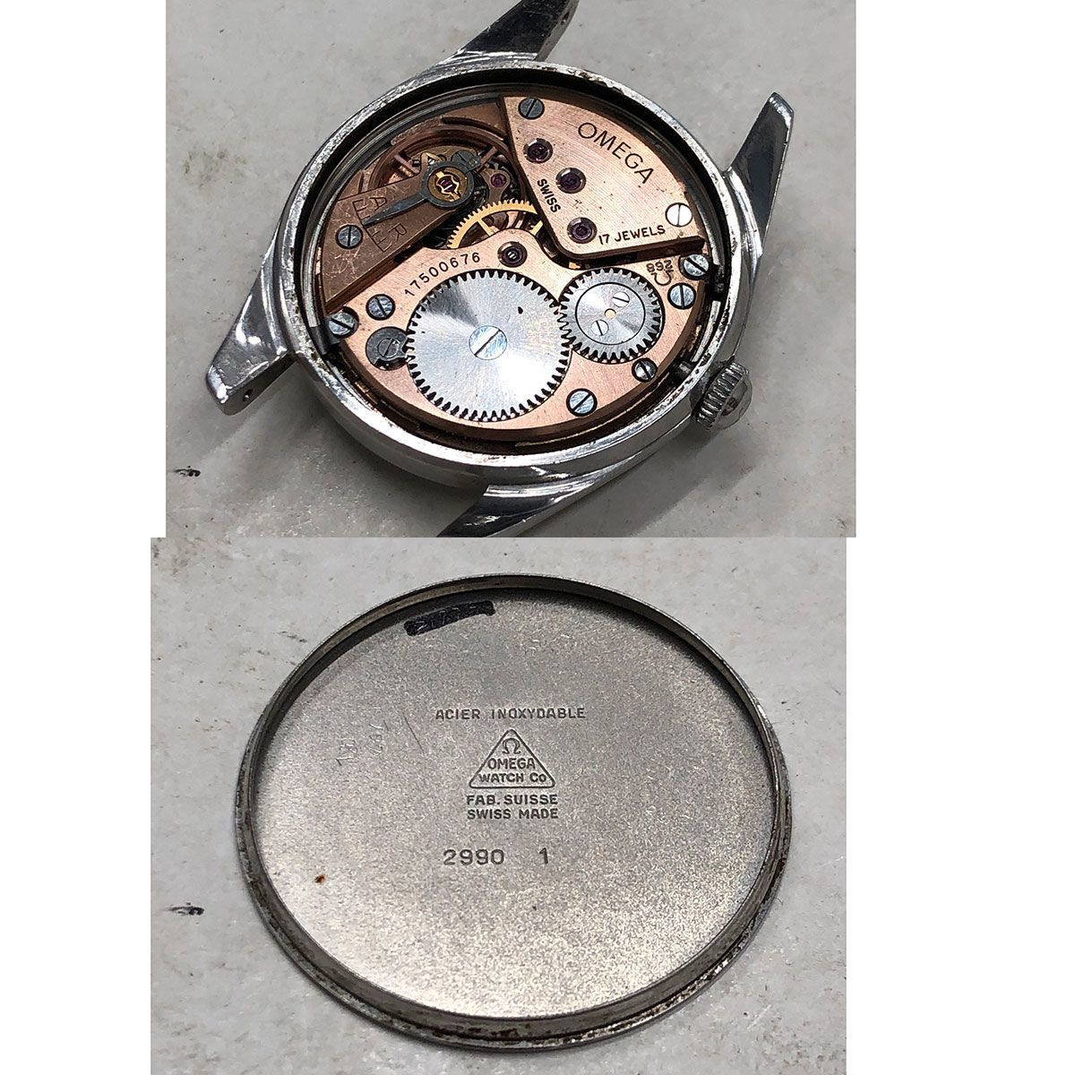

Redial, overpolished, hands appear original but without lume. Serial of the movement pretty high.
