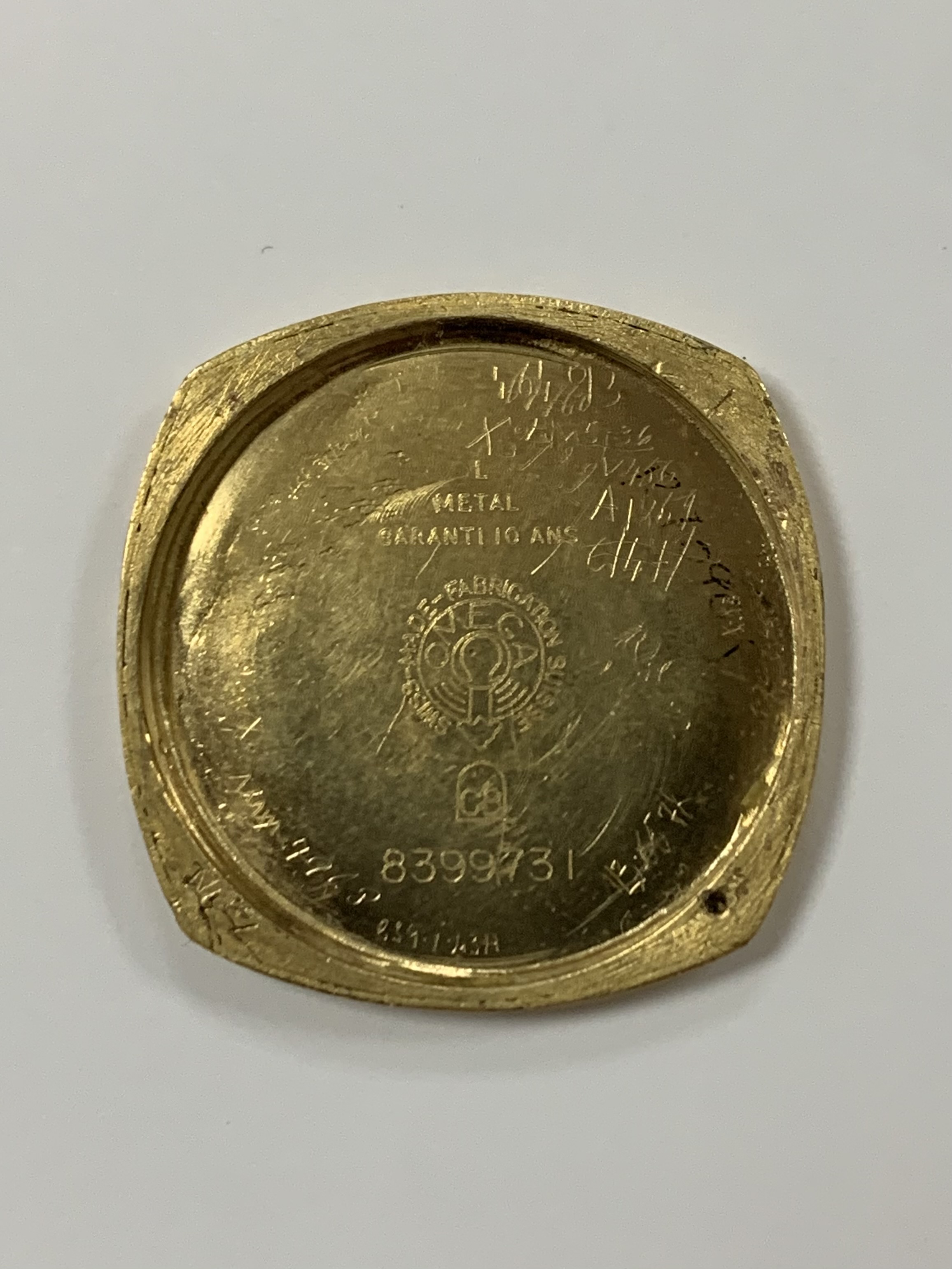

By the way, if that is possible, I would like to see the movement and the case back of your watch!

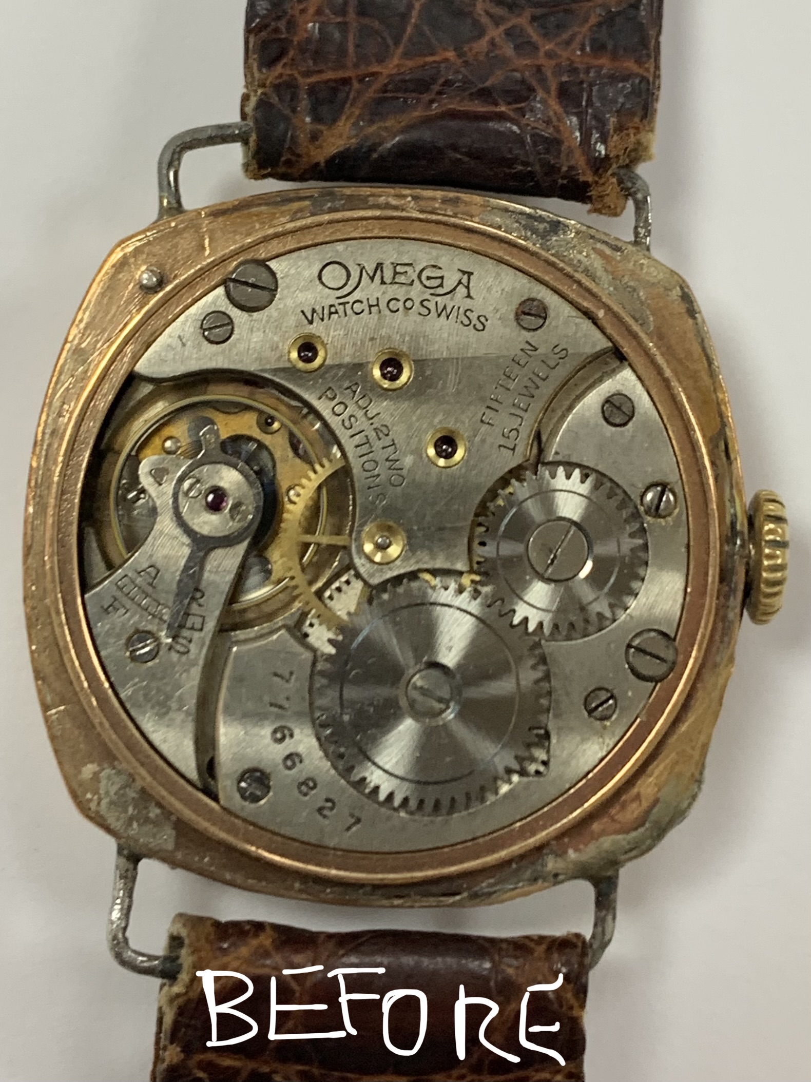

Hi Francois

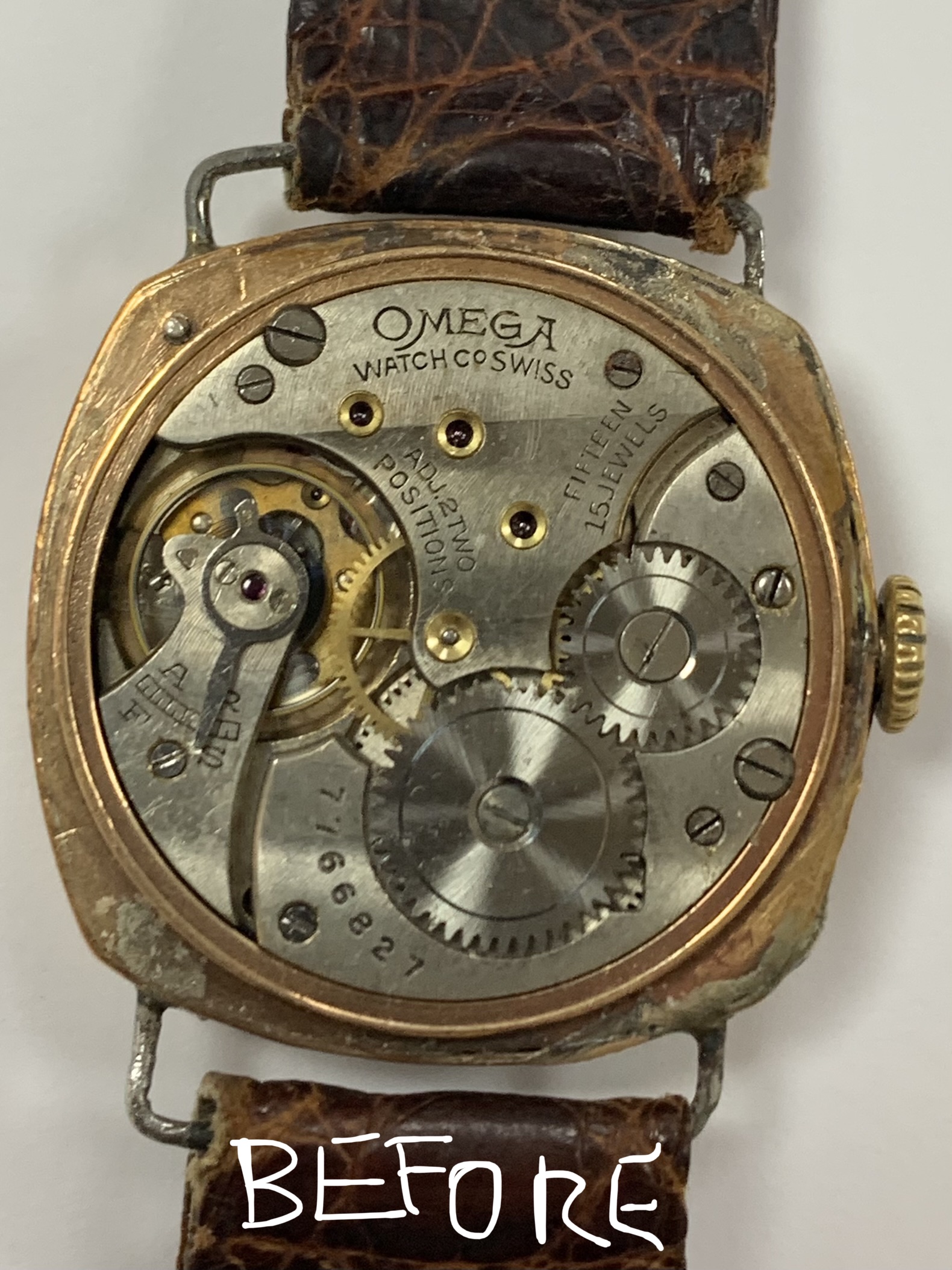

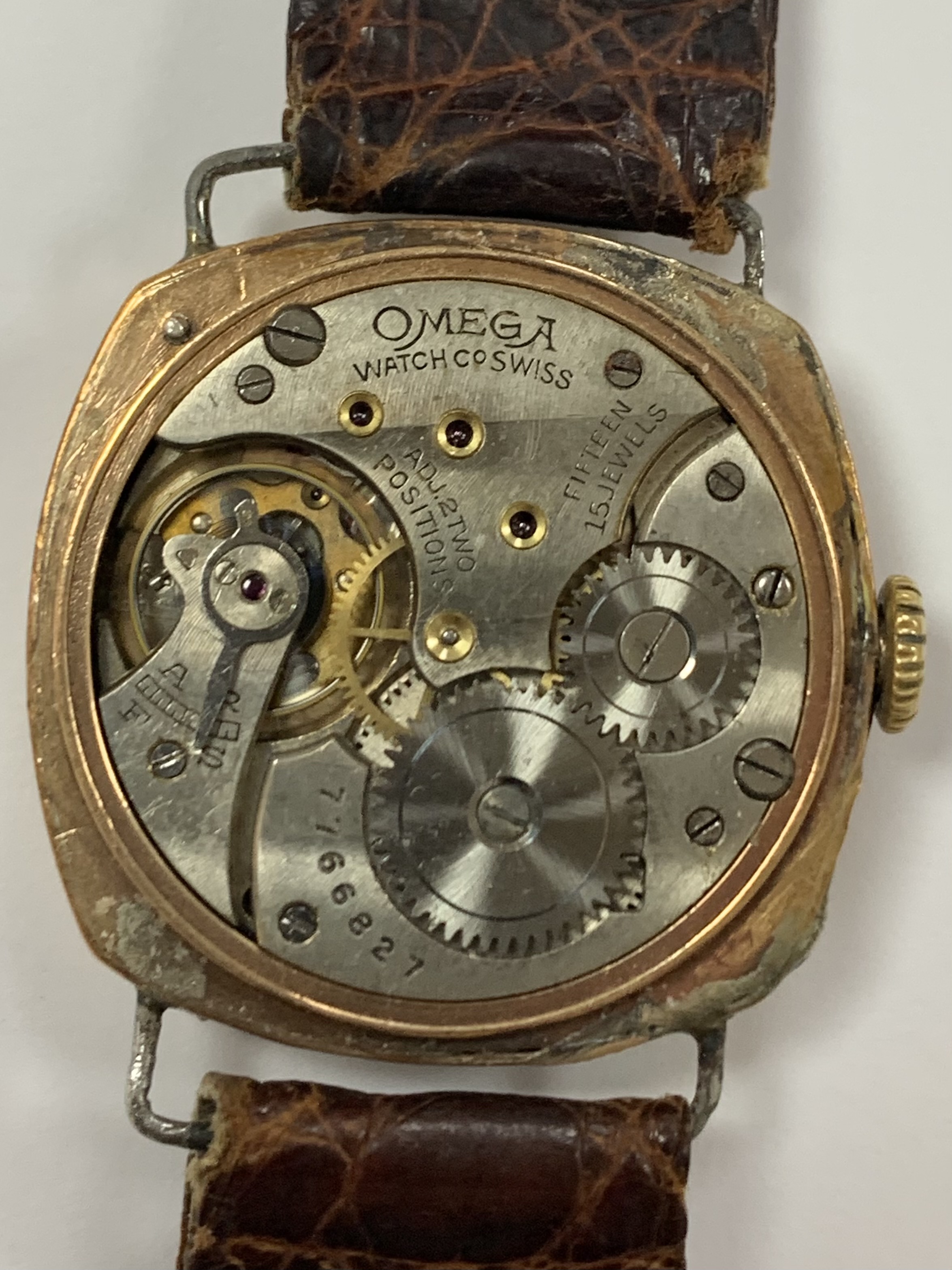

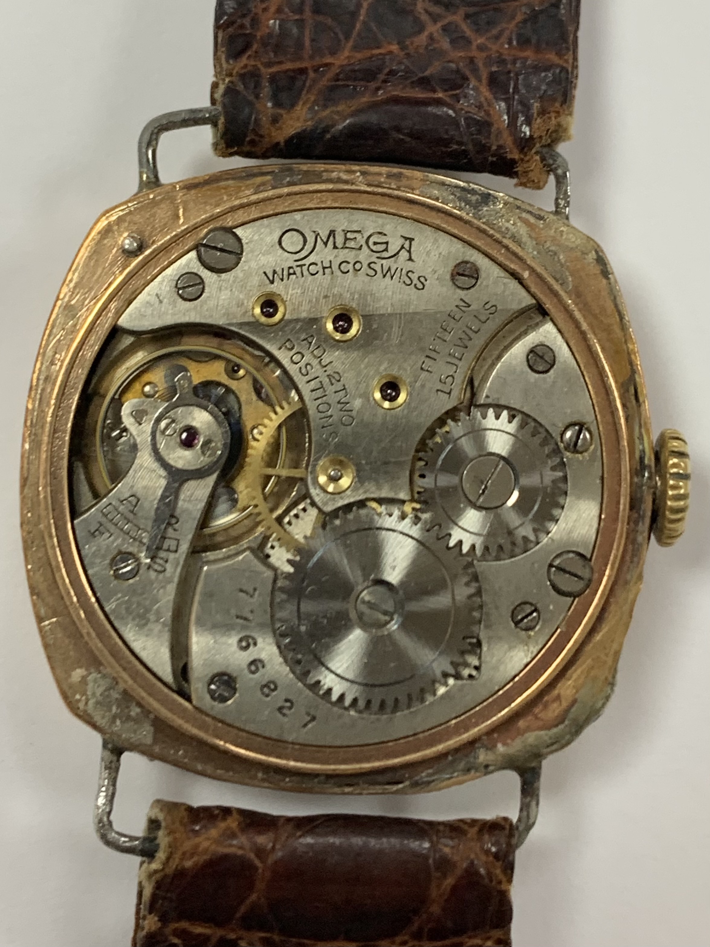

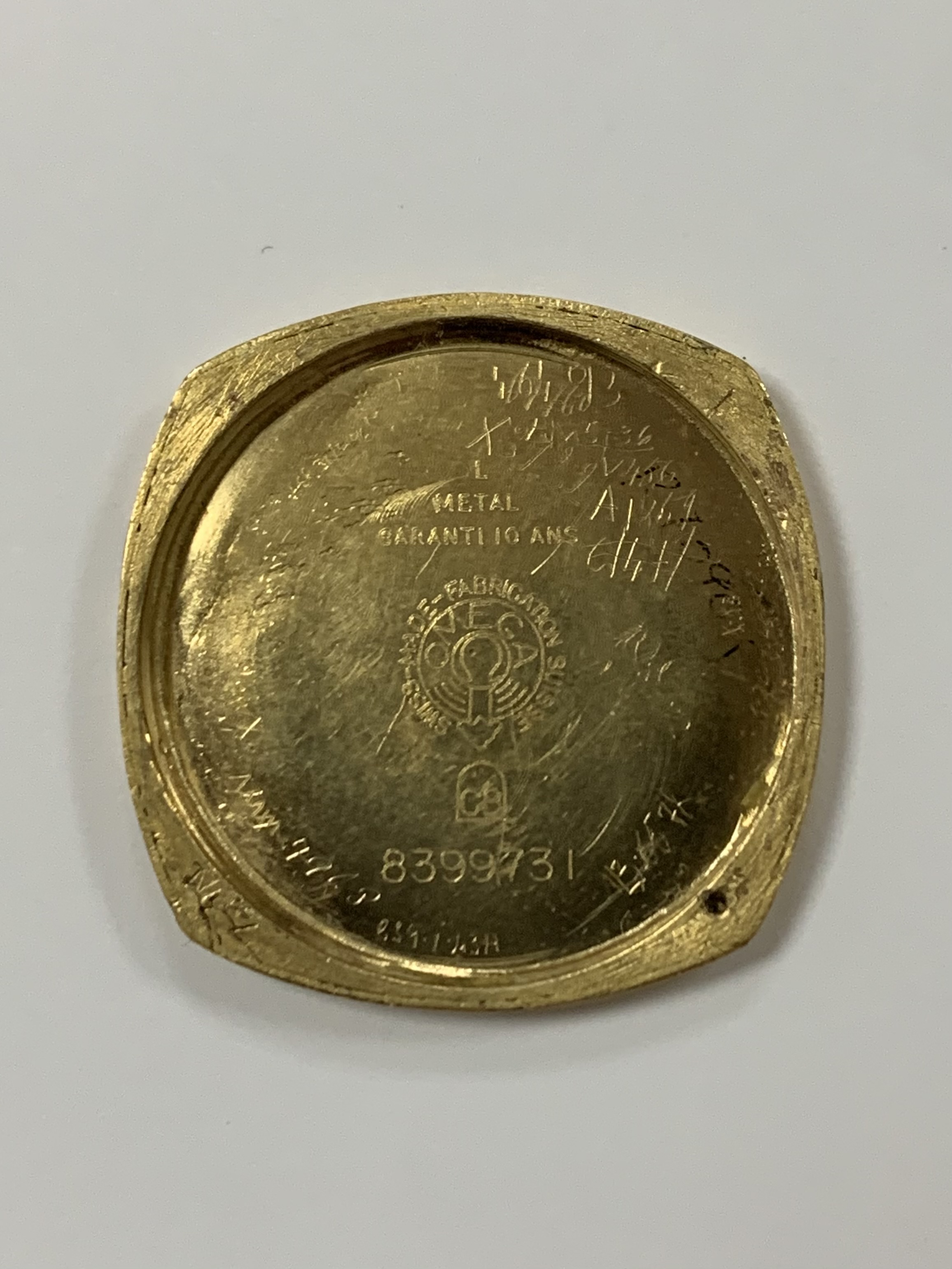

I have finally overcome my fear and decided to open the case back
Here are some photos. what doyou think?
I may turn the racket towards the - sign myself
1,531
1,088
Hi,
Caliber 26,5 and gold plated Swiss made case. Movement and case both are from the early 30’s. So everything looks good! The case is a little bit worn, but that was to be expected.

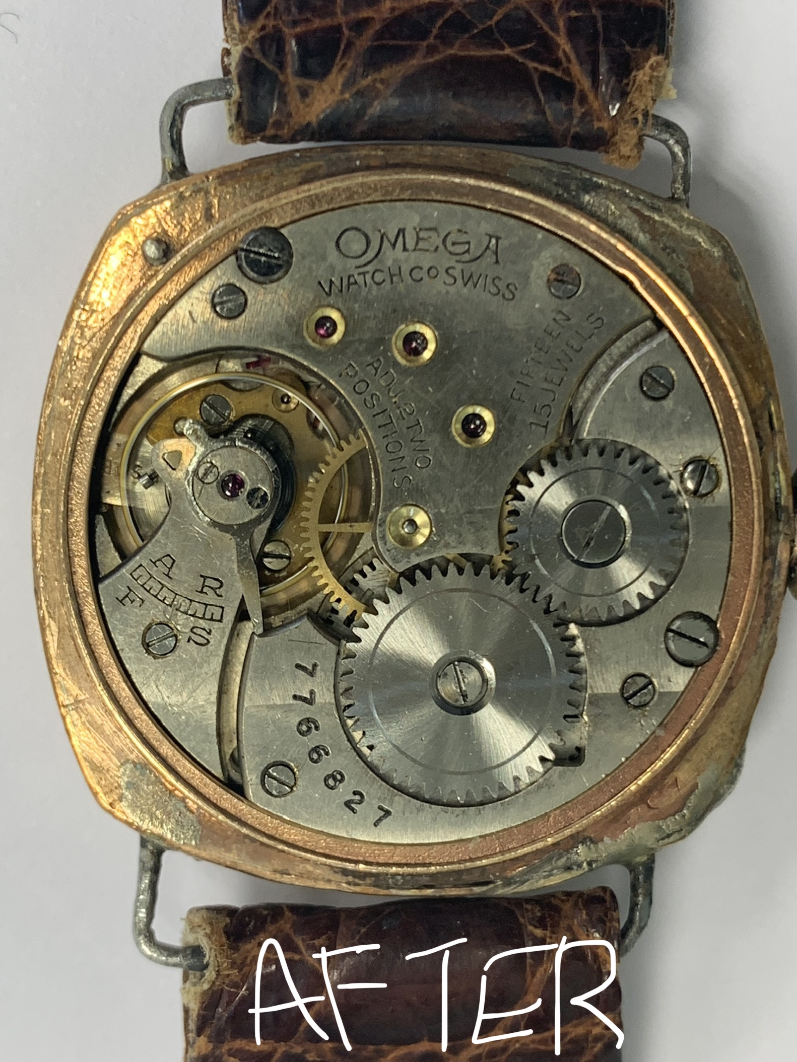

Need some help!
I have been turning the regulator gradually in the last couple of days towards the "S" side and is still running fast.
Can I carry on moving it further until the watch runs slower?
How far can I go?

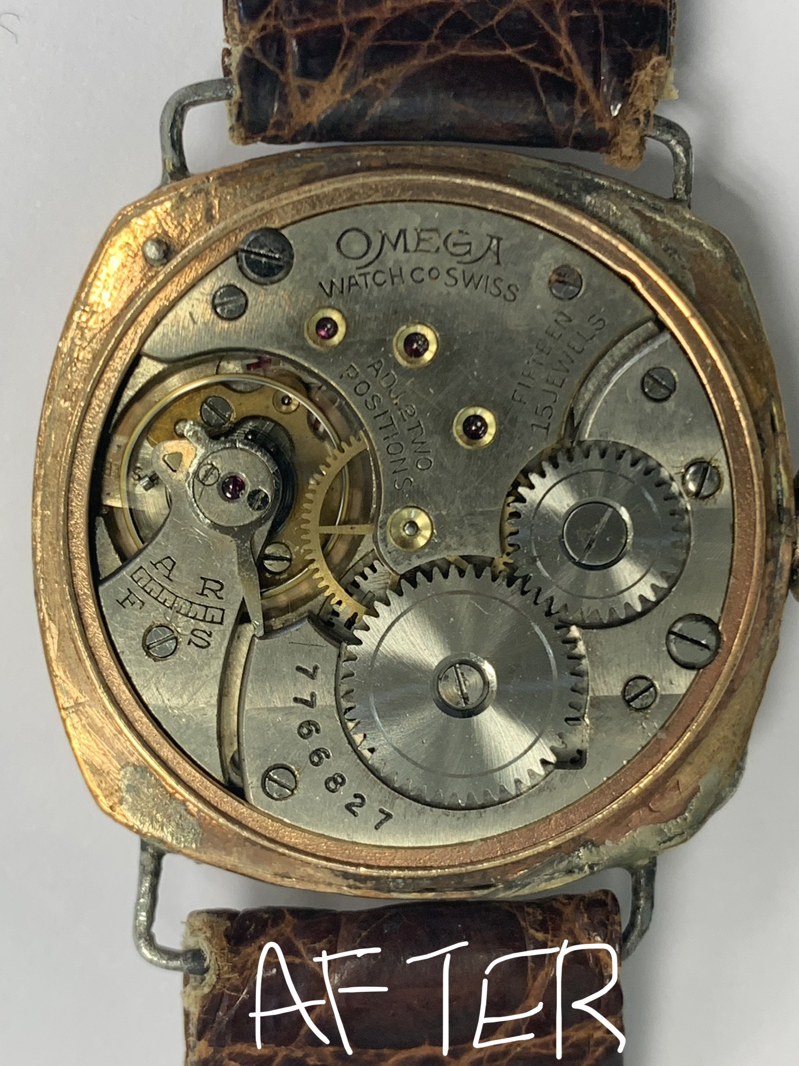

I enclose photos from before and how it is now
Thanks
1,531
1,088
The regulator is already at the maximum possible to the "law" side. Actually, it is way too much. I would bring the watch back to my watchmaker, as there is definitely an issue. After a proper service, even if the watch does not keep perfect time because of the lack of parts or other issues, the regulator should be around the middle of the balance cock.

What would that mean?
The length of the balance spring (among other factors) determines the rate of the watch. Shorten the balance spring, and it runs faster. It would mean installing a new one and getting it "vibrated"; specialized watchmakers do this function. Likely not cheap.
Maybe but there are other factors that could explain this fast rate. And it would be an easy fix - putting weight washers on some of the balance screws. It could correct the balance poise as well.
5,631
5,815
You are indeed correct. Depends on the screws and what washers the watchmaker can get.
1,531
1,088
That would be an easy task - if there is nothing else off! I am only an amateur and do this king of dynamic poising plus correcting of the regulator position thanks to washers very often - on very old vintages or watches with issues.
