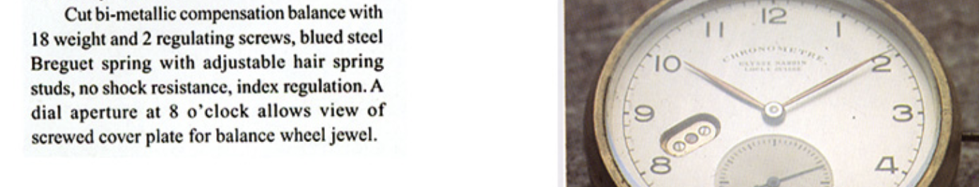

Are you referring to the spot at the red arrow?
If so, that has nothing to do with regulating the movement. That shows (for some reason) the cap jewel on one of the wheels in the movement. These are typically done on the balance, but could also be an escape wheel.
You are correct, for some reason I have always assumed (wrongly) it had some utilitarian meaning for ease of regulation. May be because it was in the region of the balance wheel. In the Peseux 260 - Ulysse Nardin is on the balance wheel.

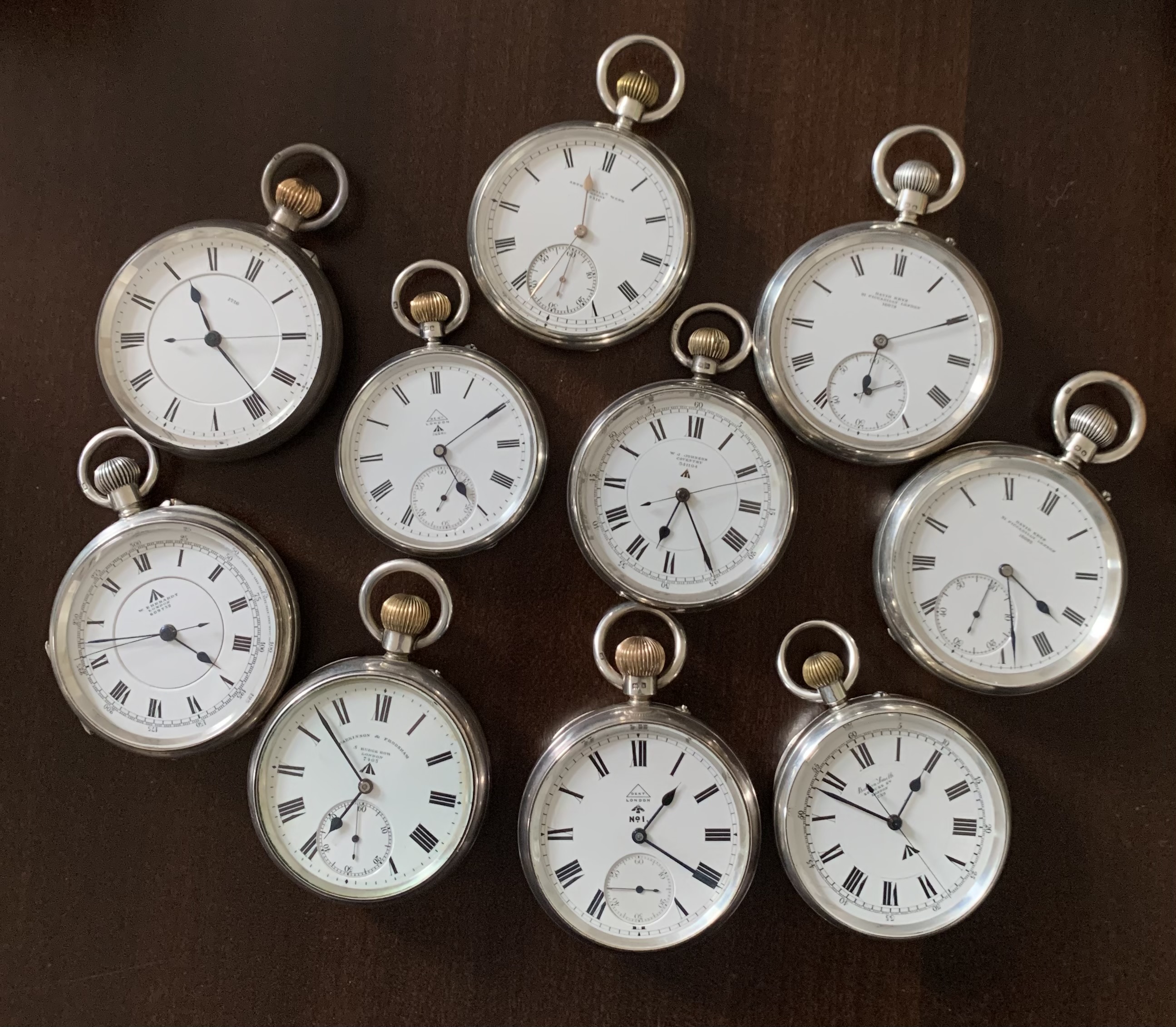

I've now moved on to lusting after Marine Chronometers - apparently I only need 5 or 6 per ship. 😁
287
1,103
I spotted a couple run through auctions and came to a similar conclusion... still way beyond my pocket.
Chris, you'l also need a nice deck watch for each of your fleet 😗

The window in the dial is simply there to be able to check and ensure concentric and correct lubrication of the balance wheel cap jewel. Improper oiling could affect performance and of course this was especially important for competition chronometers.
