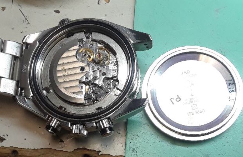

So here is the picture of the movement.
It is unsettling to me how the quality of the picture is far worse than that of the watch. Seems suspicious.
But what do you guys think?
340
416
the quality of image is just BAD. Did the seller take it with a Nokia N95??? I don't really know this movement, but there is no reference number on the rotor plate, not sure if it's normal for this movement.
Also it could just be me but doesnt that bezel look like the one for a new PO not the old sharp pointy one of the 2210 ref. ?

What do you think of the movement though? Looks ok?
worth $3000? I would like to see if I can get it for 2600$ What do you guys think?
Pictures to low detail to make a comment. Appears to be a 3313. And the caseback raises some questions... or at least points to a very early one.
Yes, completely normal for this movement. The caliber is not on the rotor.

The case back should have engravings - both versions of the case used on this model had engravings on the case back, so if they are not there, they have been removed. BTW this is the first version of the case.
Please ask the seller to send you the full serial number, and post it here - I'll double check it to be sure this isn't some kind of franken. The fact that he sent you such good photos of the watch, but then a crappy photo of the movement, makes me feel uneasy.

So I was contacted by the salesman via phone. They are not sure how or why the case back is devoid of the engravings. However, due to this I was offered a price of $2400 with a 30 day money back guarantee with box and papers from Omega and the watch was recently serviced by their watchmakers. They assured me the whole watch is authentic and not a franken-watch and that even the case back is an authentic Omega piece. I did not ask for any further questions concerning the serial number and was not given the serial number. They were kind and enthusiastic about this piece. This place has a 5 star rating and they are certain that I will find nothing wrong with the watch. I think its important to note that I didn't even ask for a lower price it was simply offered to me as i assume they noticed my concern over the piece particularly the case back.
Im not sure how to approach this now so what would you do? and What do you guys think?
16,854
47,854
They have a 5 star rating and you won’t find anything wrong with the watch.......
There is no engraving ( that’s 🤬ing wrong )
Knowing someone’s opened it with needle nose pliers.
I would have stopped looking 15 minutes ago. 😉
Youre probably right. Who knows what shenanigans they did to the movement if they indeed were able to get it opened. Im gonna pass on this piece.
