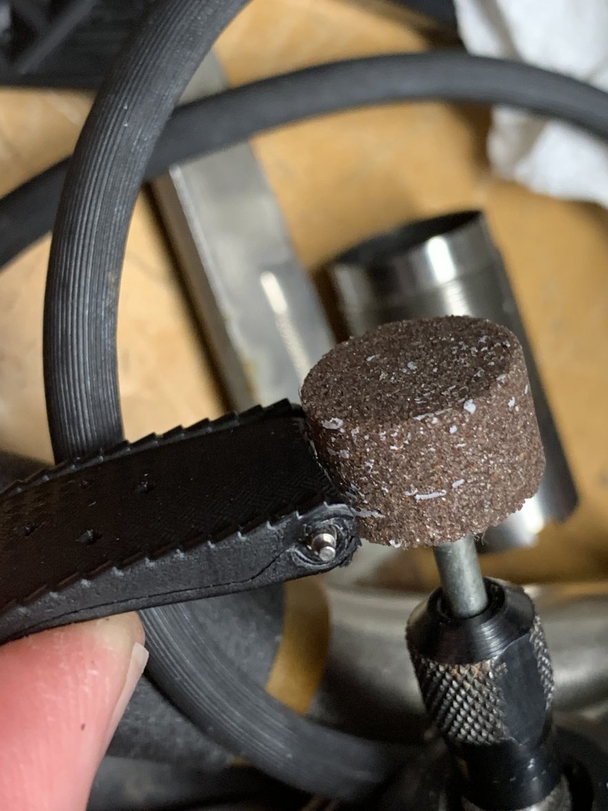

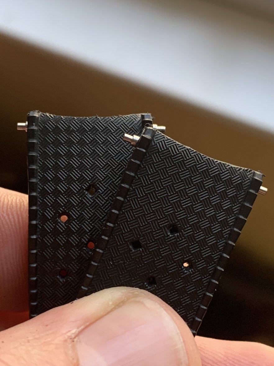

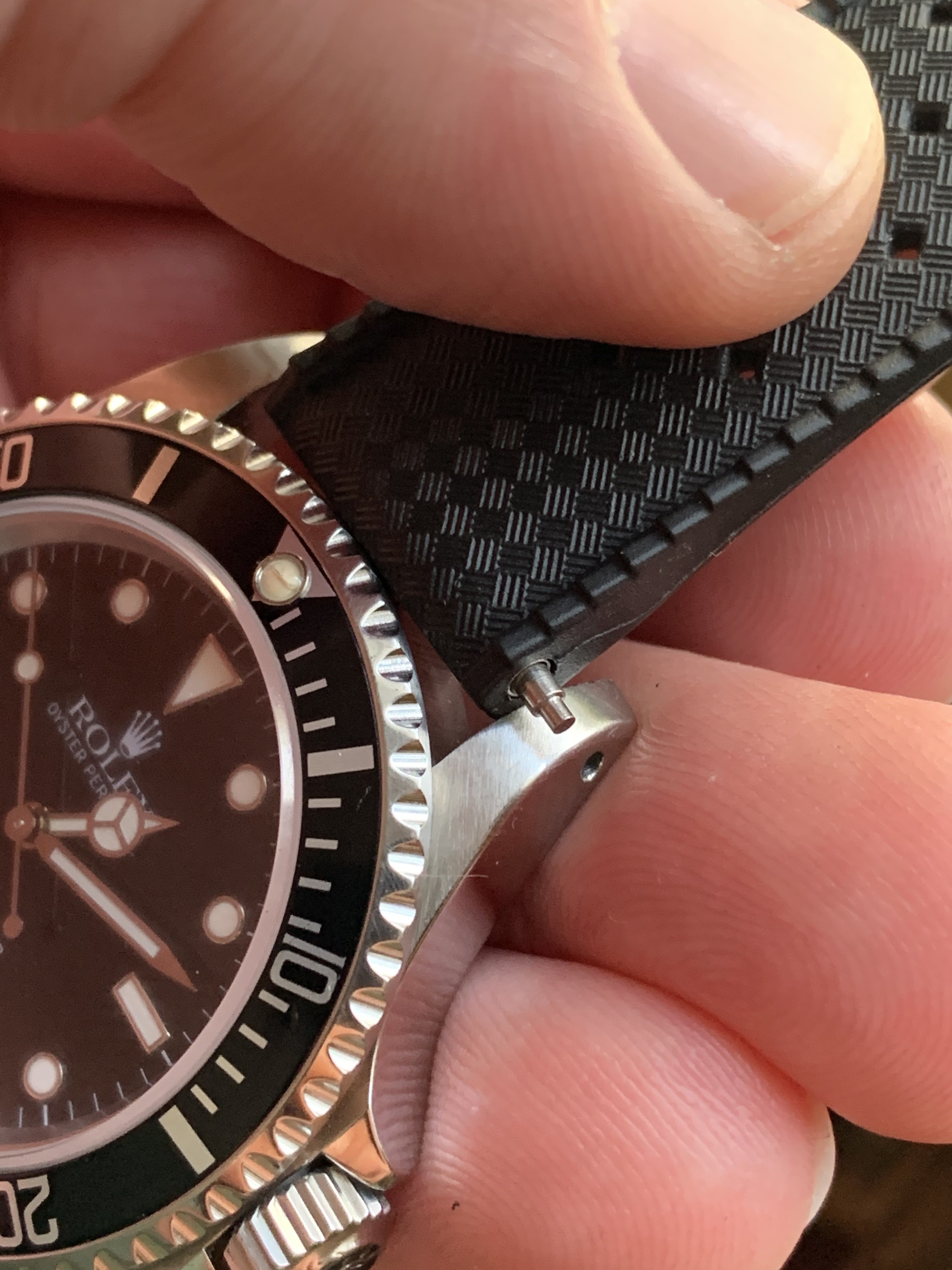

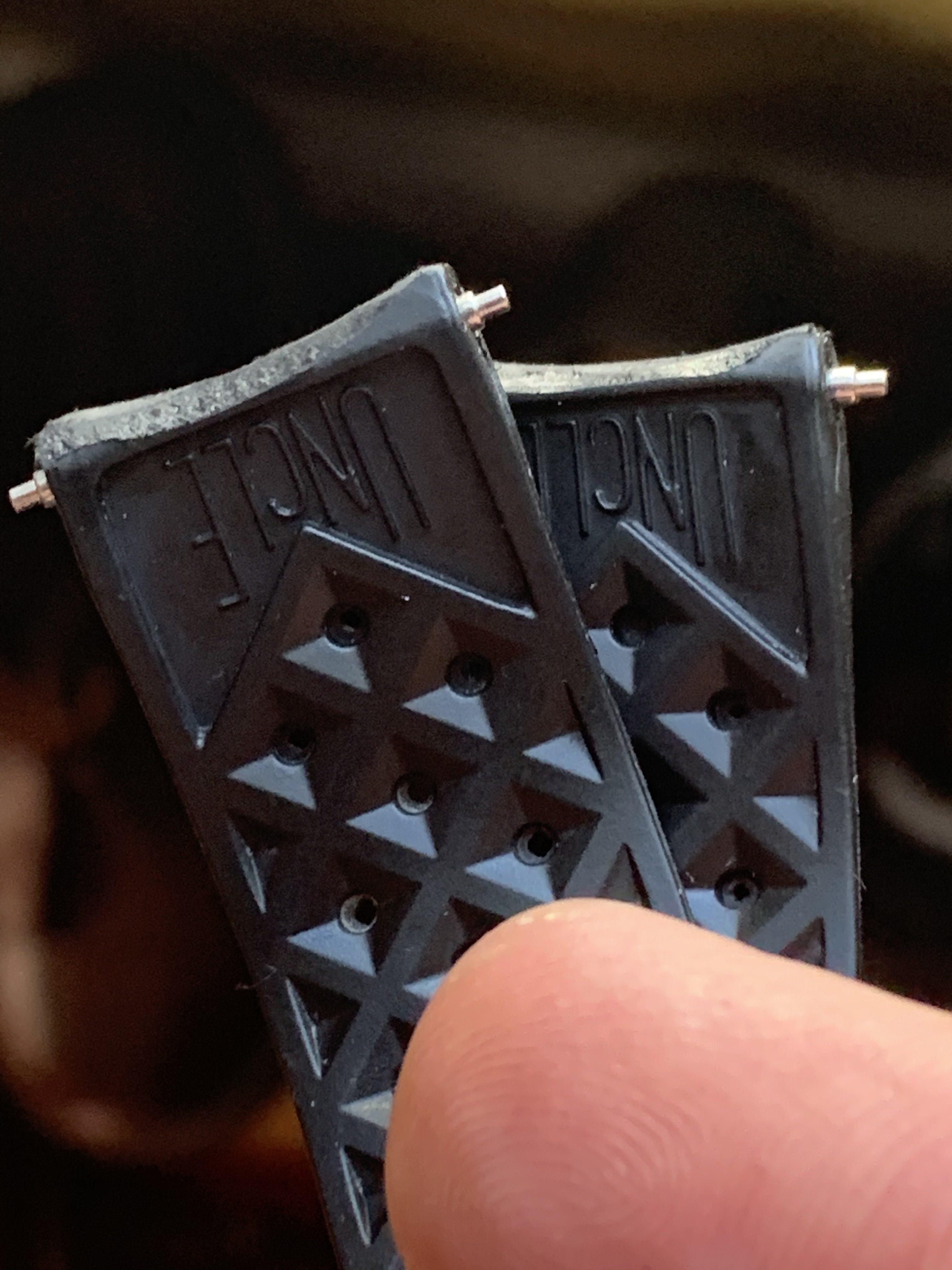

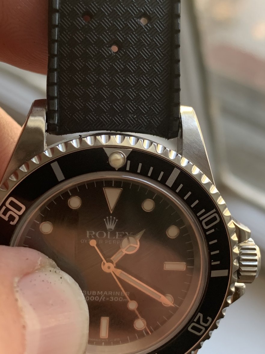

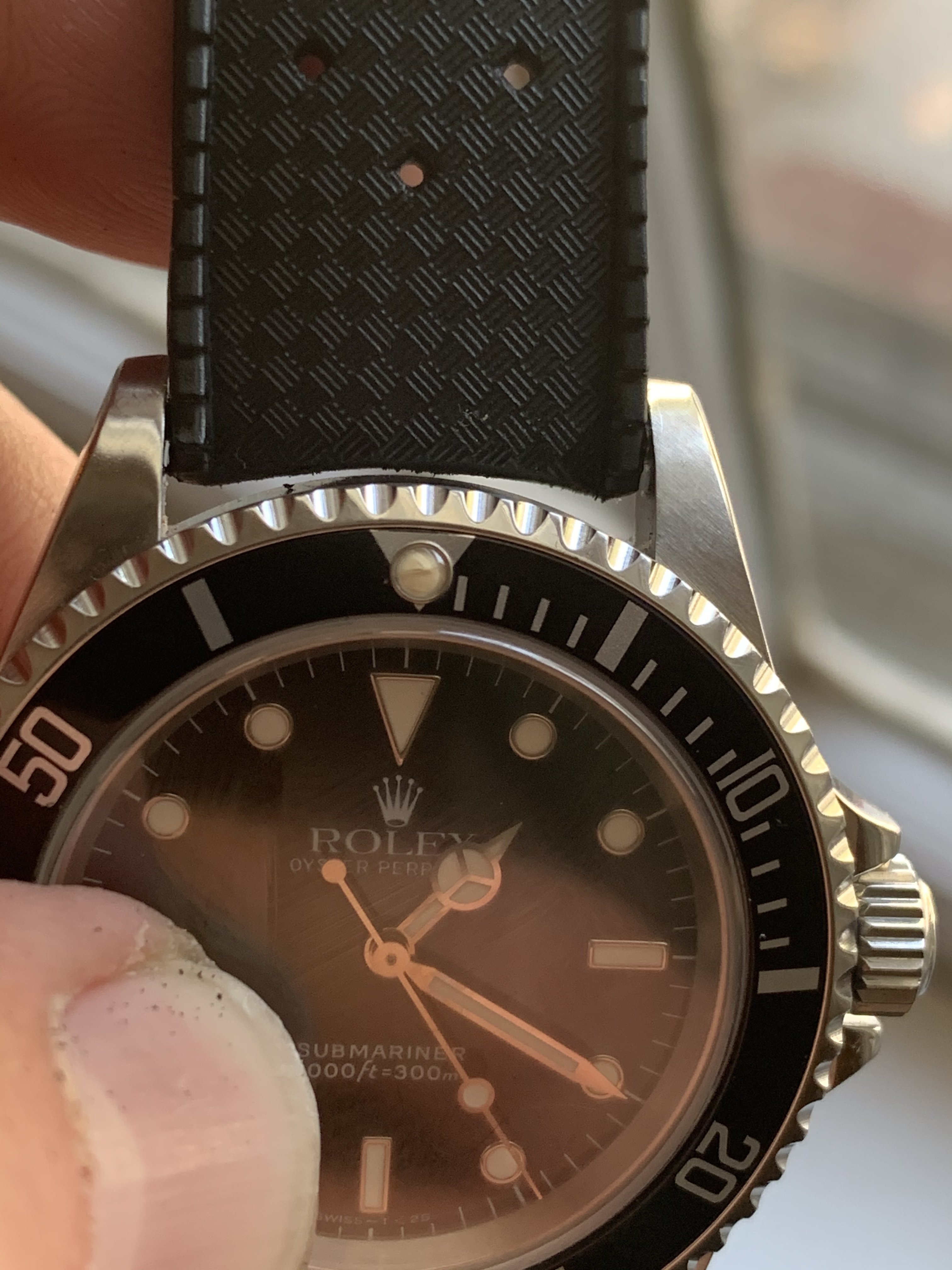

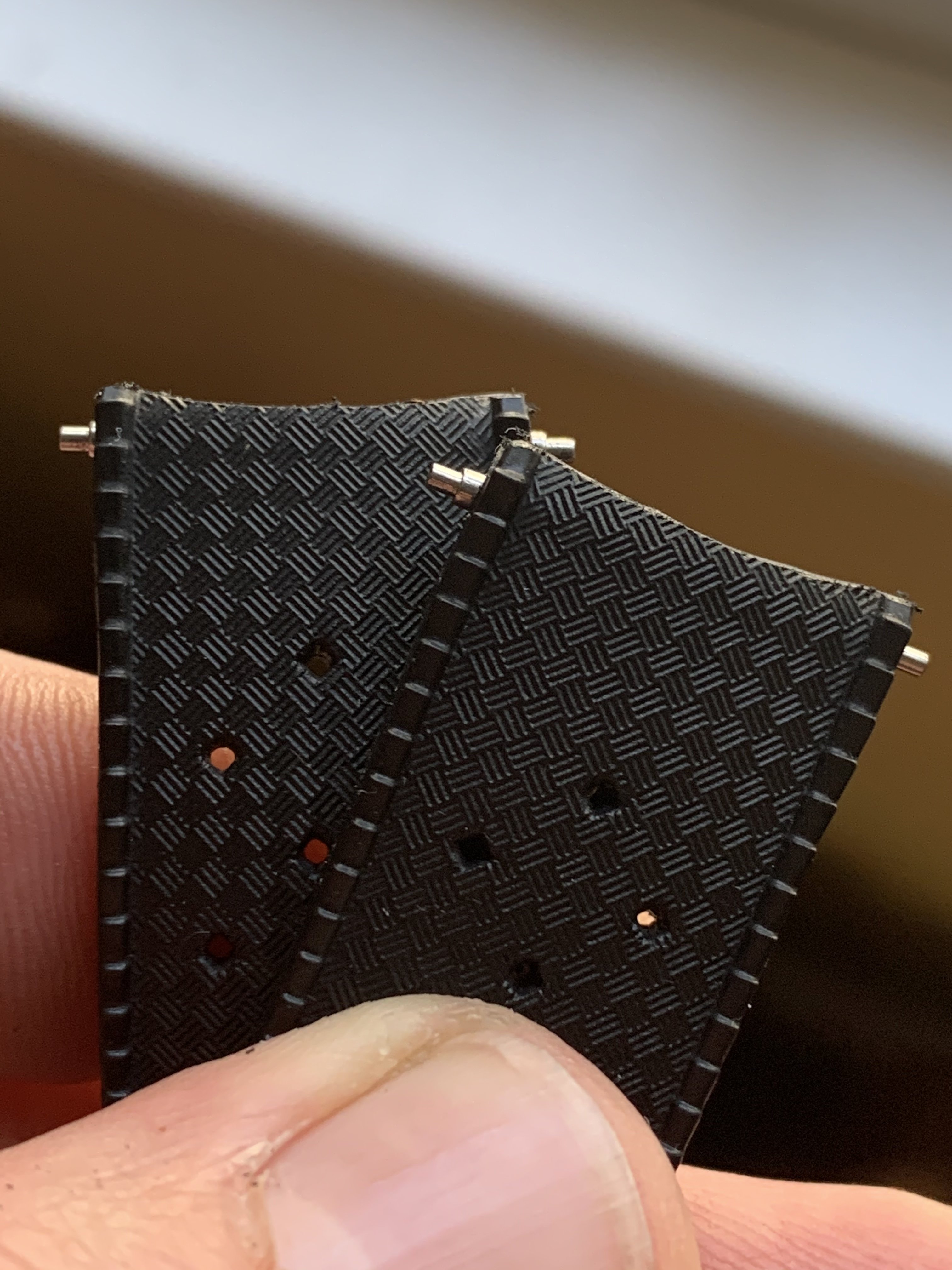

One strap I was exited to try was the Uncle Seiko Tropic, but like most straps that are thick and flat at the top, I discovered that the lug hole to case distance proved to be an issue - something I hadn’t even thought about when I got the sub- that’s a tight gap.

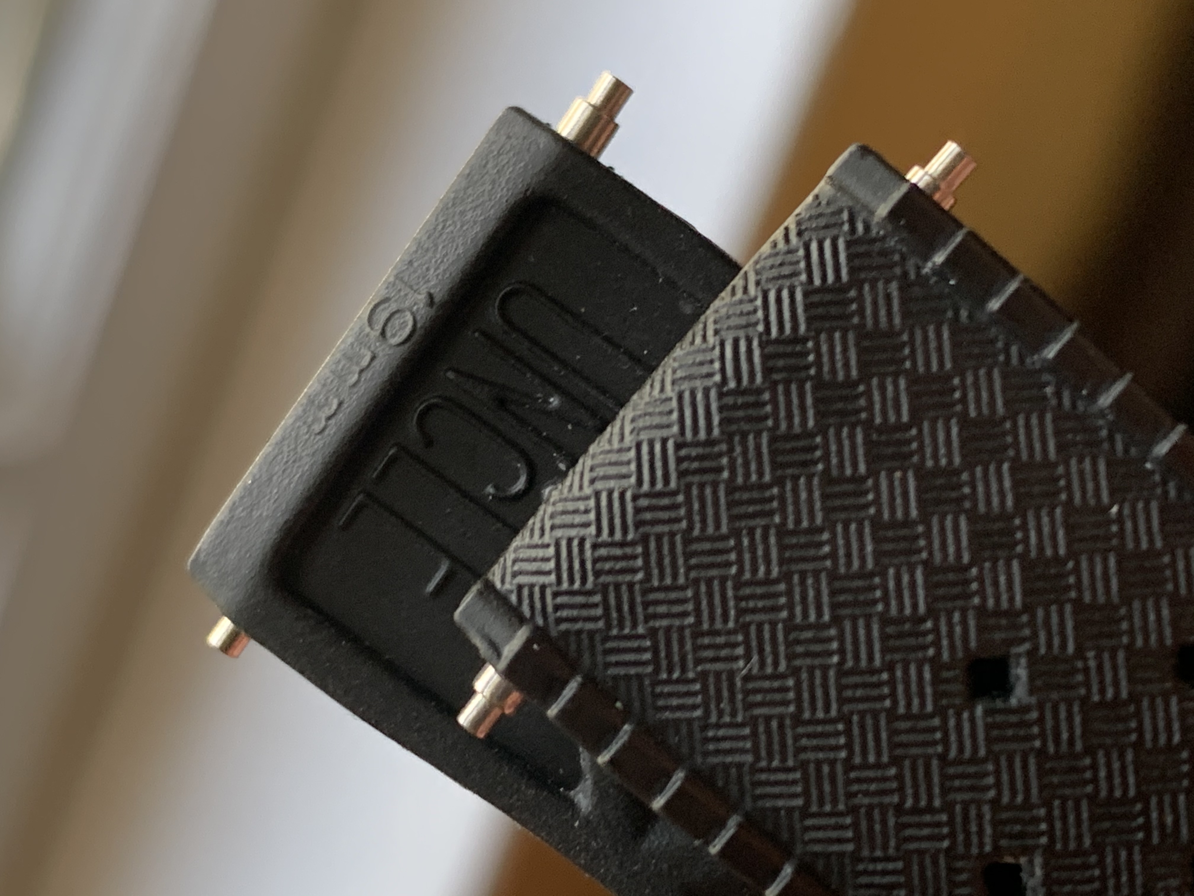

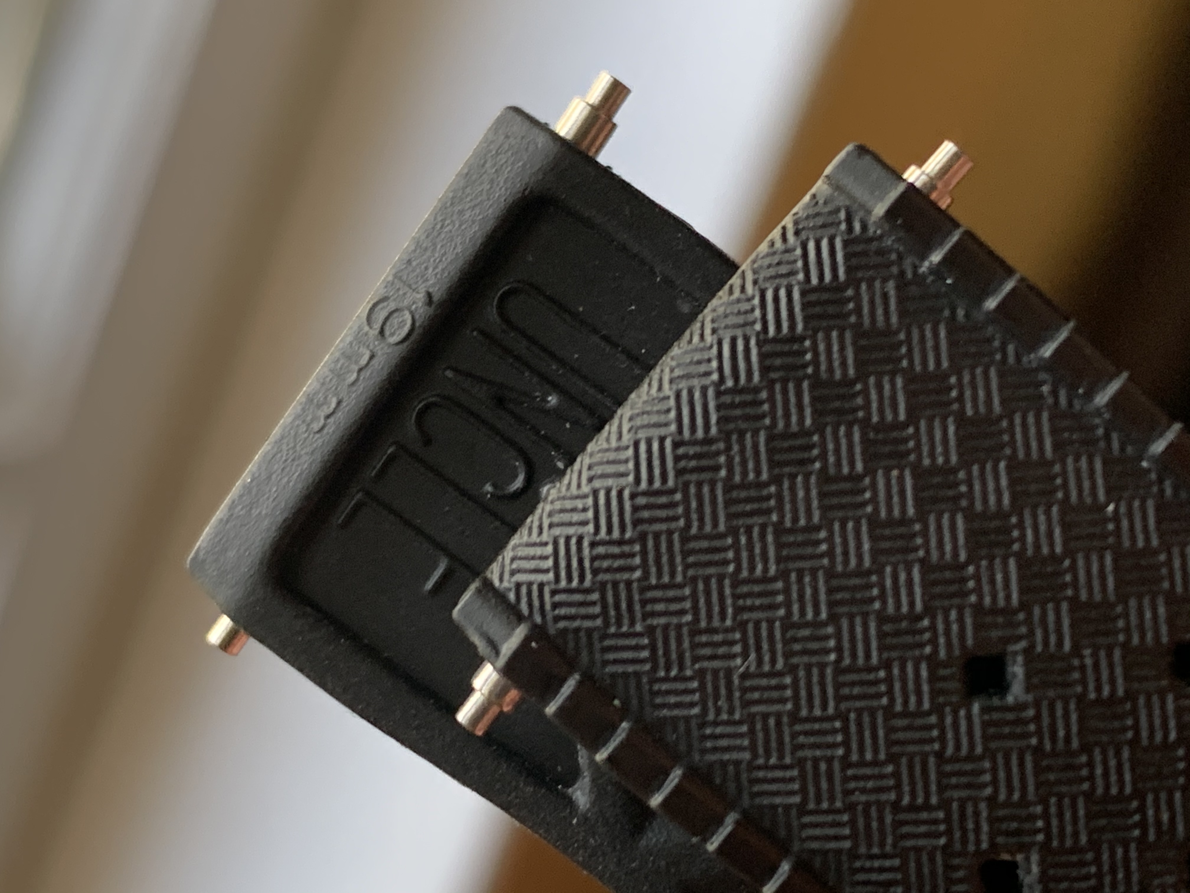

(Yes, that’s a 19mm in the below pic for illustration- I had already modded my 20 when it occurred to me to post this)
I couldn’t even seat the spring bars because it couldn’t clear the case.

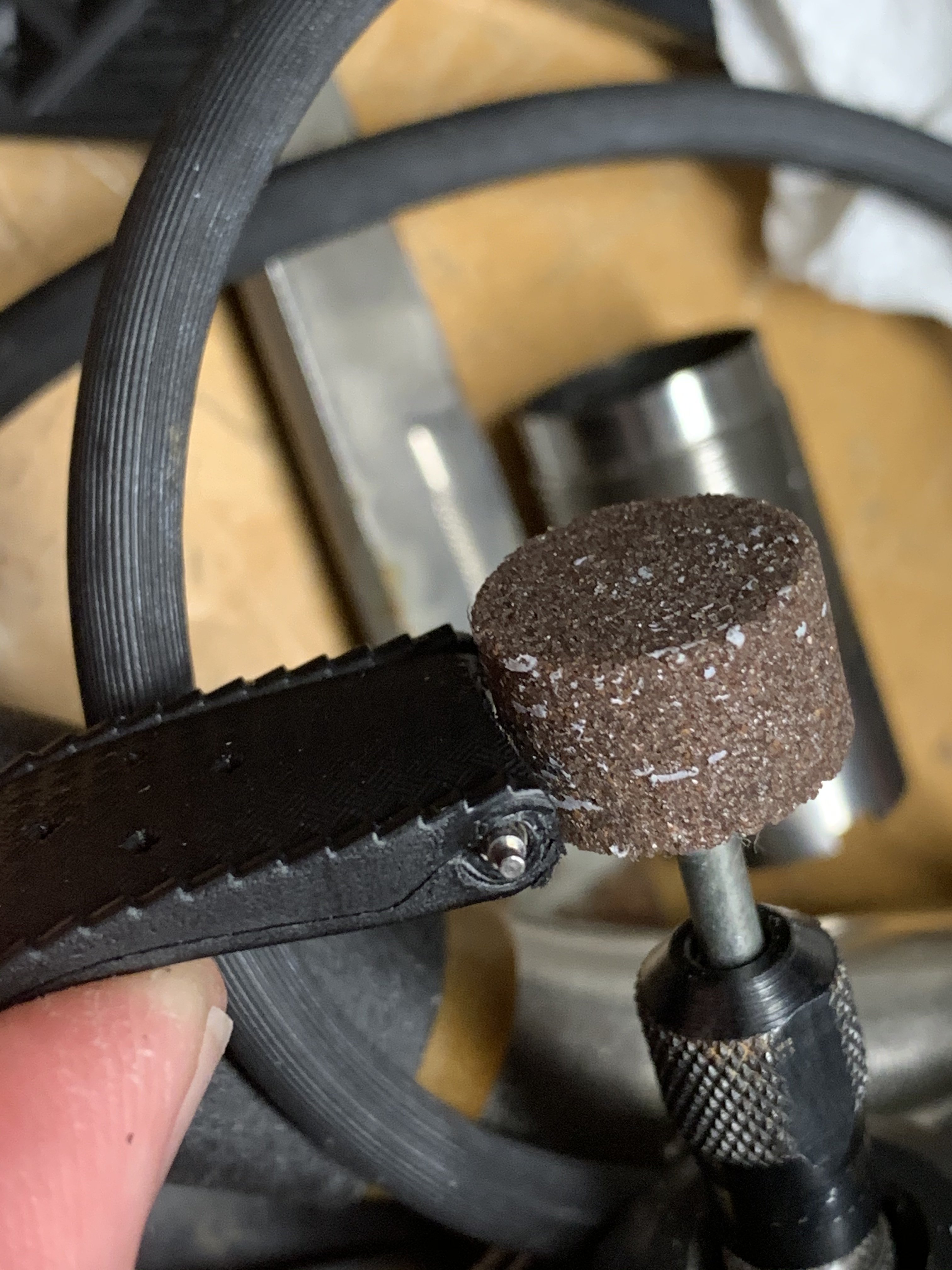

I have several vintage curved tropics but none in 20mm, so I thought that sacrificing a 20mm US to this experiment was a worthy endeavor.
I used a Dremel with a sanding wheel and started to gently grind away at the center and move back and forth to create the curve.
I eyeballed it and when I felt like it was close to the correct shape, I finished it with a little sand paper to smooth out my choppiness (not the steadiest of hands).
Now I have the gap I need between the case and top of the strap for it to move freely.

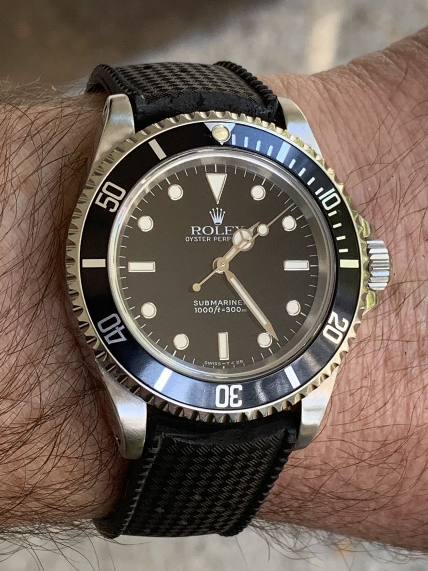

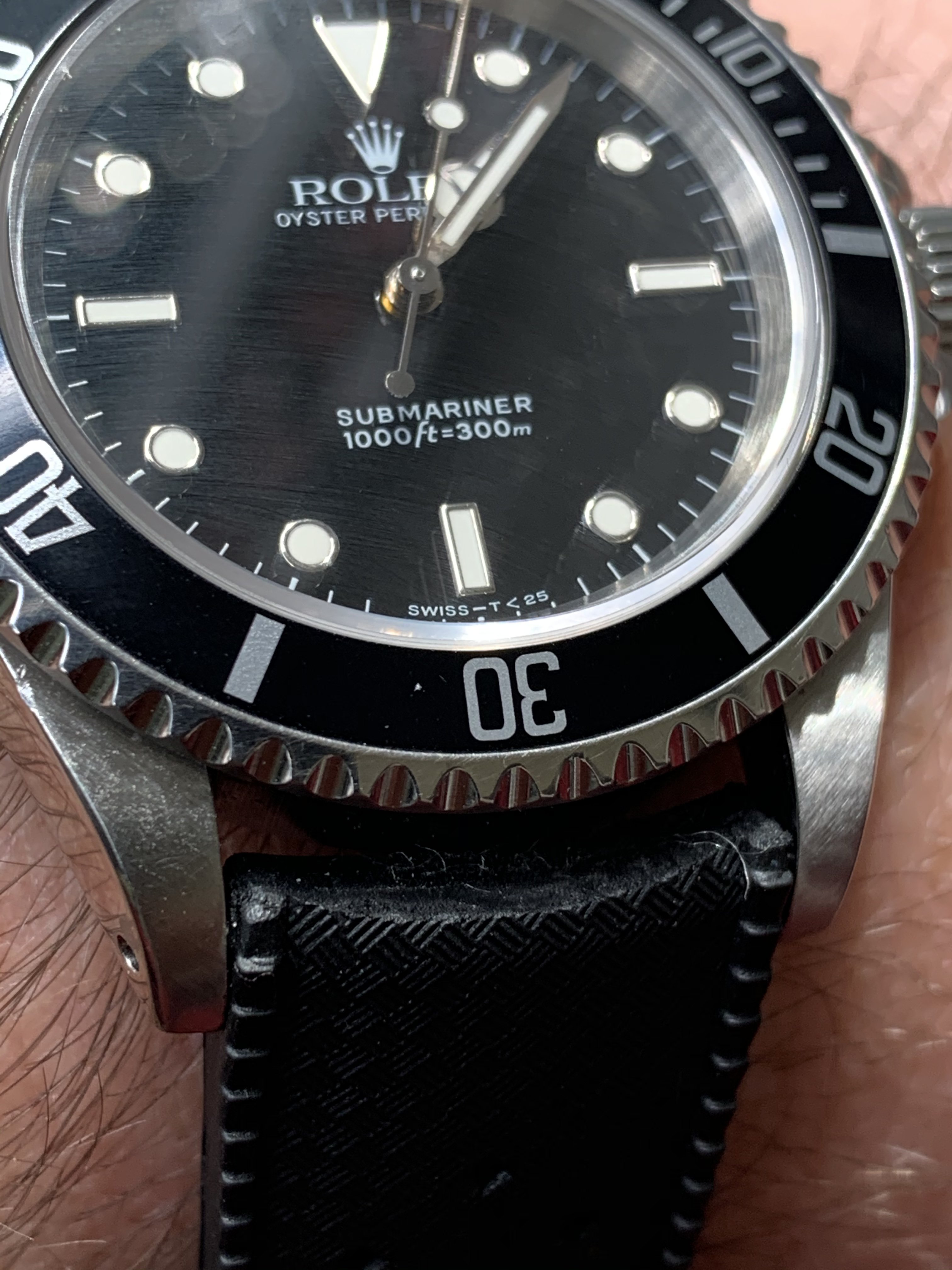

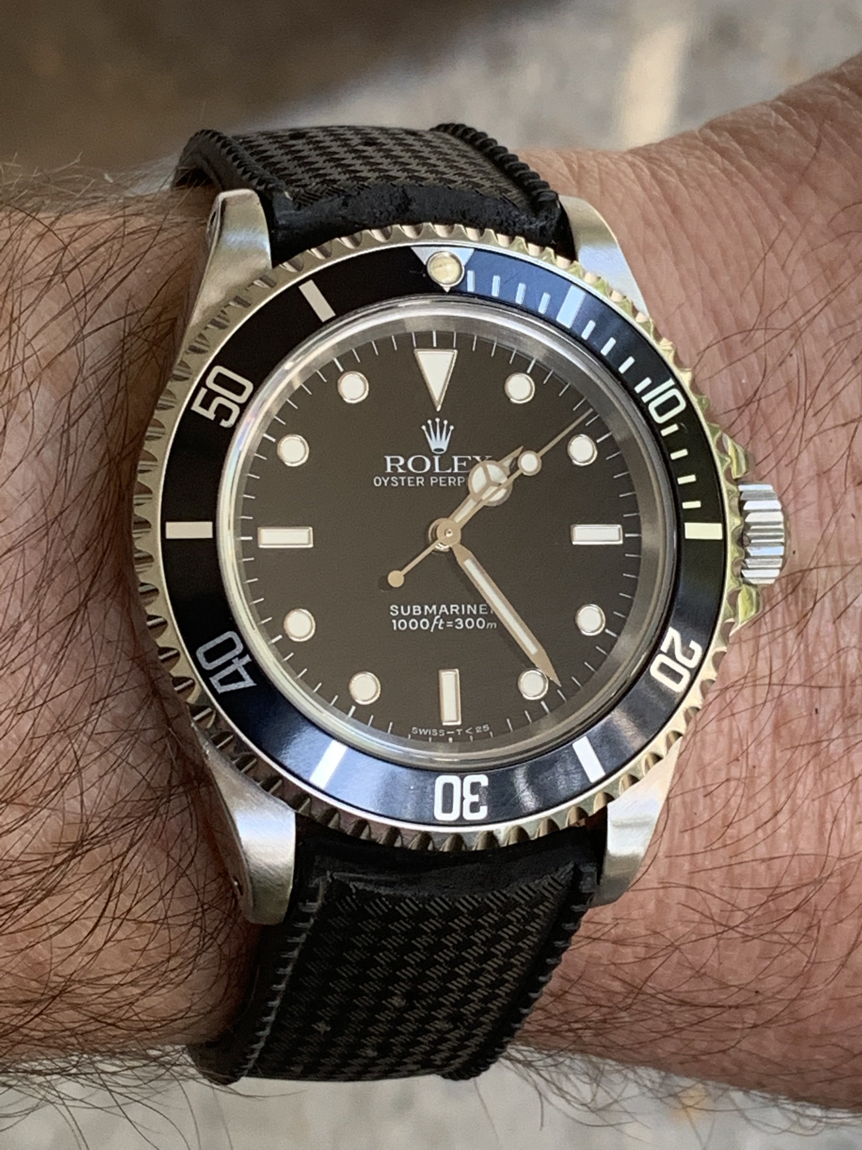

And on the wrist
In hindsight I may have worked to be a little more fluid with my grinding and angled downward the top to maintain more of the pattern on top. I was trying to create an even up/down curve so the strap wouldn’t hang up on the case- but realize after the fact that the strap doesn’t need to flex that way, so couldn’t have kept more of the top pattern.
Regardless, I think it’s promising as an option for these hard-to-fit lugs and my next attempt would probably be a little cleaner looking.

FWIW, I've had to do that with some modern rubber straps also.
24,799
55,081
You can finish it off with a finer wheel to get a more attractive end result. It's easier if you have a bench mount for the Dremel.

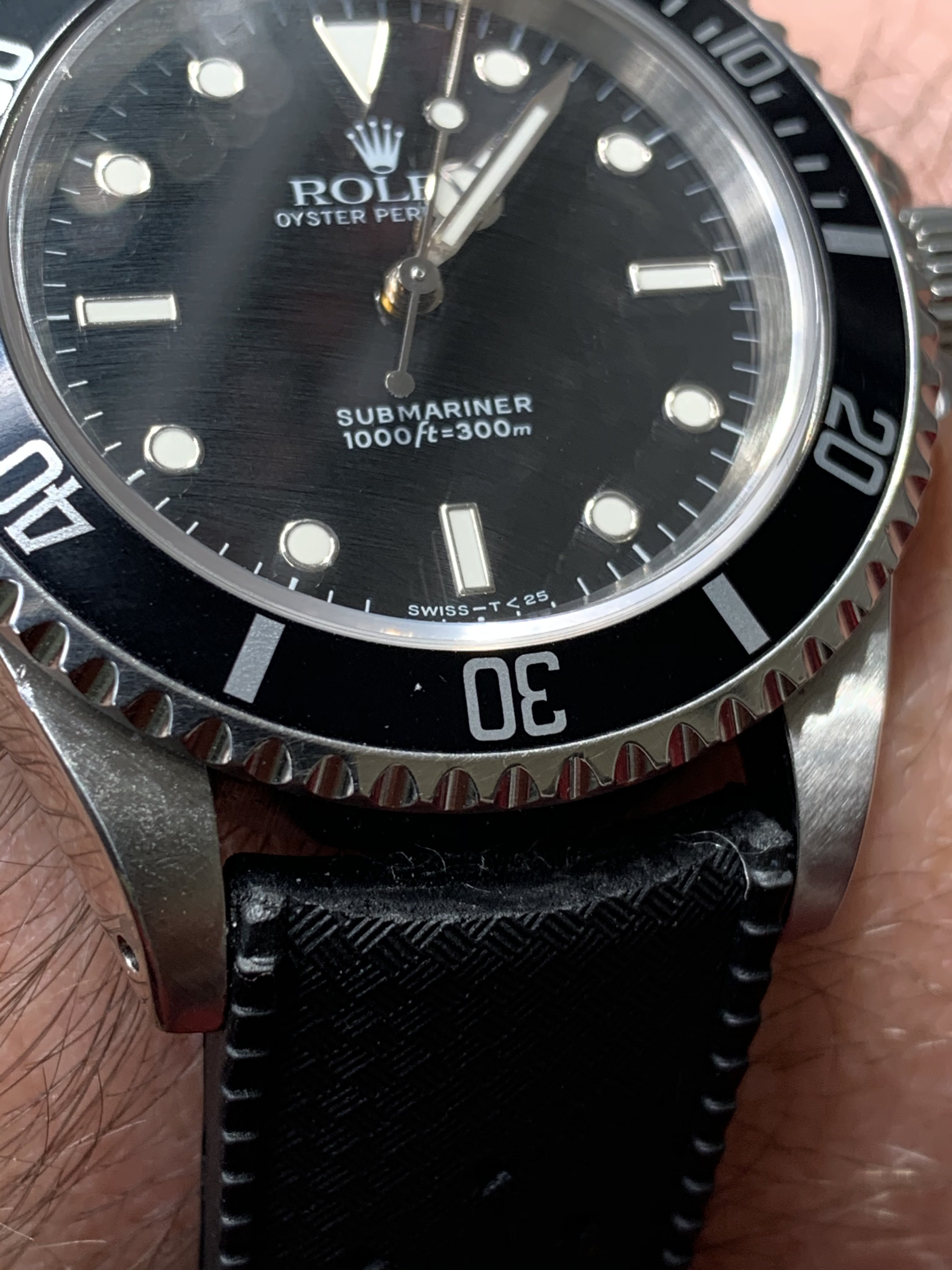

On the wrist you can’t really see the unfinished edge as you can in the photo, but I was thinking that perhaps heat treating it (like with a soldering iron) could smooth out that visible top edge
That’s a good thought- I think I do have finer wheels- but not bench mount- but I could just put it in a vice.

Looks very nice in general let alone the strap, but strap looks great.
8,292
19,579
Looks good 👍 and for the minor imperfections that remain, don’t worry - no one flying at 33K feet will notice them anyway 😁
Heat gun over a soldering iron.

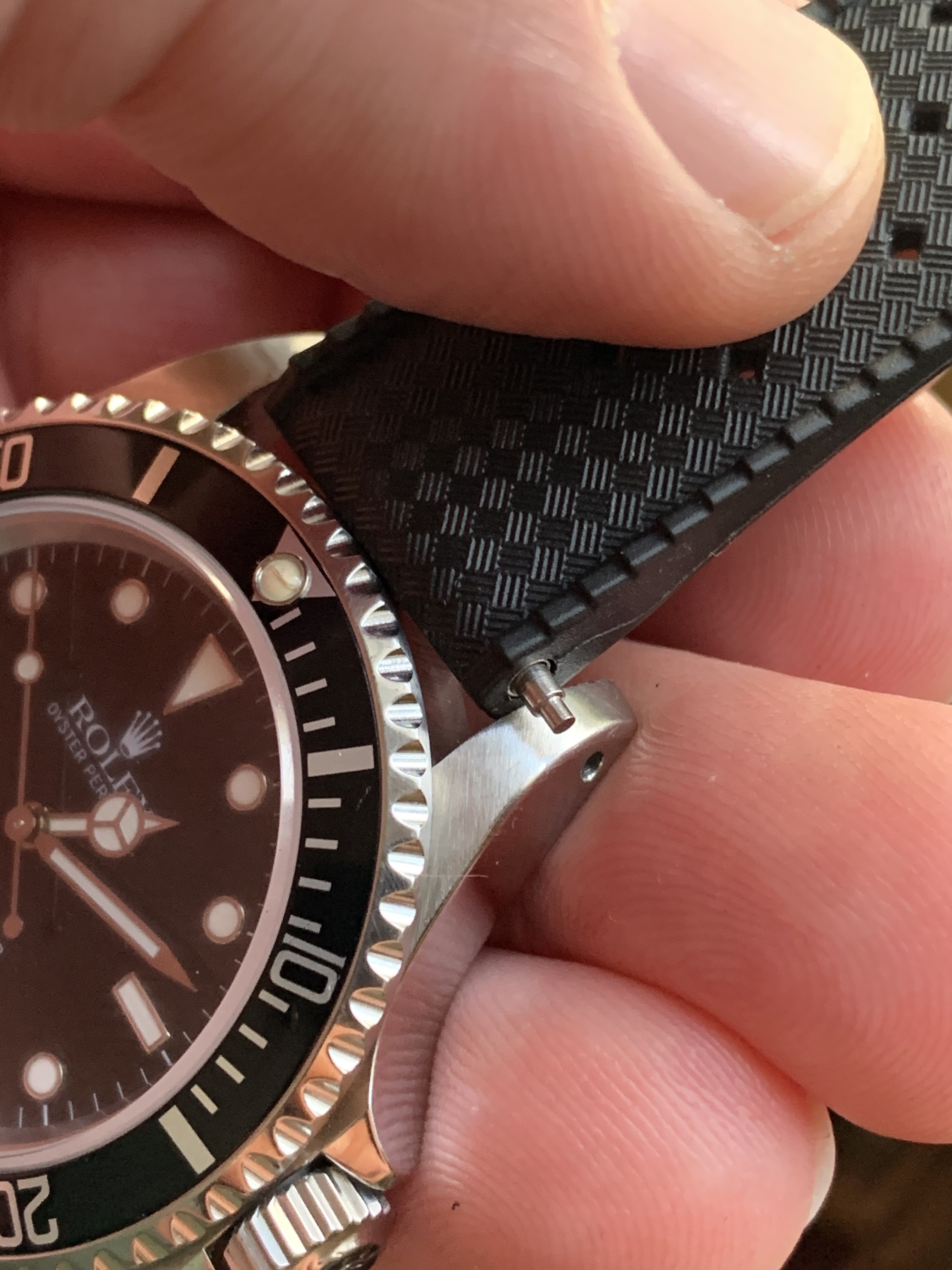

So I went back over it with a finer grit wheel and it did smooth it out
buuuuut, I went too far, and you can see the spring bar peeking through when it flexes on the top end of the strap 🤦
It’s not noticeable on the wrist but I know it’s there...so will be ordering another 20mm strap and doing it again a little less aggressively.
