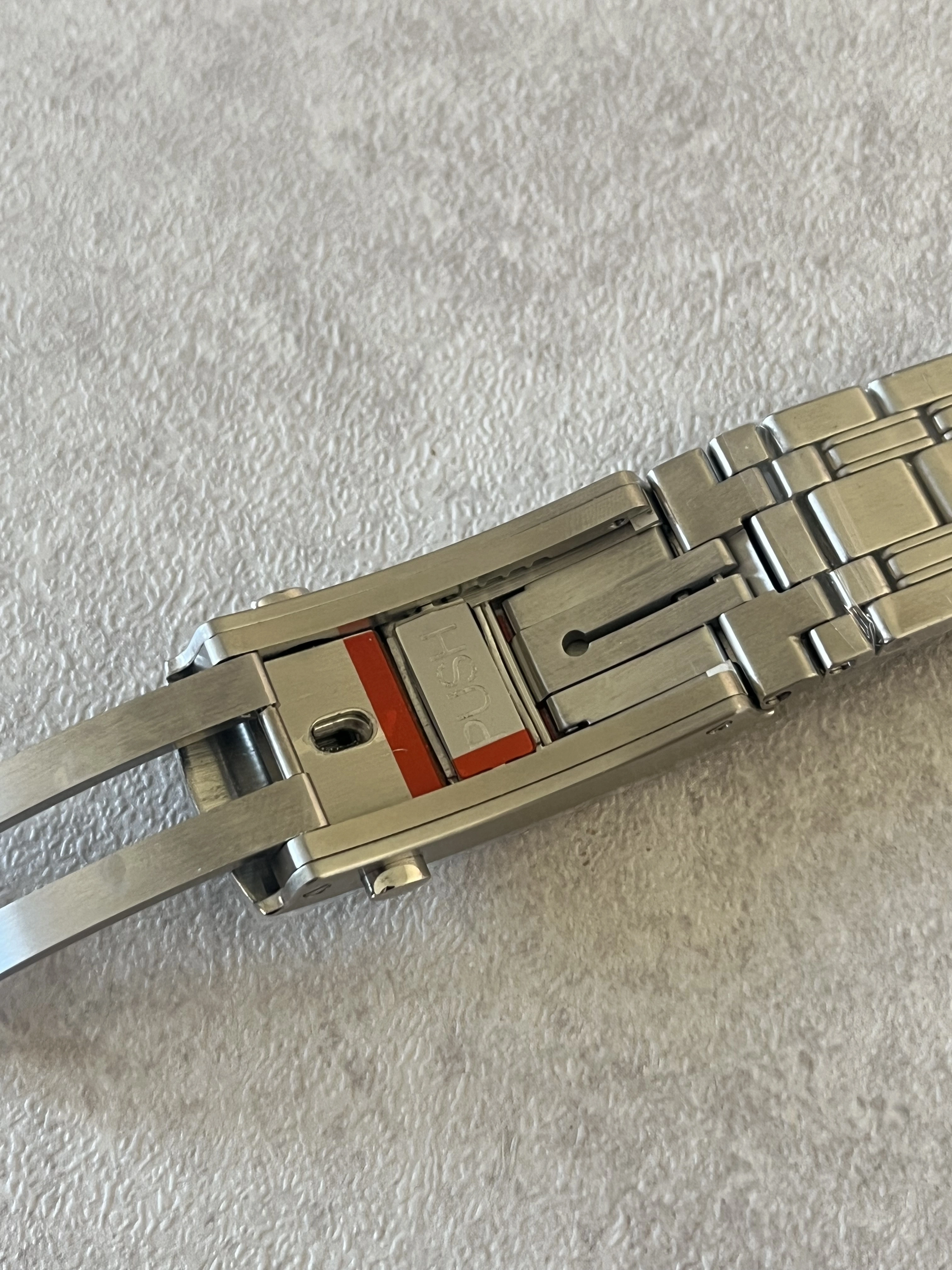

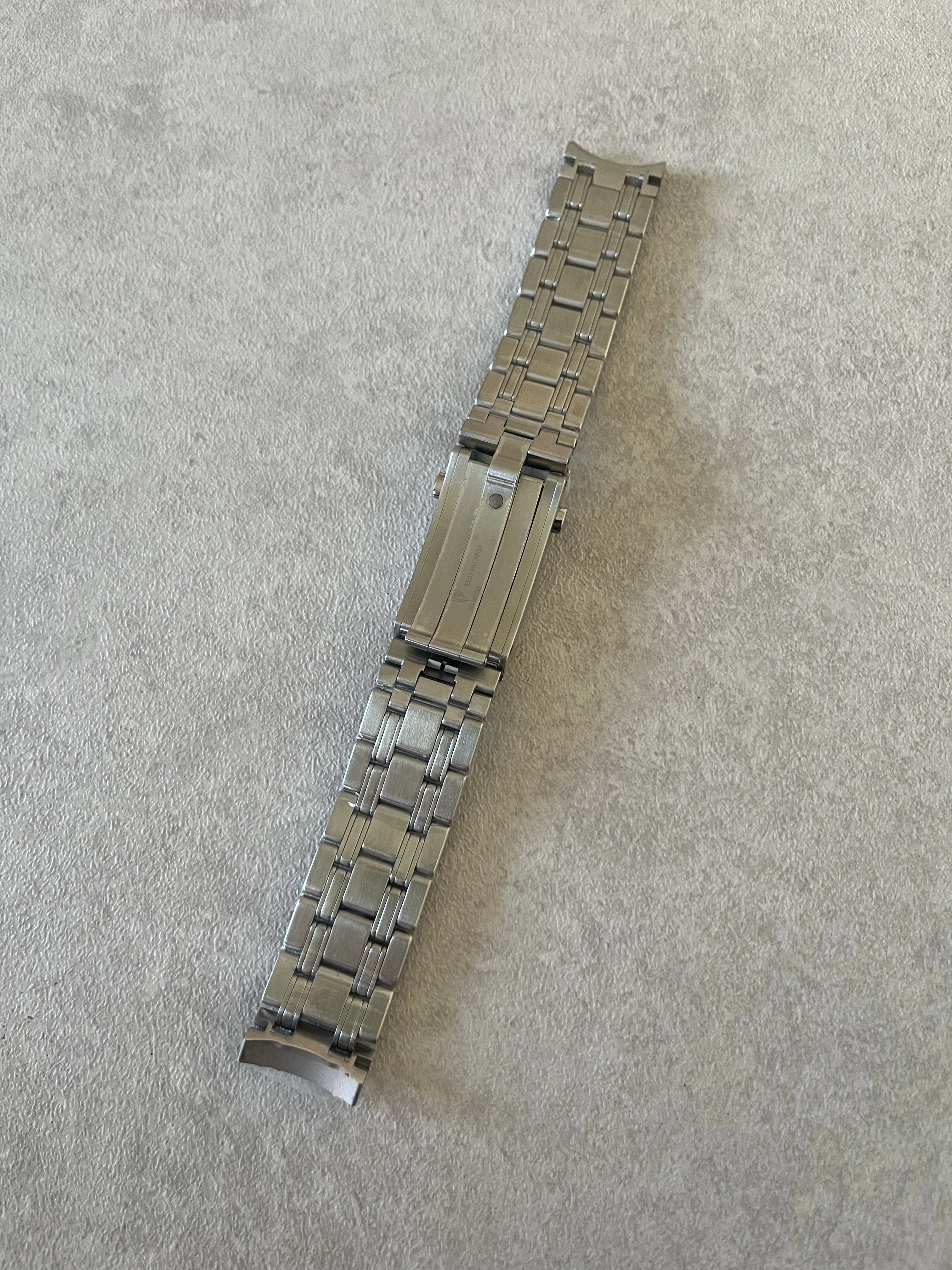

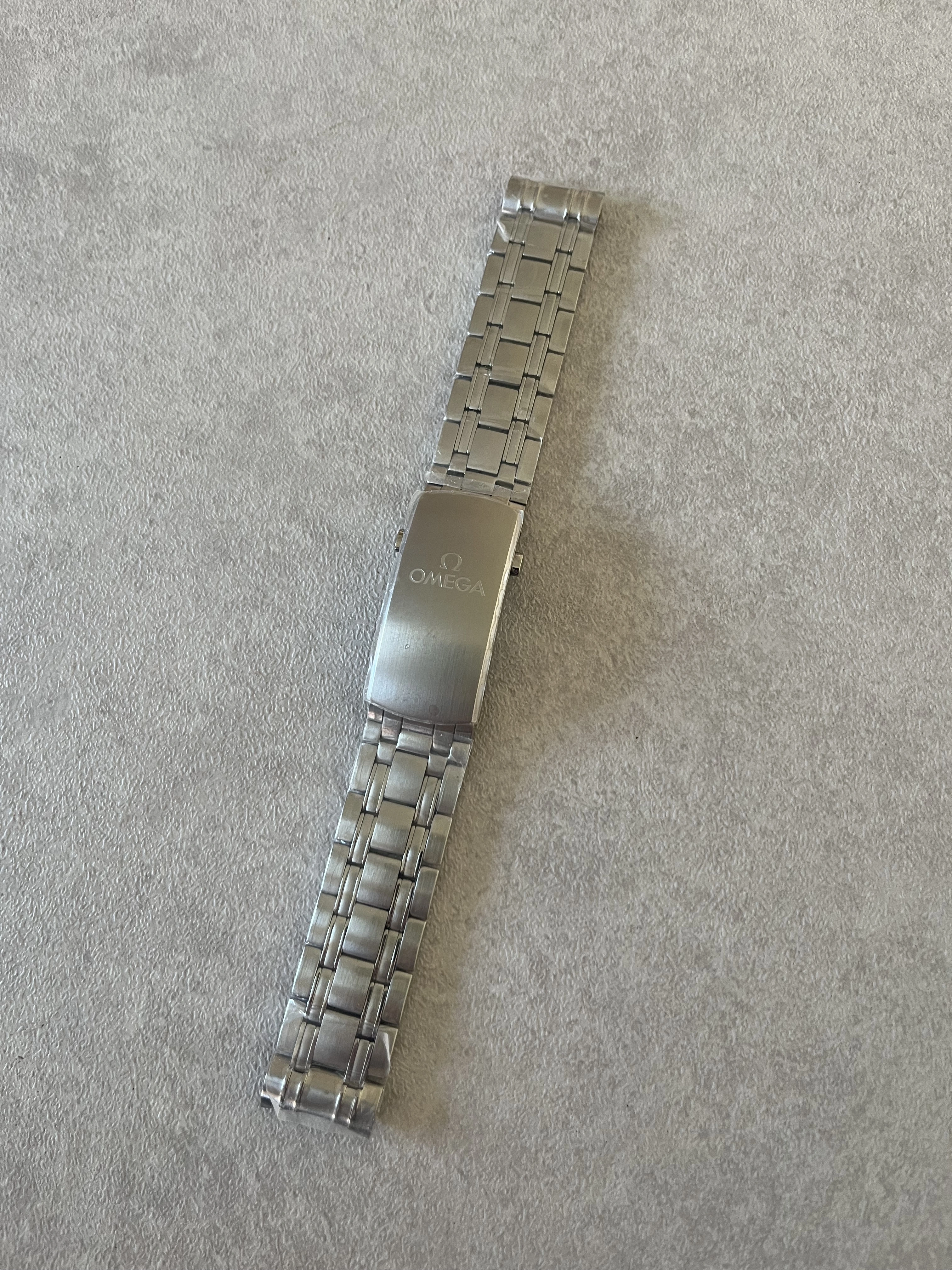

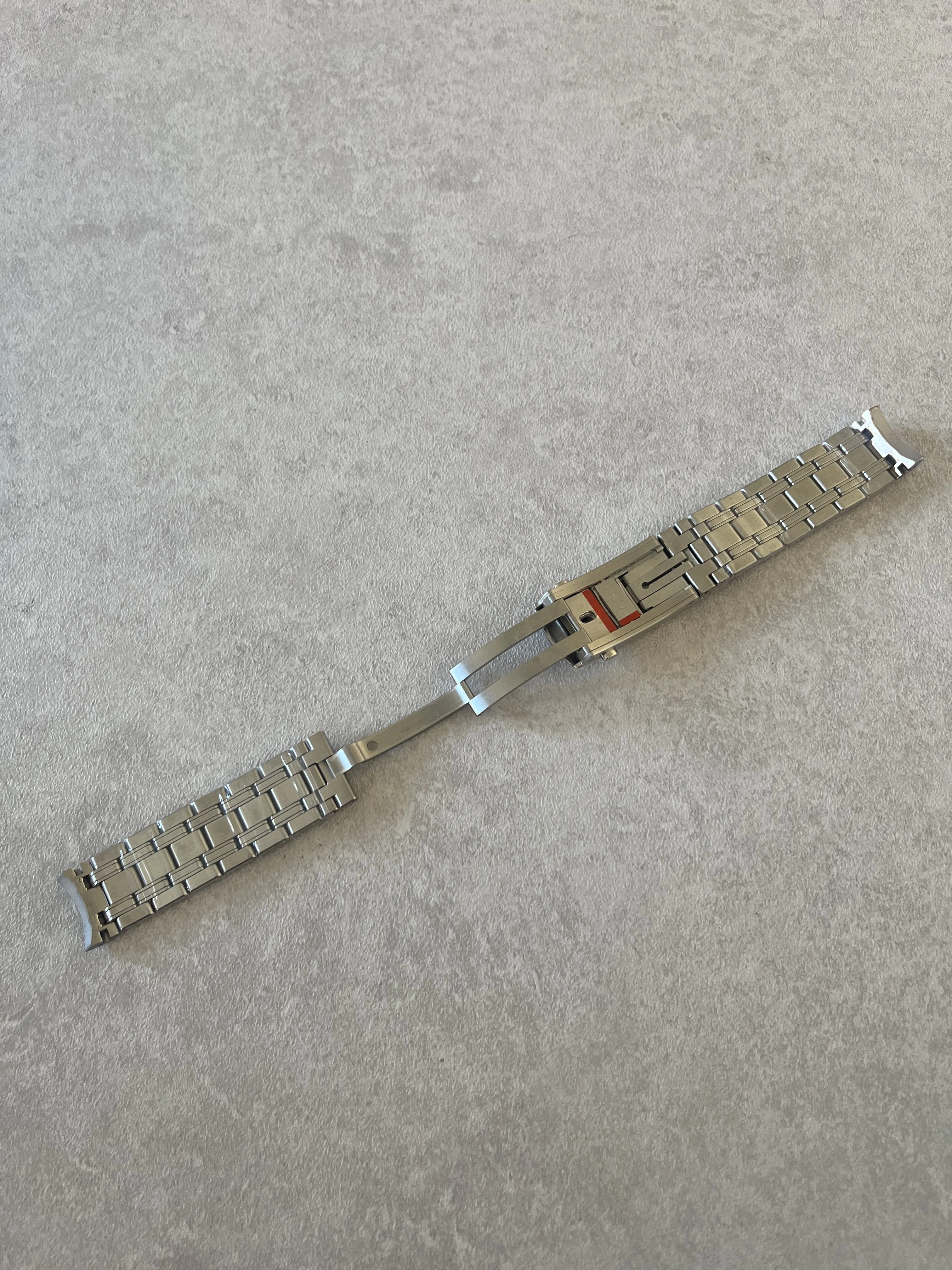

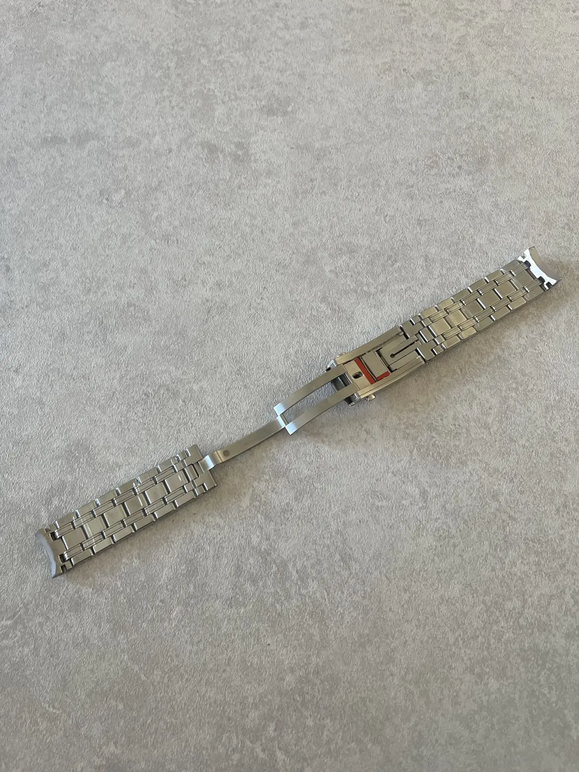

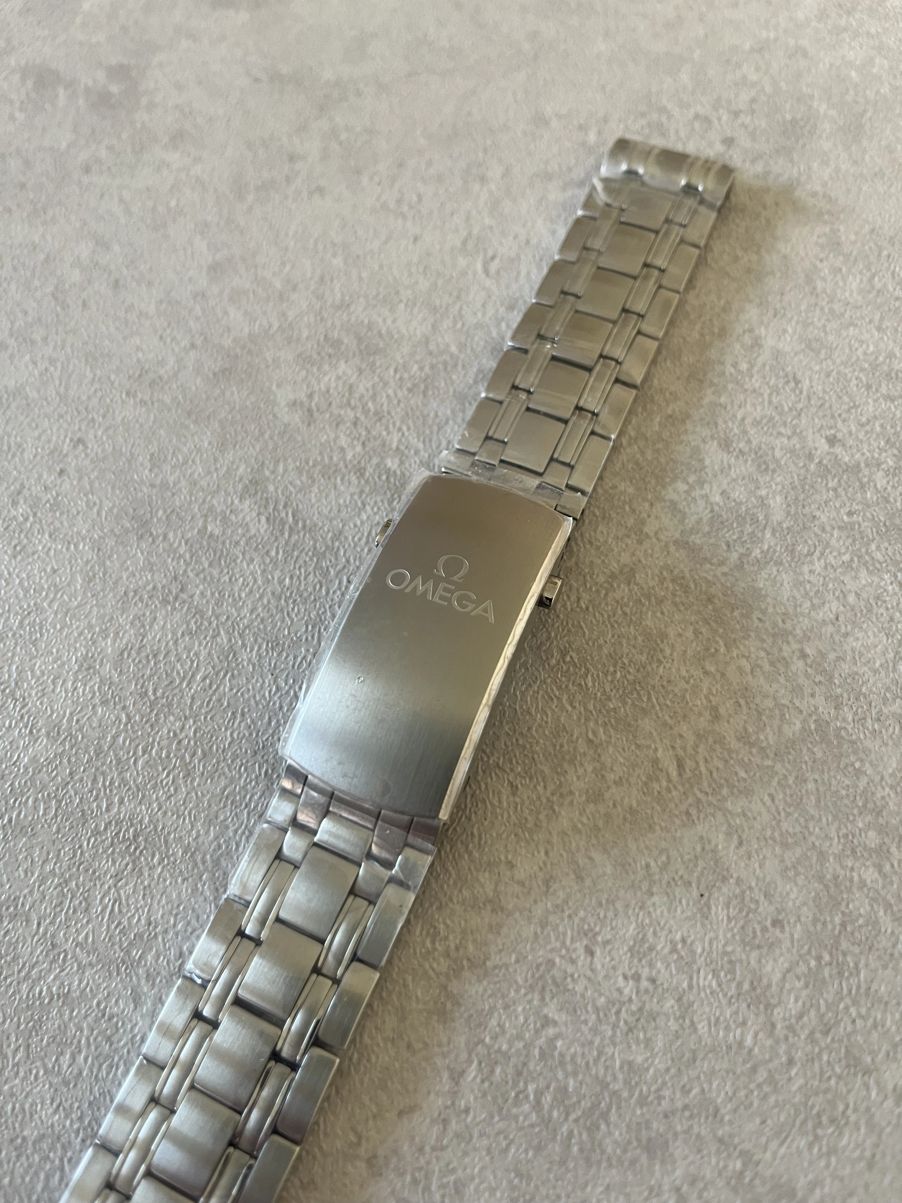

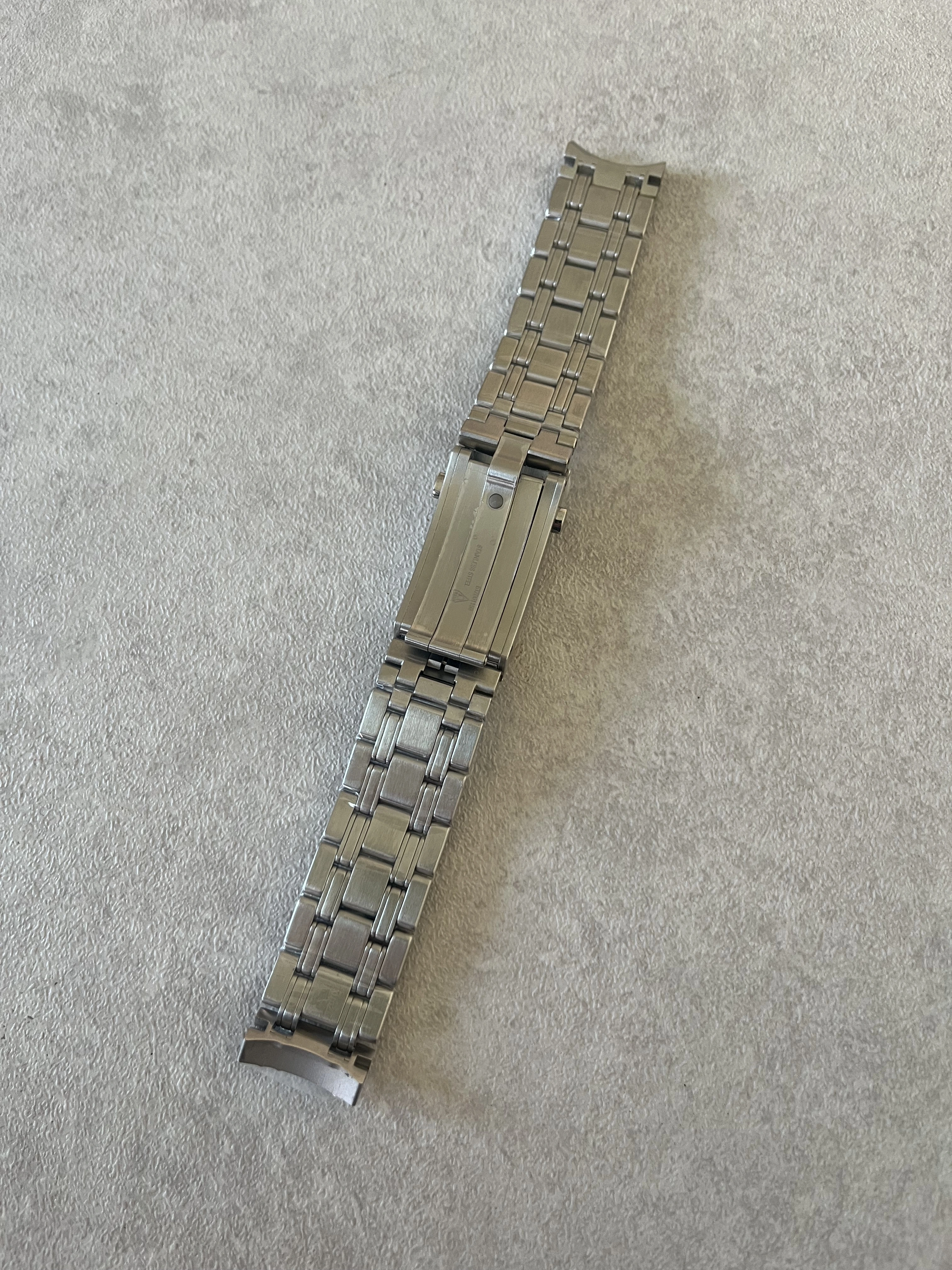

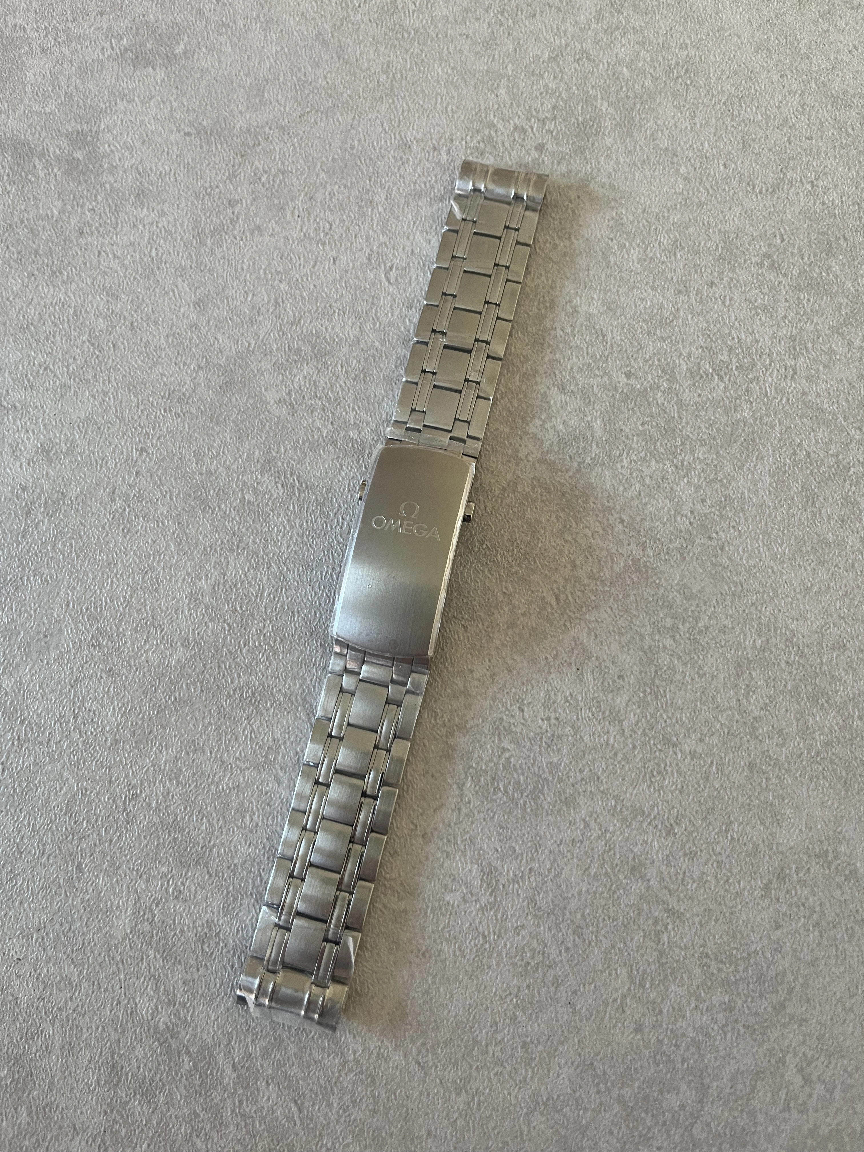

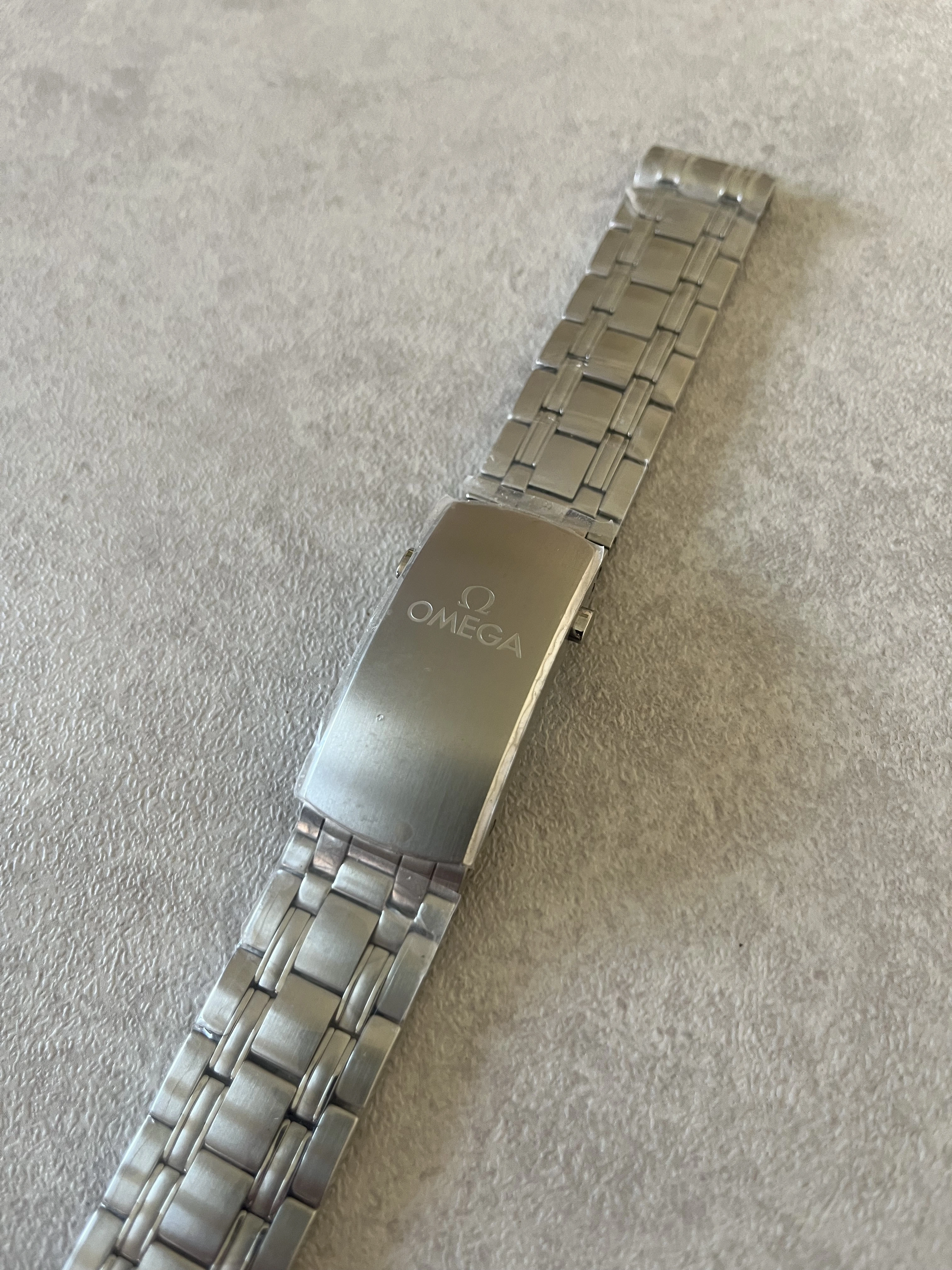

As attached, I sold an SMP 300 bracelet which had previously been on a Summer Blue SMP 300. It was new, sealed, unworn (except for trying on) due to preference of a rubber strap.
I sold the bracelet as pictured, explaining that it was removed due to this preference, however, they claimed they had taken the bracelet to an Omega boutique and requested a refund due to the following:
Item not new, unlikely in Omega's opinion to be from a Seamaster Summer Blue and noted a number of abnormalities on the bracelet, links and clasp. Abnormalities mentioned were the lack of loctite on the bracelet screws, shallow positioning of the screws in the links, the half link not being compatible with the full link.
The buyer now wants to return it having removed all of the seals and seemingly scratched the PUSH part on the clasp. I feel as though Omega are obviously going to express caution and want buyers to purchase direct… How can I successfully dispute this and what would you do in this situation?
6
10

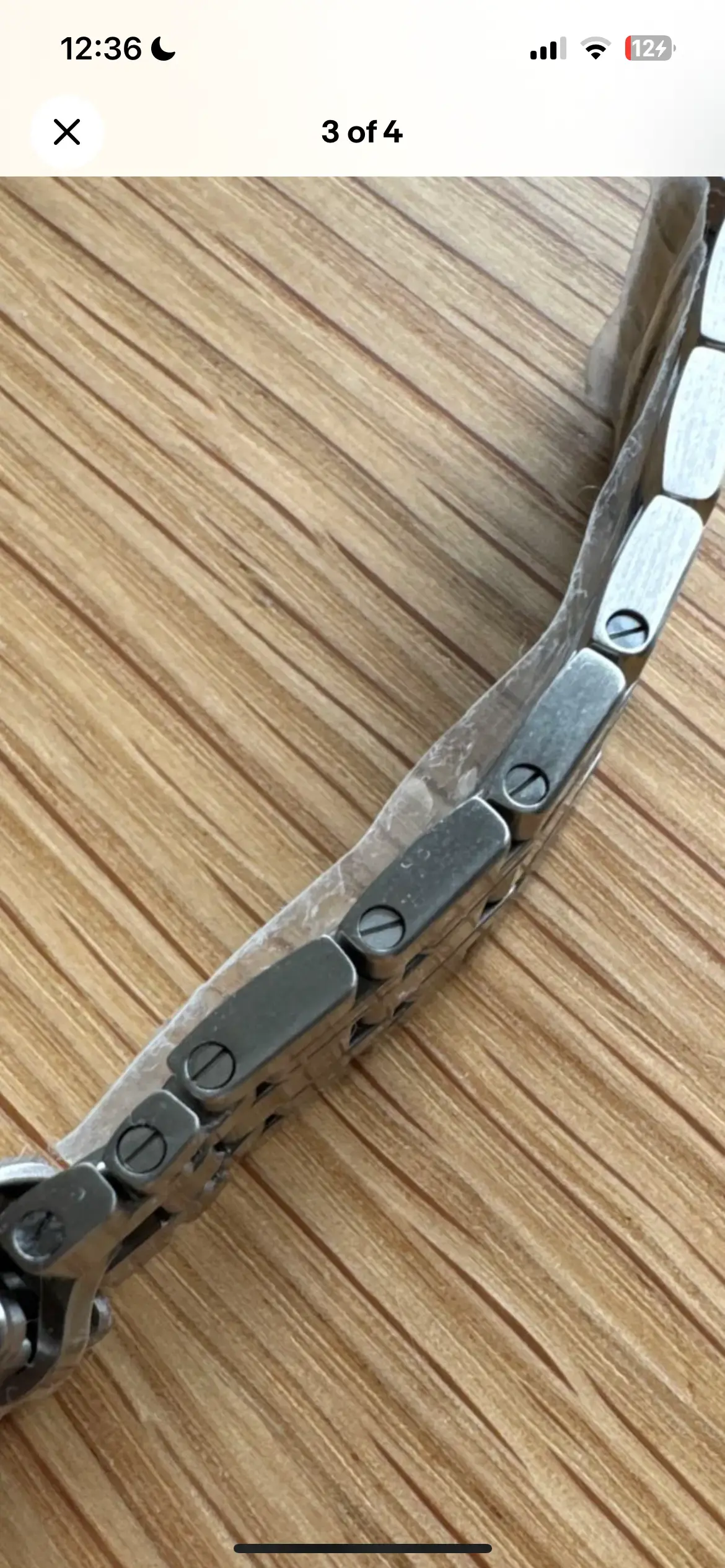

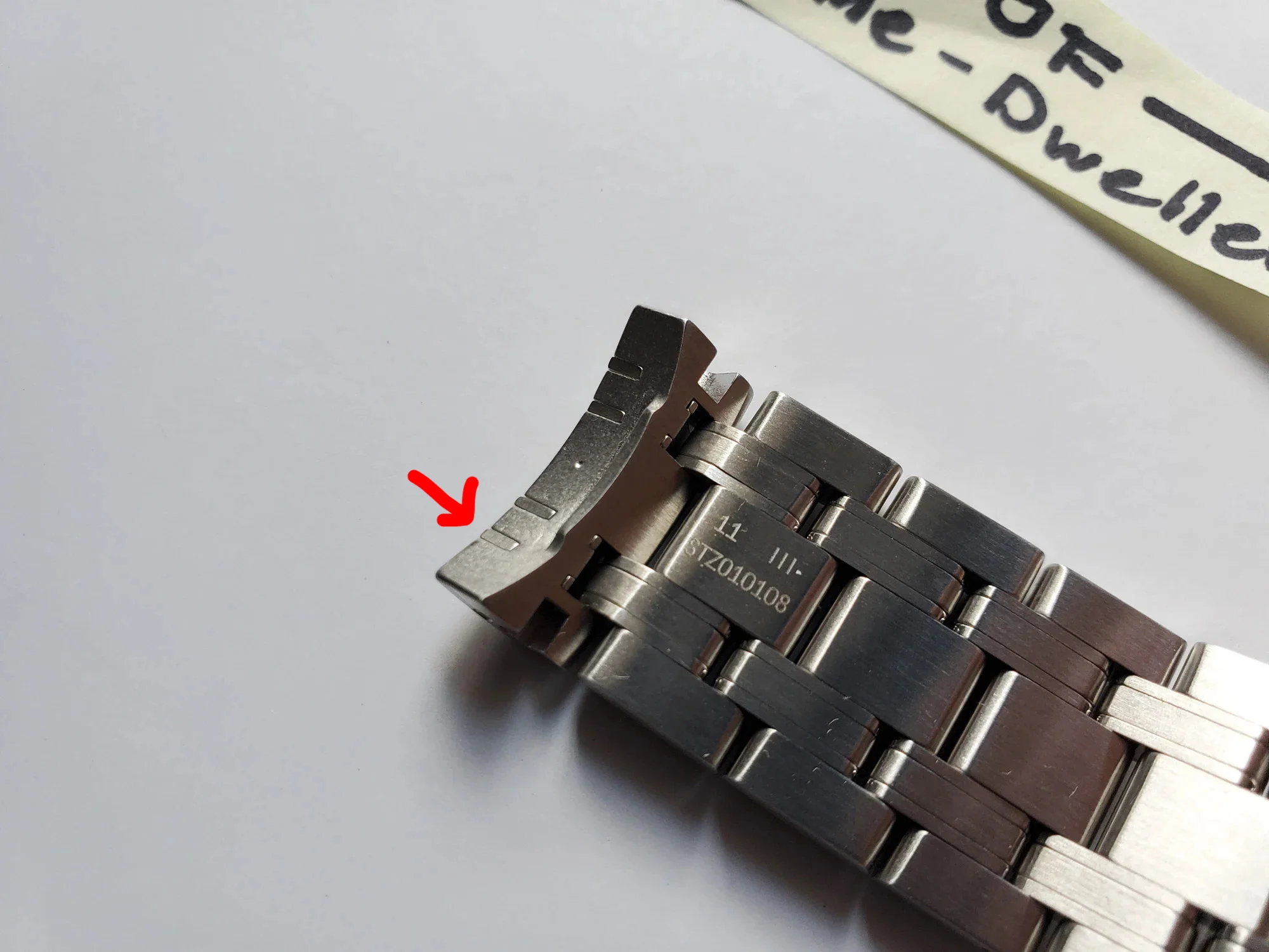

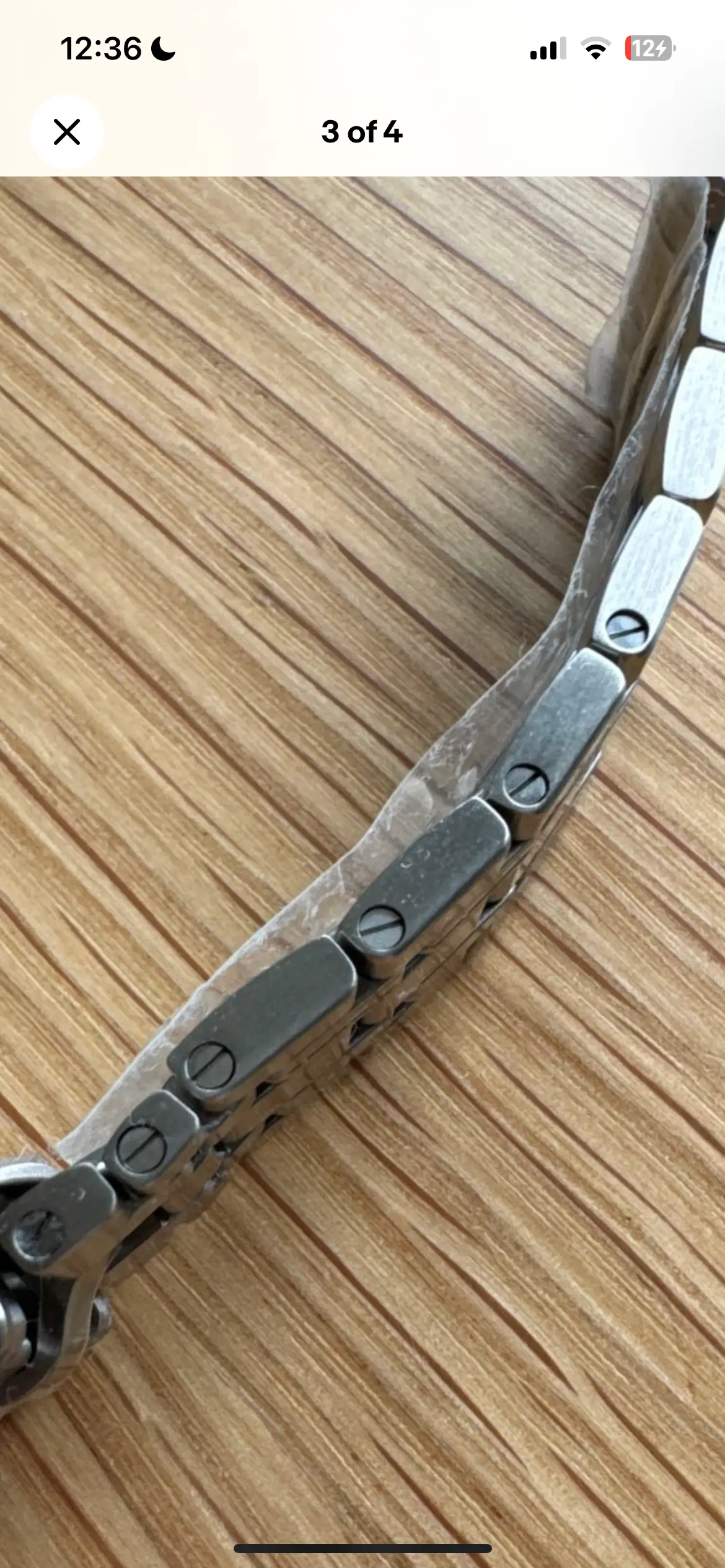

*last pic is from the buyer trying to explain ‘shallow screws’ - this seems fine to me?
1,053
1,131
Quite a few of those screws (left 2 in particular) are sitting quite a bit higher, but IDK if that is common. That left most screw's corrosion is, IMO, a bigger concern.
But "screws not loctited" and "screws not all the way in" seems like a little odd of a reason to consider it a fake, I would think markings/materials/etc would be a better reason. I don't know enough about the bracelets to know though.
EDIT: I just looked at the bracelet on my 300m.

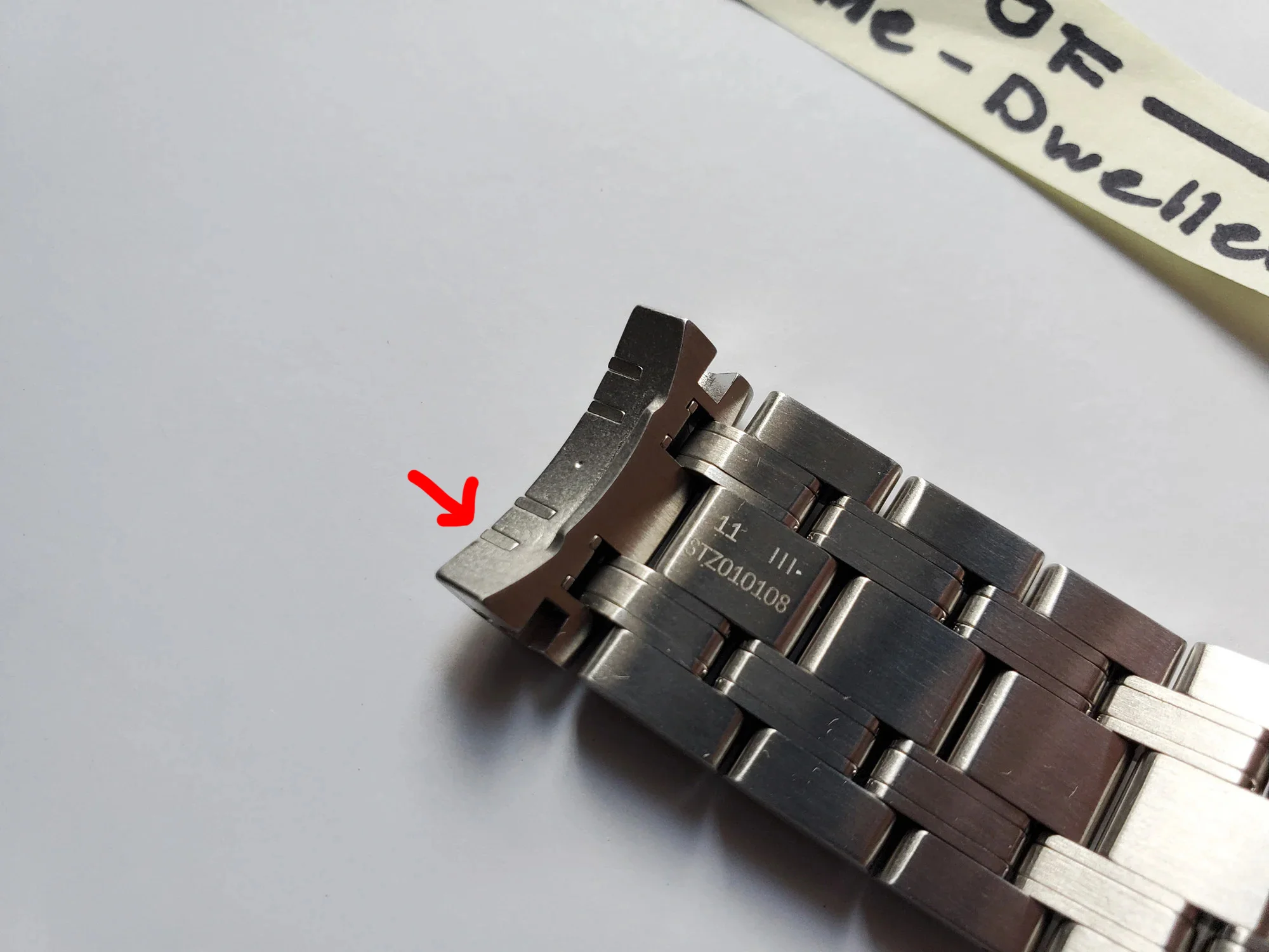

The engravings are weird on yours, but that might be because of the plastic. The one on the inside of the bracelet near the endlinks looks particularly weird, but again, could just be the plastic messing with me.
I DO note my screw depths appear really consistent best I could tell (and I've resized it a few times, so some are me).
I don't get the complaint about the half-link above.

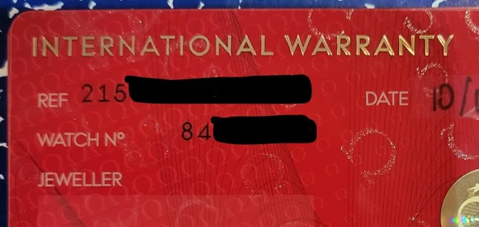

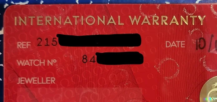

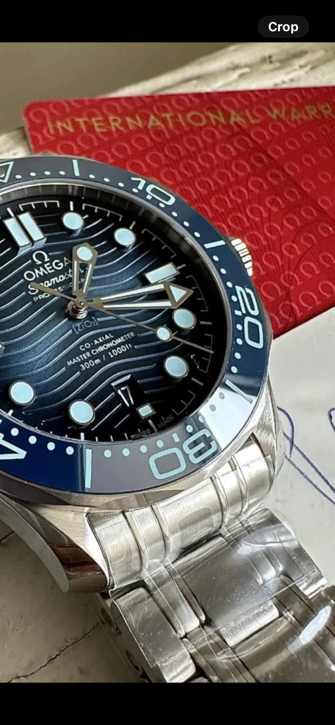

Why is your International Warranty card blank like that? These new METAS models come pre-printed from the factory with the reference and serial number.
I would be more concerned about the authenticity of the whole watch.

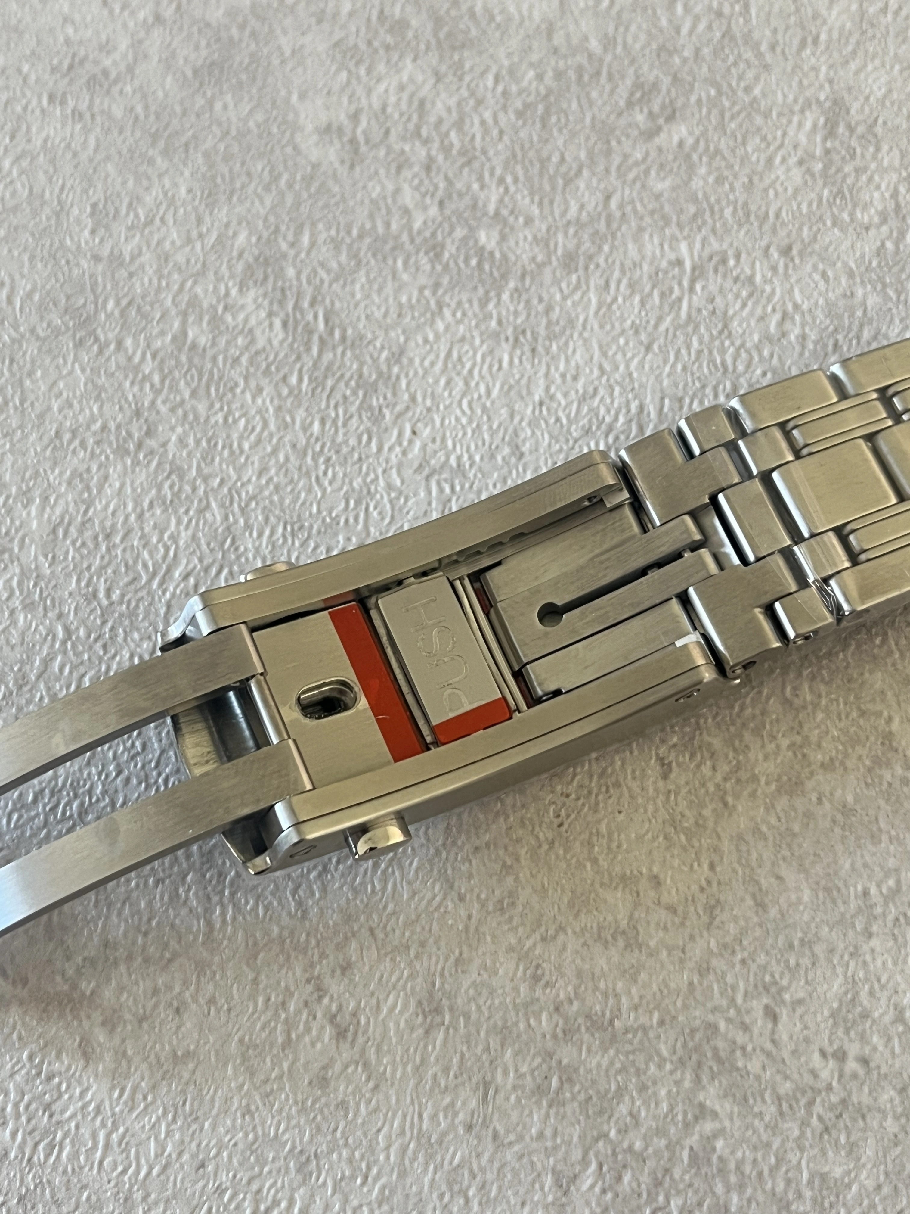

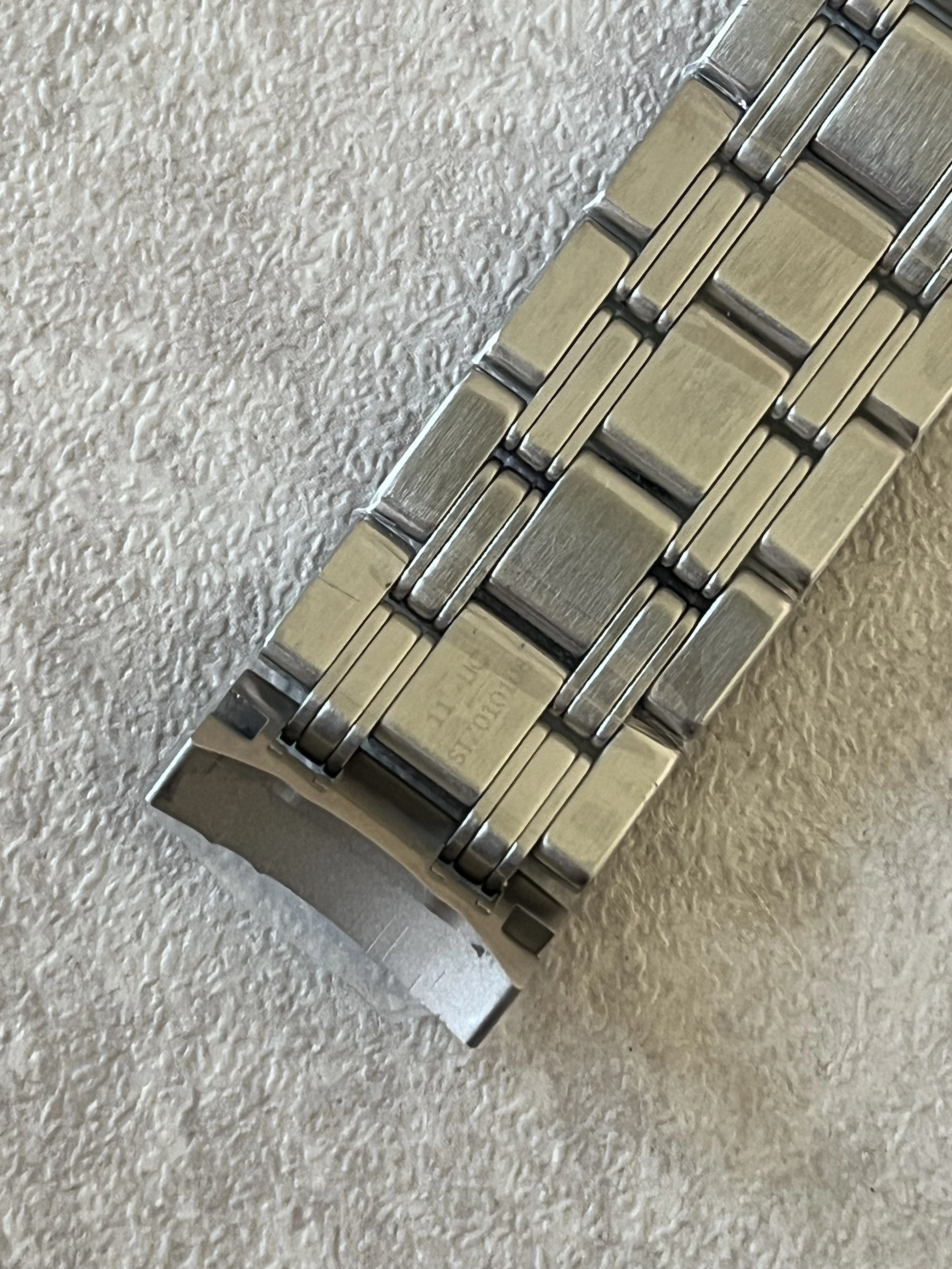

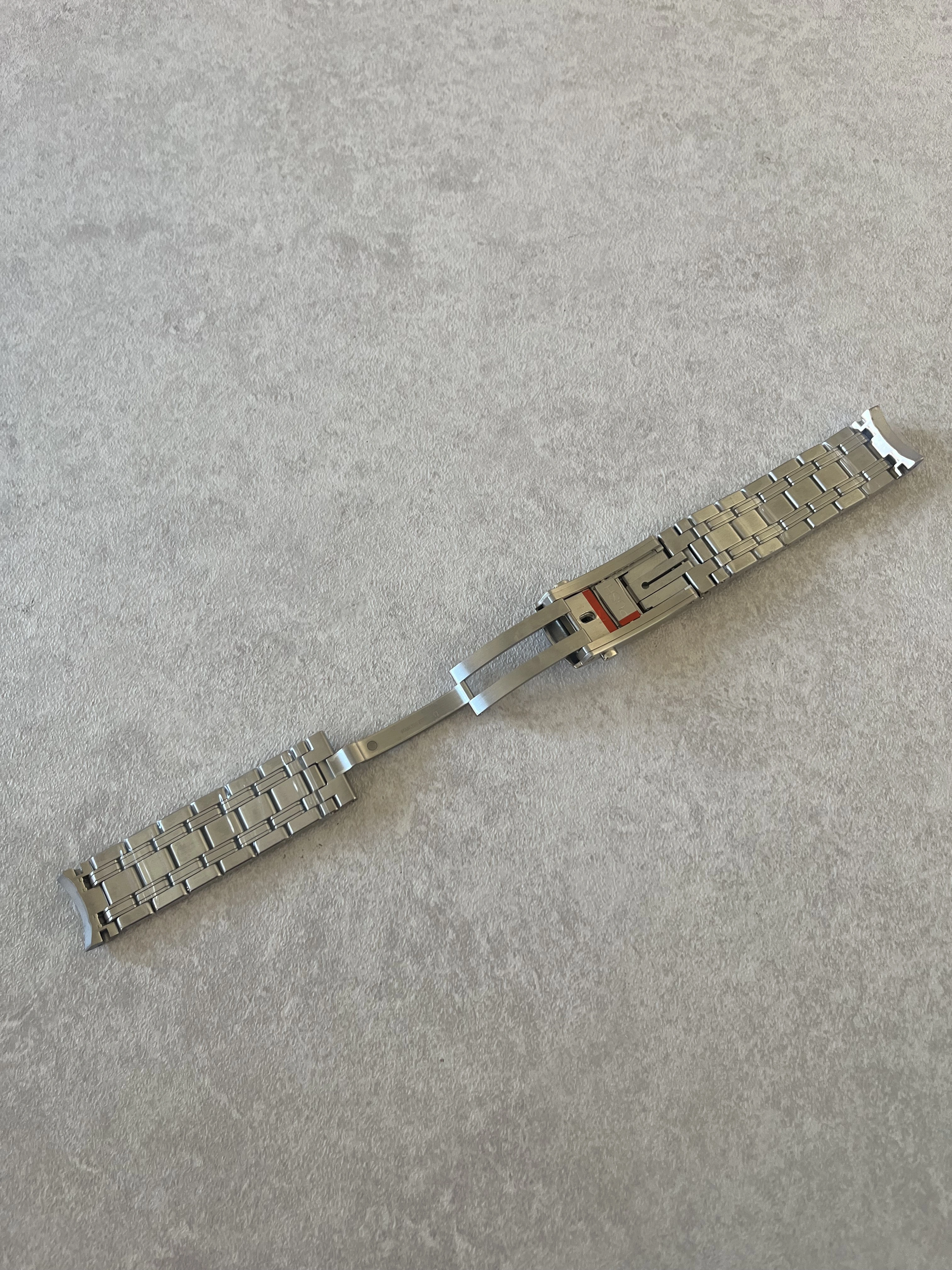

The red one inside the clasp looks very original to me, as does the code on the last link.
12,859
22,192
Everyone saying that’s the buyer opened it etc so it’s his. Unfortunately that’s not how eBay works. Unless you can prove that it is authentic by way of a receipt and also show before/after pictures clearly showing the buyer Cas used wear, eBay are highly likely to side with the buyer and force you to accept a return.
2,424
3,766
Exactly that, you can not change a product and then want to return it.

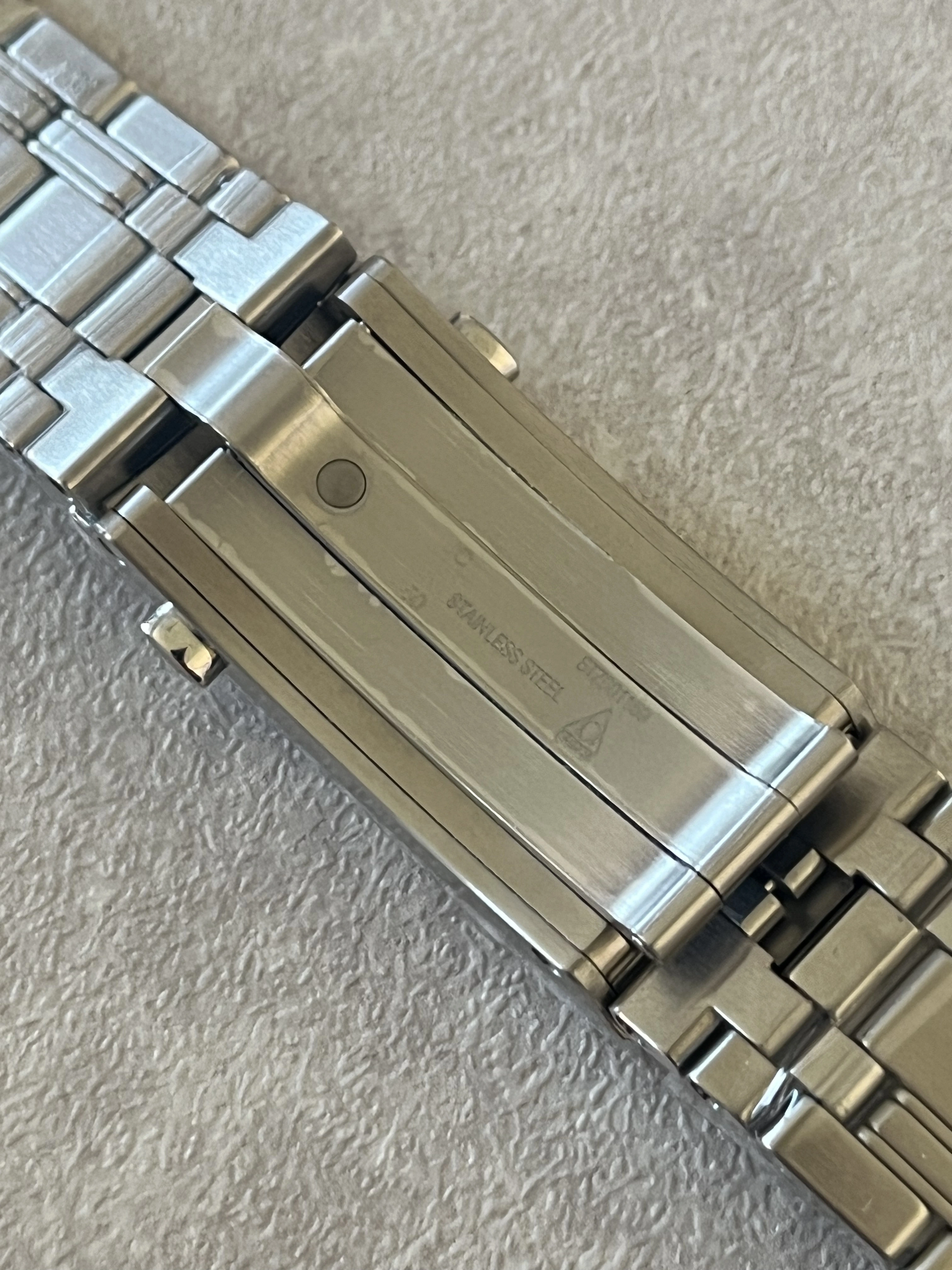

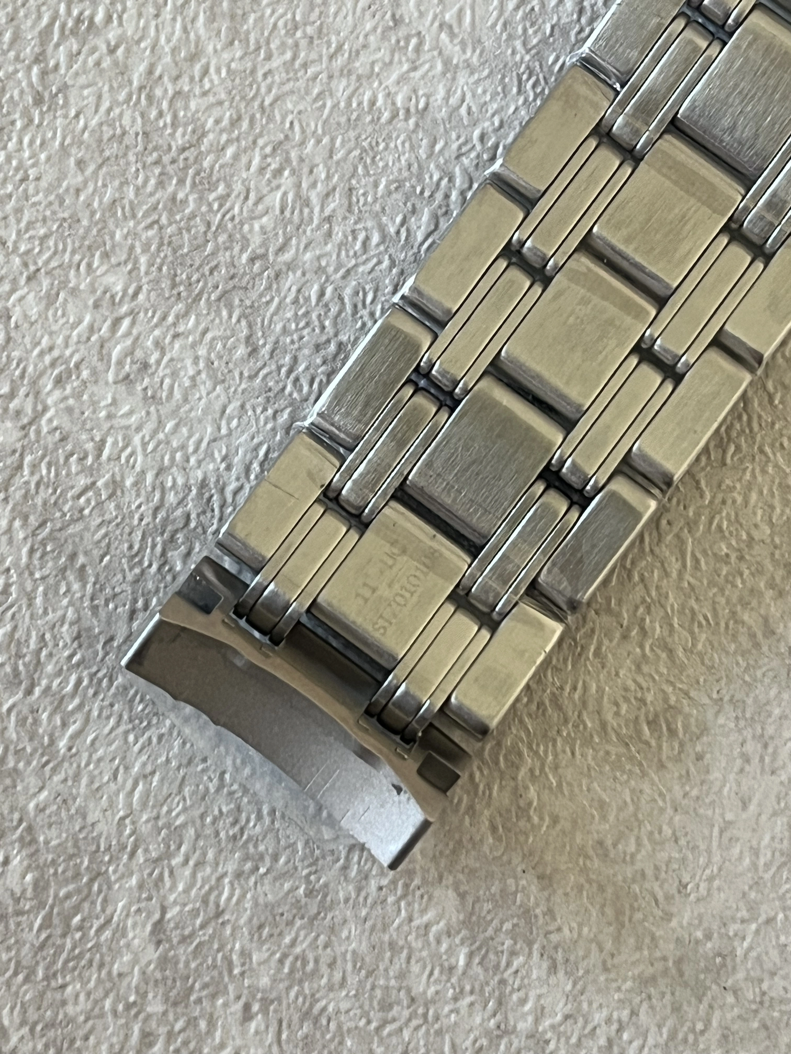

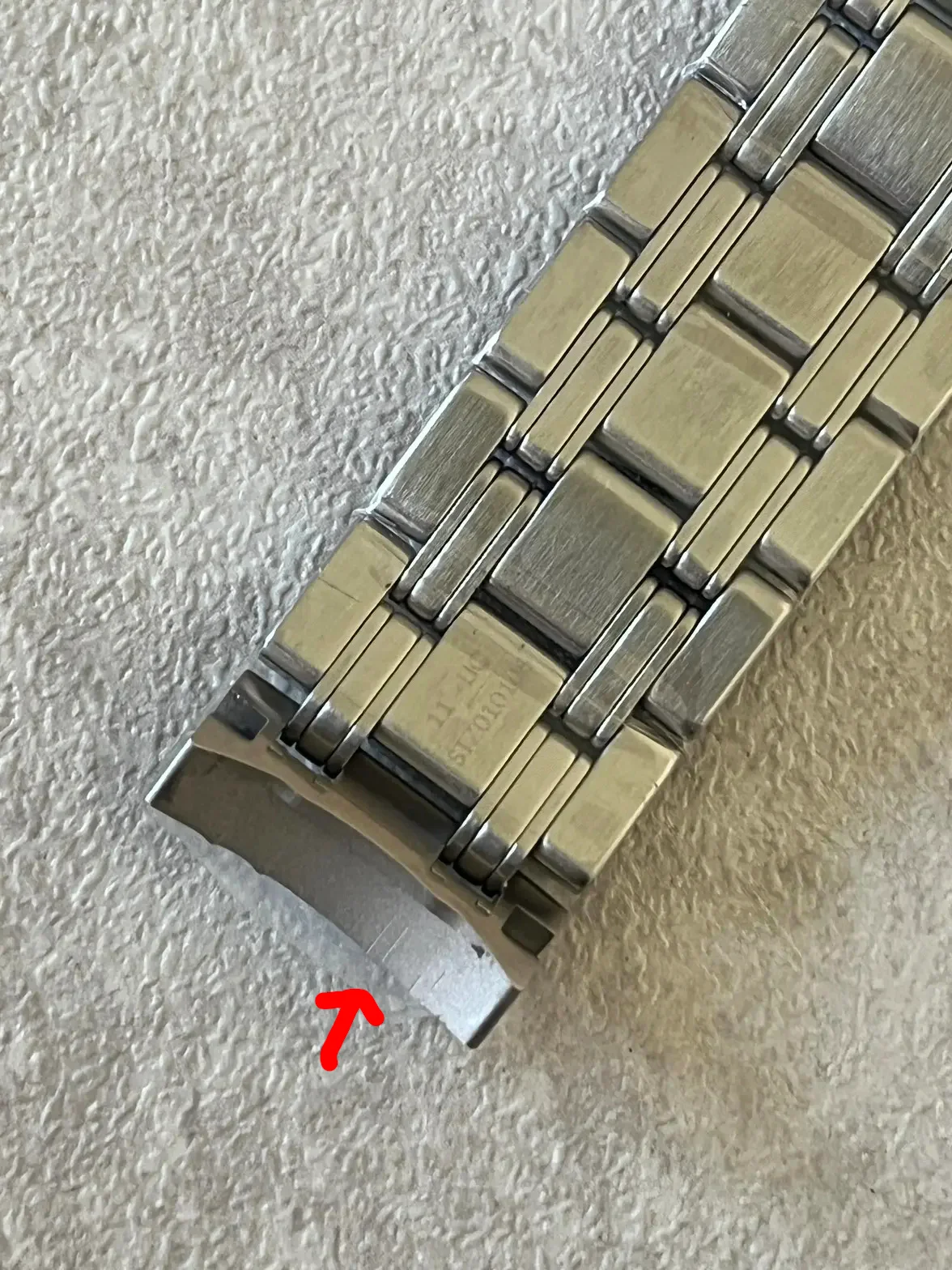

Disagree on the endlink. The inside of it looks like one big piece instead of separate pieces, and the overall brushing looks poor for a new bracelet.

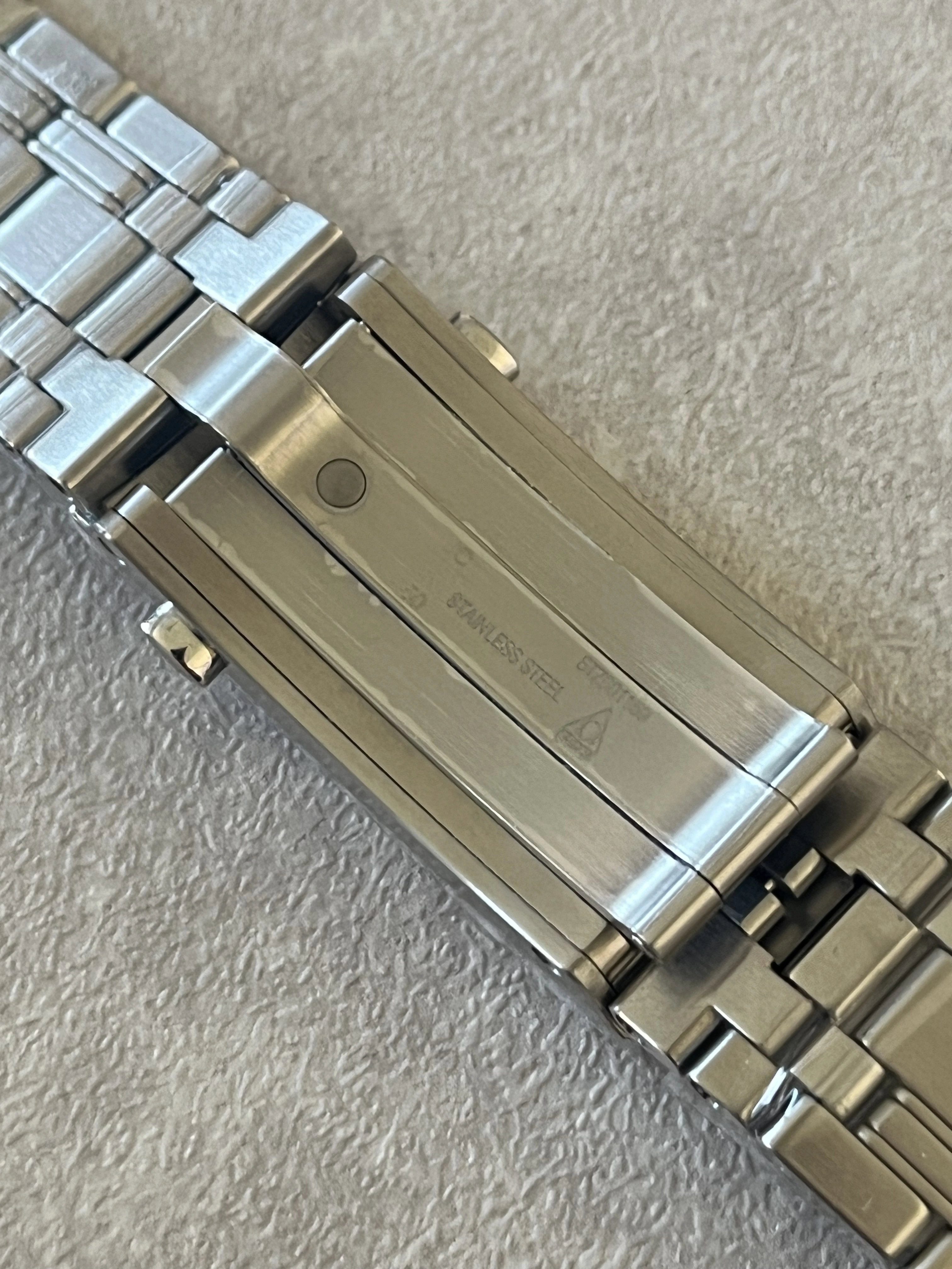

The fakes also have those stickers, and the genuine ones from what I've seen don't have protective stickers on the inside of the clasp blade like that. Though blurry, the font seems to be wrong on the clasp with the '9' being most noticeable. Combined with the strangely blank warranty card, I'd question the authenticity of the whole watch. They do make a convincing Summer Blue 300M fake.

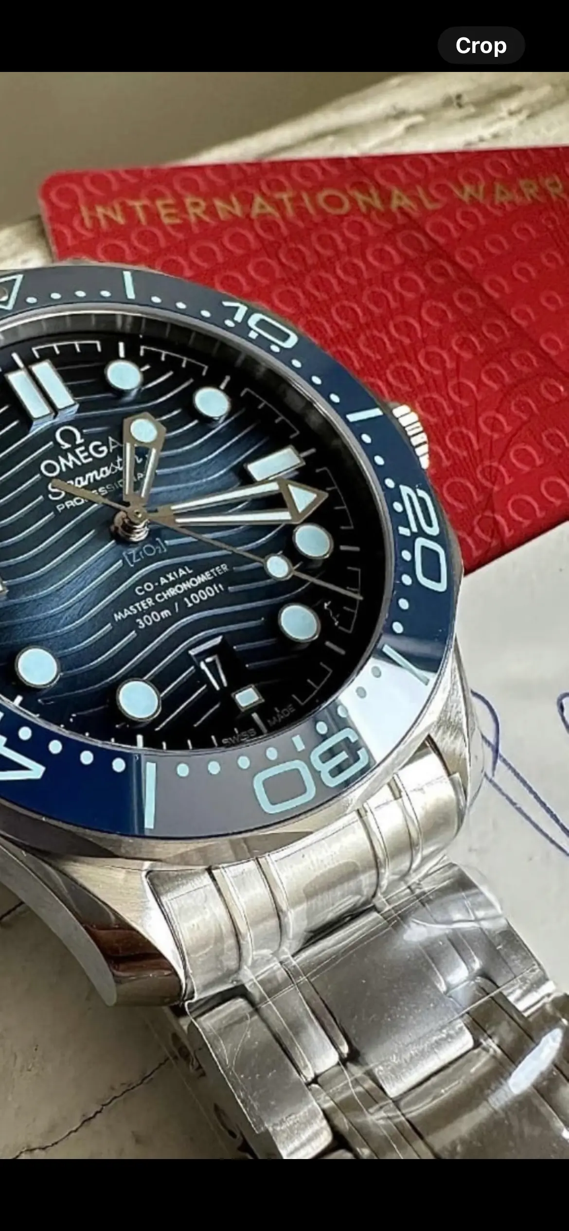

OP: you may wish to post more pictures of the dial, and if you can, the movement.
That's exactly what I was looking at. This is my (redacted) card...
