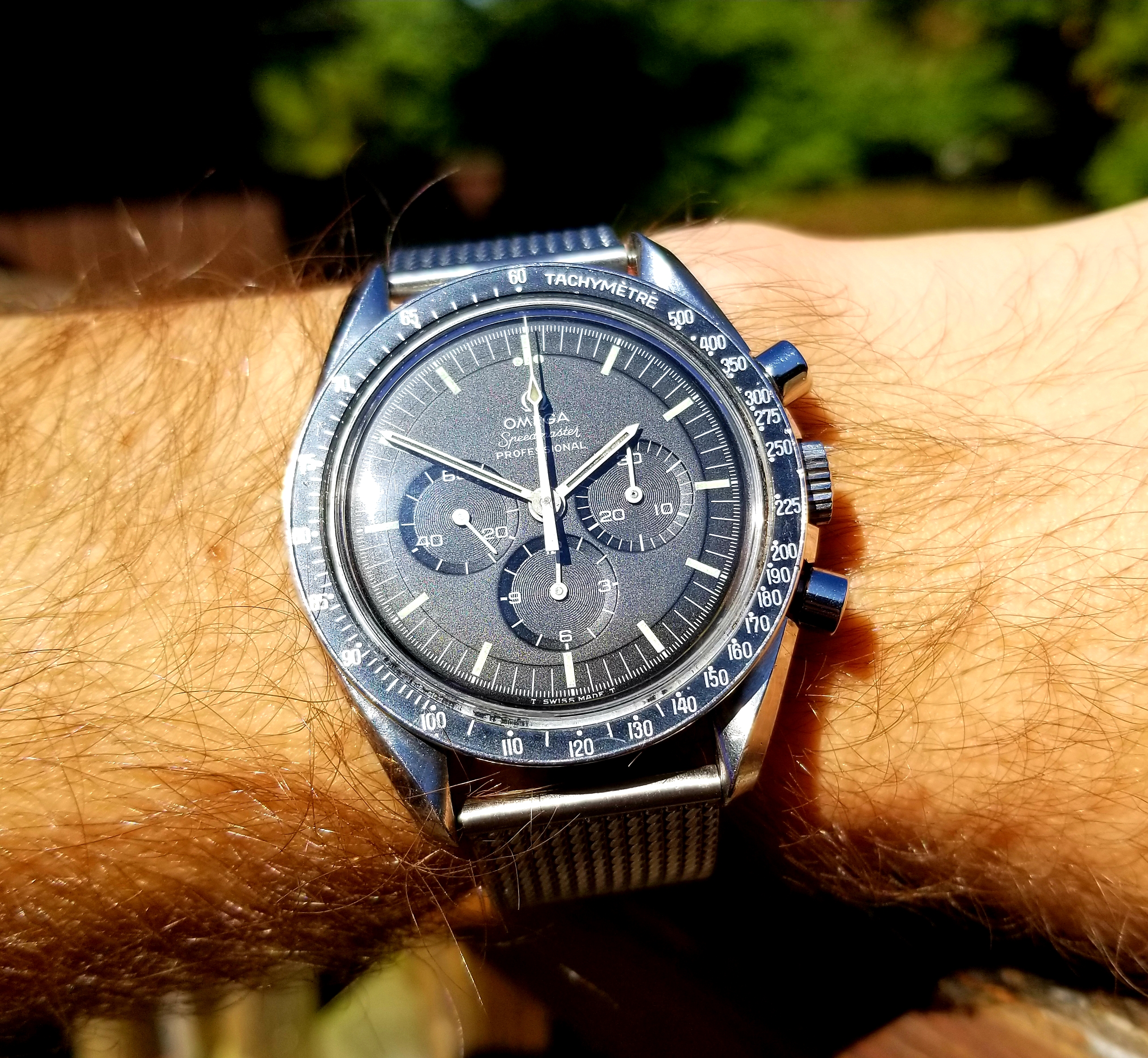

UPDATE - Vintage Ebay Speedmaster Arrived
1,428
2,960
A happy eBay customer... congratulations. Cleaned up beautifully.
I know you like the bracelet, but, it might look good on a leather strap or a NATO if you want a different look.
1,320
10,698
Update: back from service and looking great!
That looks clean and lovely. Congratulations Mike, nice work man!
1,583
10,359
Well done!
It seems to be a late 145.022-69, so a 1171/633 could perfectly fit, and is totally correct for the period. Just check the writings on the clasp to be sure it is not a modern one.
A 1116/575 too....
(And of course a 1039/516, but not in the same price range...)
13,555
23,503
Well done!
A 1116/575 too....
have you any examples of original -69’s coming with an 1171? Especially one with a DON bezel.
I’ve never seen a -69 hypocampus back that was considered original come with a 1171. Certainly an early -69 with a DON would have a 1039.
I think the SW -69’s saw the introduction of the 1175 and then the -71’s started seeing the 1171.
1,583
10,359
You're right, I forgot the 1175. Nice one, quite rare finally, I almost never see it...
But the extract will say more. If it is a late, or very late one, end of 1970, even if I never saw myself a watch in this configuration, a 1171 could be possible... It seems that people from MWO saw one like that...
134
134
DON and completely unpolished as well! Wow! Looking for a 69st at the moment. This gives me great hope!
