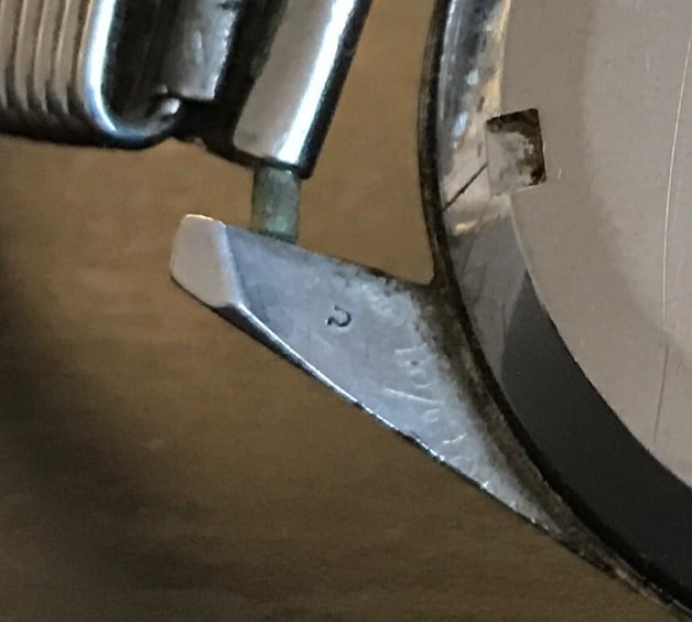

I also had @kox trying to investigate the watch. He found something that might look like an omega logo, or a half crestcent at one of the lugs. I have tried to get a clear photo of it
Omega Logo here too.
18
90
And all three surfaced in Denmark, I think?
Yes, to my knowledge all of them derives form Denmark

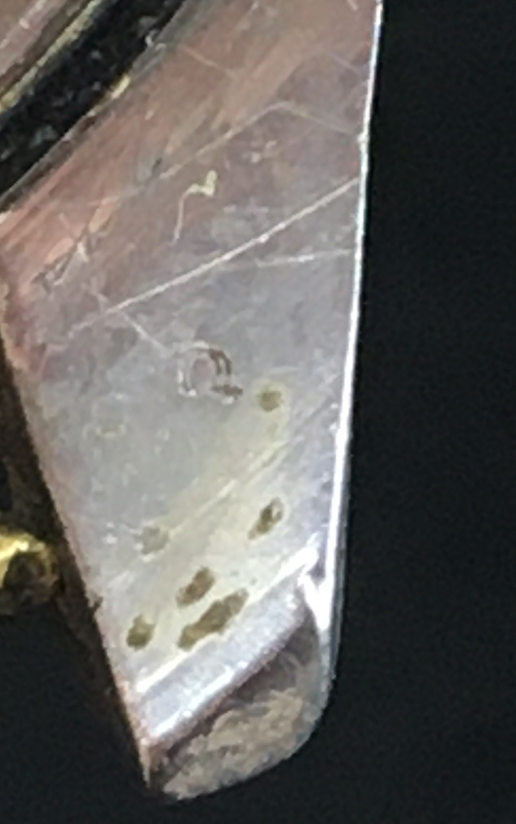

These watches certainly do look like they have the Omega log on the back of the lug.
Here is the other one.
18
90
Exactly! That is what I am thinking as well

Just a recap on these strange Flightmaster/Railmaster watches.
Three known so far.
All with Omega symbol on the back of the lug.
Unique case back.
All 2914-2.
Delivered to Denmark.
Flightmaster dials.
So the three I have seen all seem to be watches that have not been around the trade, I have spoken to Omega regarding the archives and both the OPs watch and the watch I have were delivered to Denmark under the ref 2914-2 with no mention of Flightmaster, the reason why @APAH didn't get the archive is because of the dials on these watches are stating Flightmaster, Up until now there has been no mention of a Flightmaster 2914 going anywhere other than Peru that I know of and that is why the archive personnel might be confused and believe that these watches are incorrect. So a bit of a mystery.
The probability that three watches all with the same unique traits above can be anything other than how they left the factory is very slim isn't it?, or am I missing something here?
