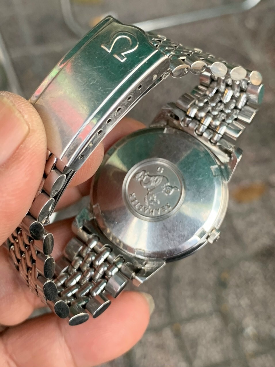

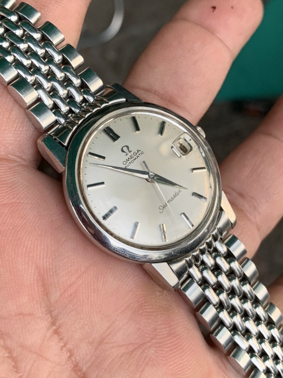

I stumbled onto this pretty Omega in local forum. Cal is 562, beautiful dial although BOR bracelet does’nt seem legit to me. Seller didn’t post caseback so I dont know what ref is it.
Would you help me to id the ref, what I should read on inside caseback...
Many thanks
9,178
76,498
It looks very nice. The relevant question is, of course, what sort of price is the seller seeking.
At a guess, it’s a 166.003 from the mid sixties, but with an unusual cyclops crystal.

The bracelet seems perfectly genuine.
Agree it's likely a 166.003.

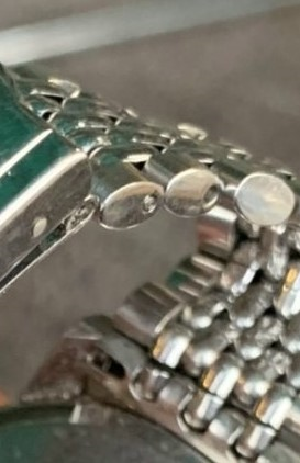

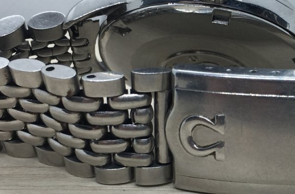

Bracelet on this case appears disproportionate due to thickness of individual links. Especially gaps between end-inks and lugs are noticeable and wonky as you can see on photos. Anyway if I can catch this Seamaster (seller did not reply to my offer yet)

Hi @river9 , I also believe the BoR in question is genuine, but maybe not correct for this watch.
There are different kinds and iterations of BoR and they come with different end links, some of them straight, some curved, some of them flat etc. Some of them are to fit Connies, some Seamasters, etc.
I also think it might not be a bad deal, but would definetely check the interior of the watch first..
Also, that bezel looks maybe too round? Either it was very heavily polished or is a replacement.

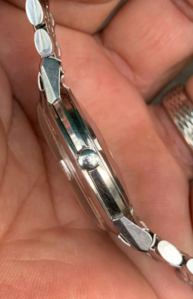

Bezel seems sharper than it appears on above pic
Here is case profile photo in which I can discern bevel on bezel
2,298
3,155
Case looks very good, original semi hidden crown, seems like a good deal!
No deal breaker just a remark:
The BOR isn't in original condition:
OP:
First link next to the clasp should be non removable like here:

Thank for your insights @Rudi99
Cool! Than it was just a weird angle. It makes sense, because the case altogether, like stated by @Passover , looks very sharp. 👍

I can't tell from those photos if the endlinks are correct, but if they are an Omega BoR would be around $150-220.
I think I can make out an 11 at lower right in the second photo.
411
627
Good eye 😀 Endlinks in real life are marked “11” @Edward53.

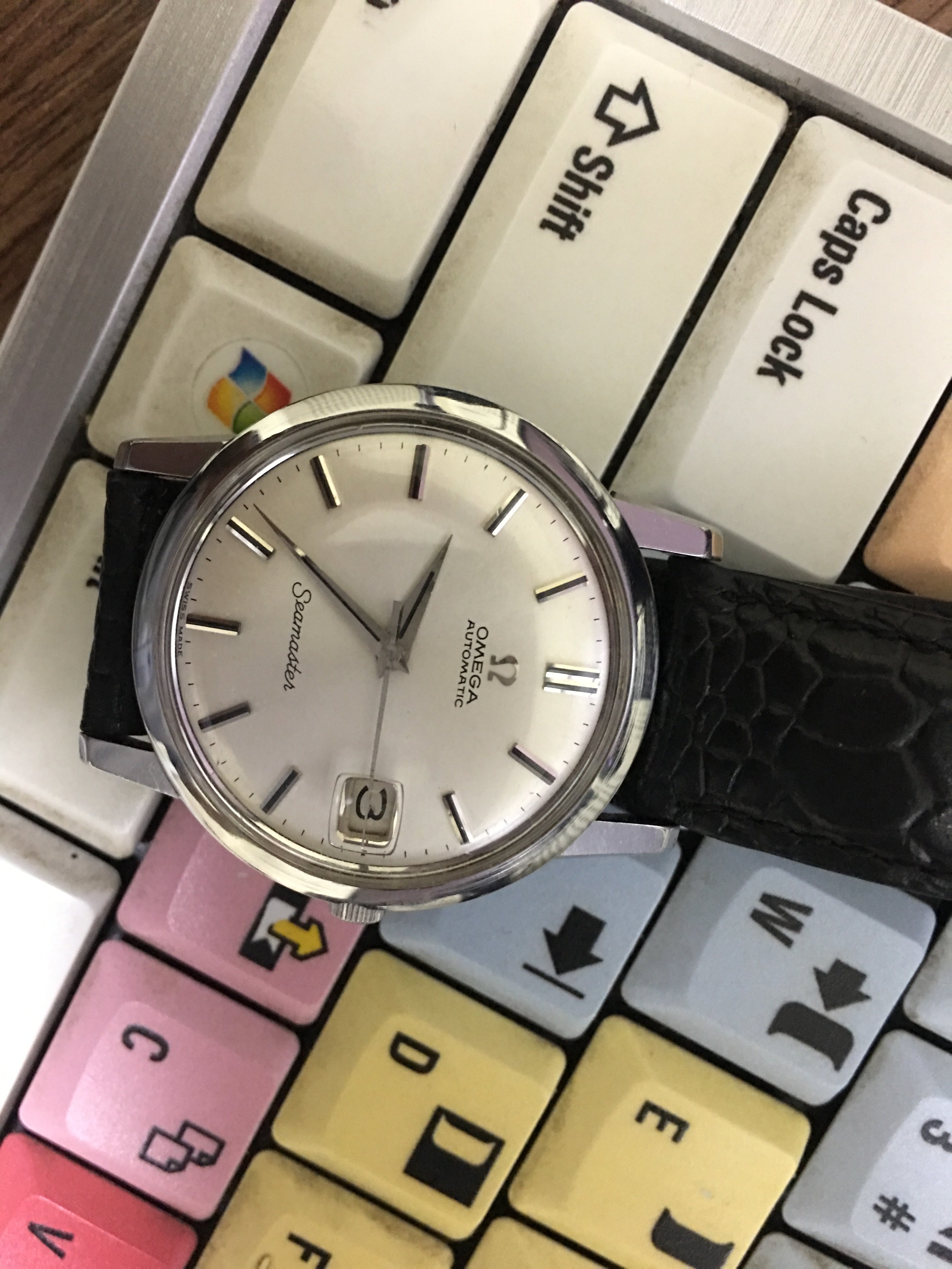

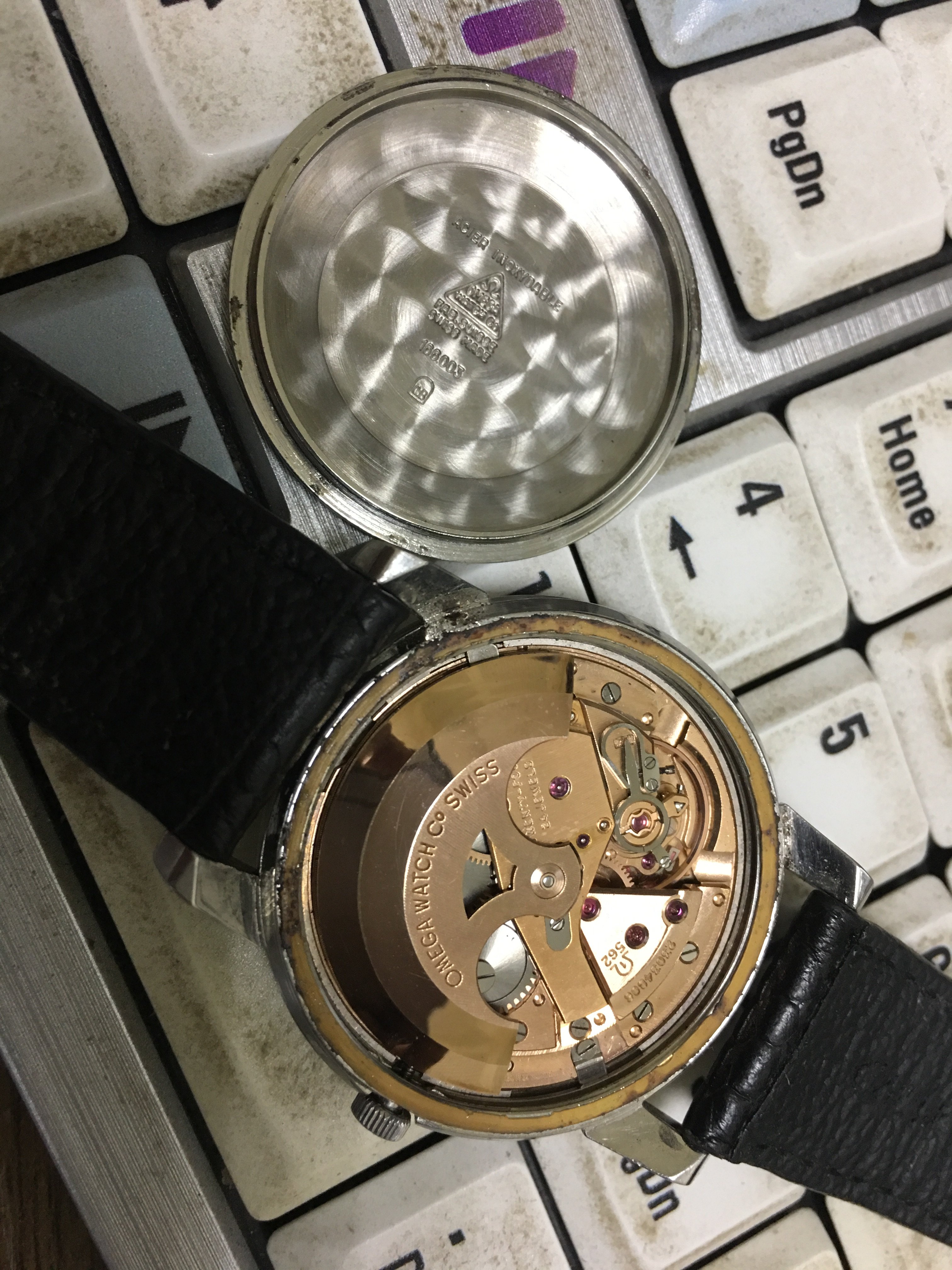

-To update-
Finally I got the watch head. Below are pics took by me with my old iphone 🙁
Since BoR doesnt specially attracts me for this ref 166.003 I put the watch head on leather band.
