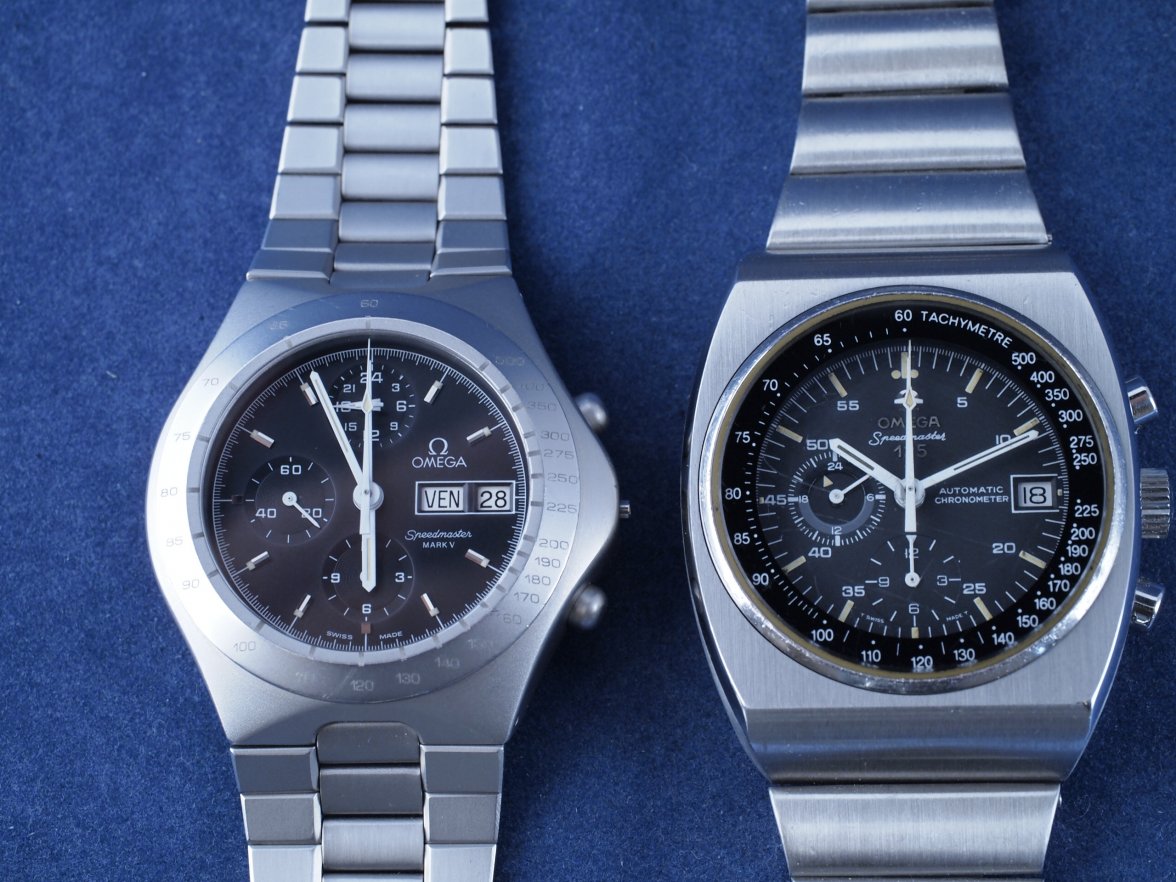

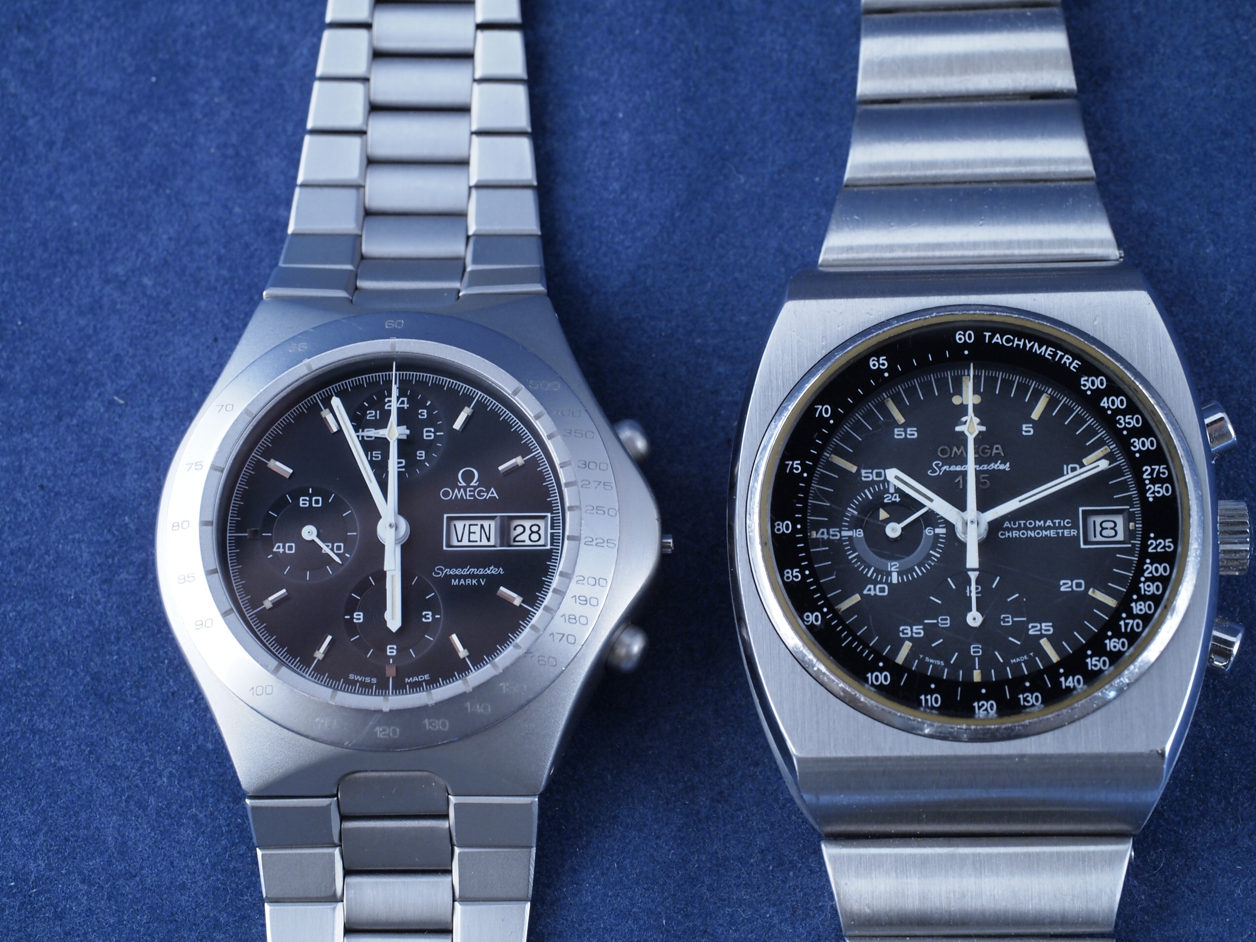

On paper mot a massive watch, in practise very top heavy ... dominant arm ends us like a tennis players
75
255
What a great pair of watches. Thanks for posting.
