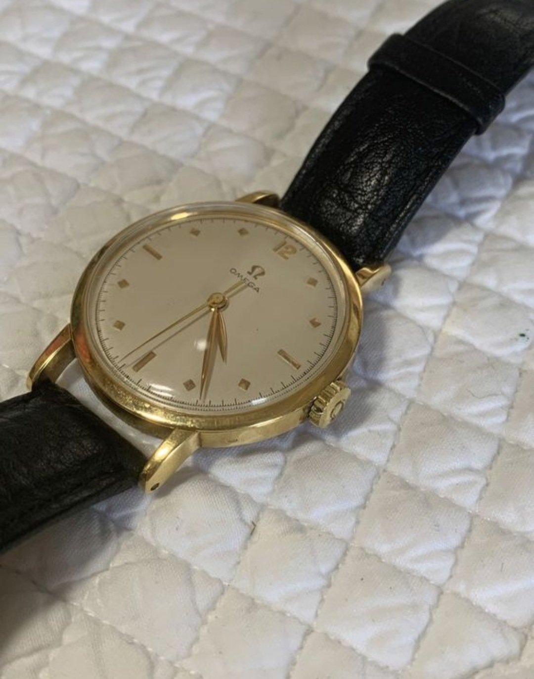

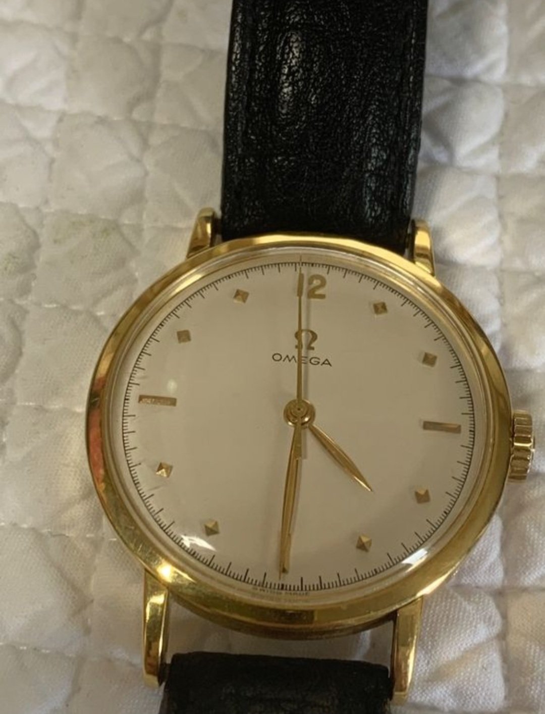

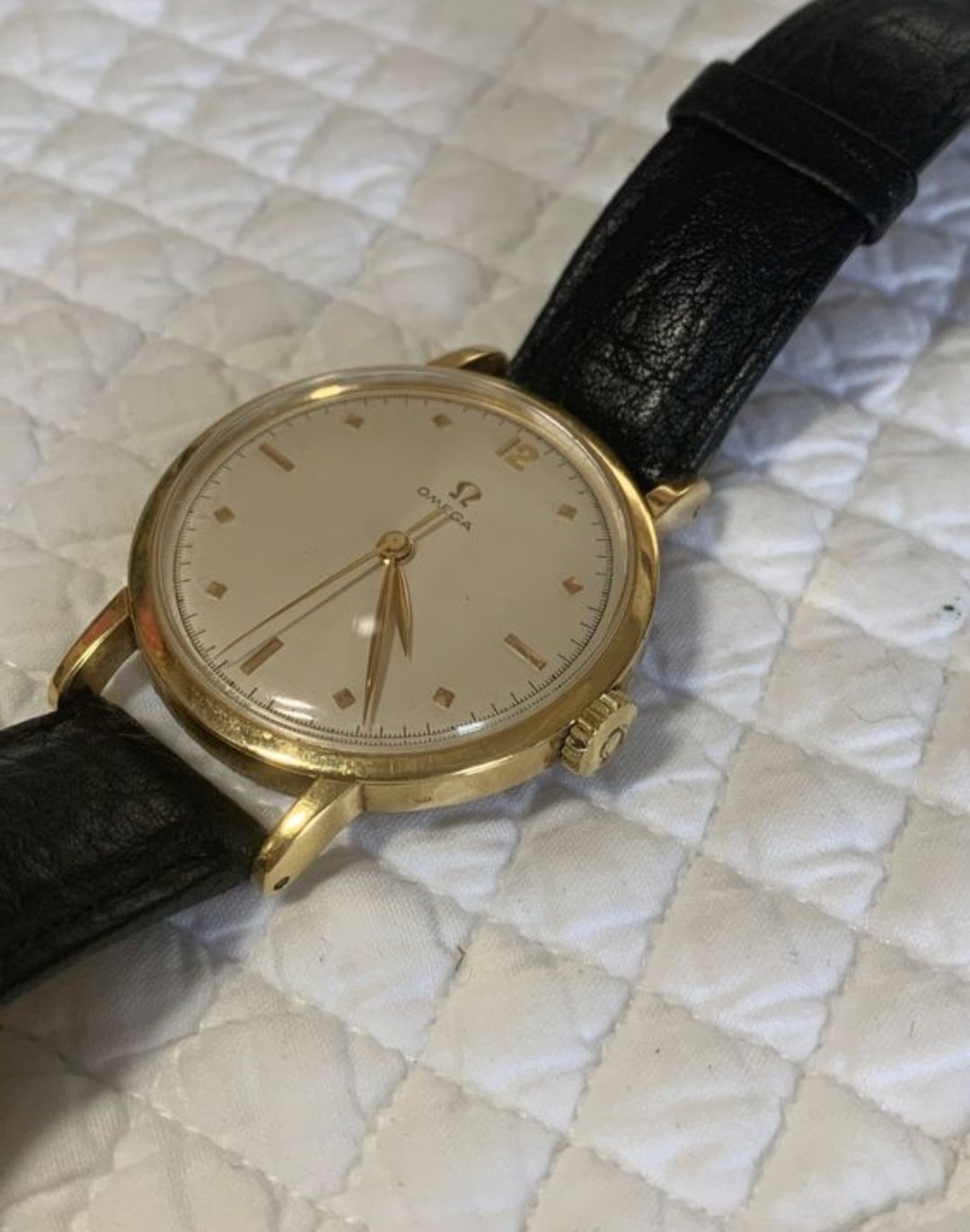

A Posts 149 Likes 239 alalalalongines ·Jul 5, 2023 Hello everybody There is a 2367 in 18k gold for sale. I haven't seen this dial variation and it is lacking the chronometer designation. The 30t2scrg movement has a serial number around 17000000. What do the specialists think? Thank you for your time!
Posts 13,677 Likes 19,047 gatorcpa ·Jul 5, 2023·ΩF InvestiGator A alalalalongines What do the specialists think? 1959 dated movement in a 1940’s watch? Something is very fishy. I’d walk away from this one. gatorcpa
Posts 3,653 Likes 7,770 mac_omega ·Jul 5, 2023 Definetely a wrong dial. As you stated yourself its missing the "Chronometre" wording which is a must for this reference. furthermore a serial number around 17000000 is a red flag
Posts 3,653 Likes 7,770 mac_omega ·Jul 5, 2023 Want to add: case is heavily polished, wrong centre-seconds hand
A Posts 149 Likes 239 alalalalongines ·Jul 5, 2023 Thank you a lot for the answers!!! It was what i was suspecting but wishing to be untrue.
