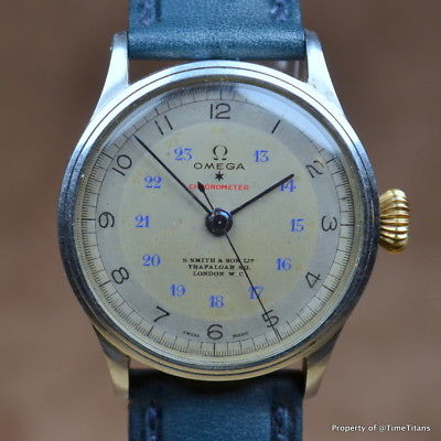

    The price for thisPurchases made through these links may earn this site a commission from the eBay Partner Network seems to be extremely mouth watering...anyone else seen something similar?

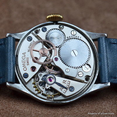

    That doesn't look like a chronometer movement even...
    This seems like a creative redial. Nice star with 6 points though :thumbsup:

    Personally I think they are full of shit, dial has clearly been messed with, more likely a complete fantasy. Why does the dial have a London reference when the extract says it was delivered to South Africa, why is there no mention of it being a chronometer on the extract, what's going on with that horrible blue 24 hour scale printed next to a faded red one? Should something this early be marked Swiss Made on the dial?
    But hey, they may find a sucker to snap it up at their bargain price of $20K.
  5. Dan S Jun 13, 2018
    18,813
    43,263
    Yes! This is what immediately jumped out at me. It's impossible that there would have originally been two different 24 hour scales.
    Also, if this is a chronometer, it should have a 30T2rg movement, which should have a fine adjustment on the regulator. Or at least that's what I have seen.
  6. 77deluxe Jun 13, 2018
    2,058
    4,613
    What is that, a caliber 285?
  7. Dan S Jun 13, 2018
    18,813
    43,263
    Early 1940s movement, so probably a 30t2.

    I'm almost positive there was a thread on this watch in the past. I believe it has been on Ebay for awhile and I can see why.
  9. merchandiser Jun 13, 2018
    594
    2,111
    When he first listed the watch I messaged him to ask him if he was aware that his account had been hacked:p
  10. Tony C. Ωf Jury member Jun 13, 2018
    7,387
    24,221
    It would be an embarrassment for an individual seller; for a dealer, it's a complete disgrace.

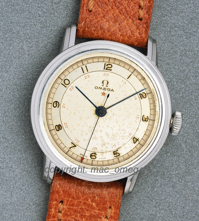

    I do not think this dial is a complete re-dial.
    IMO it is an original dial concerning the radially printed Arabic numbers, the 1/5-seconds track and the logo/Omega wording and star.
    But: The red "Chronometer" lettering and the blue numbers have been added later to pimp up the dial - most likely also the dealer´s text (but not necessarily so)
    The "SWISS MADE" is OK for this type of dial.
    For your reference - here is an original dial
    and of course the watch in question is no chronometer - it has a simple cal. 30 SC T2
    best
    erich
