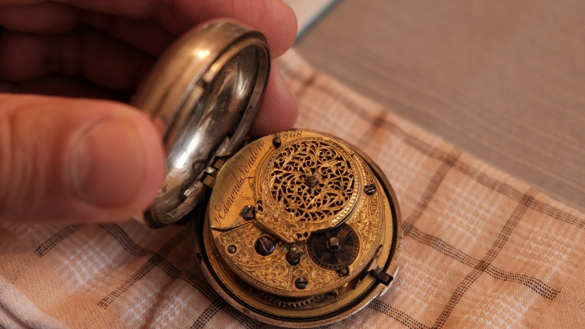

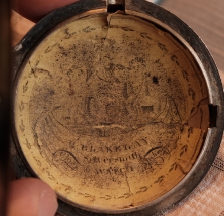

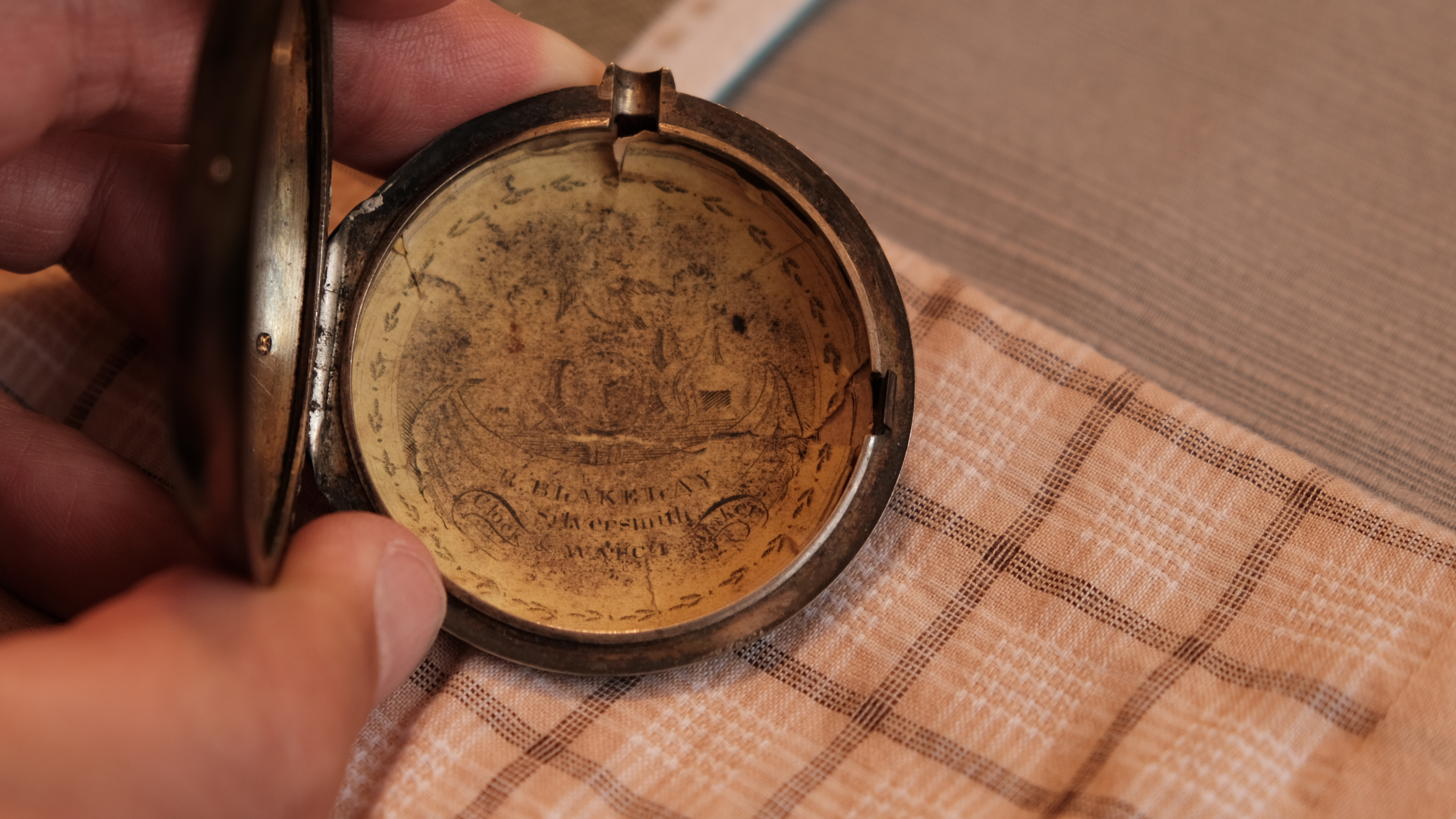

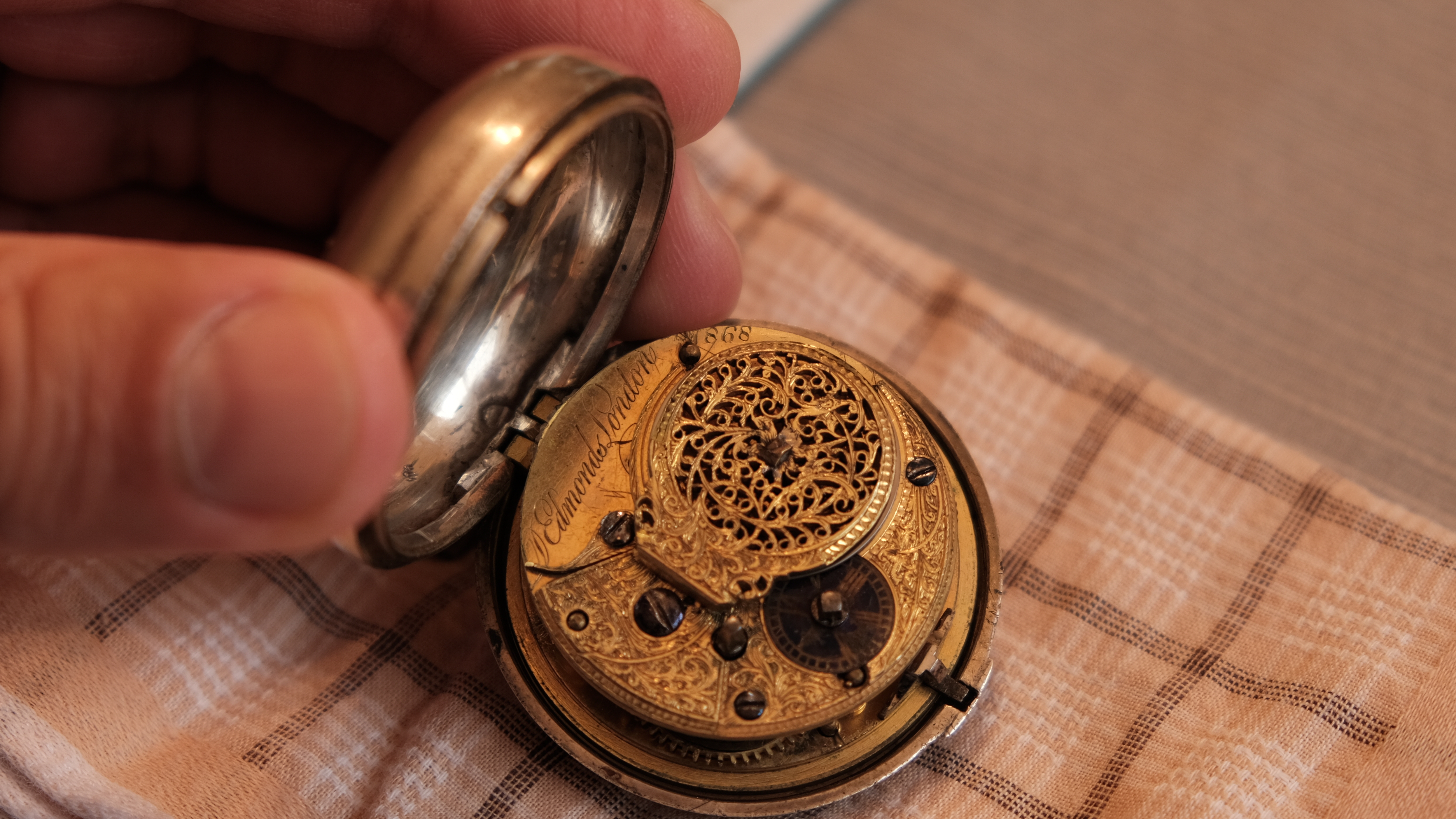

Hello all, I wanted to get some opinions on this watch I picked up today.

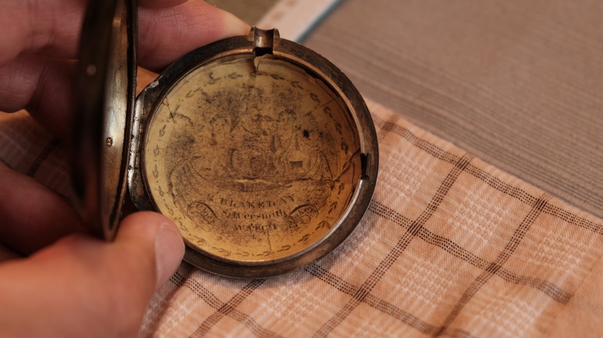

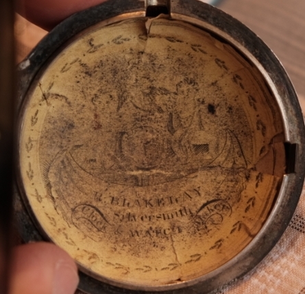

There is paper on the inside of the case that says "R. Blakelay Silversmith Clock Watch Maker" but I can't seem to find any information on that maker.

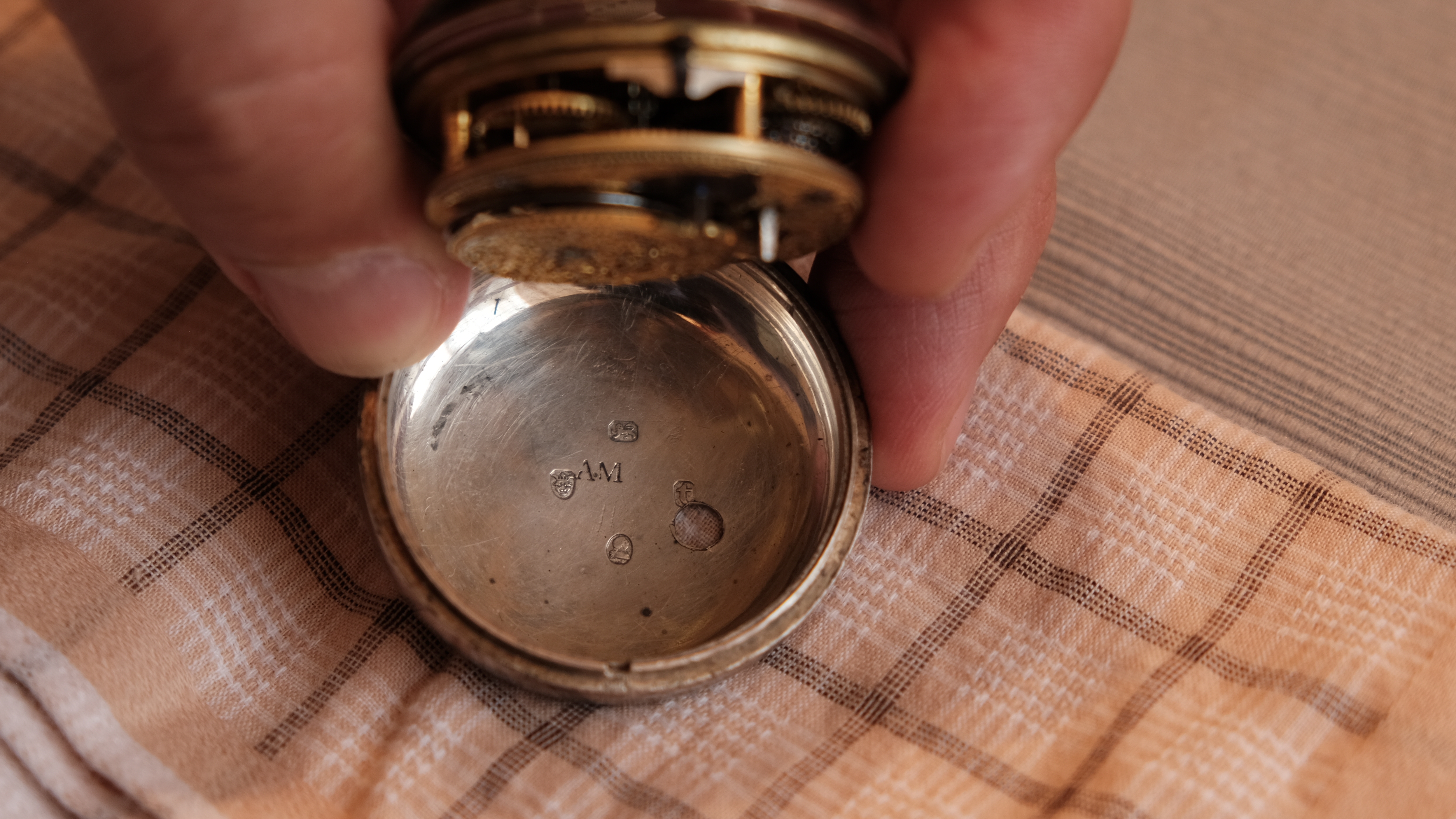

The movement is marked "D Edmonds London" and then either 868 or 898 (depending on how you hold it)

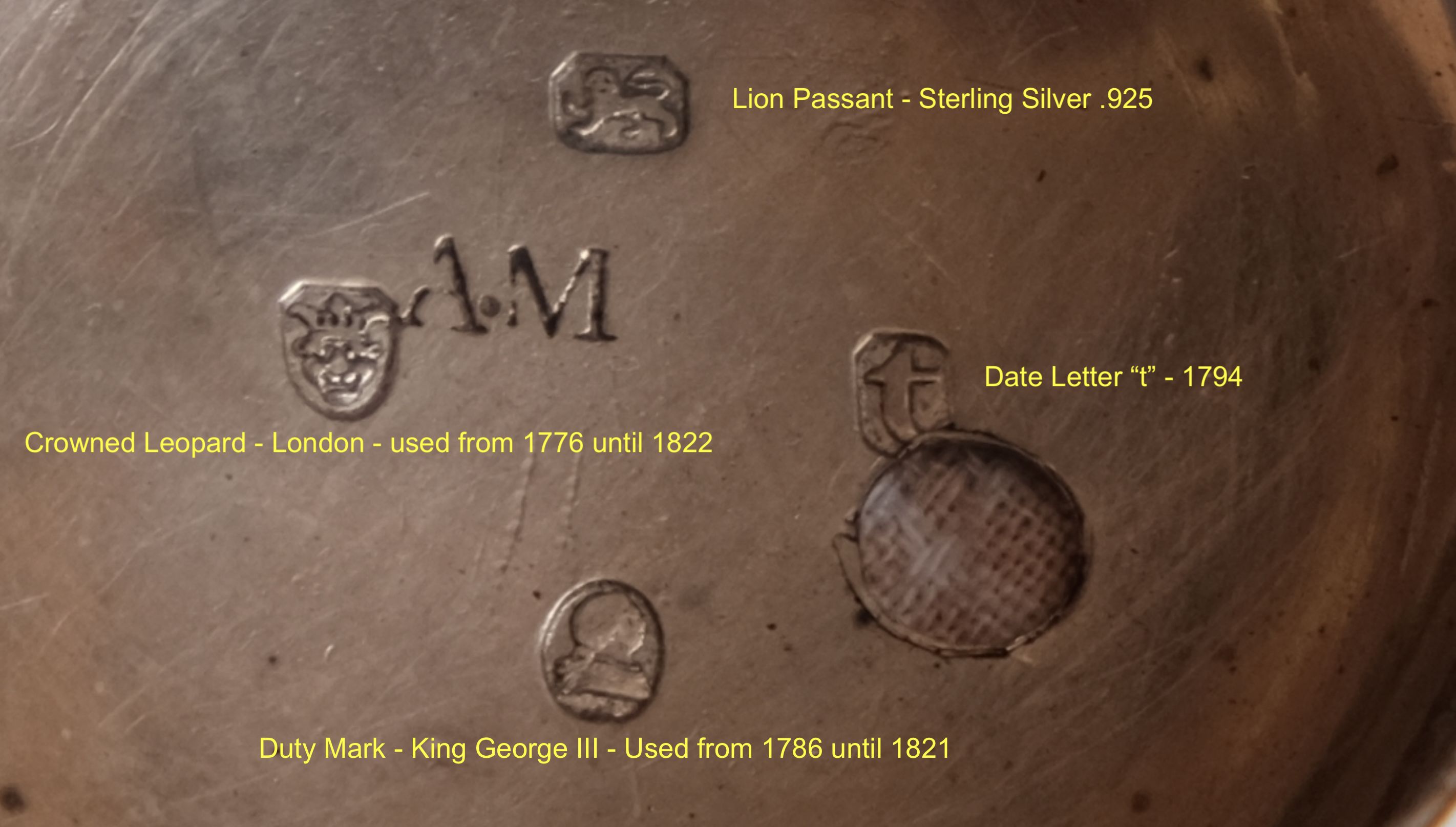

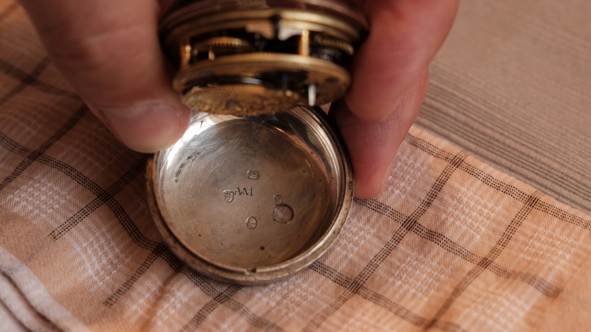

The hallmarks inside the case are also unfamiliar to me.
Any information would be greatly appreciated.
Thank you
7,738
14,321
The paper inside the case is not the maker, these were often inserted after a service. The maker is that on the movement, the hallmarks will tell you the exact year it was made. I don't have access to my English hallmark book so can't give you any information in that regard. From the look of the movement it is probably in the 1750-75 range.

Thank you. Would you recommend attempting to take the paper out? Is it possible that there would be another hallmark or date under there?

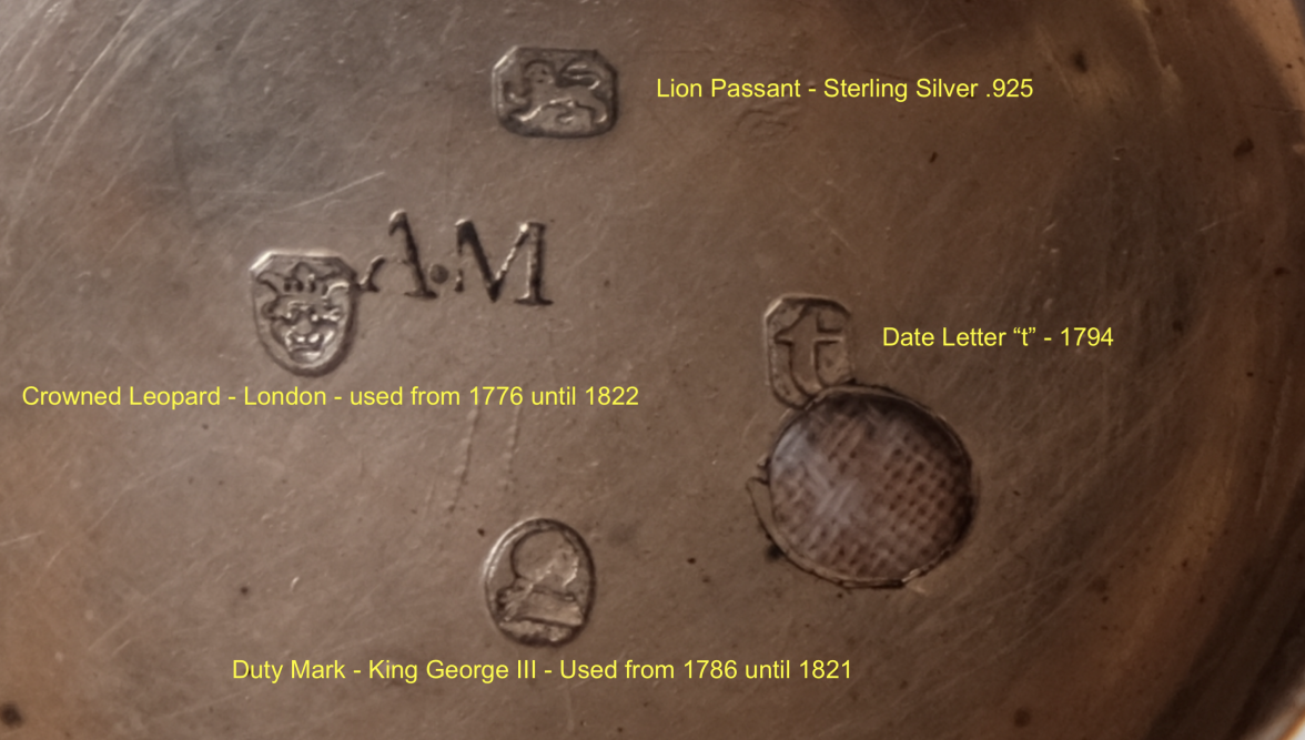

The hallmarks you can see on the inner case are all you need to date it. I believe you can find everything you need on English hallmarks on this site: https://www.925-1000.com/british_marks.html

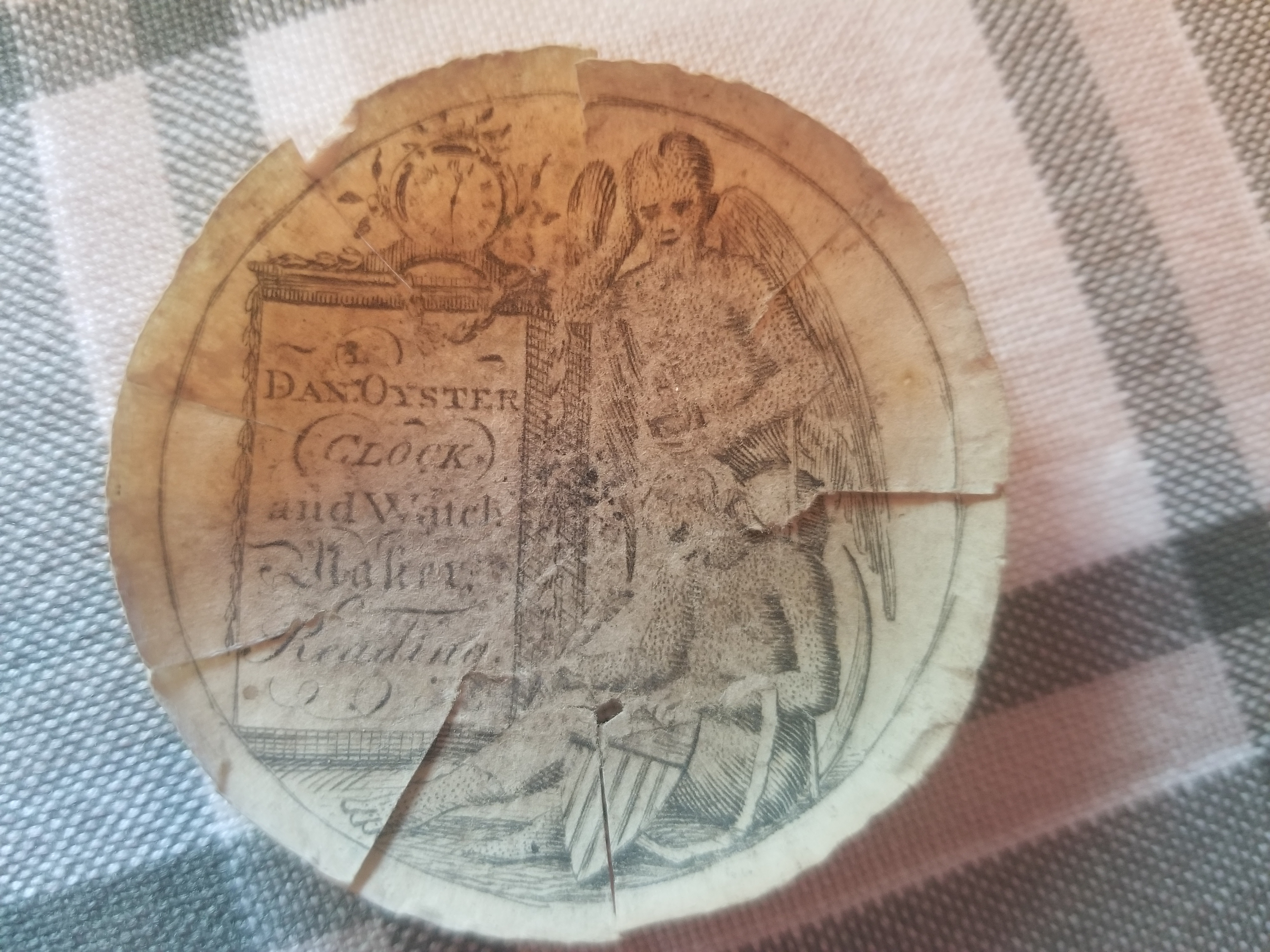

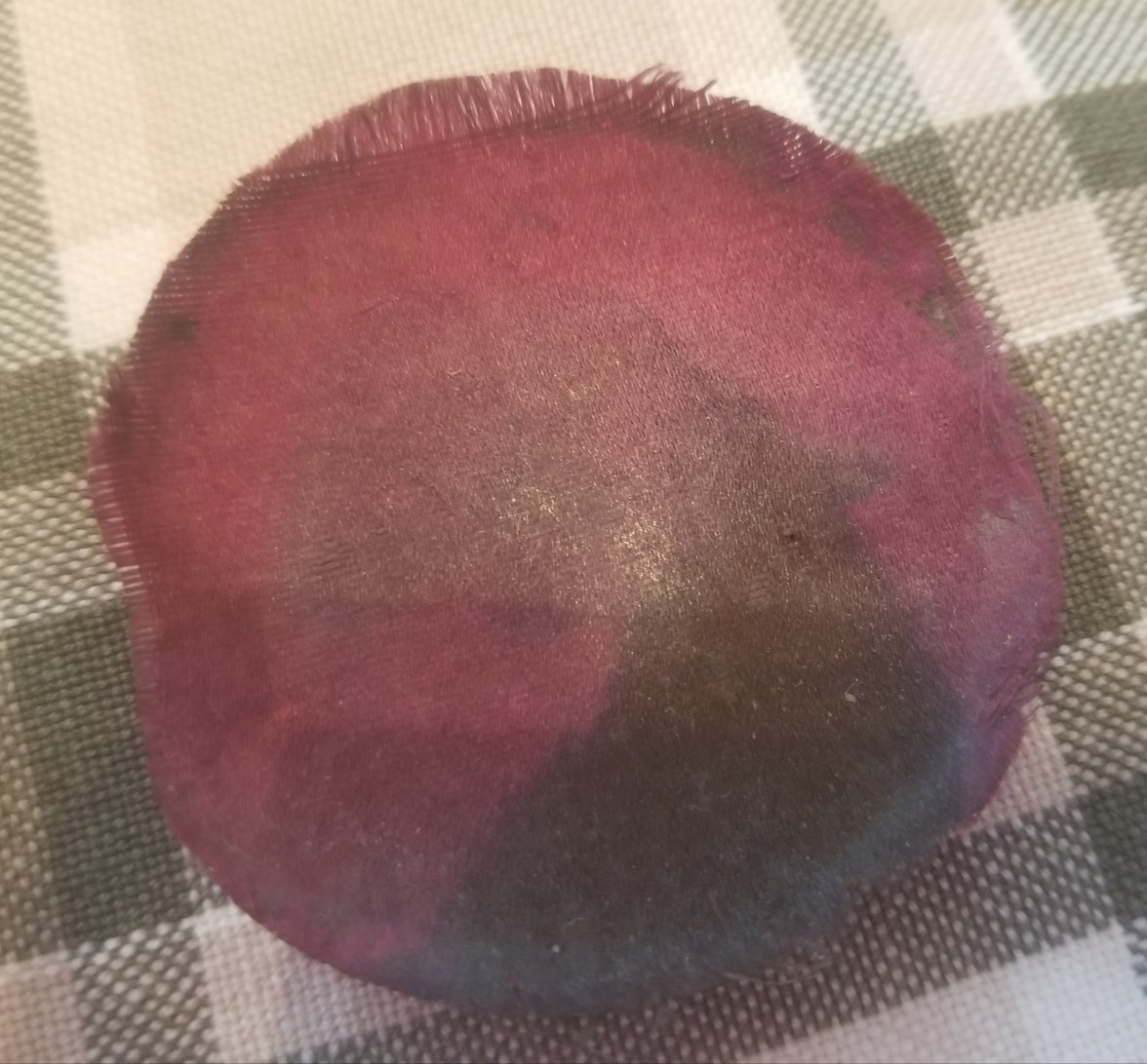

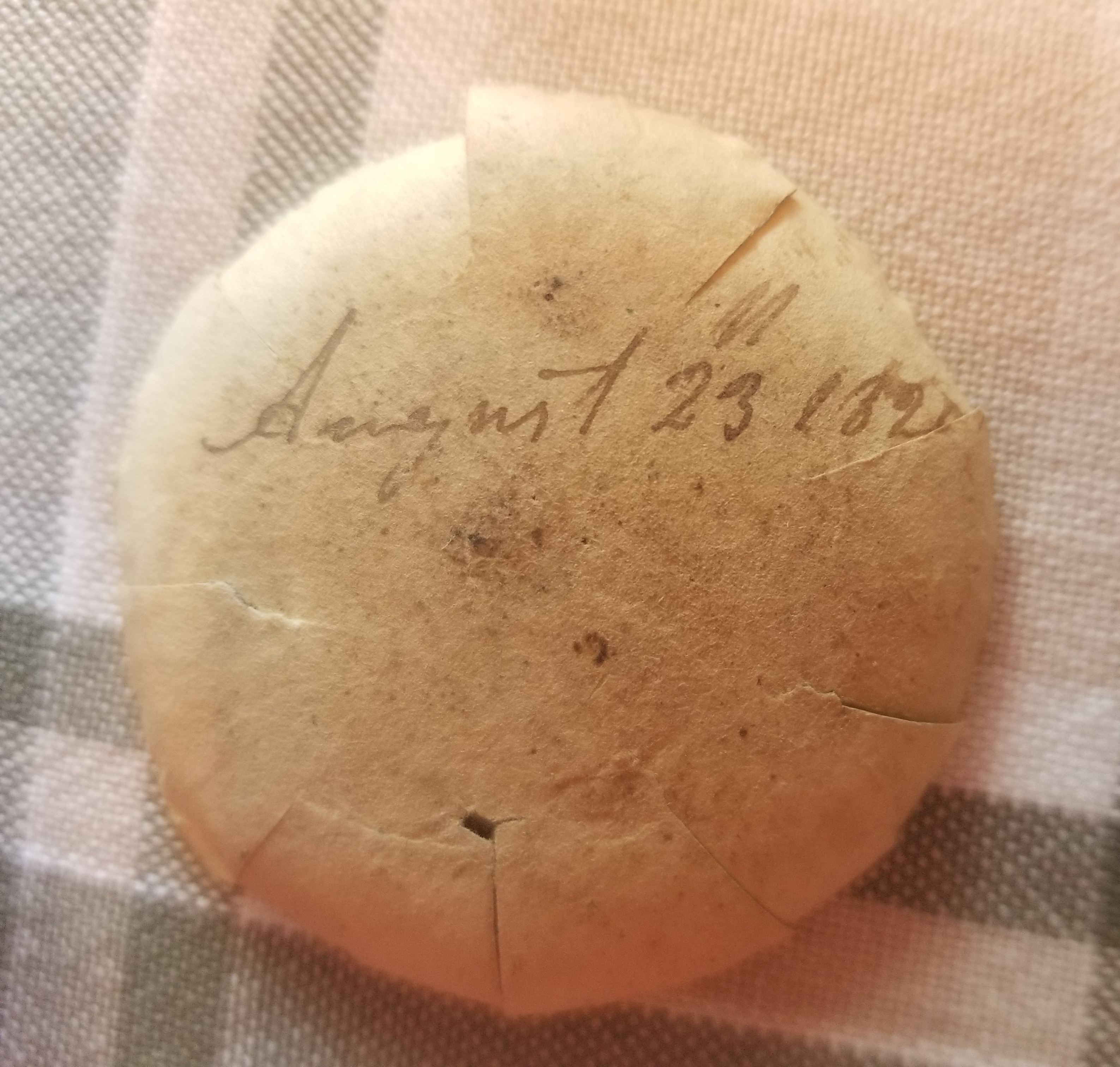

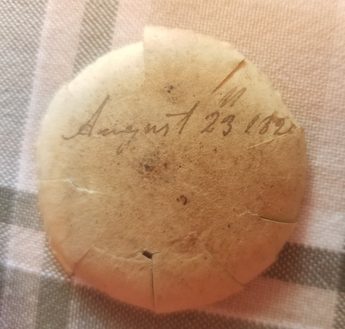

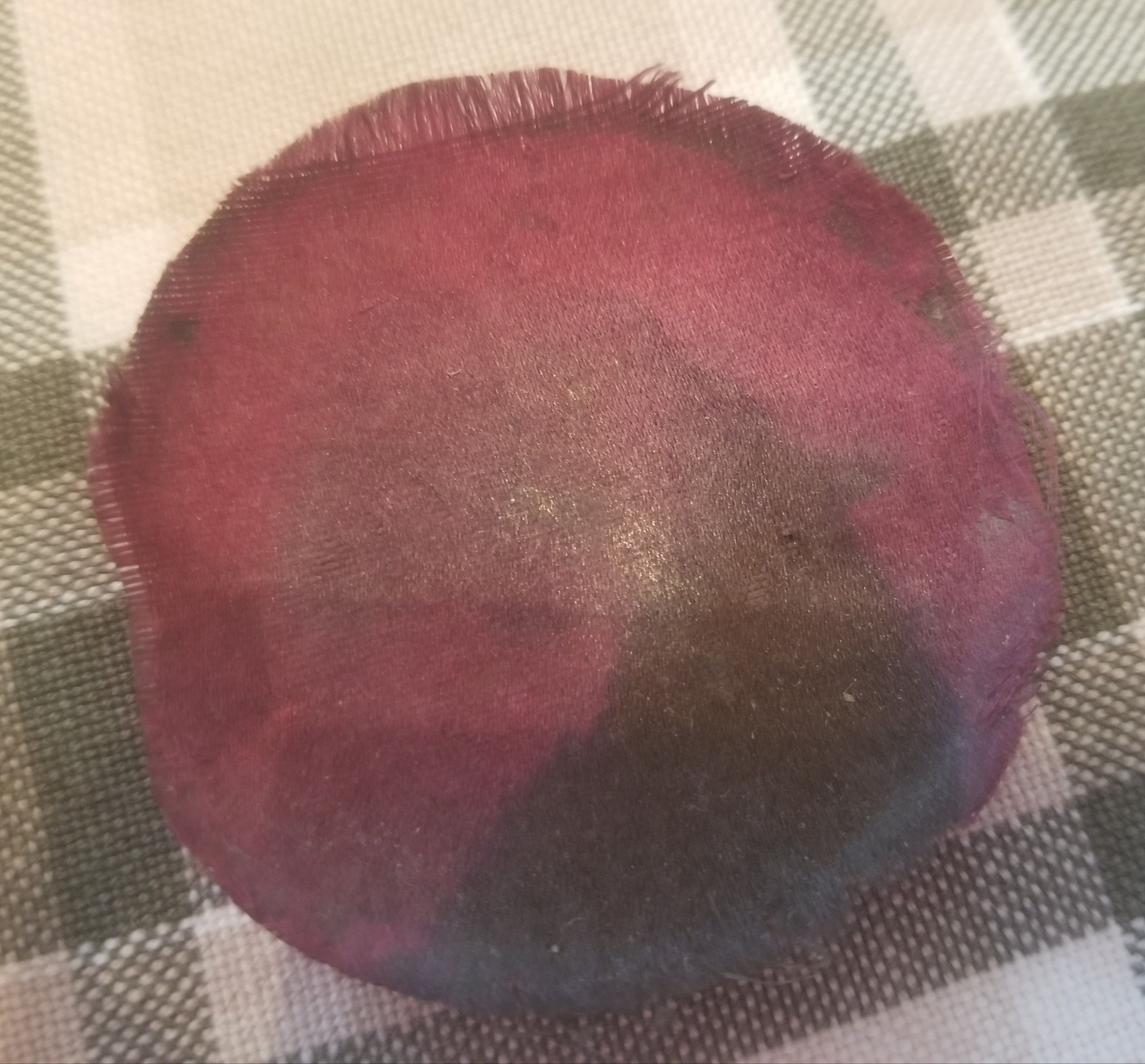

I used a pair of plastic-tipped tweezers to very carefully remove the three pieces of paper and a single piece of silk from inside the watch case.

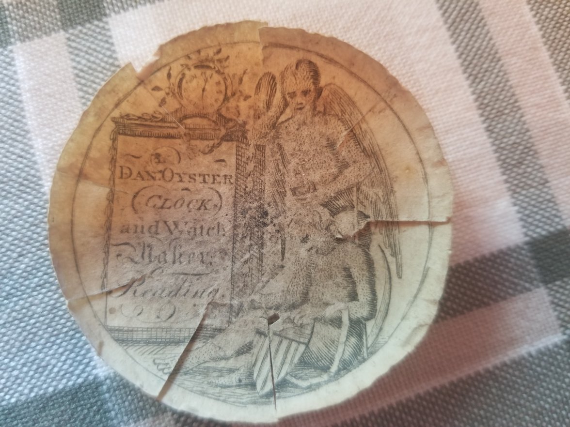

They are fascinating to look at.... one is an advertisement for Daniel Oyster clock & watchmaker, Reading (most of the research I've done says he was from Reading, Pa but one I read stated he was from Reading, Mass)
He was born in 1766 and became a watchmaker in 1792.
Another of the pieces of paper is the date August 23, 1820.

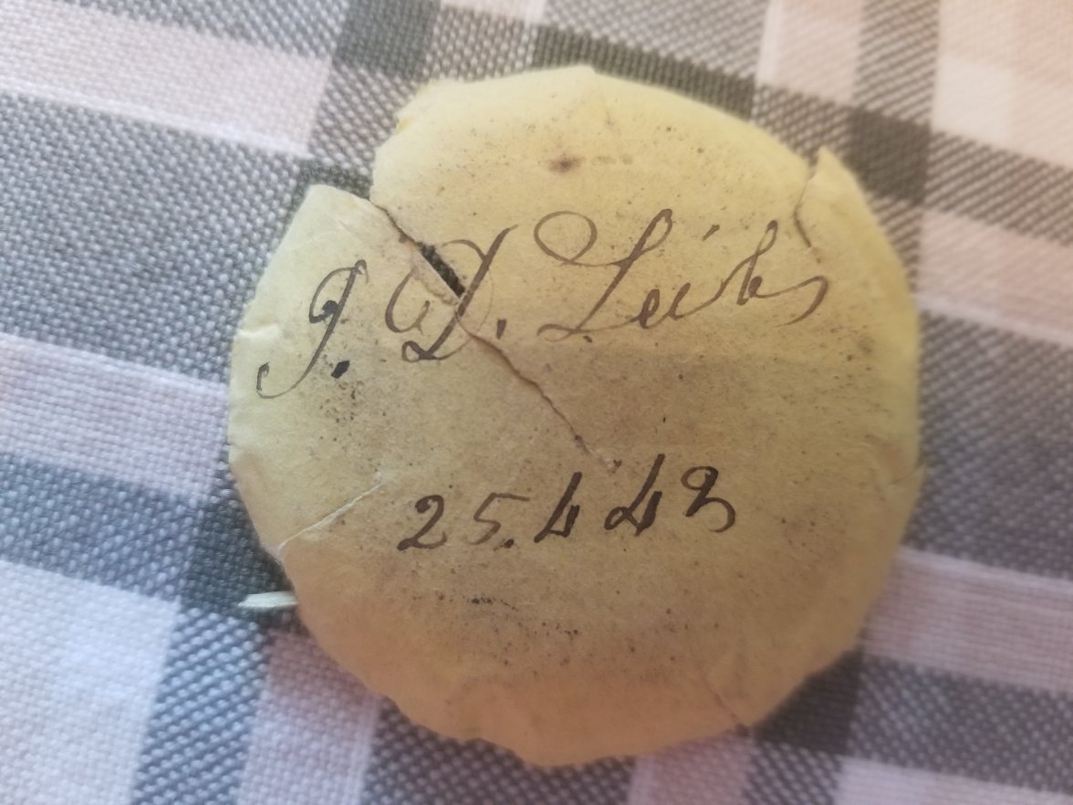

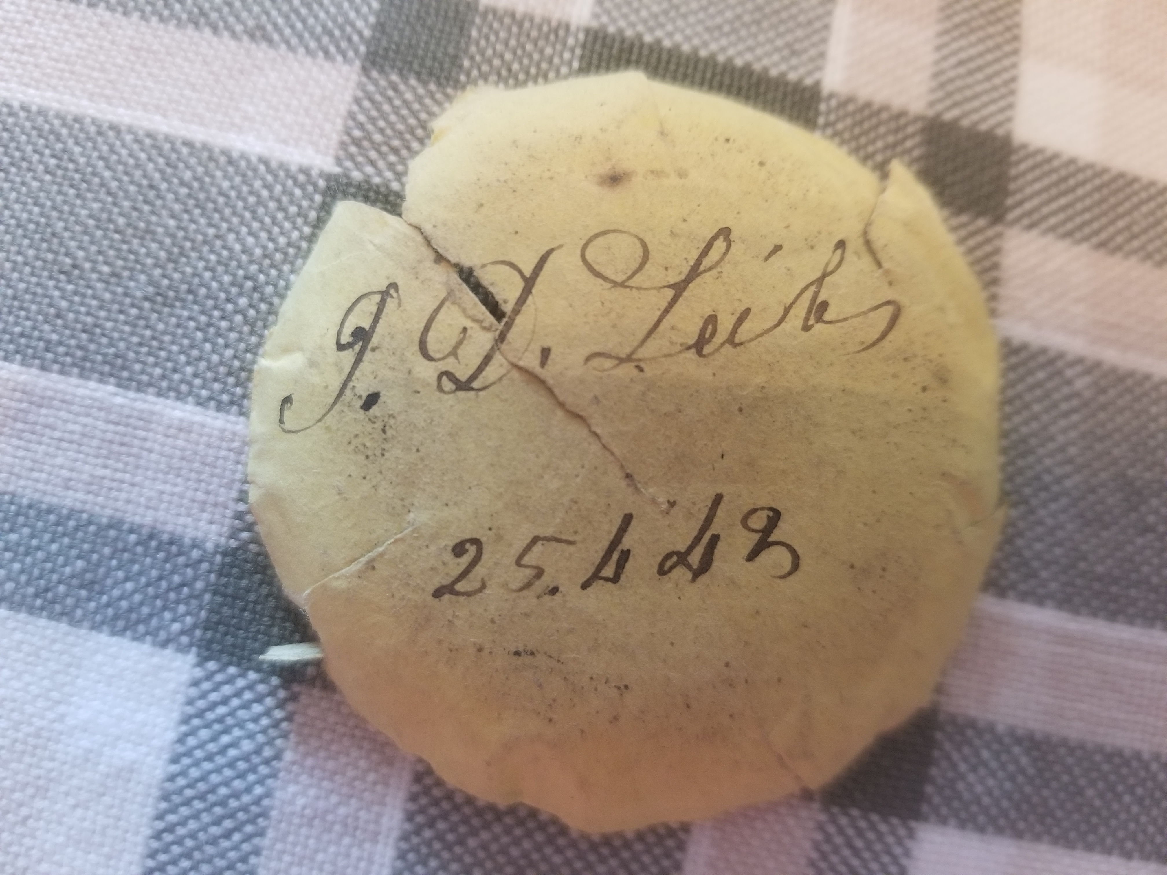

The third piece of paper has a name and some numbers but I can't make them out.
It's incredible to think that this watch and these pieces of paper have been in existence for over 200 years. Imagining the number of hands this piece must have passed through in its lifetime is fascinating to me.

The way I interpret the hallmark and date letter seems to indicate London, 1794-95. The case makers trademark A M could be Angela Marson, Butchers Close Moorfields who was operating around that time. The name Edmonds, London, engraved on the movement, unfortunately has an initial I am unable to interpret. But it could be Jacob, John, or Charles Edmonds who operated in London in the last quarter of the 18th century. Our English brethren have a much better aptitude when it comes to interpreting case marks from English cases. However, dates on the case papers seem to be consistent with a late 18th century hallmark.

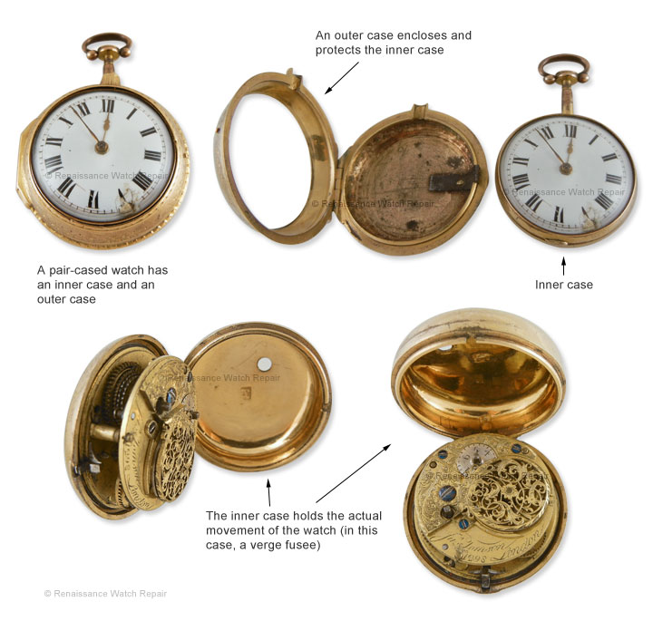

It would appear that this watch has a pair case. If so, and if the outer case exists, it might be interesting to compare the internal case stamps within both inner and outer case.

Nice watch. I'm researching a similar one and here are your hallmarks explained.
I can't find the maker "A.M" yet.

Your watch is the inner case, there was originally an outer case to protect the inner case because the winding hole and/or hand setting hole was susceptible to dust and dirt. The outer case protected the inner case and provided some protection to dust and dirt, and they were often embellished with engravings for a decorative effect. Back in the day watches like this were an expensive luxury, often in gold. They were worn by upper class gents, portable timekeepers were still a novelty and only the well to do could afford a watch. Too bad the outer case is lost to history.

I figured it was a pair case due to the papers/silk being in the back. If it was a single case there would be no way to wind/set it through the papers/silk.

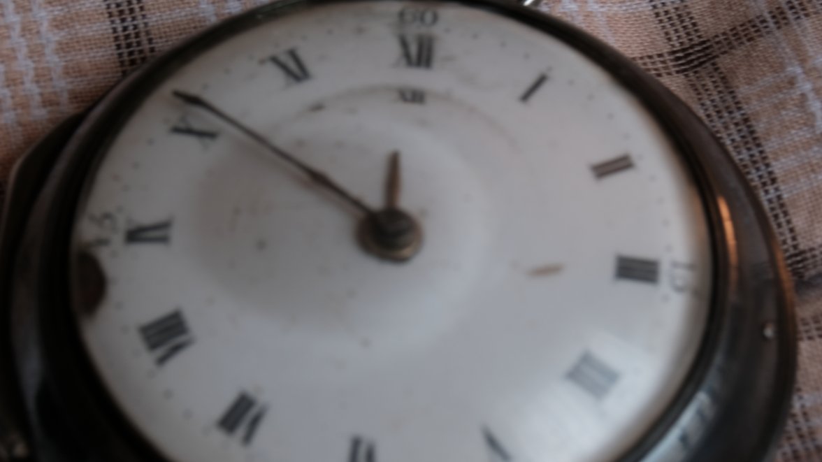

Is the outer case smooth, or does it have some engraving or scrolling decorative work? From your pics it looks like it may be a basic watch in silver.

It's smooth, I believe it is simply silver with no ornamental engraving.
