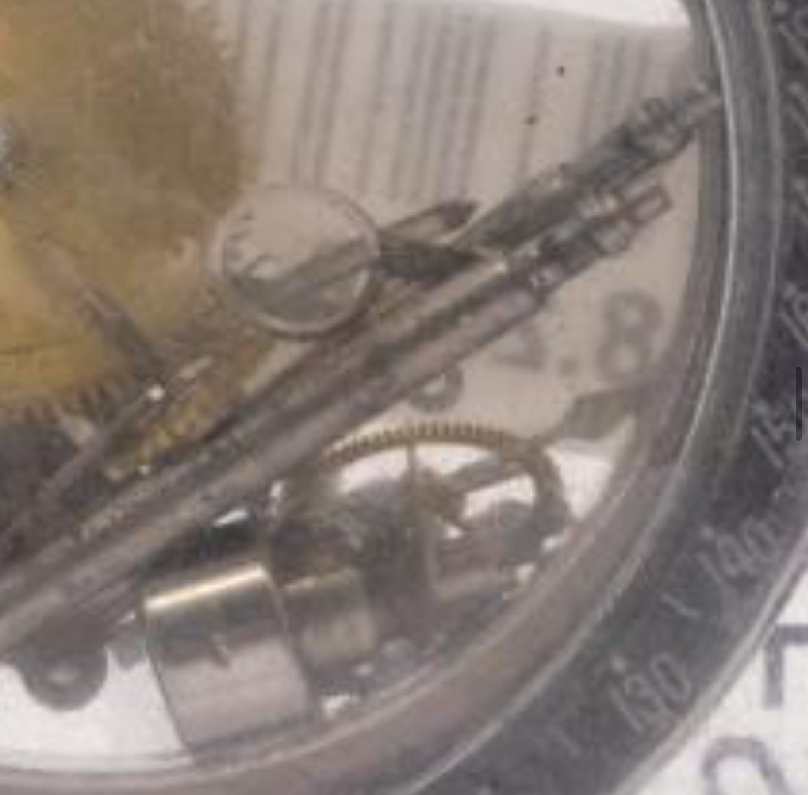

For the watch, obviously it's not an automatic as described. If came with the box originally then it would be a 1967-9 vintage. What have we got? Well if you know your dials extremely well, you can get right to it very quickly, but it took me a few minutes to work it out. Firstly I thought to myself - here we have a transitional, perhaps without lume. Then I noticed there is only "SWISS MADE", without the "T"s, which raised an eyebrow. The hands are all new, I noticed, so it's been serviced. Ah, of course, it is the luminova service dial that Omega routinely used to replace raised logo dials.
Oh dear. Well, that's a shame. Maybe it's in the bag of bits.
Ok so this is interesting. We have a DON bezel, the original set of hands and plenty of parts. The potential to restore the watch. But no, because we don't have the original dial. Thanks Omega service dept.
So, what do we have. The is case is well used, looks like it has been polished, but we don't see too much of it in the photographs supplied. We could go into detail here on the crown and pushers, but we've already got some red flags.
So for me the value is only in the DON bezel and hands, which we can't make out the quality of, and the hands anyway won't match the dial as the original dial is AWOL. Value-wise, I'm putting a generous £1,300 on the bezel and £300 on the box, then I'm left with valuing a service dialed 861 probably from late-60s but who knows as we don't have the serial or reference. If we put £2,500 value on that then we are at £4,100.
I see the original hour and chrono seconds hands… though I’m not going to hold my breath those will come out unscathed.
Yes absolutely - complete guesswork as to what shape they are in, but at least there is lume!

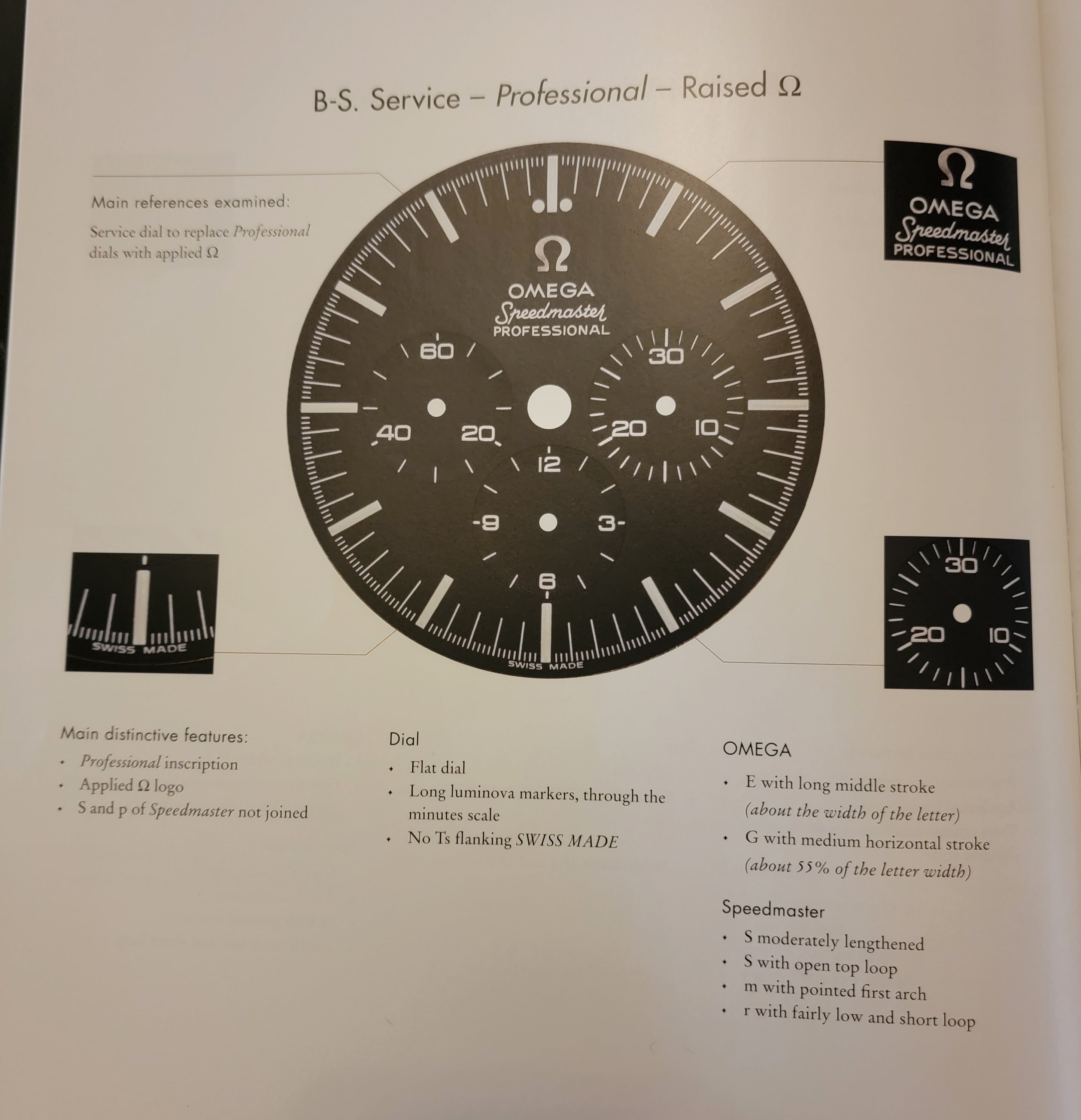

“…..Service dial 861”
Very likely a service dial on a 321 movement IMO.
Yes, could have been of course - can you tell from the parts? 😀

AFAIK they didn’t make a raised logo, long indice service dial for the 861 but I could be wrong.
Edit to add: yes, there is one for 861 but it isn’t a service dial so would be a result of a mod, not a normal service like this one looks like it’s had.

MWO is not 100% clear on this - they reference the B-S service dial that replaces all Professional dials with applied logos, and obviously there are both 321 and 861 versions of the applied dials, so this implies there are two versions of the service dial, but it doesn't actually say that. I would have thought Omega would have had to supply both, though. I guess a run through the service parts list would confirm, or are you ahead of me there?
Correct, but Omega would only use the correct service dial for the reference so that limits it quite a bit. So making the albeit big assumption that the dial was changed by Omega during a service, I’d bet dollars to donuts it’s a 321 movement in there. (They would just slap a standard 861 service dial on a 145.022-68 you see them with service dials fairly often on eBay and it’s a standard painted logo service dial)
Ah, ok, I get it now.... thanks both, I've learnt something 😀
there is no such thing as an 861 service dial.
Ummmm… What do you call a luminova dial on a 145.022-76 if not a service dial for an 861? Any damaged dial replaced durning service, that is not the original dial, is a service dial. No?

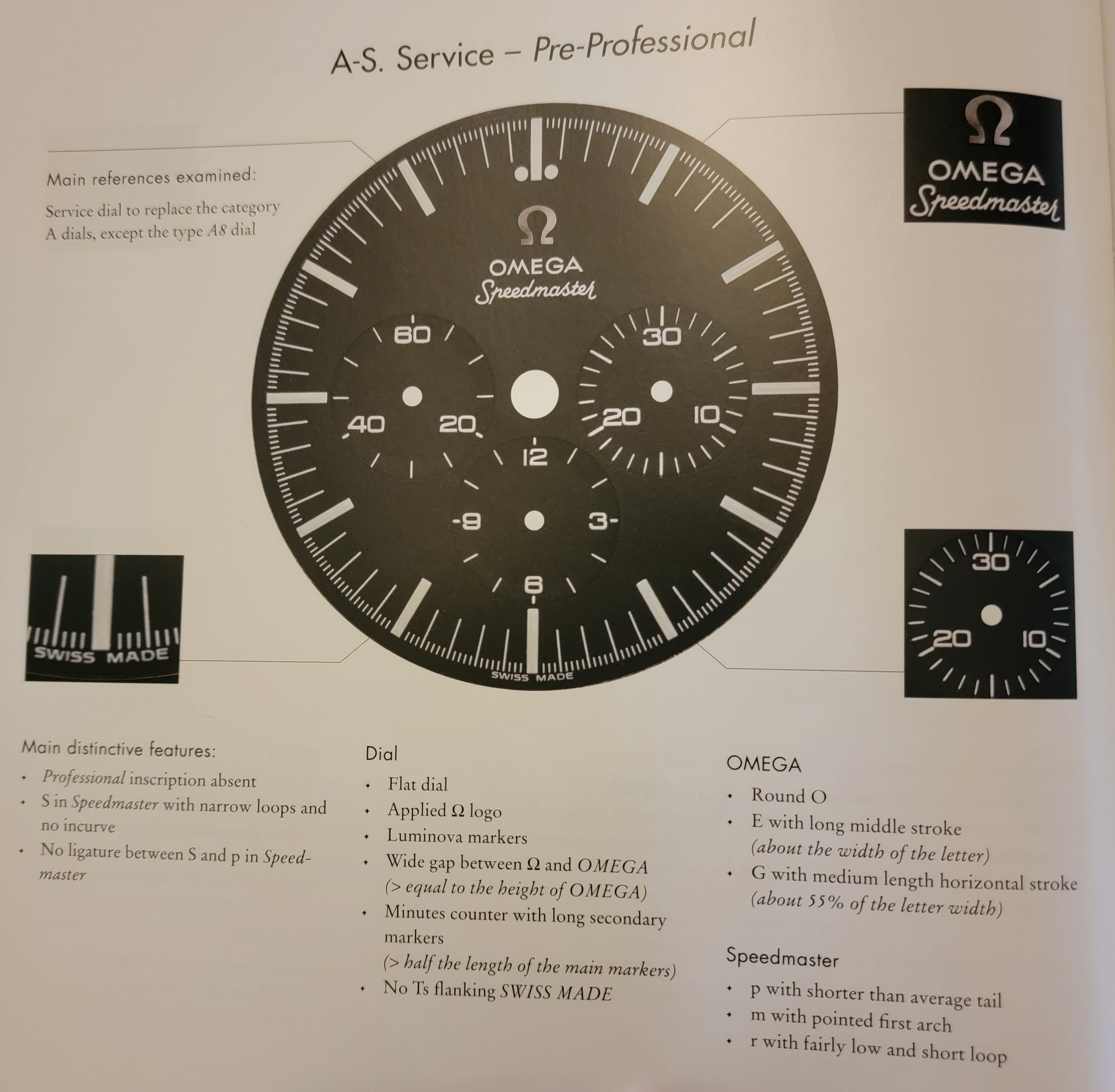

[For background for this thread, these are 321 service dials identified in MWO:]
I call it what ever is current stock not a specially made service dial.
the 321 service dials where not made untill after 1969 when the 321 went out of production. They where made in small batches as they had a limited shelf life and hence all the weird variations on them.
Receiving a new dial in service is not a service dial. The dial an 861 would review is just what ever is current production, and not a specially made service dial.
I understand what you are saying but think 90% of collectors will call a luminova dial that has replaced a tritium dial a service dial.
That's how I thought of it, that a dial replaced by Omega at service was a service dial. But as the term "service dial" is defined, I realize now that there is a technical difference between a dial specifically made as a replacement versus randomly replacing it with any dial that will fit.
