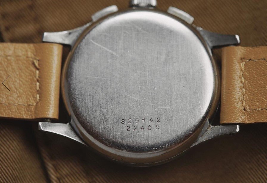

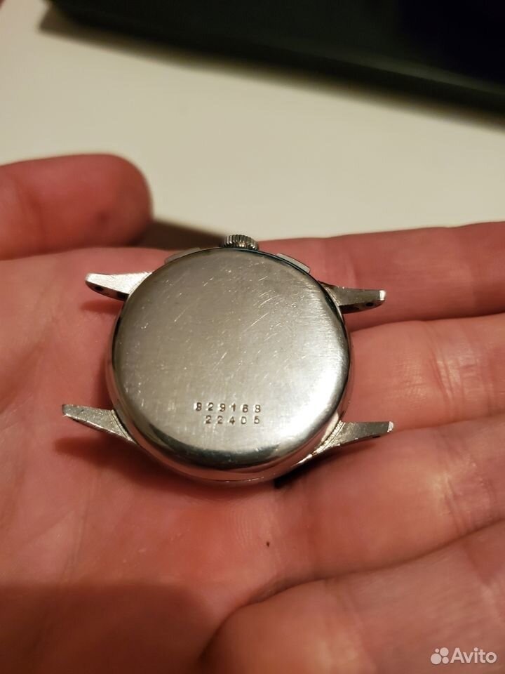

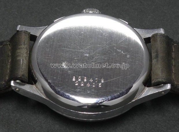

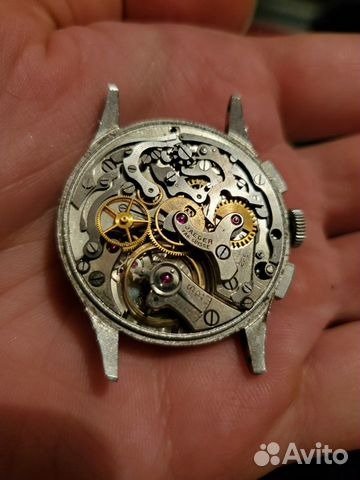

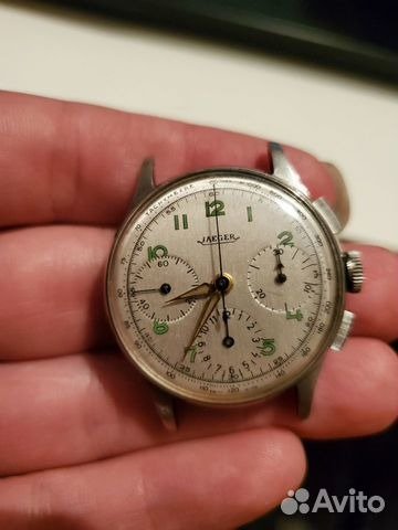

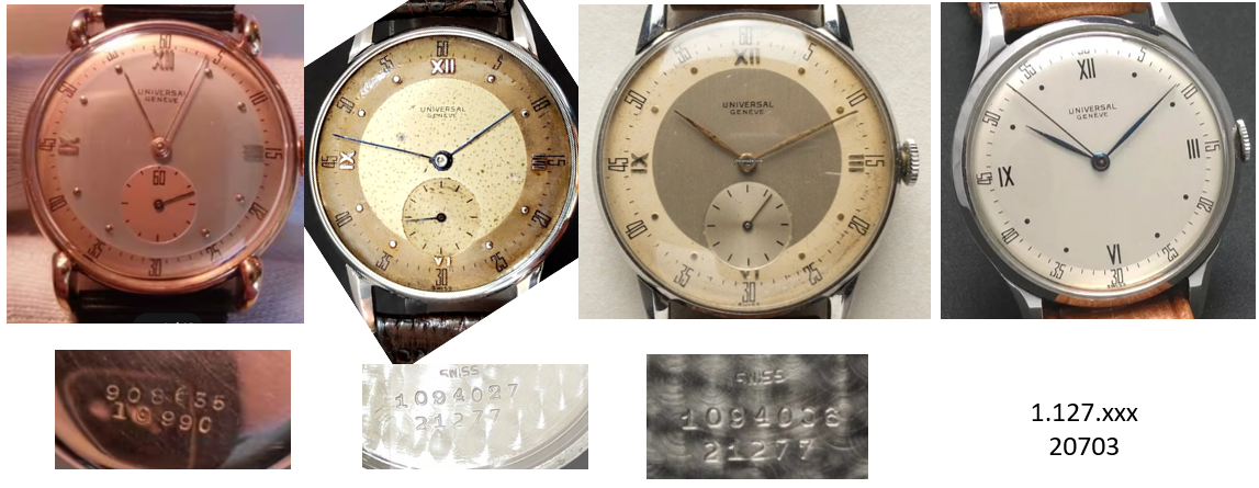

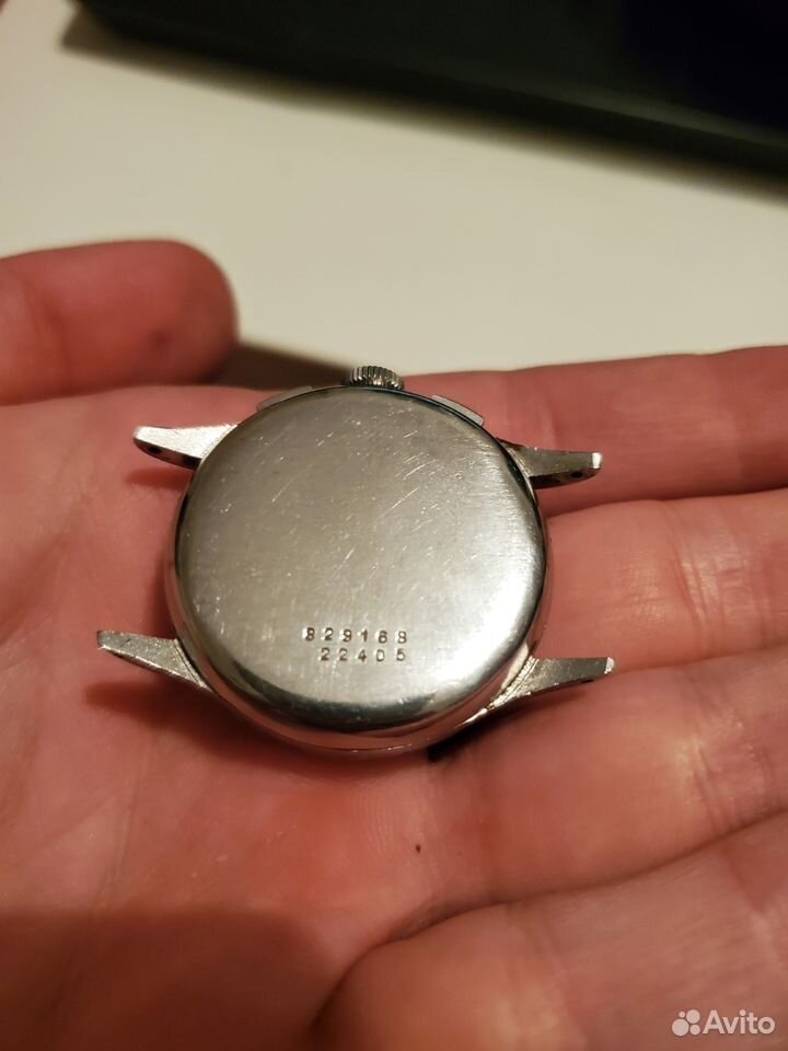

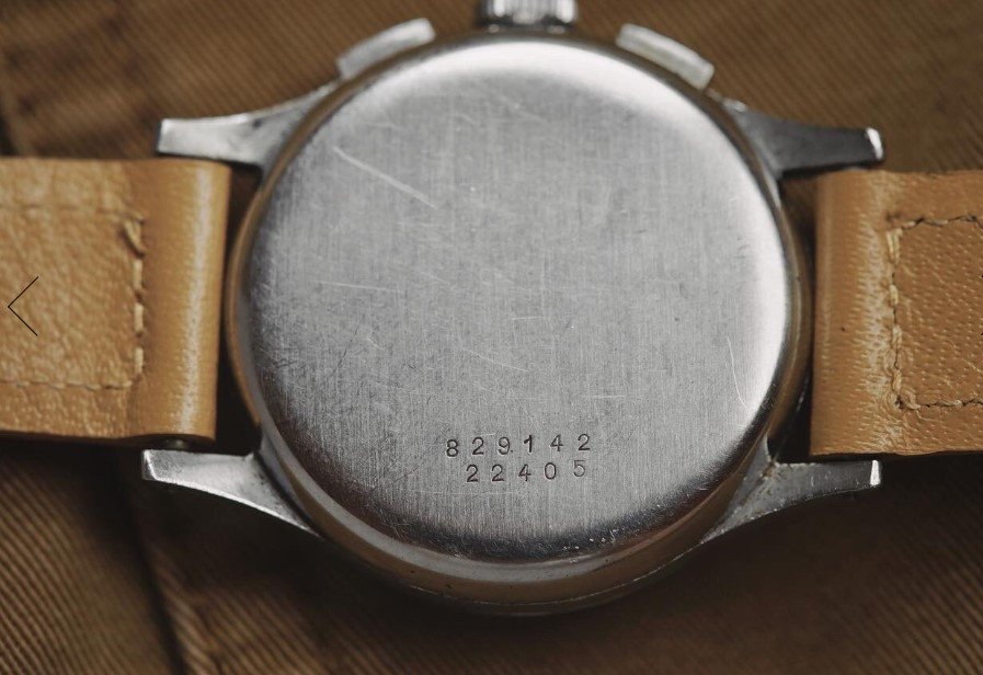

One of these interesting UG anomalies: ref 22405
Serial: 829.142. UG. Found here

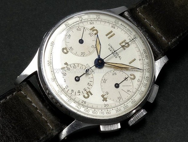

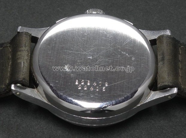

Serial: 829.479. UG: Found here (numbers not easy to see but the ad mentions them)

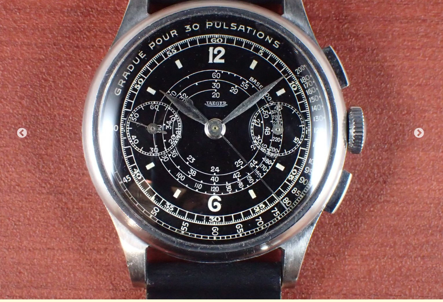

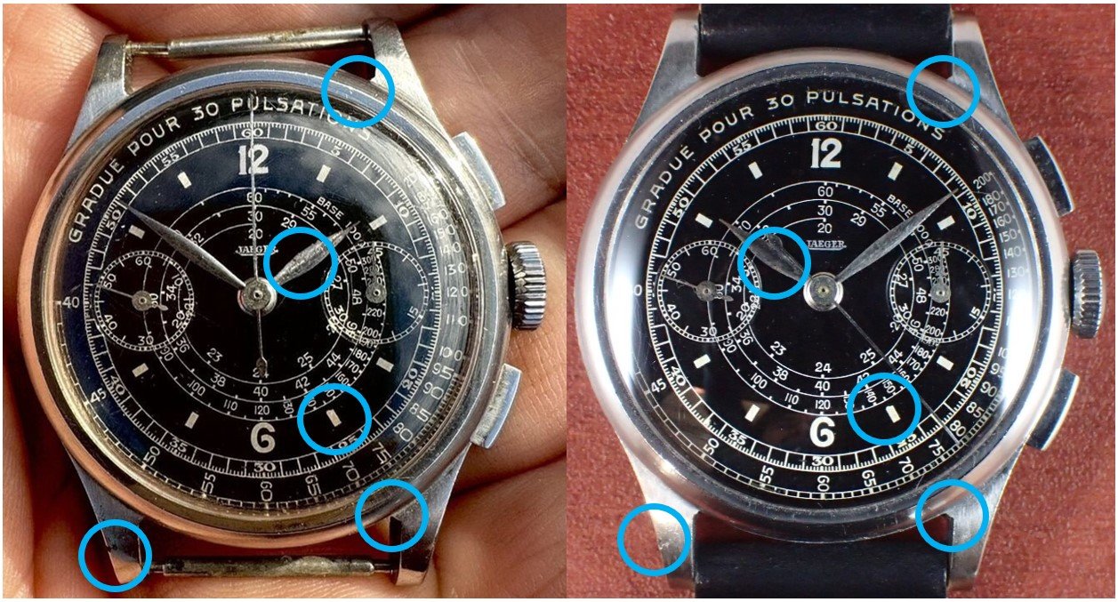

Serial: 829.188. Should be UG? Nope... Jaeger! Found here

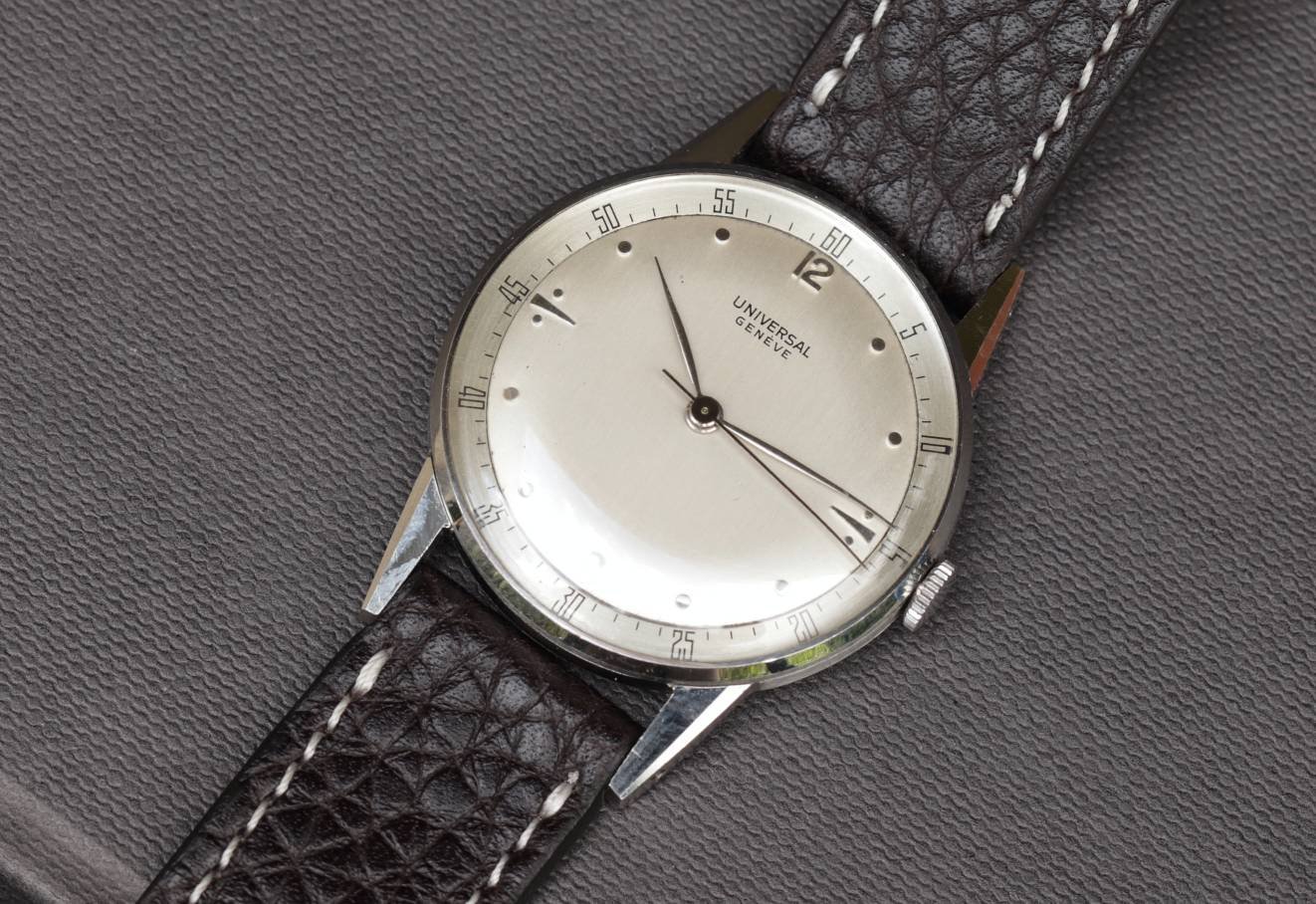

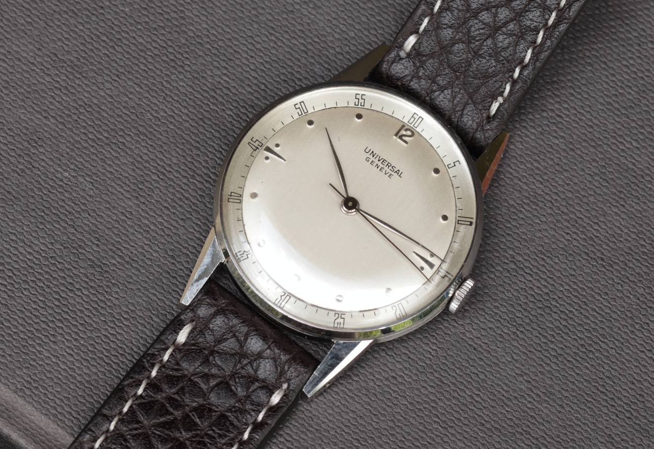

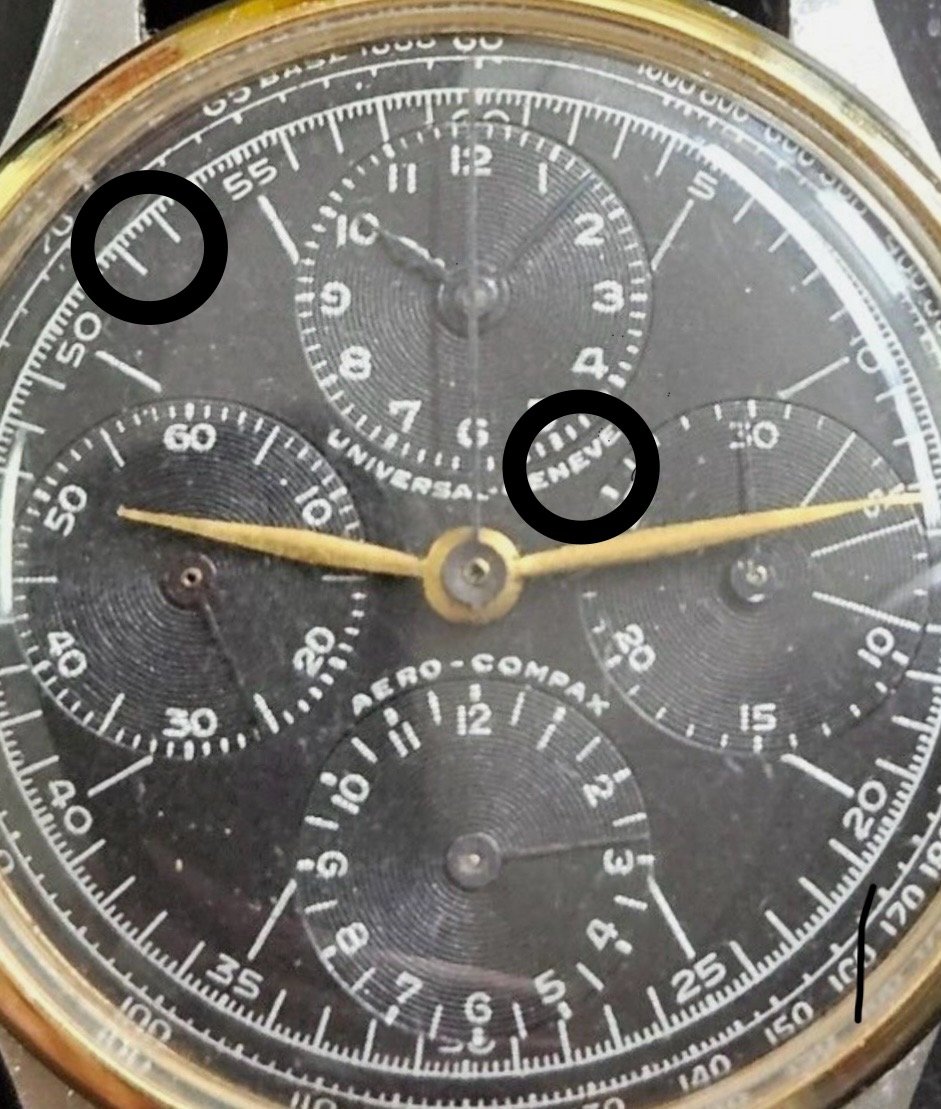

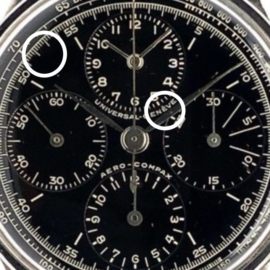

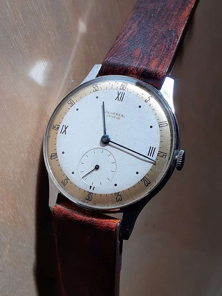

Mine kind of does have squared numerals in the outer ring ?
Yes but they are different
337
454

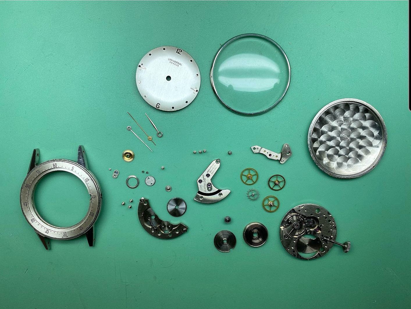

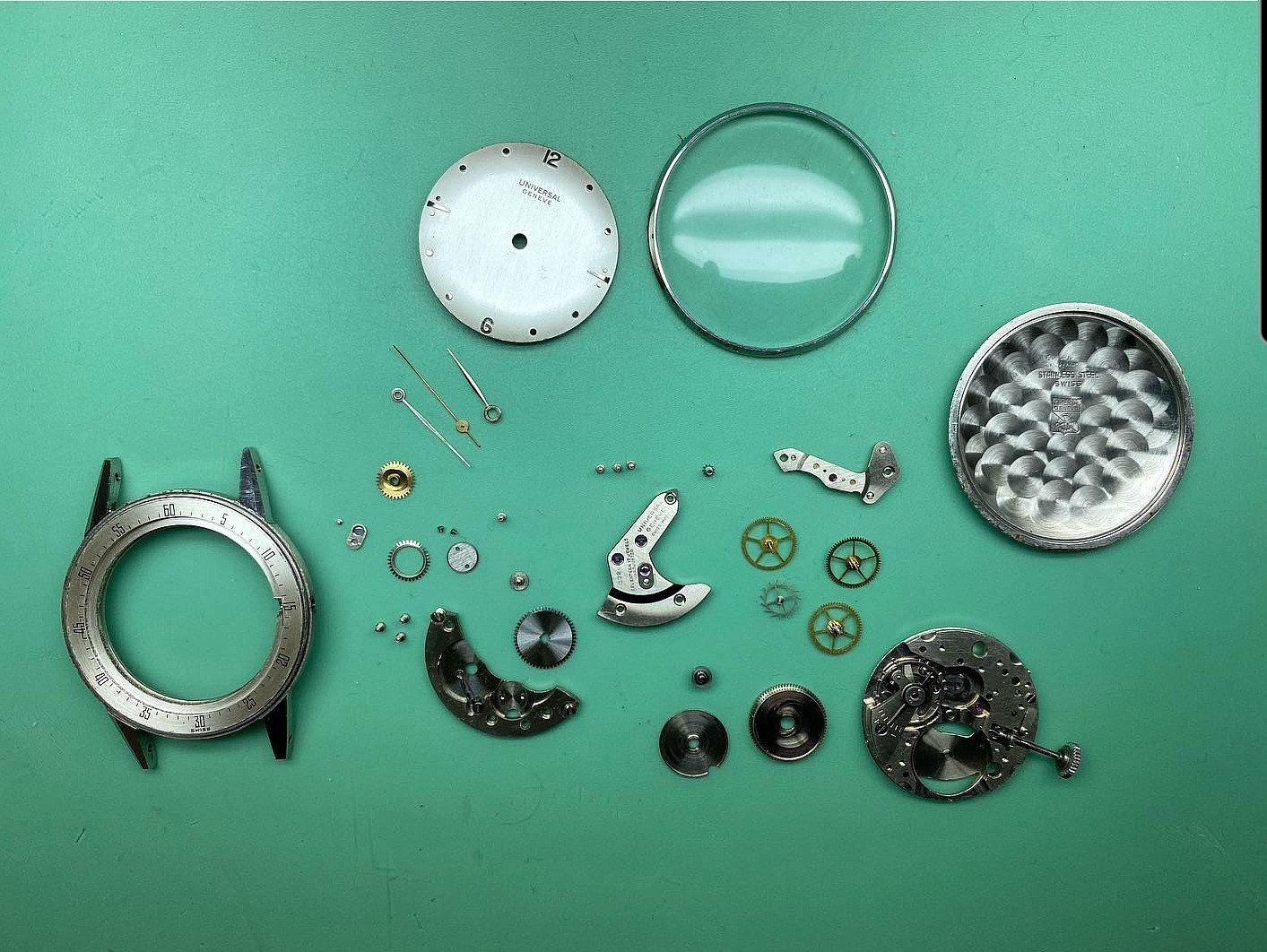

Here you are, this is mine. Ref. 206508 with calibre 332 though not 262. Same inner bezel, same fonts on the Universal Geneve too.
And a shot from its service showing that interesting bezel.

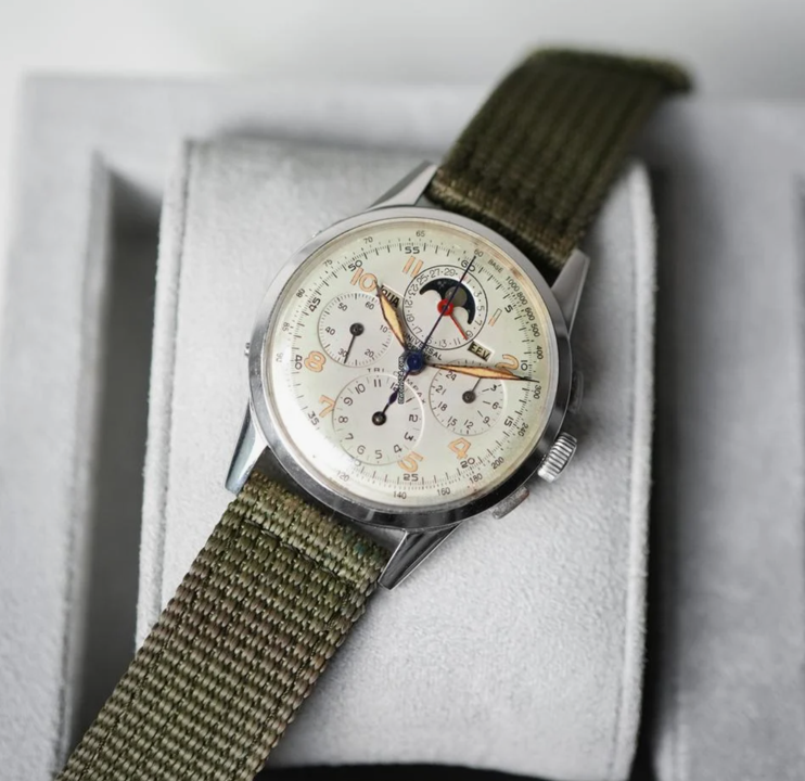

Somewhere in the process somebody made a nice ride: from EUR 2.800 to 10k. I'm 99% sure this: https://omegaforums.net/threads/universal-geneve-watches-on-ebay.3584/page-368#post-2291409 and the above are the same watch.
Sadly I was expecting this.
According to the old seller the watch was shipped to Japan.
I assume bought by the actual seller.
Still a very nice watch and thanks for comparing.
Happens too often watch is sold and shows up 1-2 month later with a hefty premium by a dealer.

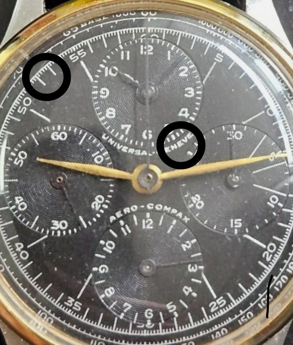

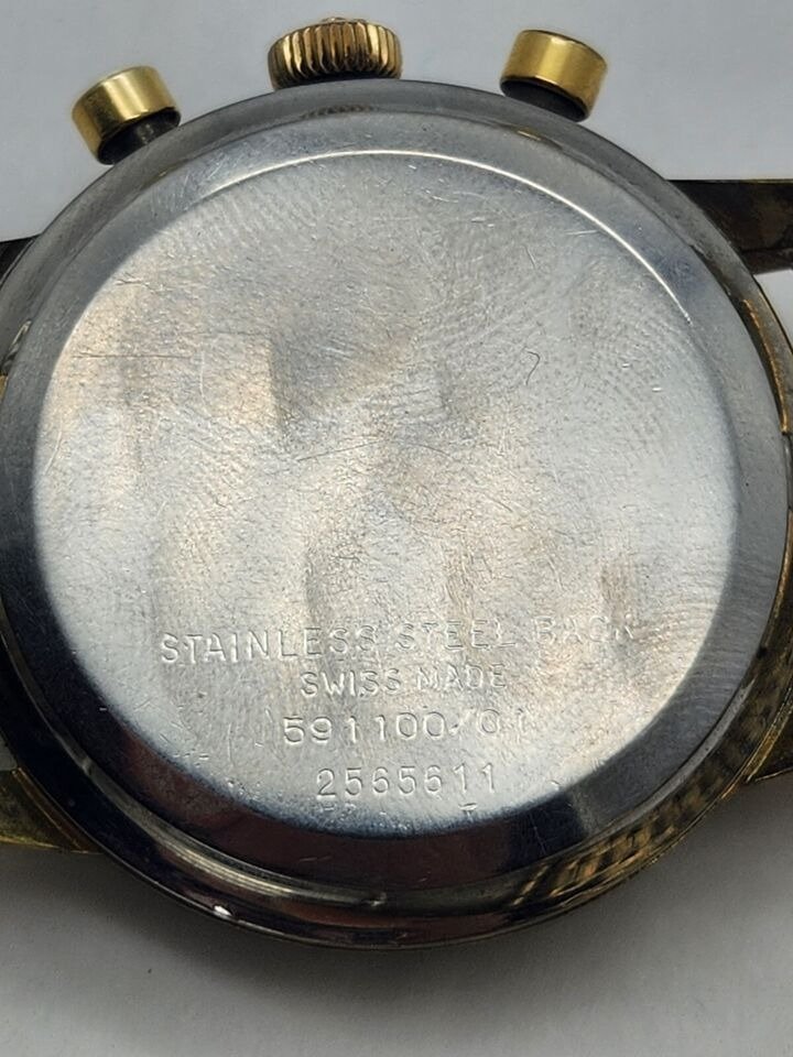

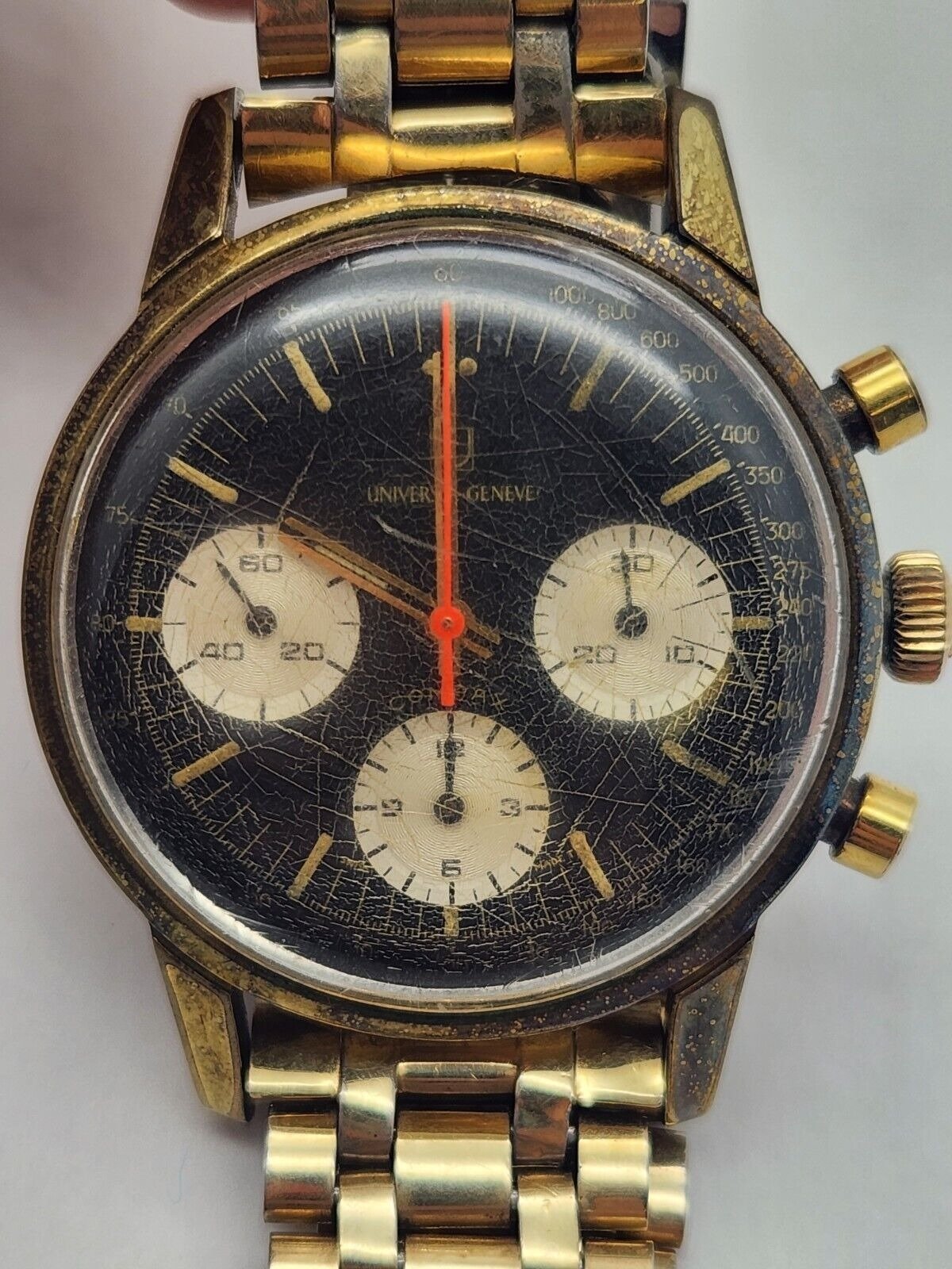

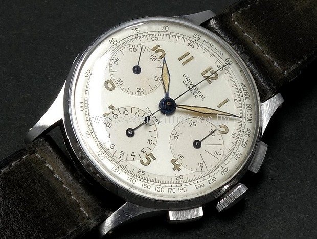

Well my first issue is that 22477 is a Jaeger reference 😁
172
423

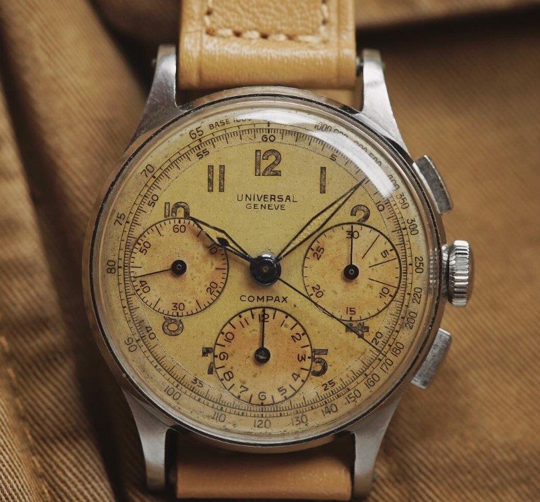

I think 22477 is a UG Aero Compax reference... (https://universalgeneve.info/chronographs/87-12440.html)
So caseback, midcase and movement of the watch in question are probably correct (pity that midcase is broken).
The black dial clearly is a redial and the handset is a good proof that the original dial was not black at all.
