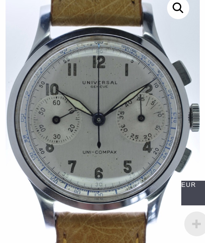

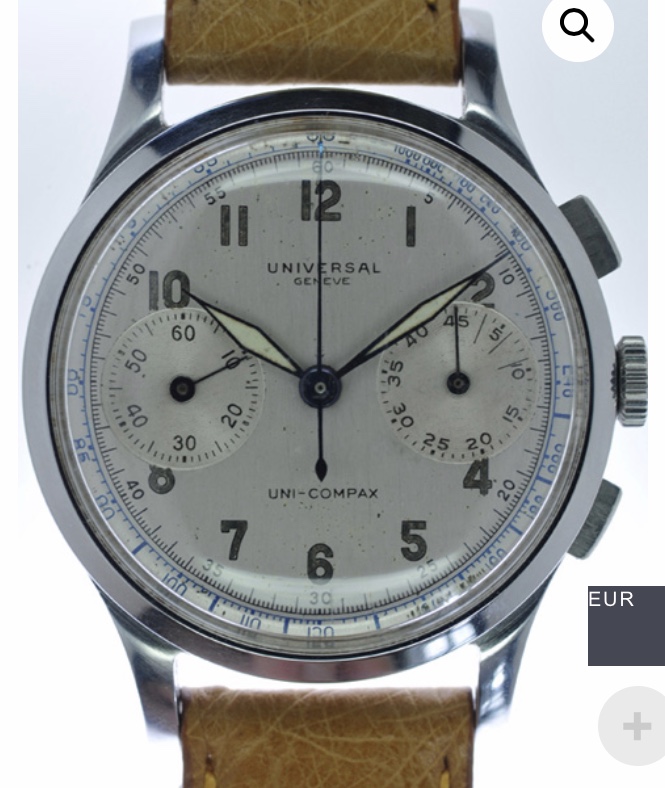

This is on C24 by Private Eyes, am I missing something or is this a fairly obvious redial?
https://www.chrono24.com/universalgenve/uni-compax-ss-chrono-silver-gray-dial--id13584948.htm
In my view you are missing nothing (as usual). Redial. Left sub dial cut out is asymmetric versus the one on the right, ie decapitated ‘8’ versus fuller ‘4’ on the main dial itself, no ‘Swiss’ is always a talking point on Compax and usually not deemed correct, top lugs are drilled through, bottom ones look female and so on. Parts of the case are undeniably attractive but, for me, the watch as it stands is a very different one to the one that left the factory.

I just thought Private Eyes was considered a more reliable seller ?

Me too. They are personal friends of esteemed members here and no doubt others will spring to their defence. However, this particular watch has been around the block and looks a little bit different each time it pops back up. Here it is a few years back, still sporting those concerning rounded subdial 3’s;

Not no, but Hell No!!! This is all wrong. “ esteemed” or no.

Is that something that was put together at Playschool ?

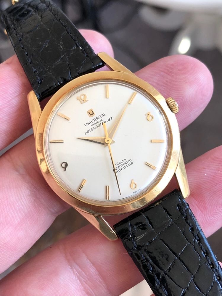

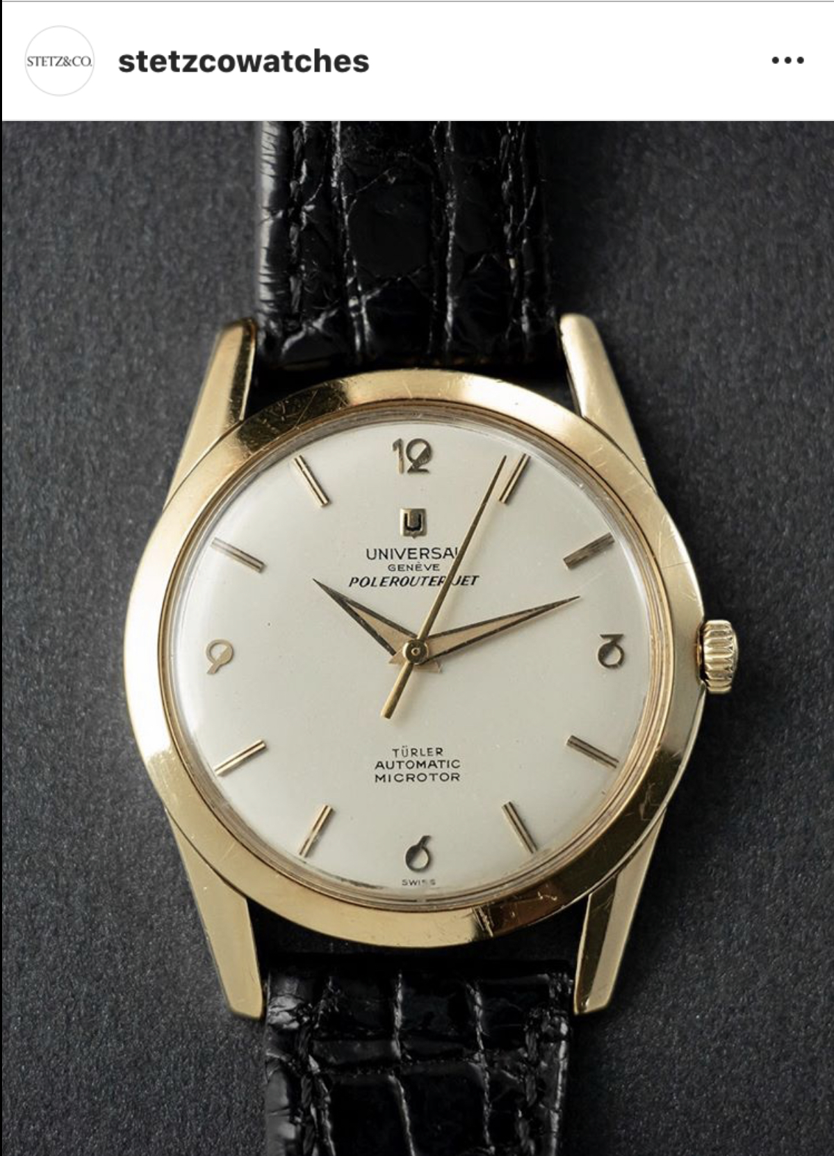

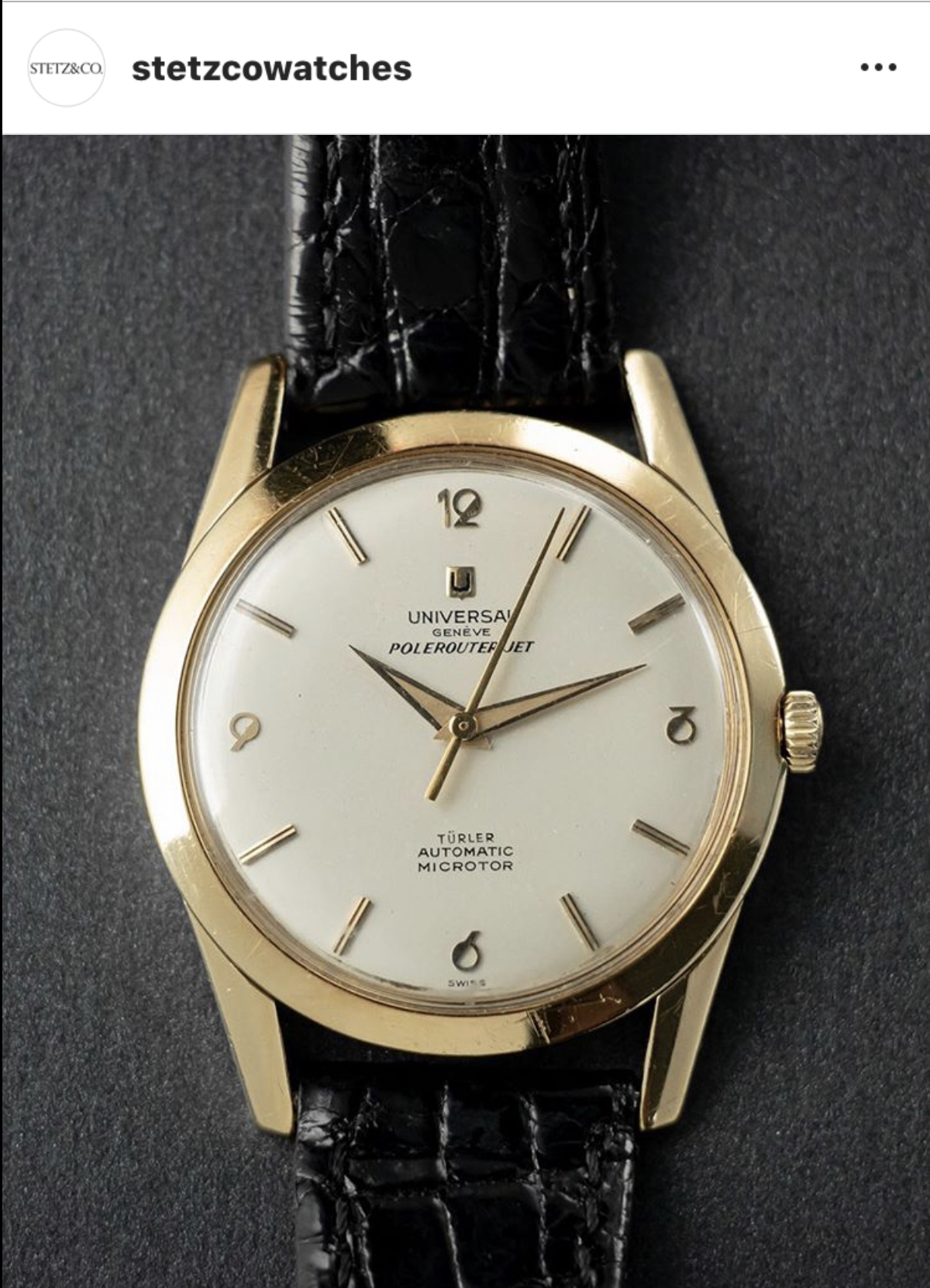

This one’s not on eBay but via Stetz & Co (@steztcowatches on Instagram). A stunner, that I figured merited some attention here. I have no affiliation to the seller. But wow...just wow.
Polerouter Jet 10364-2, Art Deco, solid 18k yellow gold.
852
3,673
You missed out the double-signed bit...
Didn’t forget. Just didn’t want to post the same listing in multiple chains (eBay, and double signed UGs). Feel free. 😉
121
475
Those numerals are really amazing, never seen them before. Is this a Turler configuration or do they exist without the double signed dial as well?

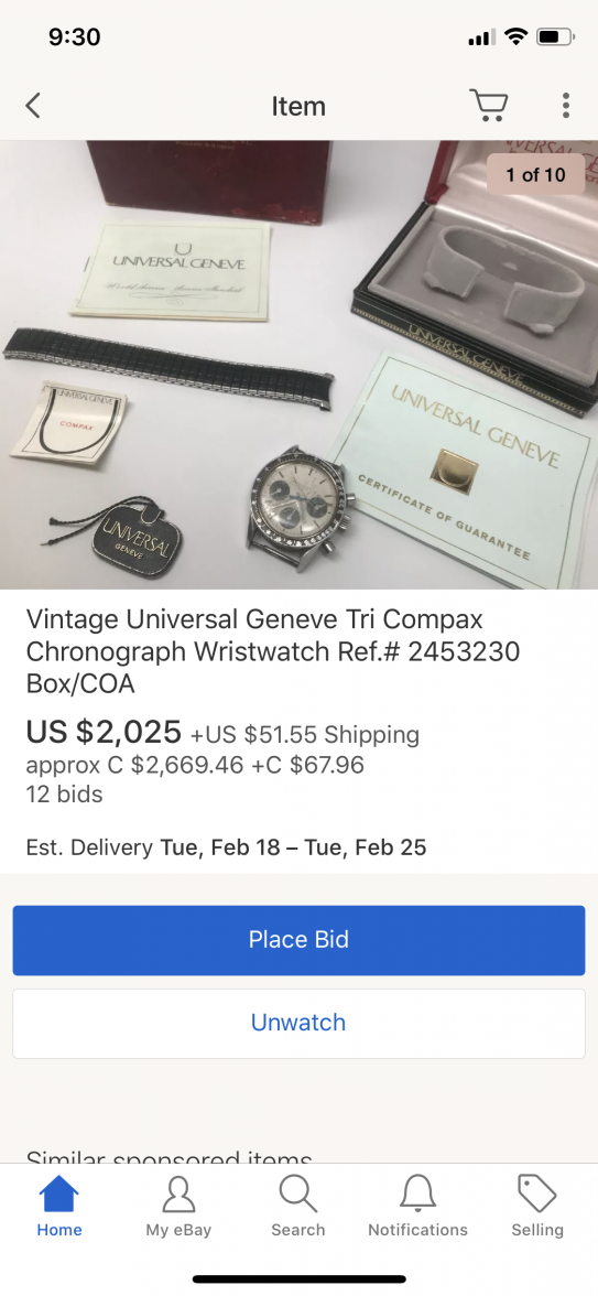

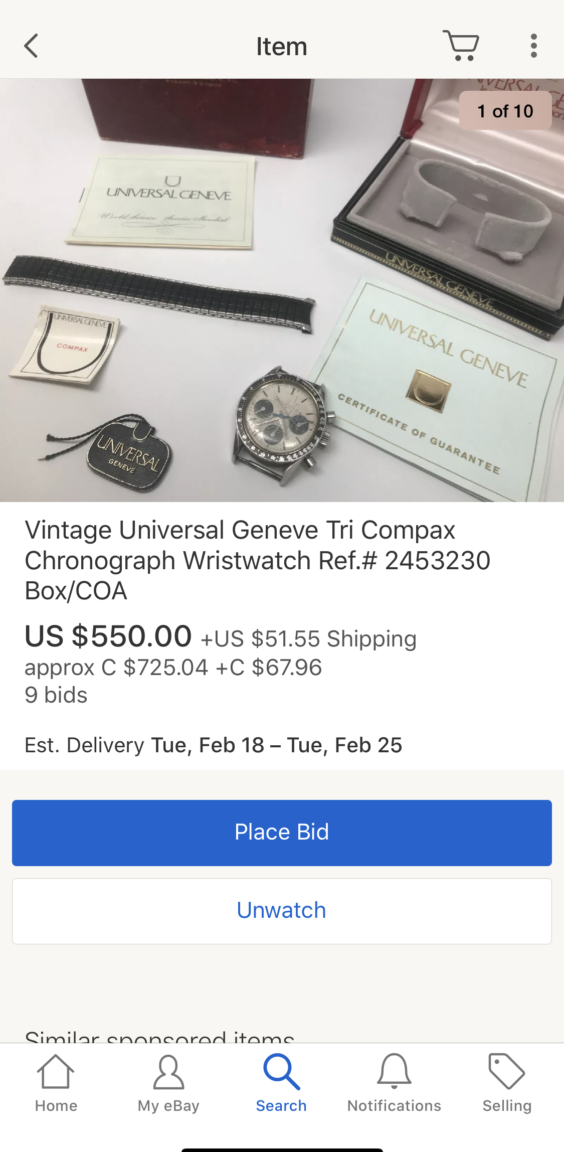

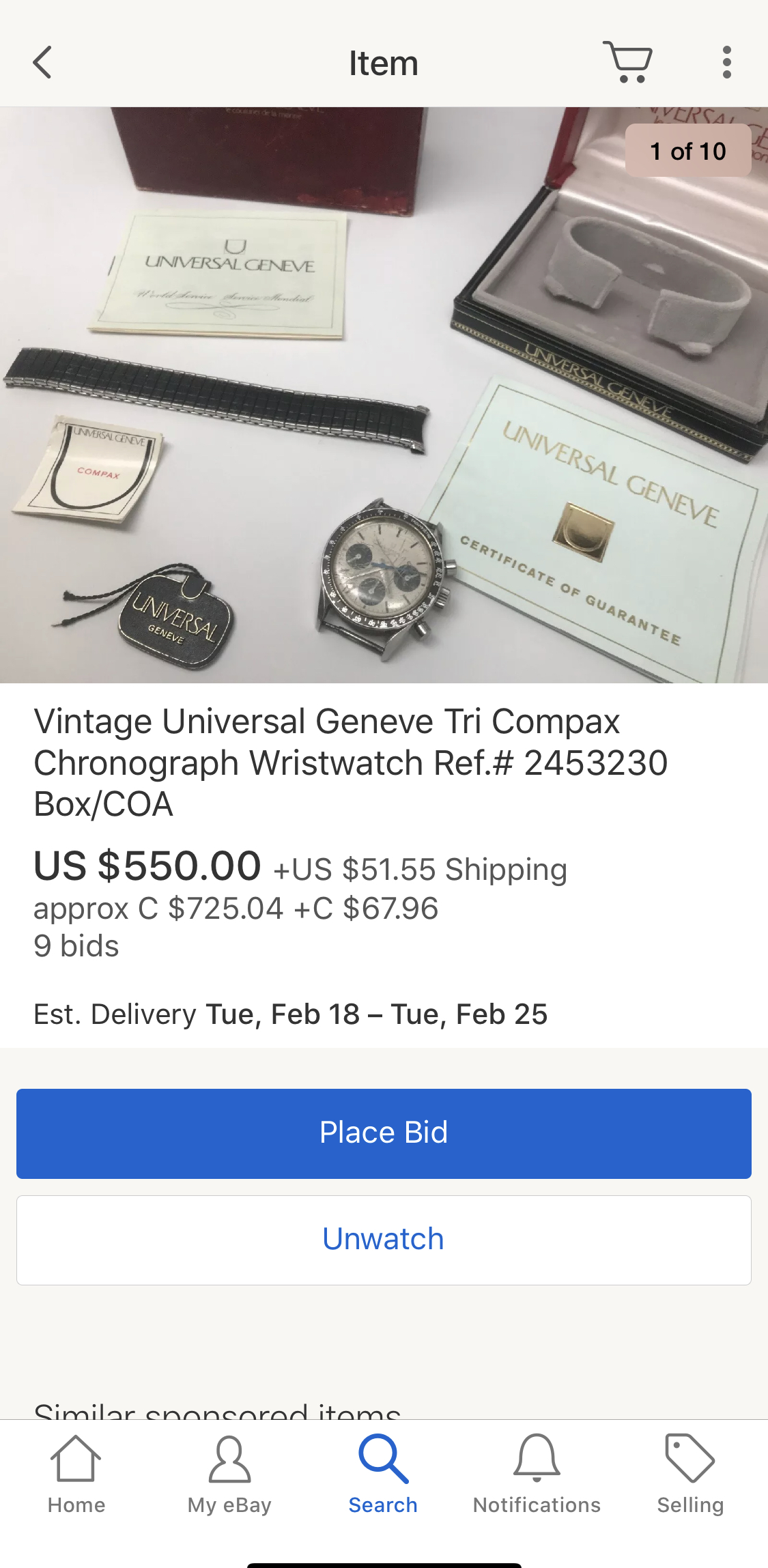

Ok UG experts... what about this one? 33 mm watch. Any advice or opinion? Thanks for your guidance...
3,460
35,286
Well! Someone liked it! Price went up with bids soon after I posted this! Game on!
13,935
54,145
Its not a Tri-Compax.
13,935
54,145
Buehler? Buehler?😁 ... full set Compax in need of a service ... yea much higher. Seller is probably an antique store.
