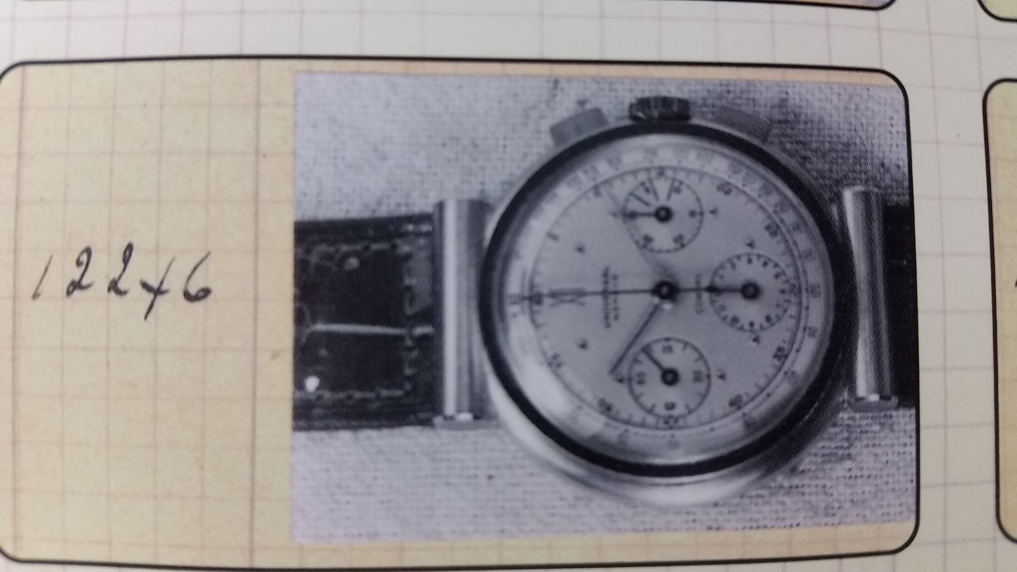

Image from the Sala UG book ...

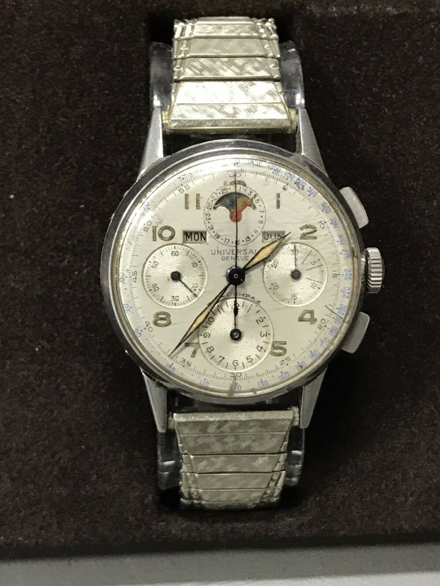

certificates of authenticity are as useful as a used toilet roll ! It makes me wonder about southerbys, they are a reputable auction house!
Dial is very different. Obviously a redial with a little extra. Amatuerish print is all wonky, round 3's in seconds register, bad print in minute counter and tachymetre scale as well as roman numerals give it away ...

It’s absolute shit. One wonders about the laziness of the “artist”.

Takes some balls to put Cartier on there ::facepalm1::

Also seems to highlight that these "Extract of the Archives" should essentially be ignored for UG...
Maybe even view them as a red flag. I sure do.

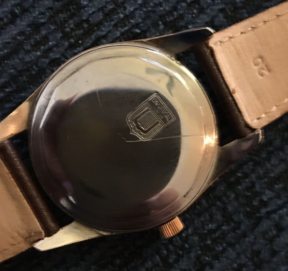

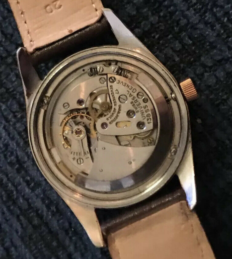

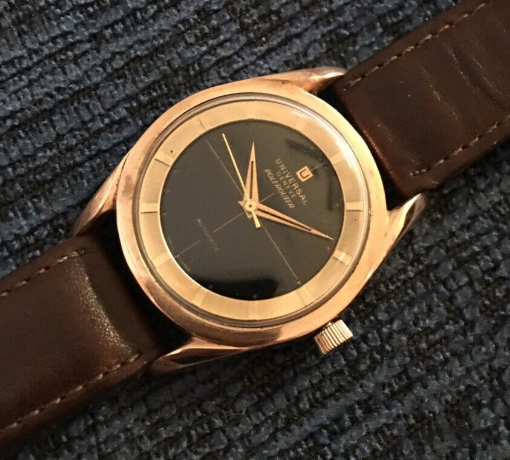

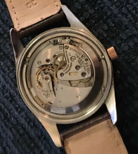

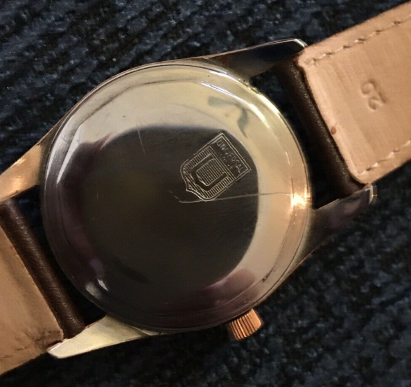

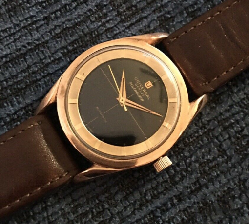

Any thoughts on this Polerouter up on eBay?
https://www.ebay.com/itm/VINTAGE-UN...203537?hash=item444ef12891:g:8eYAAOSw4PBdqPUE
I'm just getting into Polerouters, but my observations are:
-Not an original crown (no "U" marking - maybe some early crowns were unsigned, but this one looks like a replacement as the other crowns I've seen are smaller than this).
-All of the dots of lume on the hour markers seem to have been lost (looks like empty holes on the dial).
-No serial number on the caseback (I've read these were not etched very deep on early models, so this is somewhat common?).
I am looking for this combination of rose gold with a black dial, so any feedback on this example in particular and what to look for on this combination in general would be greatly appreciated!

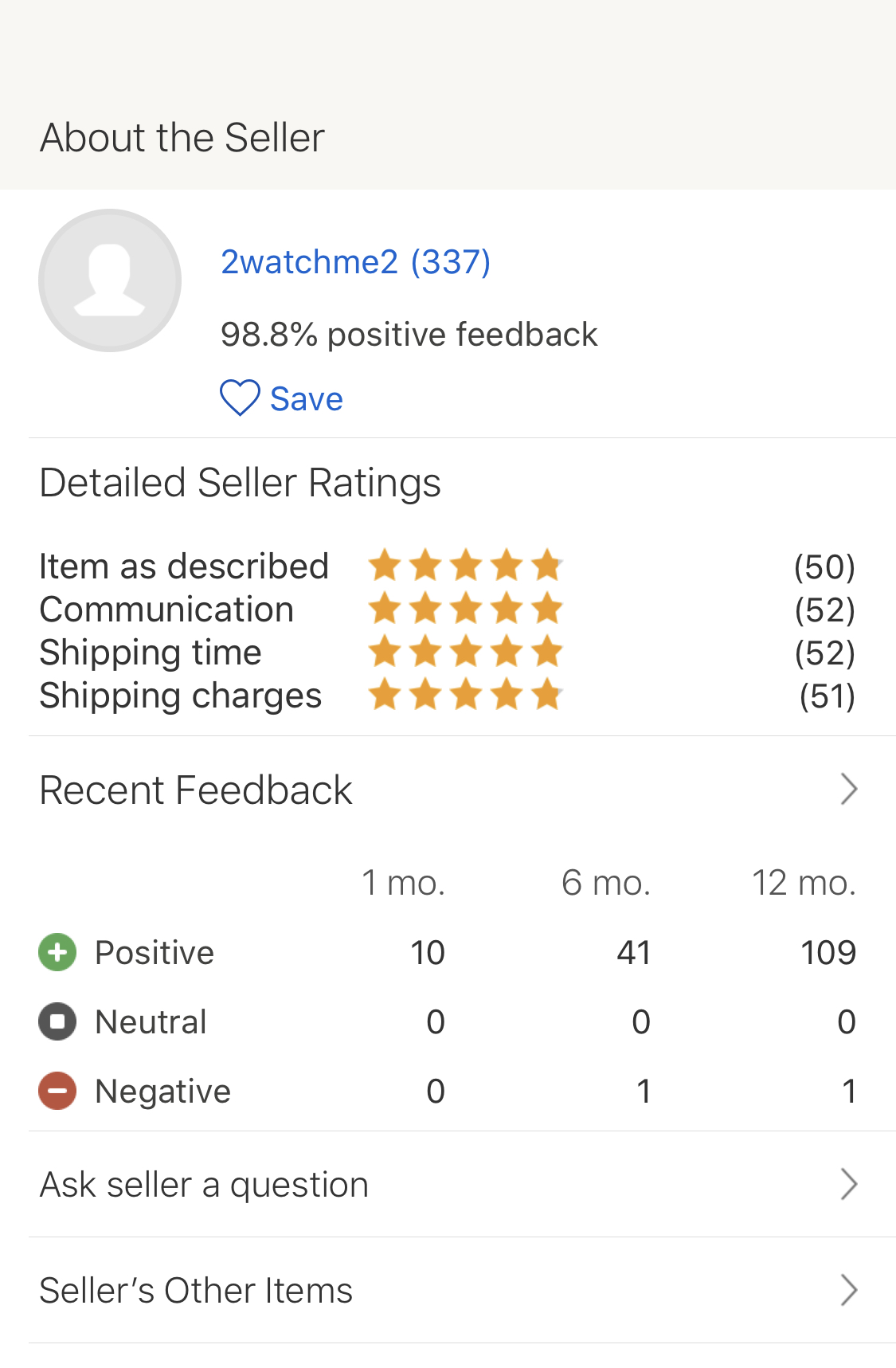

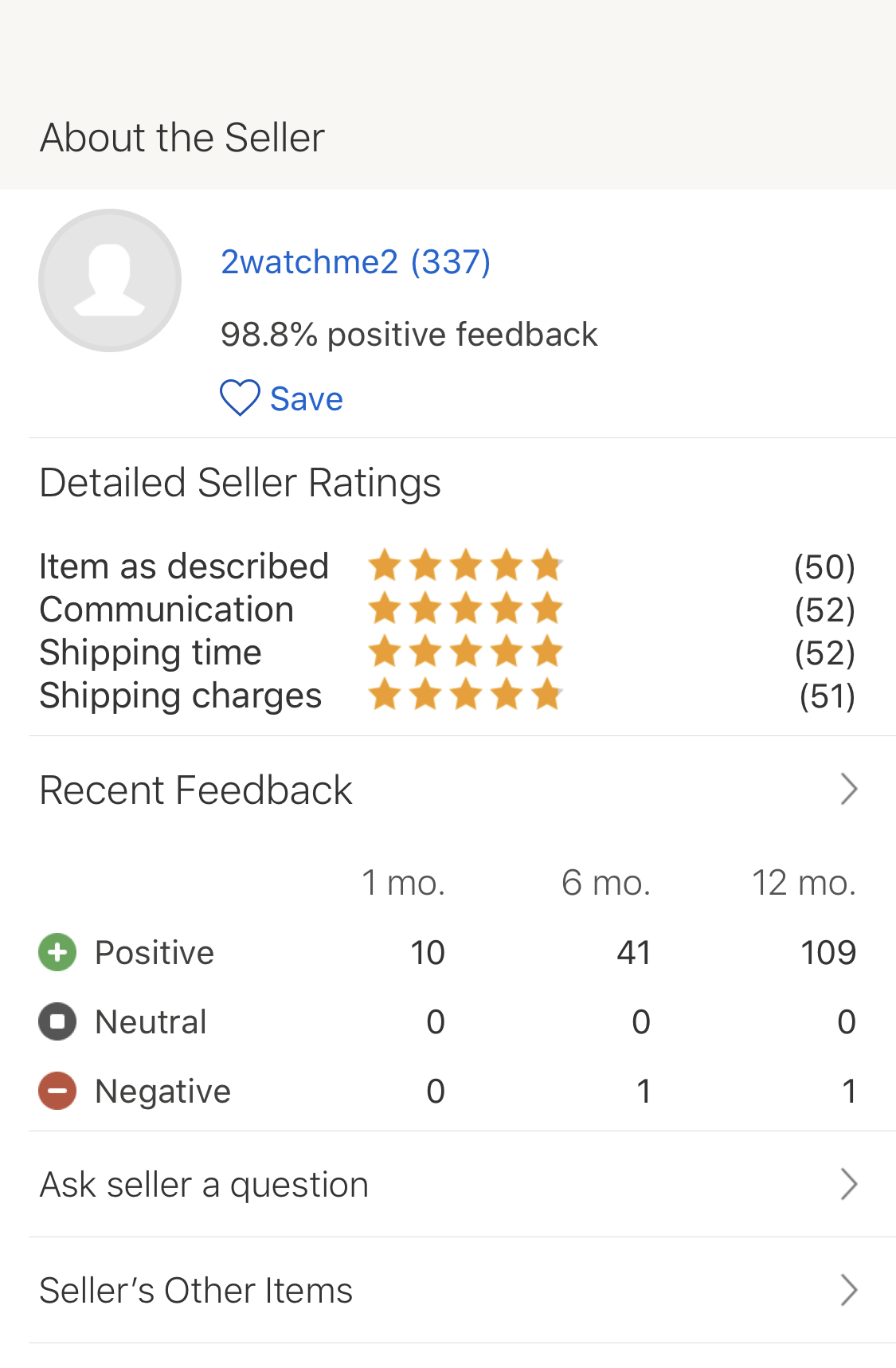

This guy only sells redials and frankens - rude and insists theyre legit 😜
230
600
Thank you both! I noticed that there were no "Swiss Made" examples in the super helpful Polerouter guide posted here, but was wondering if there were some small number of examples that had this text. It looks like the answer is no.

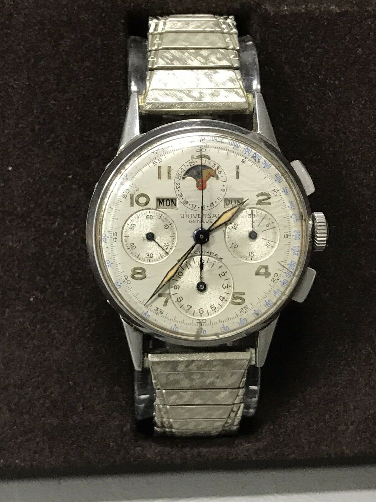

I don't think I saw any discussion about this 22536. There were some unusual things about it, but I didn't have time to really study....
https://www.ebay.com/itm/Universal-Geneve-Tri-Compax-22536-/153784948263?_trksid=p2047675.l2557&ssPageName=STRK:MEBIDX:IT&nma=true&si=0J0MGeWGOrWVV%2BxL2v3fajheKCQ%3D&orig_cvip=true&nordt=true&rt=nc
Service crown (NBD IMO) ... possible relume on hands, I believe someone attempted to clean the dial. Never ends well.
