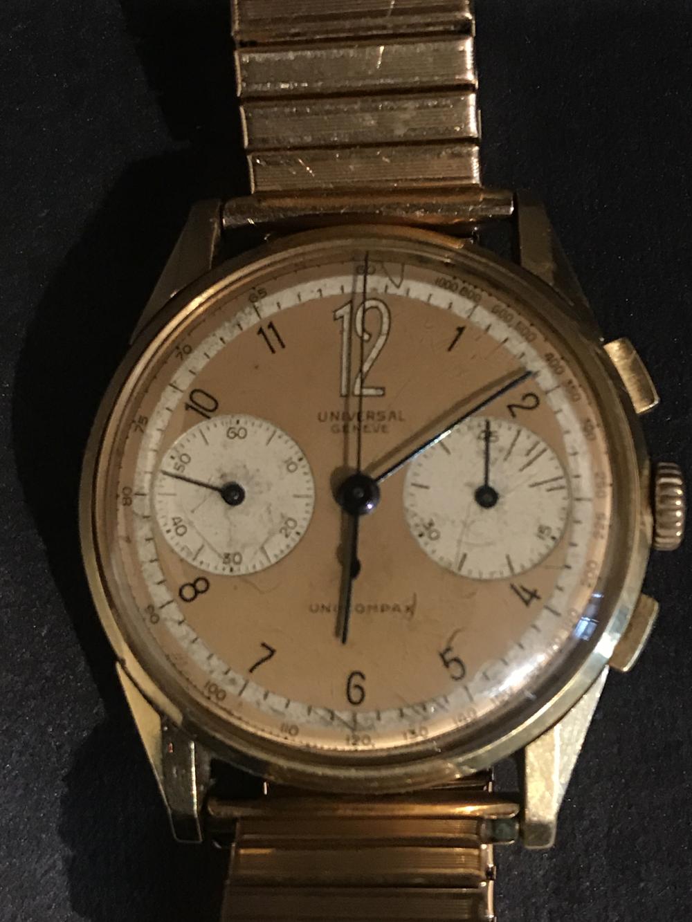

Sorry for being late to the party. I was abroad.
Is this a ref 124103 (number on caseback)?
As said above, I don't think the watch is good because the printing on the dial looks quite suspicious:
- UNI-Compax is not centered.
- Rounded 3s in the subdials
- Particularly the right dial seems to be a bit off centered.
- The font is too thick imho.
By the way, your link shows a different watch than your pics.
Not the watch i was commenting on.
I think ppl were commenting on the pics, not the link, which is, as you say............junk
Pics ppl commented on were the gold uni ... not the POS in the link.

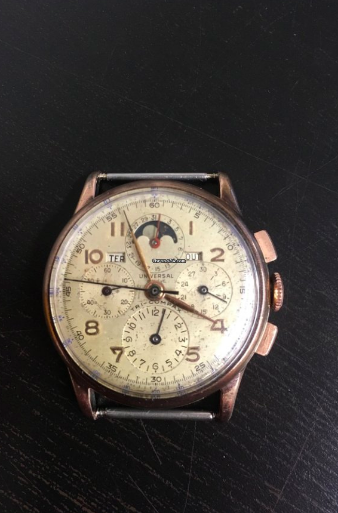

Chrono is a later replacement hand. H/M hands are mixed, Service Moon disc., plated case in good shape..Dial not great....
6
Morning Larry. Would you recommend on buying this watch? Is it a solid UG tri-compax?

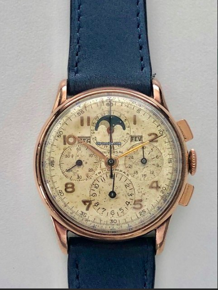

Guys, I think I’m buying the watch I posted above. Do you guys think it’s a good idea? I mean, if the watch is legit and original, would this turn out to be an awesome deal?
3,721
8,555
depends on what you mean by awesome deal I guess. it's a plated case, tired dial, some issues with the hands, etc etc
if you love it and it's really cheap..........?
So yea you can spend a grand or two on this watch. Then you can hang out here, learn more and have your buyers remorse grow and grow. I counsel patience ...
