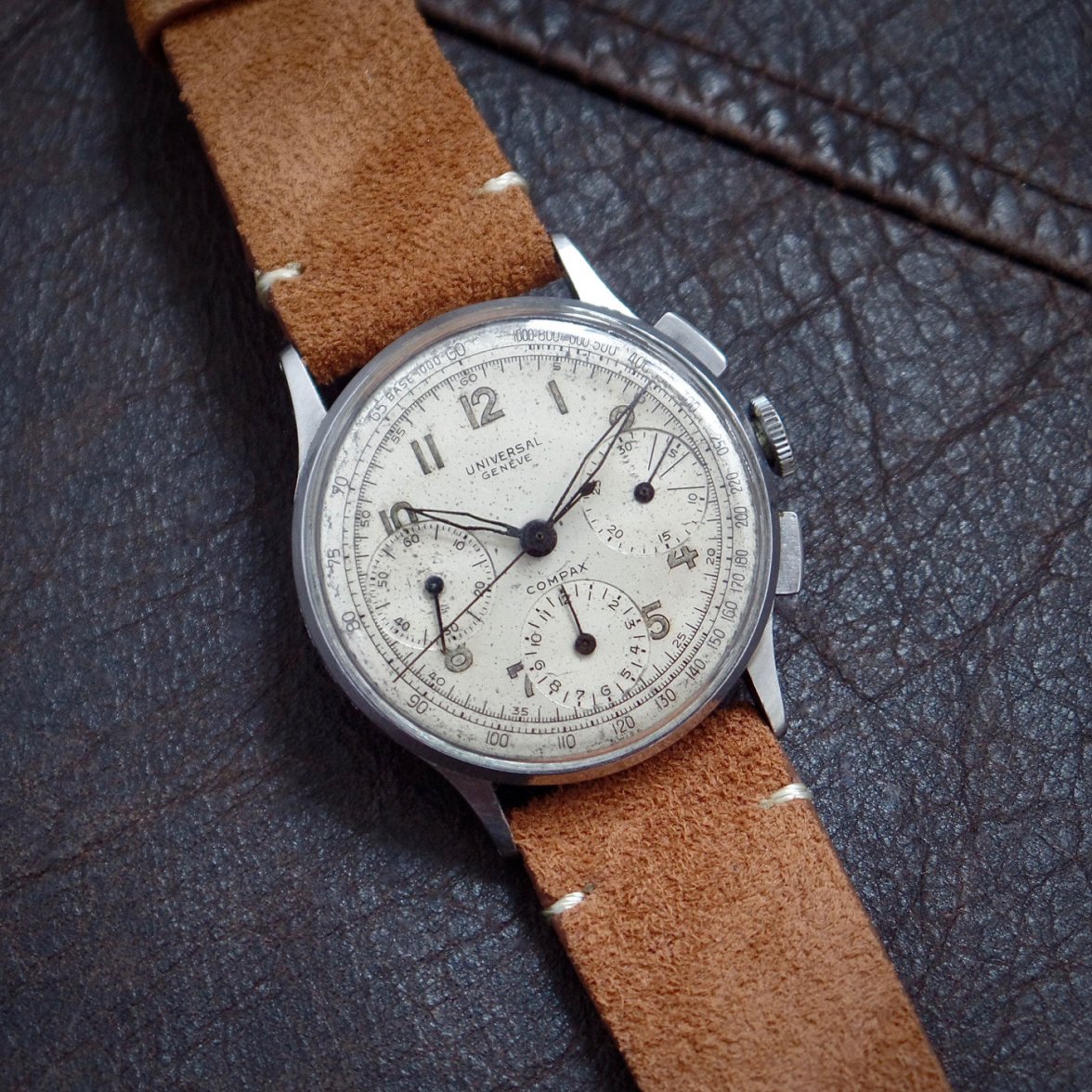

Hi All
Can you please give me your opinion on this Compax.
Seems correct to me but I am not sure tf the hour and minute hands are from this dial.
http://www.ebay.co.uk/itm/162575337856
Thanks

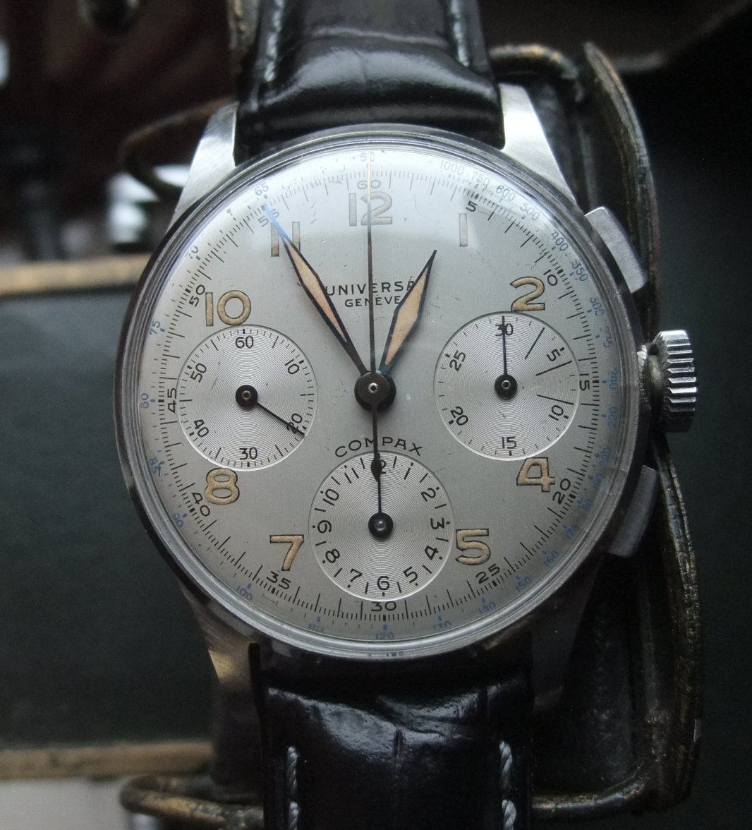

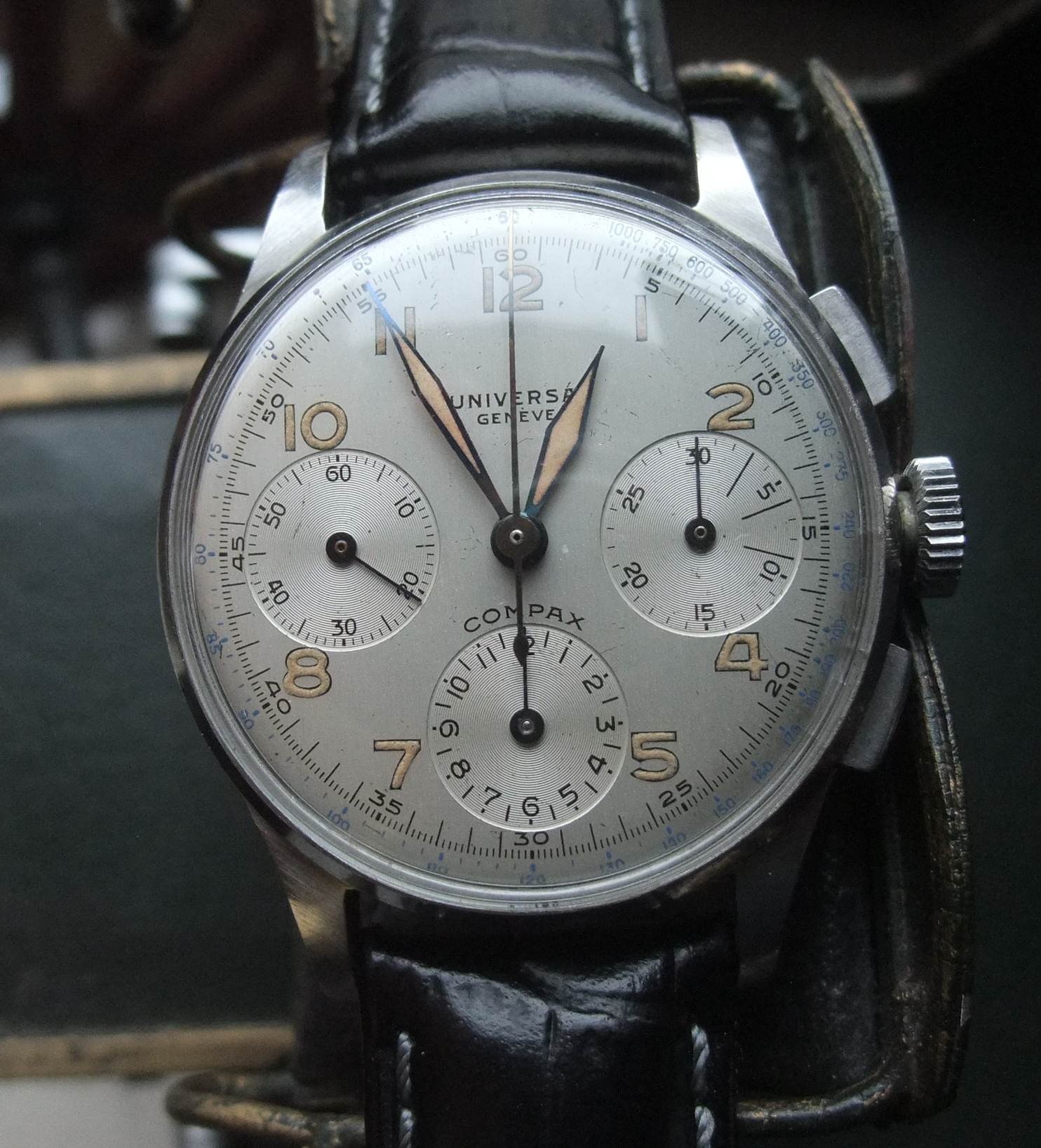

Hands have lost their lume but are original. My watch for comparison:
By the way, ebay seller is a member here.

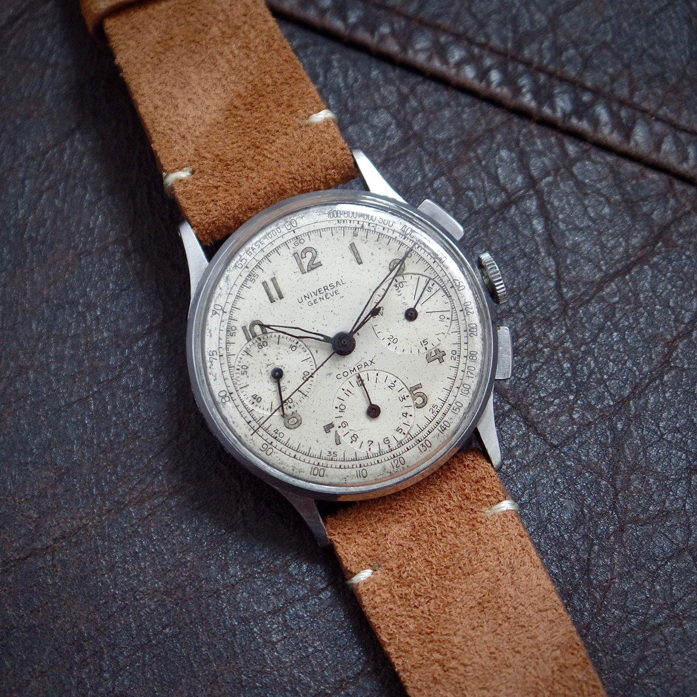

Hi All
Thanks
I don't believe that the hour and minute hands belong to this watch, they have the wrong length. I even doubt that they are UG originals
The seconds subdial hand is wrong too...
Good point, did not notice the length.

Guilty!
Probably needs a lot of work but I will take the risk.
Dial seems very good

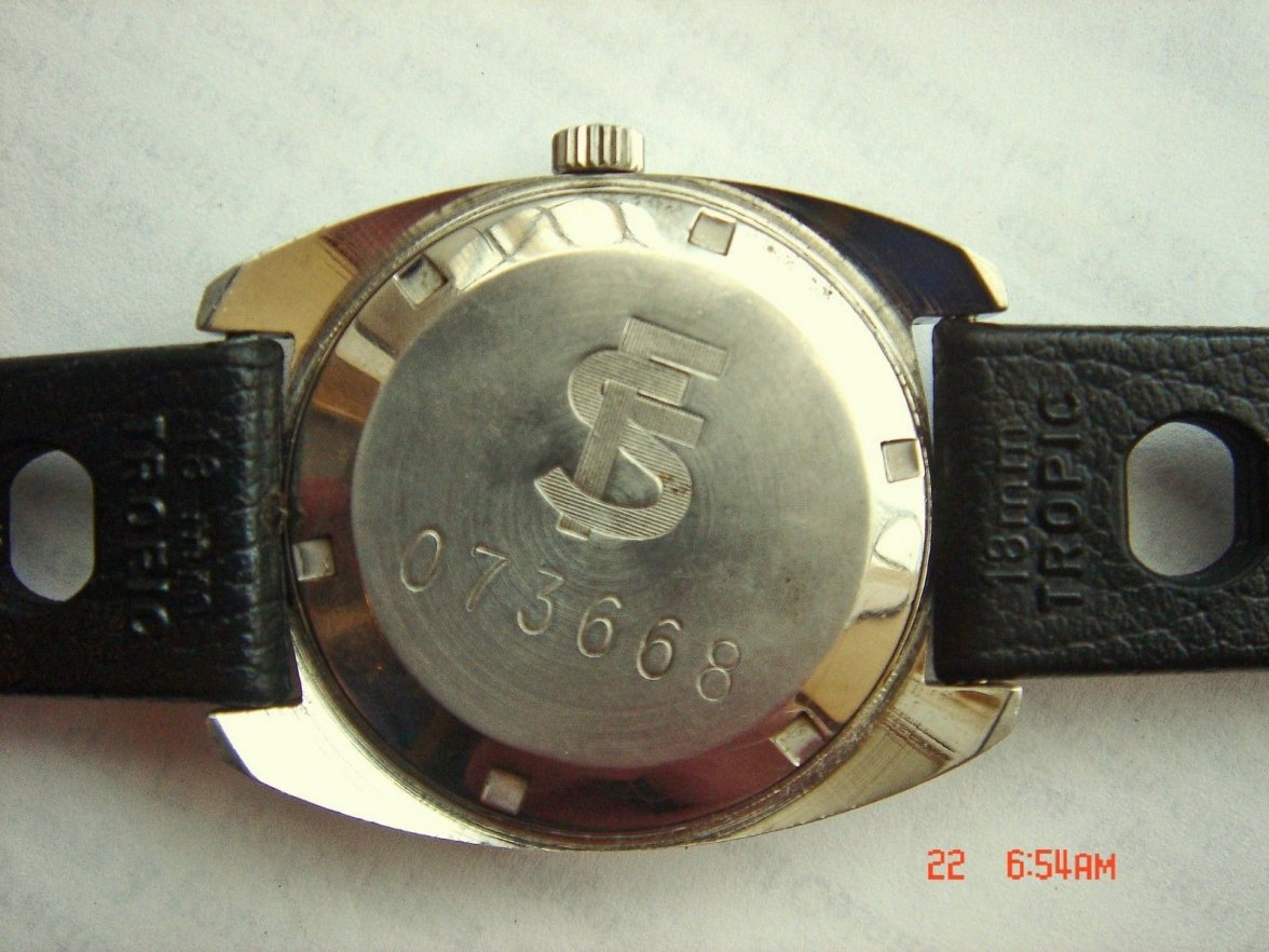

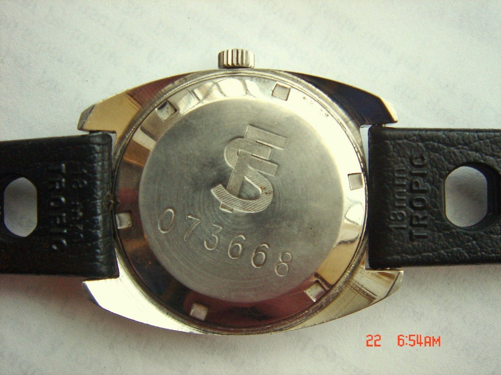

It is not a military watch. FS stands for "Ferrovie Stato" which means state railways. They are nice and relatively cheap going between Euro 150 and 300 depending on condition.
Yes, any UG aficianado knows that.
Hence my "Oops!" comment.
Bleedin' obvious to us but not to that dealer.
