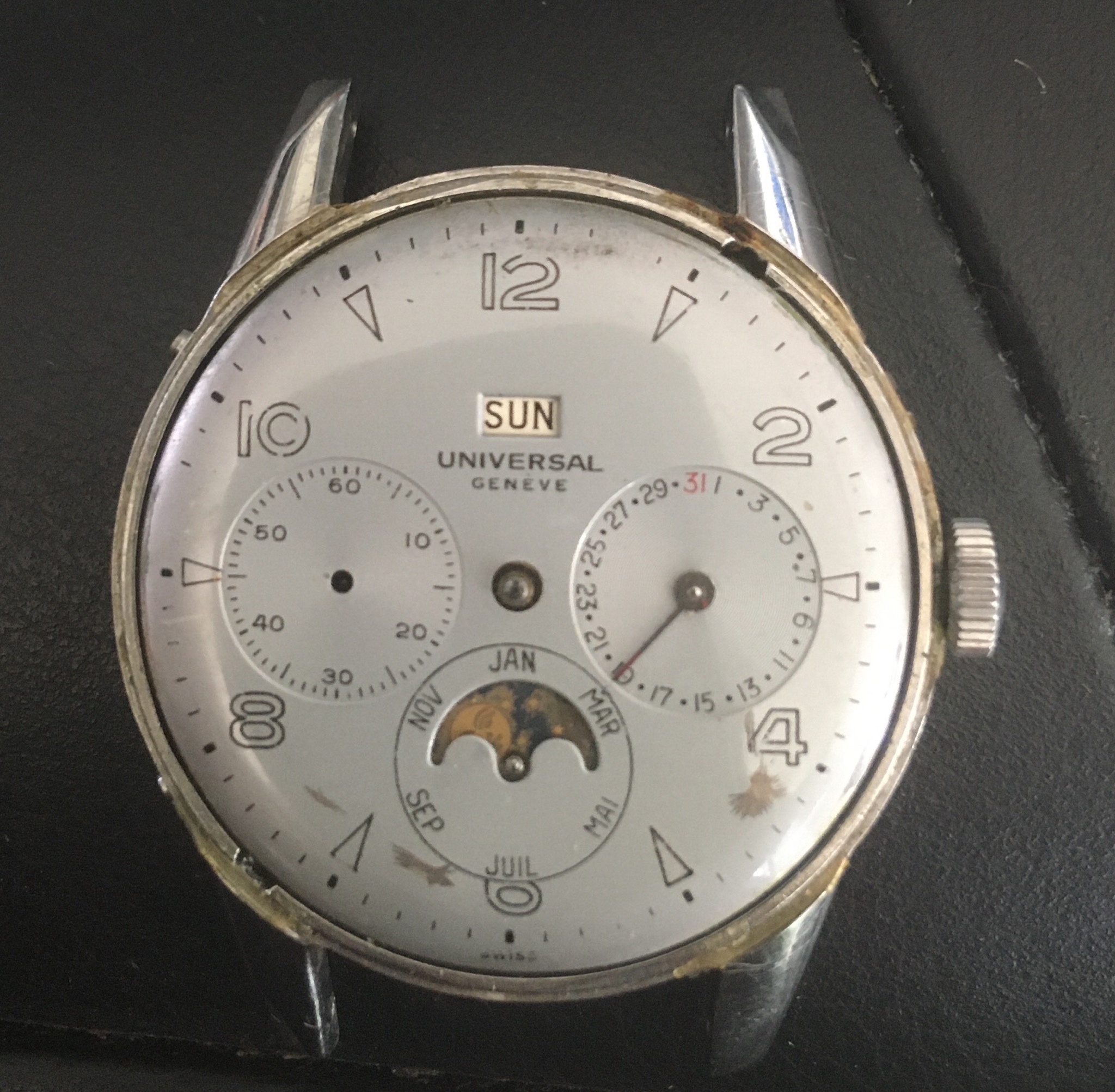

Universal Geneve triple date moon phase help

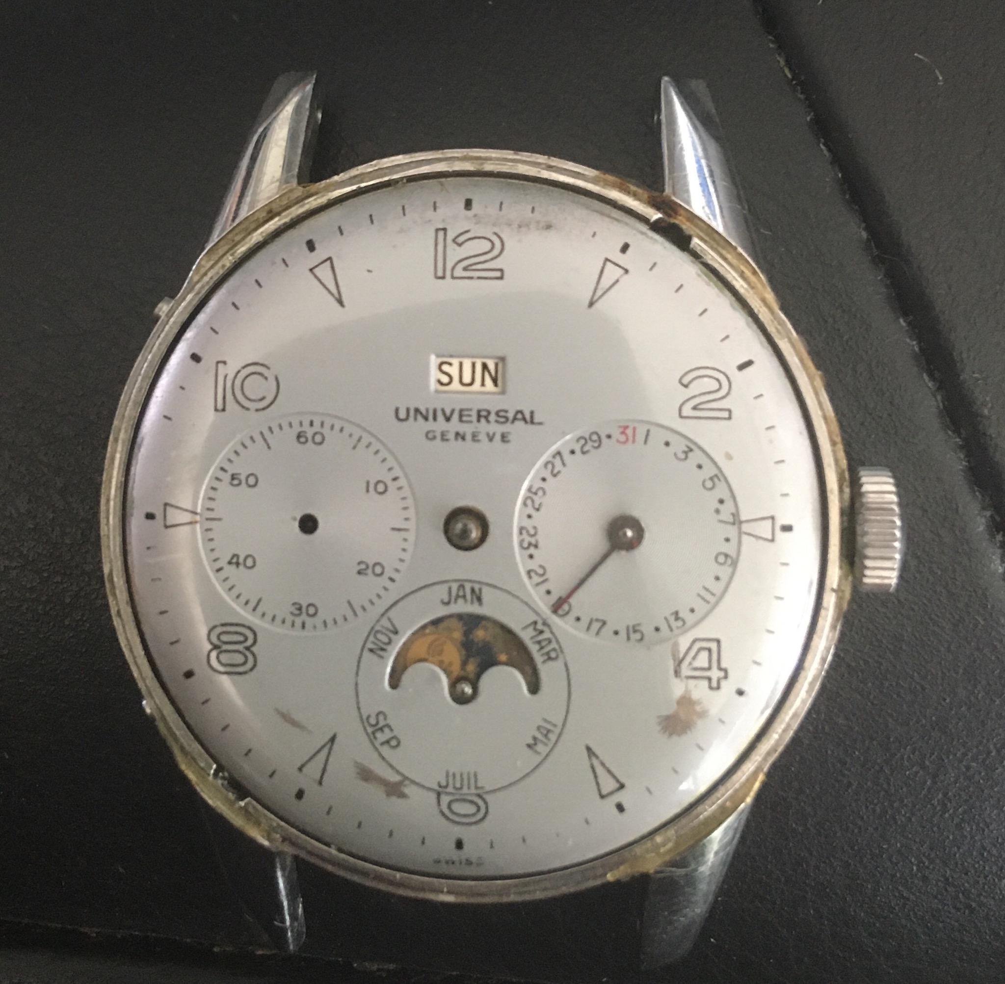

I looked at the listing and the printing looks quite bad.

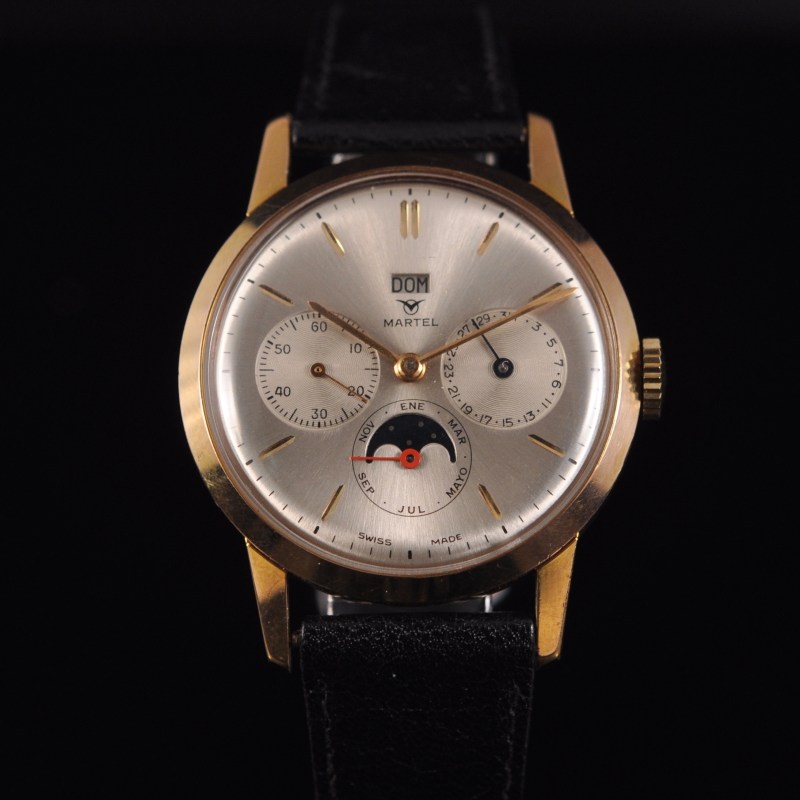

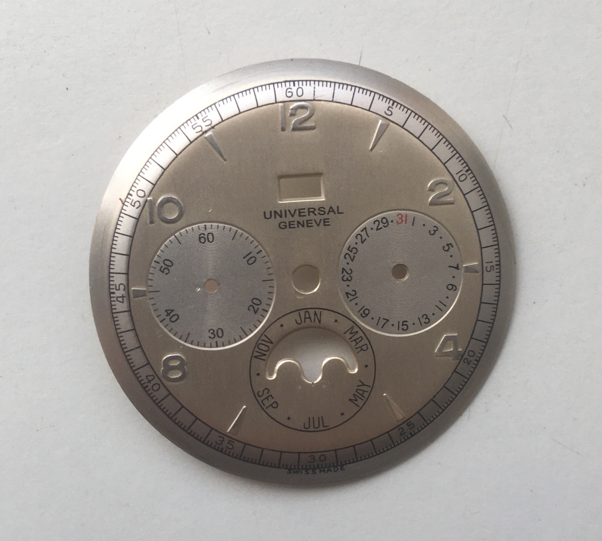

This looks like one of the triple date watches sold under the Martel/Mervos brand. Probably this is what the watch looked like originally:
(picture source: https://www.romainrea.com/montres-d...geneve-martel-triple-quantieme-phase-de-lune/)
Seems like someone took such a watch and put the Universal branding on it to get a better price. Other examples like this have been
discussed here:
https://omegaforums.net/threads/ano...triple-date-with-moonphase.10994/#post-128289
and here:
https://omegaforums.net/threads/help-me-identify-ug-calibre-291.11408/
discussed here:
and here:
Exactly! You can see these Martel branded (and I think other brands as well maybe) mid sized 35mm gold plated examples around. I think the Martel branded options, if completely original, are not a bad cheaper option. However in the OP example it's not even the original (non UG) dial any longer, it's just junk.

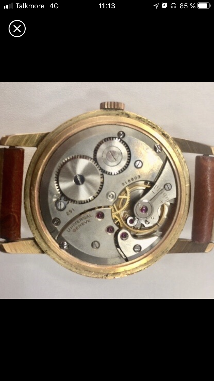

I assume you will not find any UG stamping on the case, and I would also assume you will not find any UG marking on the mvmt, although presumably it's a cal 291 or similar.
OP watch also has wrong running seconds hand, too short.

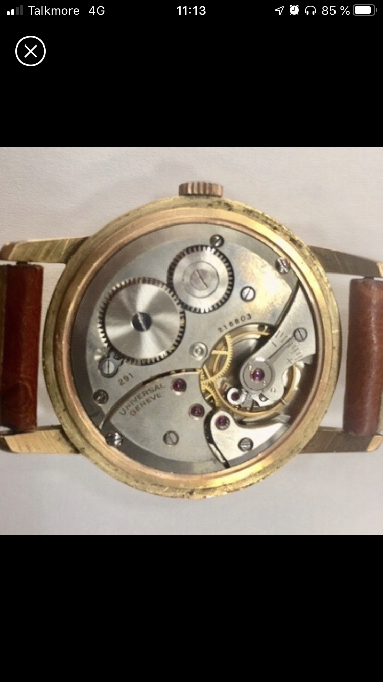

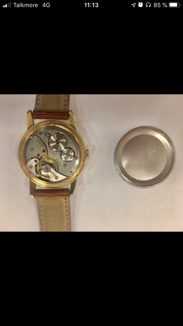

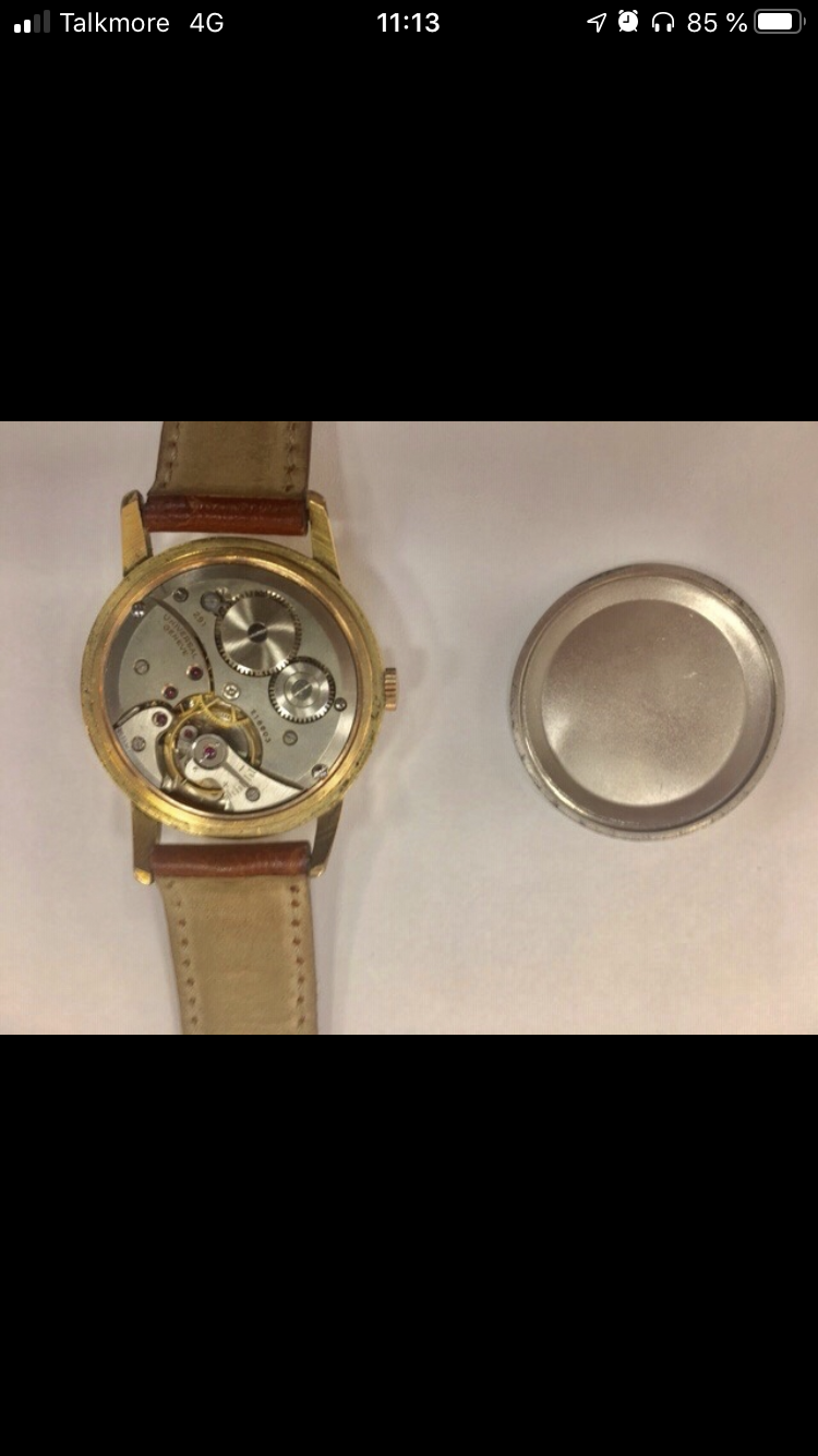

Thank you for all of this, would images of inside the case determine if it is a UG or not?
1,441
3,809
Inside caseback would help with the detective work
3,721
8,557
So it’s a UG mvmt but not UG case and the dial is no good plus some other stuff, it has no value other than for mvmt, forget about this one and move on.....

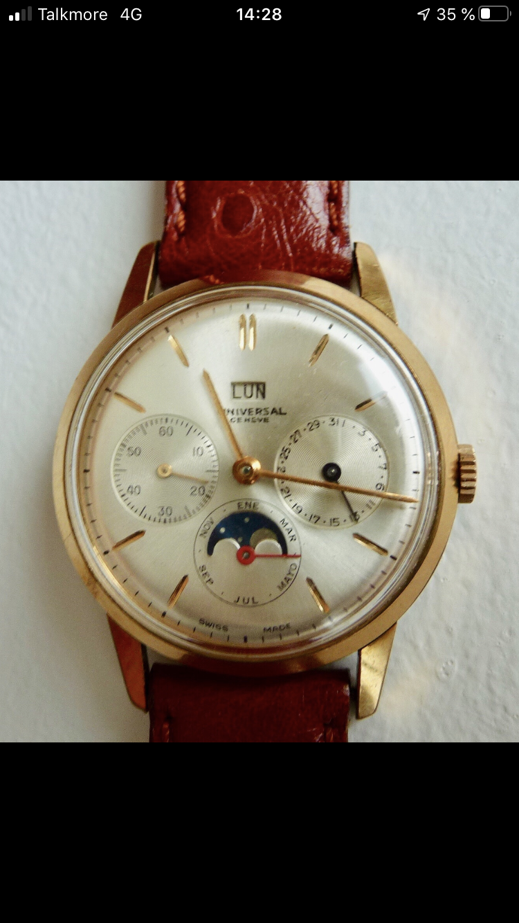

What’s the verdict on non-Swiss dials on triple dates? Obvious redial or anomaly?
As a general rule I would expect Swiss, however I have not done a comprehensive study to understand if variations are possible. Perhaps best to consider specific examples?

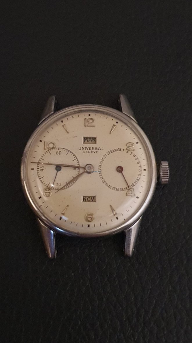

Thanks, that would be my first thought as well. I'm specifically talking about the example below, a 21301, which seems to be missing the SWISS but would it be possible it's located out of sight below the bezel?
121
476
Thanks, anything obvious apart from the Swiss missing? Picture is quite low-res.
