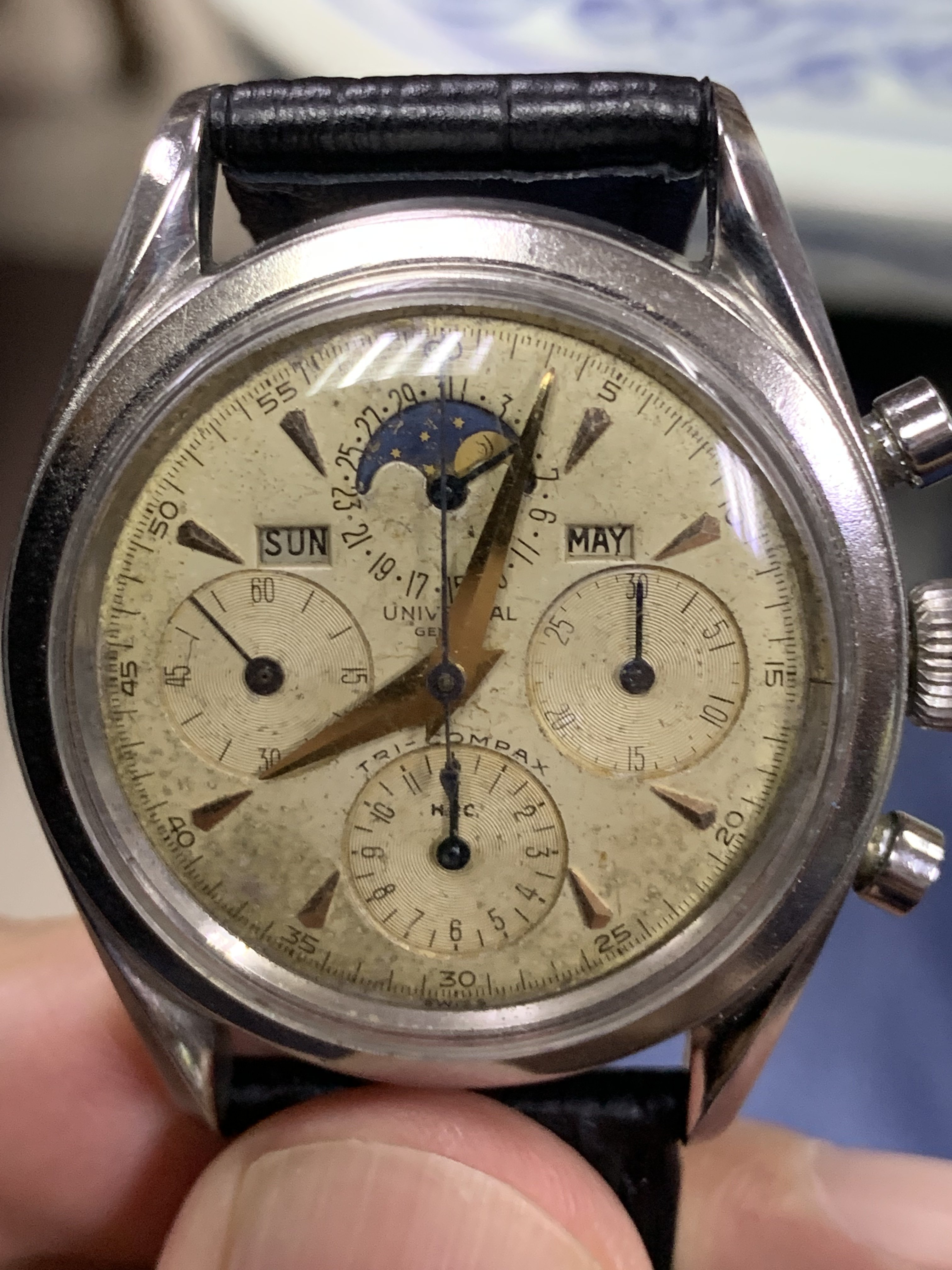

Universal Geneve Tri-Compax H.P.C
12
The differences of the small hands is to match the printing of the sub dials (I was told )
12
Just noticed the emoji added to the statement above isn’t there.
Don’t shake your head too much, I don’t believe it neither. Would make it a 1 of 1
13,999
54,301

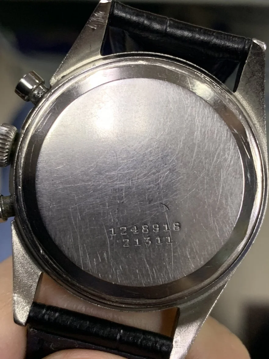

Well ... It is not a 22297 1 ...Guess that was a red herring so to speak. The serial would fit the moon disc but the closed 6 makes this a later dial. No question that its a UG dial however. Since UG did not start using logo on their crowns till 50's, the crown is later as well. The bigger issue is that the reference 21311 is for an SS calendar watch .. page 416 in Sala. Can you get a shot of the inside case back?
12
Thanks.
I missed the inside case back shot, I’m quite sure it was blank.
Still don’t know what to do… can feel a kind of attraction. How much of it… well, translates into $
3,717
8,552
the second number in the case reference is 1 for time only and 2 for chronograph, so this is a major problem. You should never see a Tri compax that is X1XXX
it would help to see inside case back to see if this is even a UG case?
anyhow, very strange

Ah but another UG mystery to amuse …..

Dial is authentic
Case looks like a 222100 one
Movement is a 283 with data and moon complications
Caseback looks fake to me
Overall, a franken with a fake caseback
