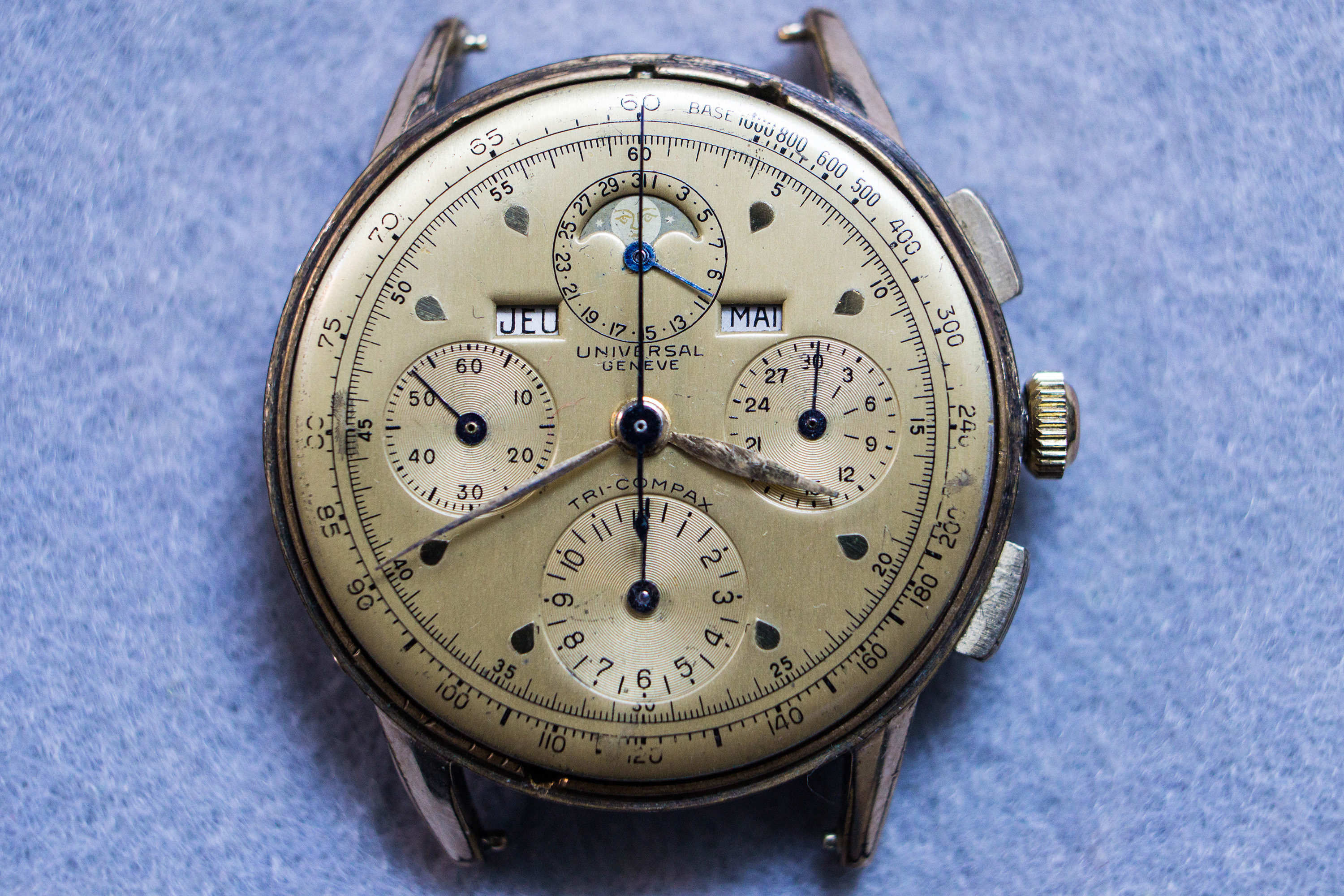

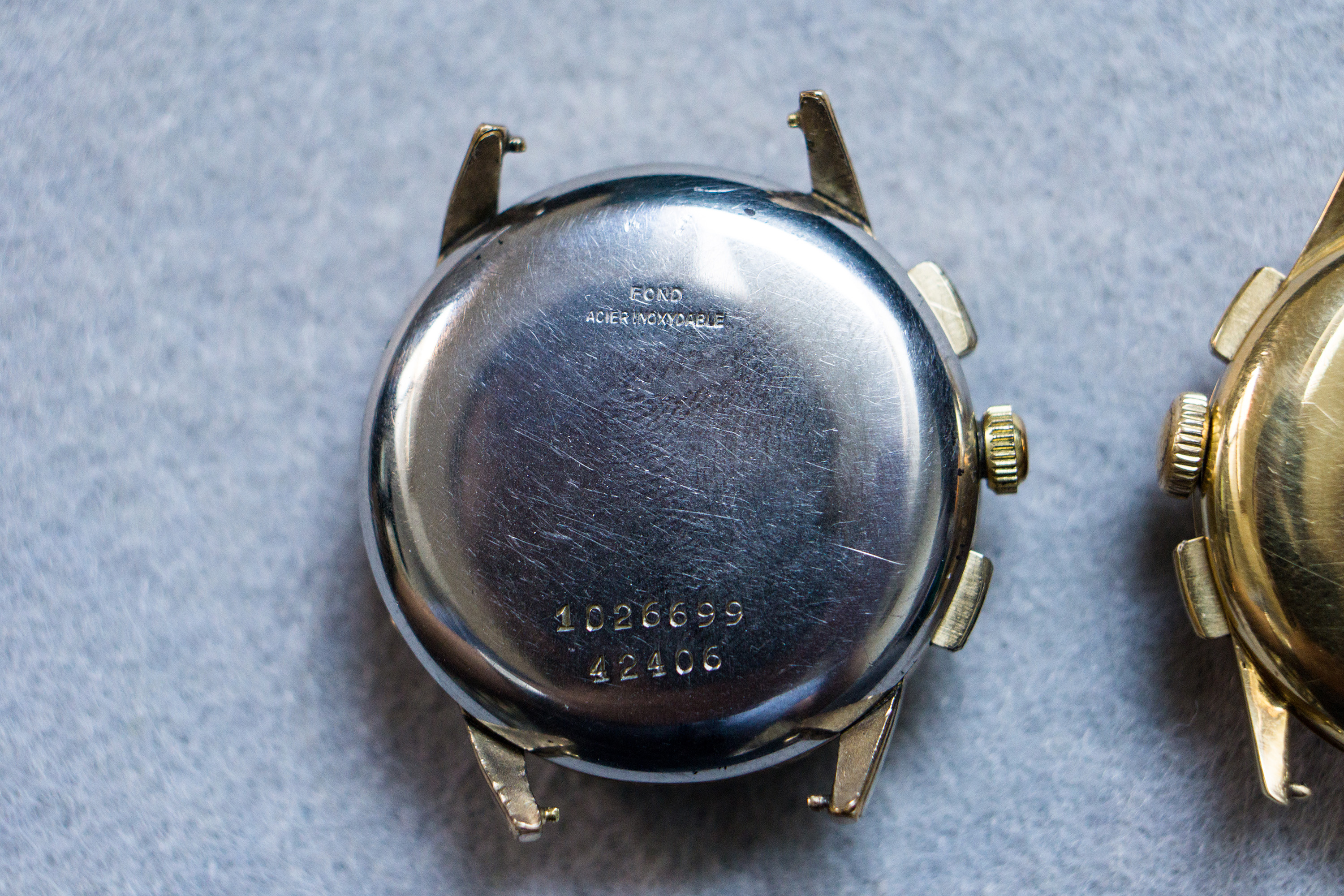

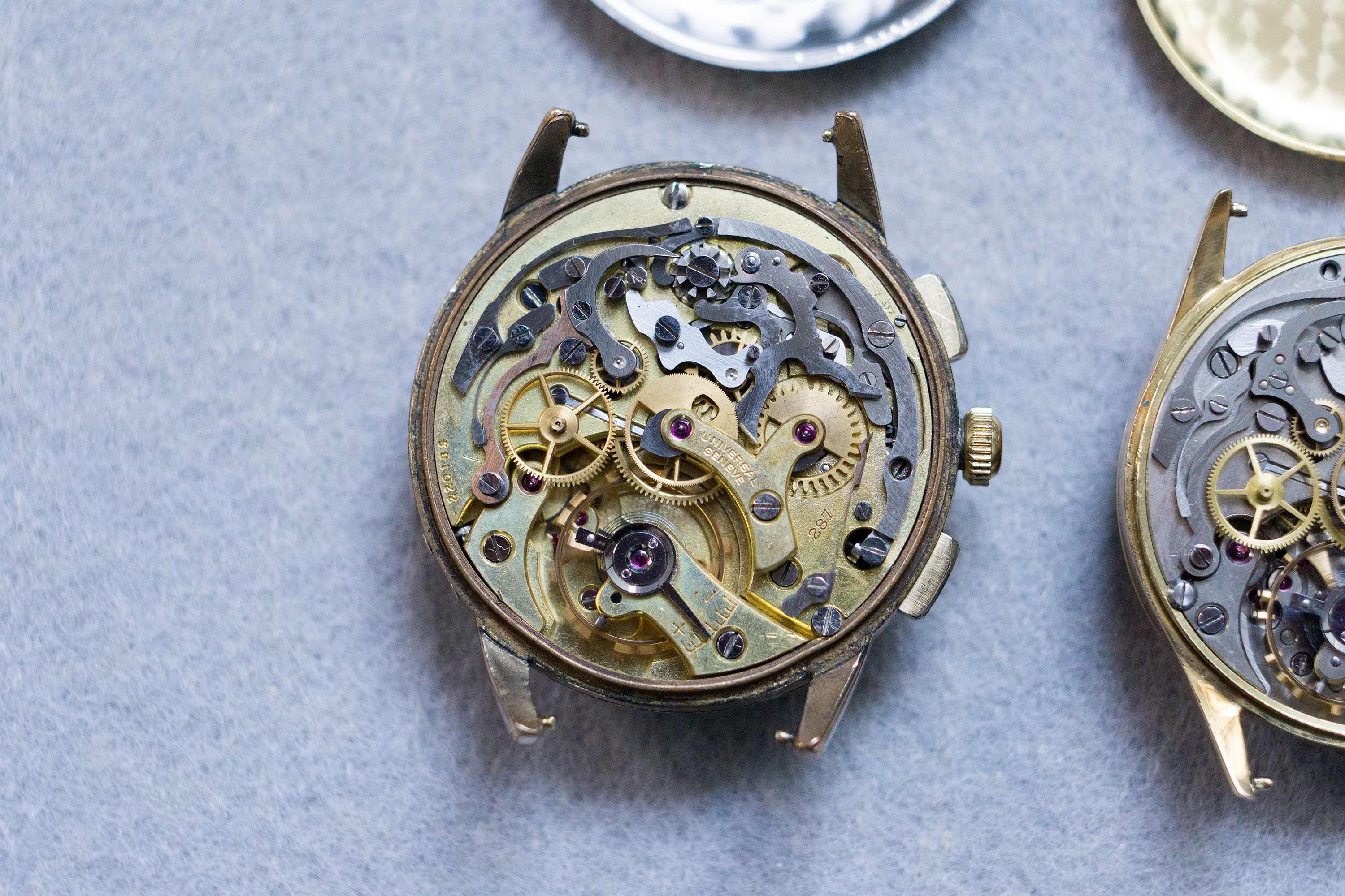

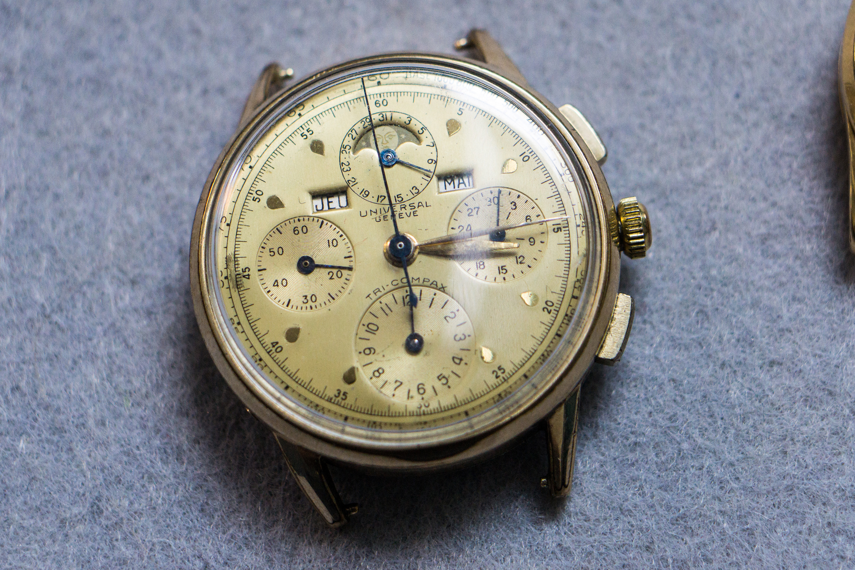

Hey guys,

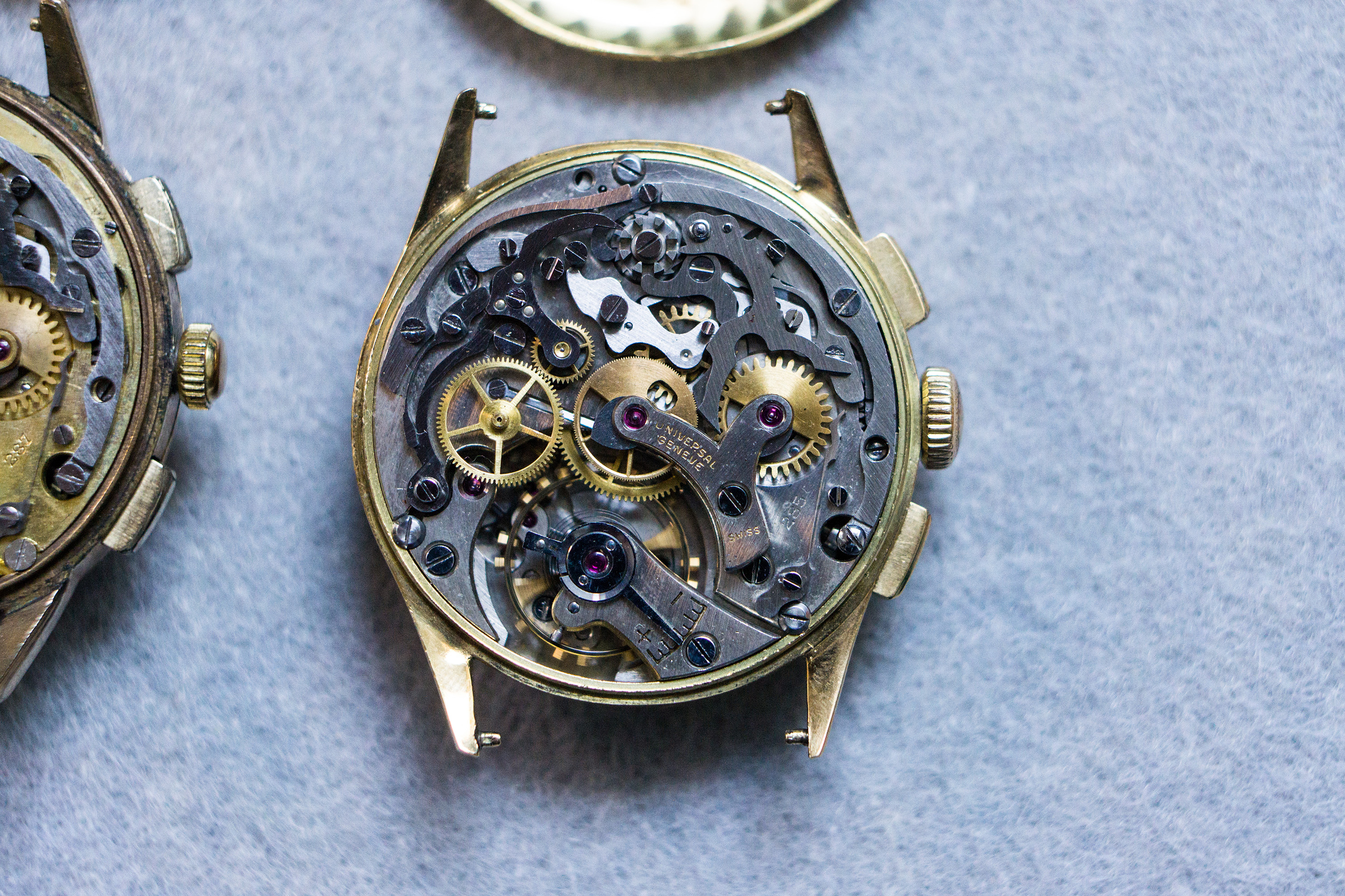

having the feeling that my Omega and Enicar knowledge is good enough, I am a total noob in regard to UG. I had the opportunity to get some watches cheap out of an estate and those two were among them.

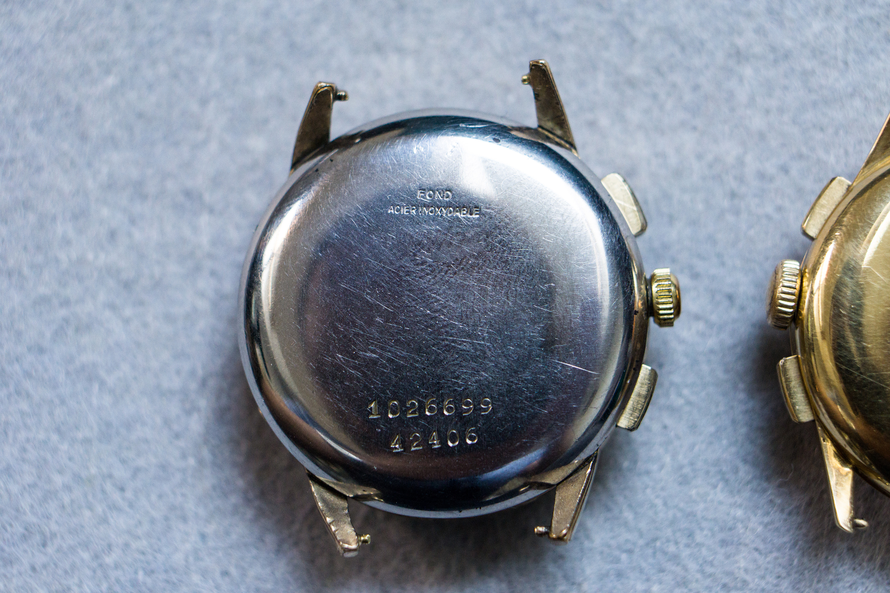

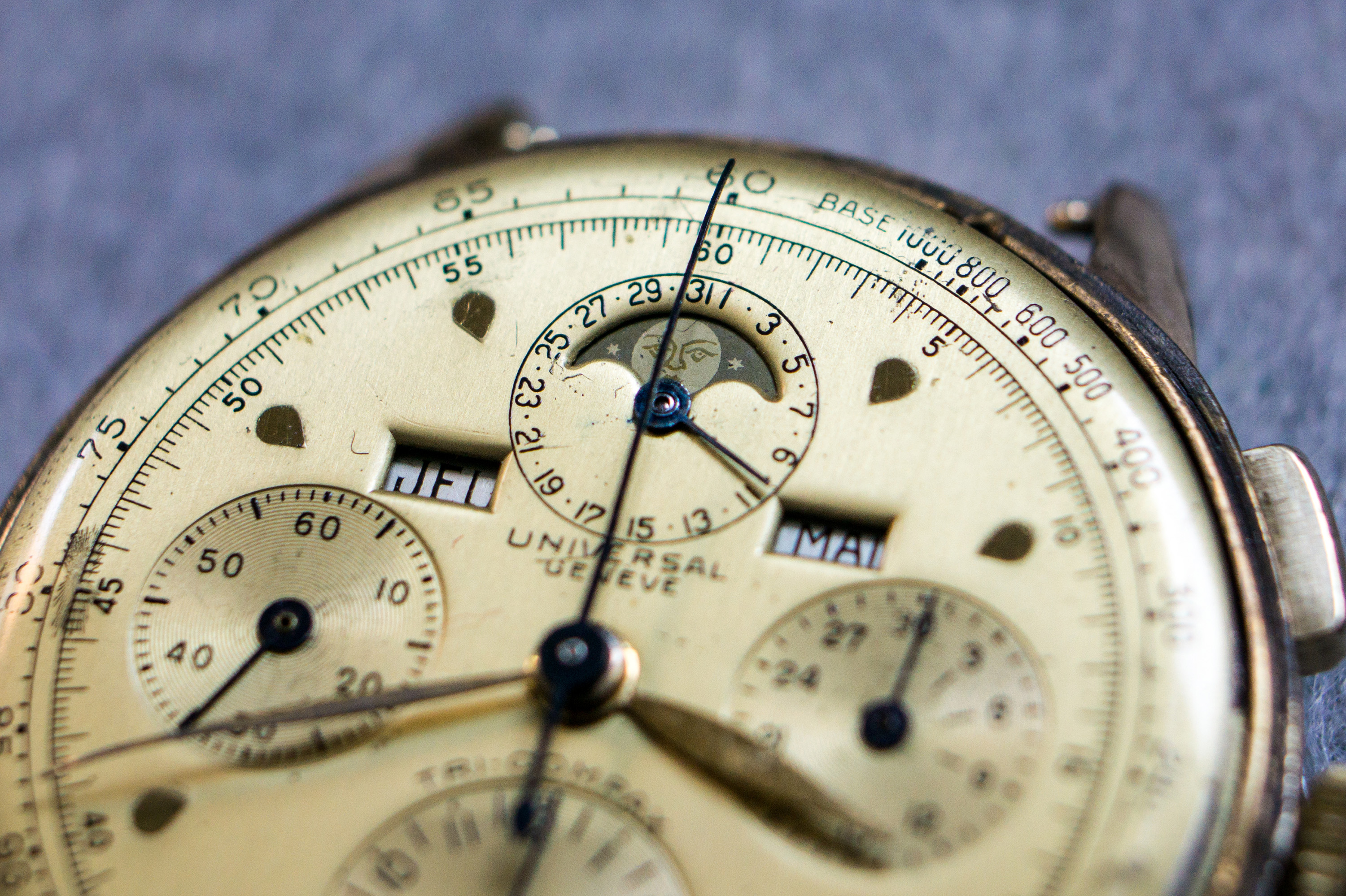

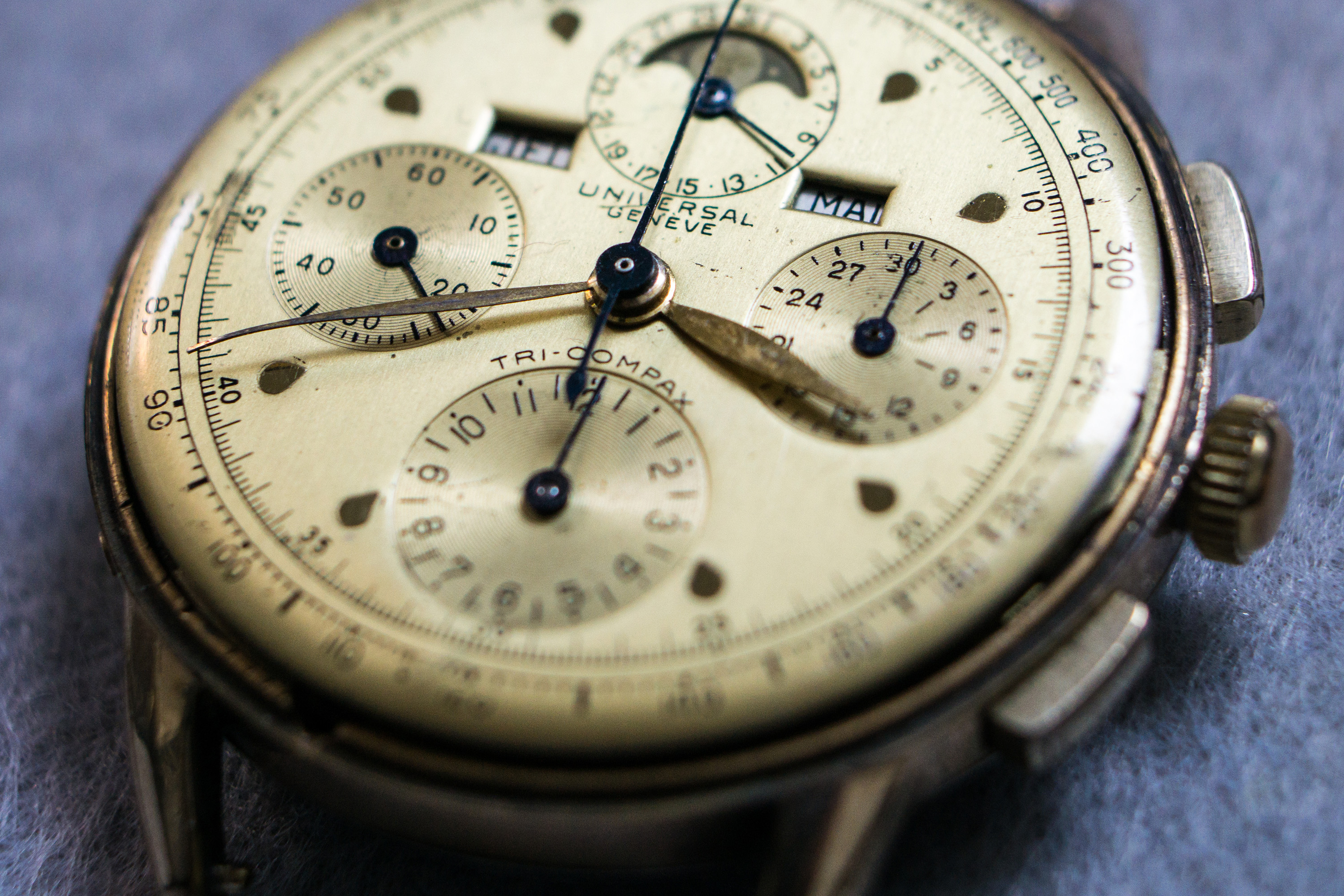

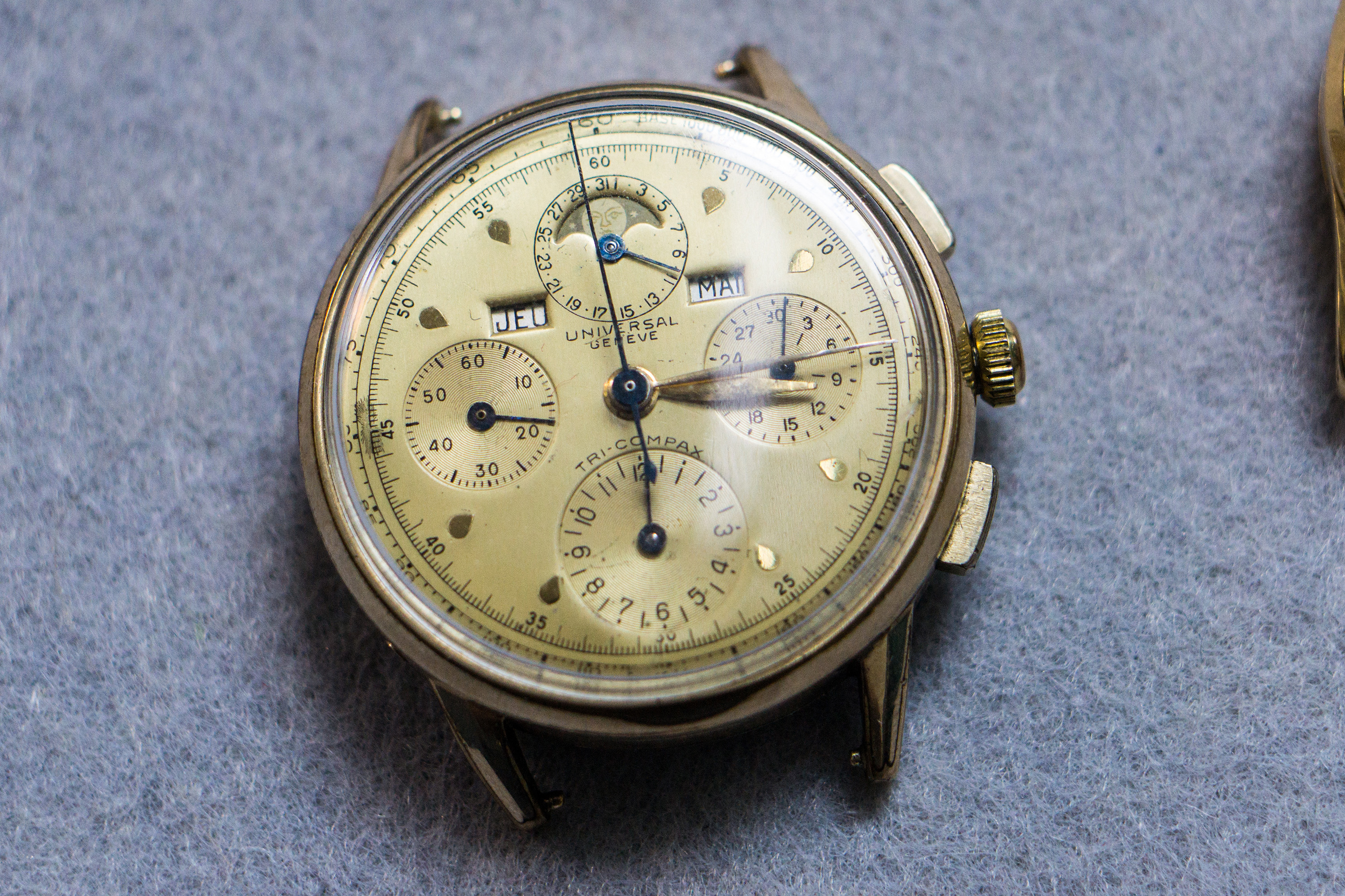

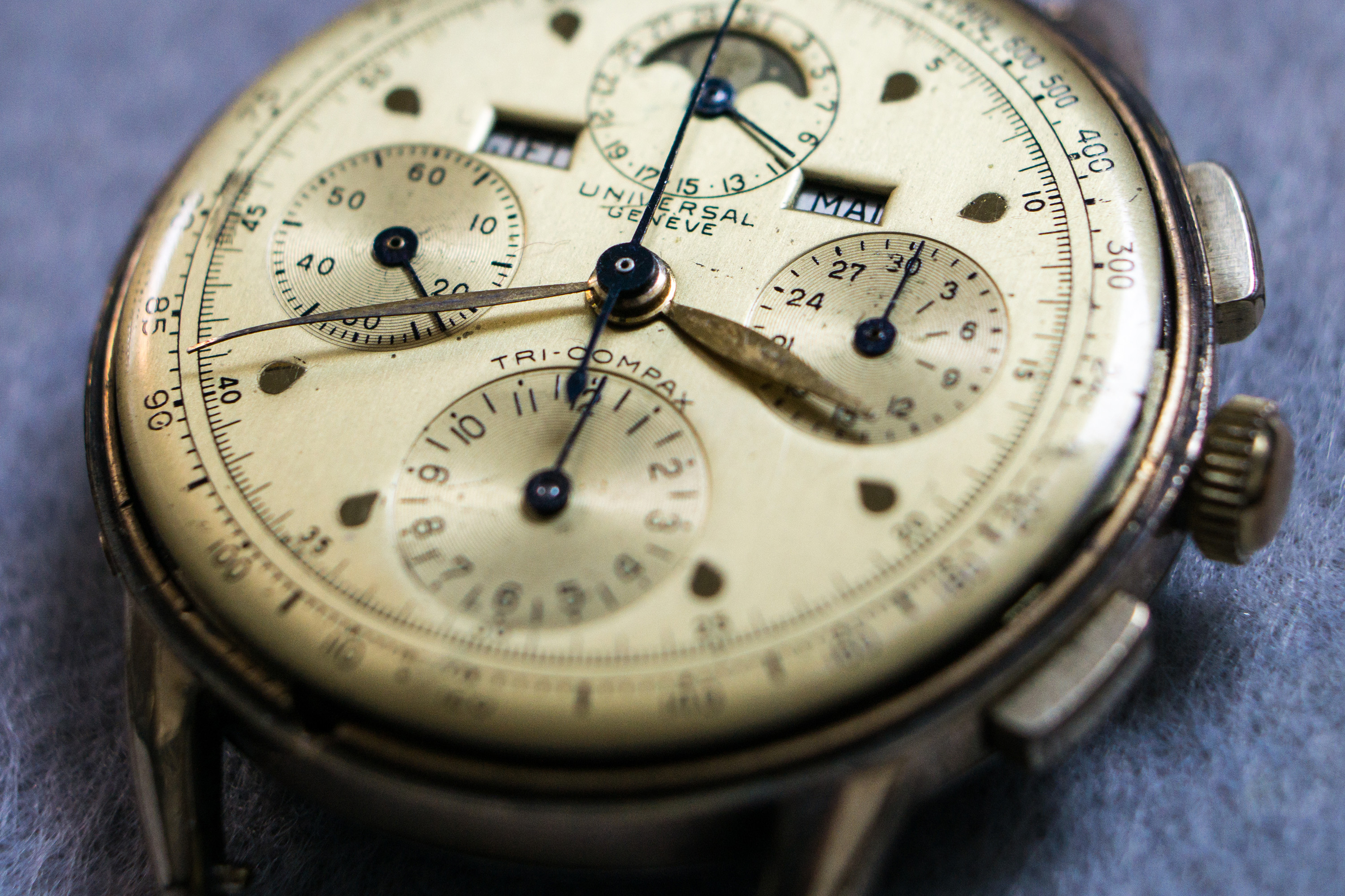

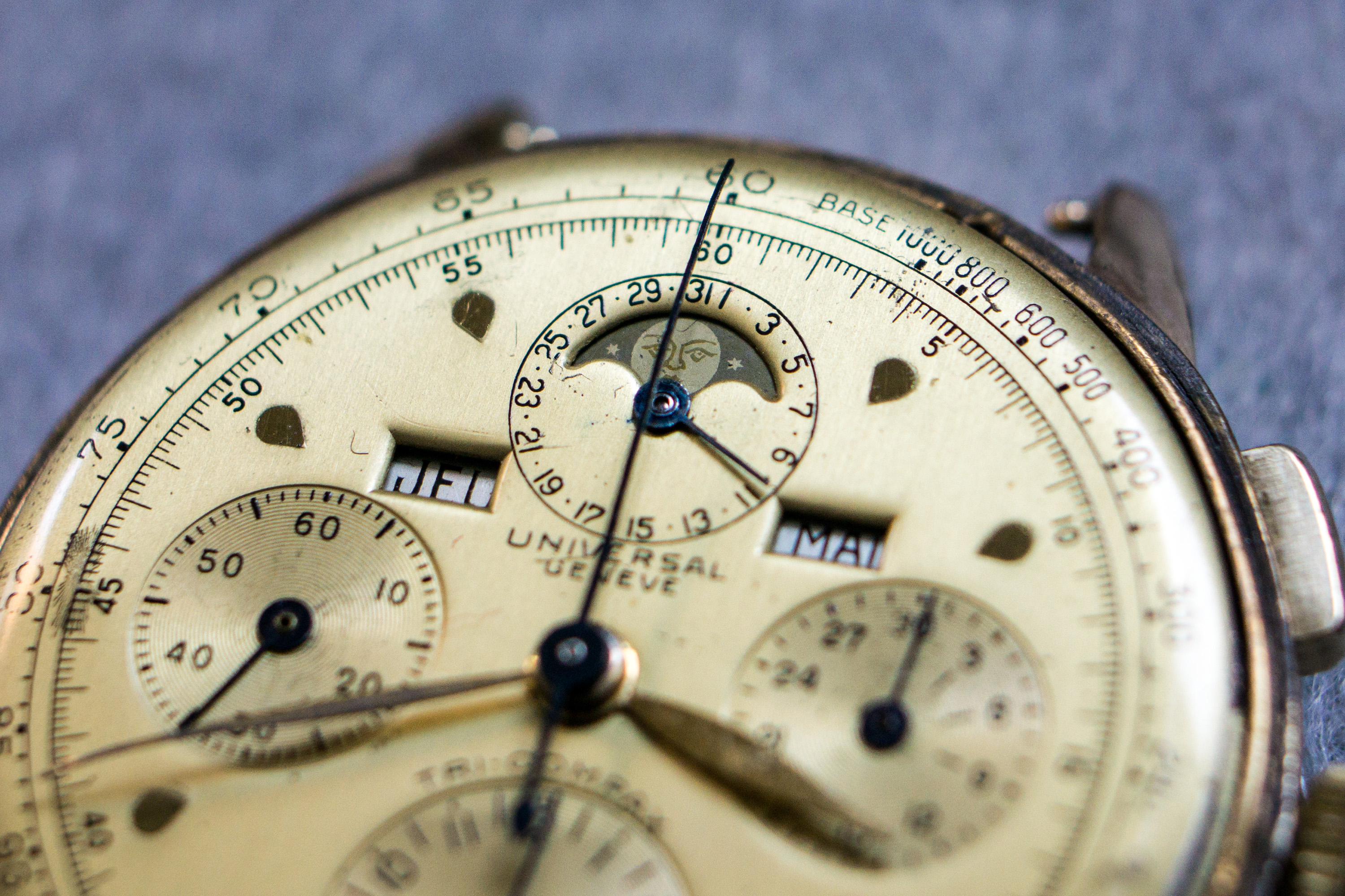

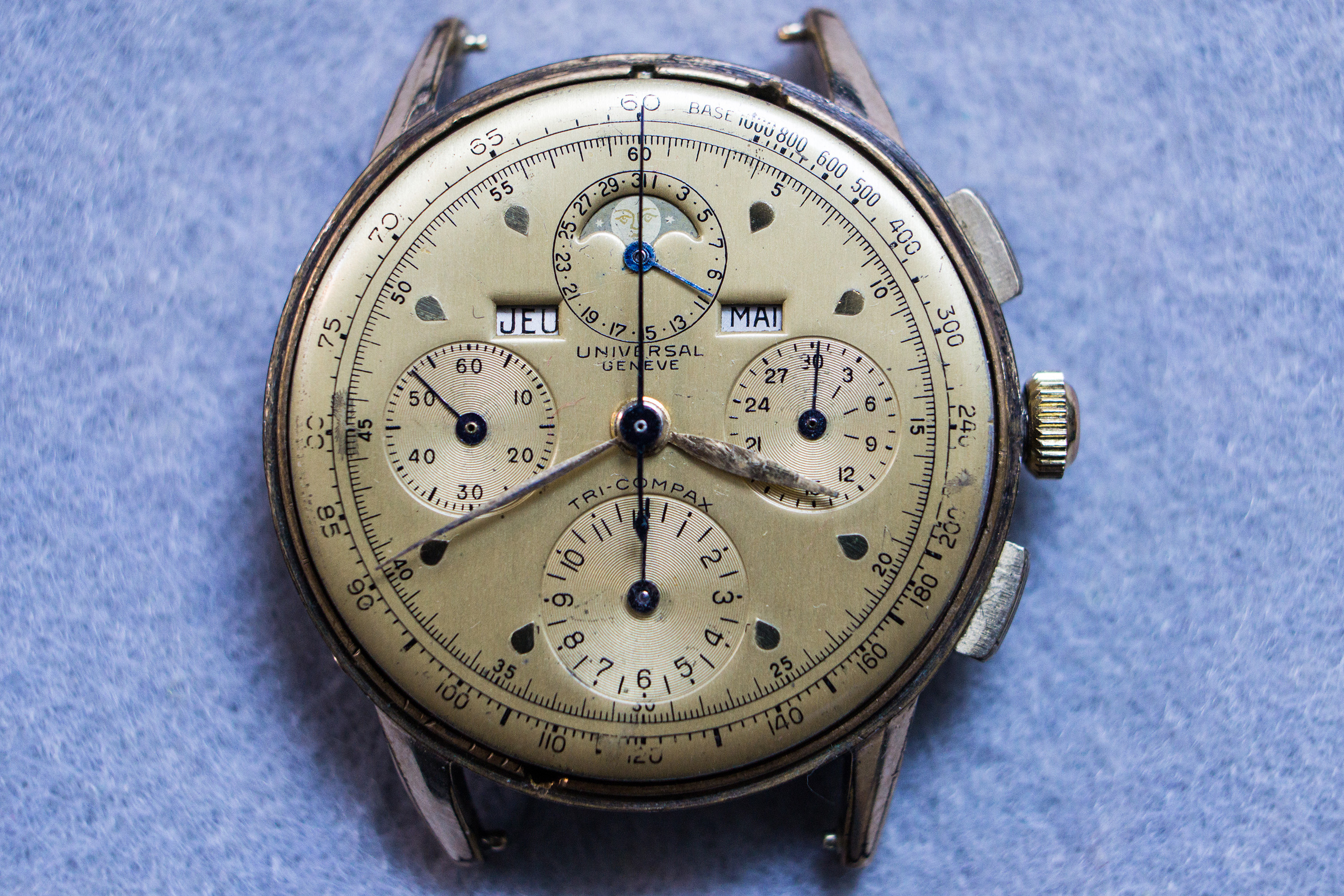

First is a UG Tri-Compax Ref. 42406, SN 1.026.699. The watch has a nice size with 36,5mm and a UG Cal.287, but when I showed the watch to a friend, he was suspicous about the dial. Missing the "Swiss" at 6 for example and the weired markers. Although there are some things typical UG, like the 31 to 1 looking like a 311 at the date window at 12 o'clock. Maybe you have an idea what this kind of dial is, any help appreciated.

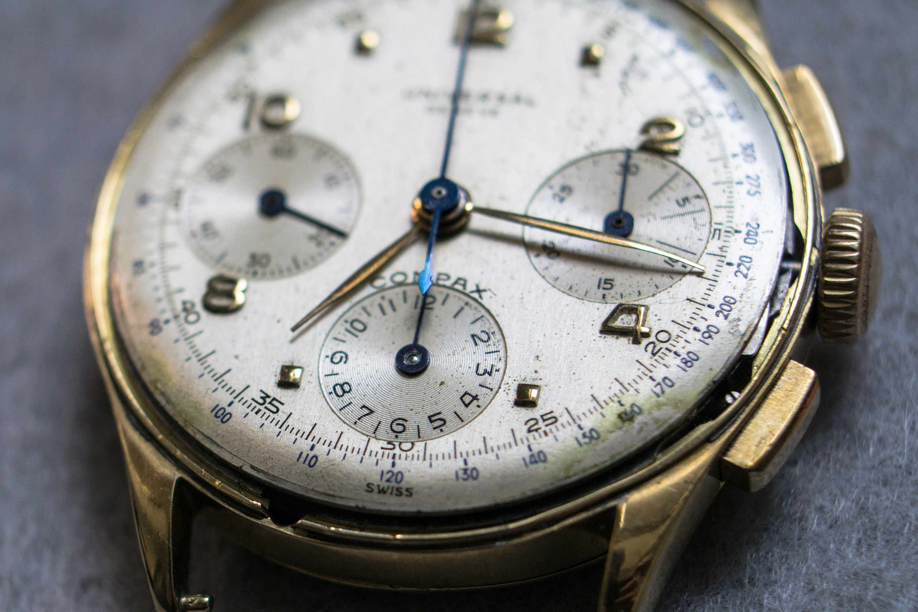

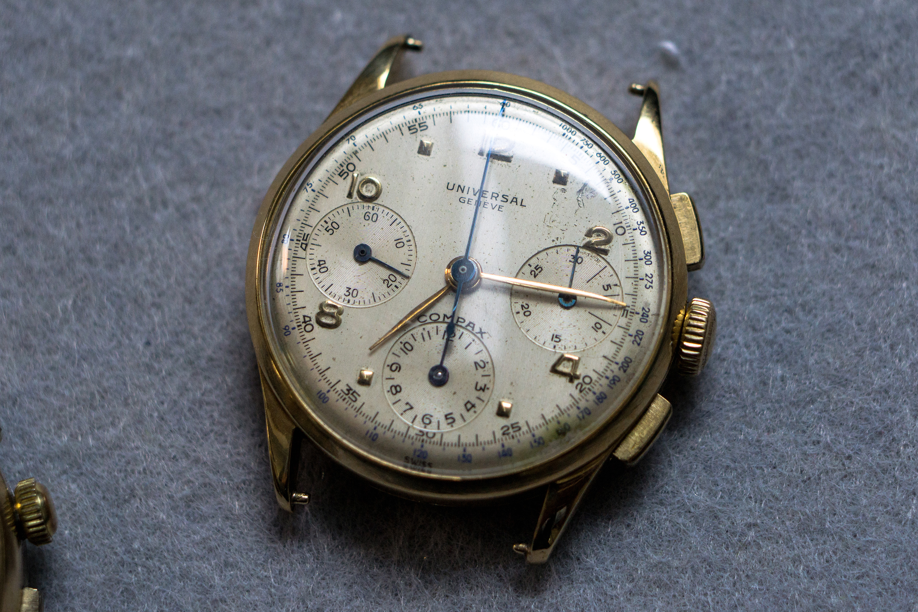

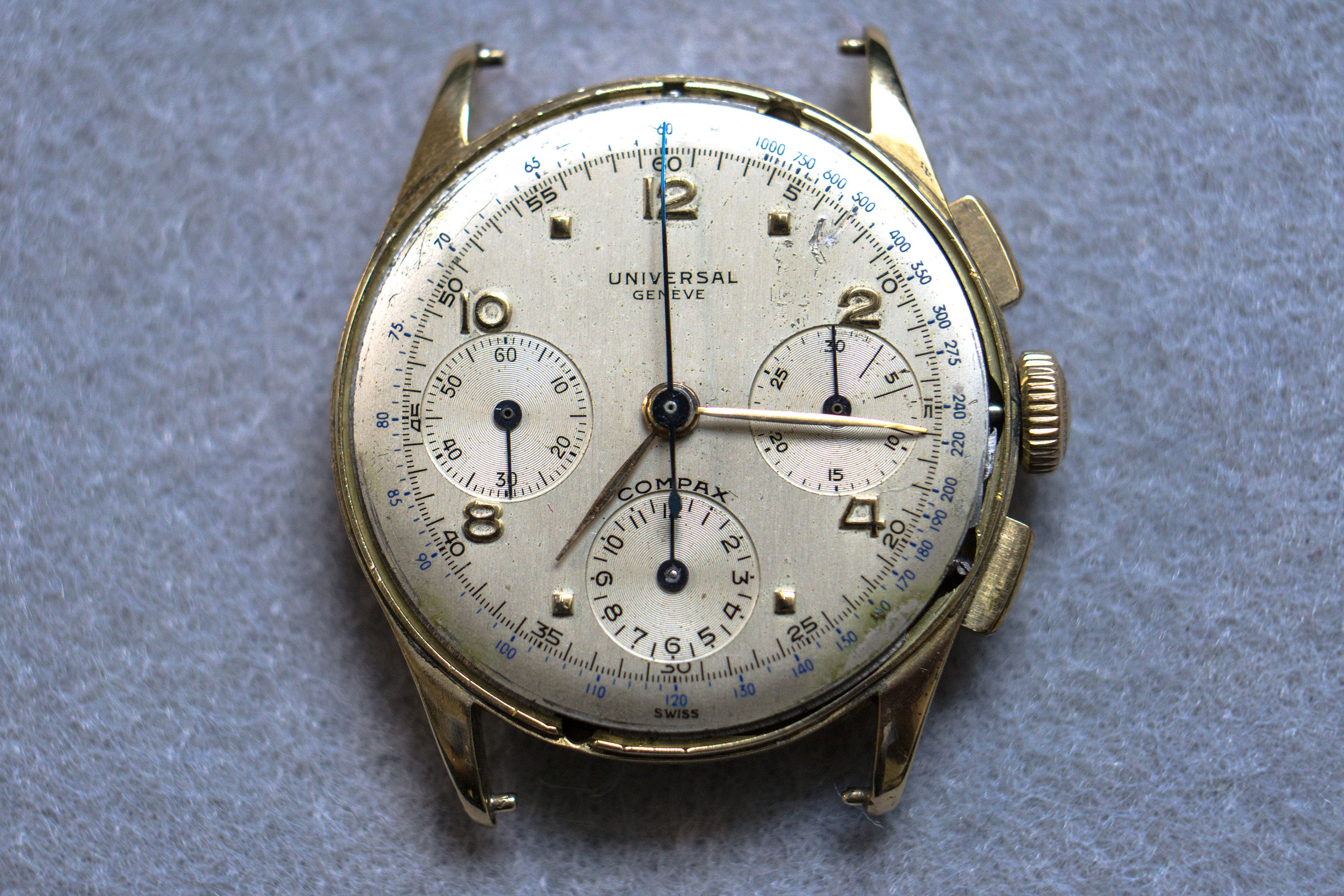

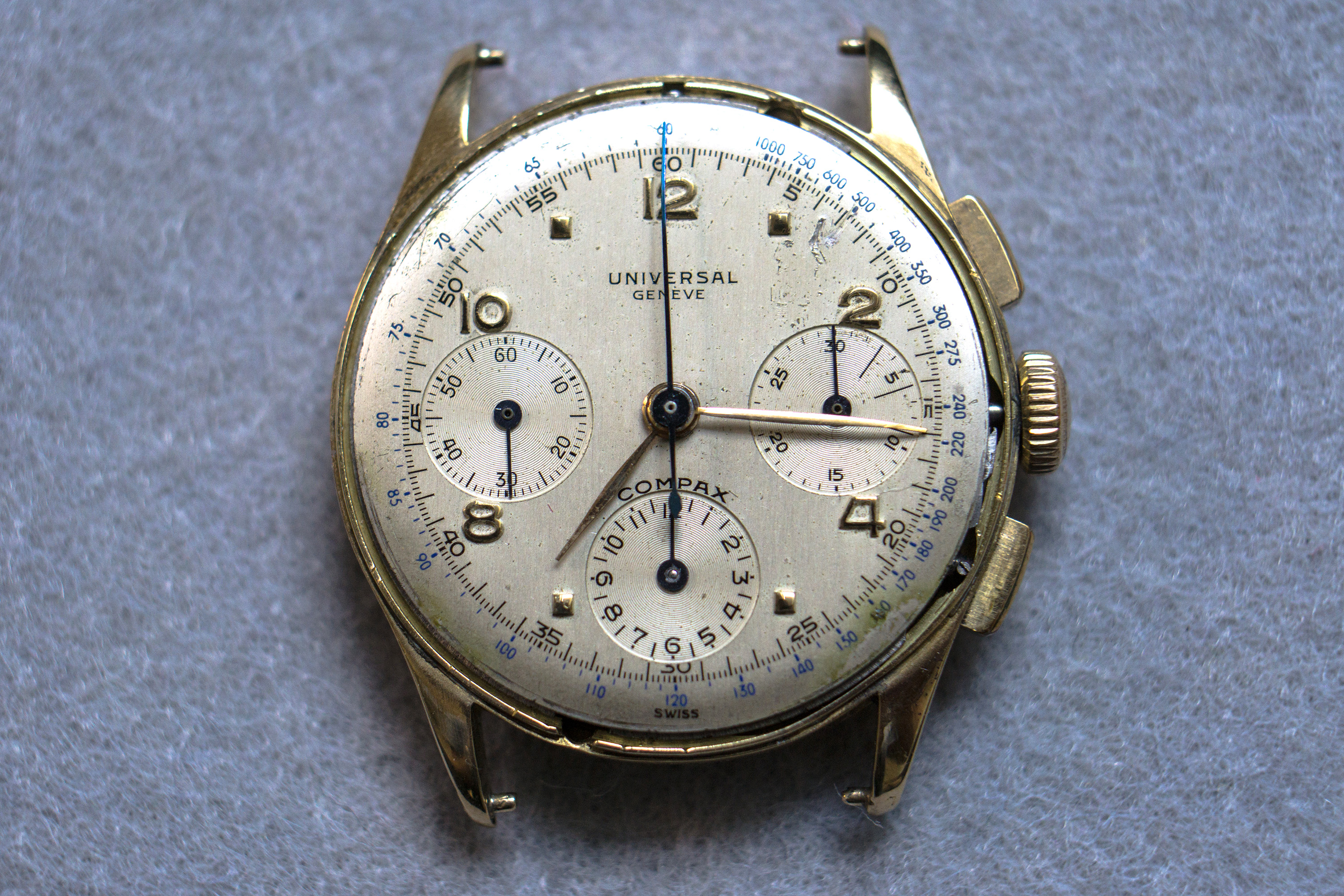

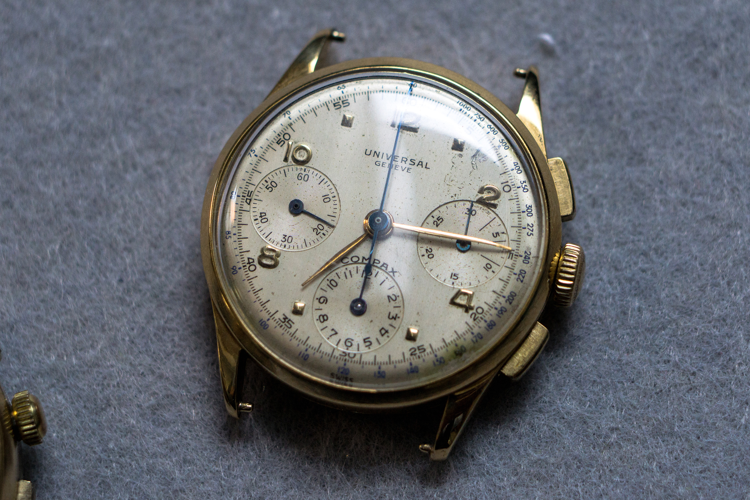

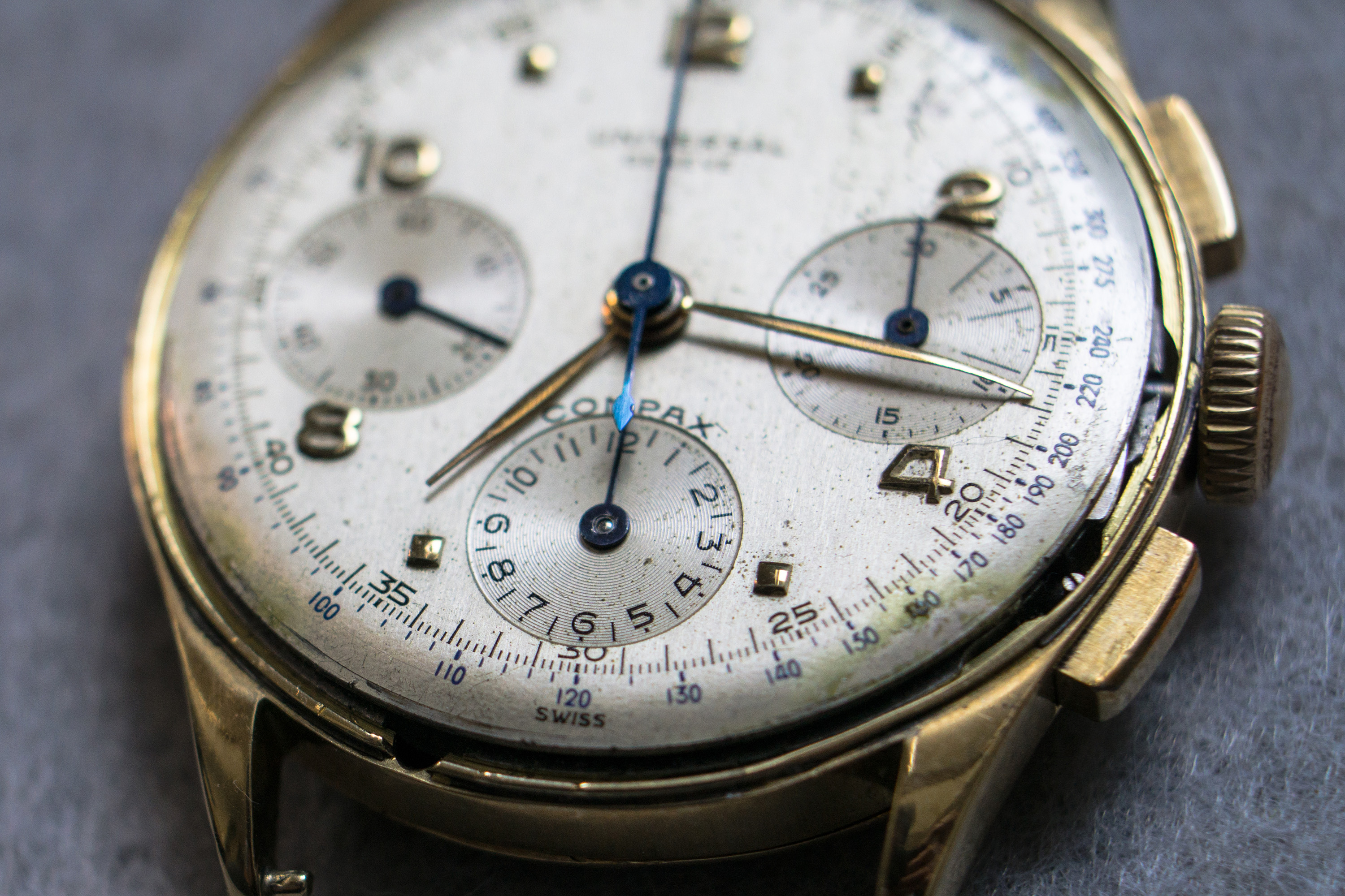

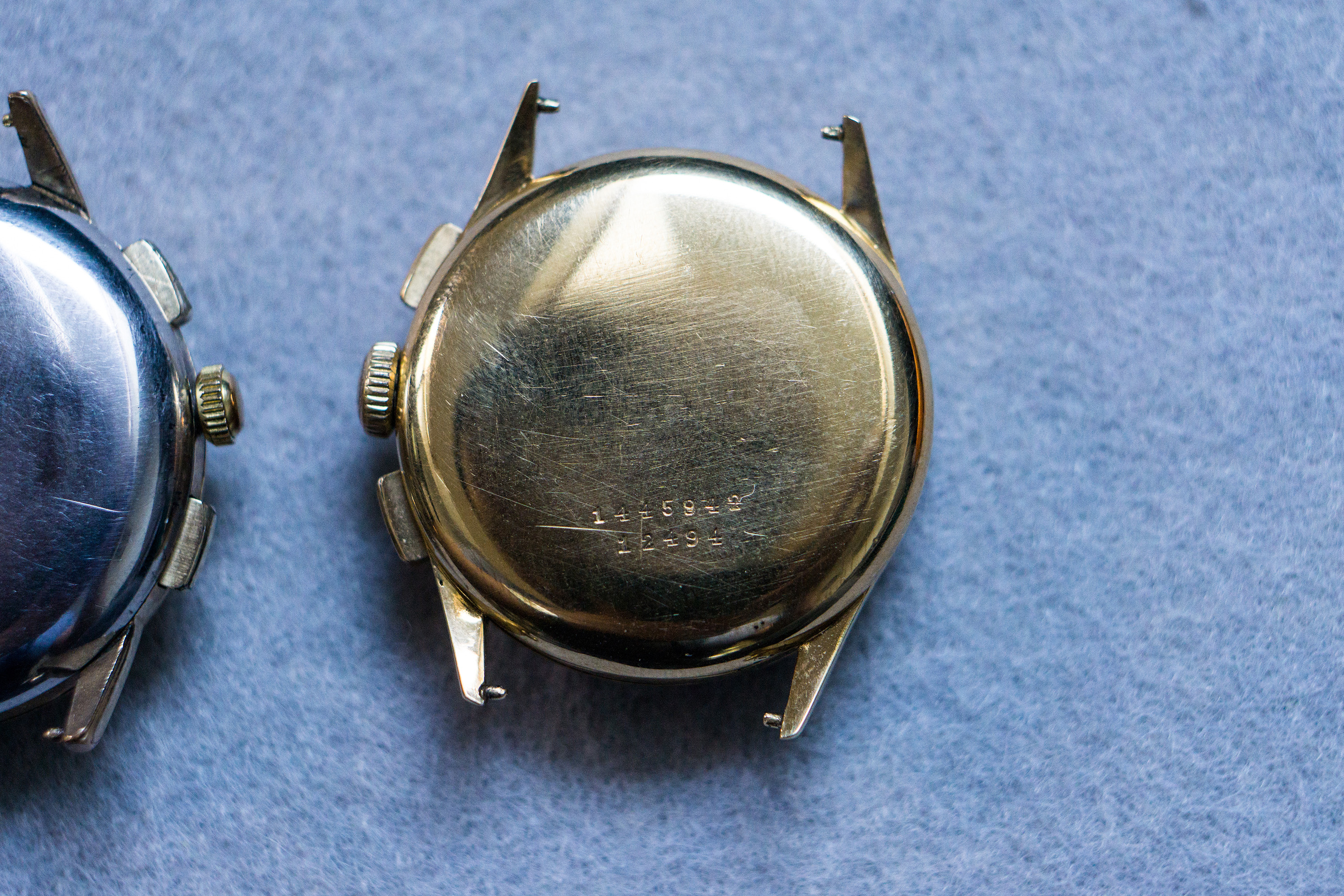

The second is a solid gold 18k Ref. 12494 Compax with a Cal. 285. It has some dial damage (or strong patina 馃槈 ). All in all it looks genuine to me, or am I wrong? I really like the hands how they change color in the light. Something I dont have seen before.
Would love to hear your thoughts,
Nico

Hi Nico...the Tri Compax is a redial I'm afraid. Rounded tops of 3's is usual giveaway.

Should have open 6 as well. Compax is fine. Price should reflect dial issue, but it鈥檚 a good watch.

Hey congrats on the find. But yes I vote the Tri is a redial. No open 6 or 9 on the hour sub. The Compax looks better but like the Tri above it the word compax doesn鈥檛 appear even and is awfully close to the subdial.
So you think the Compax is a redial too?

I鈥檓 going to vote original but Im just unsure about the font and placement on the COMPAX. Admittedly I look at way more Tri鈥檚 so my eye is not as keen when it comes to Compax.

As Larry already said, the Tri is redial and the Compax is good. Also the Tri date hand, hour, crown are wrong, and the lower left lug looks seriously bent. There鈥檚 still valuable parts there.

Ok, I had some hope, but I guess I knew that it鈥檚 not fully correct. What is the Tri-Compax worth in parts? Maybe I can at least break even and fund the other ones 馃槈

Awesome find. The compax looks nice to me- I don't mind the patina / age - it's still beautiful in the light. A treasure trove all in all.

I am in complete agreement with Larry. The tri-compax is a redial but the compax is good. I was a little worried it may have been a later dial on an early case but it is not. A very nice lot !

I would've been just as confused and enthused - just getting into UG a bit - that Compax looks great to me though; I actually like how it has aged...looks like the sort of thing an 'Indiana Jones' type would still be wearing to remind him of the good old days when he and the watch were both young! 馃榾

I kindly have to disagree on the assessment as a parts watch. The reprint is not bad. It is an old one with thin printing, the alignment of subdials and scales is well done, nothing that is really ugly. So although it is not a collector's piece, it should still attract many people who are interested in a Tri that looks nice and who are not chasing for the perfect original watch.
I would not disassemble the watch and sell it in parts. I agree that the hour hand doesn't look very nice so I would try to replace it and list the watch for a reasonable price. There are so many ugly redialed UGs out there that I am confident it is possible to sell this watch with a quite nice redial.
