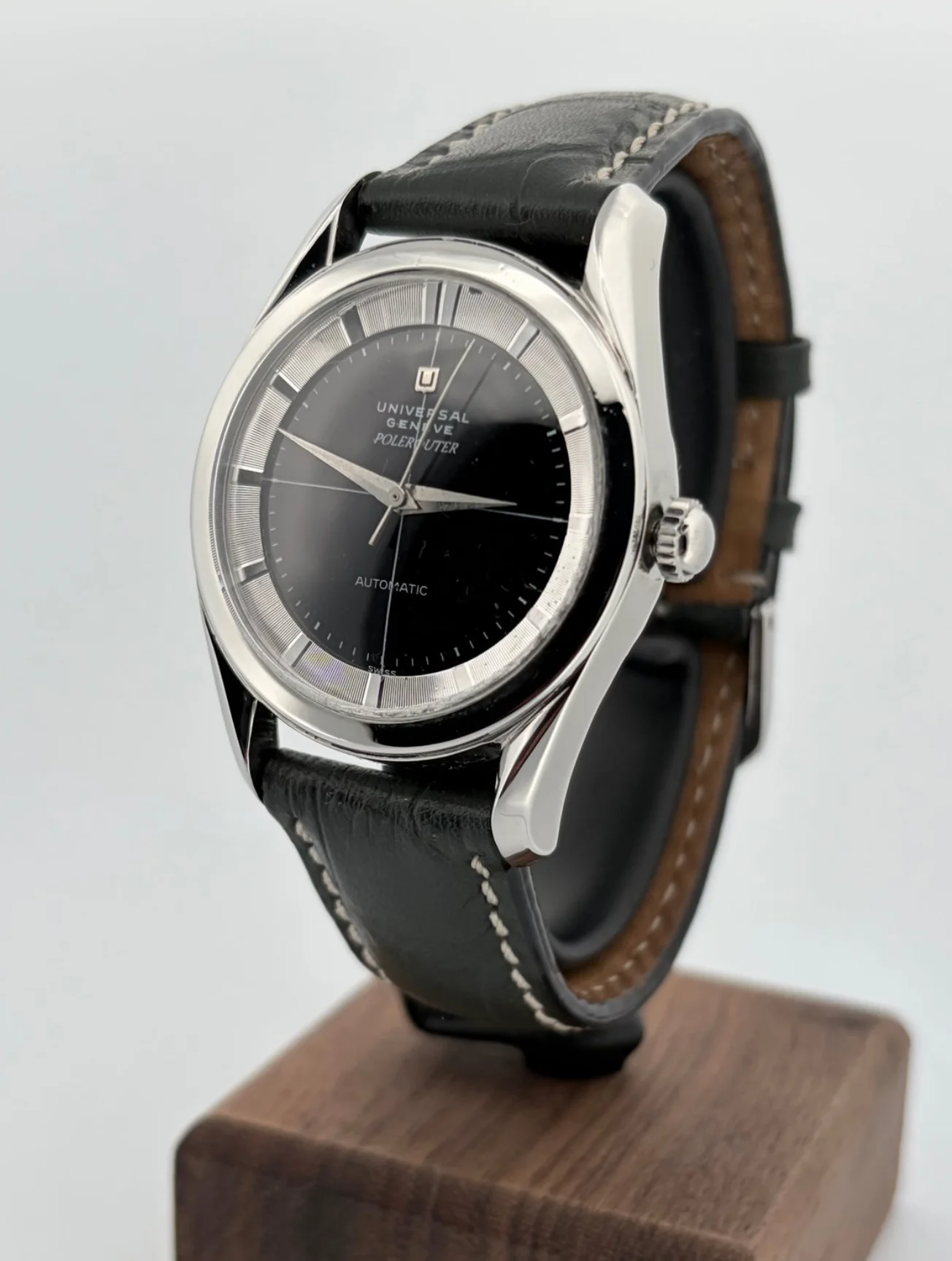

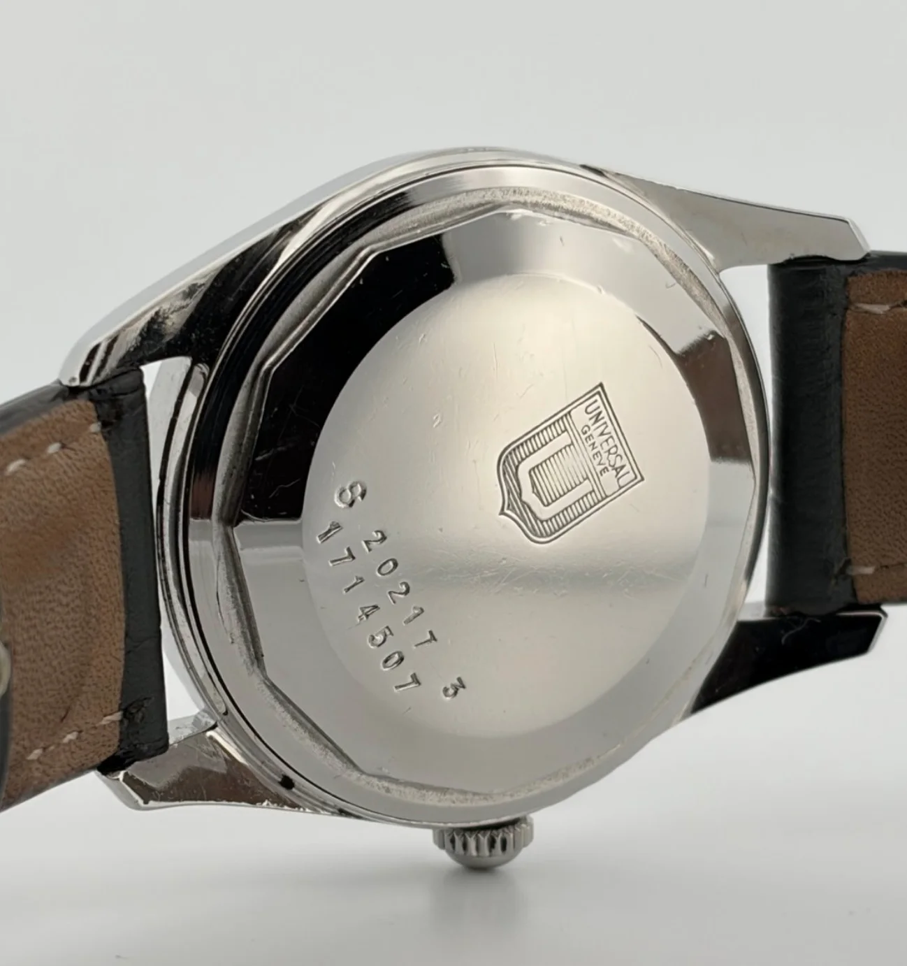

I bid and won the below, but I have some worries about whether this is a legit Polerouter given the inconsistency in serial number - dial etc.
Description reads:
• Reference: S20217-3

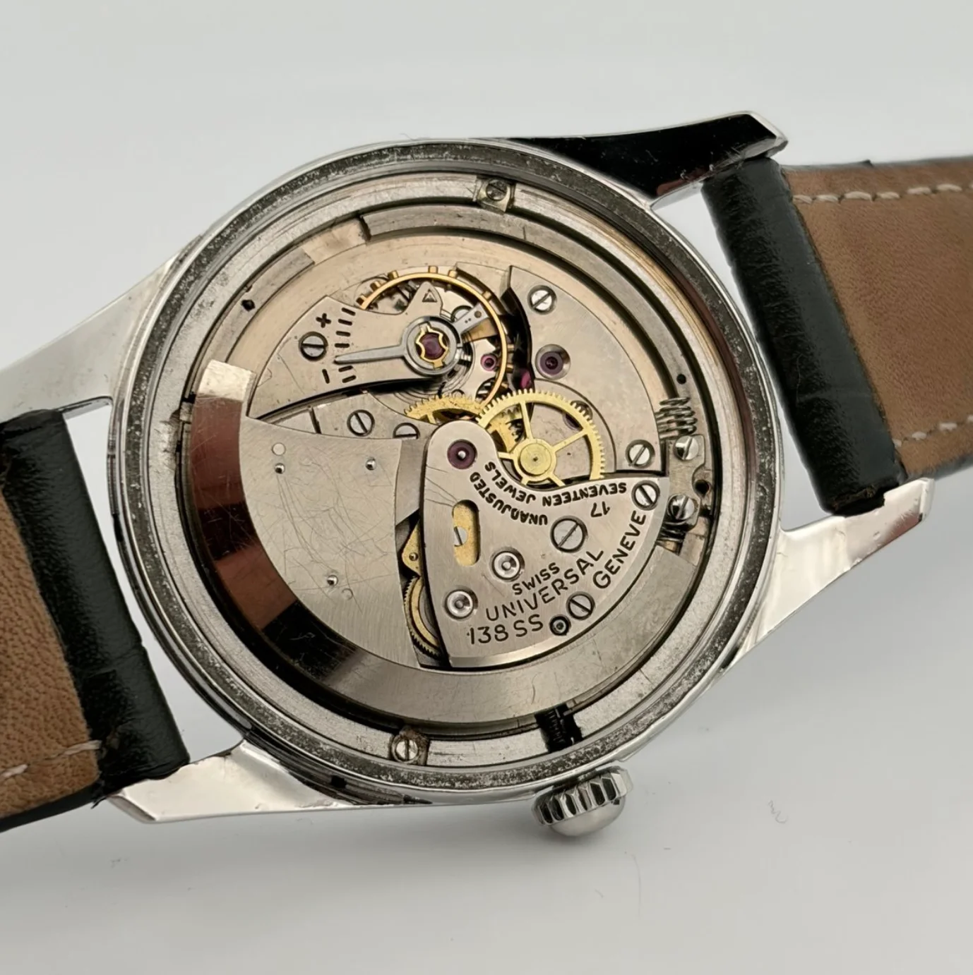

• Movement: Automatic, calibre 138SS, signed and in excellent working condition
• Case material: Stainless steel
• Diameter: approx. 35 mm (without crown)
• Dial: Original black dial with silver inner ring, in beautifully preserved condition
• Crystal: Plexiglass
• Crown: Signed
What do people think this is?
32

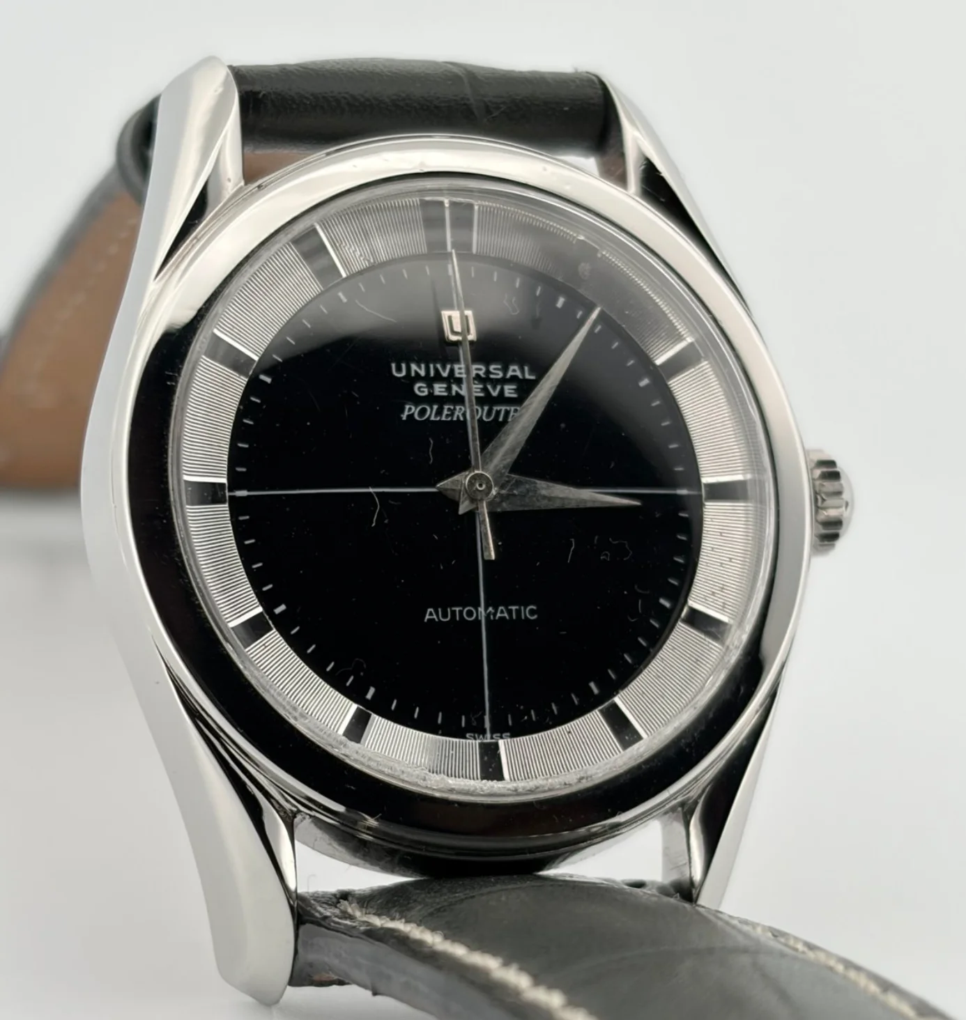

50
