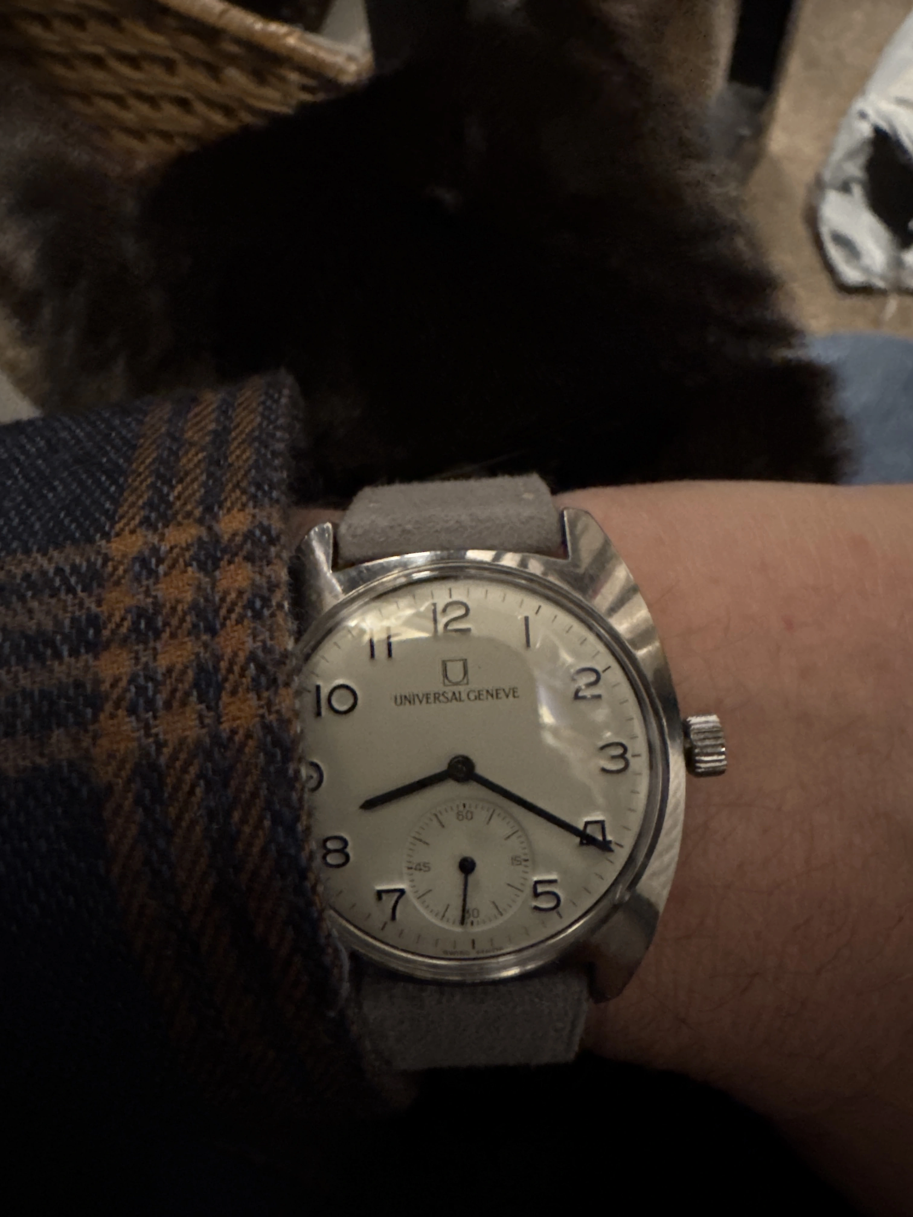

Hi UG experts,
Thanks to @Rman and his wonderful thread, I found myself picking this beauty up from Ebay Italy.

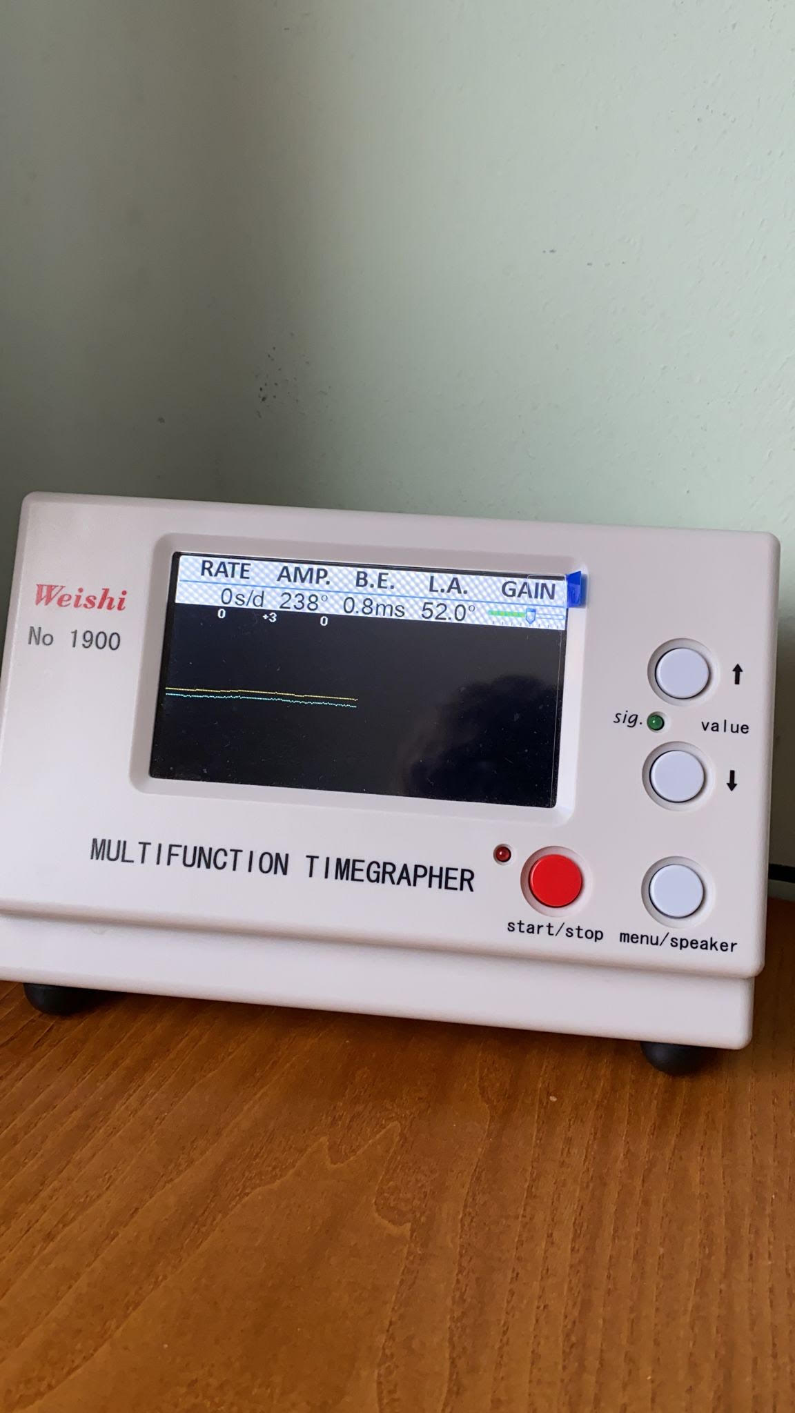

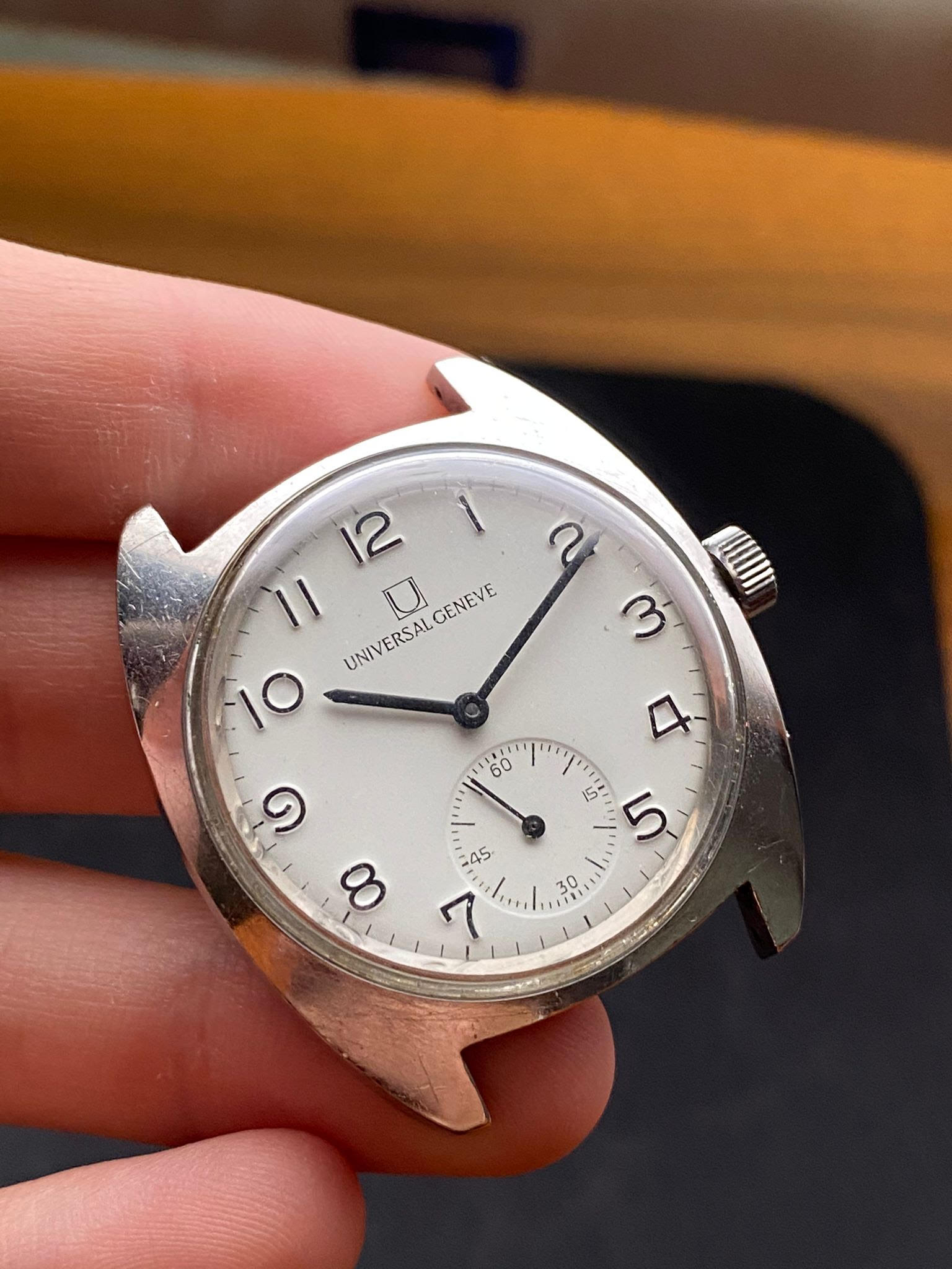

Suffice to say, I can't complain about the timekeeping ability although I still still have it cleaned and serviced. Although I did notice the crystal retaining ring is overlapping the "swiss made" text on the dial. I would love to find an original if not something a little bit closer to replace the current crystal.
I was wondering if anyone knew the part number or had a potential source for getting a new retaining ring + crystal for these guys. I tried checking the usual places but I haven't had any luck yet. Any advice would be very appreciated.
Thanks!

My unique problem is not a plexi but rather getting a retaining ring that won't block the "swiss made" text.

For anyone looking, the crystal you want is a size 320 (32mm) high dome. Get a crystal lift and make it happen. Crystal is cat approved as well.
