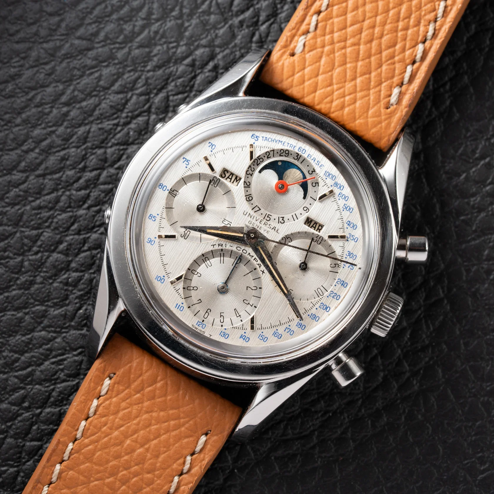

Congrats on the watch, I'm also looking for 222100 and also going back and forth between variant 1 or 2. As you said mostly variant 2 is available online.
I'm looking into this one - seems it is not sold for months, so wondering if something is wrong with it:
https://www.lepetitsuissewatches.com/products/universal-geneve-tricompax-chronograph-ref-222100
P.S. As everyone said, don't touch the hands, to me they actually elevate the piece to another level.
3,721
8,555

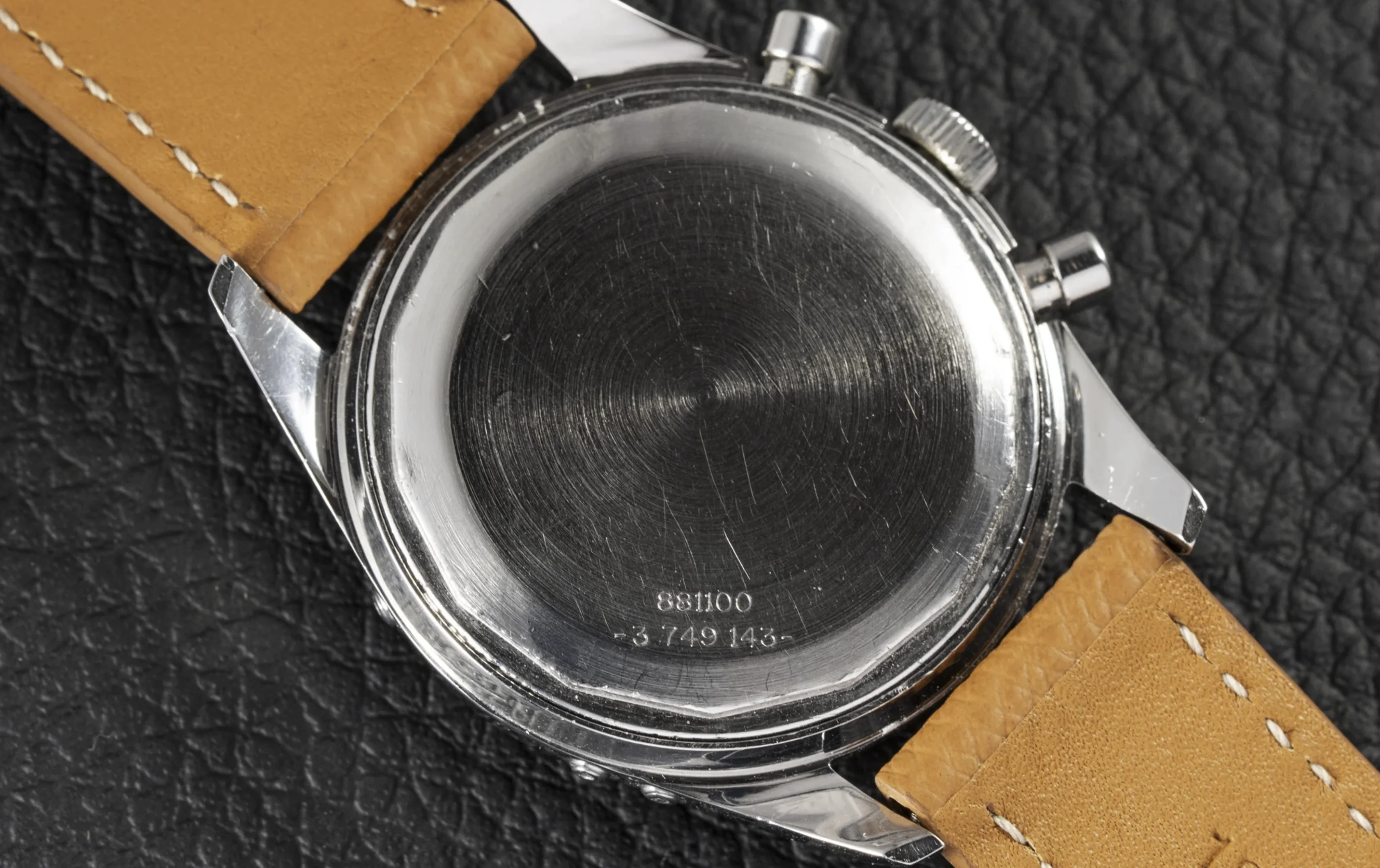

The chrono sweep hand looks wrong, and maybe my eyes are playing tricks on me, but I'm not sure both pushers are exactly the same? But more importantly, the caseback, offhand I'm not familiar with this ref # or this very late serial. Was UG throwing stuff together very late with remaining inventory as the company was spiraling? Would require research.....

The dial is good and rather attractive. But there are some issues. In addition to what @bgrisso has stated, the crown is also later (service?) and the box and tags seemed to have been cobbled together to make it a set and justify the high price.
Also, the caseback of these are notorious for their reference number and serial rubbing off. This caseback reference no is wrong (from what I've usually seen) and the serial no range seems much later so perhaps its the wrong caseback for this reference that just happened to fit it.

I was assuming so, but I'm not even aware of this reference at all, from any time period? The normal engraving is super light, these are deeper and the font looks different. I suppose someone could have re-engraved with wrong case reference and serial, but that seems very weird? Given that I've never researched this issue, withholding judgement and hoping someone else might jump in with some other examples or info?

I didn't notice wrong ref. number, and I'm not familiar with the dimensions/look of the original crown.
It seems there is 881101 ref, but not 881100 as bgrisso said.
I've asked the seller about hands being pontentially non-original and caseback, and they replied everything is original and that probably UG fitted this caseback from the inventory.
Is there some different reason for replacing the caseback other than having engraved ref/serial numbers to inflate the price of the watch?

The typical crown is the "U shield" logo, not the "fat U" logo. However in this situation where the crown has the later logo, plus the box and hang tag with the fat U (but we don't know if they are original to this watch or added), plus the extremely late serial number and weird case reference, it makes me wonder a little if such a thing could exist? With UG I generally refrain from making absolute statements without extensive research, which I have not done, so all I can say is that I have not seen this before.
Looking again at the chrono sweep hand, it looks fine.....before I thought the tail was missing but now I just see it's how it's catching the light in that particular photo......
Anyhow, the first question for the seller, or for any interested buyer, can you find another reference 881100 anywhere?
The value between a caseback with numbers visible vs not visible is not especially significant, I can't really see someone swapping or engraving the case back just for the purposes of trying to get a little more $$ for that reason. What is more likely is this caseback is simply swapped from something else because the original caseback was lost. But what's odd in this example, is swapped from what? Again, I am not familiar with reference 881100.

Yup, never seen or heard of a reference 881100 anywhere.
