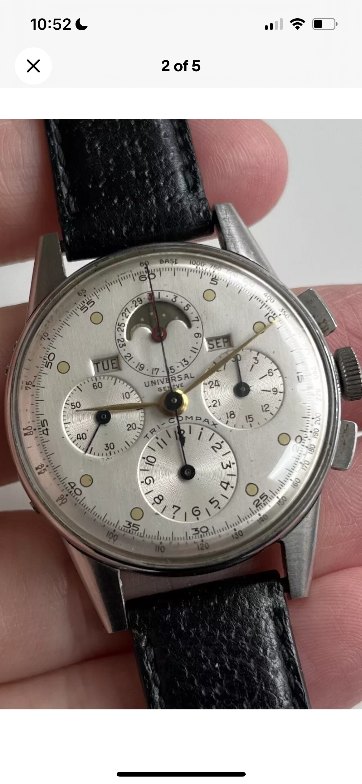

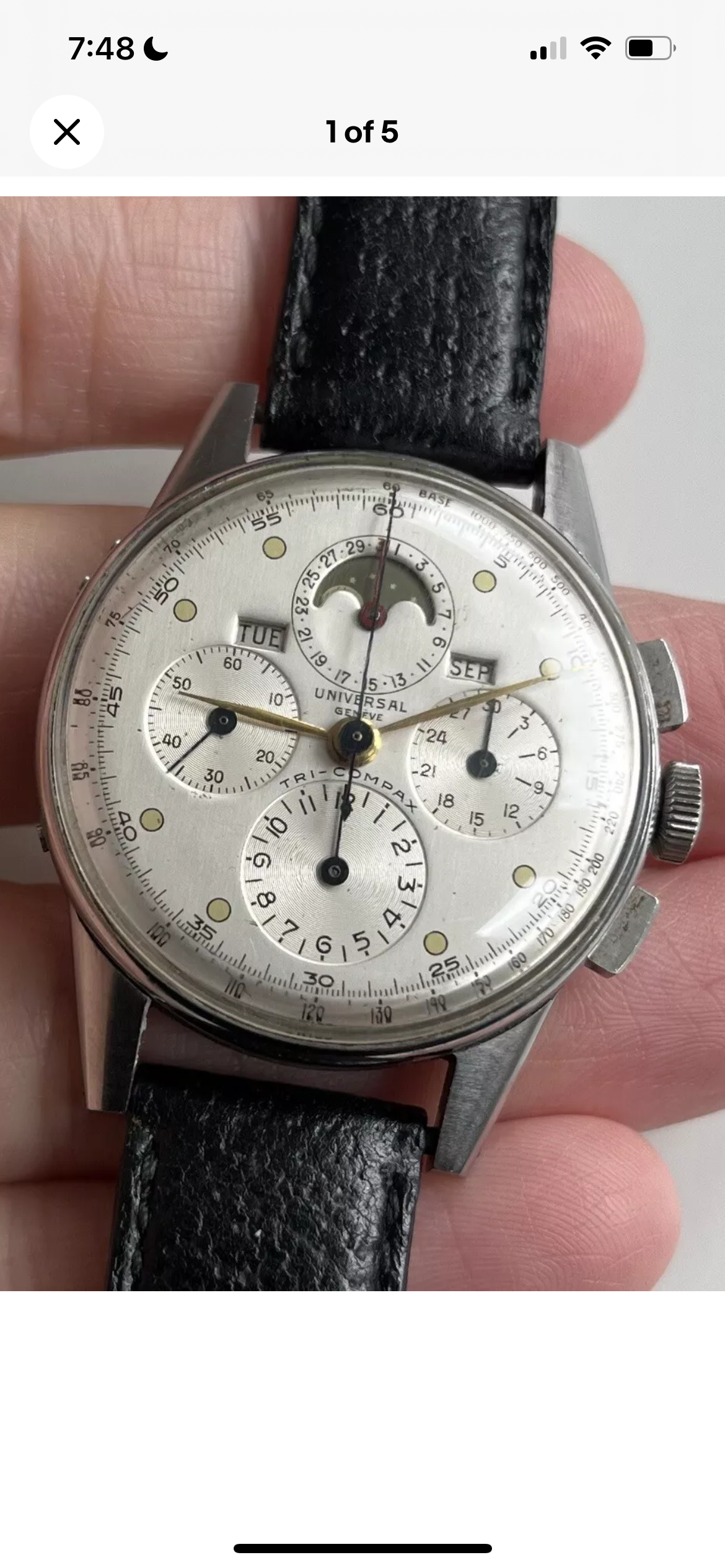

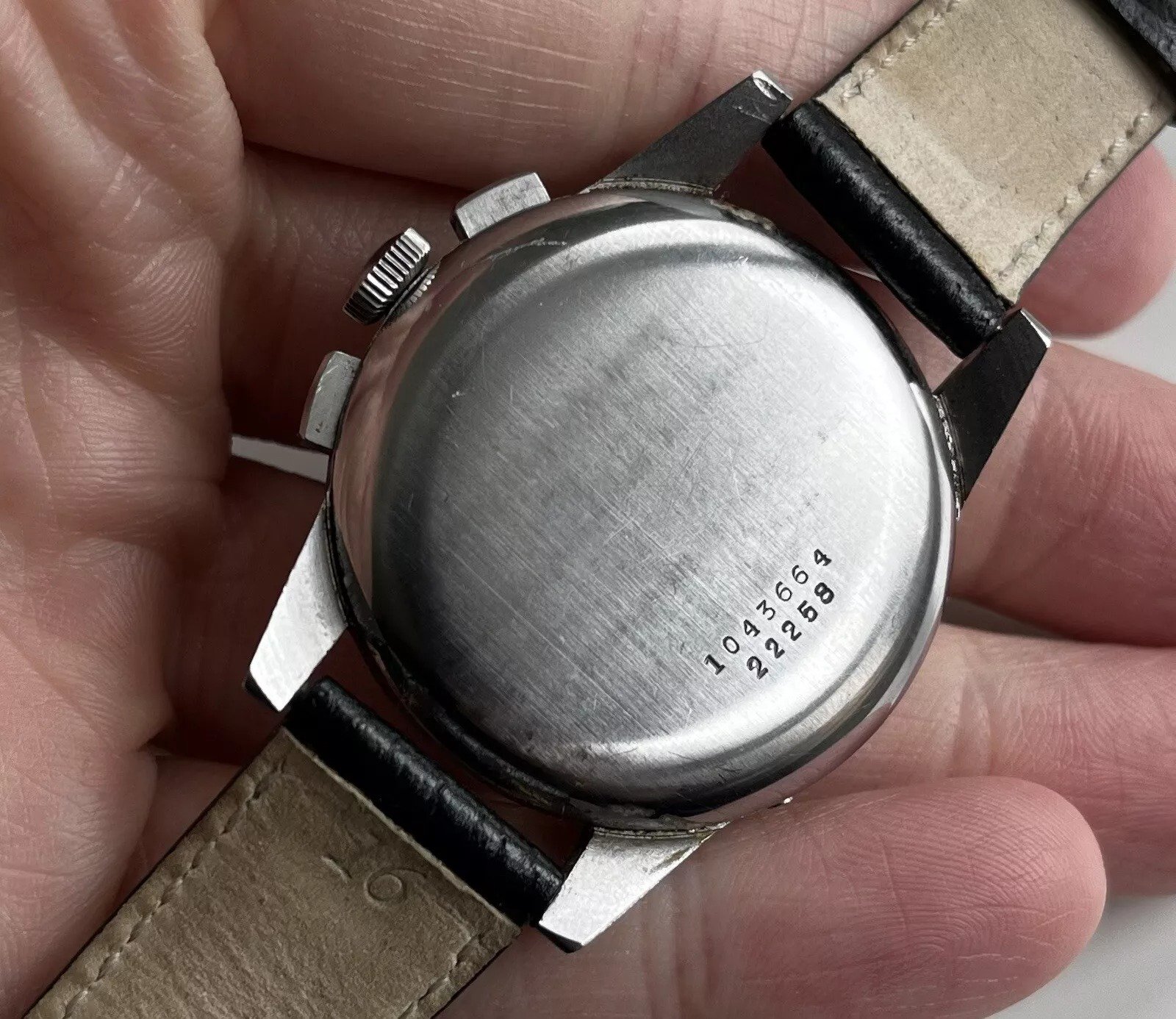

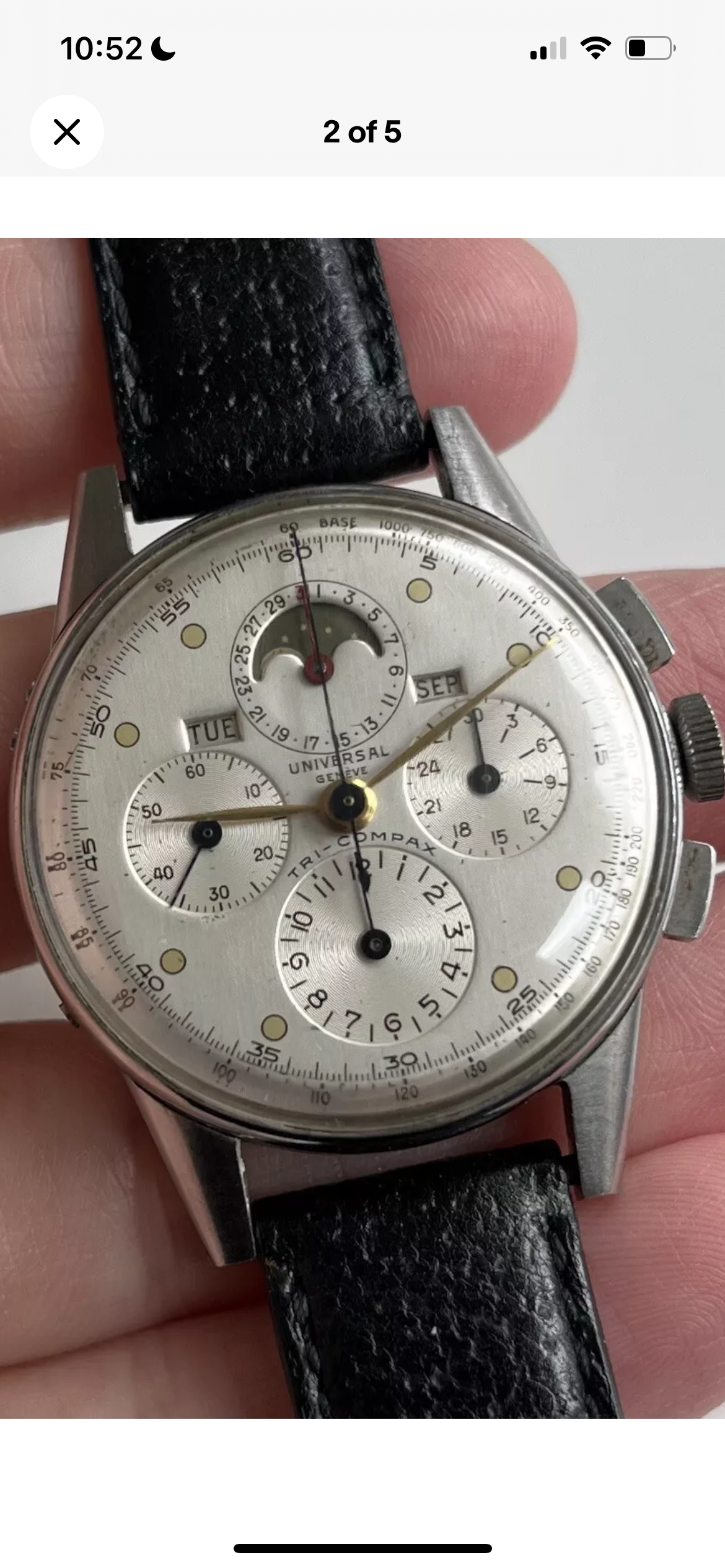

Hi, just purchased this Tri-Compax from eBay. I did some research about the reference and the dial (perhaps I should have done more) before purchasing and thought it checked out. But I’m feeling a little nervous so I figured I would get an opinion on here.
I saw this thread below with seemingly the same exact watch and they all say it checks out. https://www.watchuseek.com/threads/authentic-universal-geneve-tri-compax.5231623/
W
orst case scenario, it’s a redial and I simply open a case for return once I get it. Thanks in advance!

40s dial. Long telephony and open 6. Not a redial. When you come here for info we need S/N and reference. Moon is most likely original. I hate when sellers fail to show the moon in full . Nice piece from what I can see.

Something else a Compax collector told me to do was test to see if the markers are painted or are lumed. If lumed then the hands are incorrect since to my knowledge the rule of thumb is lumed hand for lumed dials.

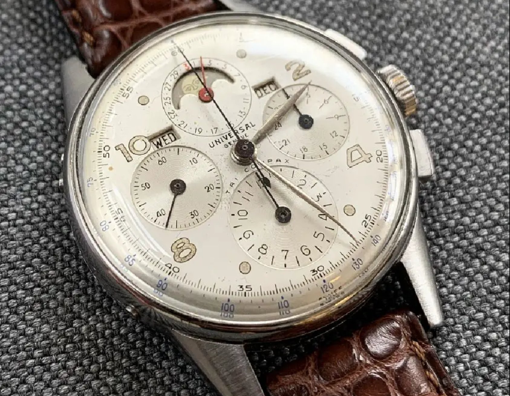

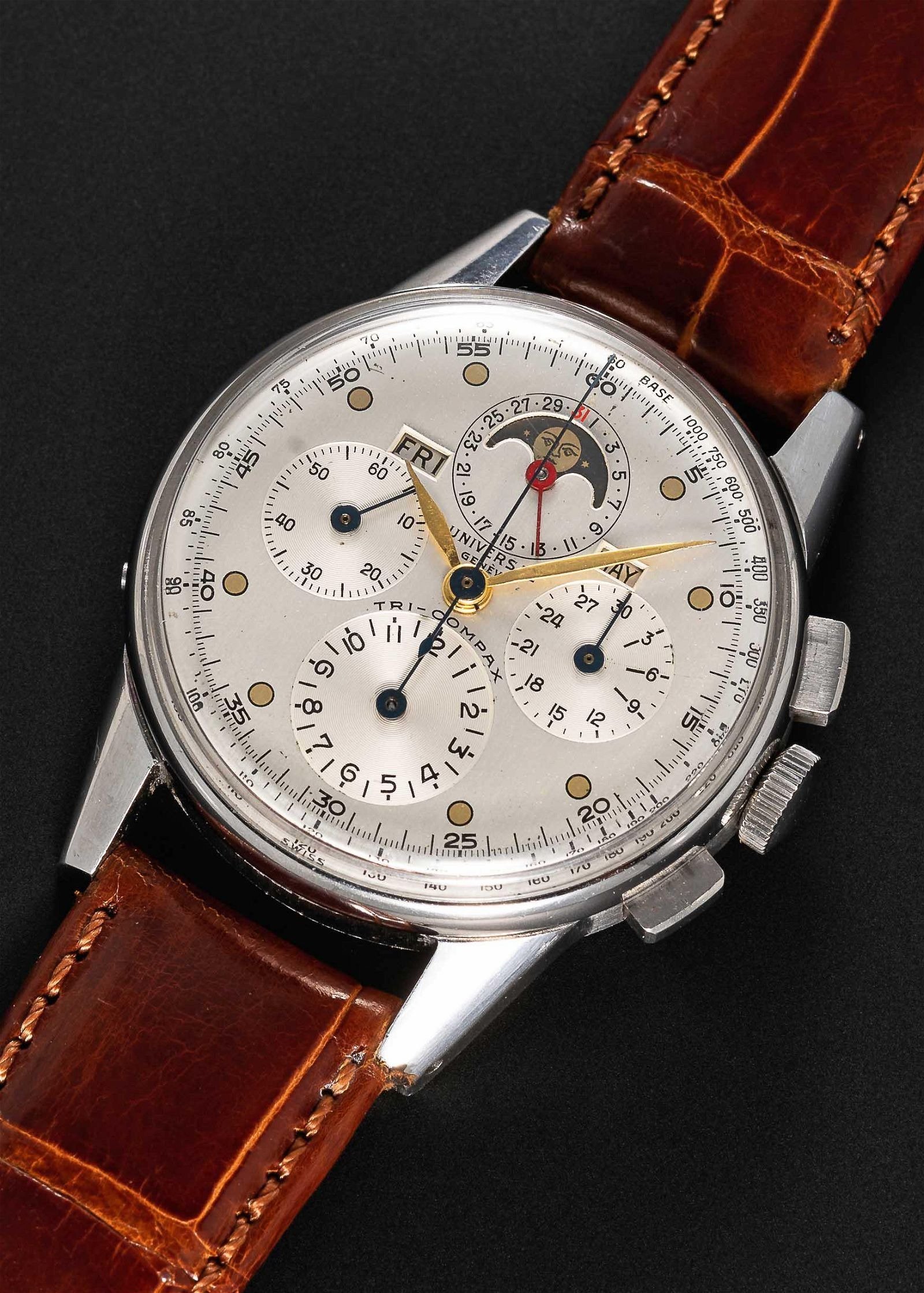

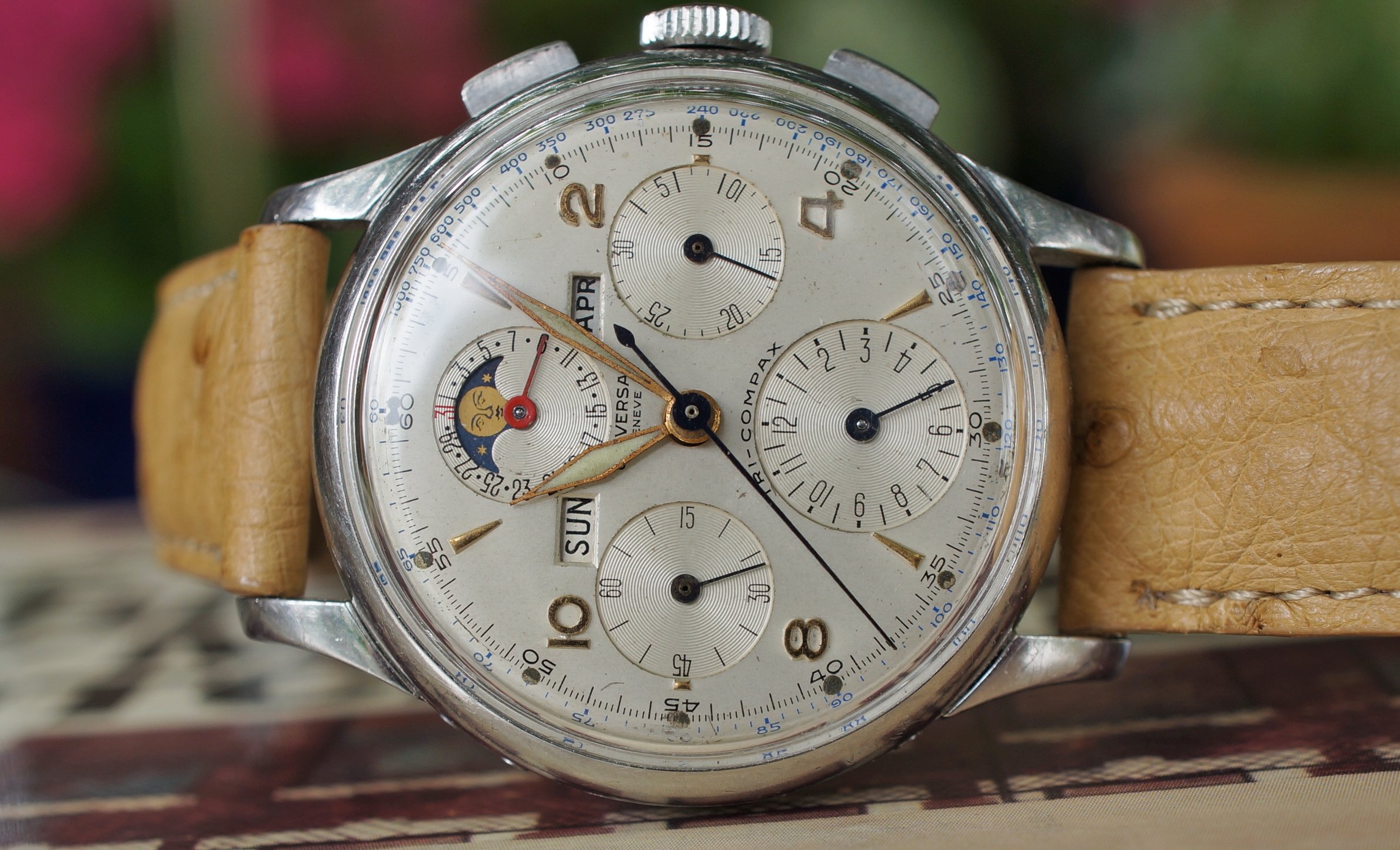

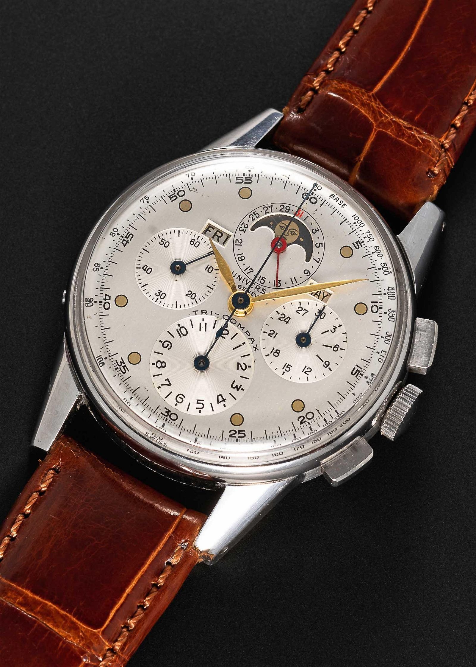

correct. but I think they are probably gold foil, as per the second example in this thread. just not great photos so they look weird. Anyhow that's my guess, definitely confirm in hand.

Your indices are not lumed. You got a good watch. It need a full overhaul as I’ll bet the moon mechanism needs work.

Anything I should look out for? If the moon phase moves fine I should be in the clear right? Or two be clear, any specific red flags you notice apart from not having a full picture of the moon in the listing?

Update: Everything looks great in terms of all being genuine. Moon phase, date, everything looks good except the mainspring is broken. So if anyone has a connect for a 481 movement feel free to send me a message. I ordered a few online so I’m hoping they could come in soon and I can get some power into this guy

Honest question from an UG noob, is it normal that the dial in the OP has such soft edges (around subdials and apertures)? The other examples shown also look much sharper.
It looks like before painting someone softened up the dial with some abrasive (as is often done with a refinished dial).
